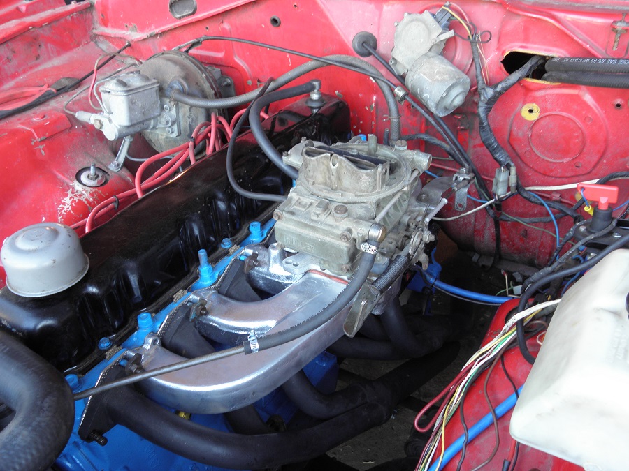

  1. Yep, 265 and 73 VJ Charger.

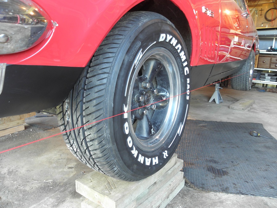

  2. After rebuilding the front end all shims went back where they came from but heres how I set toe in.I still got it reset at a wheel alignment place but this is good enough while I'm test running it. Also a shot of my next project. The make should be obvious but who can get the model?

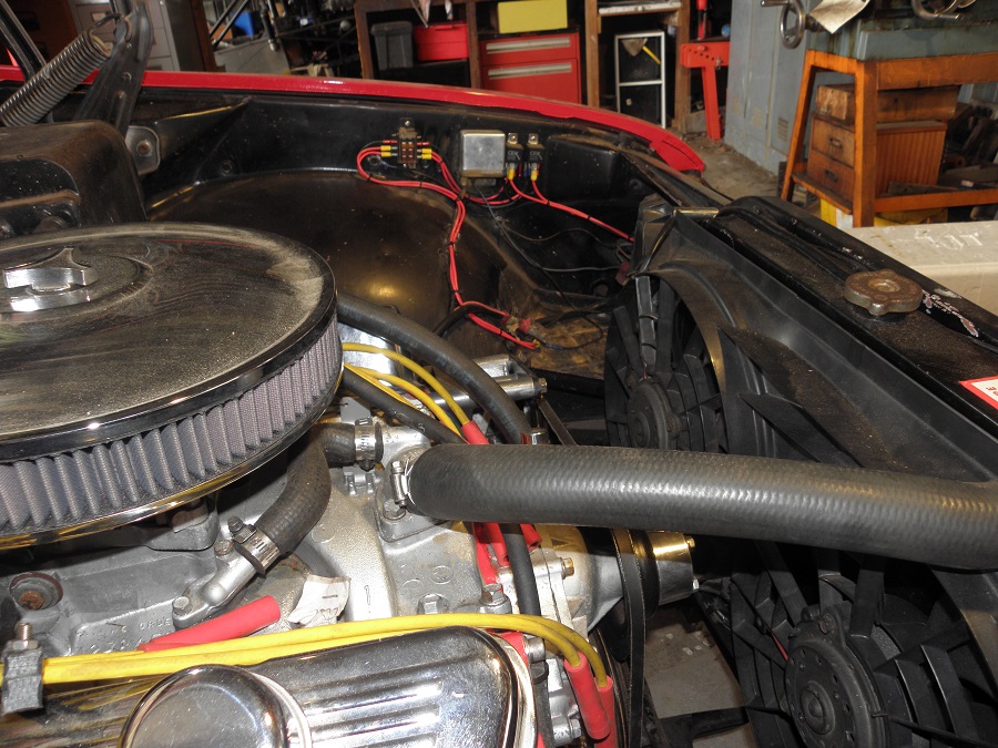

  3. I also decided to go with electric fans .These are actually from a Falcon and the advice from my radiator shop guy was to fit the sender switch in the bottom tank,which I did.

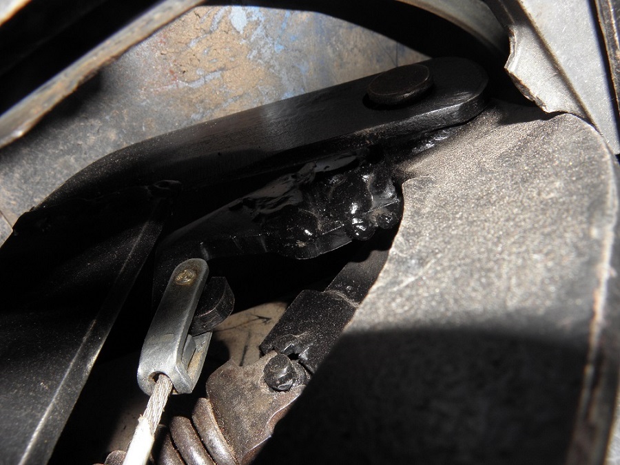

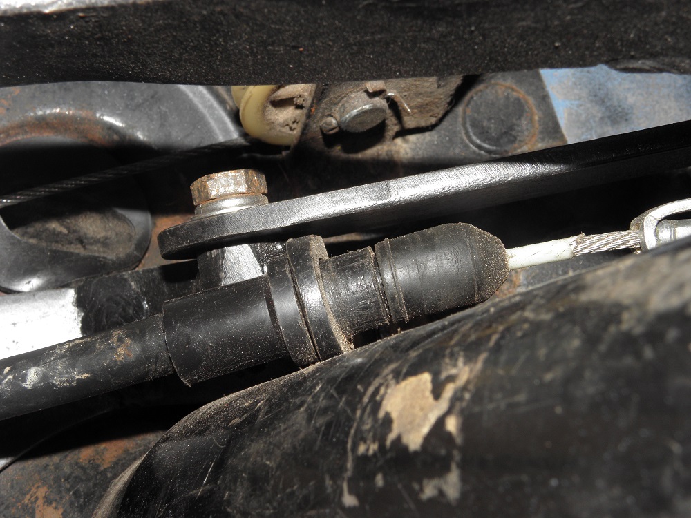

  5. About time I updated this.I got the car road legal in January and since then since then been busy on another project.Anyway another of the modifications I did was to the clutch mechanism. I wanted to convert to cable clutch to suit the bellhousing .I spent the best part of three days getting the distances right so I had good travel and was light to use.Of course most of the time spent is bolting it in and removing it everytime you change something.The end result works perfectly though unfortunately I didnt take pictures of the assembly while it was out of the car (or measurements ) but here are some pics of it in the car.
