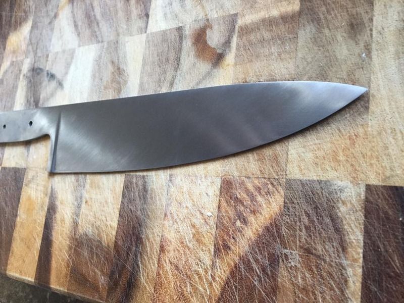

On the home straight of sanding now. One side done up to 600 grit, the other up to 120.
Next up will be heat treatment. Still yet to build the legs for the mini forge, but the burner is now complete - also visible in the above pic. The non burny end of the burner has the following assembly - pretty much just a valve and a couple of brass bits fitted/brazed together to attach a standard BBQ hose and fit it to the 15mm steel pipe. Have a couple of oriface options with a 0.8mm and 1.0mm option. Can just buy more caps and have different sized holes drilled if necessary
At the end of the day its just an oversized Bunsen Burner - hopefully enough to heat the forge up to the 800 degrees I need toe knife to reach before dunking it in oil

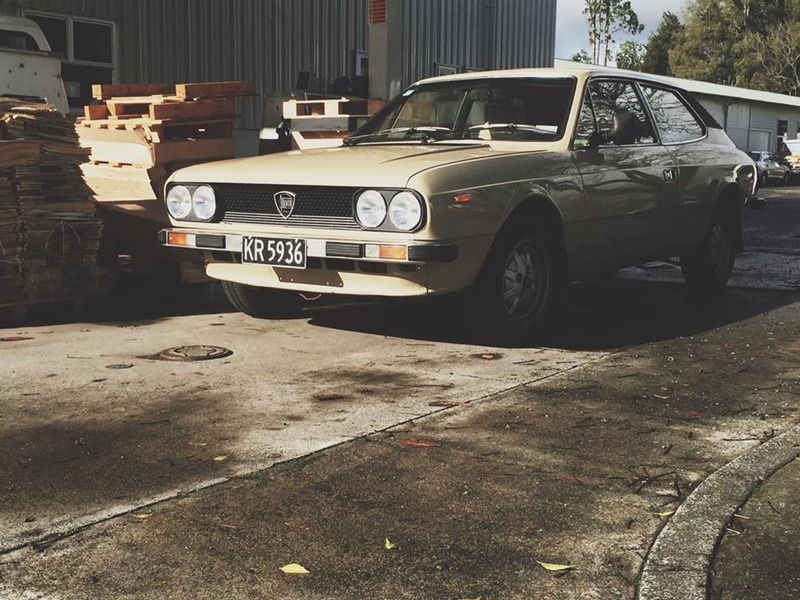

A lil Lancia action sitting on the work grounds.

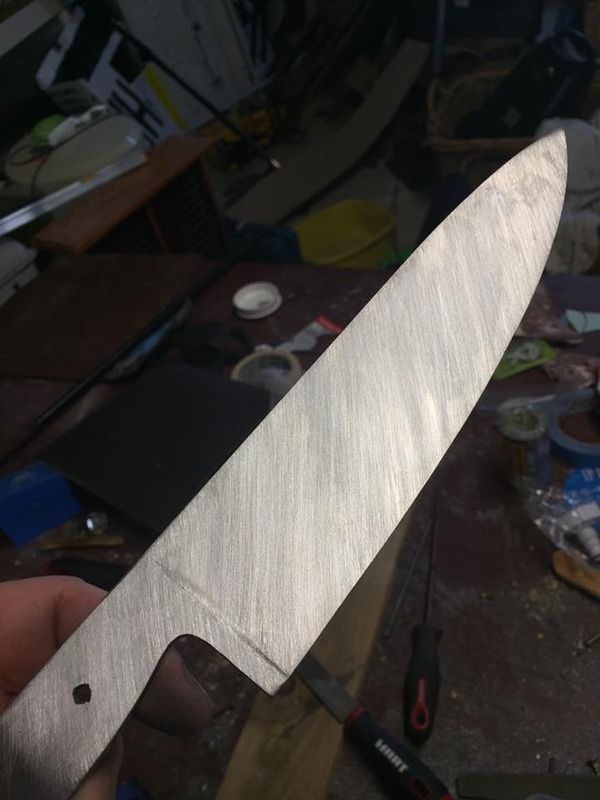

So then is it heat treatment time? So was that just
File the bevel on then remove the file marks with the paper? What oil you useing for heat treatment?
Yeah, I should have followed up the bastard cut and second cut filing with a smooth cut file. Some of these file marks are a bit of a pain to remove even with 120 grit. once I've finished it to a reasonable standard, i'll heat treat after I've built the burner for my mini forge. Plan is either Canola or Peanut oil - whichever is cheapest that I can buya couple of litres in bulk. Then back to sanding up to 800 grit for a nice satin finish. Then its handle time, followed by sharpening and murders - I mean slicing onions. I may acid etch the blade with ferric chloride or hot vinegar before I put the handle on though. At least help a bit with corrosion resistance being carbon steel.
Shit that looks good!!!
Cheers! Started working on the other side but ran out of 120 grit tonight. 10 sheets burned through pretty quick! Thankfully the hard work is done by then and the 240 then 400 don't take nearly as much

I've been thinking bout having a go at this to. Did ya just start with a blank say 3mm wide?
Yeah bought a couple of 2" x 18" x 1/8" (about 3mm thick) flats of 1095 steel from the US (Damned if I could find it here!). Carved out the knife with a hacksaw and a file
Made a beveling jig similar to the ones you can find on YouTube

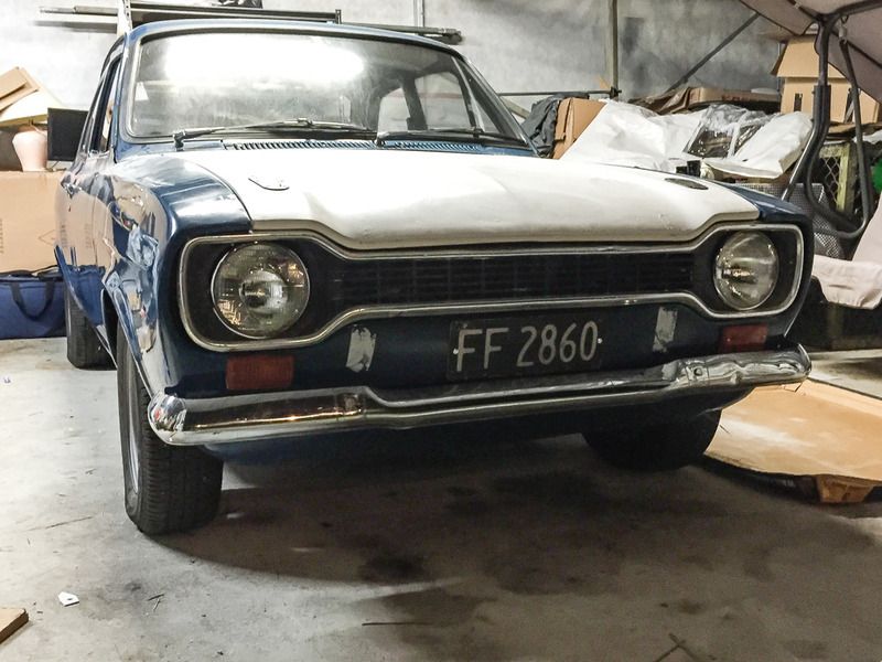

Grabbed some of the headlight buckets from Palmside after getting fluffed around on trademe by a couple of guys. Trial fit of the round headlights followed:
