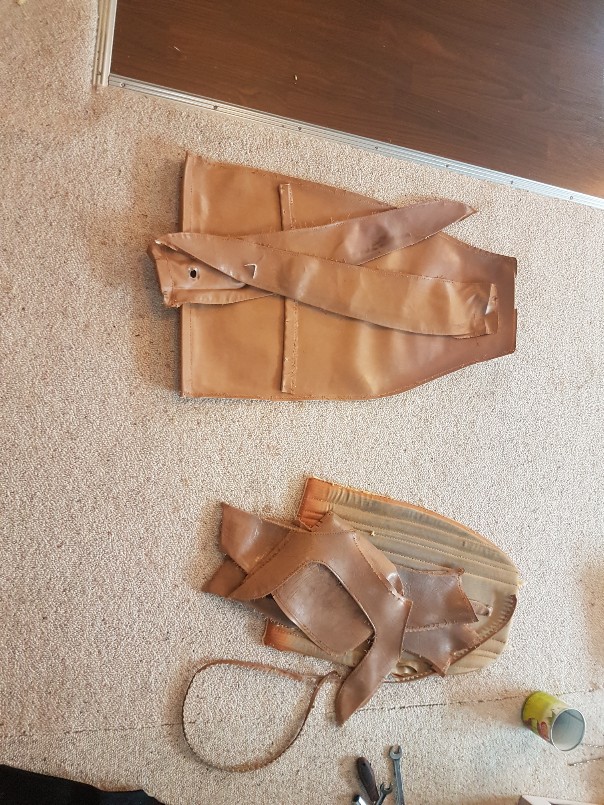

  7. That's the finished product for one of the seats. Defanatly not as easy as I thought. I appreciate the work of pro upholsters. For a first attempt, I think it turned out alright, better then they were before, I think anyway. There's a few loose bits that need to be stretched out, but not sure how to do it without taking the cover back off and glueing it down.
  8. Here's a Bit more pictures of the sewing. It's quite hard as the machine is super quick and i can't slow it done anymore. There's no room for mistakes haha. Un stitched the old covers and traced them onto the new vinyl. Got them sewn up along with some pleats and piping.

  10. Got the seats all pulled apart. Marked all the peices so I don't get lost and have un stiched all the pieces. Iv ordered some black vinyl material. And some piping cord. Also bought a industrial sewing machine for $50.
