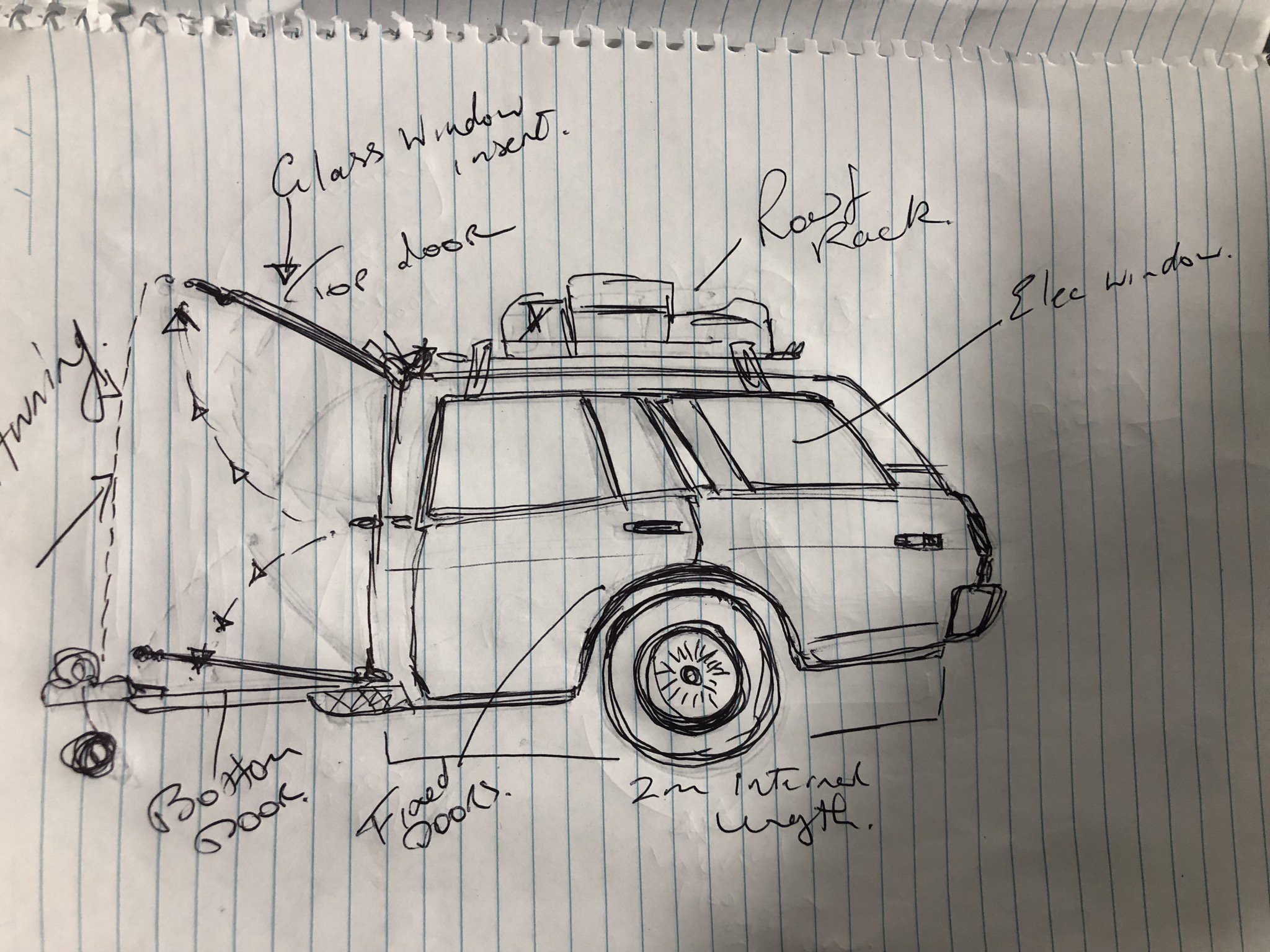

So originally I bought the stoved 230 wags for the rear dickie seat. This required sawing the car in two, hauling it back to a mates workshop and getting it into the air alongside my 330 wagon to get the right fit for the dickie tray into the 330...
We were just about in the act of cutting the green stoved 260c in half; when old mate Who was assisting me in chopping the bitch in two exclaimed “Why not make a half car camper!”
the makita was put down and things quickly went the way of a half wagon/camper (half 230 would that make it a 115 260c?).
these things have plenty of room, totally flat floor, makes sense, and would look the part behind my 330.
if i’m lucky the one in Victoria is okish; then I might be also able to come away with one good wagon as well as a trailer, as well as sort out some parts for some other antipodean 230 wagon purveyors.
There are some crappy looking conversions kicking around.. B pillar cut with a maybe half a foot for moulding the front of the trailer and or door would look good and still give over 2metres internal floor space.
