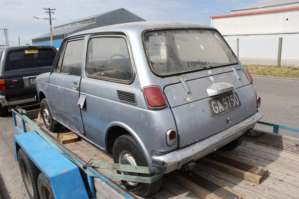

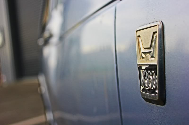

My new Honda N360, 1972.

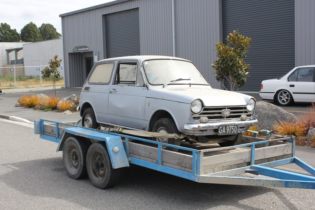

I waited around until almost the end of the auction before I better shoot home and grab a trailer as it had to be out of there by 4pm.
These are photos of it arriving home.

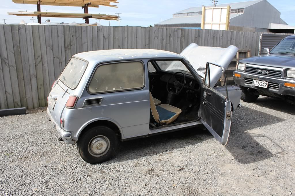

Got it off the trailer ready for a decent look at what I had just bought....
I didnt know anything about the history of the car, nor the current state of any of the running gear or even the registration due to CarJam being down when I needed it the most! Bought it completely as-is, no idea if it would start and not much time to find out what was missing.
After some research, it has been off the road for 18 years and de-registered. BUT, it's is NZ New and as you can see, it still has the original plates on the car which is a very good thing.

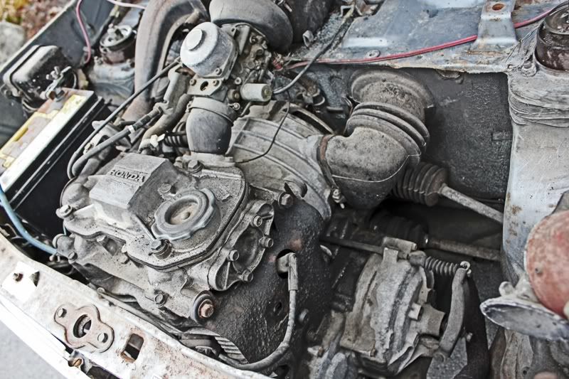

First thing you do to a car been off the road for 18 years? Check oil, add fuel and jump start....
This thing fired into life completely effortlessly. After seeing it running for a bit, checking things out, I jumped in and went for a drive. Gearbox and engine are sweet. the only thing that needs attention are the brakes. It doesnt have them. Later to find out that the MC is completely dry and i'd imagine a lot of seals will need replacing. But that's further down the track.

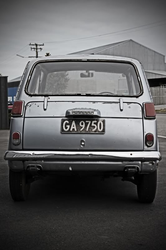

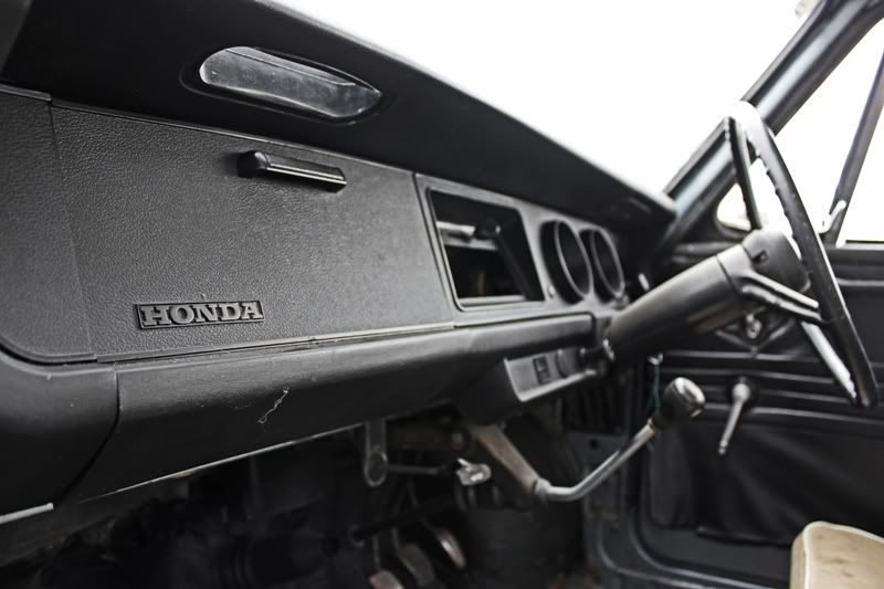

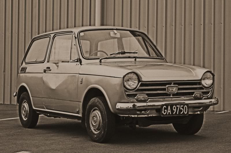

I gave it a quick clean and some better photos. Enjoy.
Now for some details of the car:

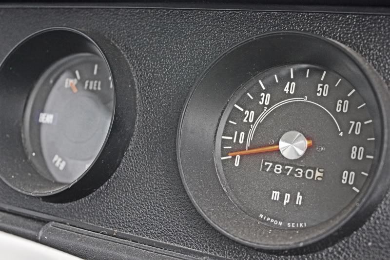

354cc Twin Cylinder Forced Aircooled OHC
31 BHP
Top Speed, (an unfortunate) 115km/h
4 Speed Manual
Whopping 505kg
All this combines to a claimed 28km/L fuel consumption with around town driving.
The only thing that is actually missing from this car is one of it's wheels and hubcaps. The spare has been put on and the original is nowhere to be seen. So I will be on the look out for a hubcap and a 10" rim.

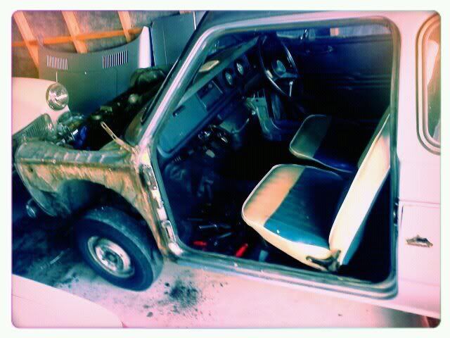

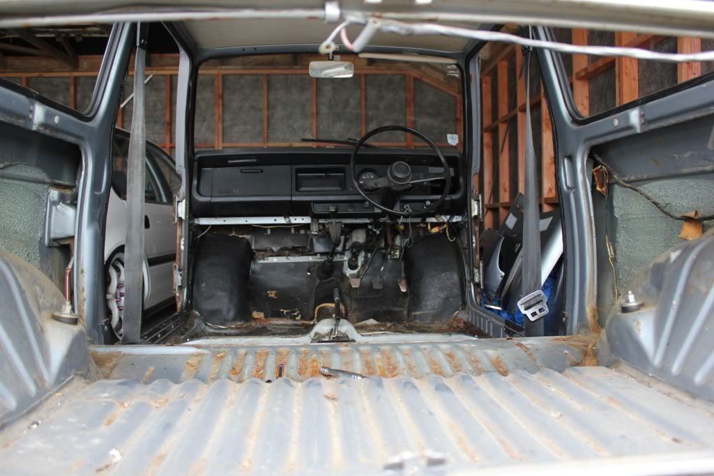

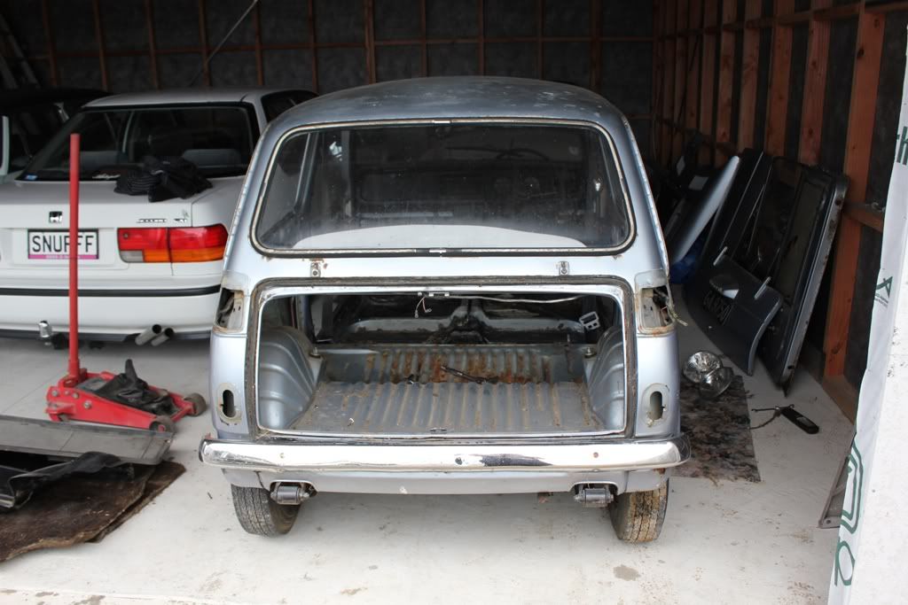

So, got onto it and started stripping it back.

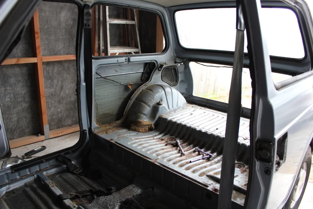

Once this was done, I inspected it all for rust and decided what I was going to do with what. Seats etc
I gave the car a good waterblast with everything out of it and peeled back old sealer. Vacuumed all teh crap from the interior.

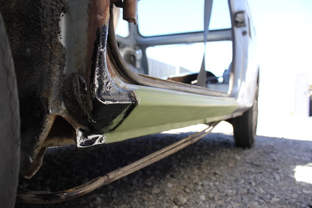

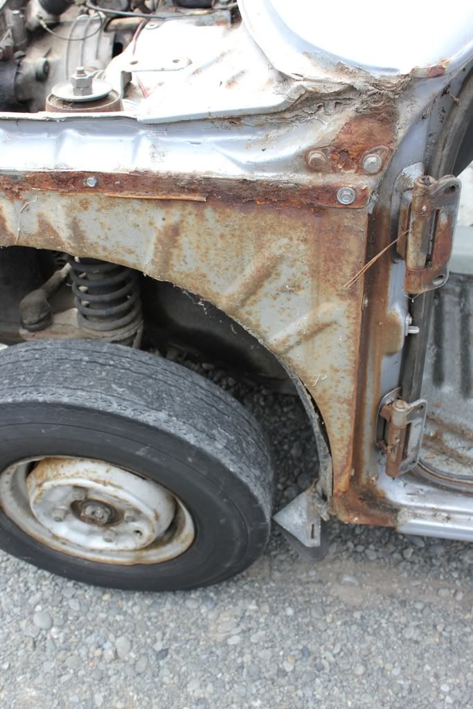

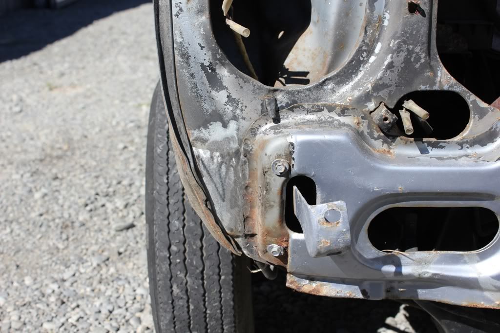

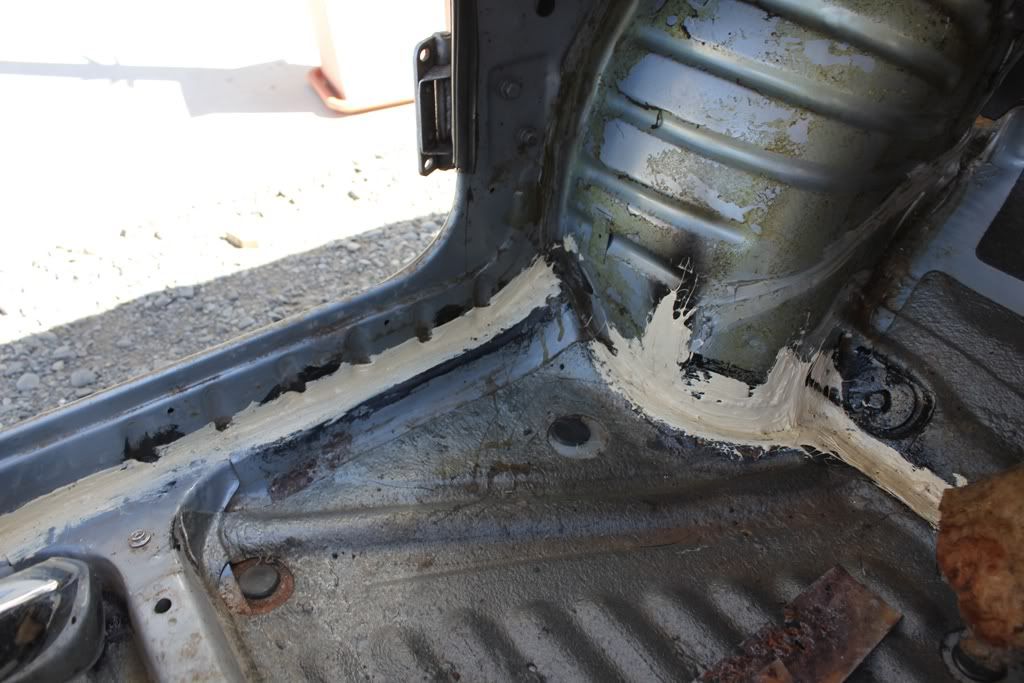

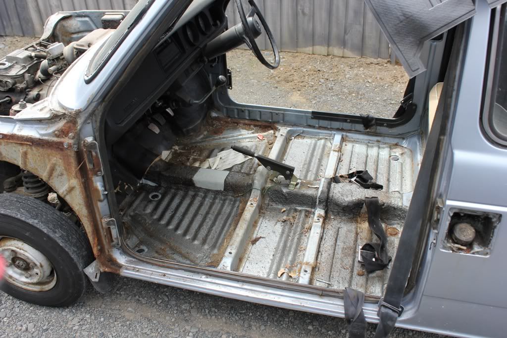

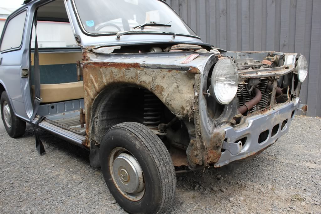

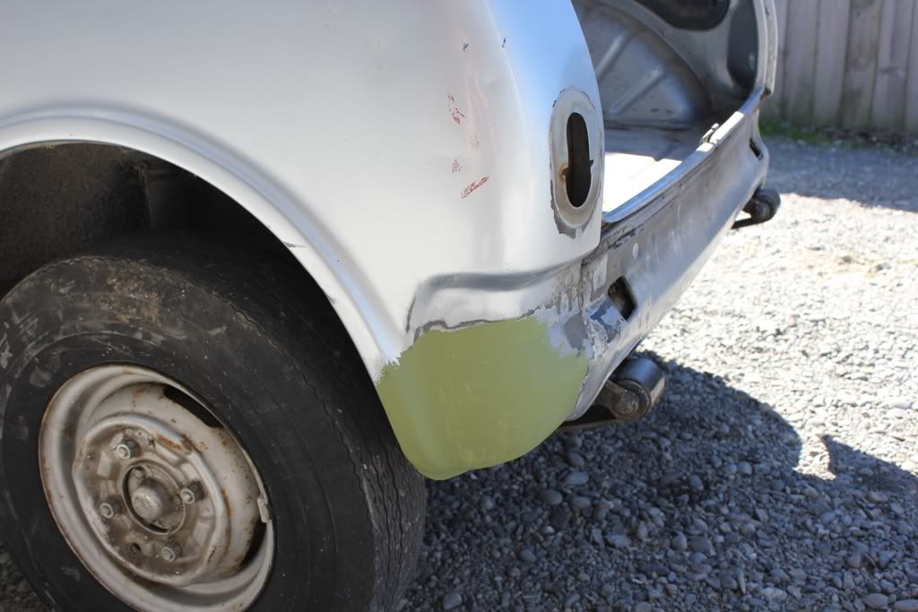

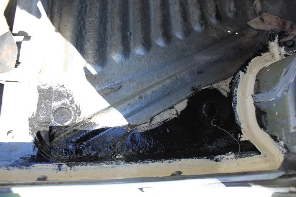

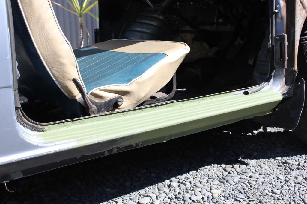

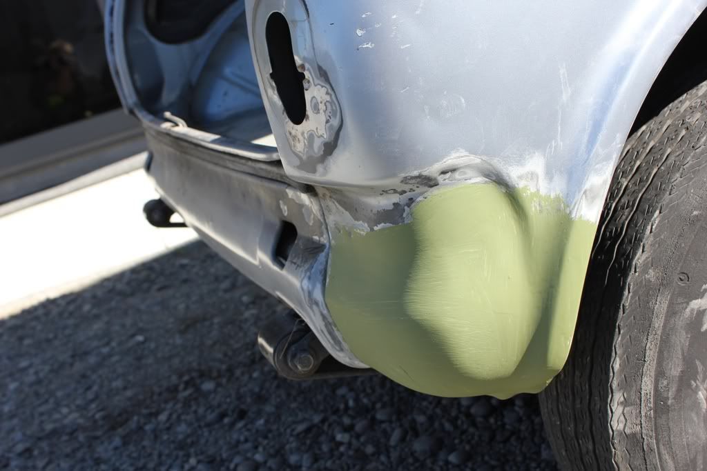

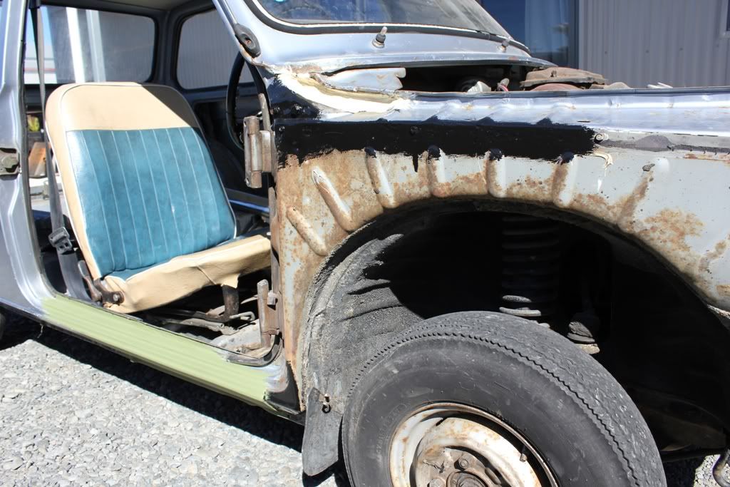

Rust repair.
Stage one, the body....

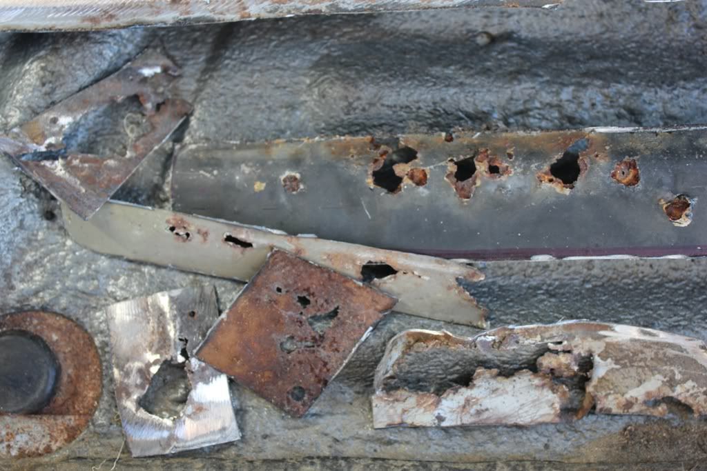

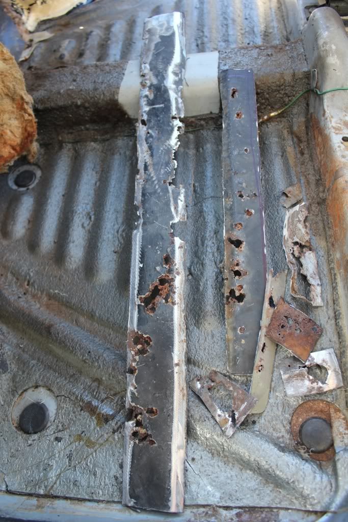

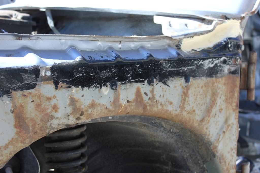

And what you see here is some of the rust that's been cut out. Long parts are the Sills.
So now, I need to find out what parts of this are actual structural rust and need to be Repair Certified. Which is another massive expense.
Later this week I'll have the Drivers door and both front gaurds back. Then it's just the passenger door and bonnet left :D

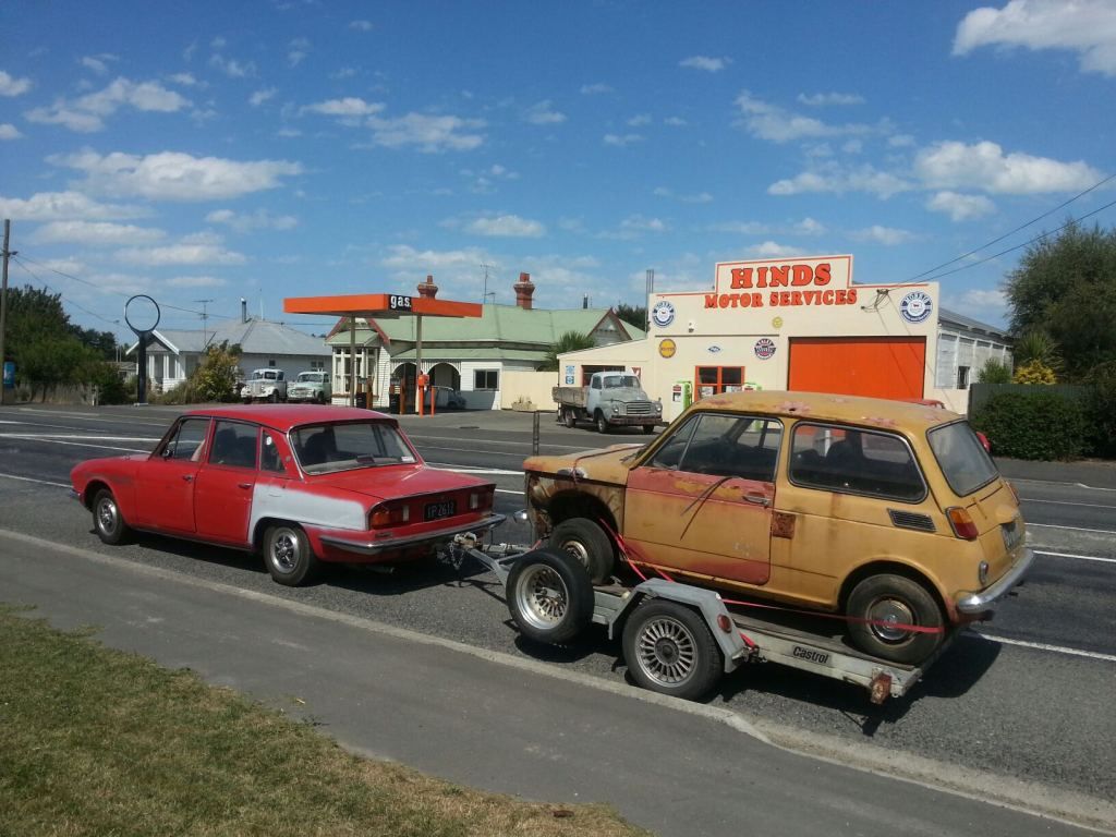

On the way home from auction:
OMG, I just bought another car v - What I said the the GF once the auction had finished.

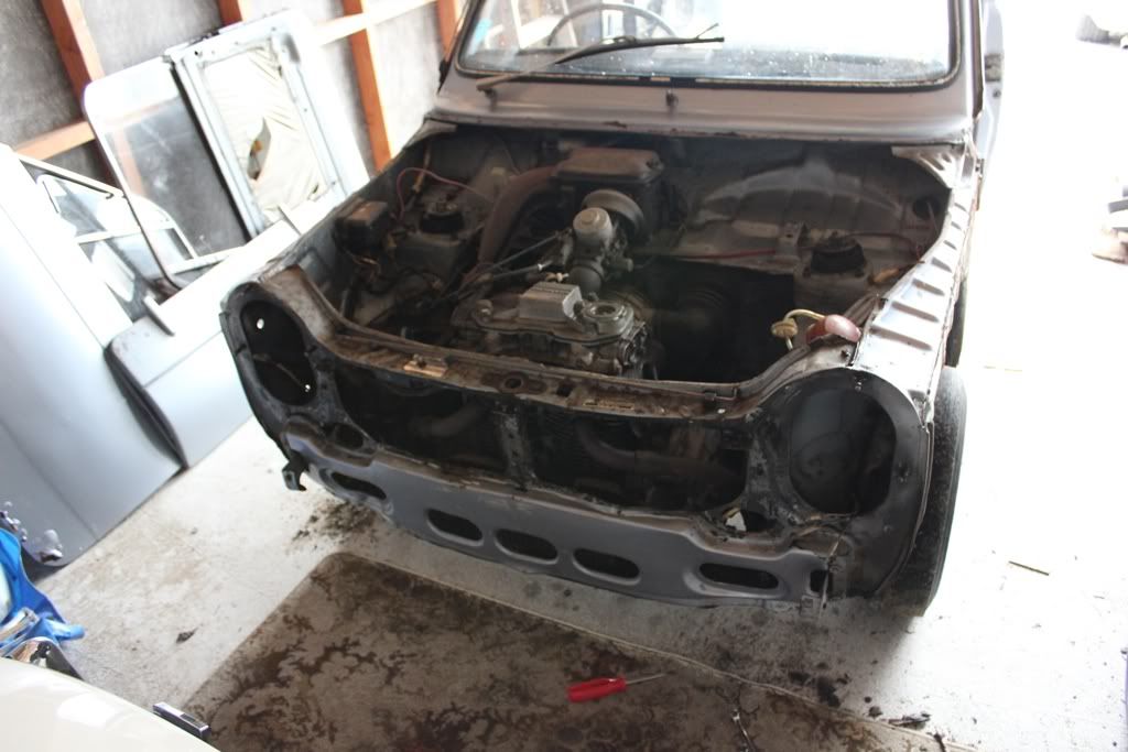

Halfway through stripping:

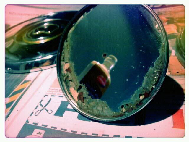

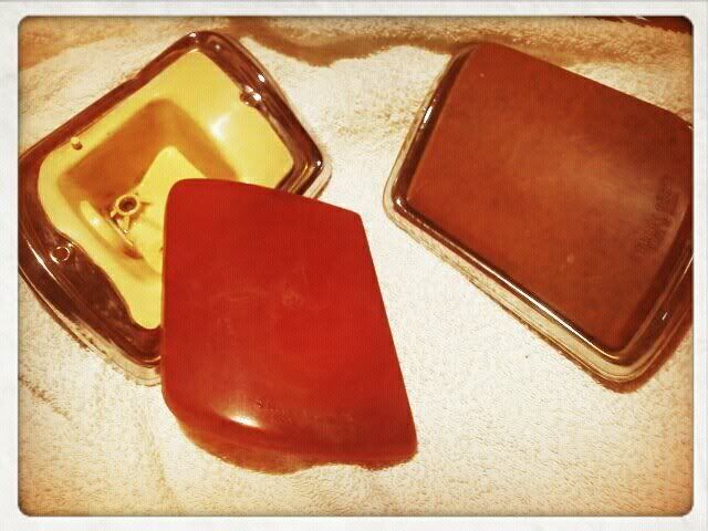

Tail lights, before and after. A screw has rust seized in the bacl of the other tail light, may need to drill it out :/

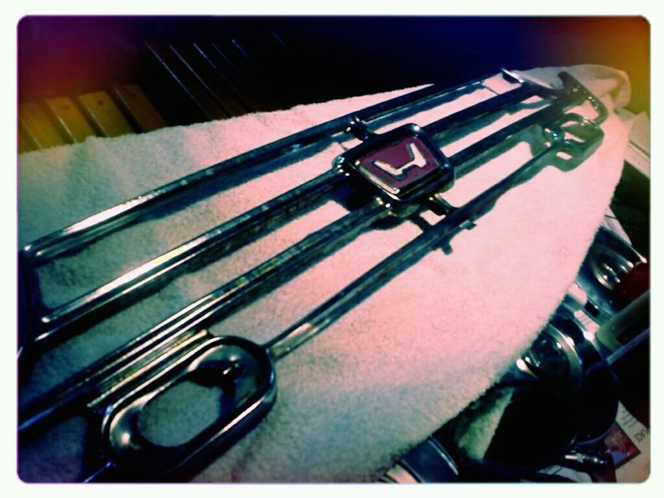

And front grill. Will need more polishing.

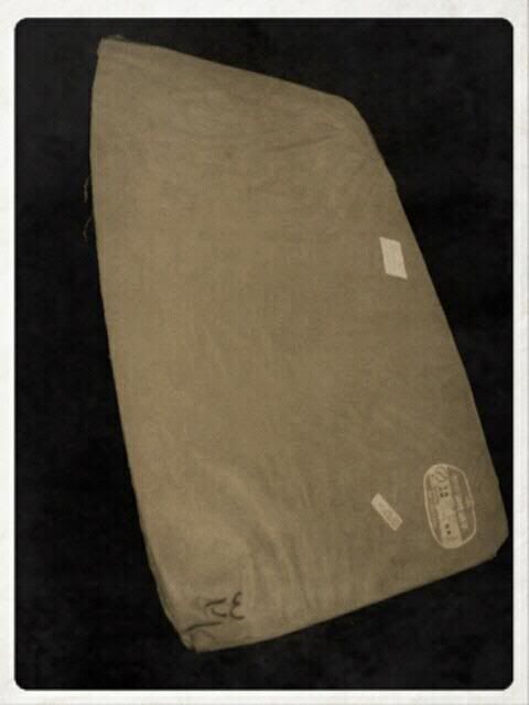

He's going to strip down the worst seat and see what he can work with. He tells me they've been home sowed before and there may be very little material to work with. Will see how we get on....

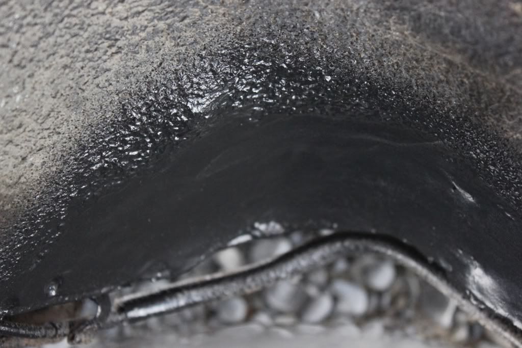

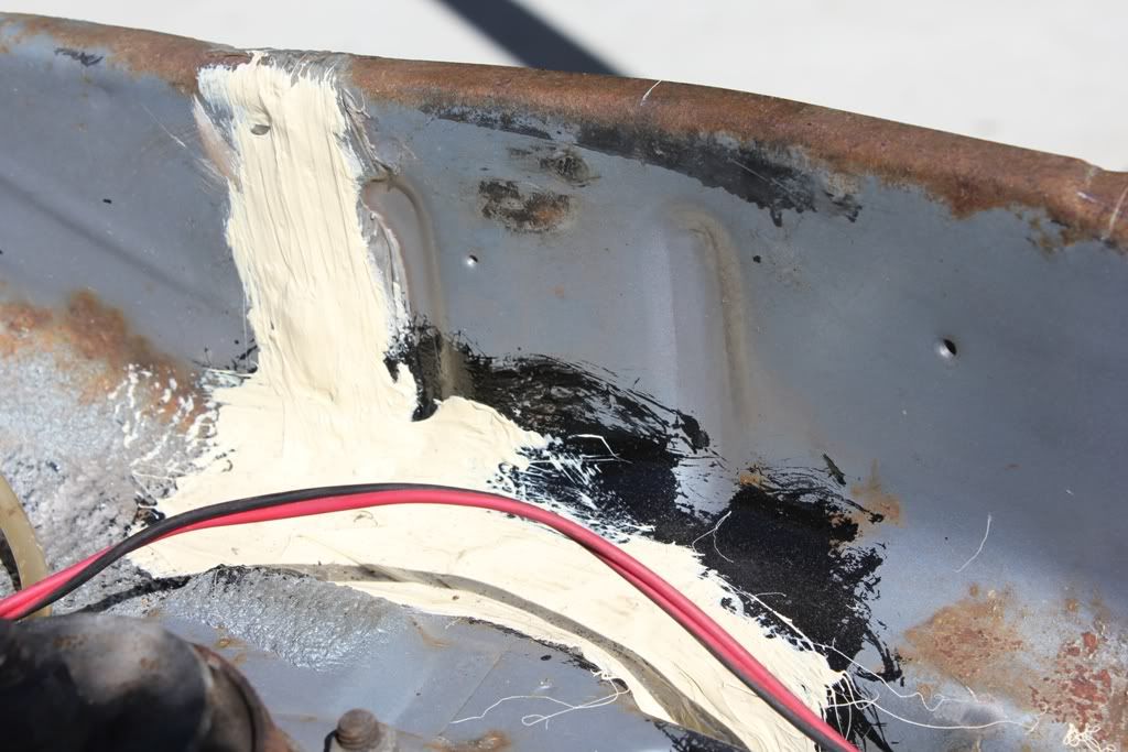

Whilst going over the car looking for surface rust to attack with some paint, I noticed a fully paint cracking crease in the roof, just above the B pillar. gave it a wee tap with a screwdriver handle to find it caved in effortlessly. [More backwards]. Was a perfect spherical hold cut into the roof and then patched up with bog. I don't know why. But now it's something else I need to get welded back into place. Which means the roof liner needs to come out - which I really don't want to considering how mint it actually is. Will probably never go back in the same way. To be completely honest, I don't even know where to start it taking it out! Damn you, well built 70's Japanese cars.

I found out what the hole in the roof was for. Another optional location for a radio antenna. I now have an original rubber bung to cover it, but i've also found an original antenna to fill the hole. So i'll use that and weld up the holes on the A-Pillar.

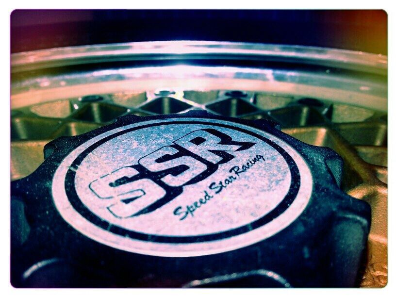

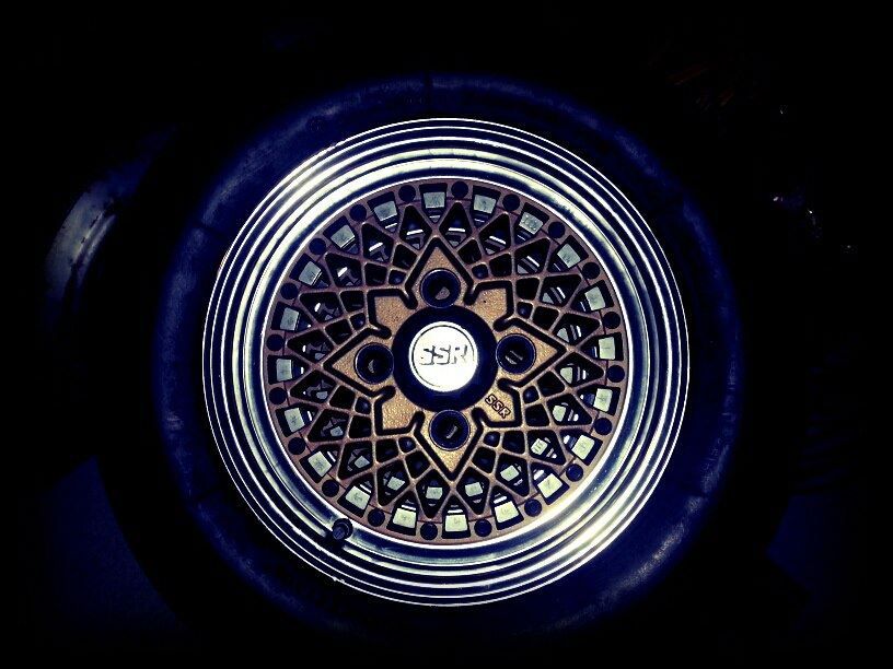

I bought a set of wheels. 13" SSR Formula Mesh in Gold with polished lip. All had original centre caps and valve caps. Wheels are near perfect, so very happy purchase they were. I just need to get the right size tyres now which isn't going to be as easy as i'd like.
The guards will need a slight pumping. I have thought about bolt on flares but finding the right shape etc is a bit more work that I need at the moment.
Hopefully these images work - Please let me know if they don't.

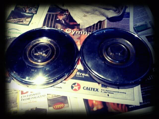

I also needed a new steering wheel due to mine cracking when I bought it. It had a seized rear wheel bearing and I put too much pressure on the steering wheel trying to push the car. Thankfully a guy got hold of me who helped out significantly. N600 Steering wheel (MUCH nicer), a fourth hubcap, tools and Jack. It was awesome.
