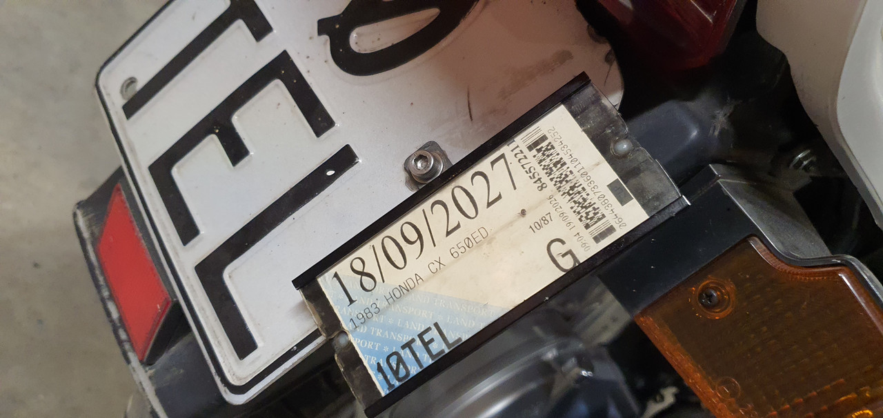

Popular Post yoeddynz Posted October 3 Author Popular Post Posted October 3 Took the bike in for a wof. Failed on a few things. I'd completely forgotten to replace the broken front brake lever brake light switch. $15 from local m/bike shop. The front sidelight bulb had a poor earth, easily fixed. I had to re-fit the rear foot pegs because with a double seat they have to be present. I'd removed them when cleaning/painting the frame and not fitted them back on because ugly. Sorted these bits out and got my years ticket. $91 later and it was rego'd for the year too Yay for classic reg! So I've been taking it out for hoons. Its pretty nice and I'm getting used to it. My cousin from Nelson turned up yesterday afternoon so we went out for a ride. I'm still taking it super careful and just enjoying cruising on a nice looking smooth classic bike. He was able to give me some pointers (he's been riding for almost 40 years and is pretty handy on a bike) Took some pics.. me , Alex Macpherson legs making the bike look small 🤣 .. ( I do have proper gloves, just not on at photo time. Jeans are the proper deal kevlar lined things I picked up brand almost new at bargain price from local fella who barely dabbled in bikes) Perfect day for a ride.. My cousins SV650 is quite a thing. I took it for a short ride. While its only got 9 bhp more the bike is some 40kg lighter! So much more nimble and easier to ride than my old bike. Not really a bike for learner me though- I could see myself being a bit silly on it, running out of talent and ending in tears. It was also a bit cramped for me and I got really sore hip flexors. 14 Quote
