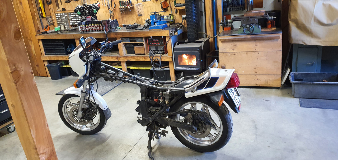

Popular Post yoeddynz Posted May 15 Popular Post Posted May 15 I've been looking for an ideal first CX since selling my Goldwing a few weeks ago. I was tempted by some fairly spendy ones in the 5k range. I was chatting to a mate from the next valley about bikes, mentioned cxs and he said his brother has a couple... ...and he is planning to sell them. Cool. One of them is a CX400E. Not sure on the other and I would have to wait for 10 more days because he's away. So I've been counting my sleeps and then on Monday another cx popped up for sale locally - for only $500! But it has a seized camshaft and is in bits. In other words a proper project. Within a couple of hours four different mates had sent me the advert link. I contacted the seller asap. I said.. "I'll buy it! Can I collect it tomorrow?" "yeah man, no probs" Great. So on Tuesday this old thing followed us home.. Off the trailer and inside. It might only be 'late summer' here in sunny west Tasman but its fresh enough to get the workshop fire cranking. Bike has been lightly cafe'd but came with all the original parts included along with a few new Honda bagged spares.. Original speedo matches the recorded mileage that shows up online.. I was blown away by the brand new fan.. Following morning I freed up the sticky front calipers which luckily had nice clean pistons. Nice to see bike already fitted with braided front hoses! I plonked the seat and tank in place and took some pics.. Hannah helped me remove the engine and lift it up onto the bench. I had to get this pic.. I started looking into this 'seized' camshaft. Previous owner said it started leaking oil out around cam seal and making awful sounds. After turning the bike off they couldn't turn it over. They took it to a mechanic who tried to remove the tacho output/camshaft front bearing block. He got it to spin round but it wouldnt come off and broke the casting. He decided the job was going to be far more involved than they wanted to spend. The bike sat a few years and now its mine. Damage here... Picture from FSM of parts.. I managed to spin it round but I could see the spiral cast into the camshaft that turns the tacho gear is damaged. You can see the spiral here.. My guess is that on of the teeth had broken in there and made a mess of things. The camshaft was forced sideways and made a mess of the bearing bore. I tried everything thing to remove it without having to resort to further disassembly of the engine but no luck. I'd got the tacho pinion out but the alloy housing was all burred on the engine side of the cam spiral. there's a good visible .5mm (.020") of movement on the cam so the clearance is far too much. So I will pull the cam out. Hopefully the bearing journal is ok. I can clean it up in the lathe if just scuffed with alloy. I'll fabricate a new cam bearing block and bore it to get the exact factory nominal .0015 I've popped the rear cover off and this is where I'm at as I'm now away visiting mum. Great news is the rest of the engine appears in good condition. Very clean inside suggesting regular oil changes. The cam chain looks in good condition with plenty of life from what I can tell. I'm hoping I can carefully remove the headbolts, pop the top rockers off and replace the bolts with some spacers i'll machine up. Then the heads are still clamped while I remove the pushrods and flip the engine upside down. The cam followers will swing away from the cam and I can extract it. Ultimately if the engine is a good runner I'd be happy to give the heads and valves a birthday clean but I really dont want to pull it down further until I get a full gasket set. I'm also waiting to find out about the other potential cxs on offer. 21 Quote
Popular Post yoeddynz Posted May 18 Author Popular Post Posted May 18 Work on this stopped as we went away. Got back home and discovered I needed to buy or make some tools for dismantling. I dont mind spending time on such when I know there will be more of these engines to play with. I made a toothed cog holder. The usual thing I've read is to use a 2 cent/1 penny coin and jam it in between the teeth. Just doesn't seem right nor can I afford such extravagant throwing about of money when I have steel sitting here.. I also needed a really deep 27mm socket for the camshaft nut. It was the weekend and the only one available at Repco didn't look deep enough. I remembered I have an old 1/2" socket set I've robbed a few sockets from. Luckily there was still a 27mm so it got the chop and extension treatment.. Because my initial intention is to try and remove the camshaft without removing the heads I machined up some spacers that would replace the rocker shaft pedestals... This way I could carefully crack off the headbolts and fit the spacers, so hoping not to break the head gasket seal. From what I have read the original Honda gaskets will probably hold tight. At the mileage this engine is I presume they are original. If the camshaft is ok I will probably pull the heads anyway, buy a full gasket set and give the top end a birthday. Spacers installed, engine was flipped upside down and I was finally able to extract the camshaft, complete with its front bearing that refuses to budge.. Into the press... It still wont budge. I didn't want to go overboard with pressure. The damaged worm gear on the camshaft must be holding it but I didn't know how. Something really jamming it. I spun the remains of the spiral off... Now back in the press and the bearing housing finally popped off. Along with some small bits of metal. Oh dear. I actually laughed. Hannah was in the workshop and she gave the same 'faaaark - I didn't expect that' expression too. ZOOM IN.. ZOOM IN FURTHER...😐 Wow. How the fark?!! The bearing housing is understandably rooted as well.. So...I think I might need a camshaft.. I'm not surprised the engine made funny sounds/leaked some oil 🤪 I can only guess that it got super hot from a clogged oil way but you'd think the alloy housing would have disintegrated first? I don't know. I believe the camshaft I need has to be from a later bike as it has holds the valves open a few degrees longer than the early ones. If I can't find one easily then I could just skim this one down and shrink fit a sleeve, then re-machine. Its not a highly stressed cam and I was intending to make a new housing anyway so it can suit anything. Hopefully I'll find something plus I have yet to find out what of the bikes I'm hoping to secure locally. They could come with spares. 17 Quote

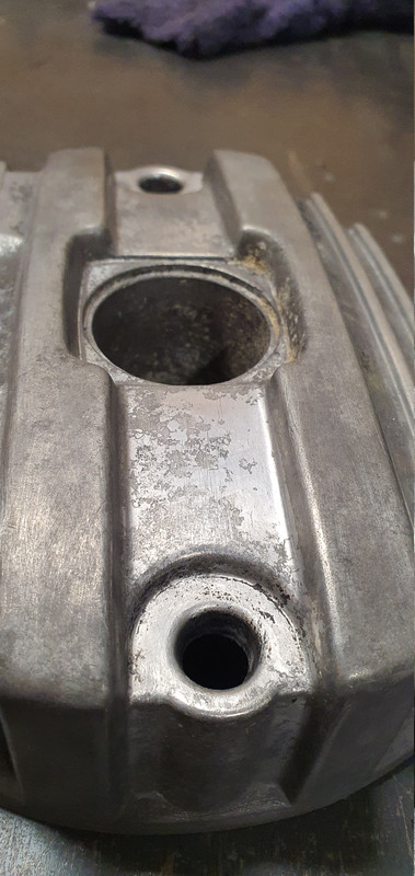

Popular Post yoeddynz Posted May 27 Author Popular Post Posted May 27 On 19/05/2026 at 11:35, Snoozin said: You got one But wait there's more!!! I decided to finish stripping the engine because the mess from the cam bearing would have been a ballache to clean out plus I really needed to see the state of the bearings elsewhere. If they were ok I could also properly clean everything, check the valves and start a fresh. Gearbox is in fine condition..(I instantly pictured and started engineering in my head how this very neat compact unit could be used as the basis of a sequential box innards for a small car etc) Crankshaft is fine. Big ends still fine.. Popped it on some blocks and checked the clearances.. About .0025" (service limit is .0031") They could be used as is and I'd never be worried but if there's available bearings at sensible prices then I could pop some in. I couldn't see any obvious colour markings though. Before I get too excited I still need to sort out a camshaft/front cam bearing. So in the meantime I have bought some more plastic storage trays and I'll stash the engine out of the way. I can clean bits up in between other jobs/procrastination excuses/purchases.... ...like the following. Hannah and I took off in the Imp to look at two more local bikes - ones a 650E, rego on hold but needing some tinkering. We drove the Imp there because the fella selling the bikes, as mentioned in my first post is the brother of a friend and his parents used to own an Imp. Anyway - the bikes. I'm quite tempted. The 650E has a damaged impeller stud thread on the camshaft. I think I can fix it though. The other bike offered to me for free is a very rusty (holes in the lower frame) 400E spares bike. I could always pinch the cam from this in order to rebuild this 500 engine that's still spread all over the bench. Ideally I'll sort the 650 first because its otherwise all go, solid and rego on hold. Its really too rare/nice to do anything but restore back into use. I need to mull it over though because costs could spiral on a bike that has hard to get parts. I'm very tempted to repair the rusty 400E frame and fit the 500 engine. This could be used as a basis for a fun project bike. And if the 650 didn't exist this is simply the route I'd be taking - just imagine the entertainment for you all as I start having to restore a frame that's half in powder form. I'll report back with photos as soon as I've made the decision and have the bike/s in the workshop. 650E be all like this but in white and not mint... 19 Quote

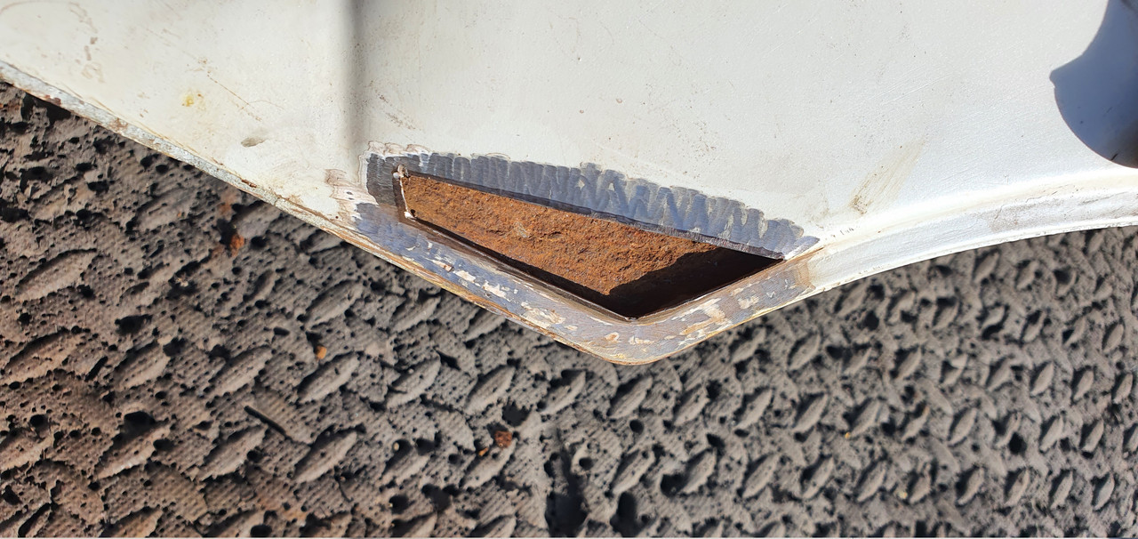

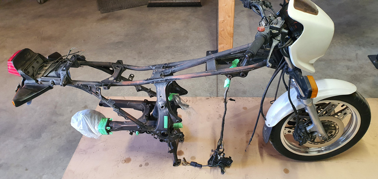

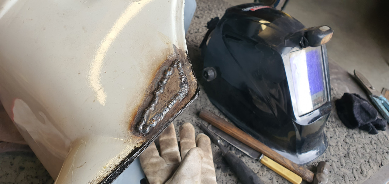

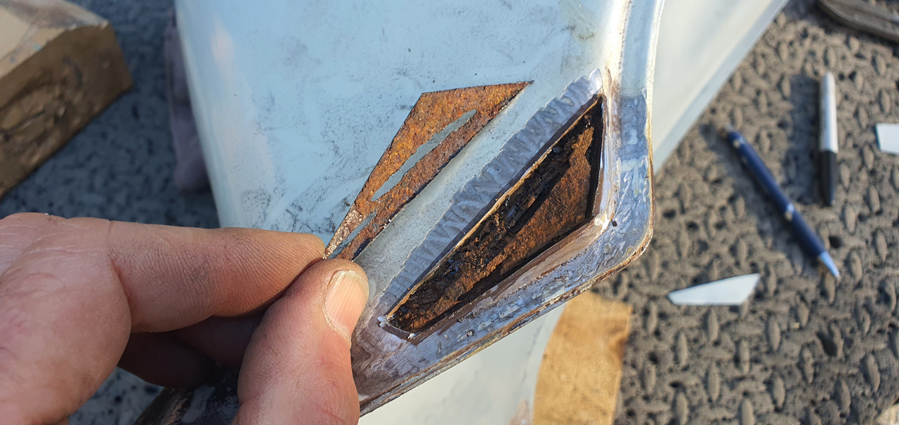

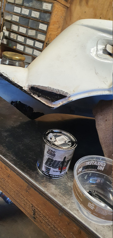

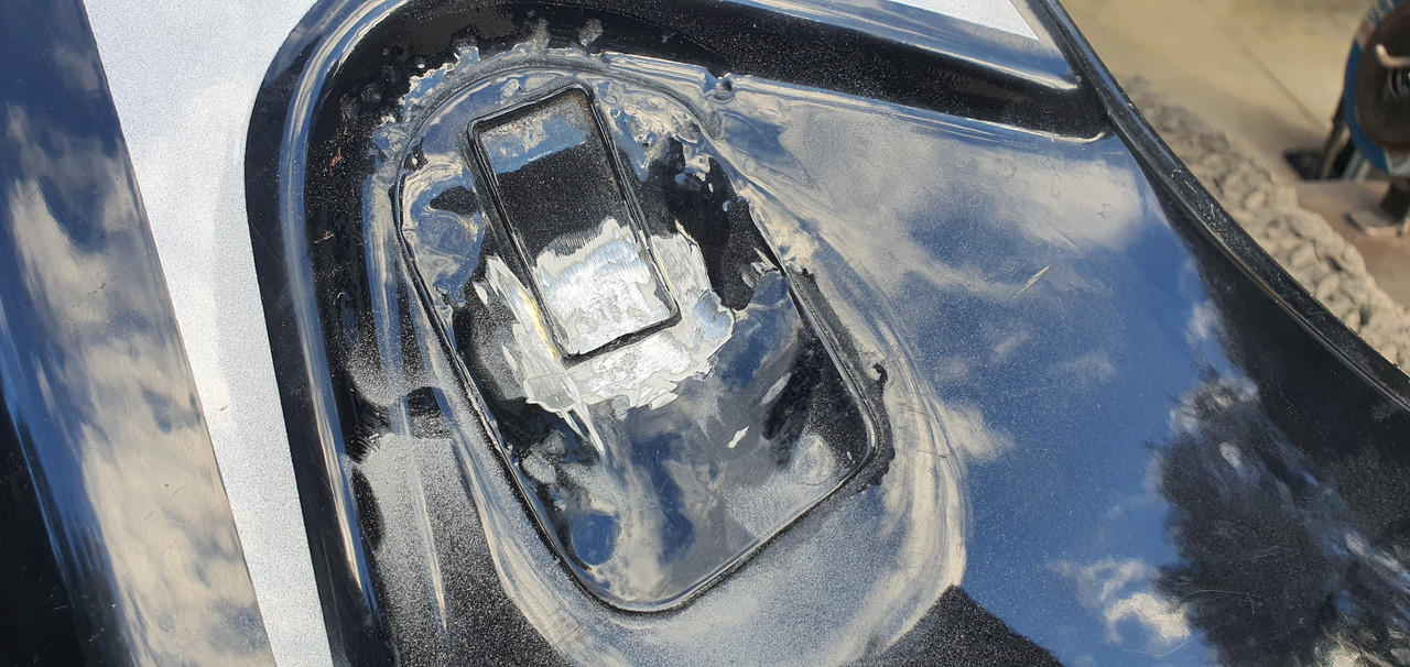

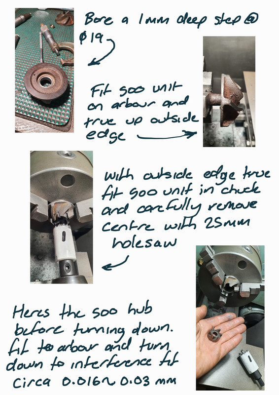

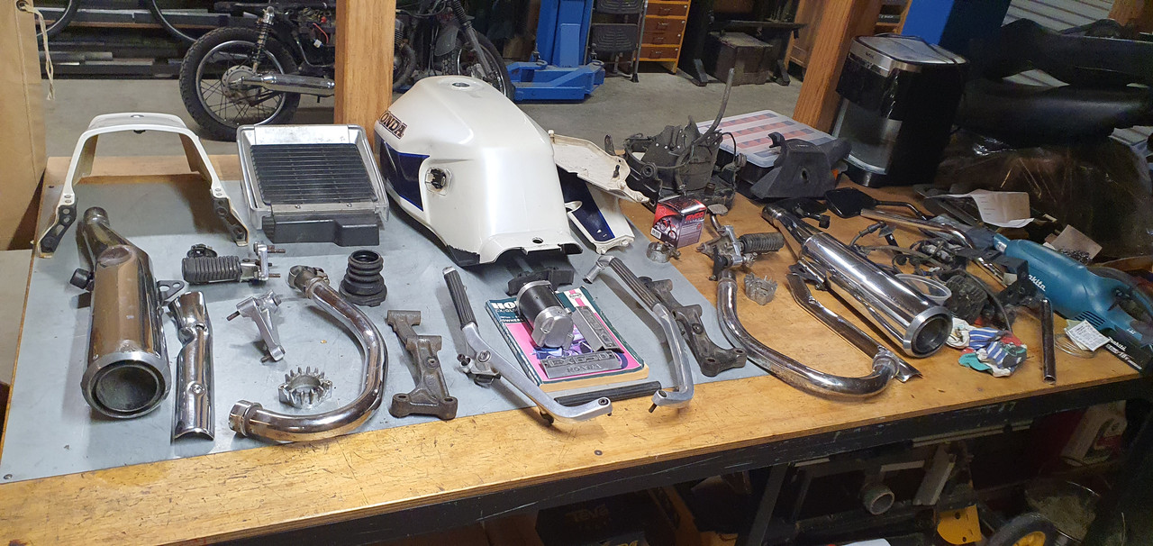

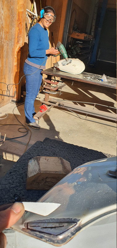

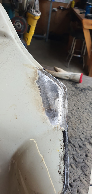

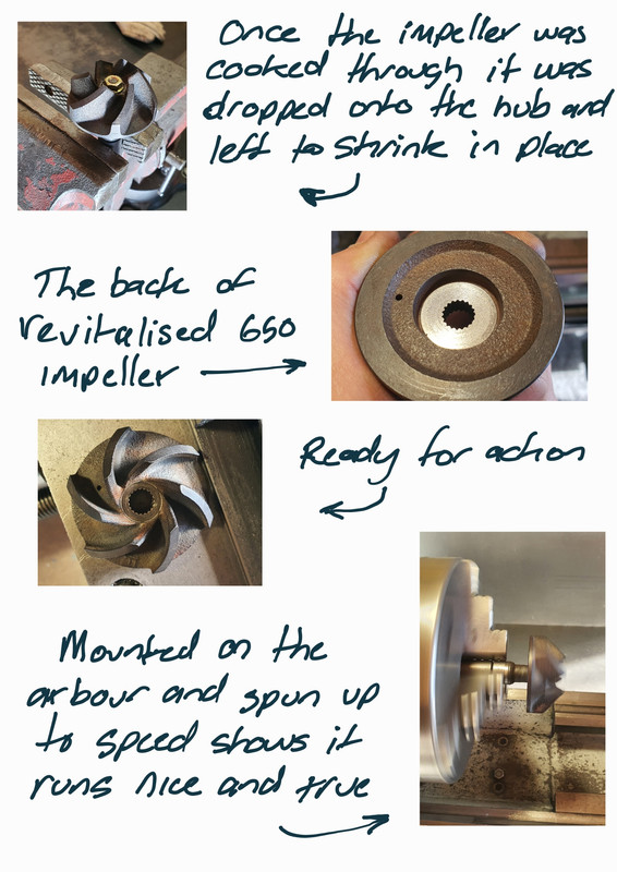

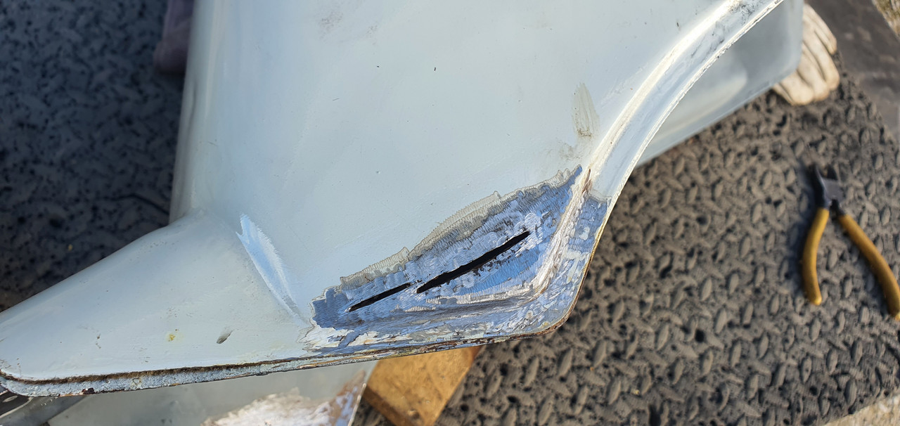

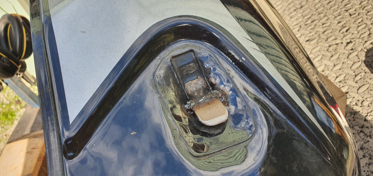

Popular Post yoeddynz Posted June 18 Author Popular Post Posted June 18 Chipping away at this. Had picked up some sort of cold/bug so that was an excuse enough to stay indoors and tinker on the bike. I wanted to sort the impeller out first. If my repair idea didn't work out I could order a new alloy impeller from Ralf. I took photos as I went through the process and instead of posting them all up I made a montage on the tablet instead. Hopefully this works. Excuse my messy handwriting... So I'm happy to have sorted that out and have a working 650 impeller again! I've since fitted it up on the cam and although the camshaft thread is a bit messy it holds the required torque. I'll use a little blue locktite on the nut just to be sure and give it a whirl. Next job was the fuel tanks. I have two to suit the bike, three if I include the rustier looking (but actually very very solid inside) one from the cx400. The white 650 tank and the black one both have broken off tabs that locate the front edge of the seat. First job was to purge out any remaining traces of petrol fumes. We had to pop to town that morning for shopping and pick up some engine paint so the Imp got chosen. This meant its exhaust was hot and free from water vapour when we got back. I fitted some old stainless tube bends into its turned down exhaust tips and it was ideal for purging two tanks at once. Honda Goldwing purging Honda cxs... I cut some 3mm stainless to shape, cleaned off the paint from the tanks and welded the new tabs in place. Nice and solid but can still be tweaked if needed. The white tank had been replaced for use by the black tank because it was leaking through some tiny rust holes at the lowest point. It has been 'sealed' at some point in its life but here we are. I gave it a prod with the Dremel... While I was working on this tank Hannah was attending her CM200T tank... Cut the rust out and exposed the yuckiness from tank sealer that had down a good job of creating a little rusty cave. The problem with using tank sealer without getting all the loose rust out. Cleaned it out.. Painted with KBS rust seal (por15 clone) Following day I welded in new steel. Mig welds on thin steel never instagram sexy.. But who cares when its getting flap disked back.. So the tanks are repaired. I need to get some colour matched paint at some point. For now the repairs are painted black. Speaking of black paint. The starter motor looked a bit rusty and messy so I thought I'd just quickly pop it out.. I'll just quickly clean it, paint it then pop it back in. A couple of hours later... So that escalated a bit then. But i did paint the starter and it looks much prettier.. To be fair to myself I knew that cleaning up and painting the engine whilst still in the frame was never going to be the easiest way or give a good result. I'd picked up a load of VHT engine paint currently going out on clearance at Repco. $10 a can! Cheaper than budget spec paint from the Warehouse! So the bike got smaller and the frame was lightly sanded back where it mattered. Its in excellent condition with no rust. Here it is ready for paint. Epoxy zinc paint for protection and make it all a bit neater was the plan. Now much nicer. I chose satin black as its my go to shade for dusty summers. I've been having fun reassembling it, cleaning and painting various bits as I go. The engines original black paint was in fairly good condition but for the light corrosion on the sides and top. I've cleaned and wired brushed it back. It's now masked it and ready for a tarting up with 'new engine in a can'... 21 Quote

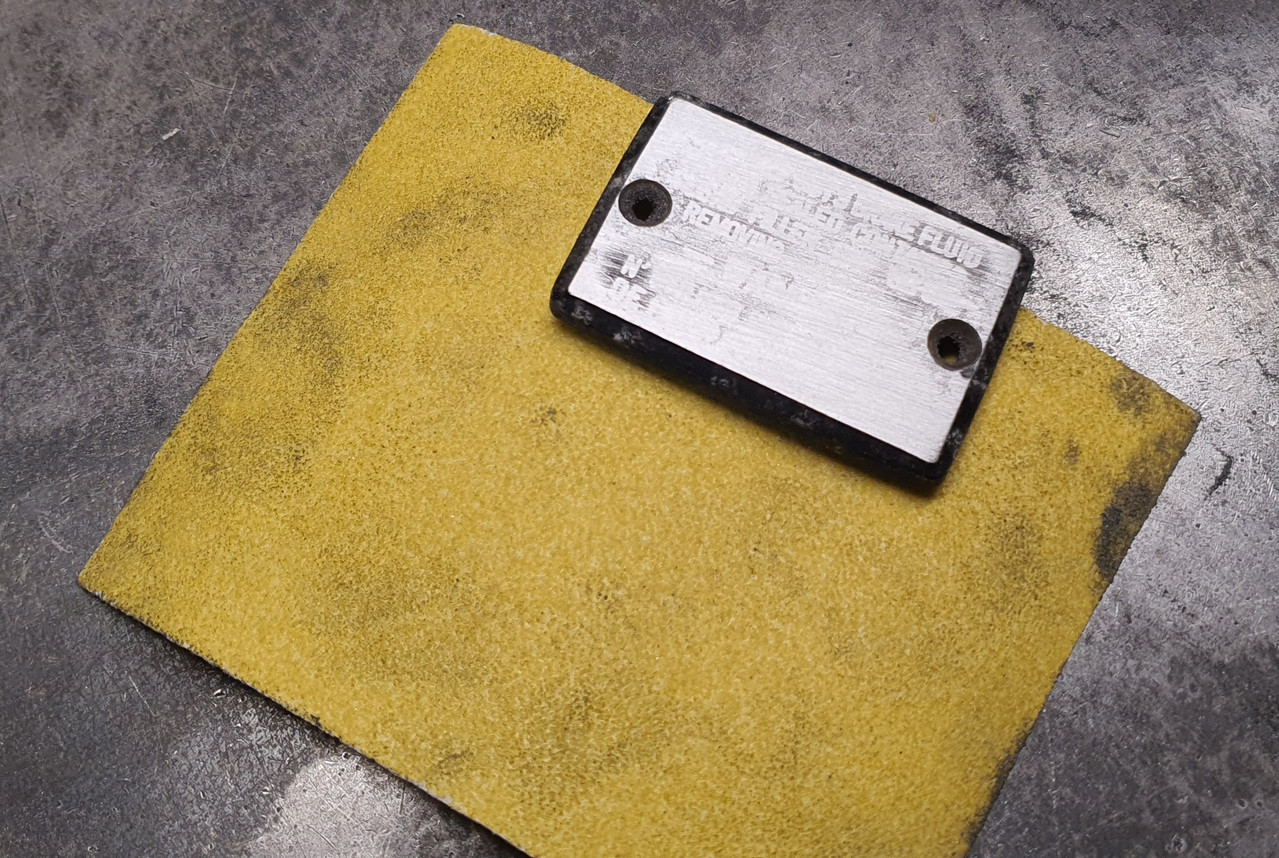

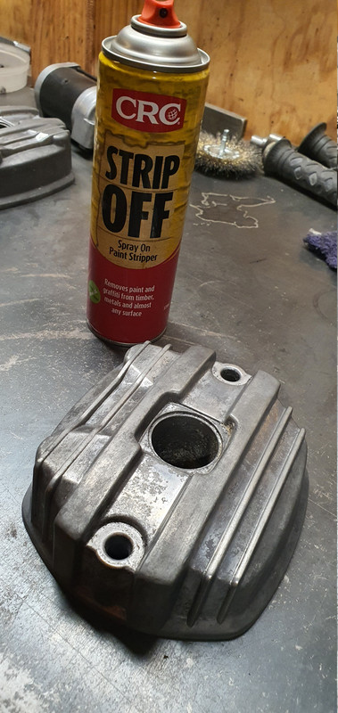

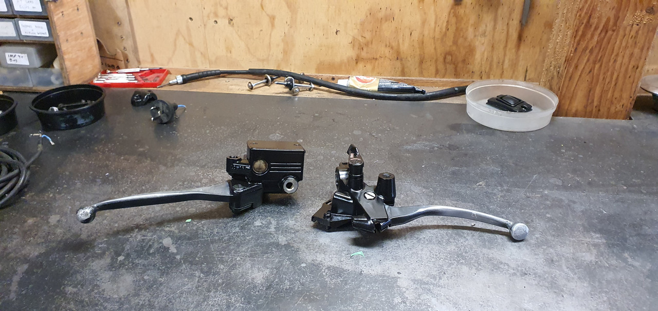

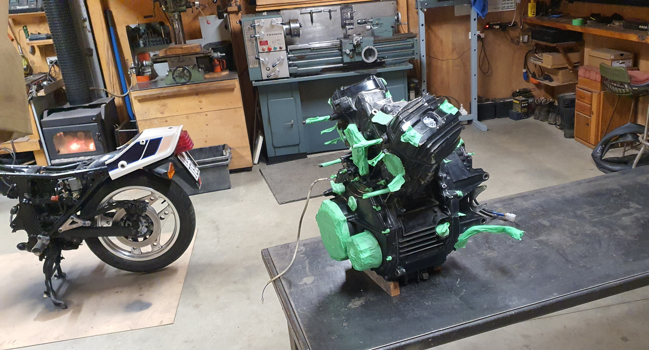

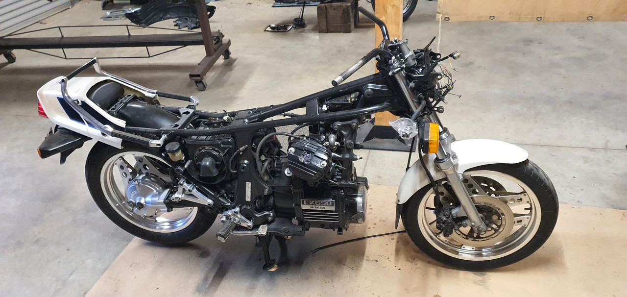

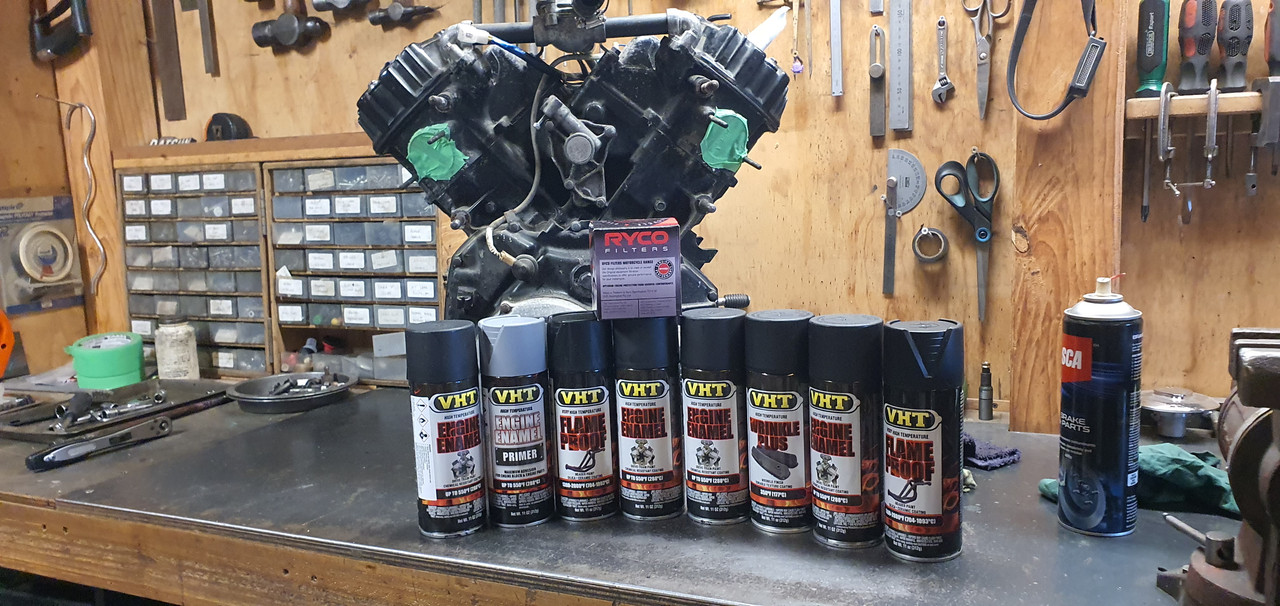

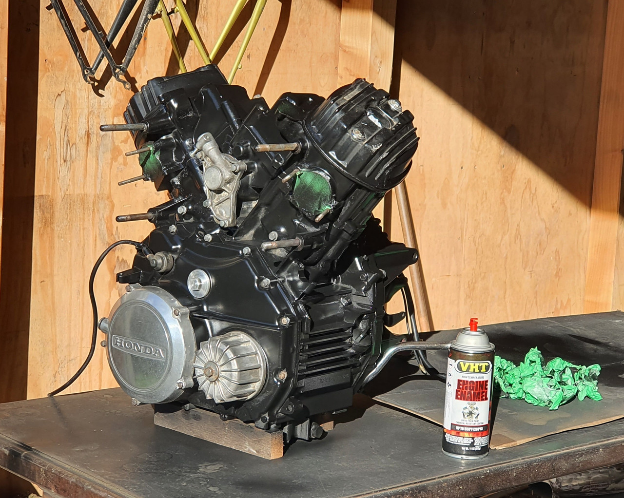

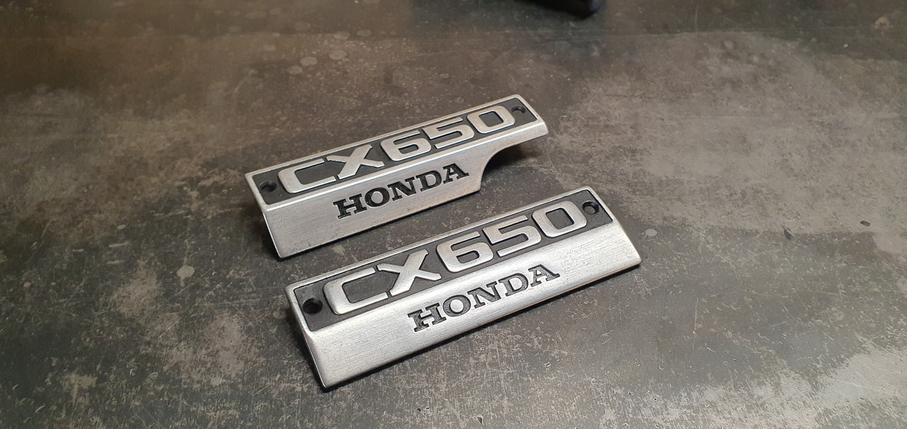

Popular Post yoeddynz Posted June 23 Author Popular Post Posted June 23 Engine paint went on well. I sat the engine in the sun to warm it up and applied many light coats. Smoothed off nicely and I like the new satin finish. As always it was fun removing the masking tape.. I used paint stripper to remove the lacquer from the engine badges, polished them as much as my patience could deal with and Hannah repainted the insets.. We reinstalled the engine. Pretty easy to jack it into position, line it up and get the bolts in place with the two of us. Which was lucky because someone (me) forgot to install the rubber boot over the shaft drive coupling...🙄 We are really good at removing and installing these engines now. Bike as it sits this evening.. I've sanded off the annoying raised lettering on the master cylinder lid.. The levers are now painted up with the same engine enamel. I'll see how long it lasts over time but they look better then they did and its the only black paint I have right now. A two pack epoxy paint would be a better option or the special Teflon type coating that Larry gets done in his amazing restoration... https://www.cx500forum.com/threads/cx650e-euro-full-restoration.59377/page-2#replies But I'm not that flash (or flush) so this will do for now. Radiator got the same treatment.. That's all for now. Once the levers and cables are all back in place it'll be onto the carbs. The bike came with 650 carb rebuild sets from Randakks that I may or may not install. Will see how they are looking inside first. I've removed the lacquer and black paint from the CX400 rocker covers. There's still what appears to be traces of silver paint. Are they painted silver from new or polished silver with black paint then clear coated? Its hard to tell. But trying to hand polish them without a machine is going to get boring real quick. Not sure how to approach them. I could paint them silver and black for a factory finish. It can always be stripped off later if I don't like it. Finally - I found this folded up in the Haynes manual. Not sure on date but interesting seeing the prices.. 11 Quote

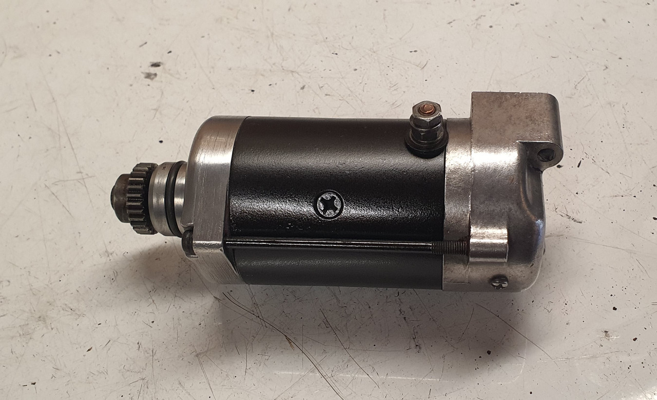

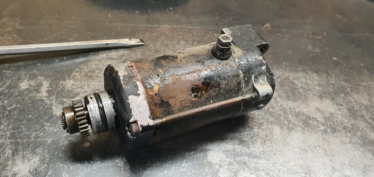

datlow Posted Sunday at 22:46 Posted Sunday at 22:46 On 18/06/2026 at 21:33, yoeddynz said: So that escalated a bit then. But i did paint the starter and it looks much prettier.. Did you look inside it for poor earthing on the brush holder plate made the world of difference with my one (I drilled and tapped a thread) https://motofaction.org/motorcycles/honda-cx-gl/starter-earth-mod-blind-hole-tap-style-cx650-gl650-cx500-gl500 1 Quote
yoeddynz Posted Monday at 01:44 Author Posted Monday at 01:44 yeah that mod has been done by previous owner! 😉 An update is due but been busy on other jobs/stuff. 2 Quote
