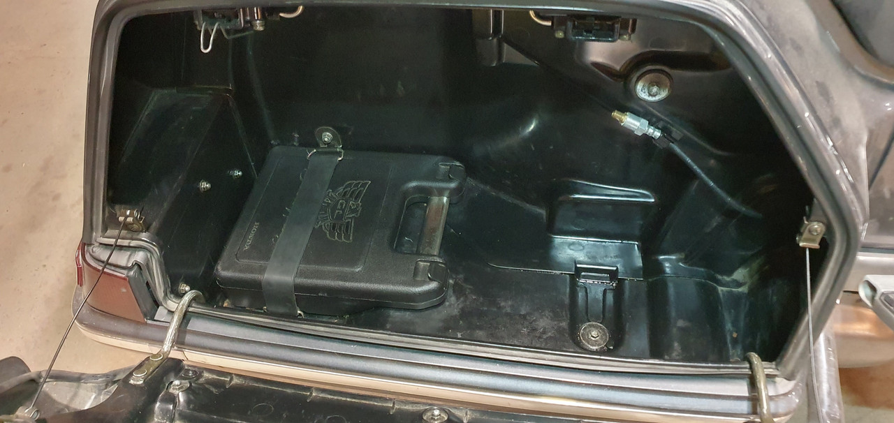

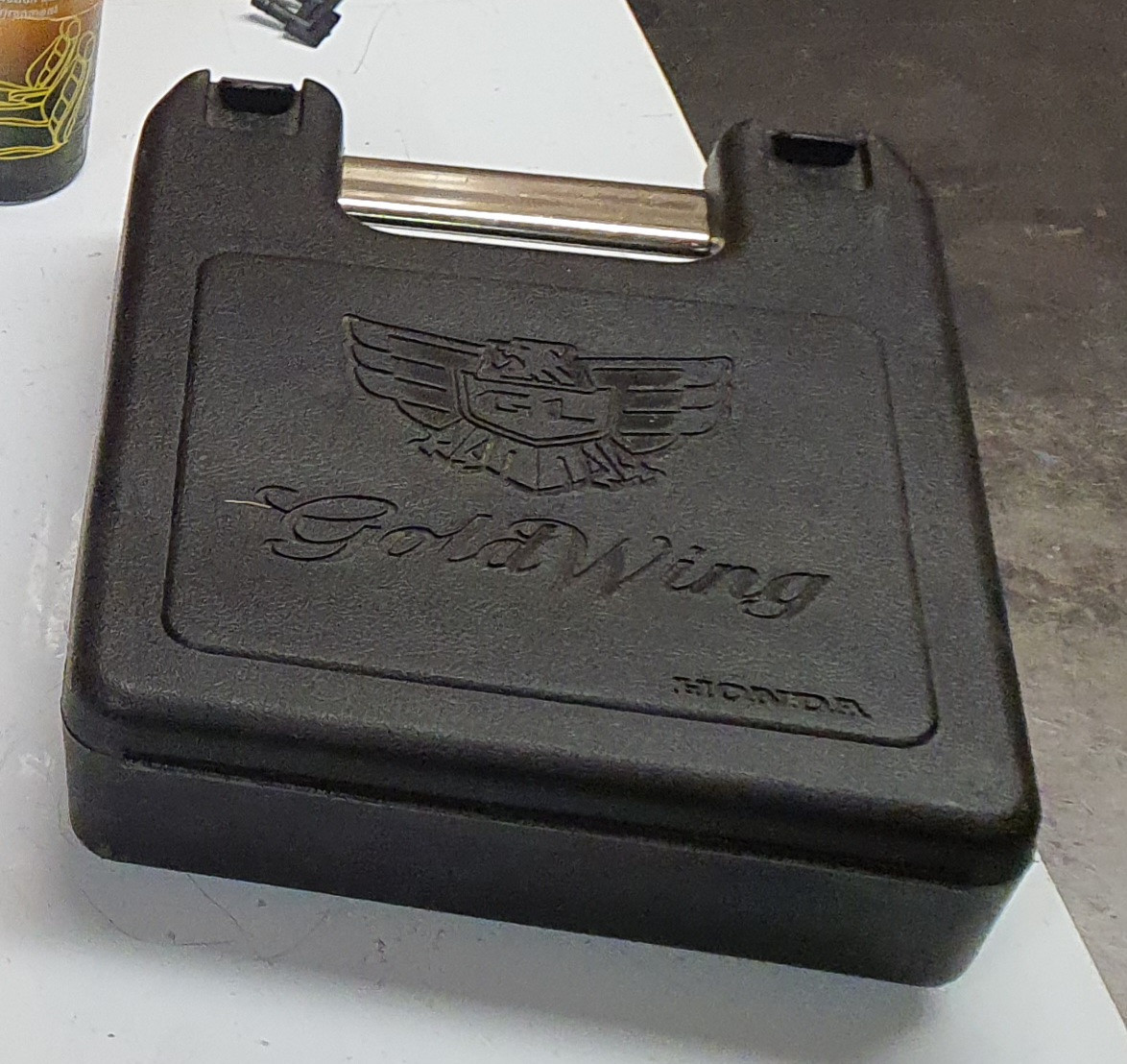

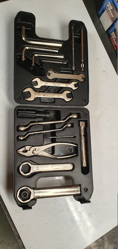

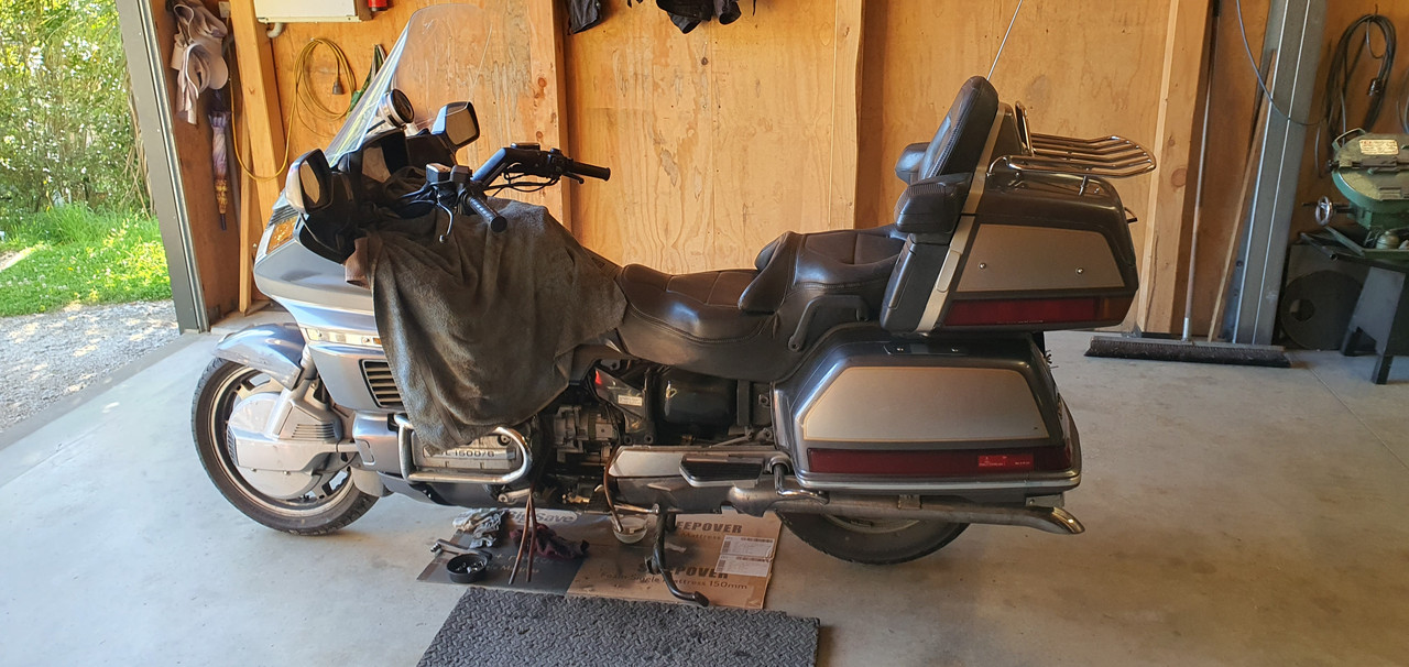

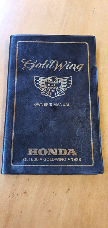

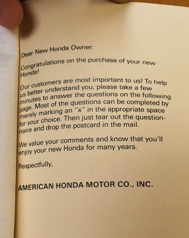

Popular Post yoeddynz Posted February 4 Author Popular Post Posted February 4 I had a look over it last night. The bike cover its come with is nice. Handy as because we have no spare space indoors to park it if there's lots of work in. Side bin was emptied. There's a tool kit in there Contents out. Many filters to see it through for a while. Random oils (quality stuff which was good to see) plus a brake bleed thingee. The tool kit is cute. The owners manual that was under the tool kit strap. So happy to have this. Still has the unfilled questionare in the back.. Lol at the questions. Pretty in depth. Tempted to fill it out and send it in. Ask for a brochure. 8 2 Quote

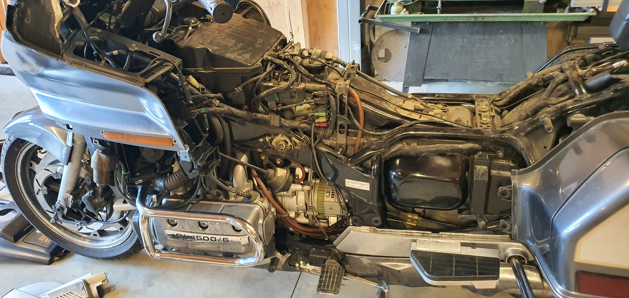

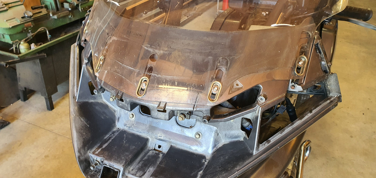

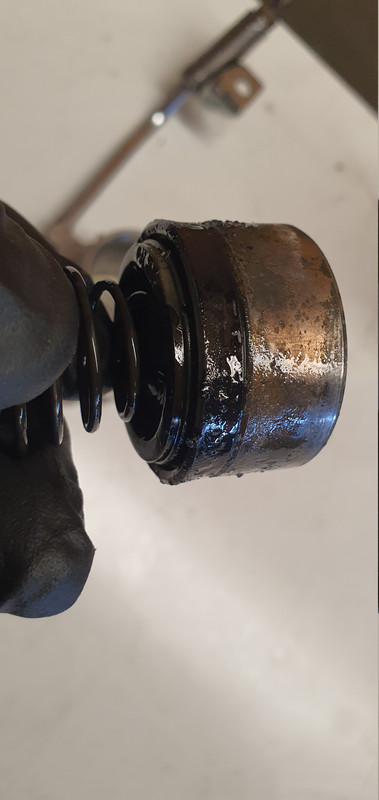

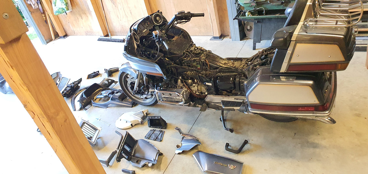

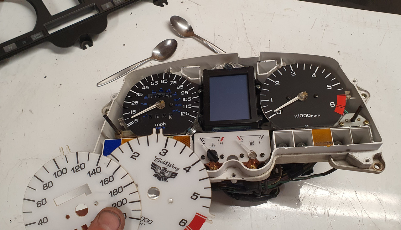

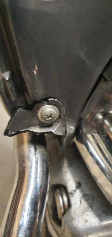

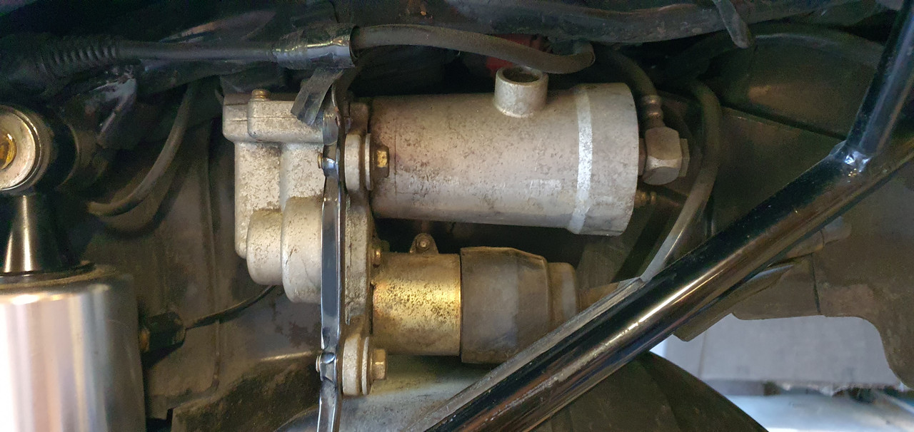

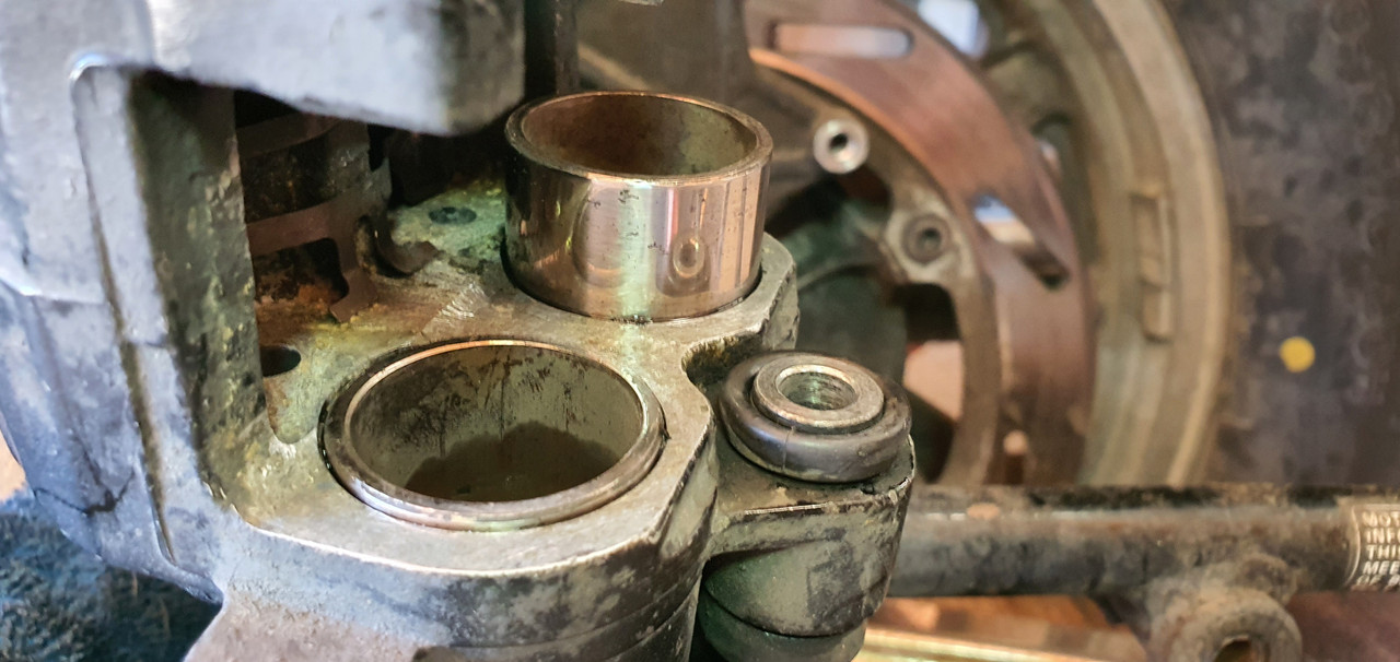

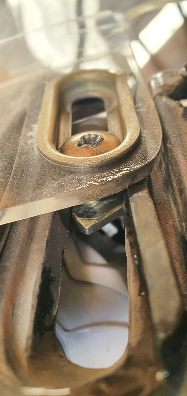

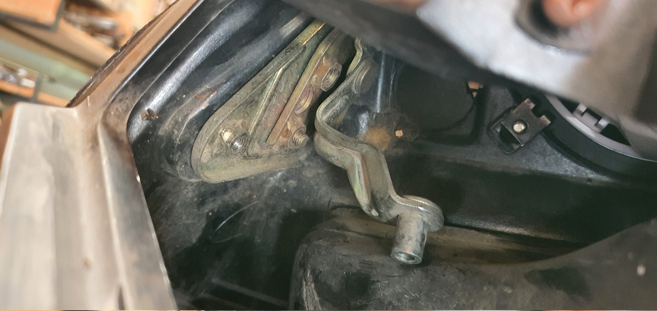

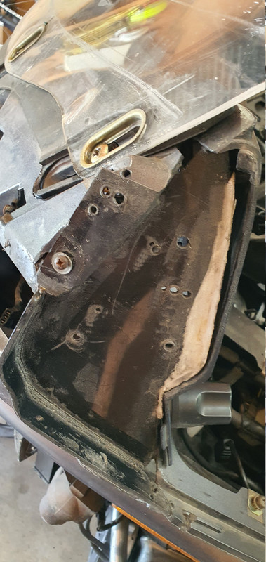

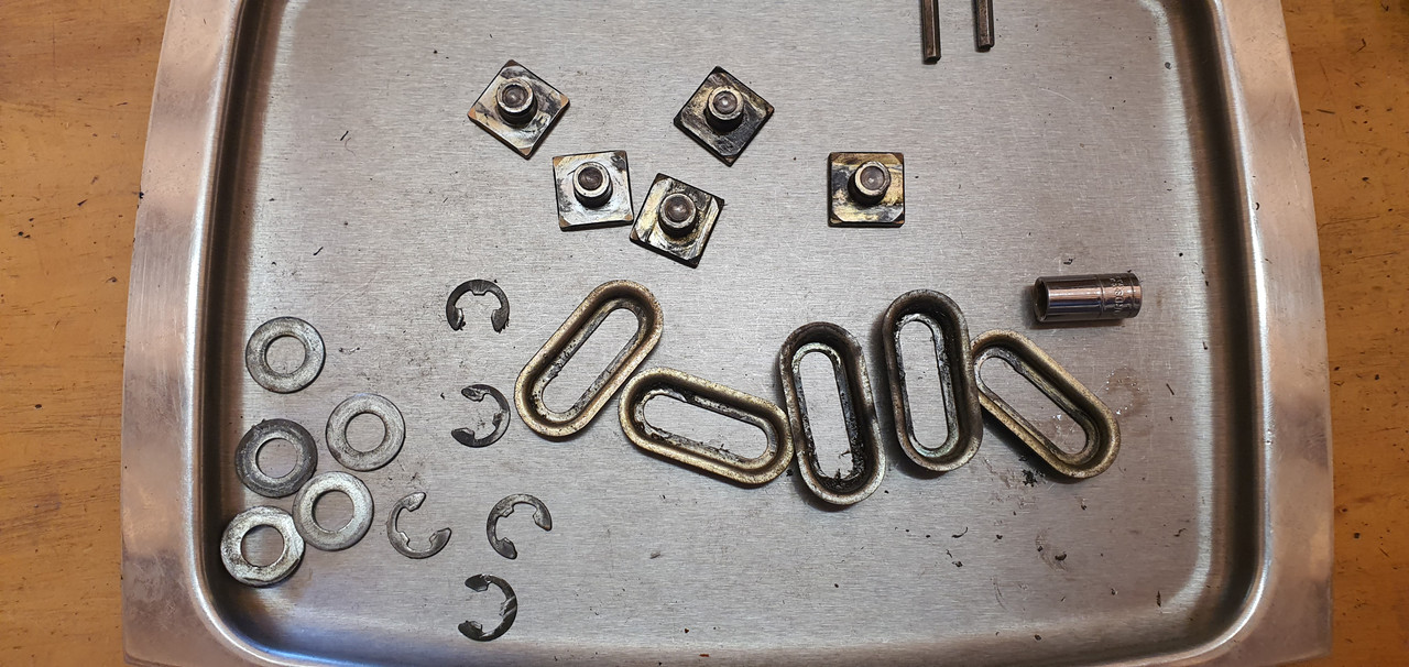

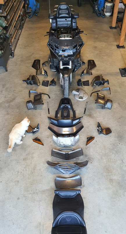

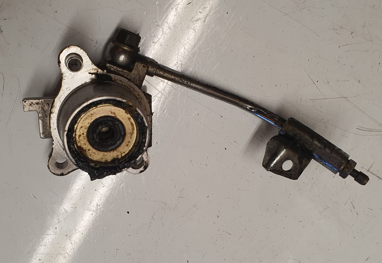

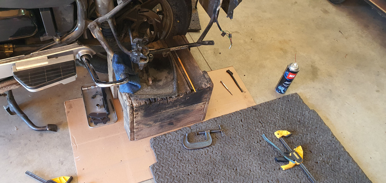

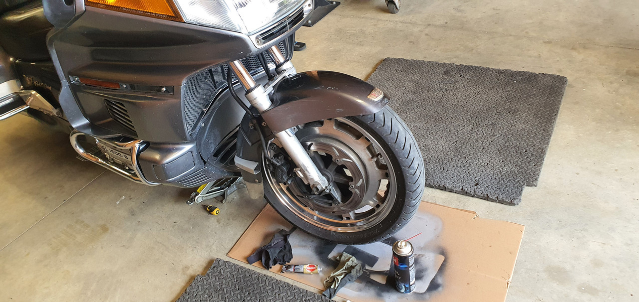

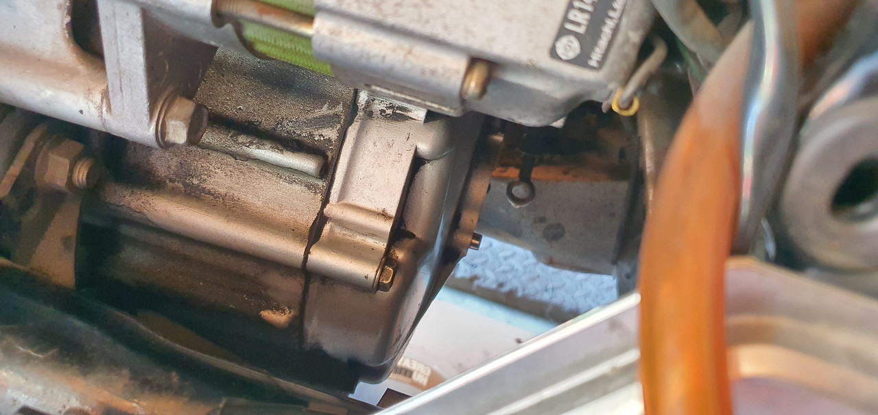

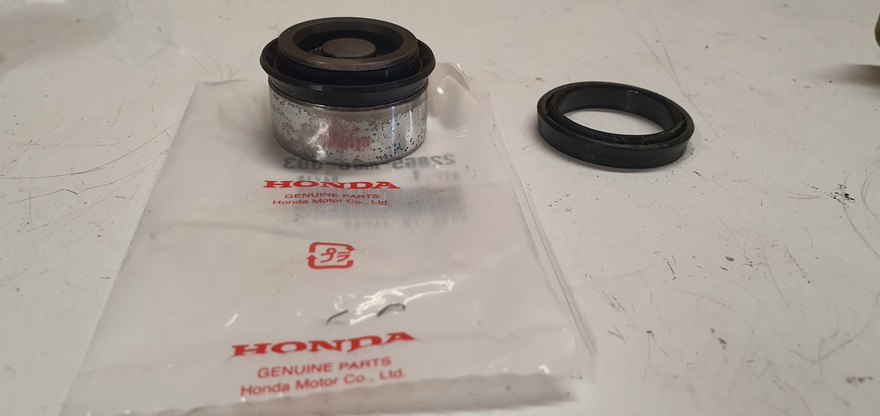

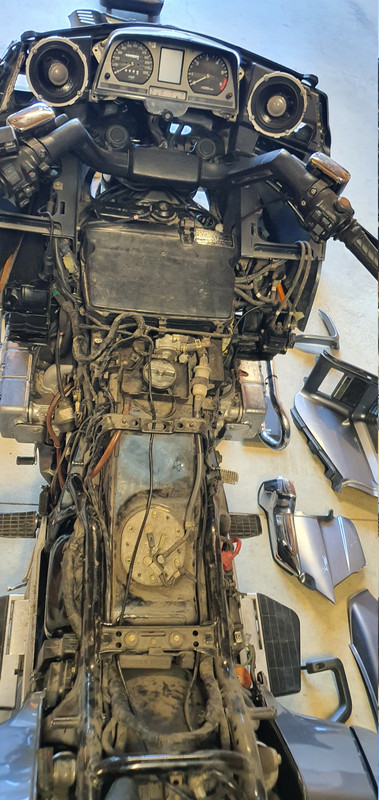

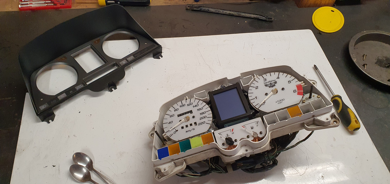

Popular Post yoeddynz Posted February 12 Author Popular Post Posted February 12 Picked up the new clutch slave seal from Nelson Honda. I also bought some proper bike gloves while in Nelson so now I'm not wearing loose welding gloves. Onto the clutch job. Bike on centre stand, towels in place to avoid getting fluid on paint. Slave came out with no fuss. Bolts on back of engine - you can see one of the locating dowels here.. Messy.. Seal flat and worn. Luckily the bore was good, just a quick hone to clean it up. Old vs new.. All back in place, bled the system and it feels better than ever. Our friendly post girl messaged me to say the cambelts I was waiting on were in her van so I set to stripping bike down. I wanted to sort out the old windshield and also remove the white aftermarket gauge faces. I couldn't find the levers that you undo to release the screen and allow it to slide up or down about 80mm. The levers are meant to be on each side near the mirrors. Upon removing the mirrors I discovered a whole repair section on one side. The levers and associated bits have been removed. Only one bit remained on one side.. The screws holding the screen to the slidey bits were jammed up solid and the square tabs they screw into would just spin. Bugger. I drilled the 5 screws out until the heads popped off. Finally the screen was off. Left with these bits... Luckily I could fit the lugs in the lathe and drill out the remaining screws. Even luckier- 4 of the 5 ended up just spinning out once the drill bit grabbed. News stainless screws with anti-seize applied and I have working adjustment. Not as fuss free as with the lever system but I suspect I'll only adjust the screen height once then leave it alone. Will fit shiny new clean screen upon reassembly of the bike. While the screen was out I could remove the gauge cluster and get rid of the white faces. If you look carefully you can see the original black MPH faces beneath. The KPH ones don't accurately match. For example 50mph = 90kph! Removed and it looks better already. Sadly the original black faces for the fuel/temp are not hiding beneath. They've been removed completely. So white it shall remain for those. Next job was the cambelts. Really easy on these engines. Double checked the manual but the pulleys are well marked and its a nice process. Old belts were Honda branded and seemed ok. But better to be sure as its an interference engine. So the bike is in many bits. I've started removing the aftermarket wiring for the stereo, charging points and those air horns. Found one original horn in place so that's now working again. I repaired some small cracks in the some fairing bits, cleaned all the areas not normally easy to get to. The chrome crash bars have come up really good. I'll clean the other bits as I refit stuff. Enjoy the process. But while its apart I had to get these shots.. Close up of the workings for those interested... Must check the plugs, change the coolant and brake fluid, fit some new pads as the fronts are low. But for now I can at least now put it through a wof. 19 1 Quote

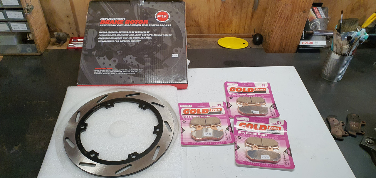

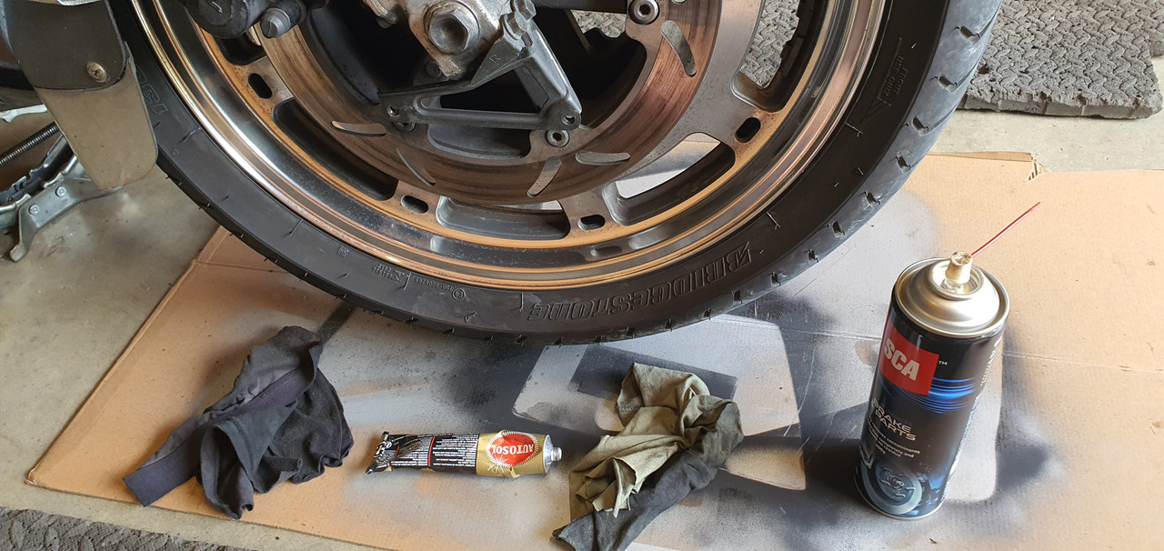

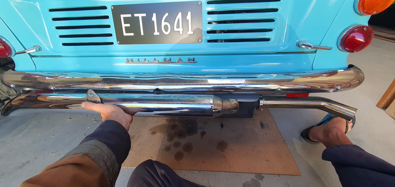

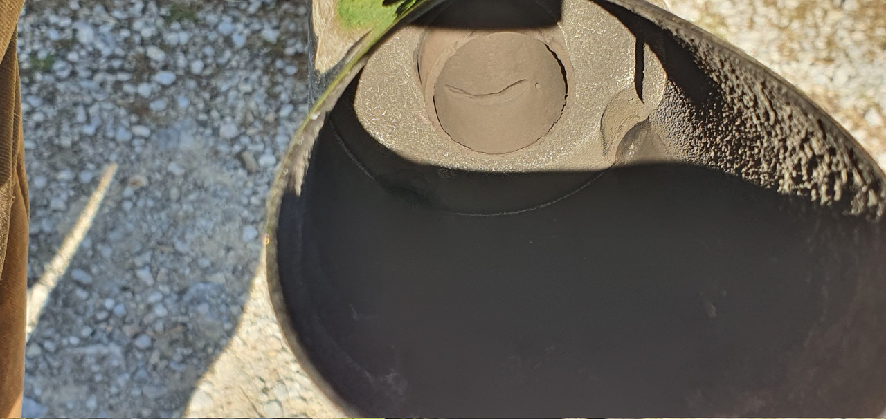

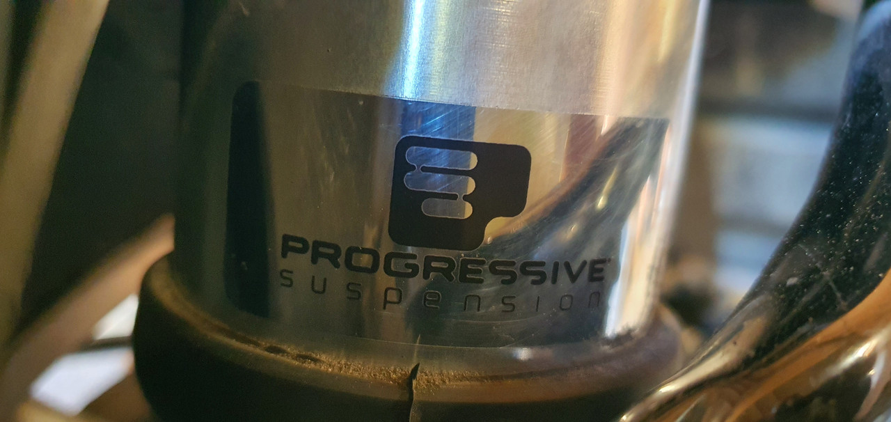

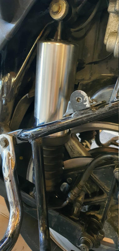

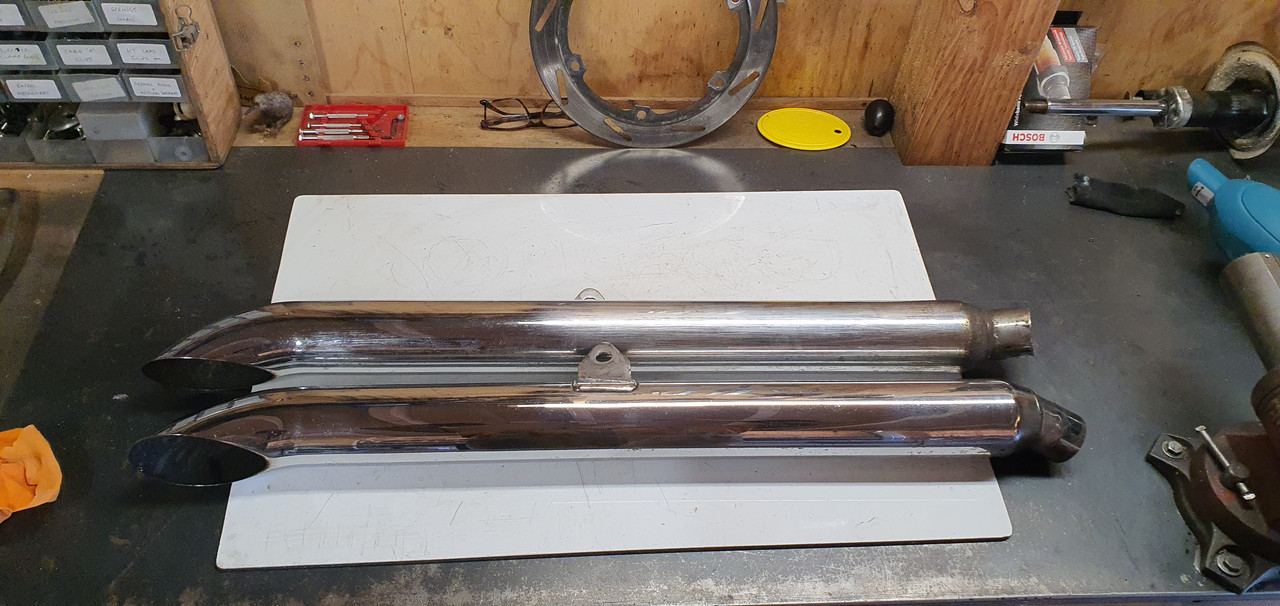

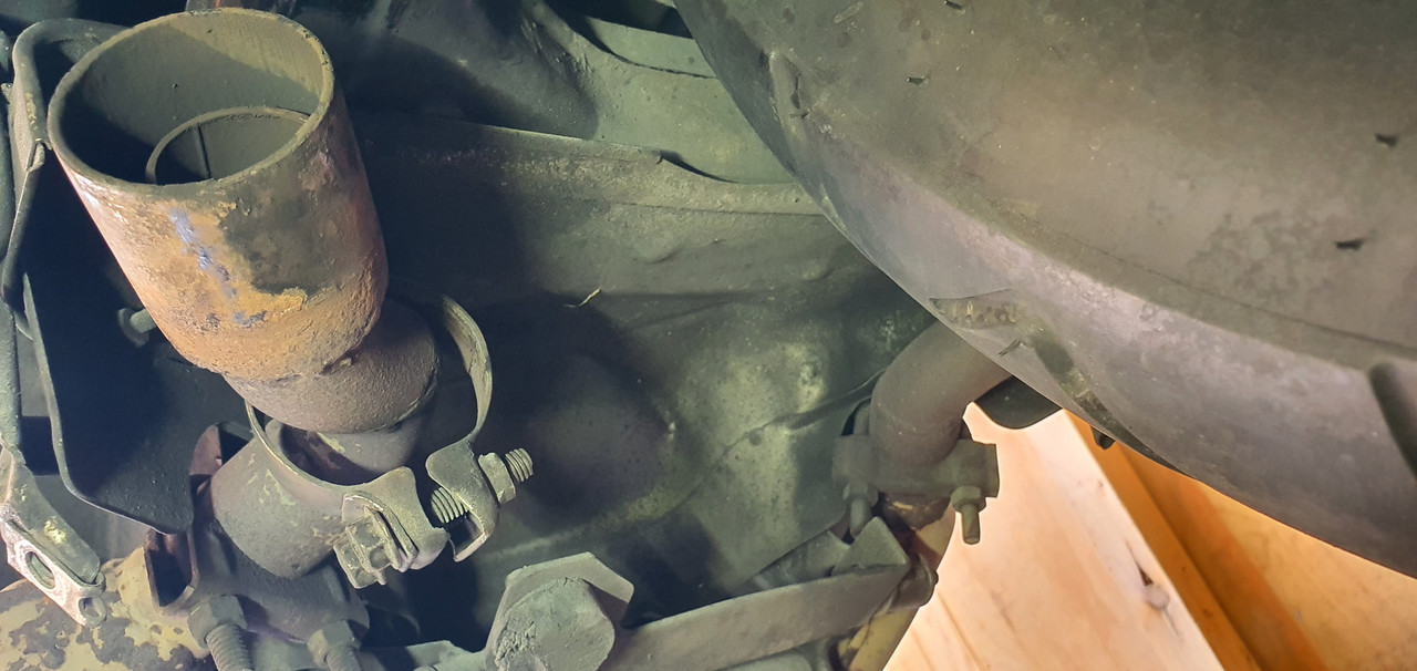

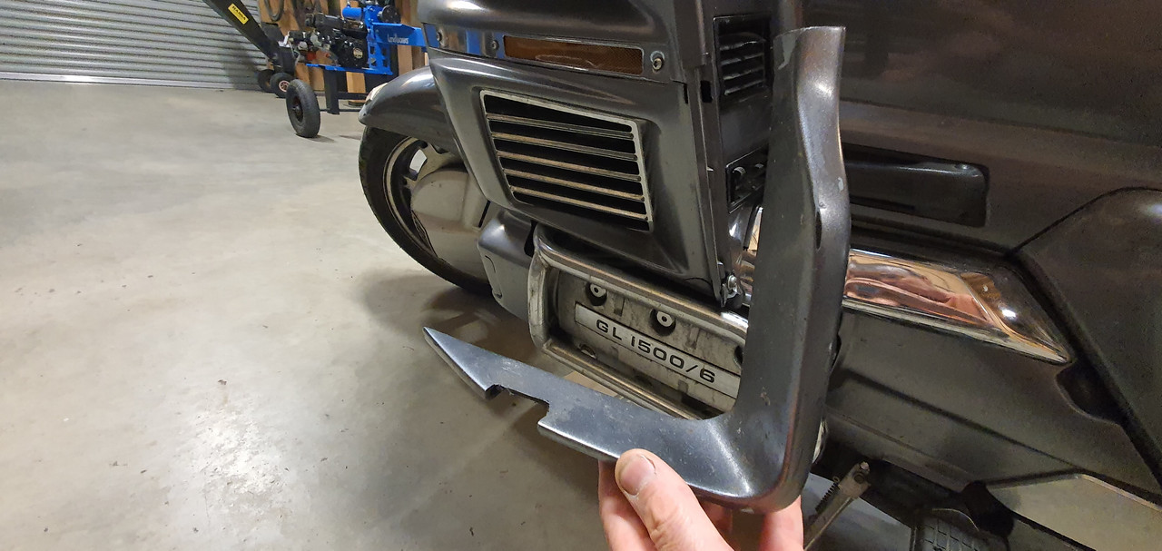

Popular Post yoeddynz Posted March 1 Author Popular Post Posted March 1 I measured the discs and the rear was below the limit. $180 later for, luckily available, a new aftermarket disc. Honda want circa $600 for an oem item! Bought some pads as well. They could have lasted a bit longert on the front but for the money its good to know its all new stuff. Removed the rear side boxes to get to the wheel. Not a difficult job. Good chance to give it all a clean. Luckily the stainless caliper pistons came up clean before being slid home. Front brakes had clean pistons too and got the cleaning treatment before new pads were fitted. Then we bled the whole system through until it was all new fluid. Cute little compressor that charges the rear shocks. It had more recently been fitted with new shocks. There's also an airline from the compressor into one of the panniers- you can use this to pump the tyres/inflatable boat/inflatable lady up. While the mufflers were exposed I removed them for a proper polish. This bike sounds so nice, although a bit loud when under load up climbs. Would probably be a bit drony in a car. But I weighed them (quite heavy) and sized them up on the Imp just out of interest. The bike has had its expansion box removed so there's another reason for the extra decibels. The silencers do have pretty small outlets though. Probably the only reason its not horrendously loud. It thought it rude not to polish up the nice alloy wheels. Mainly the front as its the one on view. It came up pretty good! In related bike news we visited a friends place down the road. He's got a lovely collection in his living room! I love this bike. CBR1000 with a straight six. What a lovely looking engine. I'd love to fit one of these into a small unsuspecting car I've been riding the bike almost every day. I just go out for 20 mins and practice on the quiet roads around here, targeting the twisty roads. I'm improving each time and getting more comfortable with it. On my Saturday morning ride I actually stopped and took a photo. Later that morning whilst busy doing an exhaust job on mates car my cousins turned up. Very keen bikers who are pretty stoked I've been bit by the bug. So the yard looked a smidge bikey.. My nephew who's started a bike mechanic apprenticeship locally has got a Ducati speed machine. Very deathy looking. My next job now the brakes are sorted is to pop into town and put it through a wof. 10 Quote
cletus Posted March 2 Posted March 2 416 Series Shocks | Progressive Suspension those shocks probably cost near what you paid for the whole bike, ha 4 Quote
yoeddynz Posted March 2 Author Posted March 2 Crikey! Good to know though. Its pretty cool using them with the panel controls. The pressure of the system gets displayed on the little lcd screen between the dials. Must have seemed pretty techy in 1988. 2 Quote
