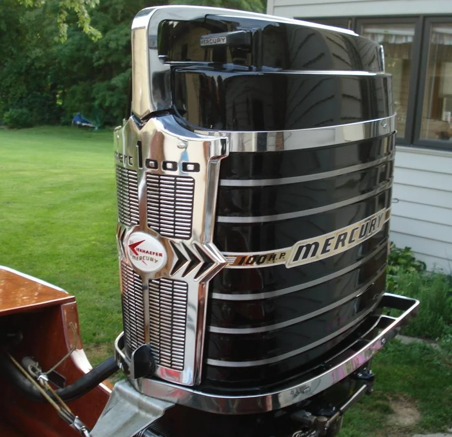

Lord Gruntfuttock Posted January 19 Posted January 19 Has anyone ever made a retro engine cover for period outboard cool factor? 3 Quote
Rhyscar Posted January 19 Posted January 19 First of all love your work. I think everyone at some stage dreams of having time to spend on a project like this and the sailing boat. You may or may not be aware of this, but there is a wooden boat parade every year at the real Lake Rotoiti (north island). We always happen to be there about the same time, and there are always some pretty sweet rigs. I'm a fan of the rear passenger compartment for pleebs in the back(or VIP's - whichever way you look at it hah). The other thing to consider here, is the single greatest thing about boating is that you can technically boat while drinking - as long as you're in control of your vessel. So I would highly encourage space for entertaining extra friends and storing a few extra cooled crate bottles on your sweet, sweet wooden boat. There are always some amazingly built boats that show up, but I particularly enjoy the ones that get used for skiing, picnicing and general lake shenanigans. Here are a few samples for inspiration; https://www.woodenboatparade.co.nz/shop/filter/category=31308/ 6 1 1 Quote
dmulally Posted January 19 Author Posted January 19 2 hours ago, Lord Gruntfuttock said: Has anyone ever made a retro engine cover for period outboard cool factor? I did speak to @ThePog about helping me out with the whaler cowling ages ago but didn't get further than that. The obvious choice would be to make it look similar to a classic merc but not sure how as the cowling has a bit of a curve to it and the old ones were straight. Open to ideas though. 1 1 Quote
Lord Gruntfuttock Posted January 19 Posted January 19 Sweet. Yeah I was thinking a moulded fibreglass type cover with stainless trim, just for looks. Obviously don't want to restrict access or airflow and add too much weight, but would really accentuate the aesthetics... Quote
