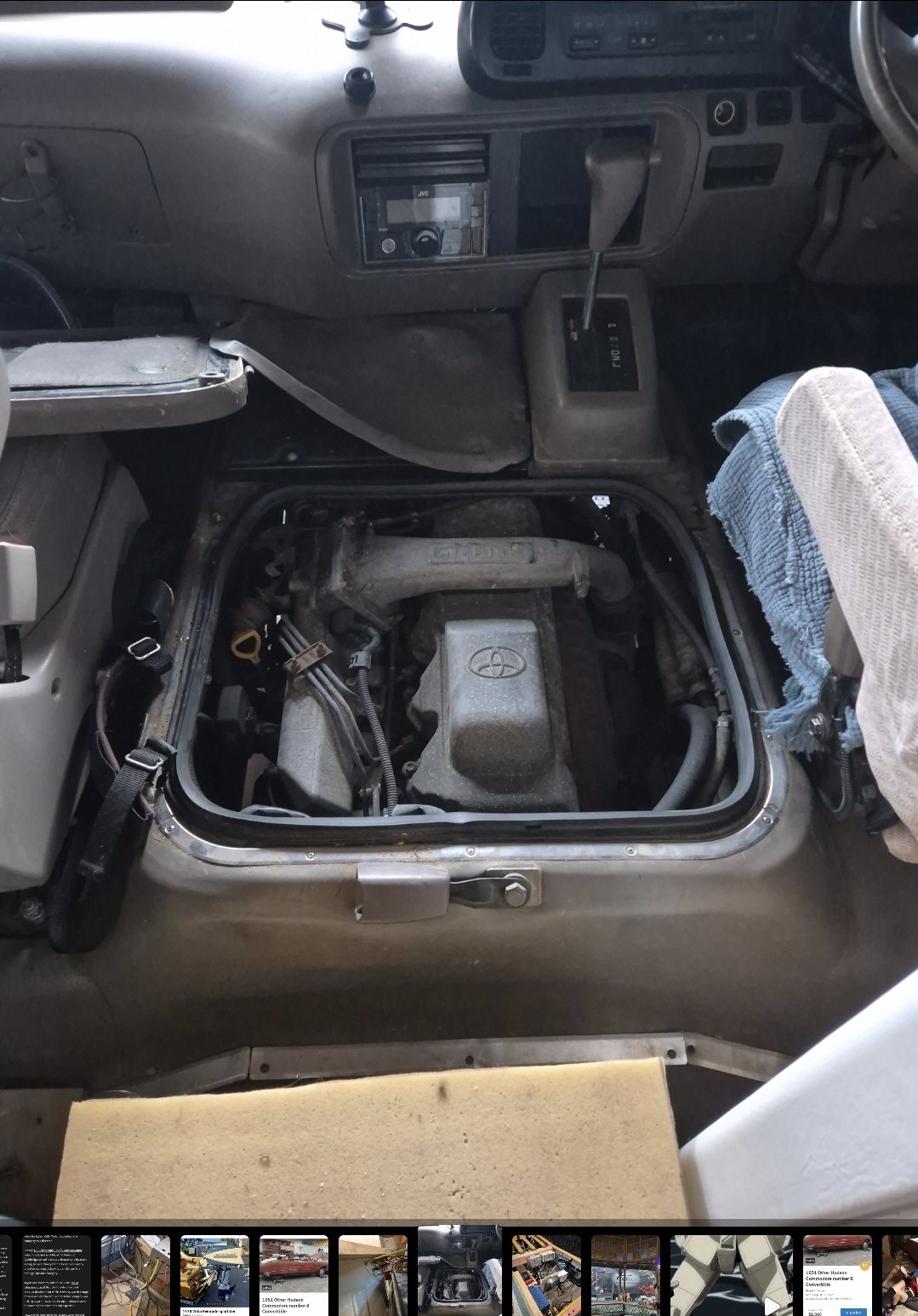

HumberSS Posted January 11 Author Posted January 11 24 minutes ago, square said: I got my pump and injectors done by trundles, it made a big difference with a bit of boost but still gave me 50hp when I wanted 100. They have their own metering pin profile and I fell for the sales pitch. Its smokier than id like Is it definitely a 1hdt ? Most of those were 15b's which is a weapon of an engine. Under piston oiling and direct injection. I had a 60 series with a turboed one in it and it made great power, still does. I wasn't actually a hundy on what engine it was. The reg actually says it's a 7 liter engine, but my searching revealed no such engine exists and Wikipedia said the 1hdt was a common donk in it. All I know is it's fucking huge. Actually one moment caller I think I have a pic... See attached - access looks wonderful.... I did think about taking it to Trundle. I've been recently doing bits of work for him designing cast inlets/exhausts for td42s. He's a good boy and they know their shit but I assumed he would talk me into more than just screwing the pump a bit.. Quote
square Posted January 11 Posted January 11 Yeah that does look like a 1hdt I think, 15b is a 4 holer with injectors in centre Quote
HumberSS Posted January 11 Author Posted January 11 17 minutes ago, square said: Yeah that does look like a 1hdt I think, 15b is a 4 holer with injectors in centre yeah its a 6 cylinder Quote

jessemk2 Posted January 14 Posted January 14 On 12/01/2026 at 08:40, HumberSS said: I wasn't actually a hundy on what engine it was. The reg actually says it's a 7 liter engine, but my searching revealed no such engine exists and Wikipedia said the 1hdt was a common donk in it. All I know is it's fucking huge. Actually one moment caller I think I have a pic... See attached - access looks wonderful.... I did think about taking it to Trundle. I've been recently doing bits of work for him designing cast inlets/exhausts for td42s. He's a good boy and they know their shit but I assumed he would talk me into more than just screwing the pump a bit.. Rocker cover looks like could be 24 valve 1hdft the best of the of the in line 6 check the build plate. Trans lock up kit helps alot with these auto aswell 2 Quote
HumberSS Posted January 14 Author Posted January 14 59 minutes ago, jessemk2 said: Rocker cover looks like could be 24 valve 1hdft the best of the of the in line 6 check the build plate. Trans lock up kit helps alot with these auto aswell Thanks man. I will do that...when I find it.. I use the OD button on the hills etc, trans lock up kit sounds interesting Quote
