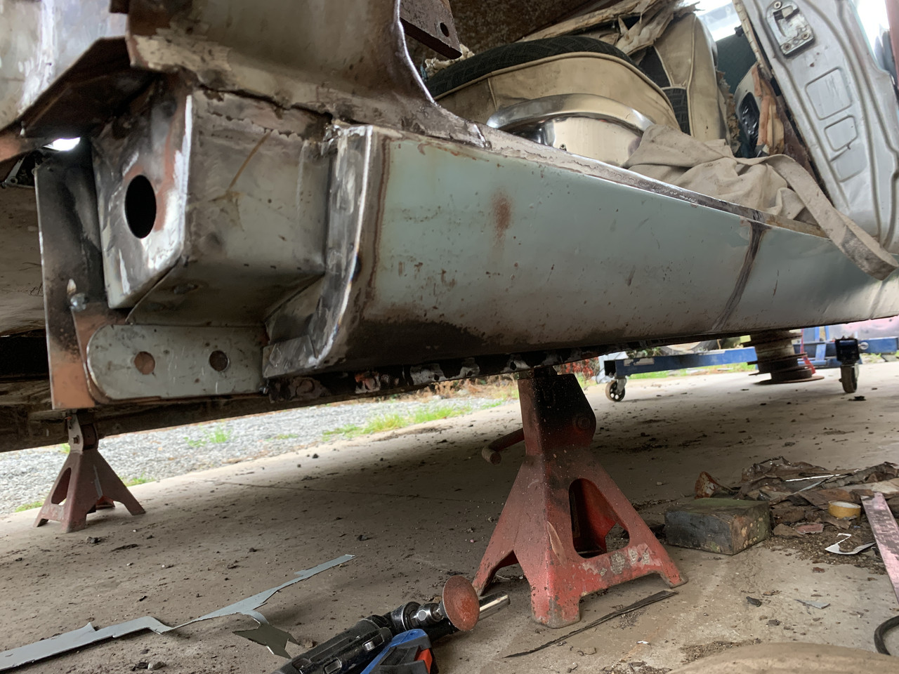

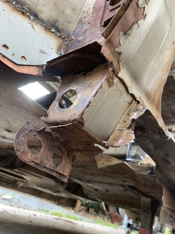

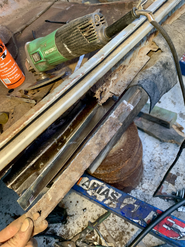

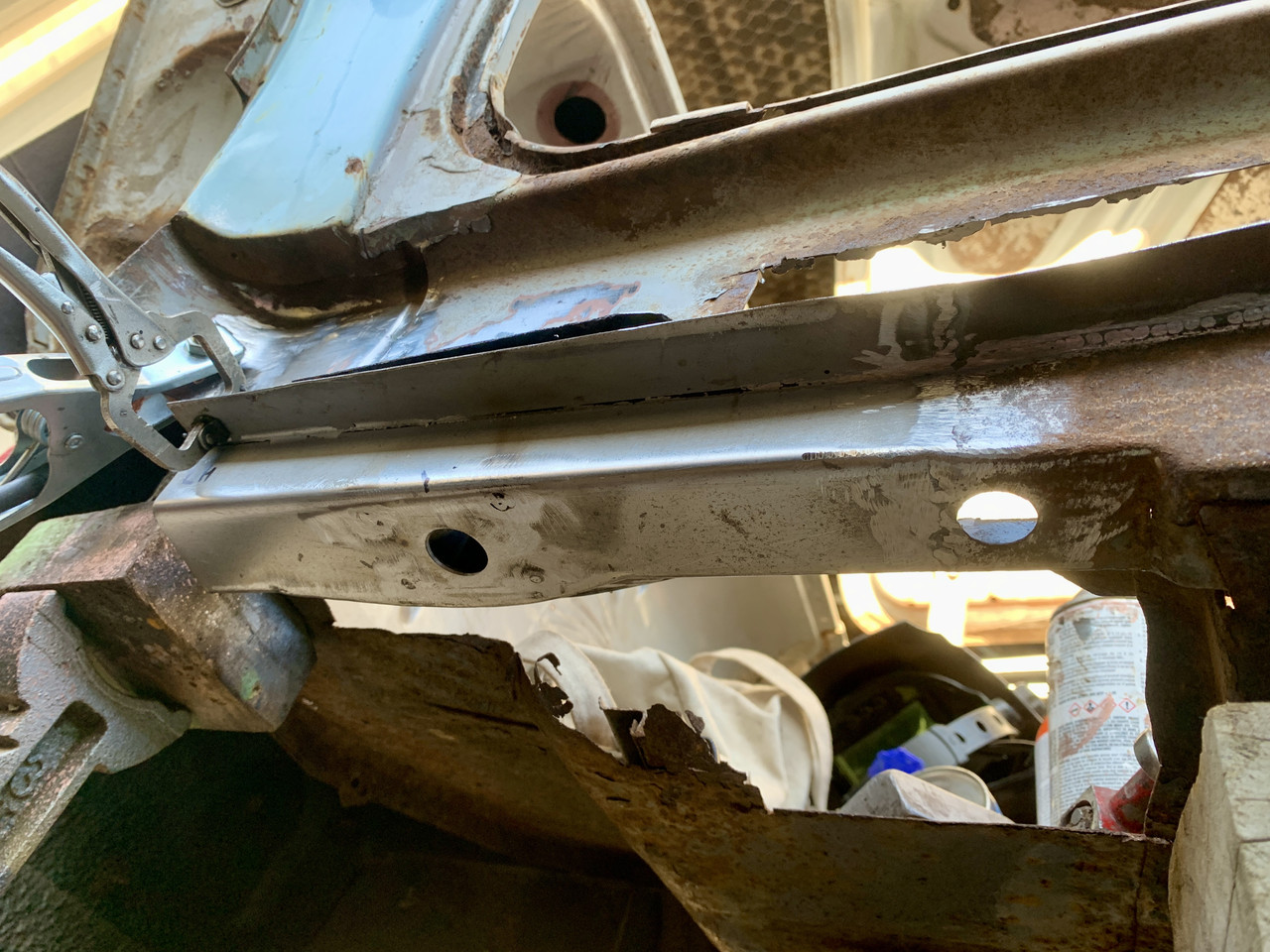

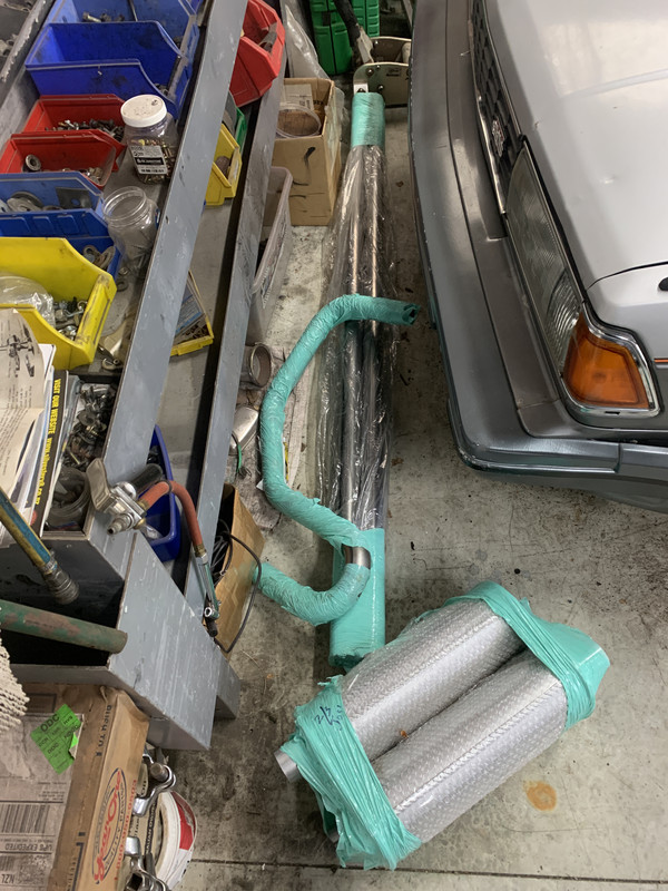

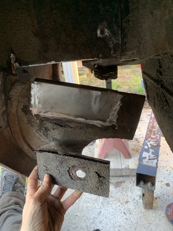

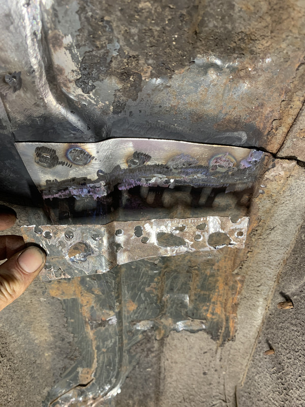

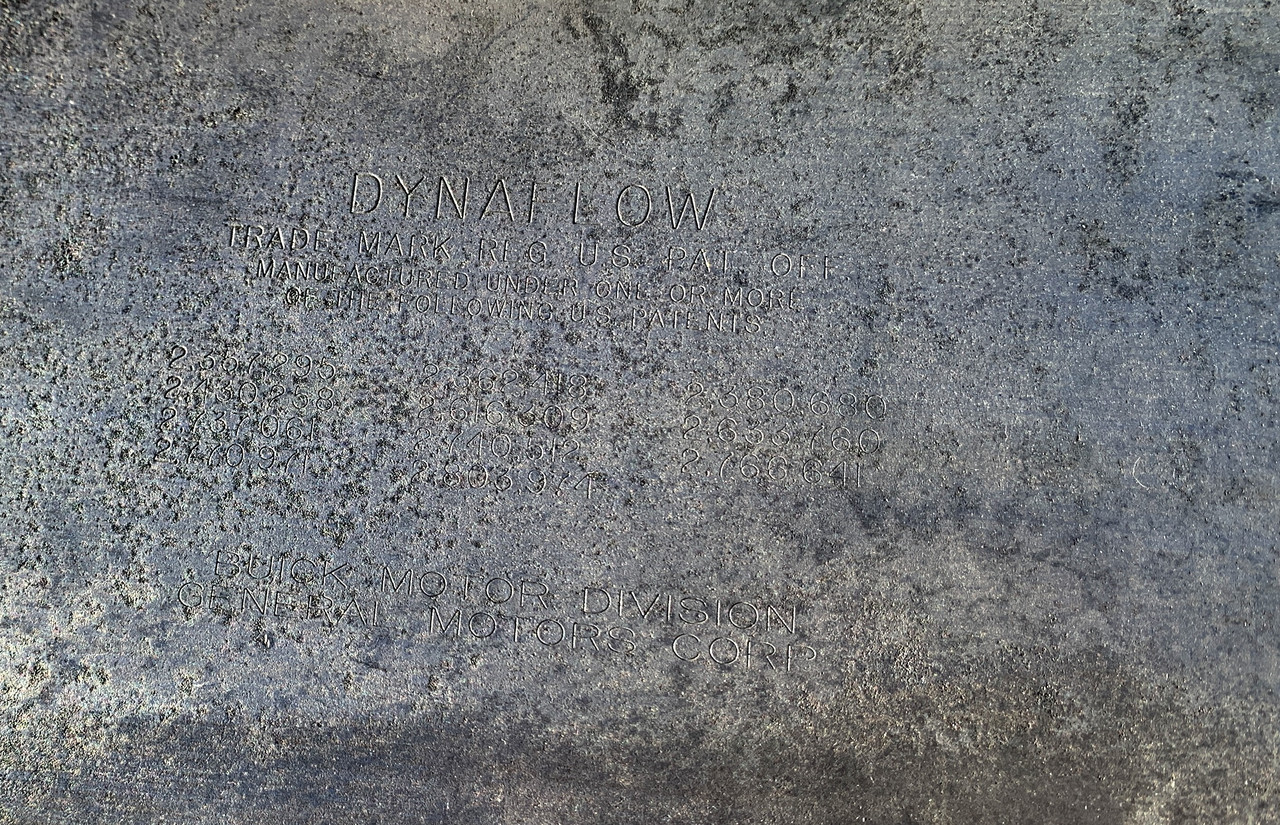

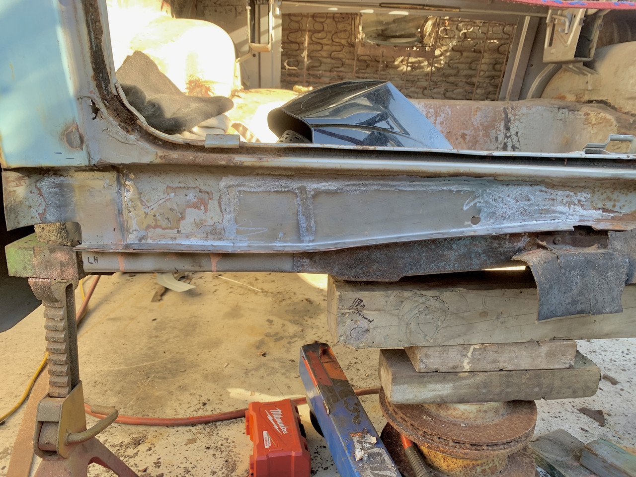

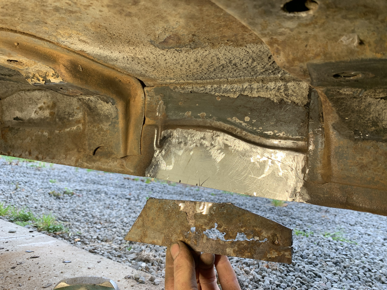

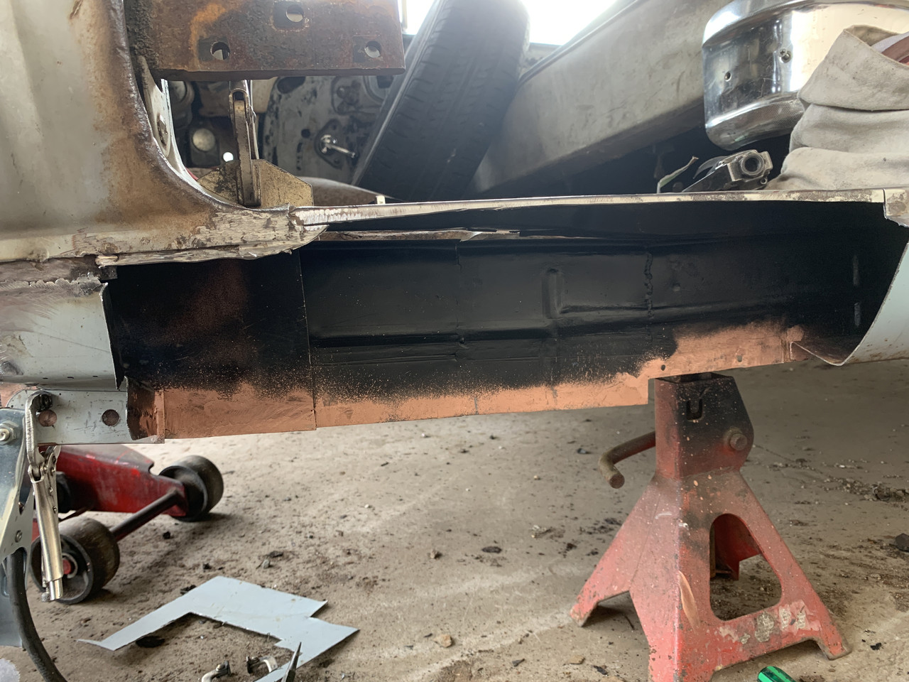

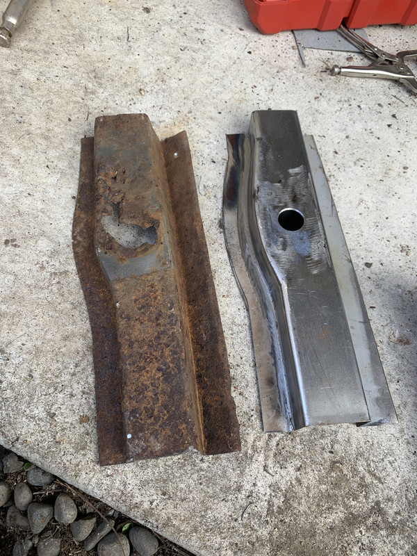

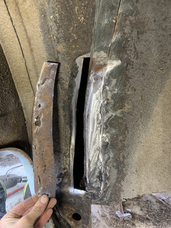

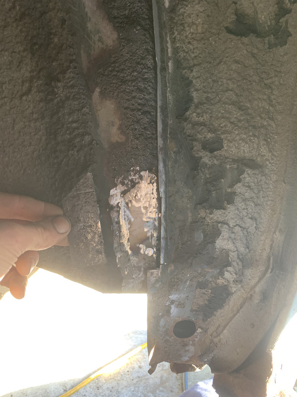

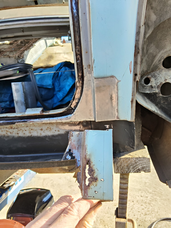

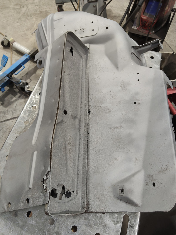

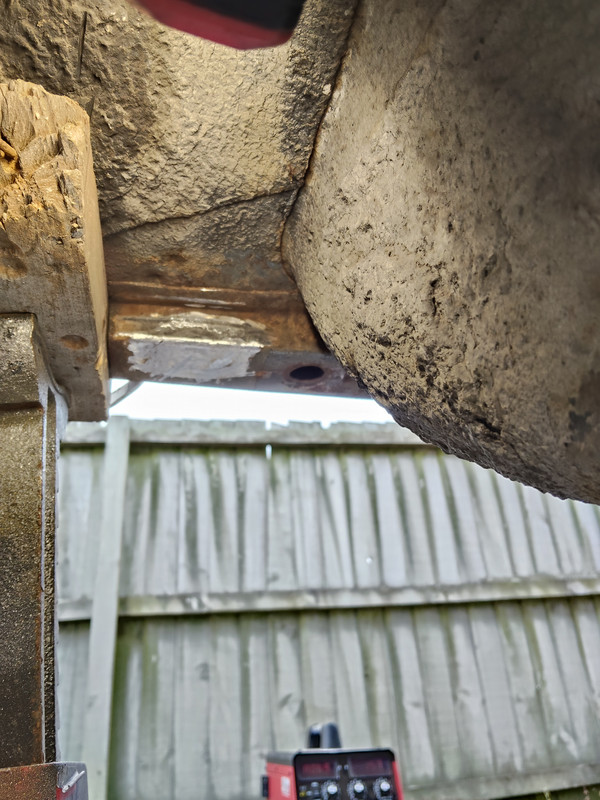

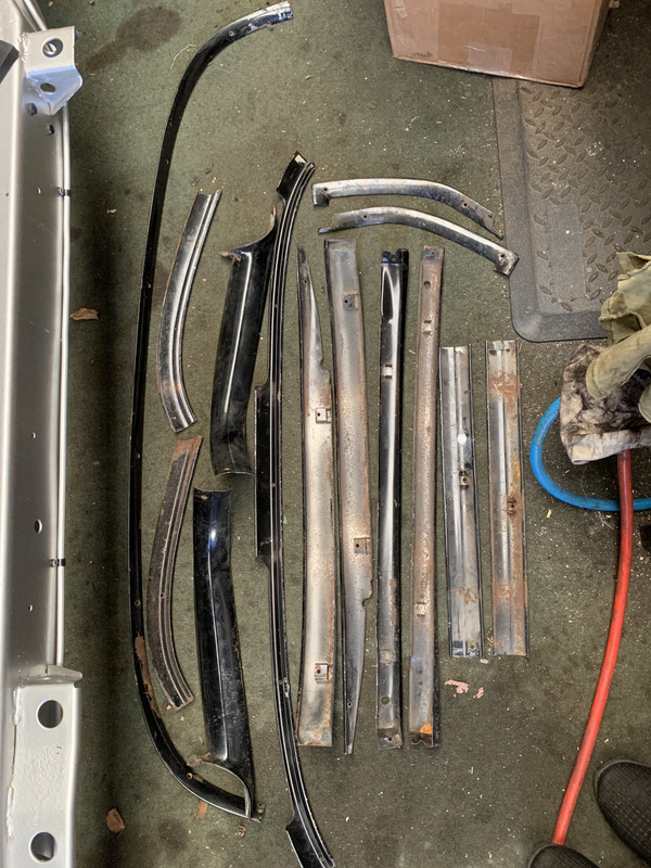

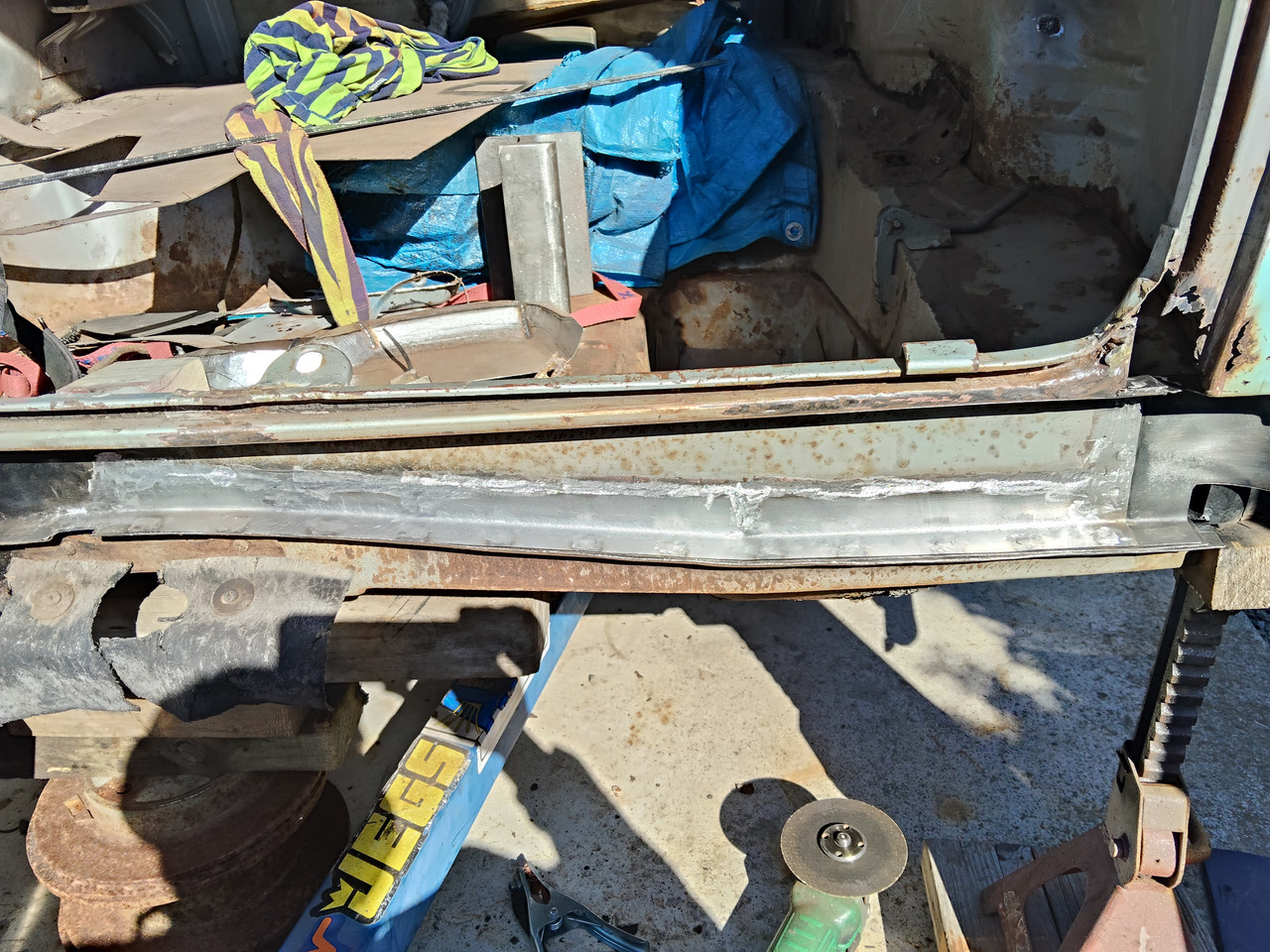

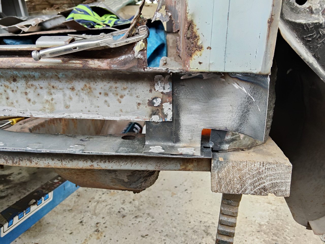

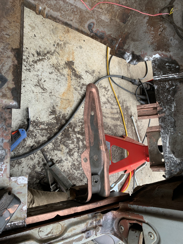

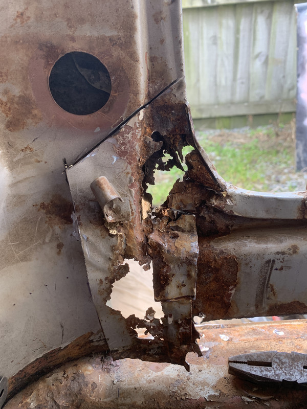

Popular Post Mr.Mk1 Posted June 1 Author Popular Post Posted June 1 The sumps came out of the molasses and were clean as a whistle. Exposed MANY patent numbers on the bottom of the trans pan, lol. Ordered black diesel-heater ducting for the other sizes required, installed sweet as. The Bailey channels showed up, was a perfect fit on the divider side, had to spread the latch side channel out as it was too tight but lush AF now. Ordered exhaust gear, one of the multi-bends is due tomorrow..never got close to chance to get started but was nice to have it for the long weekend? Right, rust time again. The sill was creased and with no good way to get at it, I had to chop it out. Thats the crummy stuff I can’t get at with the chassis under’er. Hoicked some pieces out of the rear wheel tub to replicate after work. Id say that should be dialled next weekend. 38 Quote

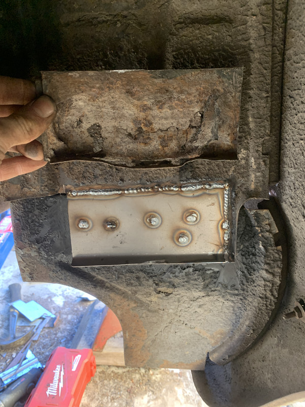

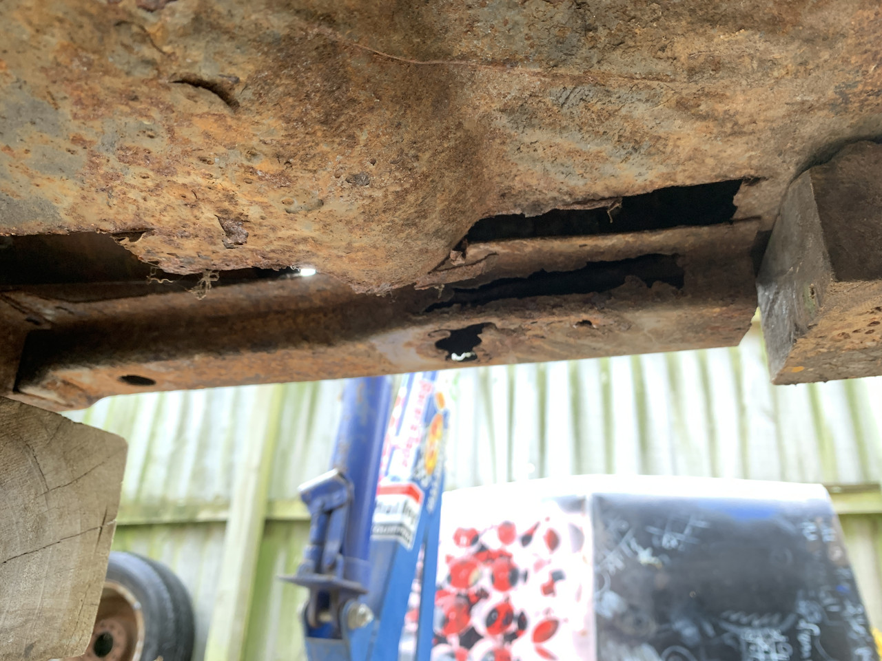

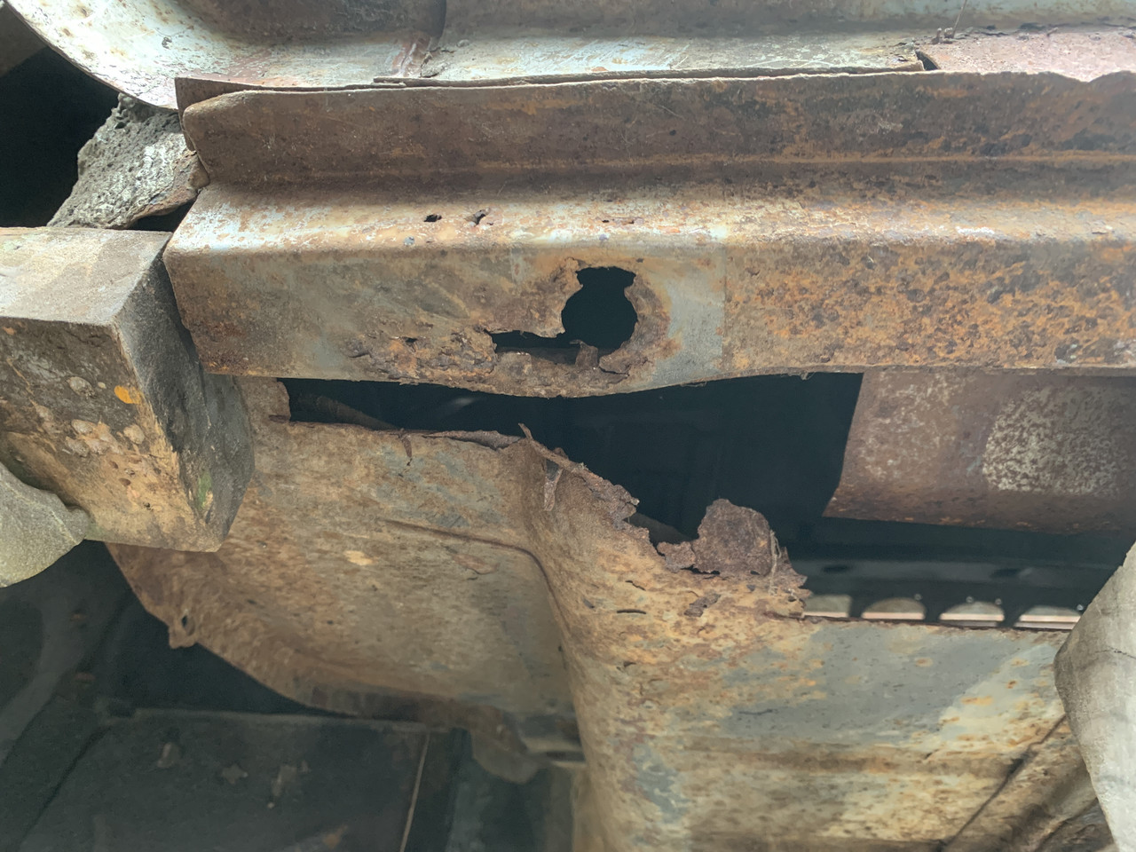

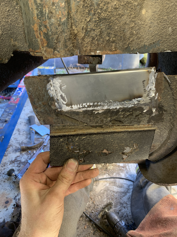

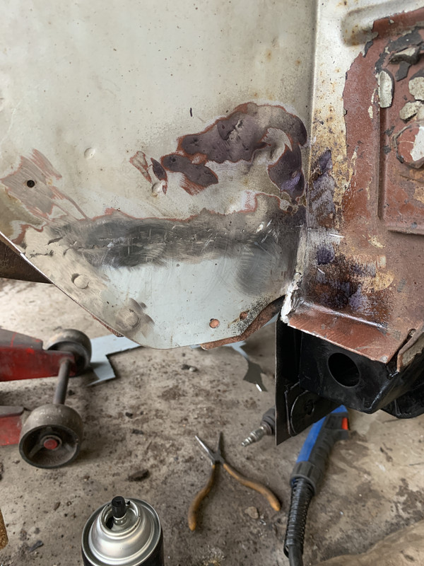

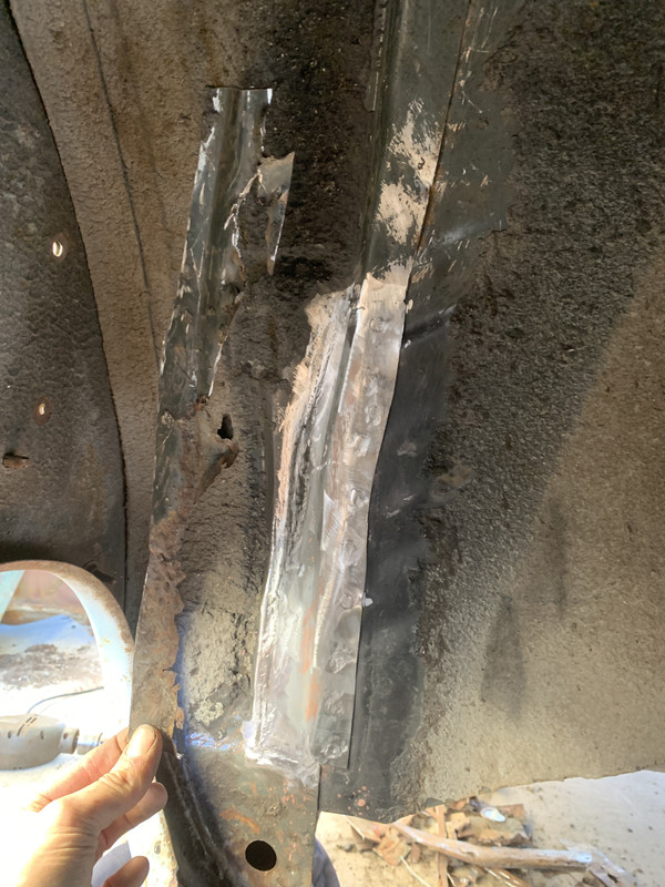

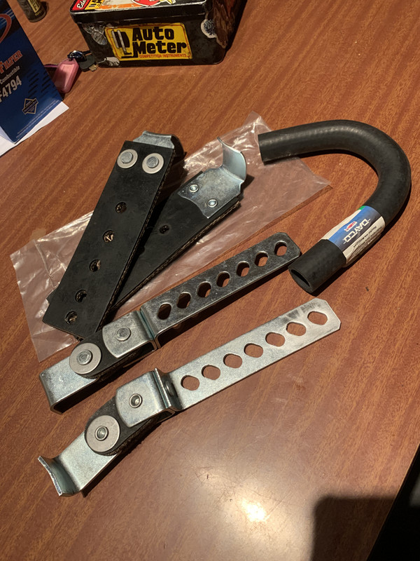

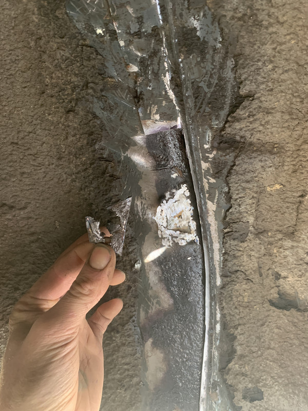

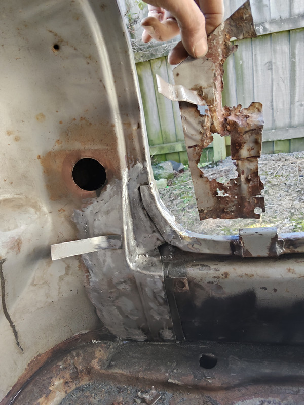

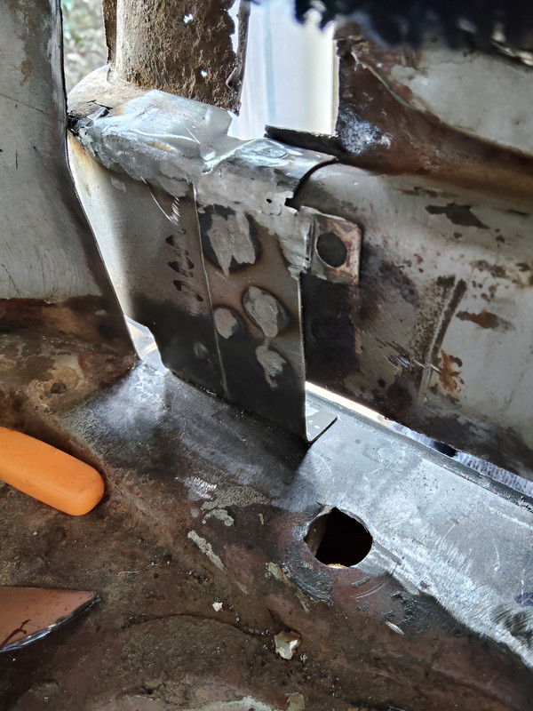

Popular Post Mr.Mk1 Posted June 7 Author Popular Post Posted June 7 More goods from ROCKAUTO.. heater hose and some cheap universal exhaust hangers that were on clearance. Rose-tinted glasses backhanded off by reality of 68 year old car, lol. What id envisioned as a couple of hours in the back corner spiralled to 2 days and more to go… You don’t see this bit when it’s on the chassis… Hmm this corner is soft. No wonder, there’s practically a scallop directing road splash into a wee nook..it was full of heavy bitumen but didn’t suffice. Had to sandwich a layer in there for the future trunk floor (This bit does taper towards the latch, I didn’t F it up) The weird transition in the corner was seam sealed to hell but let go from behind the lead join on the outer I’ve yet to whip out. I’ll seal it up again because it looks goofy uncovered In other news, $3885 for a windscreen delivered here. What in Tarnation!! Have a couple of others quoting, hoping to scrape something back from that. I’m in no hurry at all and with their stock order would be fine, but didn’t seem to translate on the bottom line! Onward 27 Quote

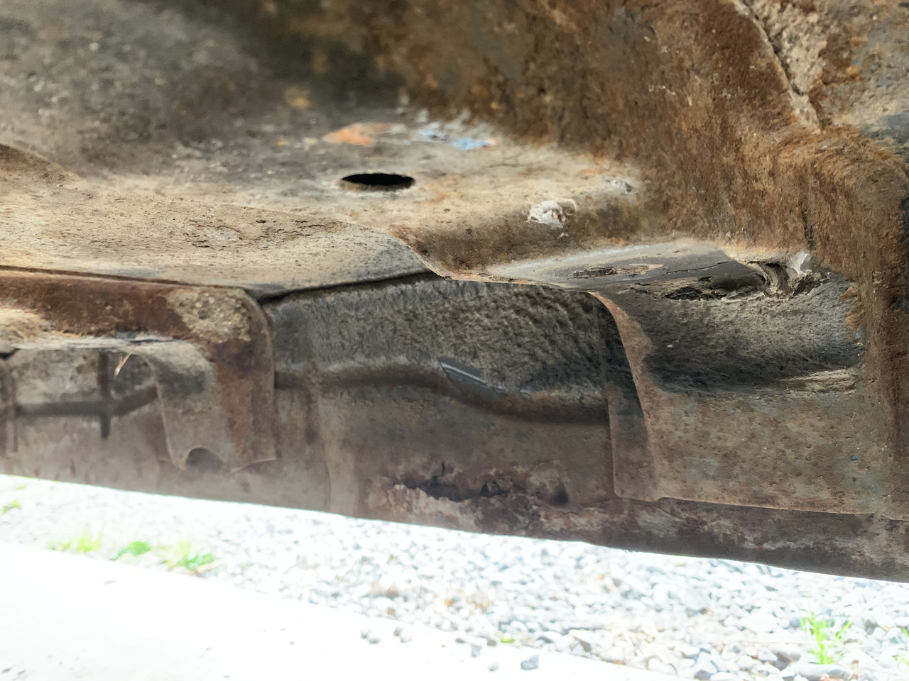

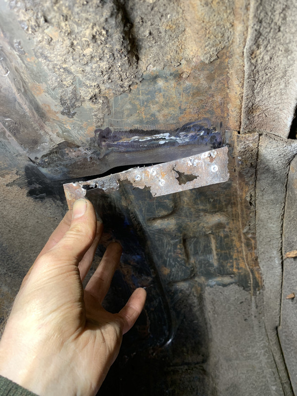

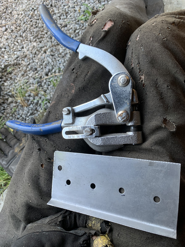

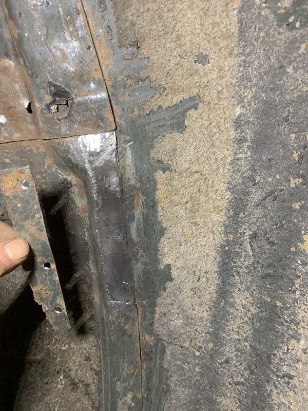

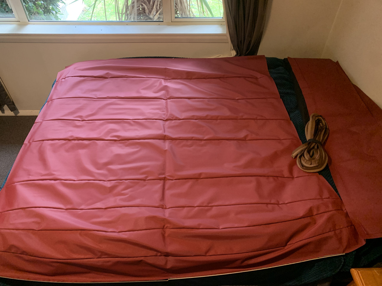

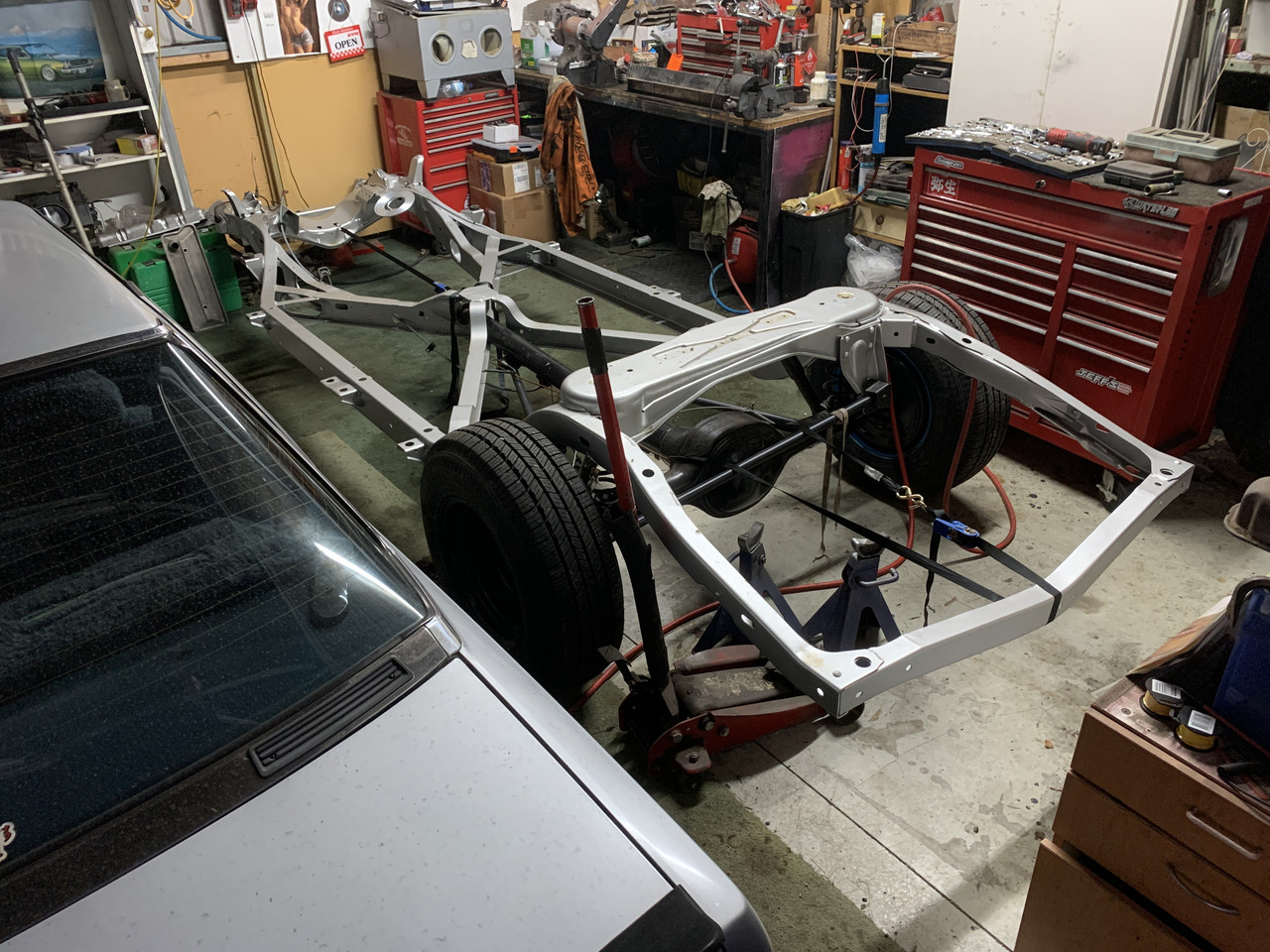

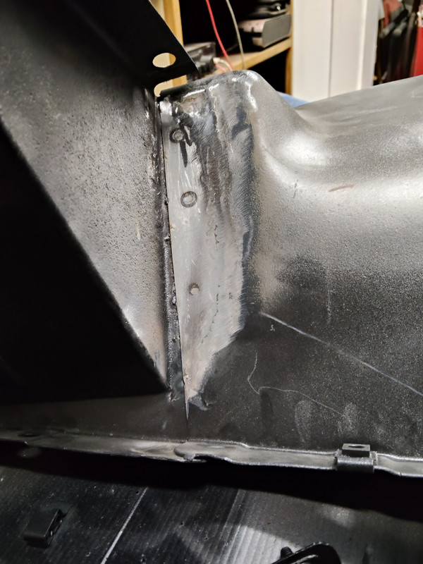

Popular Post Mr.Mk1 Posted June 14 Author Popular Post Posted June 14 I was feeling by a bit self conscious about all the grinder noise in the carport so I decided to put the frame in the shed. Tight squeeze! now I can start on the exhaust at nights. The trunk bumper pad always seems to pus out on these things. Neat wee profile I also melted out the lead in the very corner and patched, but forgot to photograph before etching. Can see it in background. Spent a while in the wheel arch, quick and dirty cause it’s a shit spot to work, & it’s going to be seam sealed and undersealed. Not a particularly smart design for longevity, will be fine when I seal it up properly Shout out to the plug-weld hole puncher, I forgot it last weekend and drilling holes was painful compared! Can swap the punch pieces for bigger and smaller sizes in the set. My headliner came in from Rock.. Always wanted a car with red guts! Will tone it down heaps with blacks and greys but red roof will be tits. Unfortunately they sent me the wrong windlace..ordered Maroon and got Cashmere. Too hard to send back so hopefully it takes some dye 36 Quote

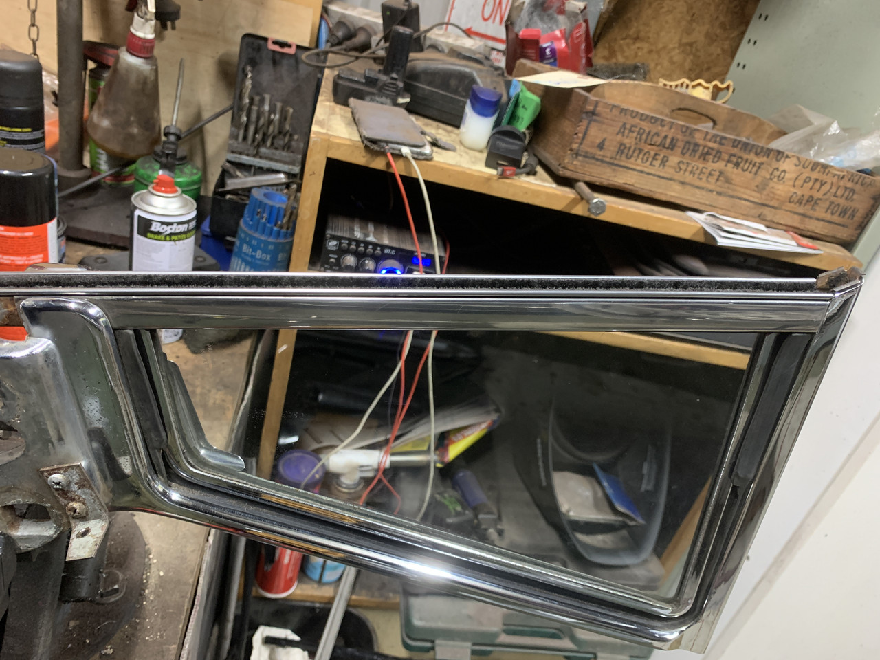

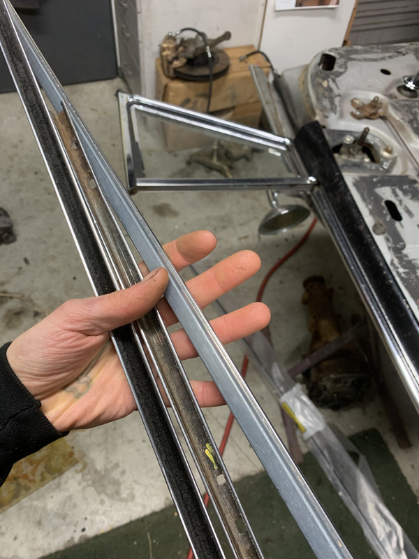

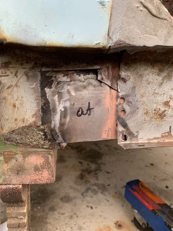

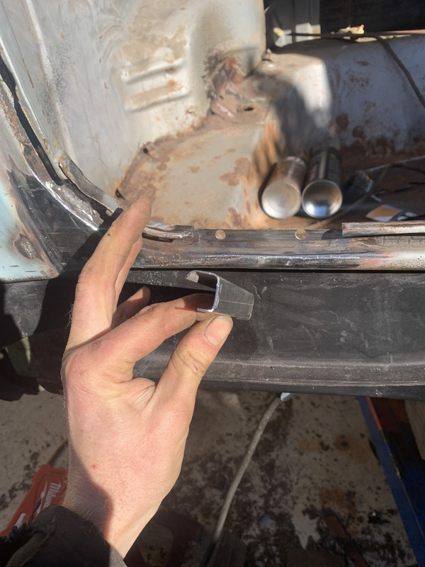

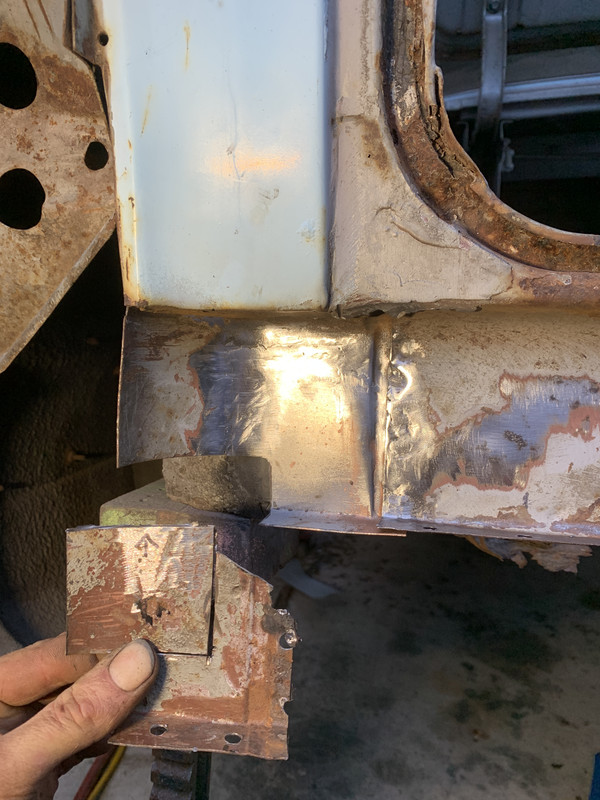

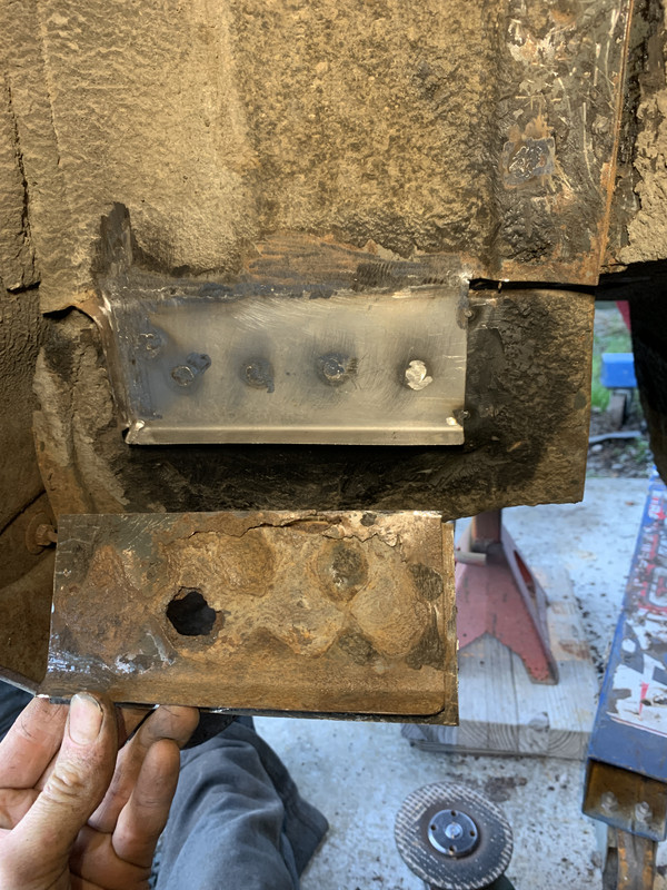

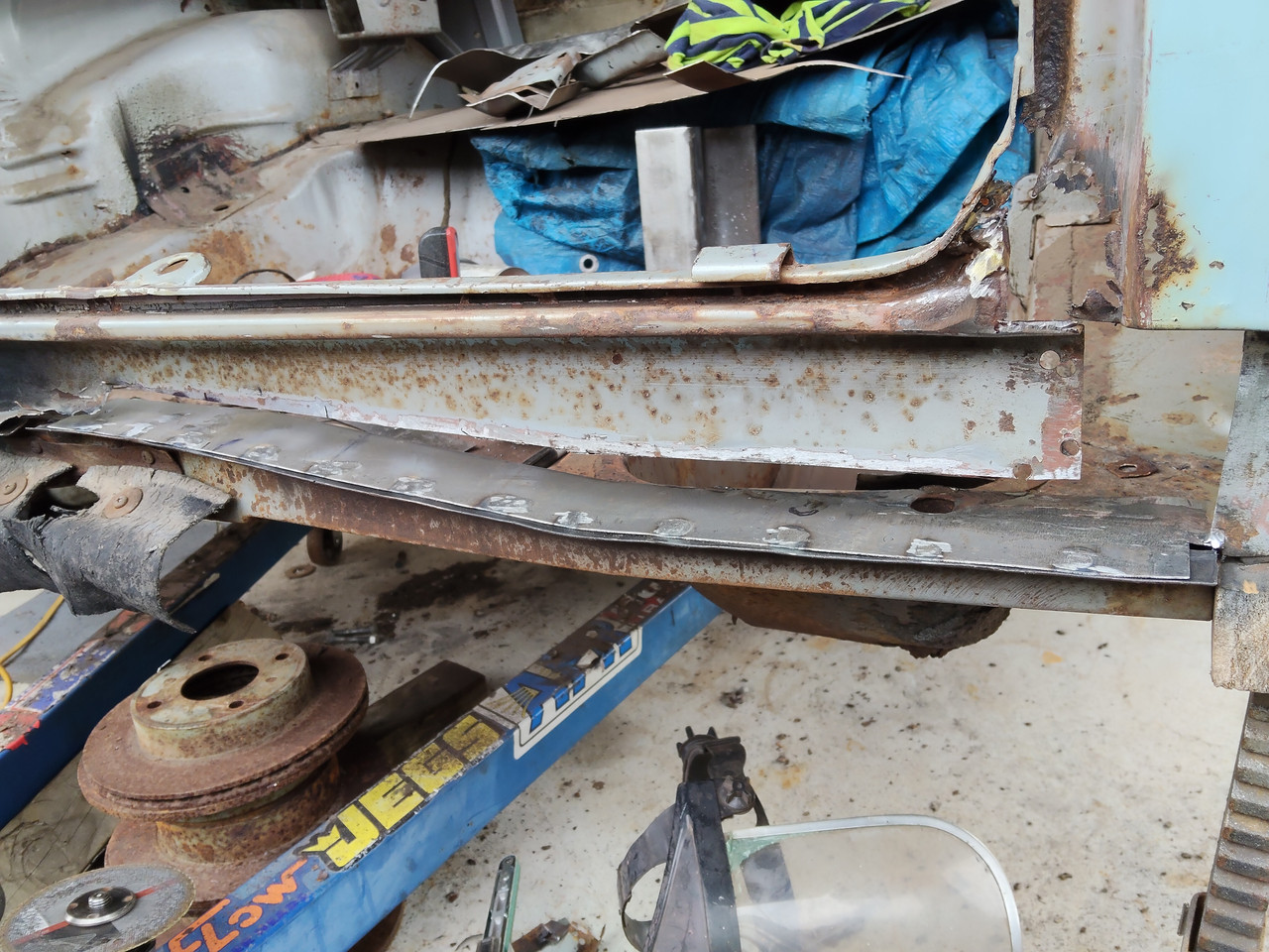

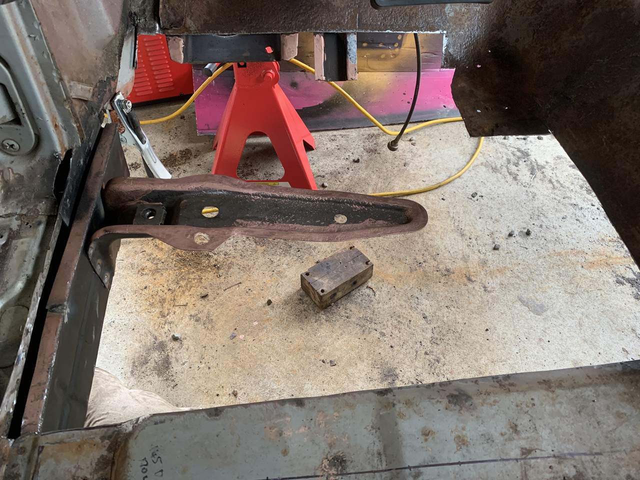

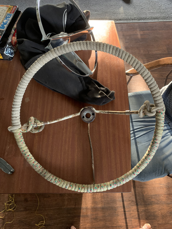

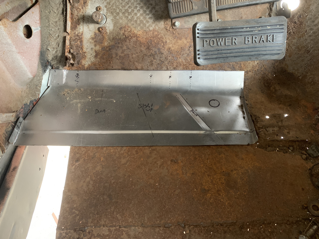

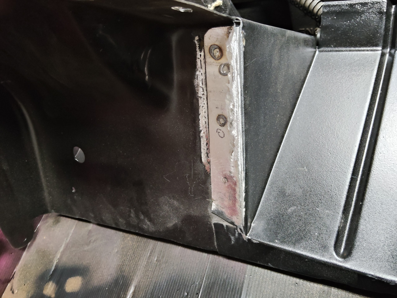

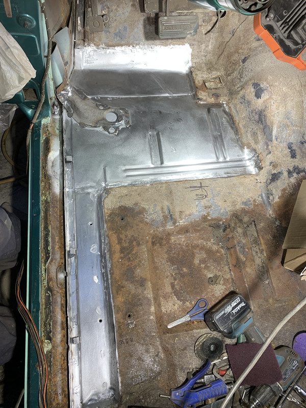

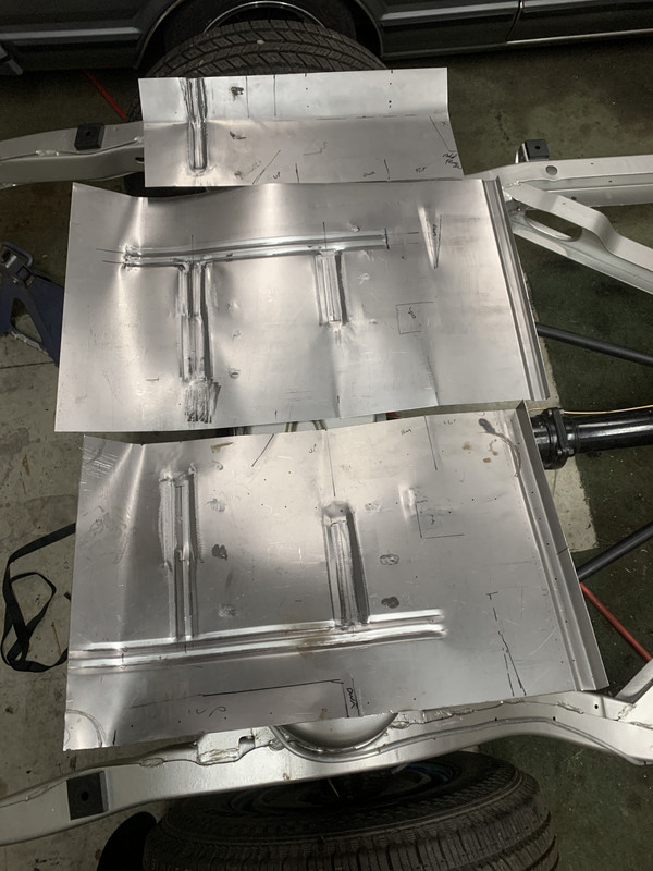

Popular Post Mr.Mk1 Posted June 21 Author Popular Post Posted June 21 Me hands are giving me jip this week so light duties this weekend. Last week I knocked up a drivers toe board, this week I roughed out the other side and both front floor pans. Made a start on the tricky corner section of the trunk floor. Here’s the ones I’ve just completed on the 57 at work: The headliner bows weren’t labelled, no surprises there. Tested them in the roof and believe I have something cooking so labelled and rust killed, stuffed them into the liner to help take out the shipping wrinkles. I’m missing one so I bent something up. Brought a pack of red dye and boiled the headliner windlace for 4x longer than it said I needed to, cant say it’s made enough of a difference. Dang Took the bolts and clips out of the front end inner guards/ rad support etc and will drop them off for a sandblast. Also stripped the interior mouldings/screen surrounds out and will see about a blast and powder coat or HPC coating to look chromie.. church up the inside to match the out! Whipped off the tiller and unwrapped to make an action plan. I wanted a lucite/clear and metal flake setup but too much effort. I’ll do mine white and then spray lots of clear with some sparkle in it. Can be a future side project. In the mean time There’s a sound 56/7 chev 2 spoke locally on marketplace so I might grab that and splice my centre in and transition it into the spokes with some filler.. anything to avoid making and sanding a rim with all the indents by hand.. Project creep: blasted horns and gave a quick wire wool polish to the alloy before some clearcoat. They are aren’t gonna win any awards but they will look better than factory intended 25 Quote

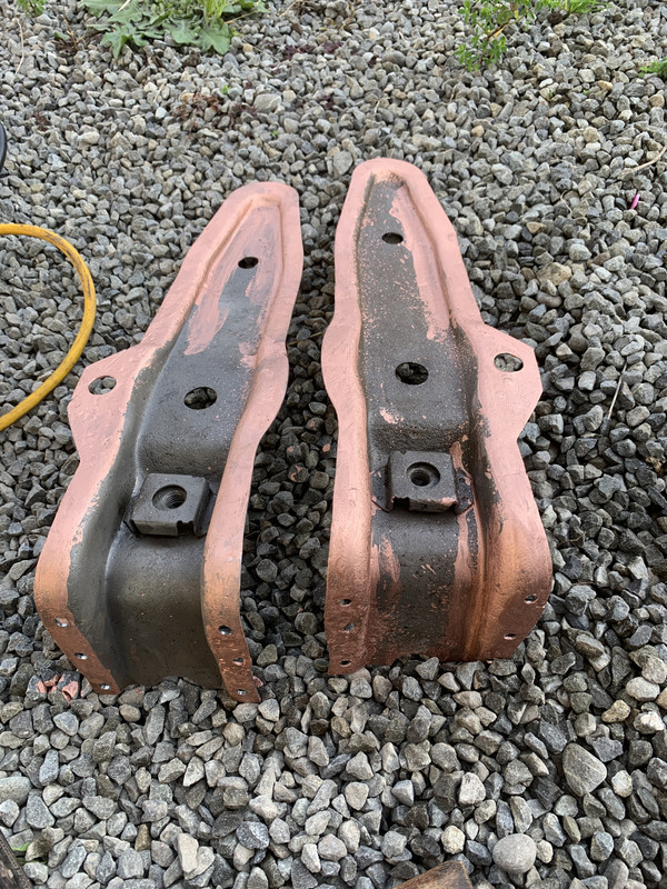

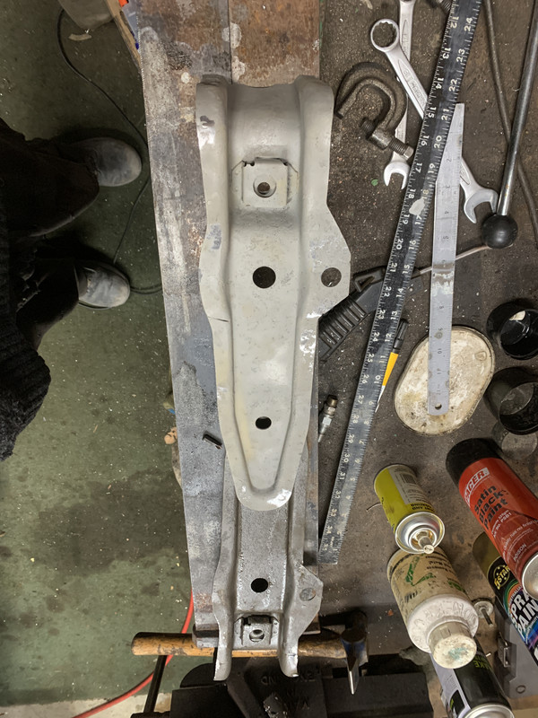

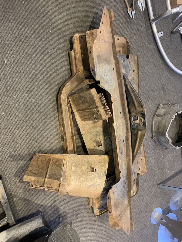

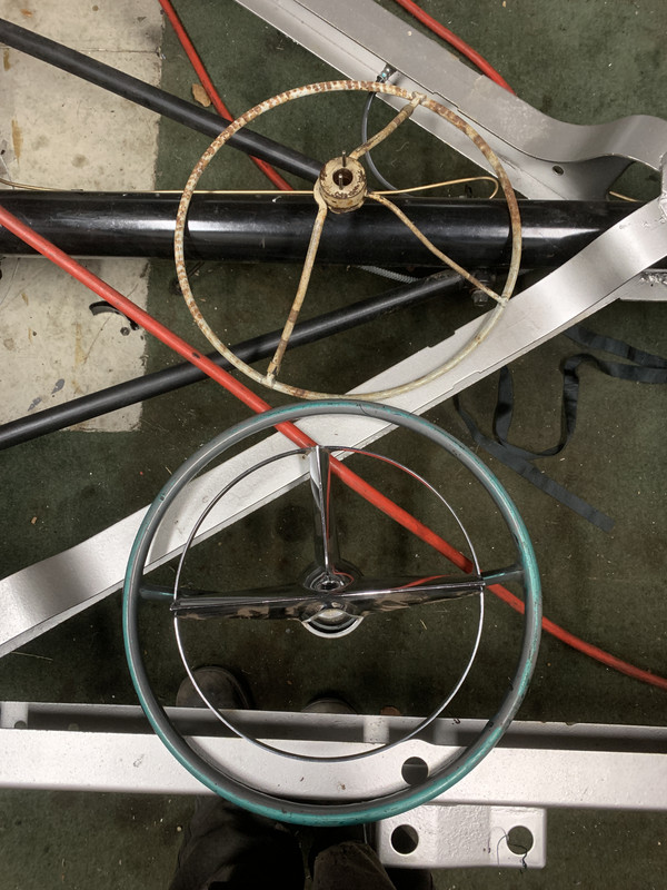

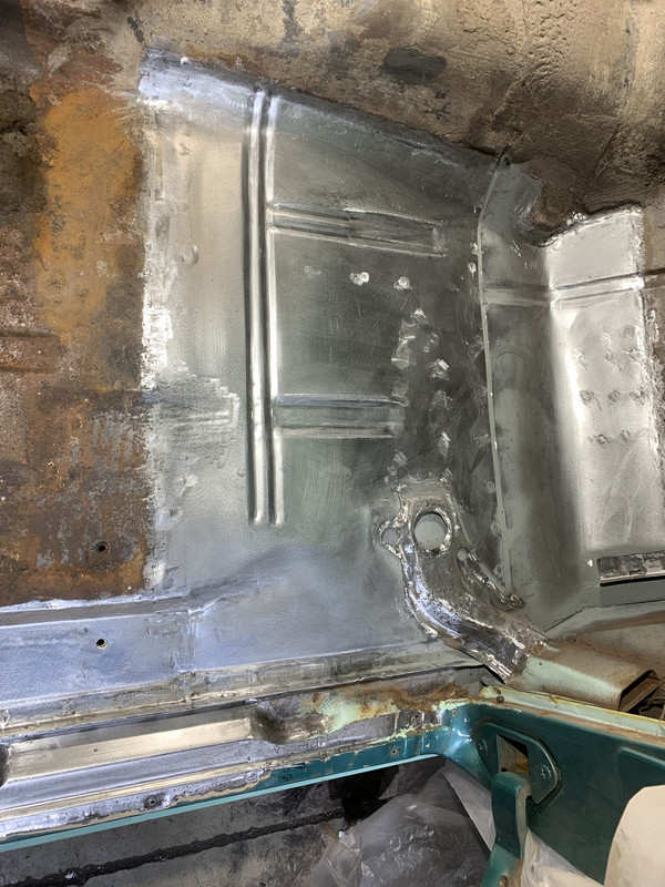

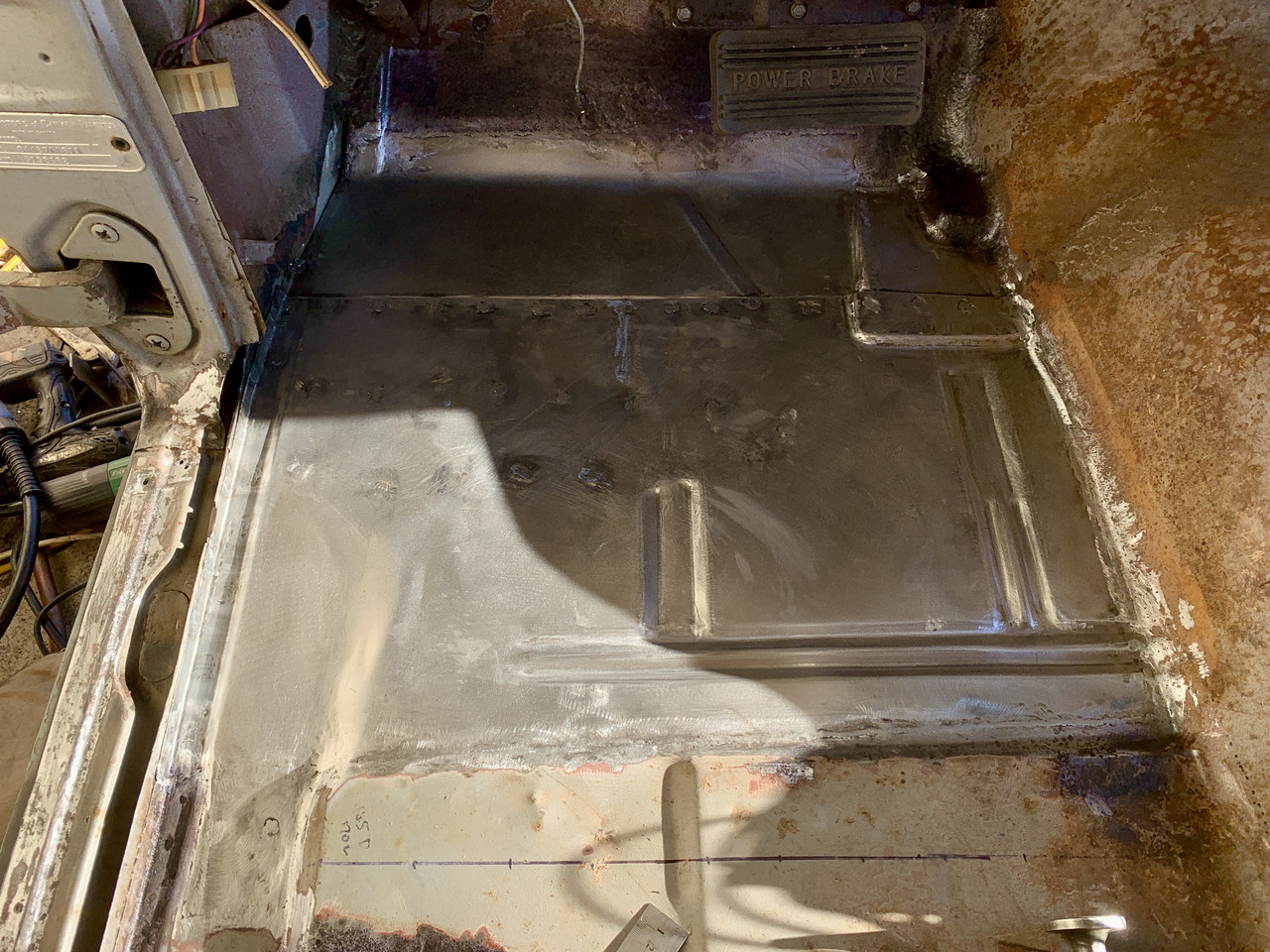

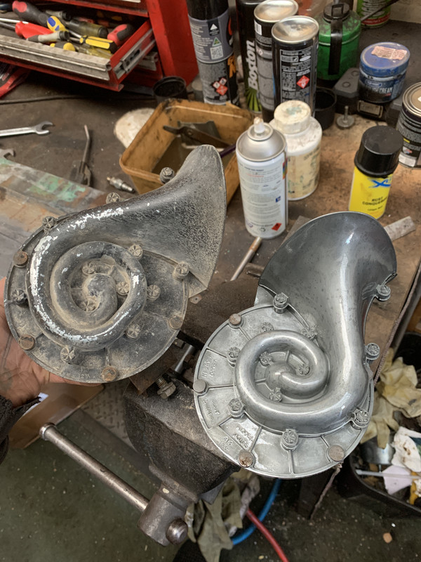

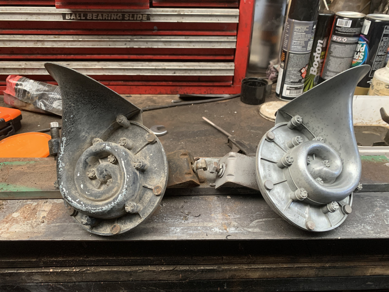

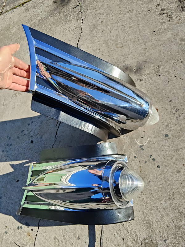

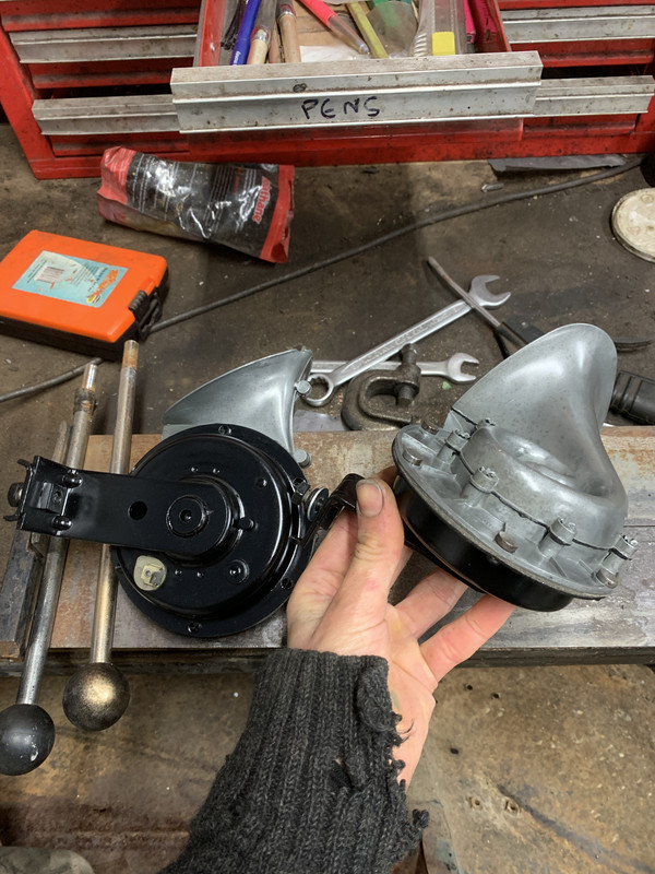

Popular Post Mr.Mk1 Posted July 5 Author Popular Post Posted July 5 Horns came up mint! I went and grabbed that 56/7 Chevy wheel, it’s going to work These floor support/chassis mounts had been in the molasses for a month then blasted them. Theres one welded in and surfaces all prepped for plug welding Now once those tubes warm up in the Sonomatic radiola, the passenger has a dance floor for some boot scootin’! The drivers side coming along.. I got the toe board partially welded in when the great weather, became un-great So inside I went, and made a start on the exhaust 27 Quote

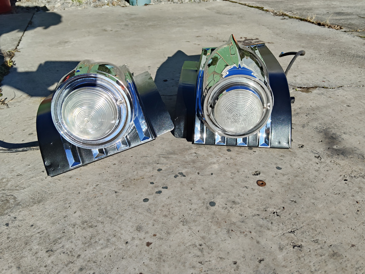

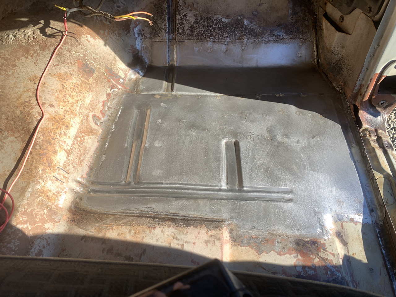

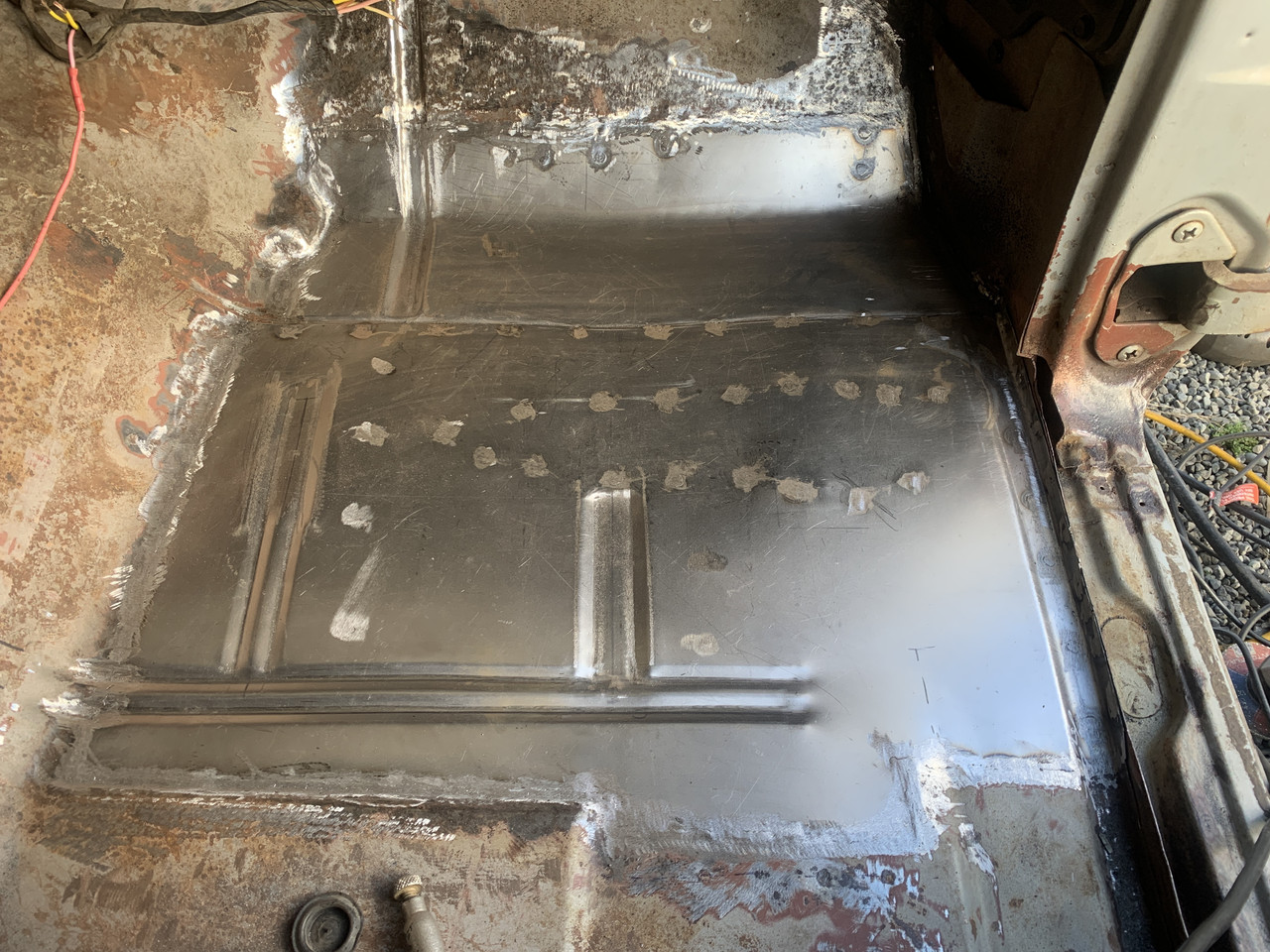

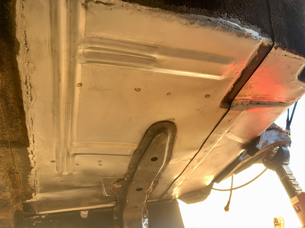

Popular Post Mr.Mk1 Posted July 12 Author Popular Post Posted July 12 Milestone!! Floor is finished and sanded up, few coats of etch-in-a-can to seal. I also stripped the headlights out of guards and swapped the dip lamps ready for compliance, put the buckets in the molasses (which I agitated and moved into the sun as shes slowed progress in the cold and shade) Tapped the front pot-metal boomerang chrome trims to accept a matched set of galv metric flanged bolts I had laid up. It’s cold. 29 Quote

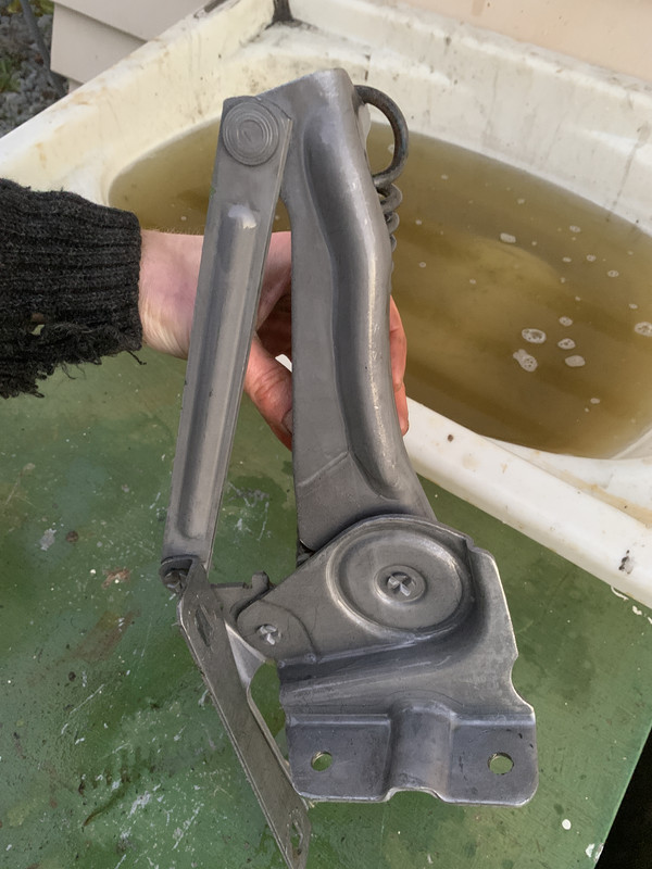

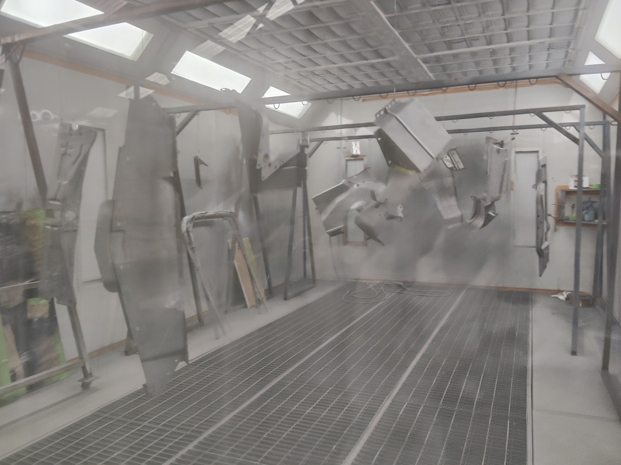

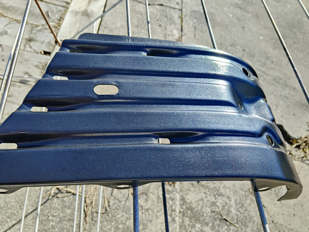

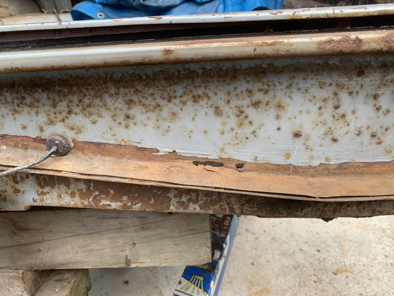

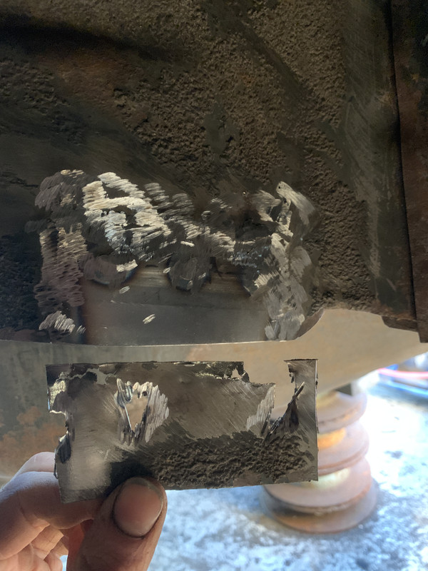

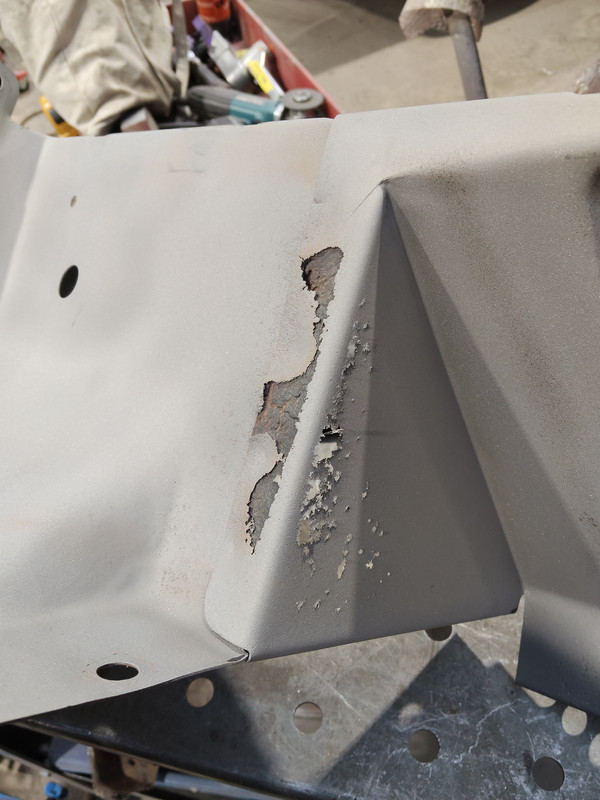

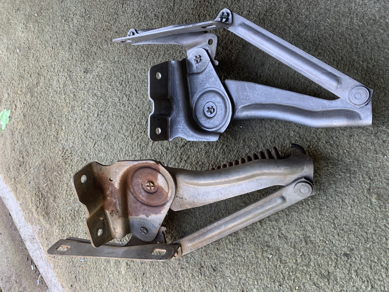

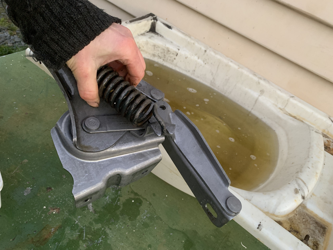

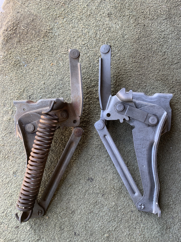

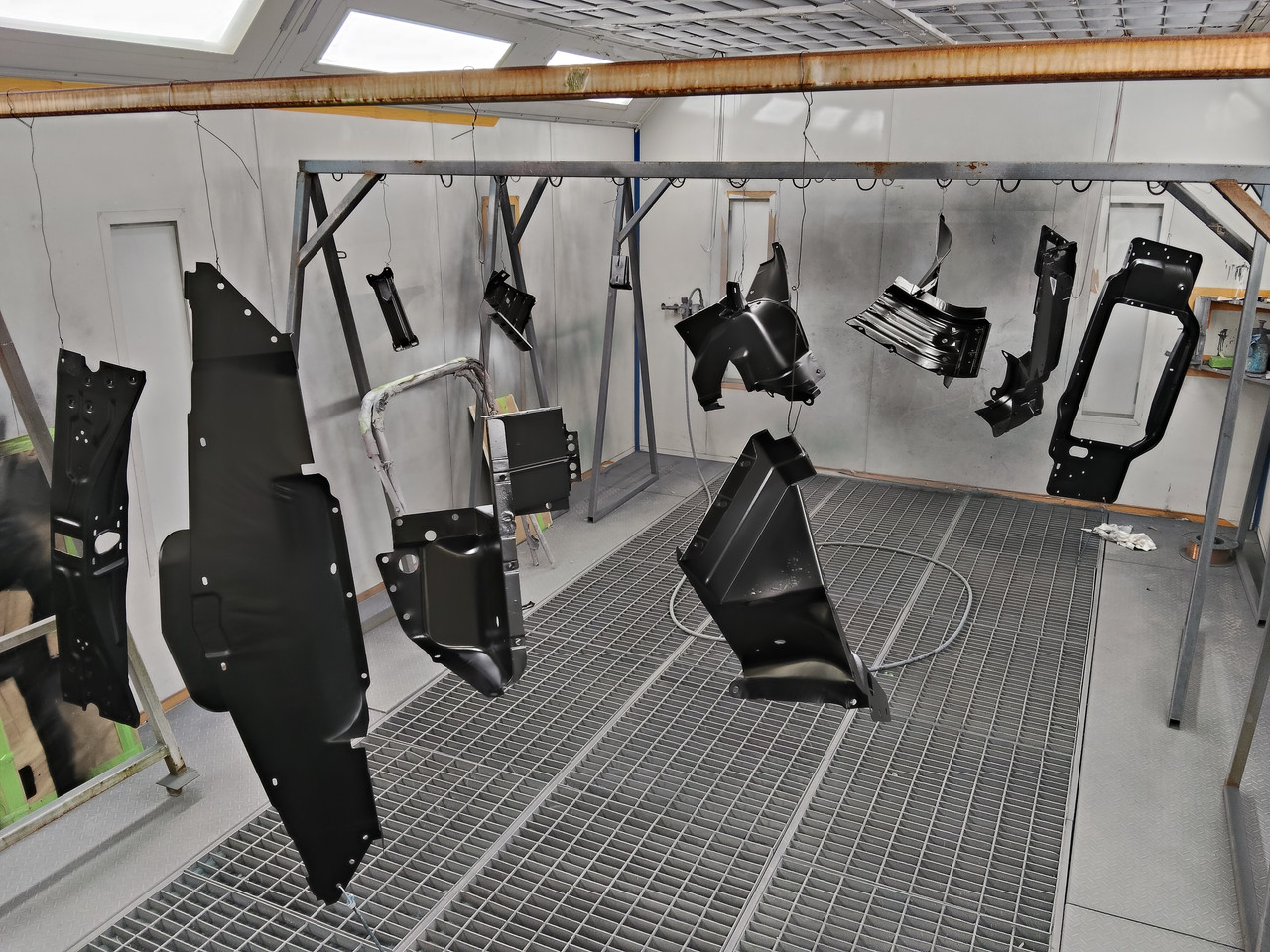

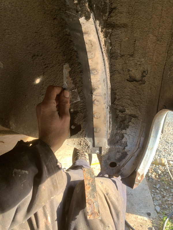

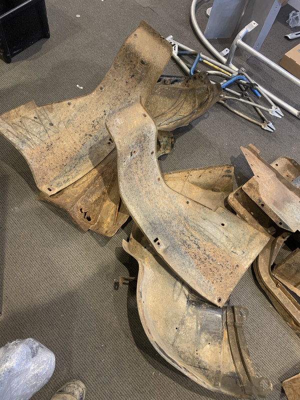

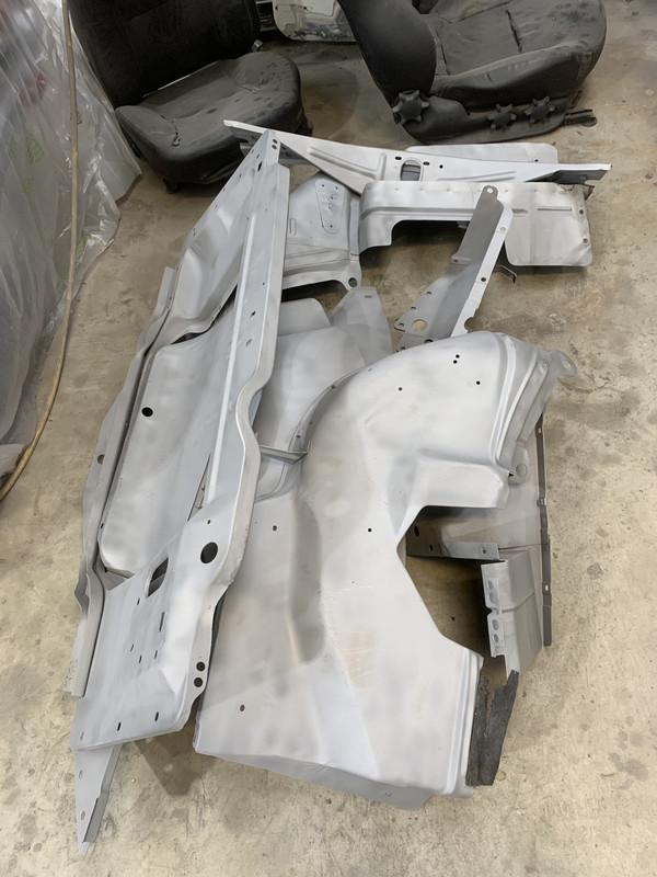

Popular Post Mr.Mk1 Posted August 2 Author Popular Post Posted August 2 Life got in the way last weekend, my hands gamm'd out so I didn't get back to rust work this week. Weekend before I smashed out the remaining bits on the RHRR wheel tub and ran the wire wheel over the underside to transfer the loose crud off and into my eyes, and got to chopping some more out of the RHRR but it quickly grew and I needed to make a piece at work..piece relatively shaped but haven't got back to this yet. However, progress was made elsewhere! Id fired up a quick rust bath as user Westy had suggested, citric acid, baking soda and dishwashig liquid...It works great, try it ! Just DONT put spring steel in there..broke a goddam hinge spring! I guess it's a bonus it didn't let go while I was handling it or while in use and ding a panel right? Also rooted all the square tensile washers on front end bolts. And the fkn trim clips I was trying to save are soft Soaked and blasted the front indicator backing plates, dropped off and picked up sandblasting of front end panels etc so then the rush was on to get them in the booth and Epoxy them. I had just enough satin black left over from Coronet so flicked the rad support, hood latch plate and catch so they are ready to roll. There are some repairs required before I can topcoat the rest but they are sealed and safe now..drivers inner guard is the worst but I have to hack it up for a battery tray mod anyway..nobody wants to sell me the quirky long skinny factory style battery. Bit like a tractor, but not. Front indicators assembled, wanted more bling so sprayed with Tamiya black metallic and cleared. Looks more hectic on camera than life. Will match it on the rear panel but that's about all the black it has from memory. Should have paid attention to how little was actually seen and got them nicer there but maybe in a next life I'll learn, fine for now! 23 Quote

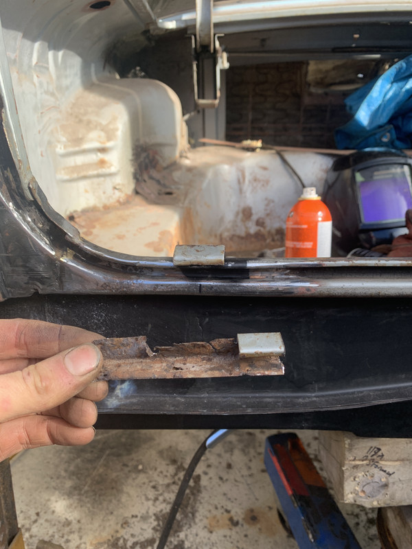

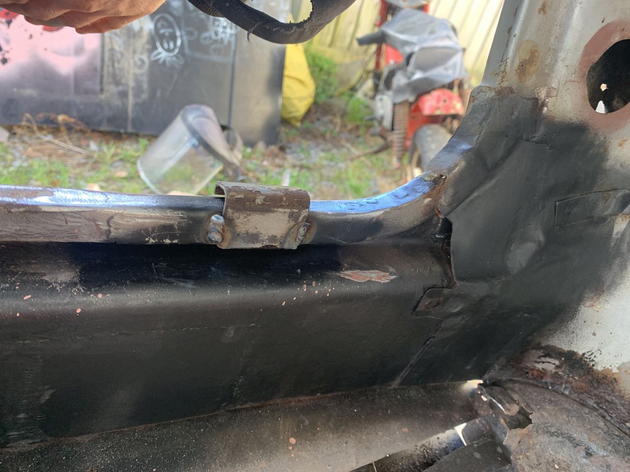

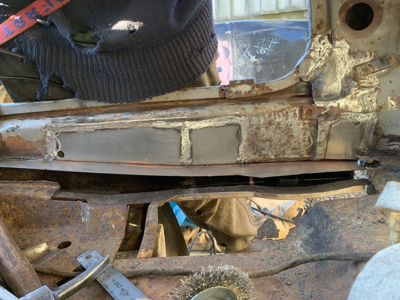

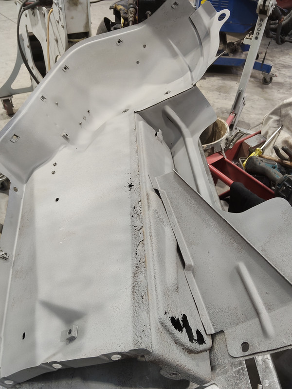

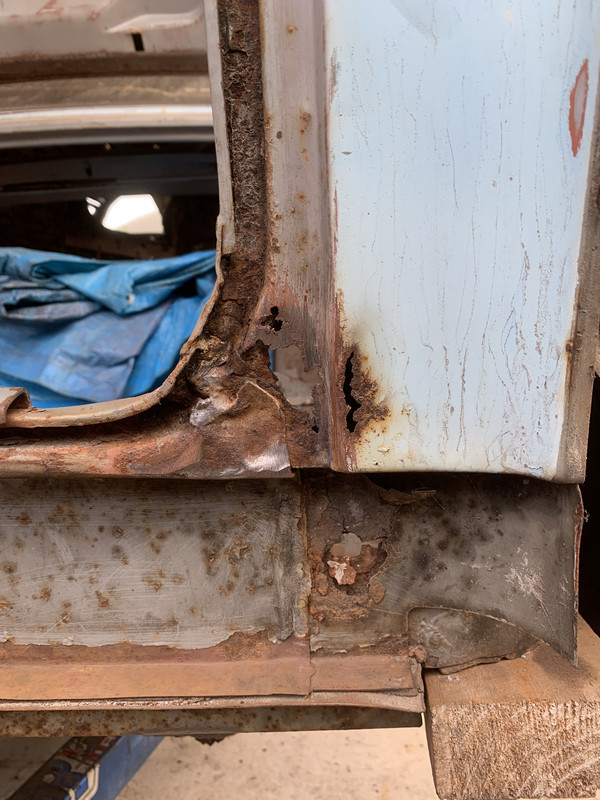

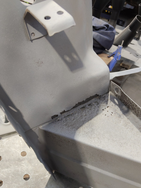

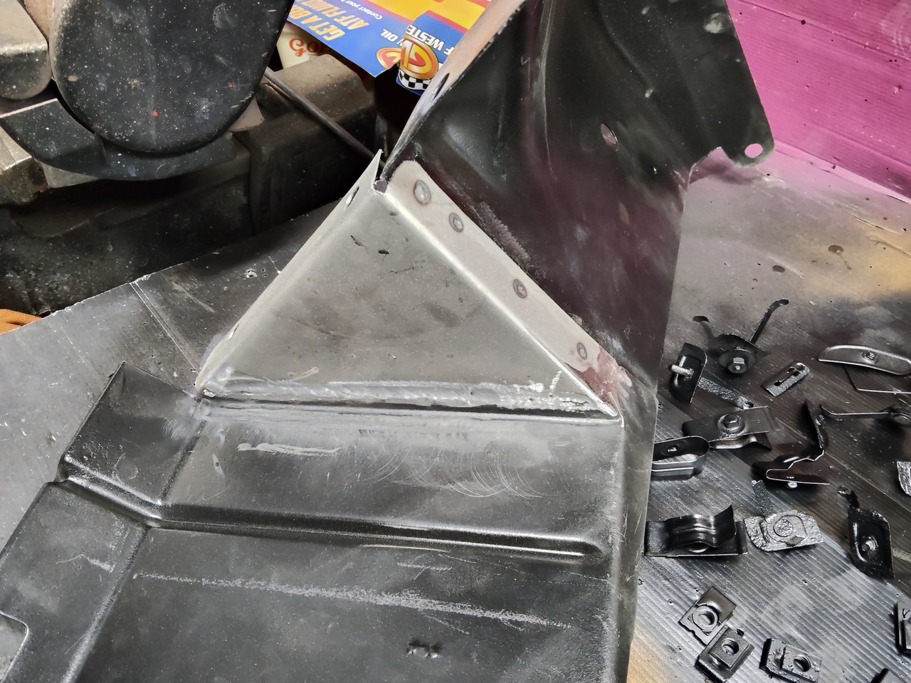

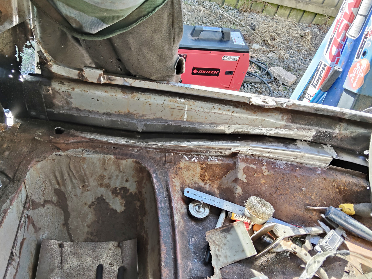

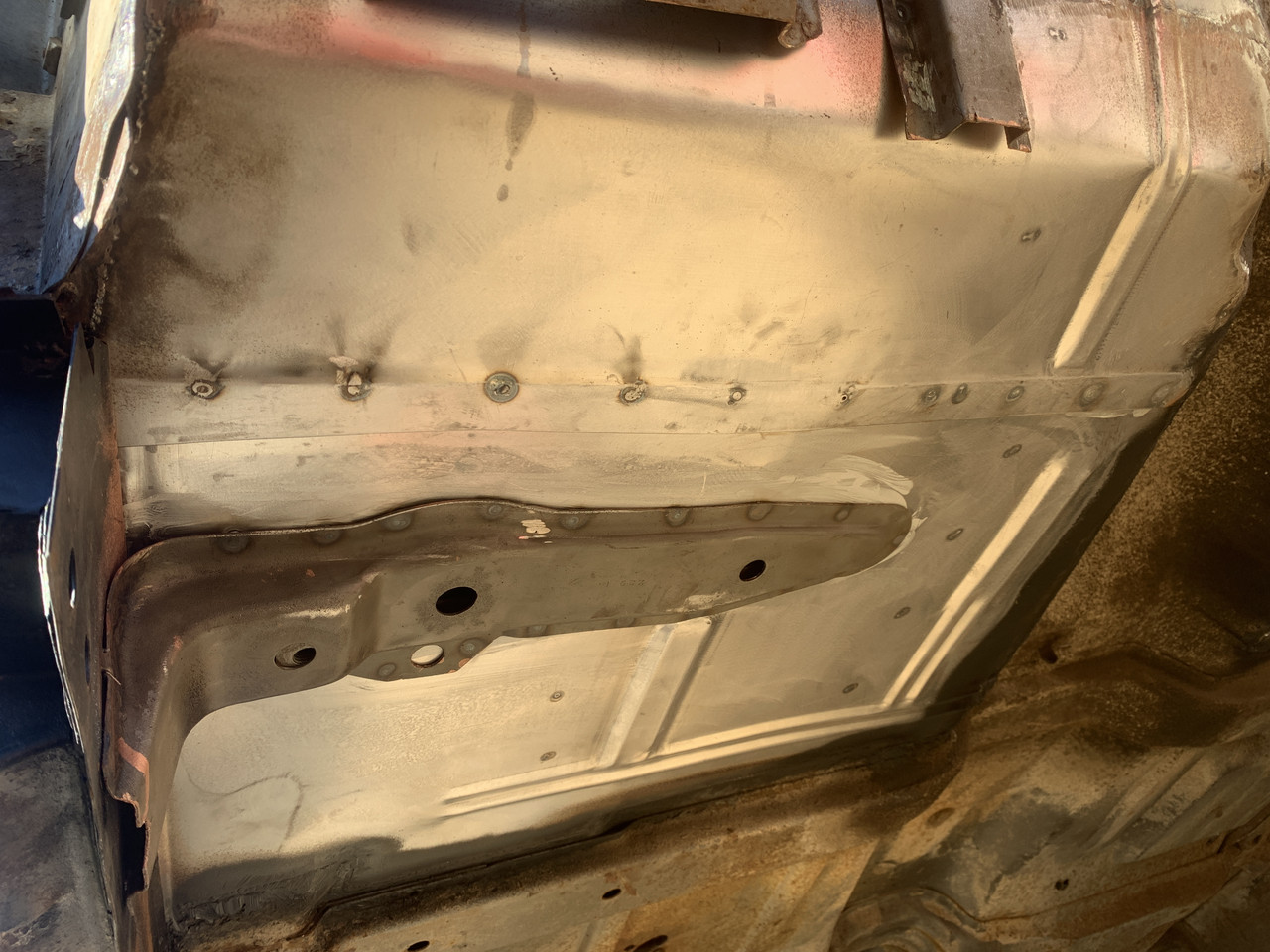

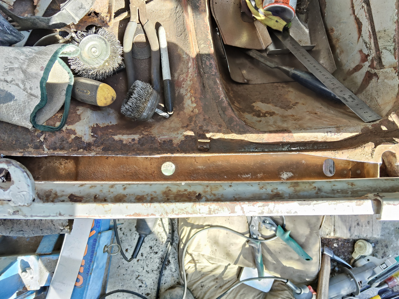

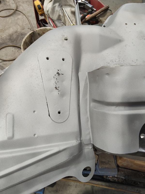

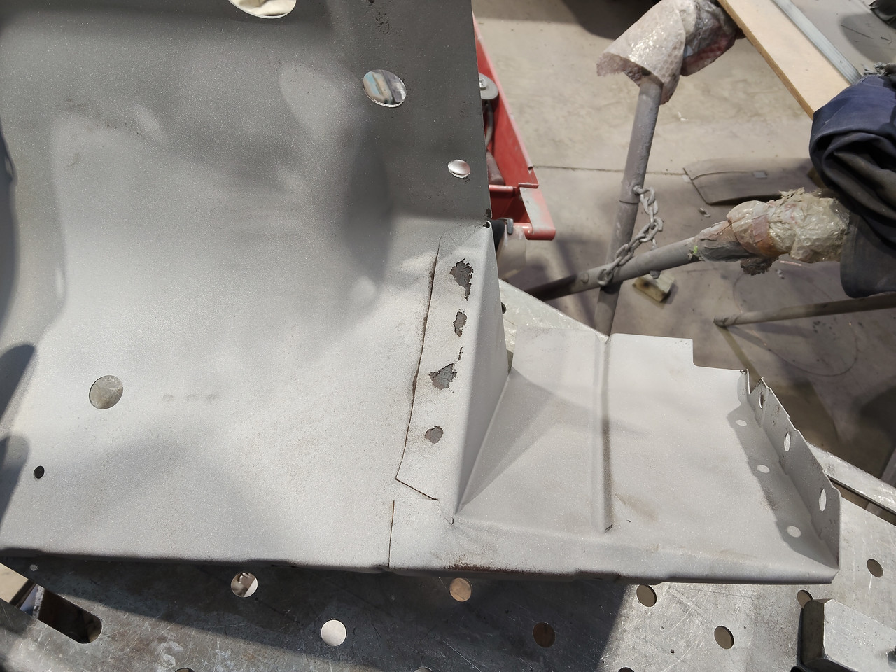

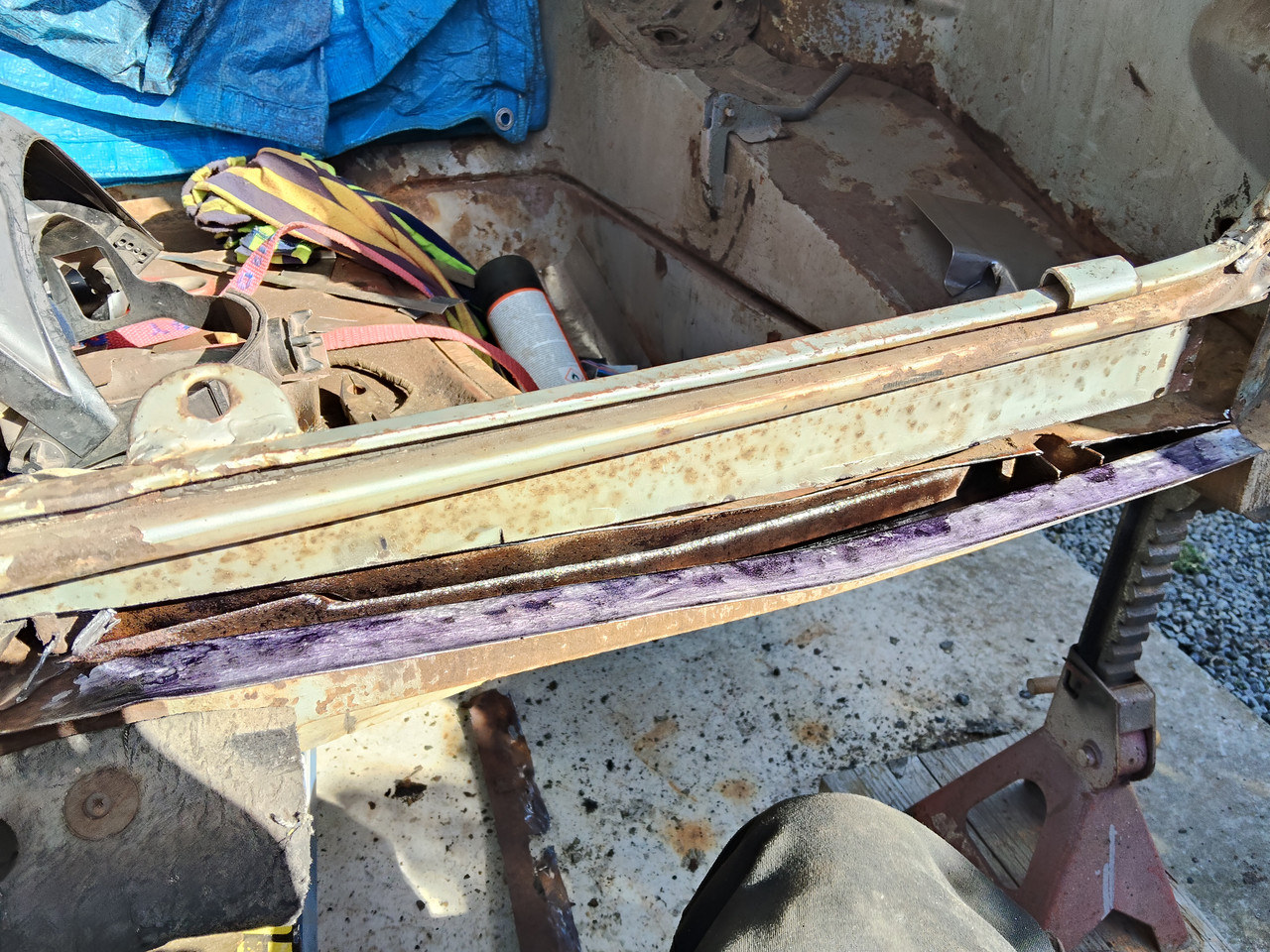

Popular Post Mr.Mk1 Posted September 2 Author Popular Post Posted September 2 The hands have come right mostly, have managed a few more days on the rig but definitely on the go slow. Was working day on day off and it was killing me having all this to do, days off with sunshine and having to rest instead! I've ended up replacing the whole width of the trunk floor sandwiched between the rail and the rear panel..which is practically new the whole way across too. Whipped the trunk lock latch off to get in behind it and that's soaking to knock the surface rust off the back side. Basically finished in the rear now, the passengers side came up better than the drivers so I'll have another crack at that side..at least it's not rusty steel I'll be dealing with so should move fast. Still have to buzz up 4 wee holes where rust from the rear wheel tub has made it through and into the second skin, visible from in the boot..small fry shit. That just leaves the actual trunk floor and behind the trim on the rear 1/4s and we've got the body knocked off! Zapped up the blowouts on the splash shields that were blasted and epoxied Dug all the dirt and old bitumen out of the rear 1/4 pockets and vacuumed them along with the cabin, water blasted the underside as well. 27 Quote
