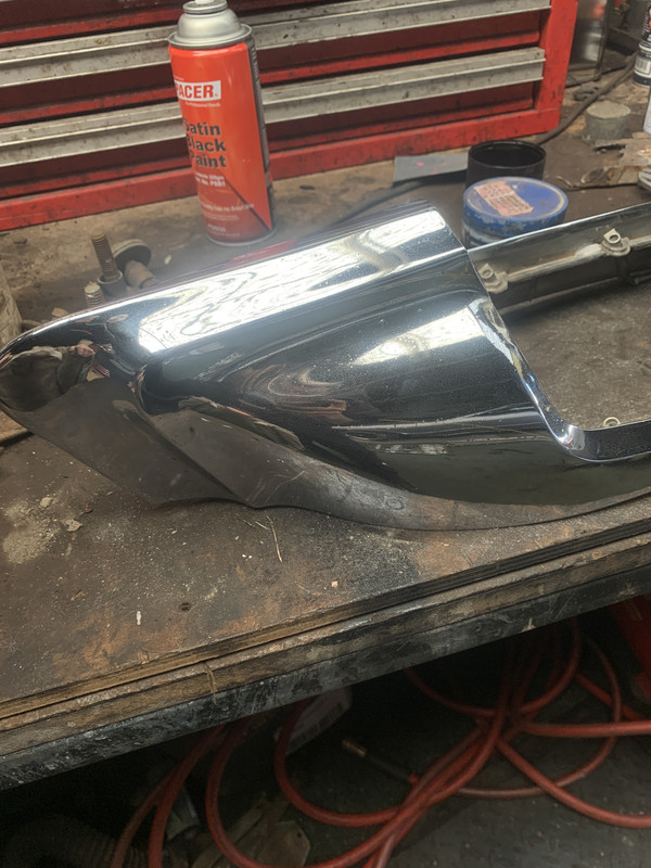

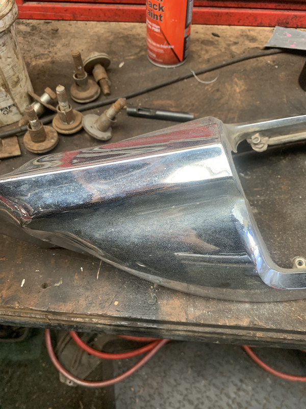

Popular Post Mr.Mk1 Posted December 3, 2025 Author Popular Post Posted December 3, 2025 Been down on power lately, nothing left in the tank after work and needing weekends to rest…it turns out it’s some rheumatoid arthritis sort of gig. So when I actually had some vim, I achieved some low-key stuff. Contacted a dude to measure and machine engine, he’s keen but haven’t had any timeline suggested. Have mostly massaged dents out of the stainless trim and hubcaps, pushed and pulled the car off the lawn with my wee van and got it under cover on concrete so I could have a bit of an investigate,measure and make a shopping list. The rear UJ is wasted, this was known, but comical with the cap off! This is what’s inside a torque tube..really just a driveshaft in there with a bearing one end and a seal the other, both replaced now. The drums are all fantastic and with a little radius to freshen they will go through compliance, thankfully. The rear brakes are lovely, can still read part numbers on the shoes and cylinders move. All got stripped and cleaned up, seals pass the test for now. Front shoes are aged but still alright for some cruise miles.. Brake pics are before shots I’ve chipped off the original underseal along the rear tub seam and uncovered some rust, cant blame it! RH wasn’t too bad. Wire wheeled all nuts/bolts/washers for the engine and some trans ones, sandblasted the crossover pipe/thermostat housing, waterpump and timing cover along with oil filter housing.. no polishing this time, just some clear coat.. Should pop with some greeny-turquoise paint on the steel bits. ^ thick old oil caked inside there! Drained the trans and gave it all a scrub. The pan was full of congealed gross, I hope it’s not too shagged but needs to go to the shop. There was a piece of cast iron in the pan too..Didn’t appear to have broken off anything/no fresh cracked face..perhaps a pawl or keyway that has dislodged! A discount code from the thread and a 6 day turnaround had the first of me ROCKAUTO parts arriving. How good are they! A bunch of wheel bolts, a fan belt on clearance, bearing + seal for torque tube, sway bar bushes, brake hoses and a set of shoes. The ignition barrel and keys were $25, probably cost more to match and cut a key to my original, which has the faceplate pop off regularly. GM run that setup for many years I could, maybe should have ordered engine stuff too but something deep down says hol’ up..just incase this motor is a flop, or a runner shows up, etc. 31 Quote

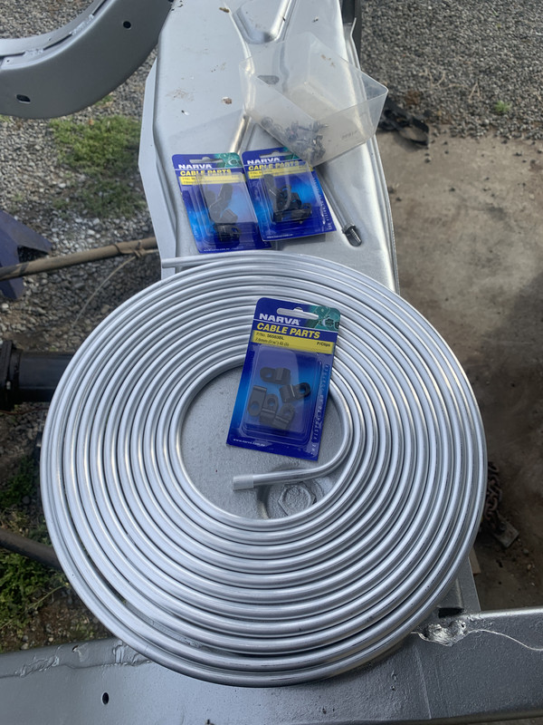

Popular Post Mr.Mk1 Posted Tuesday at 00:12 Author Popular Post Posted Tuesday at 00:12 Did I get a fair bit done this week? Yes. Did I start but not finish WAY more aspects? Oh Yes Got an organiser and sorted nuts bolts screws washers etc as opposed to piled into tins as they were; flash. Fuel line ran, had a shit of a time trying to find the route down the chassis, and the hardware to suit the holes..turns out they had rubber hose front to back with special clips that never made it to me! That won’t do in NZ anyway, ffs Never too late to start saving weight is it? Nutted out the heater and vents, hooked everything up and made a list of the (4!) sizes for the flexi tubes to track down. Found homes for some of the random brackets. Picked petrified sealer, dumdum and some corrosion, then brunox sprayed spots to put a halt to that until paint O’clock. Got up in behind the dash and cowl too. Chopped out the second row body mount braces from the floor to gain access to symmetrical rotten bits on inner sill. Have dumped them in the molasses to chooch. Measured up and Templated the pieces I need to make. A couple of mousepads provided the right thickness for replicating tail lamp and marker light seals. Pulled the tail lamps apart and cleaned, polished etc along with spiffing up the biiig outer housings. New screws This was the exhaust outlet side so was fairly tarnished in comparison. Got into the front markers too, split the whole assembly down to polish shiny bits, scrub lenses, mend some broken hardware, metal backers in molasses tank. Doors got a good scrape and vacuum inside then brunox’d, did any surface rust in jambs too, nothing to hide from repair certifier. Pulled the vent windows apart and polished, fit new rubbers and back together they go. Turns out the iddy biddy strip I was supplied needed bonded to the OE steel backing that has hold-down tangs, so had to snap off the plasticised old rubber first. Went to Rare Spares and pickApart looking for suitable Bailey channel but didn’t score.. vent side has polished beading on each side and the striker side is uber wide as the window has bonded chrome frame running in the channel. Basis might have something or I sack up and get the real, much darer stuff off ROCKAUTO. Also got the main outer weatherstrips fitted. whipped a door handle out to have a key made for them as too, the trunk lock. Motor dropped off to Frontline to see if she’s a contender. Front UJ and output housing dropped to MS Coombes to see if they can make a bushing work and see about sloppy staked joint. Left the spindle with them too incase they can make me a new LHT nut. Had some OK shock bushes in the hoard so stuffed them in the top of the rears. One was torn and dog-eared, looked ratshit. Quite a spot to get to when assembled so. I’ve just spent another weeks wages on more bits from OldBuickParts I simply can’t shake this ‘do it factory’ mindset I’ve got and fuck me, it’s hard on the well-being. Eg, run fuel line front to back with some P clamps like a human, or spend a day searching the internet and online manuals to see how it goes for the absolute fear of squashing it or having to do it again..sandblast and paint some clips that sorta work and find matching nuts and bolts small enough to clear the clip but not pull through the OE holes.. only to simply pop rivet them. Shrug Cummon you dysregulated cunt, stop making big jobs any bigger. 18 Quote
