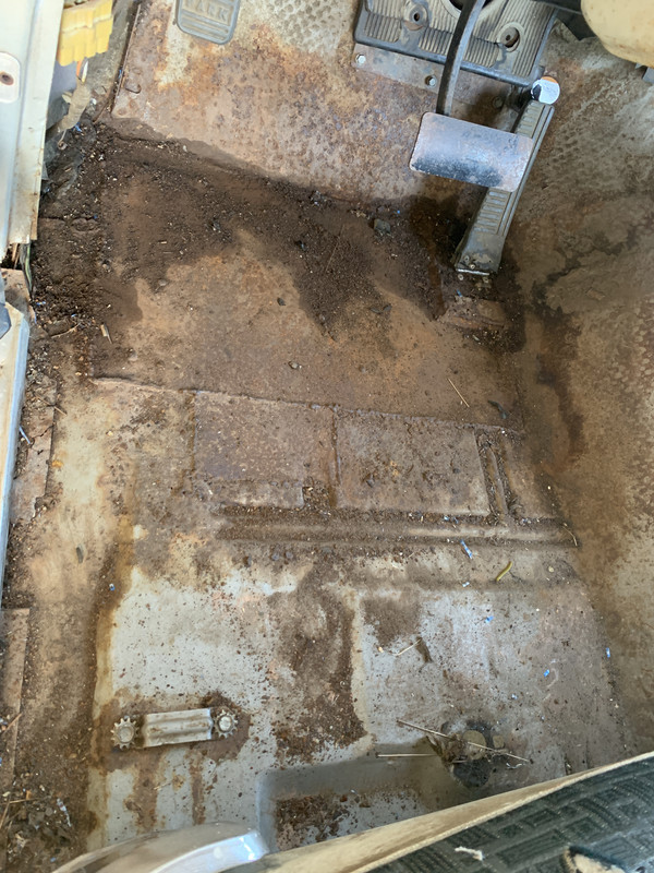

Popular Post Mr.Mk1 Posted October 15, 2025 Popular Post Posted October 15, 2025 I’m back, with another tale of scatterbrain and determination! Stoke the fire and Settle in with a choice beverage. With my whole life situation completely different to a year ago, having no decent old schooler to drive ( ‘82 isn’t my speed)..I felt I’d lost my identity. The late 50’s GM range had really taken my fancy lately. Not so big on the Chev range, but Oldsmobile/Buick/pontiac/Cadillac for sure. They are big, ostentatious and dripping in space-race atomic era mid century modernism. 58 was the year they could legally have twin headlights, which give them a meaner demeanour I reckon. The 58 Buick line had THE MOST polished trim you could get on a factory motorcar..just nudging past the Cadillac. Id been chasing 58-59 mercury and Edsel wagons but not finding much, and after studying the GM’s, the fords didn’t have the same edge I was after. Mopars are sick but stylistically a few years behind.. I needed a 195* this time. Marketplace scrolling start of June found me this 58 Buick special in Rotorua. Shit pictures, vague description. Its was 8k. Not looking too bad, don’t really want another project. Saved. I toyed with the idea of a 64 wildcat coupe that was local, complete and running. Needs some rust and compliance. Easy. Not the end goal, but something old and cool to cruise with a [for sale] sign on it. $13k and getting cheaper. But I couldn’t get past that 58. I did a deep dive and I couldn’t not have one now. Shame nobody had one for sale. One bloke had a Century but his neighbour had first dibs and ended up with it. However, he said he may know where a diff was. Start of august I Started asking questions about the marketplace 58, met with short unhelpful answers via the wife. Do you have any more pictures? Are car specific items Complete? Hows the chrome? … We’ll get back to you in a week or two. No rear seat, driveline. Best to get a container. Container hire and shipping $4k. And likely to turn up looking like a mixing bowl. Nah. End of august, how are you going with those photos? … Whole time I’m silently obsessing, looking for parts and generally in a frenzy with no decent info. Then I was searching random related things on trademe and found it actually listed on there, 6k and auction ending in a couple of days! No bids, one extra photo though! From the q&a section I found out the wheels were actually gone, gone too..bugger. More should I,shouldn’t I. Max Anxiety etc. With no bids the Auction ends, I’m thinking it will be reposted, no worries. Can always message the marketplace chat and sort something later if not. But Hot damn, now my shipping budget has squared up. I ring him and eke out more info, cracked screen…Totally stripped further than original photos. “Hire a container”. Ding. The seller has offered fixed price @ 5k’ A few days until offer expires and I’m searching the world for a screen now because that could be a deal-breaker for compliance. Found one, about $1500 landed. Looking like I’ll be running a small block chev and a 10 bolt as the Buick stuff is rare. September 1st, paid in full. Ok so I’ve got a few quotes from Wise Move.. I’ll fly up, drag it out and assemble it, fly home and someone will transport back to chch. I’ll have a wee tiki tour while there. The cars in a container on axle stands in a storage facility. The parts are in a house bus project at a transport yard other side of the lake. That’s fine I’ll rent a van and there’s a few towies in town. The big pisser is these cars were about the last GM to have a torque tube..the trans bolts to a tube containing a driveshaft that bolts to the quirky big diff pinion. Panhard bar and a couple of radius rods running forward to a mount on the torque tube itself. I’ll never find one complete and it’s common in US for people to do open driveshaft conversion with a Pontiac diff. I’m aiming for easy compliance process so want original gear or period correct..think 283/powerglide/10 bolt and make it look like factory? Same as a chev would have had. NZ got a fair few 58 checks. Message a few sellers, form some plans but still a bit early for this level of organisation. so I’m thinking marketplace again, change it to Rotorua with a 400km radius: get an old diff and strop it to chassis, buy some wheels which will be different front to whatever the back end would be. Doesn’t matter just needs to roll for shipping. Or shoot to repco for hubs and stubs and an engineer for some pipe.. make a trailer beam, some workshop will let me weld that quickly. I haven’t seen under a stripped 58 and don’t really know what to expect so won’t be able to sort much until Saturday morning. Maybe a couple of sack barrows from Bunnings to get it out of container and onto tow truck? Marketplace again fills me with hope - a lady selling parts from a 56 4 door special. She’s got a whole driveline,springs, radiator, refreshed 322 and a Dynaflow trans..it’s only 8 hours driving to get to levin & back but it will solve some problems. Much research revealed that it’s a pretty different setup. Have to run a smaller motor as trans won’t fit the 58’s 364, unsure if the tube will be too long or too short. Motor is 5k which isn’t bad but how will I get it in the van and out + into the chassis at the other end. Let me know when you are ready and I’ll book flights etc and come straight up: 2nd october “can do Saturday 11th” Turns out he’s actually crook so this wasn’t a priority despite being all I could think about. Woooo! Fights, accomodation, rental van, airport parking all booked in quick succession. Good ole oldschool, post asking about Rotorua residents gets me in touch with Gaz who’s got a spot in his shed just out of town. I met him once at OS nats, shitfaced. Fucking legend! This was a huge help, as I was picturing working on gravel outside in a yard or driveway I hadn’t yet found. A few messages with Gaz, They are out of town that weekend lol… but the shed will be perfect, there’s a couple of jacks and a set of wheel dollies under the cortina. YES! Teed up a towie, all is good I pour a bag of bikkies into several bowls for the cat, pack some tools, head torch, fruitcake + a gedder dun attitude and fly up Friday arvo. In the rental, straight out to grab the Dollie’s. Blown away by the facility and setting! Trying to dial in the towie and he says he’s off to ozzy, might be able to get a fill in. Scroll marketplace again for the millionth time: Nailhead, Buick, chev wheels, HQ mags, diff, 283 v8, 5x5 rims, whitewalls, wire wheels.. (There’s also the lingering thought.. these use wheel bolts, not nut and stud. Some online things say one side is LH thread. If I don’t have any/enough that could mean derailment of any plan! welding a rim on?) Had a bit of a look around, ran around Waiotapu geothermal place an hour from closing time. Wicked! I’m pining the adventure now. The motel is fuckin grimey. Cheapest non-hostel room available but the road noise is horrific, hasn’t been updated or cleaned properly since the 70’s and the water pressure is wack.. booked it partly cause There’s a hot pool on site. Trying to dial in the towie and he says he’s off to ozzy, might be able to get a fill in. Cun+y. Hours pass, hes ghosted me. Rang another place and got the after hours lady, was going to check in with the guy on call. He rang and wasn’t too put off, said he’d ring in the morning. Up early after a shithouse sleep, grab two post off-cuts from the garden of the motel to use as blocks, and meet him and his son at the storage yard. Fuuuu, shes definitely stripped out. Has parts inside it but most are his sons! Some tins with nuts bolts brackets screws etc which look imperial.. He puts some wheels of his on the front, a dolly with wood stacked on under the middle-back of the chassis. It’s moving well! Where’s that tow truck at? Gave that number another call and he reckons he can have a guy there in 20. Sweet as, sort through the parts..Japanese vs not Japanese. Finally get a better look at this thing, it’s actually pretty fucking decent! More rust than disclosed but nothing scary. It’s bloody straight apart from RH sill having an indent and the front of the 1/4 has been pushed in a tad. That wasn’t a surprise, could see something was up in the initial photo. I might have won here! Truck shows up, initial fears allayed ‘just send it bro’. It winches on the pull-out bed fine. Looking janky but secure, I follow him out to gaz’s and nothing falls off. ART IMITATES LIFE/ foreshadowing Disembarking was a cinch on flat ground. Now off to the bus to get the rest of the parts. Oh Lordy Hey fuck these panels are really good! Jesus, there’s a set of hubcaps! Van loaded, his GMC loaded and we’re off back to the shop. Everything but the inner guards is now scattered around the shed, I’m on my own and I’m a pig in shit! Umm nothing is labelled. Nothing is bagged or labelled at all Ugh I tiredly yet excitedly pinballed around all the boxes taking stock and making piles of related items. Started sorting nuts bolts screws washers into groups, then splitting into sets. Right, I’ll start with windows and doors.. that shits pretty generic. About 5 hours of putting together/taking apart/distractions/adjustments and I’ve got glass in and moving. Doors hung and clasping. The rear glass rolls down and then pivots back real stylishly to tuck inside the body..fizzing Shagged and dirty I head back to the motel for a golden shower-spec wash up and some cans. Hot tub? so I investigate and it’s locked.. no relaxation for me. I message that guy who had a 58 century he sold to his neighbour. The diff in question was still available. Has the tube and a trans x-member too. Well…. What are you up to tomorrow, I’ll come and get it? I made some ear plugs out of wet napkin paper and get a better sleep but Up early and on the road, weather sucks so not much sight-seeing happening. I arrive in Napier, meet up. Holy fuck this is a massive diff! Some weird wasp stings my neck but it didn’t come to anything thankfully. Spot 5 wheels in the corner, investigate, turns out they are chev 15” with massive balloons on, but the centre bore fit the diff so a deal was struck. He threw in an old air cleaner he had no use for too, rapt. Back to Rotorua and 4 more hours assembling before retiring again. Hot tub locked again. Dang Trunk lid assembled and on, shes looking like a veee-hickle. How rad that the dealer badge was still amongst the parts! I’ve always wanted one. Thats a place in Manitoba, CANADA! Must have been their summer car cause it’s way more sturdy than it should be! The title is Washington state. Monday morning I shuffle in and sling more parts on, add some wheels..WTF the hubcaps fit hahaha. Much fitting and unfitting and now the dash is complete and all the trims around window secure. Many of the trim clips are rusty/snapped or missing so I can’t hang all the cool shit on for transport unfortunately. The diff is now under the car. Would you believe, it’s the one sold out from under my car originally! The snipped handbrake cable and brake lines confirm. How good! stuff piles getting smaller. Do you even have a factory 5kg Sonomatic valve radio..thought so Peep the details in the side flash! I spend what seems like 2 hours wrestling the torque tube through the frame and lining up internal blind splines 300mm inside the diff pinion. The uni joint is fuckin cooked and the yolk was flopping around so it was pretty shit for a time. There’s a hole for greasing; filled with a bung so I could get my finger in and try guide it some. Started with long bolts and pulled it onto the spline then subbed out the bolts to shorter and repeat until married! Talked some shop and assembled the headlights/buckets/rings/bezels. One side was like brand new, was bizarre. I get a call from the motel saying they are upgrading water system so wont have any hot water for the week and did I want to stay or transfer to another place in town. There’s also a takeaway right across the street so they are getting my money. TRANSFER ME BABY! I showed up filthy and he understood I wasn’t going to come right with a cold shower so I moved into town. Instant stink of durries when I opened the door (smoke free suite), it was tidier but not by much. BUT they had a fucking spa in the room so I filled that bitch and soaked away my pains, I was feeling it after a few days of rolling around in the car and under it. Would have been lush to have a dart in that spa but didn’t want to push my luck. Instead I messaged a guy from a hot rod classified page that had a motor and trans out of a 59 for sale for ages. Listed as stuck piston unknown trans @ $1500 id be a fool to pass that up now I have the rest of the driveline to suit. It’s a rare factory 4 barrel so it can Chong more gas and still be slow, moving 1800kg of Buick. Awesome! Now I could take the van up to Hamilton and collect it but that’s pushing myself a bit far. Plus 300kg of dirty old cast iron making its way through the side of the rental would be frowned upon. Also, hard to get it out of van and into the car at Gaz’. Tuesday morning First thing, I had picked up the inner guards from a bloke in town and grabbed some huge bolts for the bumpers. Went to town hanging the front sheet metal and all the bits and pieces, wrangled the rear bumper up and on, same with front. Put together the marker lights and grill..160 chrome squares influenced by the designer looking at knobs for his new kitchen Reno! Shits heavy. By about 4:30 I’m relatively happy with progress, 6 boxes are empty; flattened for recycling and the last bits condensed into a couple of plastic crates, stainless trims methodically placed around the car so as not to chaff on the journey south. Had a sweep up, back into town..spa time nigga. Going back and forward with the transporter guy the last few days wanting to know the earliest it would be ready and he goes cold. Said I’d have it ready about 11. That’s ok there’s other guys quoting around the same money. I’m peaking out a bit ‘cause the she is up a gravel drive and across a bit of paddock then down to a lush pad but car needs to come out on a bit of an angle. Wednesday dawns and I go grab a 4pack of strops, head to partsworld and see if they have any coil springs I can put under the back..I used those aforementioned fence post offcuts but there’s a stud coming out of the body at the top and a stud on the diff housing..both accept a retaining plate. The wood was harsh and it would probably shake the car apart again on the way home if it didn’t split it into kindling. First thought was a couple of rugby balls? But the stitching terminating on the ends, the studs would probably penetrate and pop. Mr. man at partsworld wasn’t as onboard as me with my ‘i need a pair of random coil springs’ request, said they only did Mazda but he went and had a look and returned with a set, including rubber retainer isolators and one end was progressive/tightly wound just like Buick! Fuck mate I’ll have em. Chur Well they actually turned out to be perfect! Might even run them permanently..time will tell if an airbag makes its way in there instead. Used my strops to hold hood on (old mate can’t find the hinges at the moment), another around the torque tube to the X of chassis, and one pulling rear end back towards the bumper..having no trans mounted means the whole assembly could shimmy forward and tyres chaff the body. Not a biggie but nice to try avoid it. Message transporter at 9:30, good to go. No response. Sat here writing this whole blurb until he messages to say hes been out of service, can’t do it but a towie mate will.. he’s on his way from Hamilton. Ok cool, this is something. Mate rings and explains he hasn’t got the winch trailer but if there was a vehicle that could help tow it up ramps it would be a go. Hmm an added level of fuckery but let’s do it. He arrives around 4, we push it out and turn a bit, he’s backed in on the rise. Planned to tow it up with the van and come alongside the trailer and truck. Van has no tow hooks and the plastic bumper is fair flush with the diff..flag. Go pinch the diesel side-by-side and it’s all go, car rolls beautifully and it stropped down. See ya in a couple of days hopefully! I do regret not taking more before pics but I was on a mission and it will come apart again. Most of the car is virgin and remarkable for age. The rust has entered the chat in the front of inner sills, front floor pans, spare wheel well, rear of trunk. Behind the trim on front of front guards, Plus oddball hole on side of hood and beside tail lamp. Has also sweat a bit behind the side flash’s. Might be deep enough pitting to need a patch. Quite manageable. I do need to concentrate on the besties Hakosuka so will try limit myself on Buick .. but we all know how that initial dose of enthusiasm goes! Discuss: 51 15 Quote

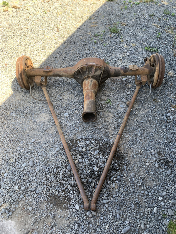

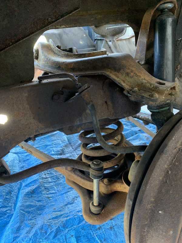

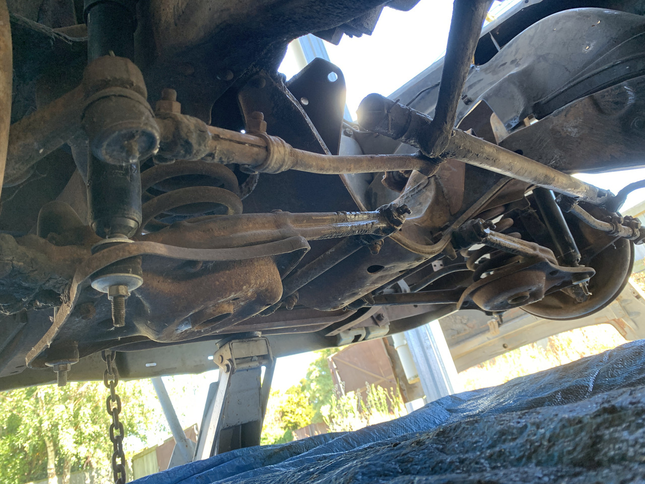

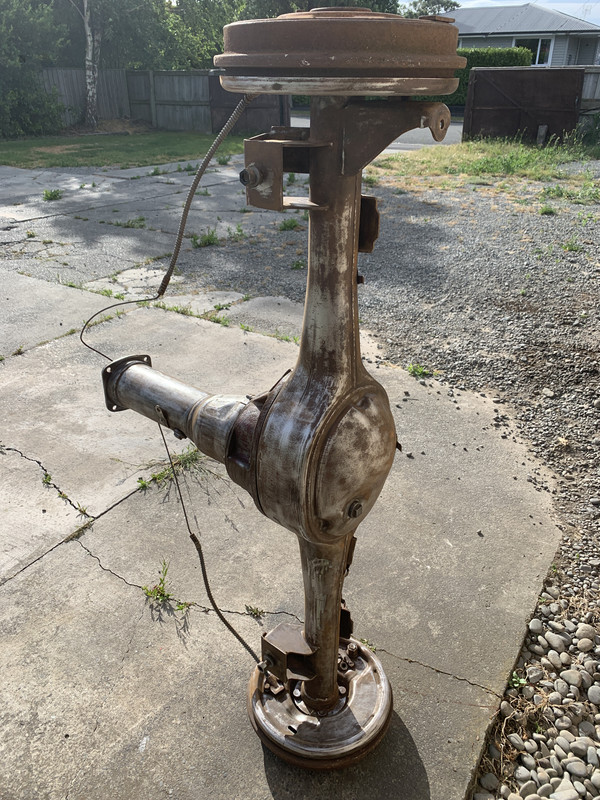

Popular Post Mr.Mk1 Posted December 3, 2025 Author Popular Post Posted December 3, 2025 Been down on power lately, nothing left in the tank after work and needing weekends to rest…it turns out it’s some rheumatoid arthritis sort of gig. So when I actually had some vim, I achieved some low-key stuff. Contacted a dude to measure and machine engine, he’s keen but haven’t had any timeline suggested. Have mostly massaged dents out of the stainless trim and hubcaps, pushed and pulled the car off the lawn with my wee van and got it under cover on concrete so I could have a bit of an investigate,measure and make a shopping list. The rear UJ is wasted, this was known, but comical with the cap off! This is what’s inside a torque tube..really just a driveshaft in there with a bearing one end and a seal the other, both replaced now. The drums are all fantastic and with a little radius to freshen they will go through compliance, thankfully. The rear brakes are lovely, can still read part numbers on the shoes and cylinders move. All got stripped and cleaned up, seals pass the test for now. Front shoes are aged but still alright for some cruise miles.. Brake pics are before shots I’ve chipped off the original underseal along the rear tub seam and uncovered some rust, cant blame it! RH wasn’t too bad. Wire wheeled all nuts/bolts/washers for the engine and some trans ones, sandblasted the crossover pipe/thermostat housing, waterpump and timing cover along with oil filter housing.. no polishing this time, just some clear coat.. Should pop with some greeny-turquoise paint on the steel bits. ^ thick old oil caked inside there! Drained the trans and gave it all a scrub. The pan was full of congealed gross, I hope it’s not too shagged but needs to go to the shop. There was a piece of cast iron in the pan too..Didn’t appear to have broken off anything/no fresh cracked face..perhaps a pawl or keyway that has dislodged! A discount code from the thread and a 6 day turnaround had the first of me ROCKAUTO parts arriving. How good are they! A bunch of wheel bolts, a fan belt on clearance, bearing + seal for torque tube, sway bar bushes, brake hoses and a set of shoes. The ignition barrel and keys were $25, probably cost more to match and cut a key to my original, which has the faceplate pop off regularly. GM run that setup for many years I could, maybe should have ordered engine stuff too but something deep down says hol’ up..just incase this motor is a flop, or a runner shows up, etc. 31 Quote

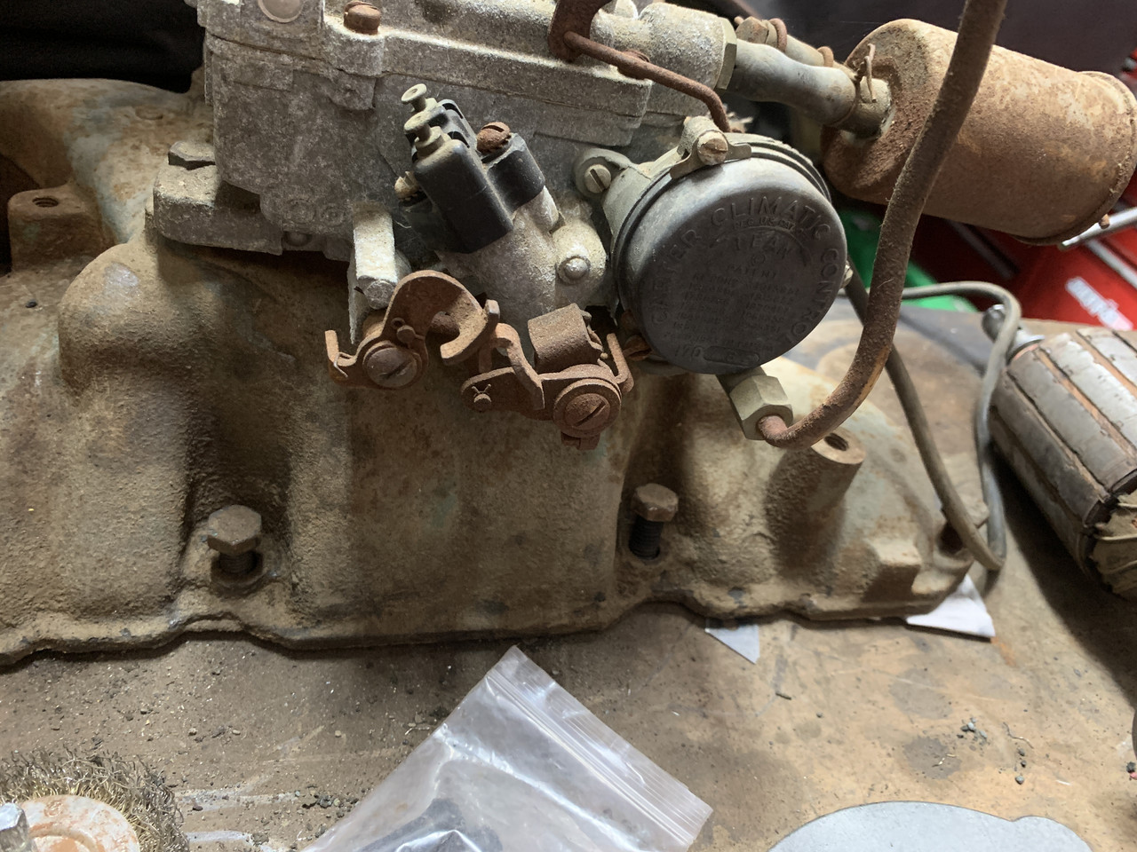

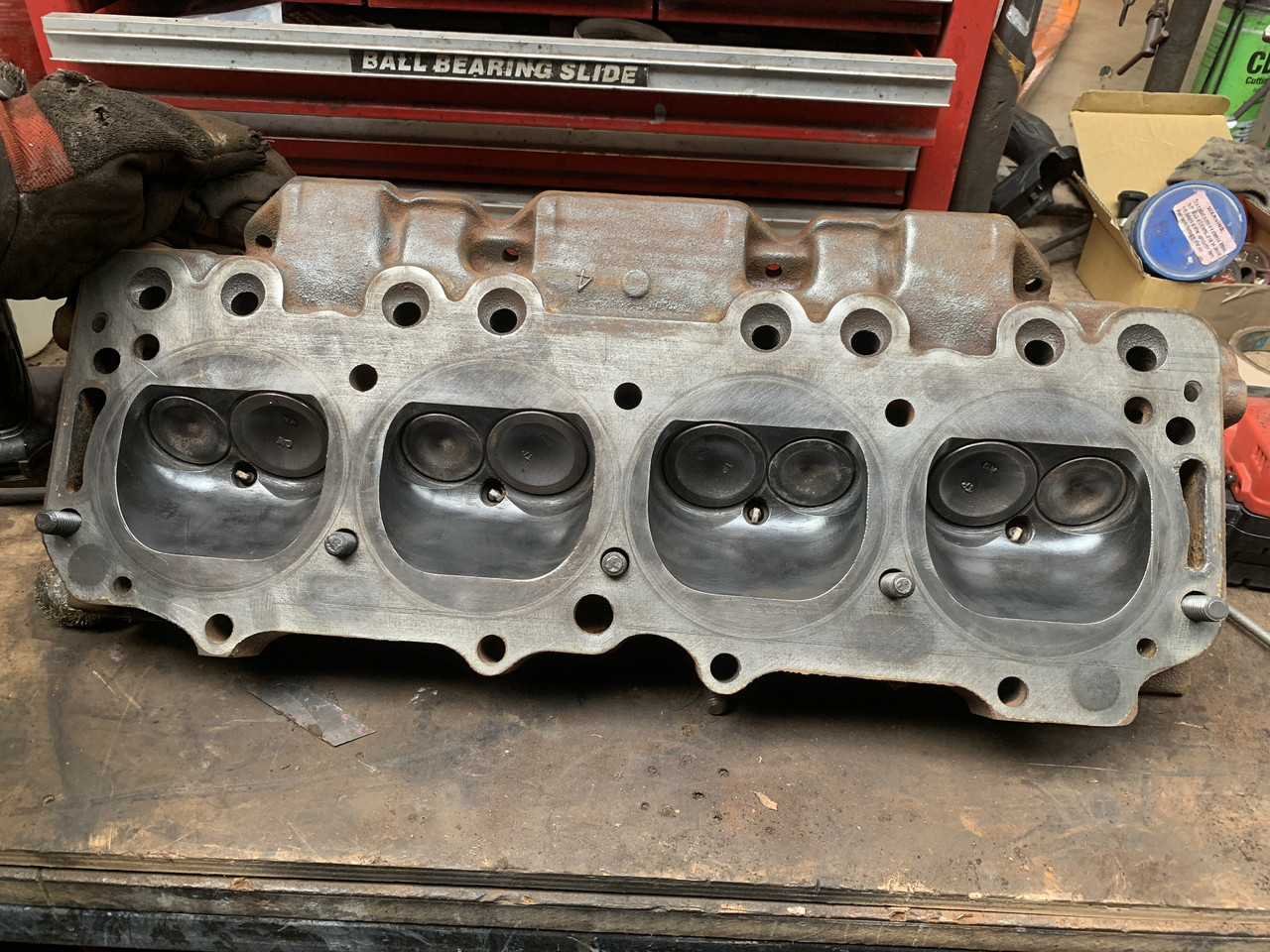

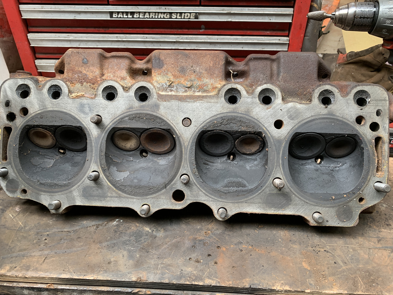

Popular Post Mr.Mk1 Posted December 28, 2025 Author Popular Post Posted December 28, 2025 It would have been the day after placing the rock order that I decided to pull the generator down for a clean, lube and paint. Of course both brush tension springs were broken. Asked a couple of local places to no avail so poked through another rock order! Be rude not to get a couple more things.. some Datsun bits to flesh out the order too. Ripped into the starter after that, someone’s done a solenoid in recent history, so clean lube and paint with high hopes for success. Blasted more stuff, cleaned up the heads with wire wheels and scrapers. Took to ports with a carbide bit and knocked the sharp edges and slag off, water ports were fairly haggard from new. Inlet manifold got some lovin’, removed the casting seams and smoothed it out, with a flapper disking to finish. Soaked some hardware and brackets in Evaporust. Wasn’t an amazing result but certainly helped. Diff, link rods, brackets and as previously alluded to, torque tube were cleaned up, sanded back and blacked. Replicated the brake lines, punched bearing and seal into tube. I spent 2K at Old Buick Parts, eagerly awaiting that shipment! Put the feelers out on FB for some window crank handles knowing the GM stuff was very similar for ages, a bloke Nigel Allen had some, free just cover postage. Well they arrived with no money changing hands, good bastard! The engine bay loom is 70% snipped off ends and plugs. I found a diagram and labelled what’s left to save some time for future me. Carb is a Carter AFB, ran them for ages on different makes so must be an ok piece of gear? They say a big carb is best for a nailhead, intake port velocity more than volume. This one is seized but complete. On a Ritchie Tip I got onto Simple Green for degreasing and cleaning alloy. I read that the HD version is safer for carby soaking so I grabbed some from Bunnings, mixed 1-1 with water and soaked each half, intermittently scrubbing. Came up much better but still some stubborn fluffy bits. Gave them a quick white vinegar soak and washed with hot water. Certainly was some blocked jets and passages, only one jet actually unscrewed but rest blew clear with a Mig wire poke. Old gas turned to resin in one bowl and took some chiselling, powder in the other! Tried to wipe an alloy polish over the housing to make it uniform but wasn’t great, hit with CRC and wiped off, much better but looks average in photo, hopefully soak right in for a few months. Then I snapped the fuckin mixture screw. The HD Simple Green was all good, certainly filthy now so must work. Used an enamel roasting dish, one end against the running bench linisher to get some ultrasonics going! I’ll be trying it again on something not fragile soon. Ive got some Break Away on the shafts to see if we can’t get some butterfly’s opening without bending anything! 28 Quote

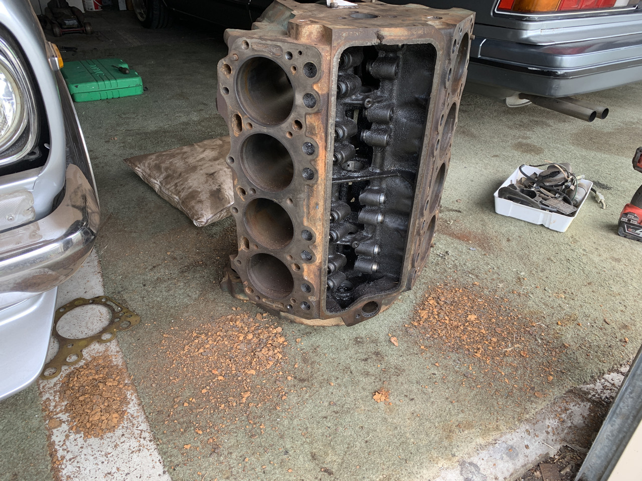

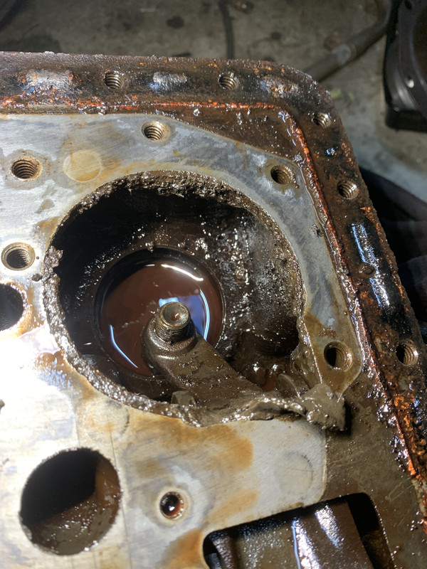

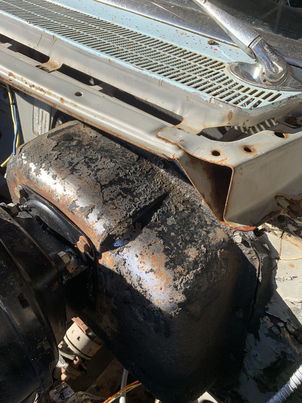

Popular Post Mr.Mk1 Posted January 17 Author Popular Post Posted January 17 Got the block water gallery’s cleaned out, decent pic of my bad bore crater 23 Quote

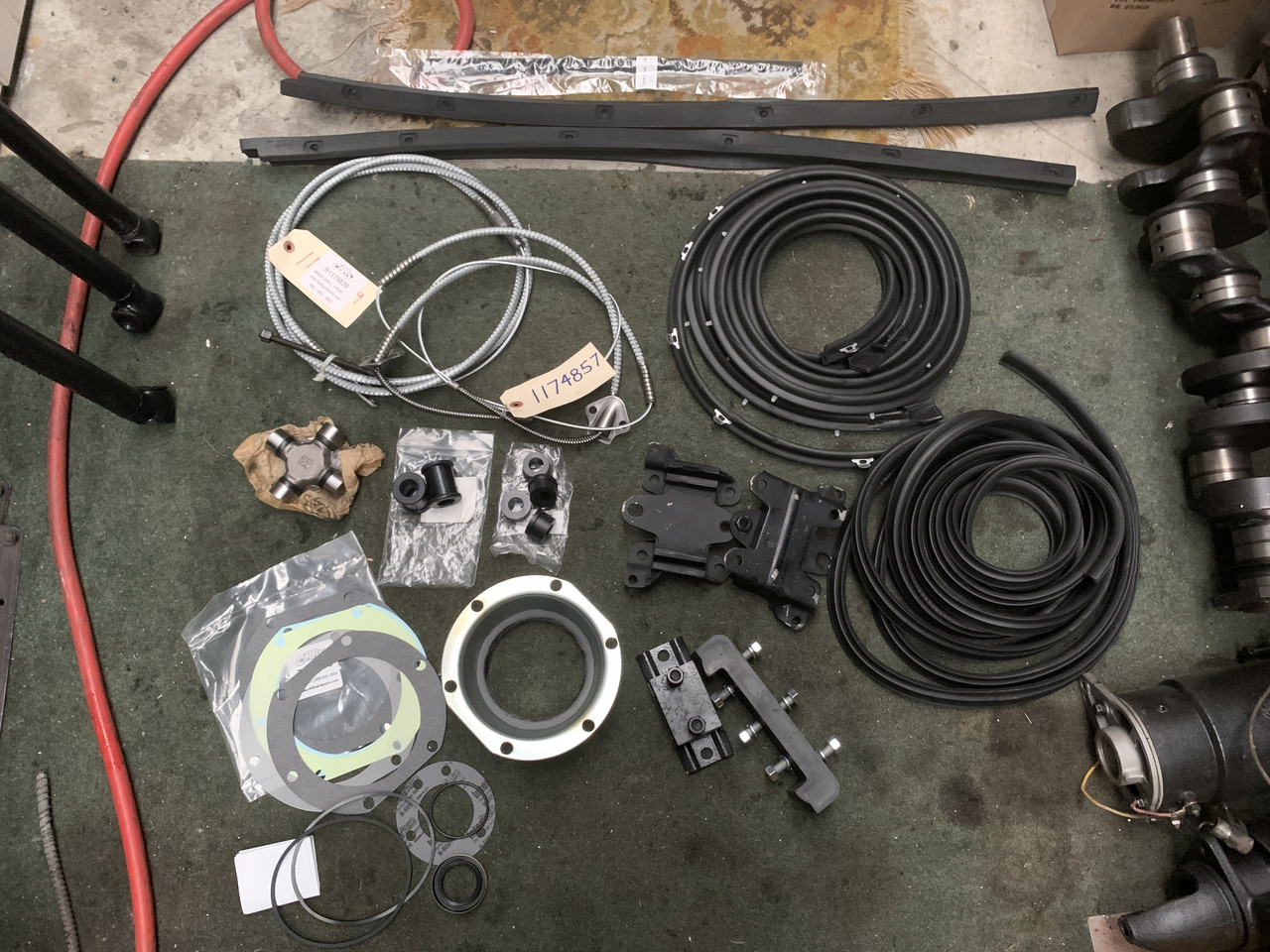

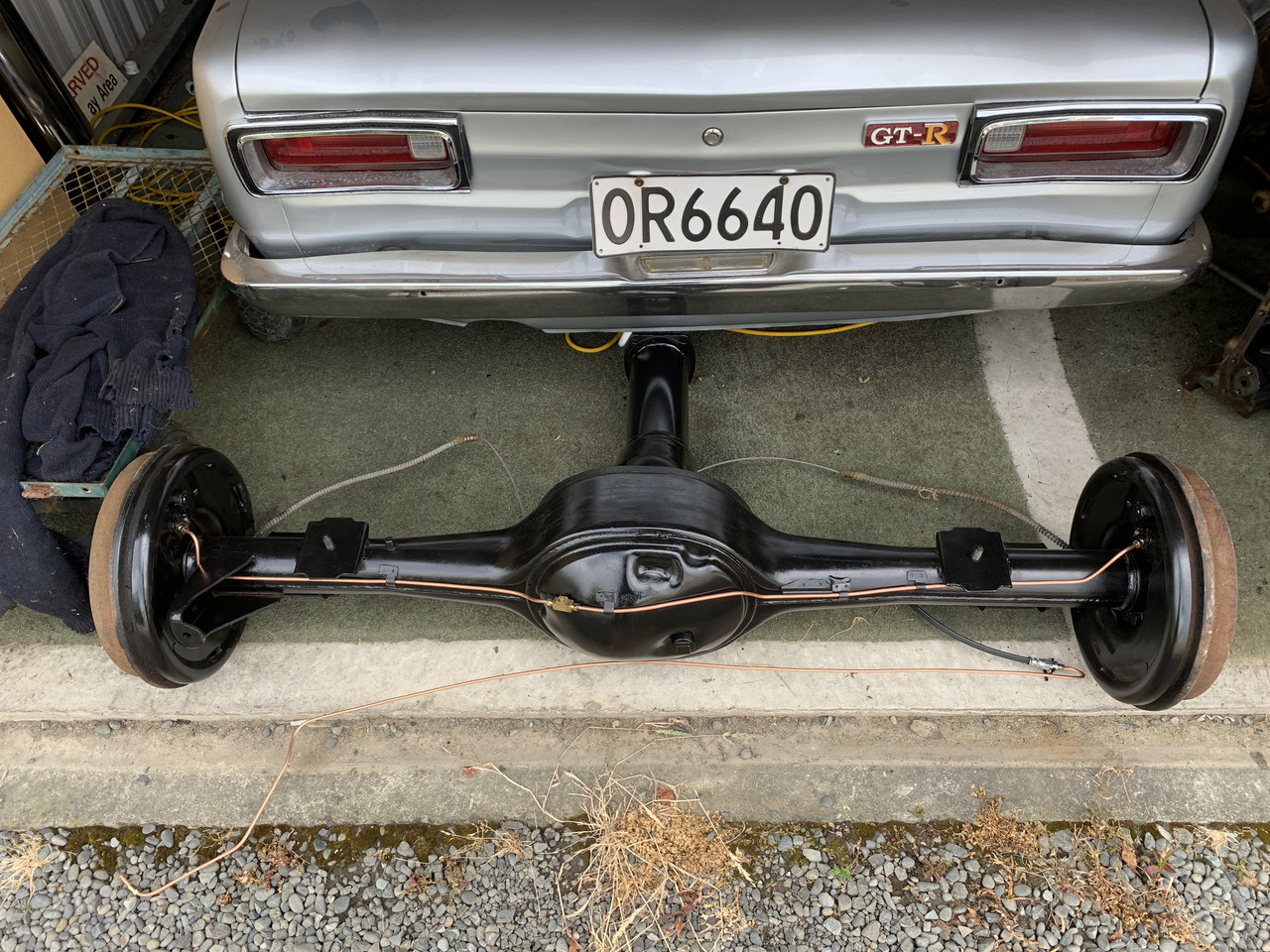

Popular Post Mr.Mk1 Posted February 20 Author Popular Post Posted February 20 More chipping away where possible.. Received the goods from OldBuickParts, so ripped in with the goal of assembling the tube and handbrake setup then bolting the rear end back in. Instantly hamstrung with the incorrect Uni joint. I’ve worked in parts for 11.5 years so I confidently went looking for part numbers and nothing solid appeared. Searched like fuck for dimensions to clarify what did pop up and came away empty handed. All the inside circlip stuff for that era was a different cup size. Hours lost and much frustration. The joint supplied measures perfect but isn’t an inside circlip type. Went to MS Coombes with the intention to have grooves machined into new cups but he managed to find something appropriately sized! Thats mostly back in and sorted now but no pics I’m afraid. -Rubber bushes for leading arms both ends -Rear UJ -Rubber seals running along roof -Rubber seals for 1/4 vents,pillar-to-glass -Torque ball rebuilt kit/seals/cup etc -Engine and tranny mounts -Door seals -Trunk seal -Handbrake cables (the rear was OK but I accidentally left a new one in the cart at checkout..wasn’t cheap!) It’s all quality gear so I’m happy, apart from Customs hitting me with $377 ransom. Will get future suppliers to remove or doctor invoices going forward! The headlight bezels were painted in the past, of course they are chrome underneath so I stripped and polished them up.. glad they weren’t keyed up before paint! Not sure why but I photographed the beat up one, passengers is mint. 28 Quote

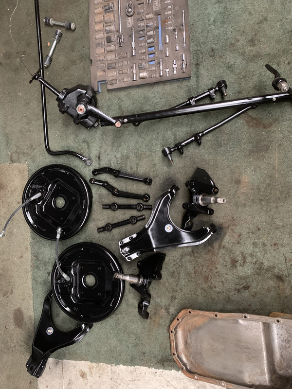

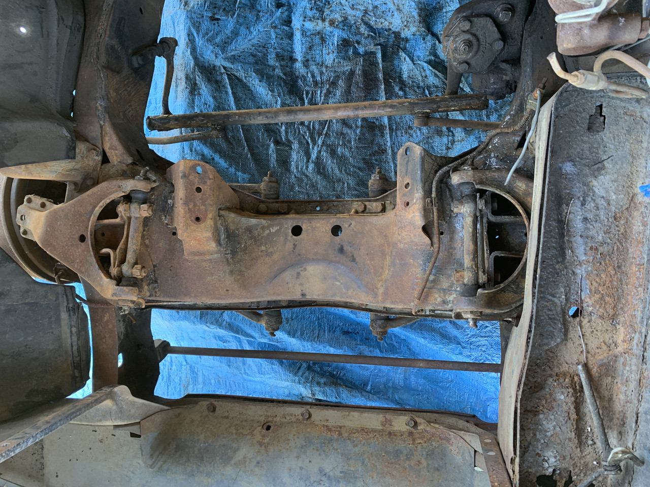

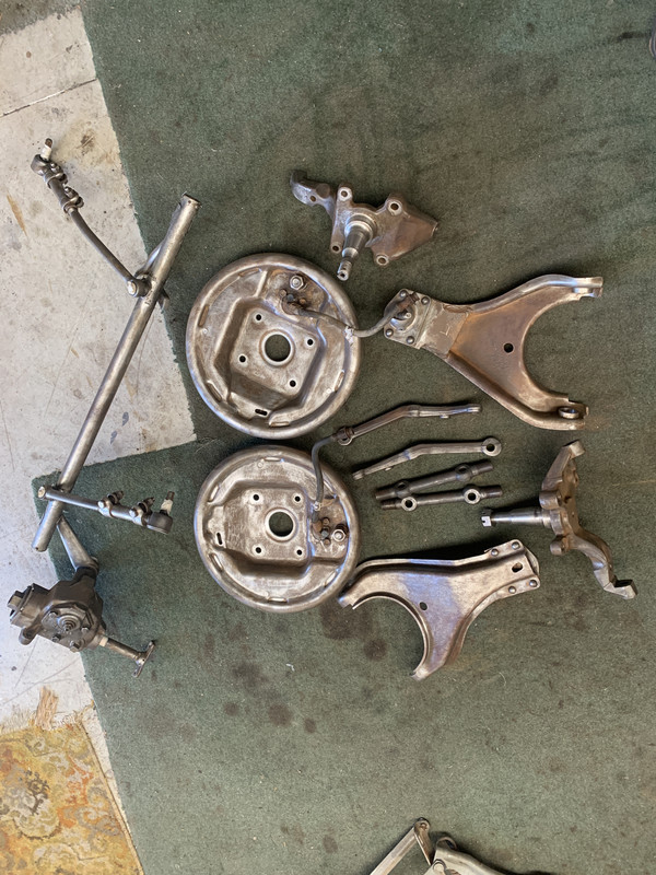

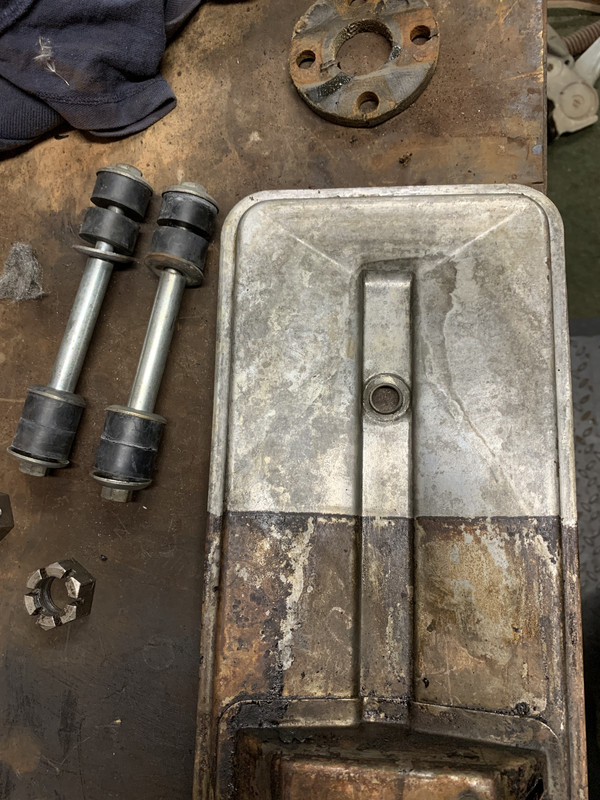

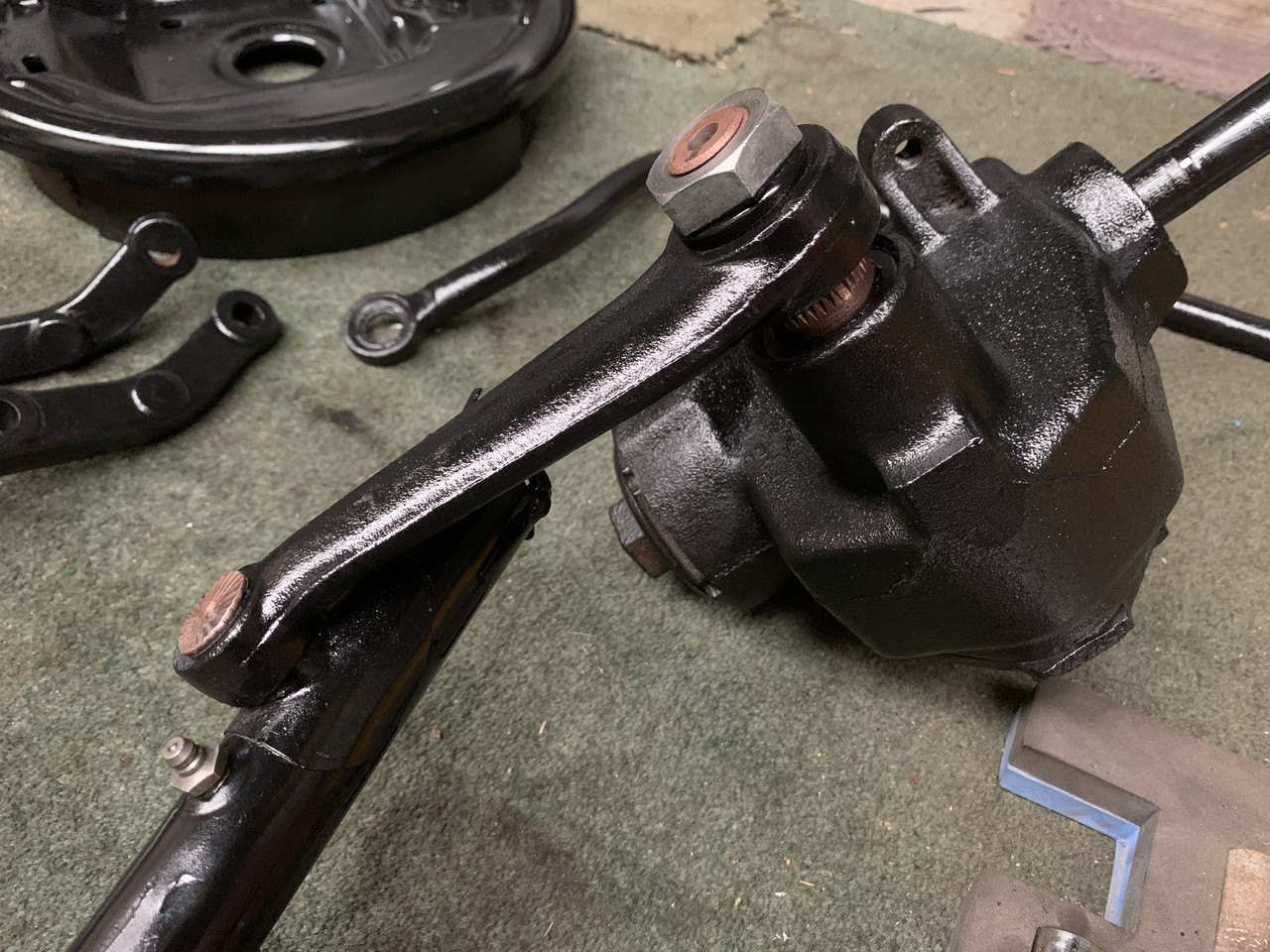

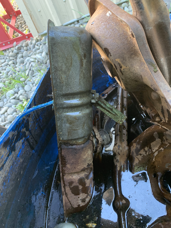

Popular Post Mr.Mk1 Posted March 26 Author Popular Post Posted March 26 Here’s most of that suspension and steering gear wire-wheeled back and, like those petite white internet women, have been blacked..not pictured are the drums I love the copper coated bits so have left them exposed. There’s new bumpstops on upper arms and bushes on the swaybar links. Im astonished by my molasses bath results, this stuff comes out amazing! I had the sump in the tank and its odd shape was corrupting the submergence of some bits so I pulled it out and transferred the rest into a rectangular tub. Sump is 80% there but I’ll whack it back in when the tubs emptied next to get it super lush. I half-made another brake line from the torque tube rubber hose mid-car to the distribution block then promptly got confused and went inside. Factory it’s a single pot so pipe feeds brass block, block has front and rear outlets. But someone along the line has installed a mystery Chevy dual circuit and now I have too many lines. Lines which have been snipped and mangled so I can’t really envision what they had done. Front pot seems to have been block feed, rear one is tee’d to an emergency light switch and the rest goes forward, round and round and has what might be a pipe joiner in line then is snipped off after that. Is the joiner actually a stopper? Stay tuned I guess. Sorry, this photo was a random one I took as booster reference so lines a bit obscured I’ve discovered the hard way that the spindle nuts are handed. It’s a fucked up size of 13/16-16 and reverse thread so that’s me schooled on that. At least it was the fuse and the spindle thread is mint. Have asked a few places but I’d imagine many many people did this and the stocks are exhausted or now worth shitloads. Likely buy a tap have one made. I picked up my balls last night and tore into the trans again to see what that piece was that I found in the pan. Found out. that Bluetooth’d piece is the reverse band anchor and it turns out to be a super common failure when people knock it into reverse accidentally or move when the things still on high idle and shock the trans. You can get the whole cast lever still, but also a wee steel lockout plate that slots in against the broken bit and the valve body. I knew it was gross inside from having pan off, but it’s really gross. Sludge and hard flakes, which unfortunately are a bit magnetic. The actual valvey bit is somehow lovely, thin and red trans fluid but the case is yuck. A rebuild kit from the states with seals, bands and gaskets isnt super dare considering trans rebuild costs. I’m terrified of autos but this thing is super simple, 2 speed and theres plenty of info and vids online so I’m thinking of having a crack myself. It’s not filled with crucial little ball bearings and shit in a big maze like later model stuff.. doesn’t seem to be many traps. I figure I’m no worse off if I tear it down, clean the bejeasus out of it and plod through it? Worst case have a pro do pressure test and adjust it afterwards? Onwards 24 1 Quote

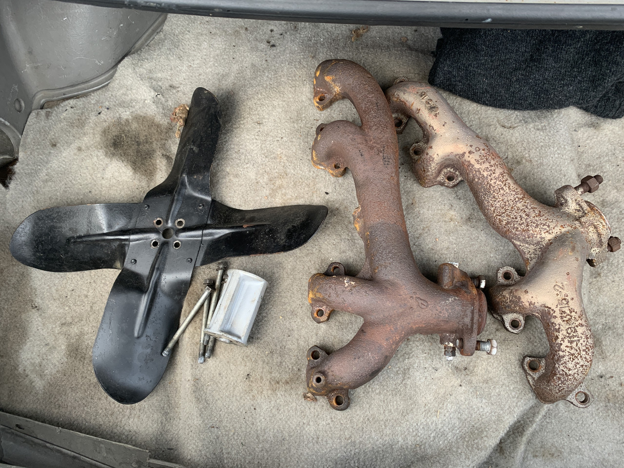

Popular Post Mr.Mk1 Posted March 31 Author Popular Post Posted March 31 A local fella on a Buick facebook page mentioned he motor-swapped his rad ‘61 Electra wagon and had spares, including manifolds he’d imported at great expense..These things are known to crack, designed to run no gasket. His car was the last gasp of the 364 before the 401 nailhead so had funky manifolds. I tee’d up a meeting and drove 3 minutes, plonked them against my cylinder head and they lined up! They dump in a different spot but I’m sure it won’t be a dealbreaker when installed in my non P/S car, and I have to make the exhaust anyway. He also had a pile of accessories and bits that I’ll probably end up buying, but one was the fan and spacer which my motor never arrived with..win!! Thanks heaps Pat, top man. 22 Quote

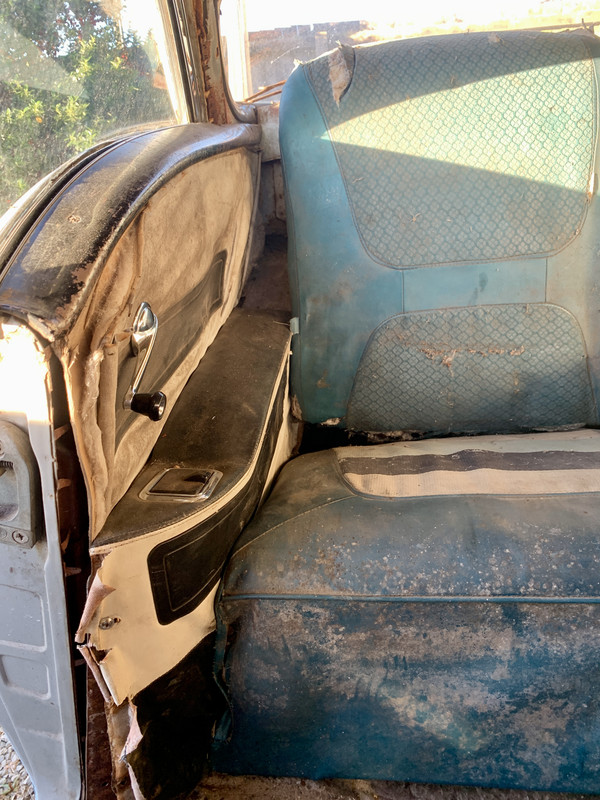

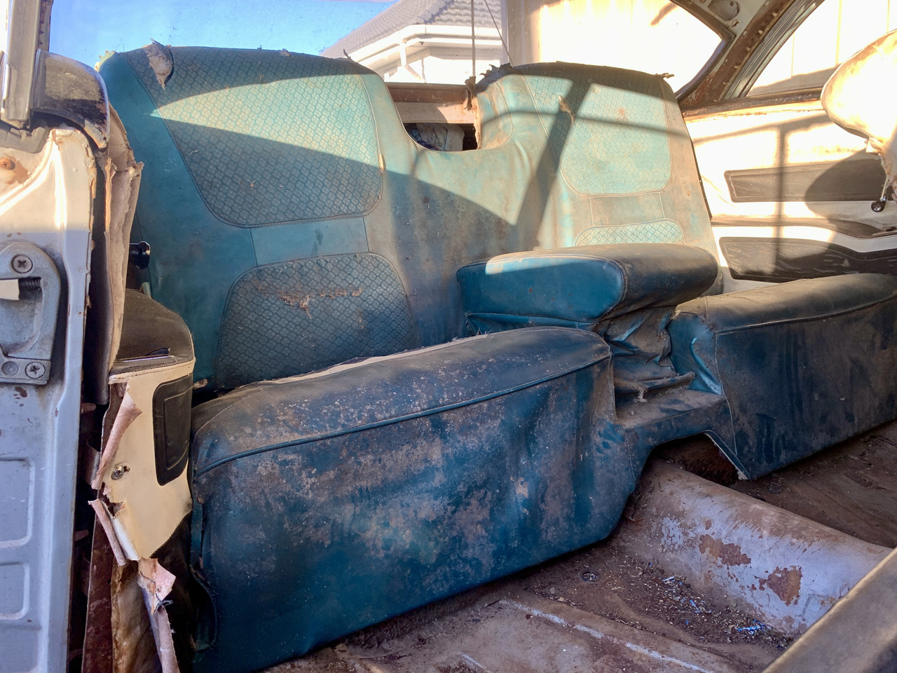

Popular Post Mr.Mk1 Posted April 3 Author Popular Post Posted April 3 Back seat: Acquired A fellow ‘58 owner who has a fucking STELLAR collection of cars mentioned he had rear seats from a previous ‘58 Impala coupe project. Guy had car in panel shop for resto and it burnt down so he suddenly had a heap of spares and no shell. My man grabbed the seats. Gotta be close right? Close enough for this guy. Wee bit weird above my arm rest but I’m ok with that. Maybe have upholsterer add a piece of filler foam before covering. The middle arm rest is a bit seized currently but sits flat usually. I have a Riviera script badge off a 70’s car that I’ll put in the top cutout. Back it with some of that patterned retro caravan alloy sheet with a polished trim around it to meet the seat I reckon. titties. Today I fished more parts out of molasses and cleaned up, painted. Scraped the inside of the roof as it was a little surface rusty and had old bitumen on it still. Will brunox it 2moroday. Got some POR15 Buick Turquoise engine paint I’m gagging to spray on stuff but adult me says wait until engine is together so you know you have enough to cover. Bits are waiting in bare metal but shouldn’t degrade too much in the mean time. Sigh. That bloke I got the manifolds off has a mint transmission for sale. Only problem is that his was open driveshaft and mine torque tube. His is stumpy with a yolk out the date. From what Ive gleaned it should be possible to swap the tail housing sections and I’ll be laughing. yeah I’ll have to tear them down pretty far but at least it’s not a rebuild. Info isn’t hell prevalent but its aft the interesting bit of transmission so surely just the output shaft will be different length? There’s a guy in Iceland who reckons he’s done it so awaiting some input from him 17 Quote

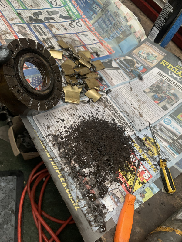

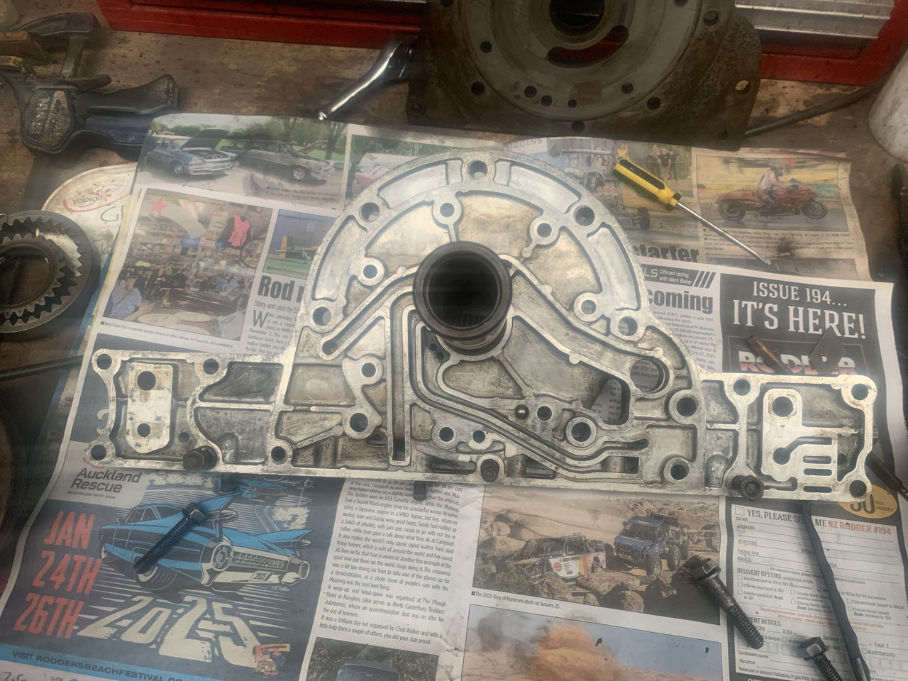

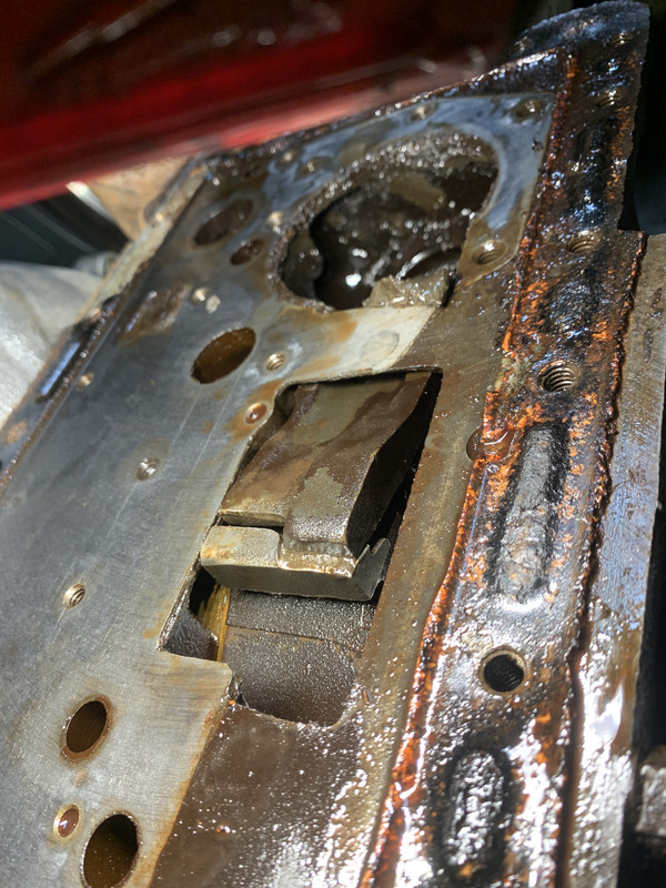

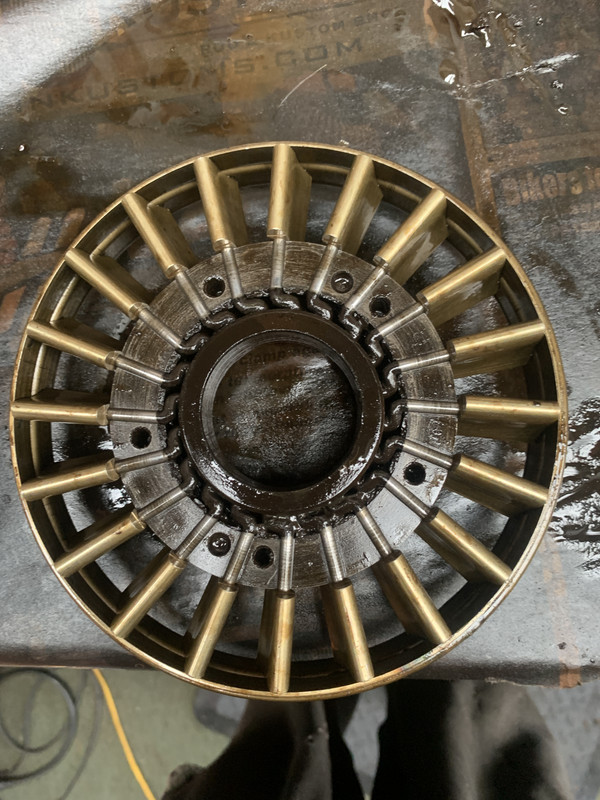

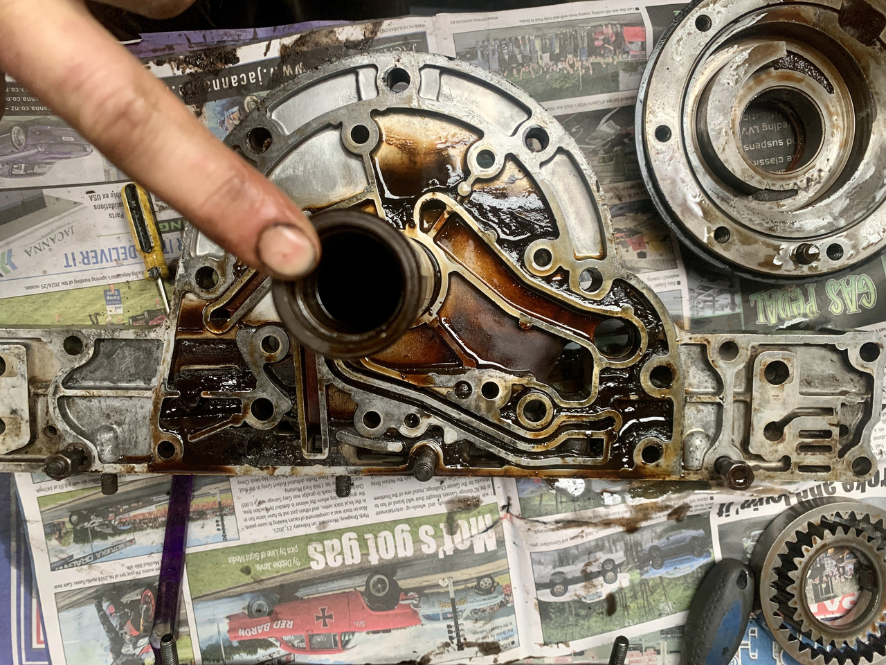

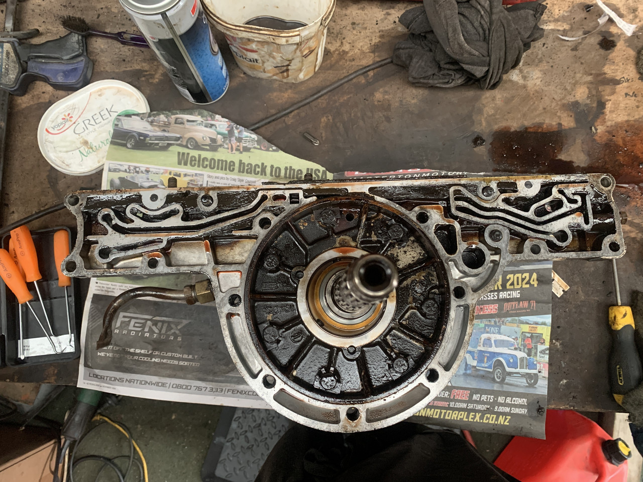

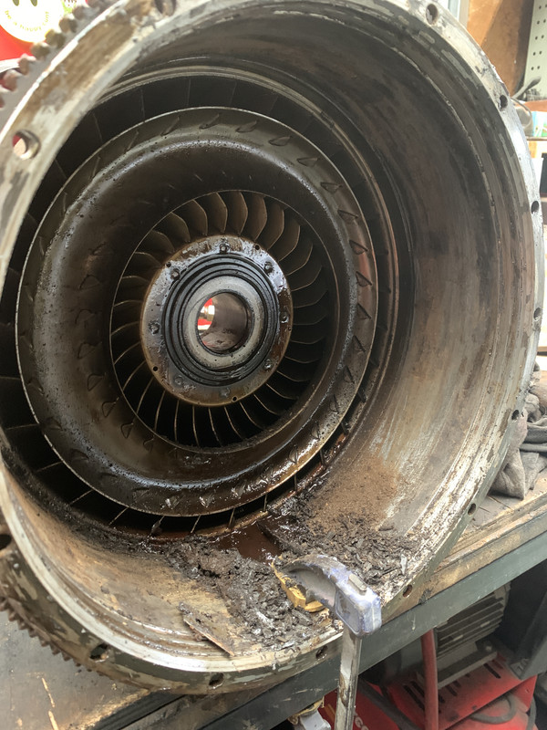

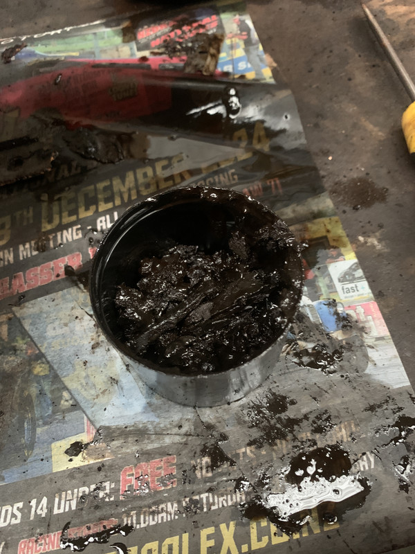

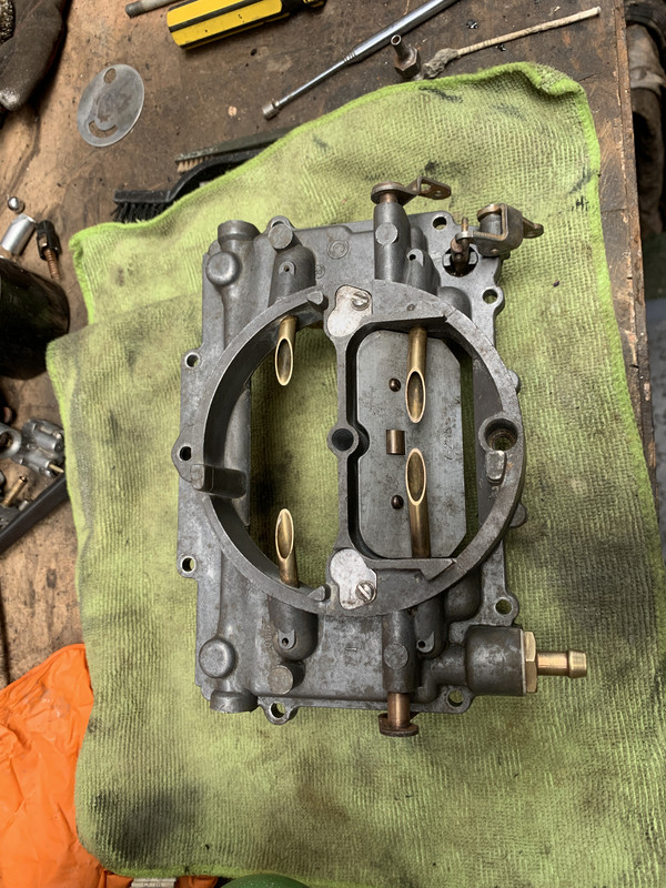

Popular Post Mr.Mk1 Posted Tuesday at 08:12 Author Popular Post Posted Tuesday at 08:12 Fuuuck this thing is filthy. Im about half way through pulling everything apart and cleaning it up/digging the resin and marmite out. Have just ordered rebuild parts from Trumpistan, so when they show up I’ll do final clean as replacing parts. I thought the inside of a torque converter was supposed to be clinical clean? Someone’s been partway in here before and instead of treating it to new seals etc they just use shellac. Things I didn’t want to pull apart. Things im glad I pulled apart. This is a variable vane thing but it didn’t move. I didn’t actually know it split apart and the centre was a ‘piston’ initially! 51 pce unit Note the galleries along top are chokka! More packed galleries. I almost filled this rattlecan cap from this part alone! I pushed a bit further along than I was comfortable with to get the bands out so I can drop them in to be re-lined tomorrow. Its kinda enjoyable at this point.. 19 3 Quote
