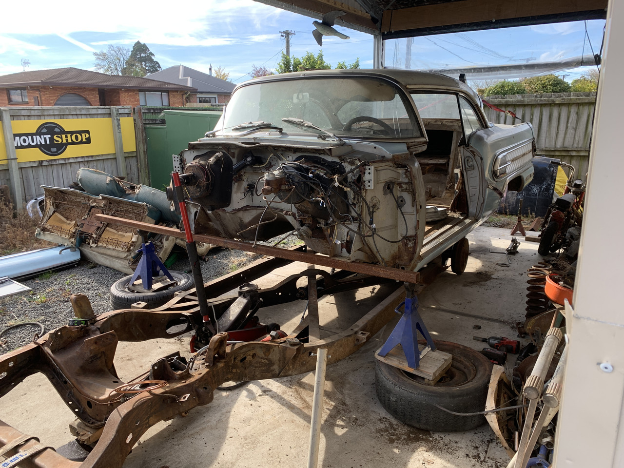

Popular Post Mr.Mk1 Posted October 19, 2025 Author Popular Post Posted October 19, 2025 It arrived home Friday arvo, so I taped on the rest of the trim and gave it a scrub 53 1 Quote

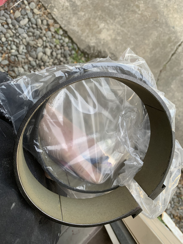

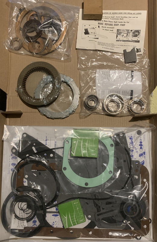

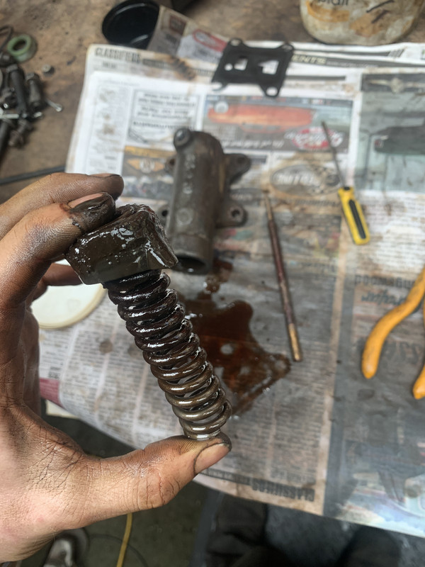

Popular Post Mr.Mk1 Posted April 16 Author Popular Post Posted April 16 Hows that jam, this is just an accumulator spring, uniform the whole length lol I have 4 days in disassembly and cleaning but all done now. It would NEVER have functioned, glued right up. The trans bits arrived yesterday, jazzed. Plenty of Old stock bits in there.. got a cheap dial gauge n stand setup too. Transgear did a lovely job of the band re-line but an easy way to spend 150+ each. It seems that whole short to long tail section swap would work but since mine was so filthy and had to come all the way apart, I’d have had to buy these parts anyway, plus a few G for the other trans so I’ve just stayed the course and rebuilding my one. 21 Quote

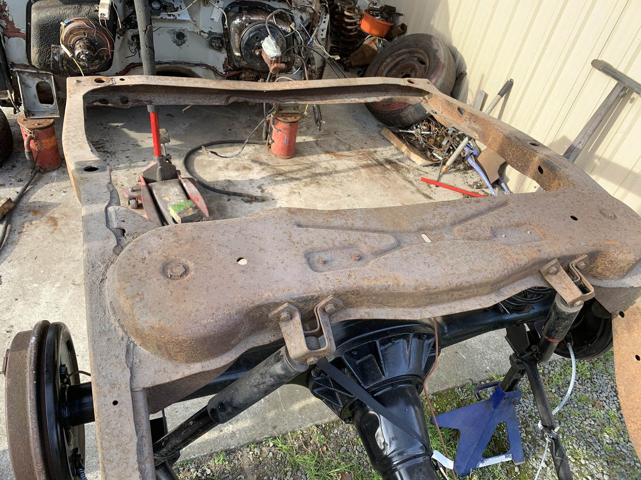

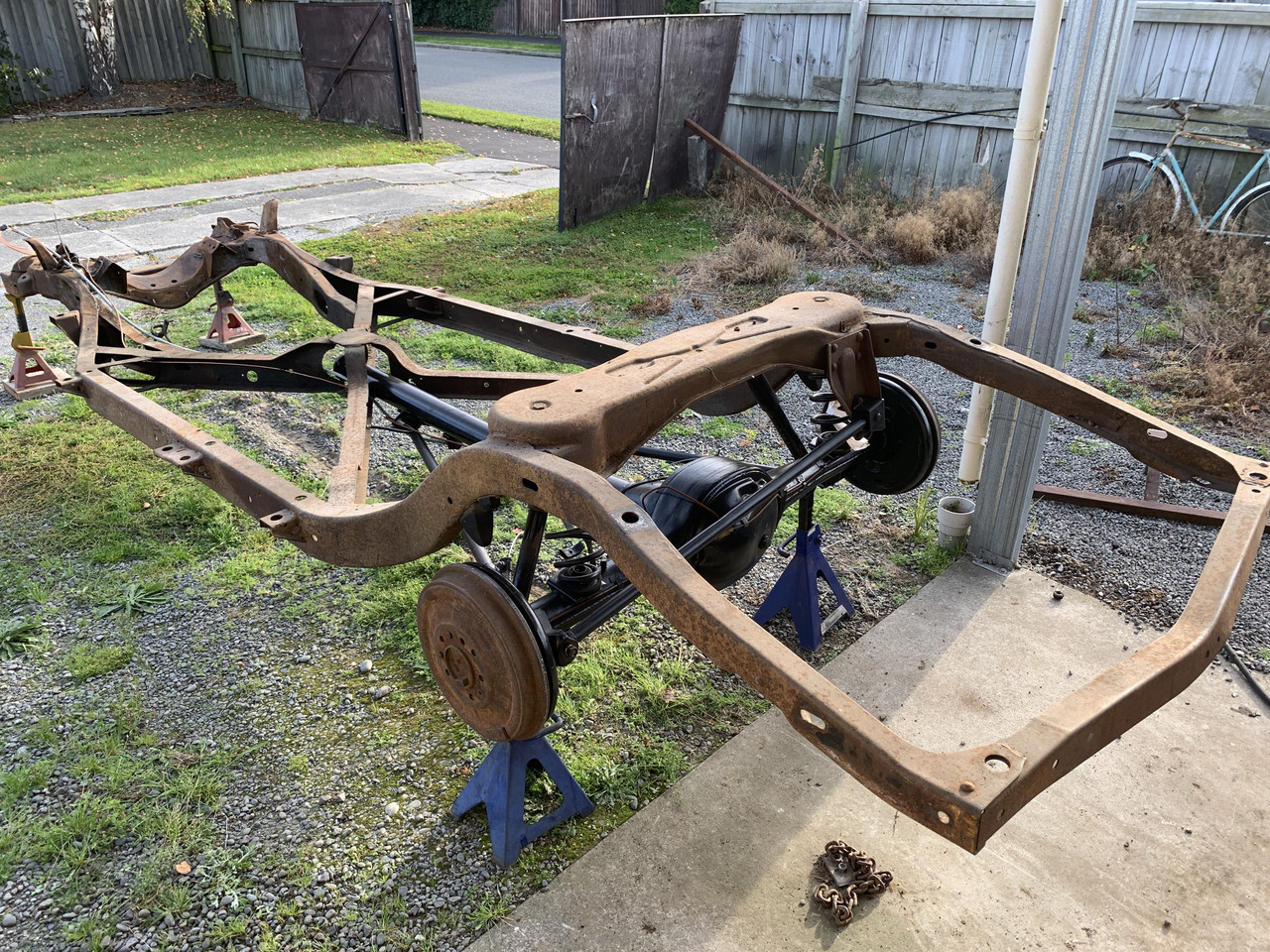

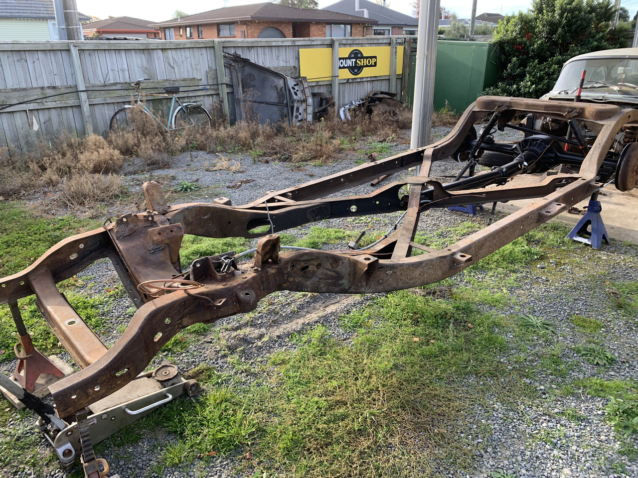

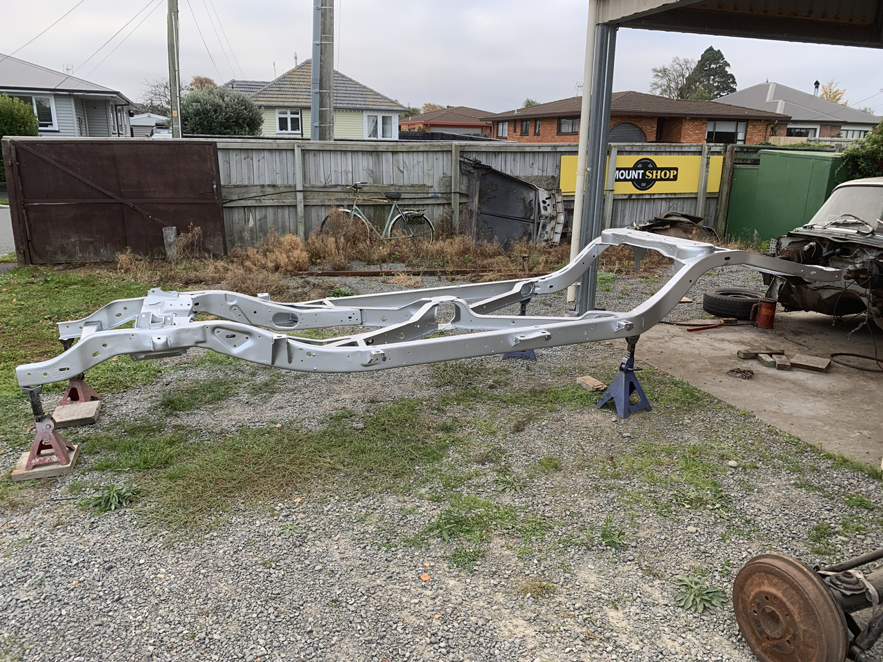

Popular Post Mr.Mk1 Posted May 2 Author Popular Post Posted May 2 Fuuuu, that will give a man Drymouth. Ultimate sketch, too many stacked items prior to this photo, to gain height of about 770 but it’s all I had and I got away with it! Had the engine crane with a strop round the back, worked well but allowed some ass-clenching sway at times when working on the front. Frame is great as expected, some wee wobbles to tweak back from previous shady jackwork but they are moving happily with a kissa butane. Will strip and clean, fire some paint upon it and reattach the completed suspension this week. Trans went back together. There’s a leftover wee needle/rod that I found stuck to the scarf magnet on My vice.. I’ll re-read my manuals but it doesn’t seem to be mentioned. While the trans kit was awesome, Unfortunately was missing a seal or 2 which id have thought pretty important so I’ve made some inquiries, there’s one on EBay but it’s a bit dare. Still great considering how hard it must be to source these bits now. Always Disconcerting to have lots of leftover bits but kit covers many years and iterations of Dynaflow. (‘58 actually had a orphan version that’s very expensive to rebuild, remember mine is from a ‘60) I also had to remove a thrust washer that looked important to get the right end play so I might revisit that, but for now it’s all in one piece again and not precariously spread all over the shed. 26 1 Quote

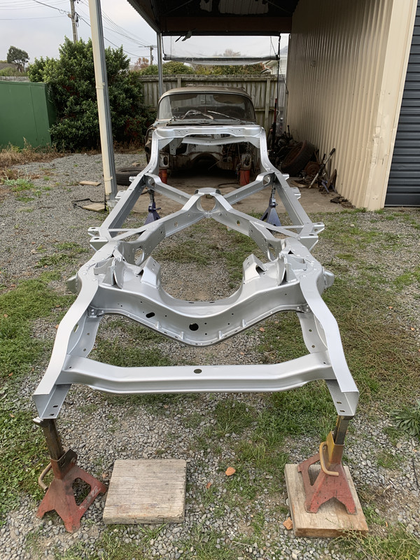

Popular Post Mr.Mk1 Posted May 5 Author Popular Post Posted May 5 Sweet! Would love to get it back under the car but then I got to thinking perhaps I should run fuel line and exhausts and all sorts of things while it’s easy.. 34 Quote

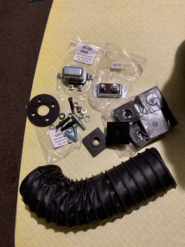

Popular Post Mr.Mk1 Posted May 20 Author Popular Post Posted May 20 UPS van came through with more goods from OldBuickParts Starter relay, battery cable junction box, steering coupler, heater duct in a diameter I couldn’t get here, + some body mounts. I was going to make some mounts work from off the shelf rubber pads but soon realised that was stupid and to just buy the thing.. Didn’t want poly bushes which are easily available and cheaper. In other news, I made some rubber gaskets for the lock and handles from some nice sheet id hoarded..last few cars I’ve assembled these seals perished really fast, ‘don’t make them like they used to’ etc. Started rust repairs! Have finished RH front of sill, opened up the LH + made the thick sandwiched reinforcement, along with the inner. (When I say finished I mean 90%, the other 10 happens when I take the floor pan out and replace, giving full access). I need to hack off the outer sill and planish it..it’s been a bit smooshed, then I can zap it all together. Made a piece for the kick-panel area but ran out of weekend. Have done some homework on the Bailey channel situation for the doors and I think I can make something from Basis work. Fine print on the proper stuff ex USA reads ‘comes as a rigid strip 72in long’. Fuck shipping that. As fate would have it, a rusty 57 Buick super 4dr HT showed up at work so now I have an excuse/opportunity to make duplicates of the repairs and I’ll be sorted at home too. 30 Quote
