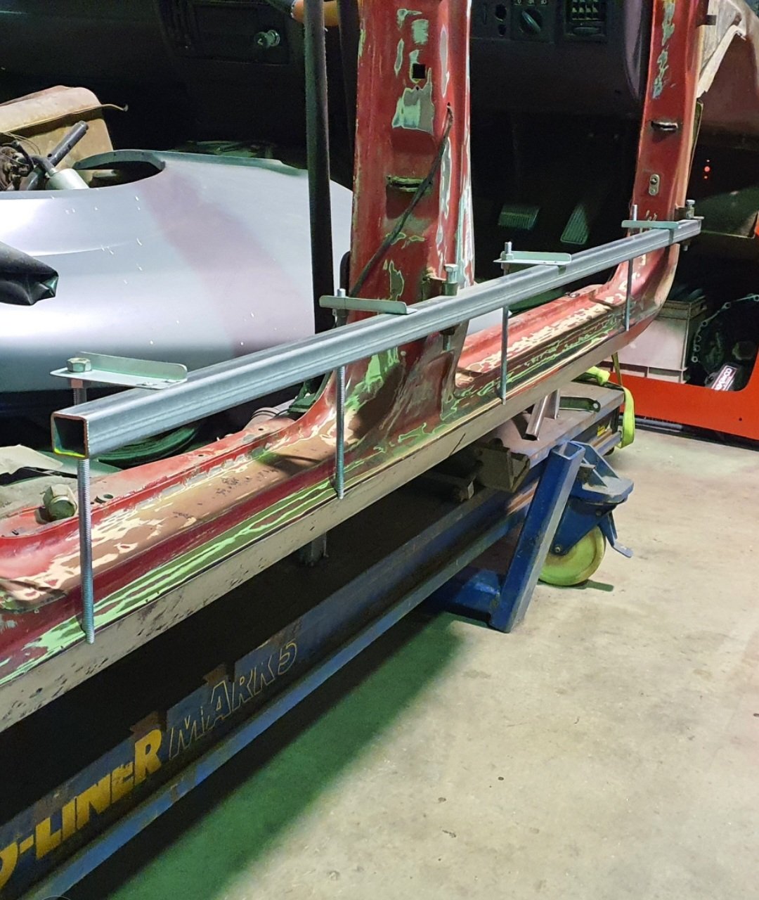

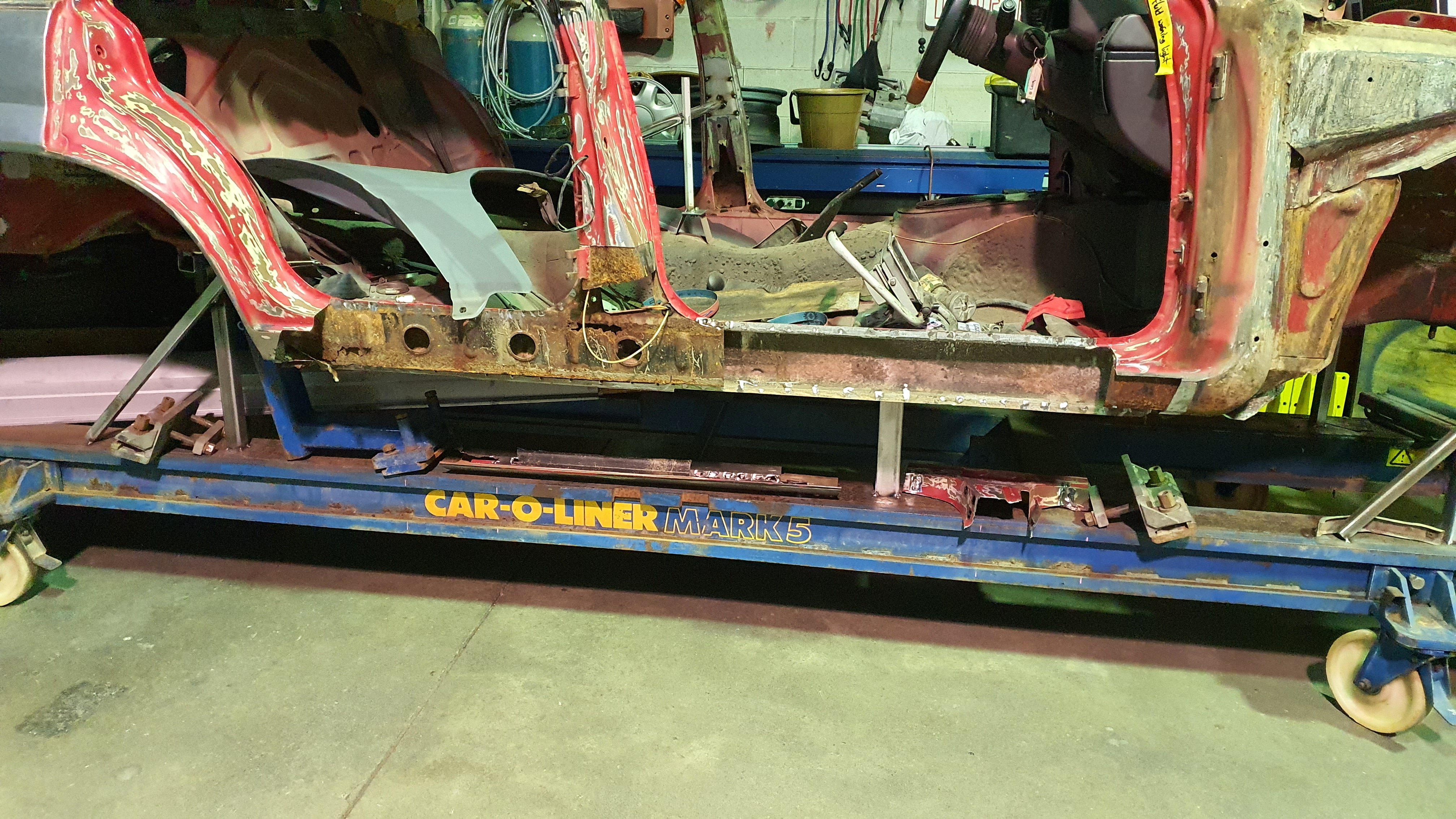

RXFORD Posted October 19 Posted October 19 Making good progress Dave. I've never you work so hard. You kicked out the shed or something? 2 Quote
RXFORD Posted October 19 Posted October 19 7 hours ago, HumberSS said: Great progress mate. Smack a link up of the vid of @RXFORDsent you so we can judge you harshly for your obvious mediocrity It was the shittest vid of me rambling because tired. Welded down to chassis machine so I can get sill clamps out of the way on that side. Have supported under centre of floor to take load off sill. Then I just brace a bit and jig stuff, plus take lots of measurements because if repair cert man walked in and saw sill missing and a flimsy pillar with no bracing he would flip his lid and throw a clipboard at me for being lazy. Once the lower section of outer b-pillar comes off these holdens they move alot quite easily. So braced between pillars and down to tunnel, plus a couple of removable bits from seatbelt mounts so can remove inner pillar skin. And made a jig to help set sill-door gap as these vb-vl commodores have knock in roll pin style door hinges so its not as easy to just throw a door on and check gap. Jig will get me close and I'l fit doors last to double check before I commit to welding. 8 1 Quote
