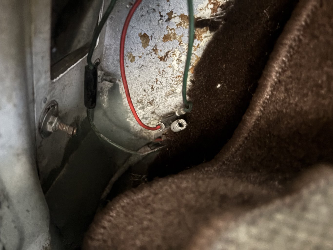

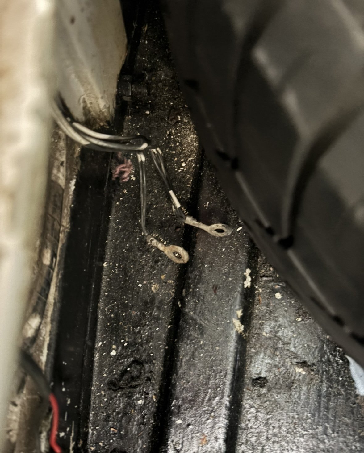

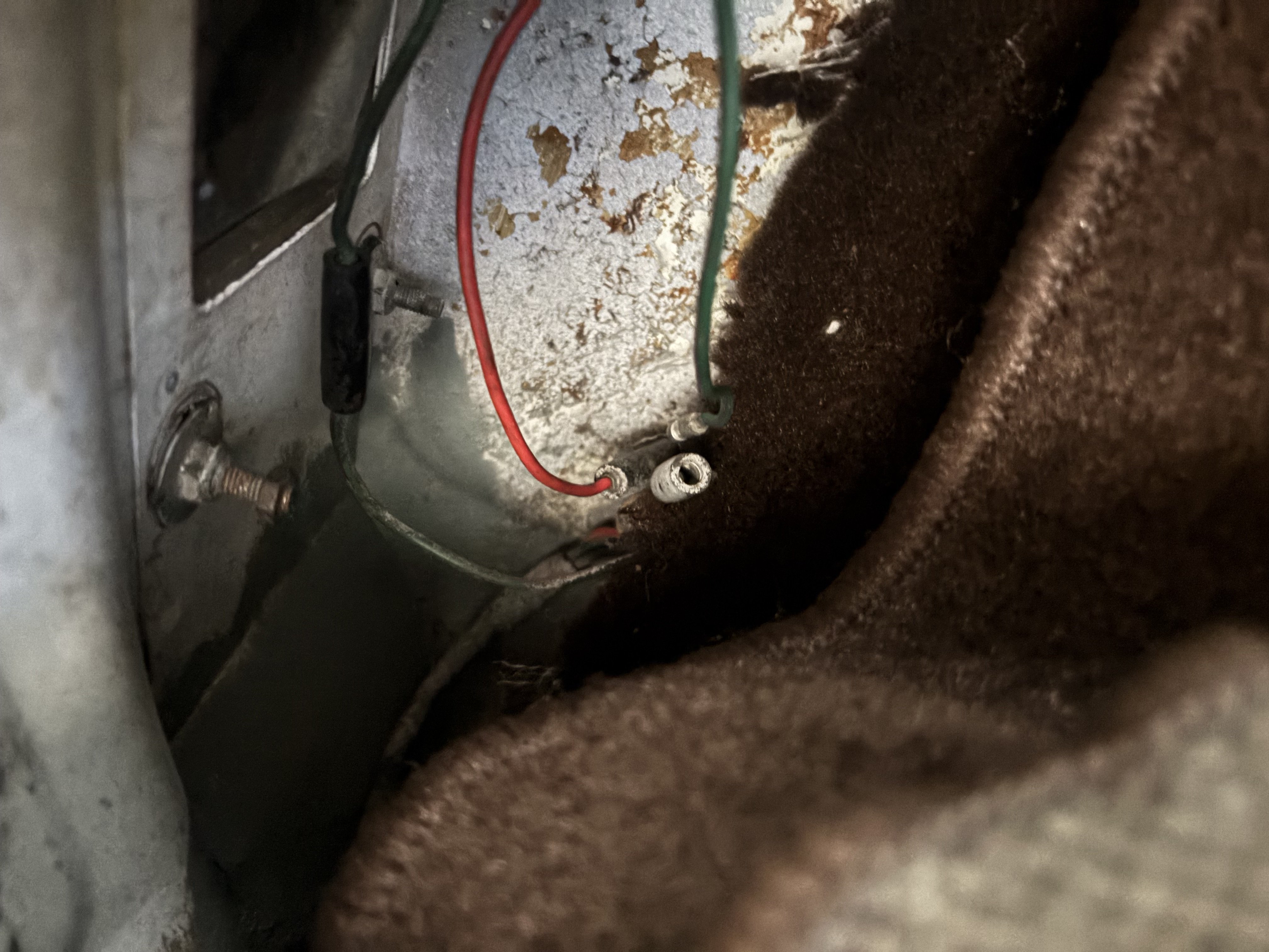

Popular Post MRT1TRD Posted August 7 Author Popular Post Posted August 7 So for the undeclared list… tail lights don’t work and with the lights on the LH indicator is not flashing then there’s the vacuum leak from the brake booster when you hold the brake at idle the engine drops down to 500rpm and sometimes stalls out. I had a look over the wiring last night and found a few things left unplugged but that only fixed the indicator and one reverse light, it seams to be no voltage going to any of the park lights but the headlights work so I will try not to drive at night. It came with a new wof with less than 100km since but on my first drive I read who issued it, for the locals that know what Kamo testing station will pass this did not fill me with confidence. so I left for the first part of my trip a 260km round trip to Opononi to pick up stuff from my now rental property, I took it easy at first but my confidence came back and it was not bad 15 Quote

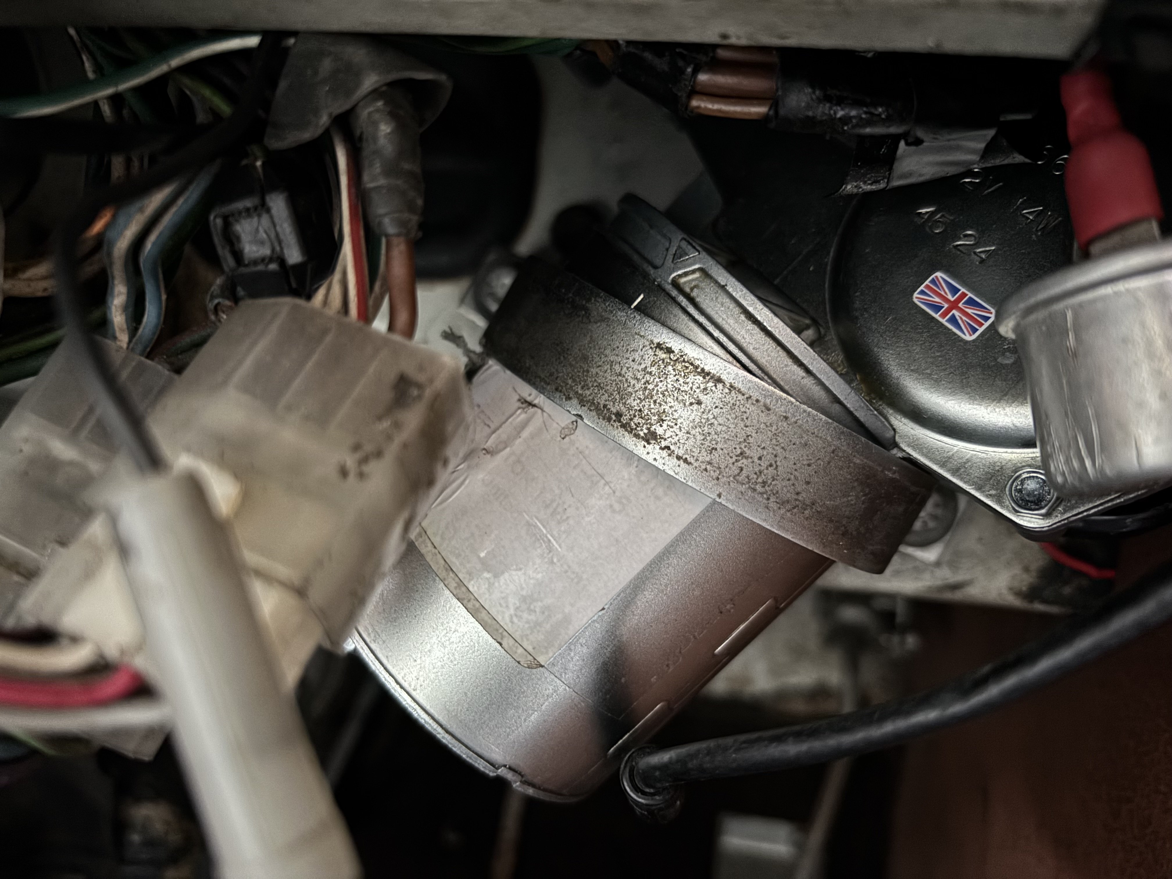

Popular Post MRT1TRD Posted August 9 Author Popular Post Posted August 9 So Thursday evening I was working on fixing the wiper motor with some scrap rubber and some flashing tape to hold it together but the main issue was he left the tube nut disconnected so with it all together it works great. And found a new issue is that the starter is not working sometimes and it seems to have a voltage drop in the switching circuit somewhere as I can short circuit it . but then my mother had a heart attack and we spent the night in ED (she recovered after a bit of treatment) then in the morning I was feeling ill most likely from lack of water, sleep and hospital A/C. So after sleeping all morning I finished off getting ready and set off I stopped in Henderson to get some rubber bits for it but other than south Auckland traffic it was a good trip 17 5 Quote

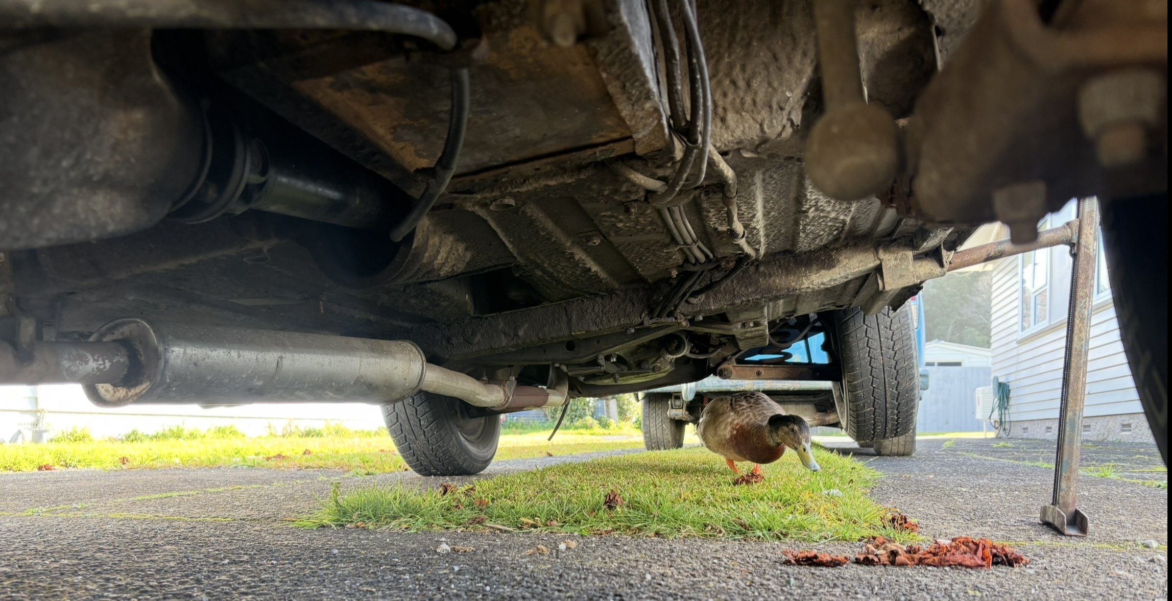

Popular Post MRT1TRD Posted August 11 Author Popular Post Posted August 11 I had a look underneath on Saturday and was surprised how tidy and rust free it is. Just needs most the rubber parts replaced, slight leak from the oil cooler and some slack in the diff remediation some locals came over to help 12 Quote

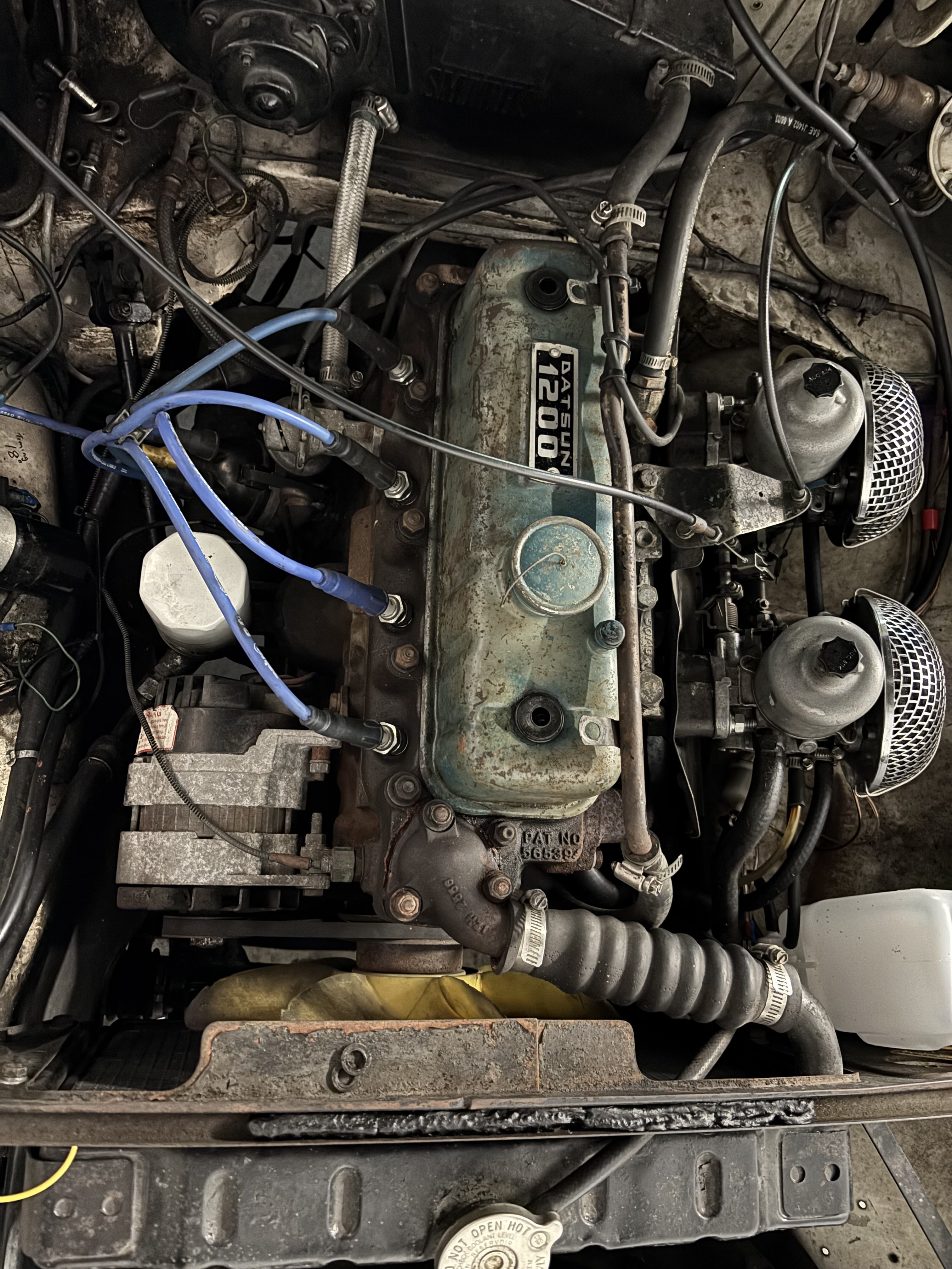

MRT1TRD Posted October 22 Author Posted October 22 So now that it’s here it’s time to give it some love for all the punishment it just received first was a valve and points adjustment and a oil and filter change then put together a list of items needed 9 Quote

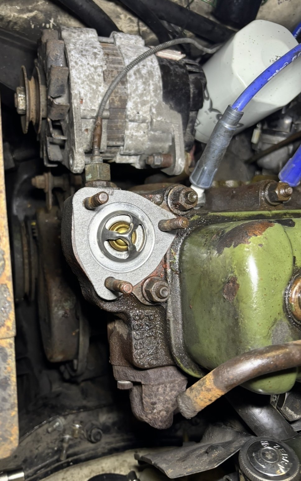

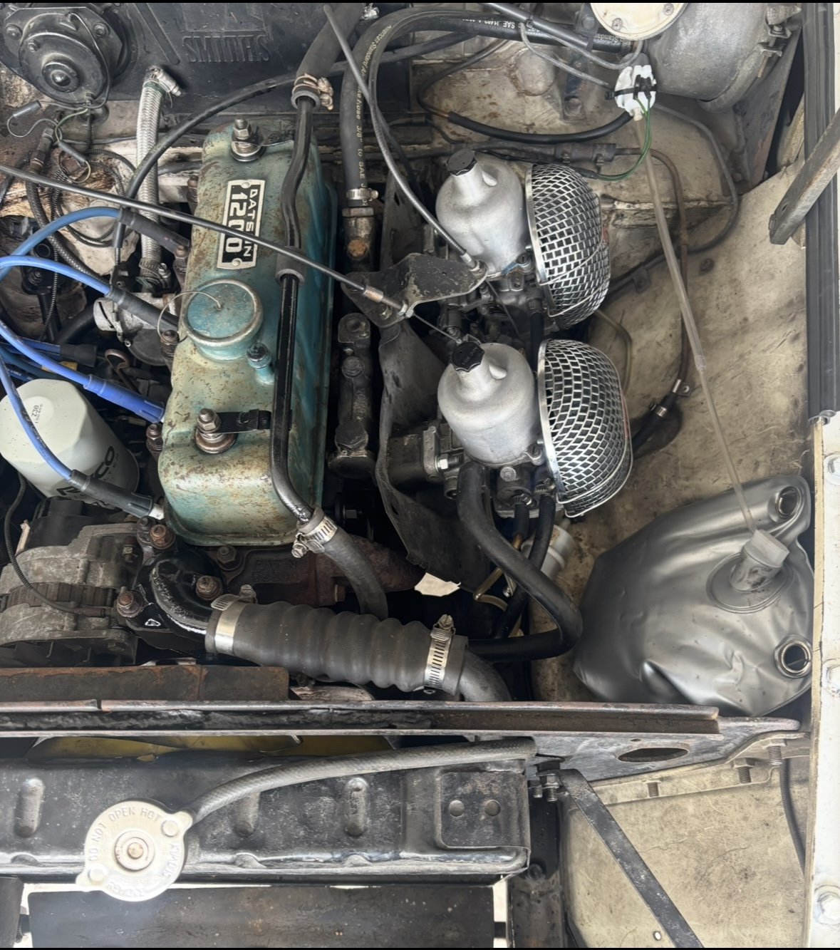

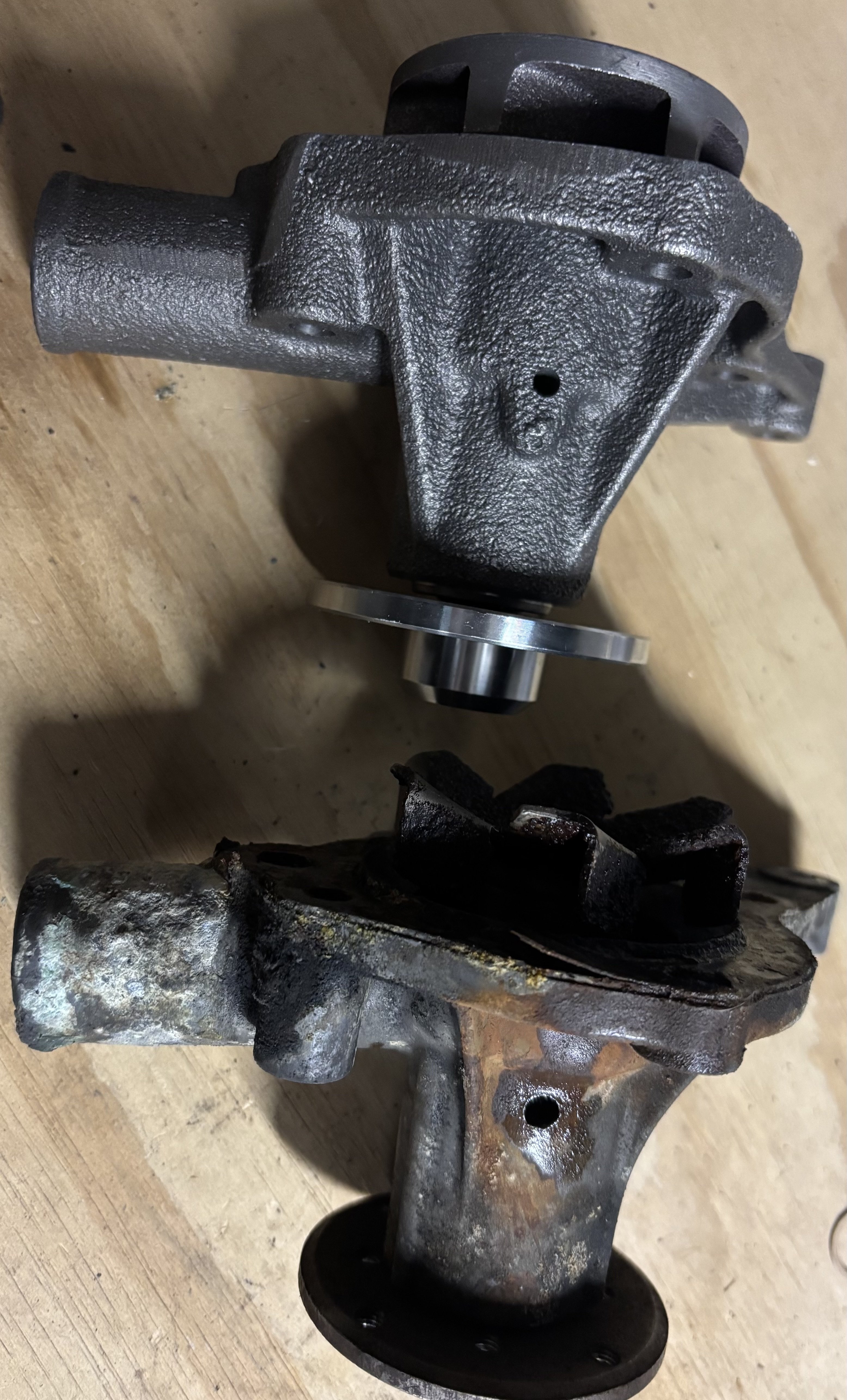

Popular Post MRT1TRD Posted October 27 Author Popular Post Posted October 27 So the water pump was very noisy but somehow holding water so with a bit of a tidy up of the cooling system it’s back together but after a test drive I need to replace the heater hose also 10 Quote

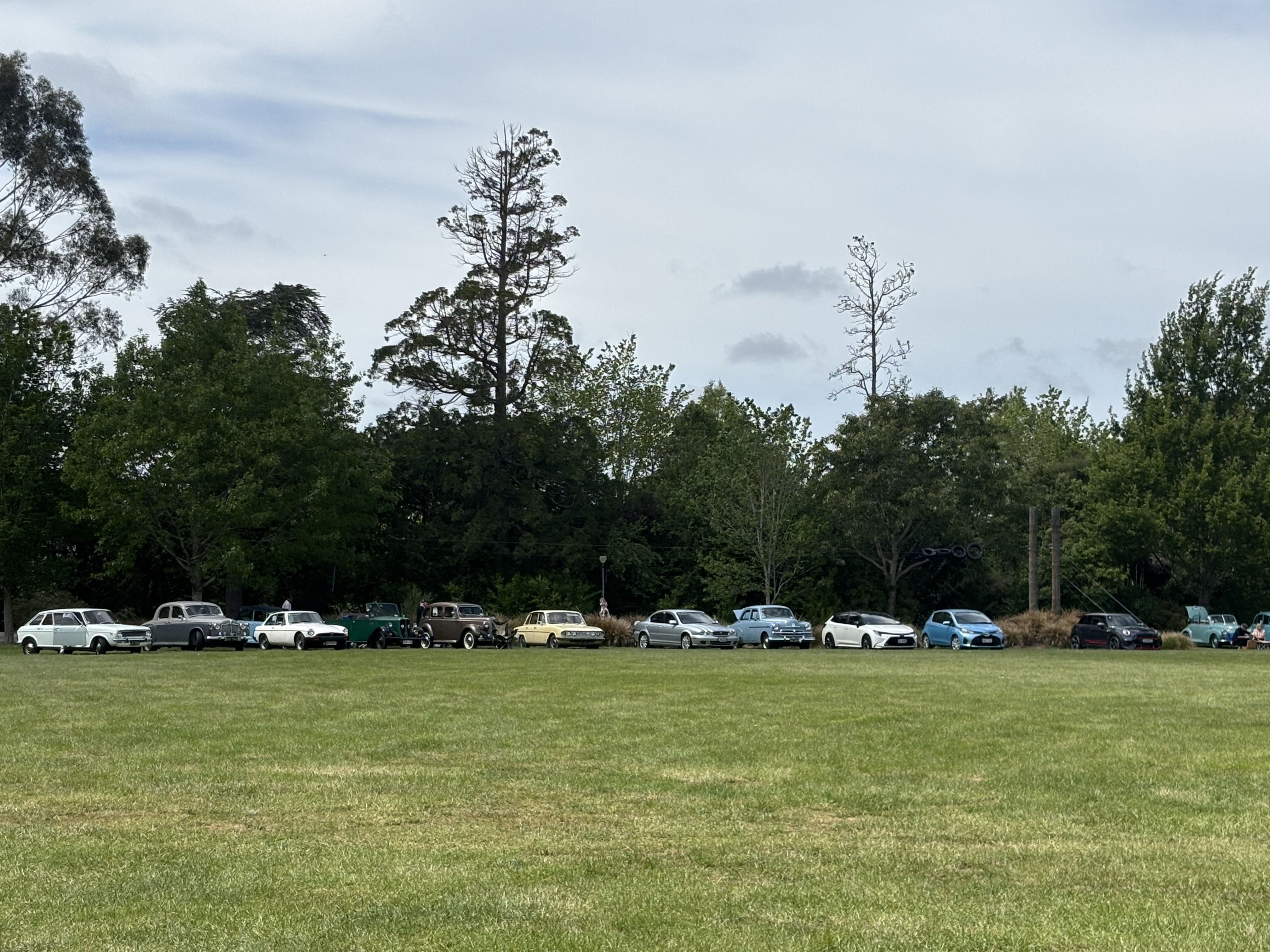

MRT1TRD Posted Sunday at 21:19 Author Posted Sunday at 21:19 I took it out for an all British rally over the weekend. Looked abit average next to the other well kept vehicles there, tho caused a stir with the non British valve cover 9 Quote

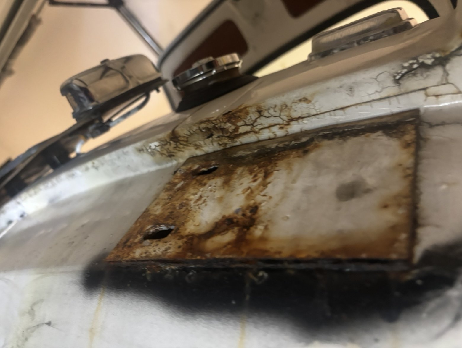

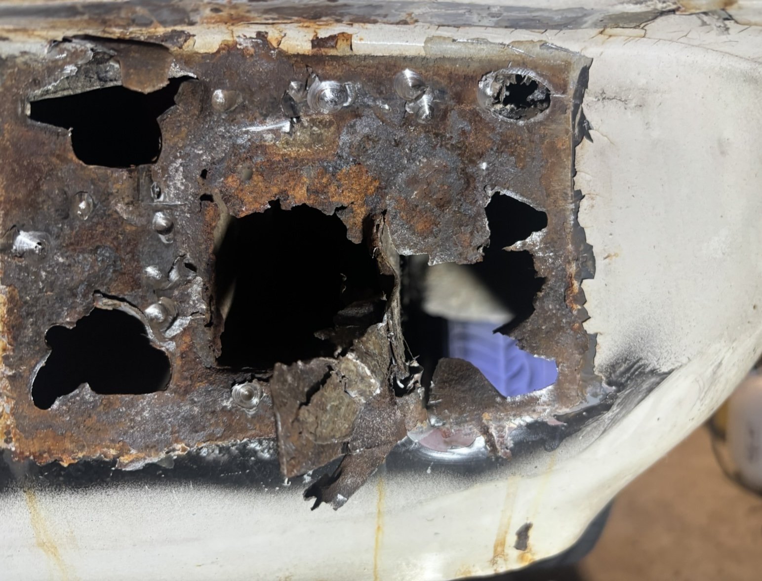

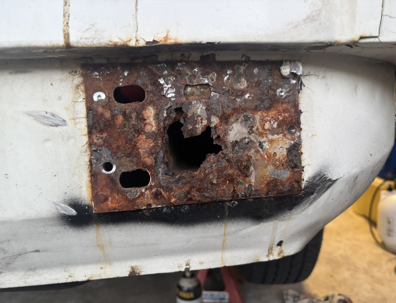

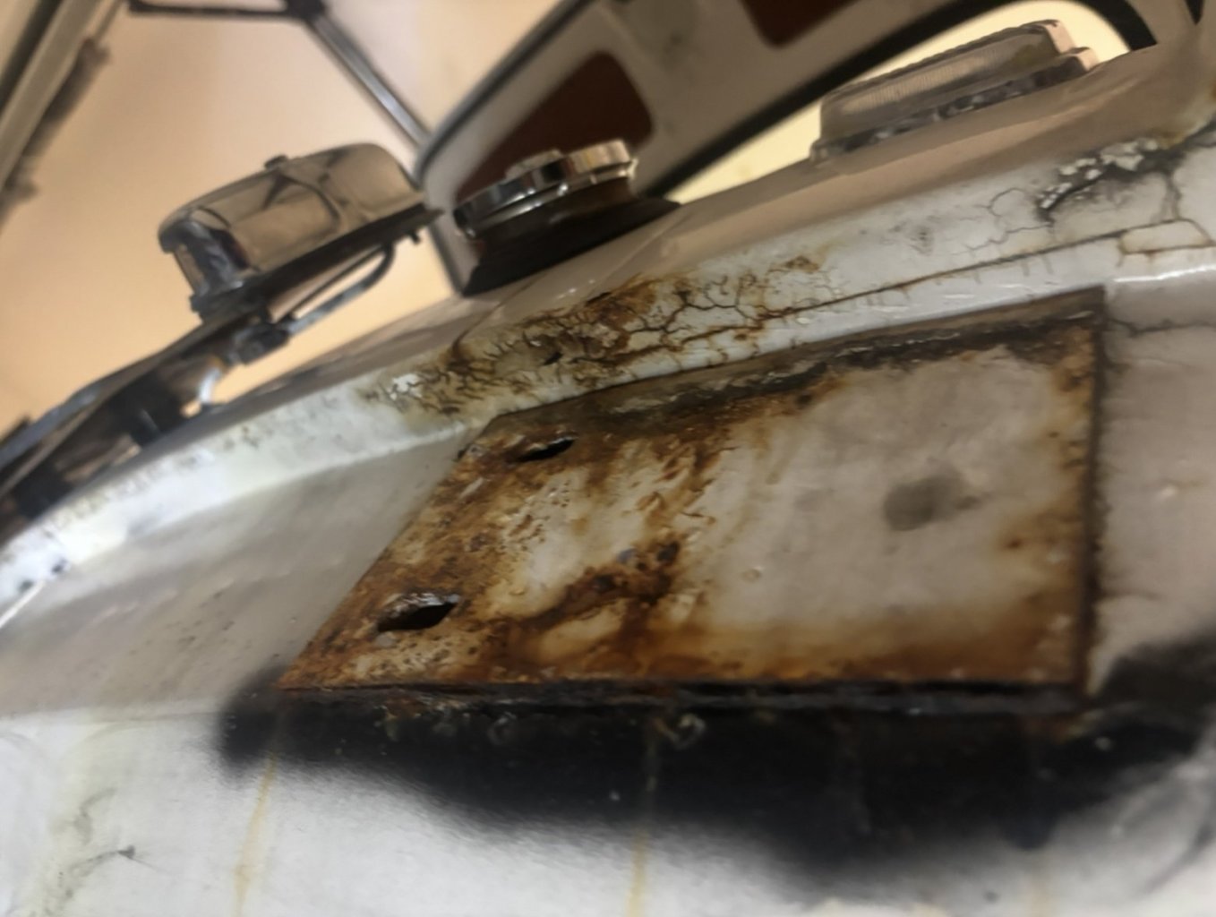

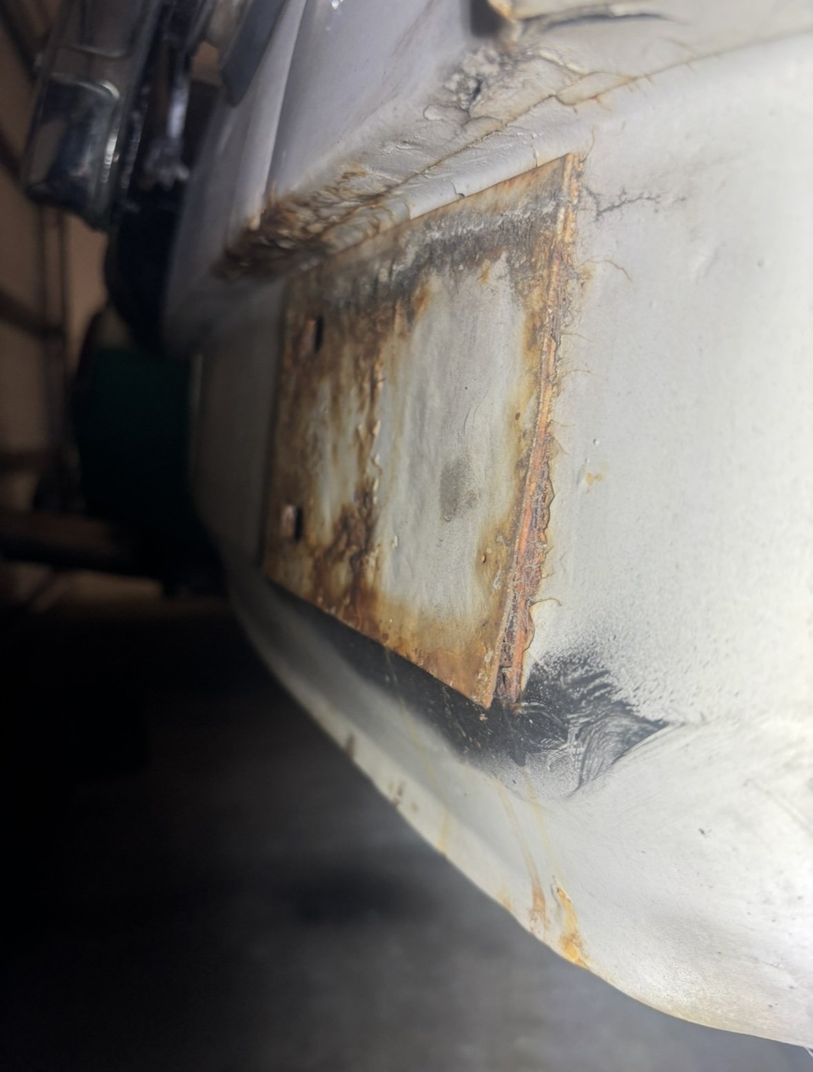

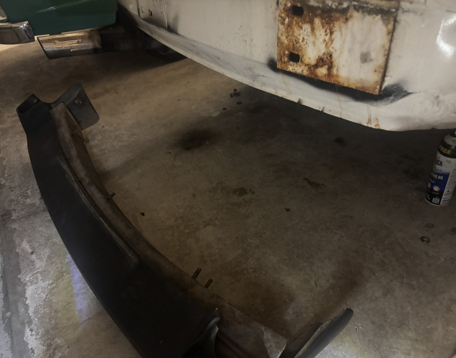

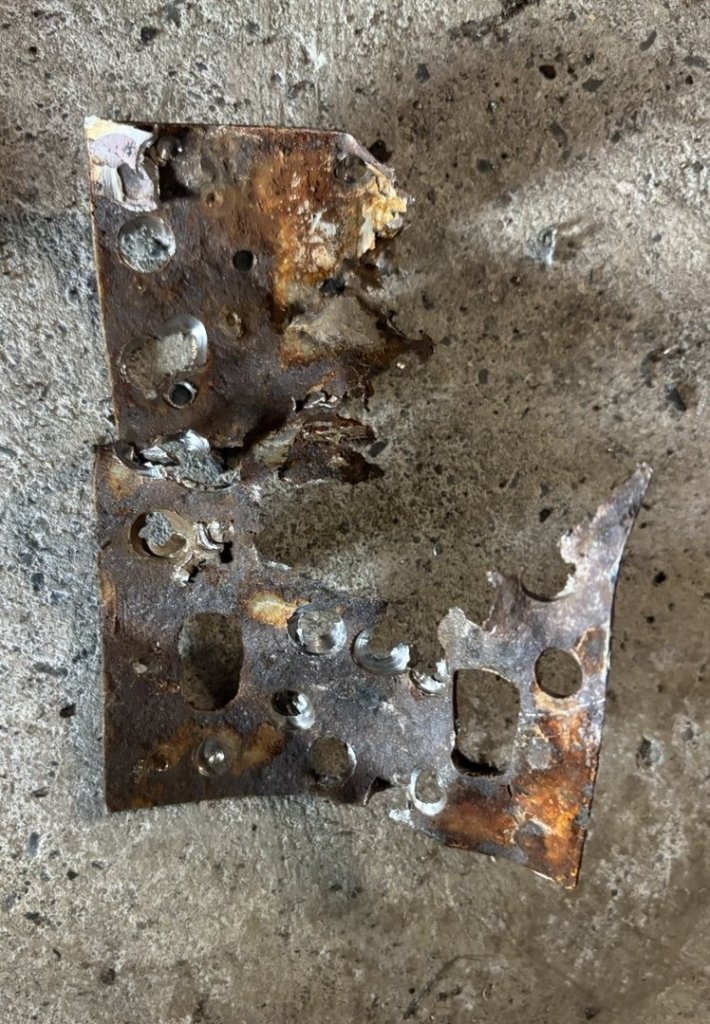

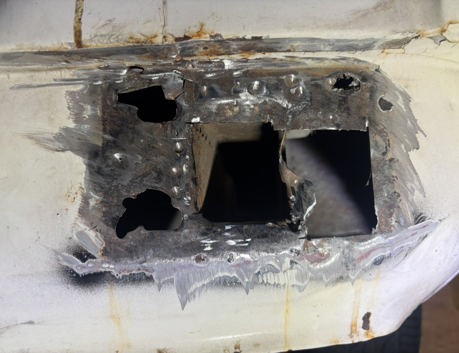

MRT1TRD Posted Wednesday at 07:12 Author Posted Wednesday at 07:12 So I removed the rear bumper and inspected a little surface rust on the RH reinforcing mounting plates which consisted of three layers, the tail panel and two plates stacked together. And of course the meat inside the sandwich had gone off . removing the first layer was easy enough but the second layer even though I made Swiss cheese of it with the spot drill it took with it as much of the tail panel as possible while fighting all the way 9 Quote
