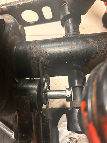

Thousand Dollar Supercar Posted August 12 Author Posted August 12 1 hour ago, Shandangles said: Size limits necessitate multiple posts 😕 You know you can just set your camera to a lower resolution, or resize / crop the photos, save them at a lower quality setting etc. 😛 With those small radius arm bushes and their weird bolts, I believe you do have to fully disconnect the lower end of the shock as you mentioned. The ground-off bolt head is necessary to provide clearance for the bolt to be withdrawn. I have these bushings ready to install - urethane instead of the recommended metalastic. I've just been put off attempting the job by the stories of seized joints / sheared bolts, and of people having to cut the radius arms to bits to get them out. 4 Quote
Shandangles Posted August 12 Posted August 12 I assumed there was a simple way but am too retarded to figure it out. I looked at urethane bushes and heard mixed results so decided on factory replacements. The poor handling was related to the arc the radius arm travels during the suspension travel. Being that the arm is fixed at the chassis end and pivots at the LCA evd the effective length changes throughout the suspension arc. Allegedly the factory rubber took this into account so their is enough slop to minimise negative handling where these us essentially zero slop in urethane so during the suspension travel it's pushing / pulling on the lower control arm causing weird handling during the suspension travel. . How true any if that is, I don't know but the description I read made sense so rubber it is 🤷♂️ 1 Quote
Raizer Posted August 12 Posted August 12 22 minutes ago, Shandangles said: I assumed there was a simple way but am too retarded to figure it out. There's lots of free apps for your phone, I've been using "Photo Editor" on Android for years, simple enough to use but lots of features to do a shitload more than just resize if you wanted. PC is even easier. 1 Quote
Thousand Dollar Supercar Posted August 12 Author Posted August 12 54 minutes ago, Shandangles said: The poor handling was related to the arc the radius arm travels during the suspension travel. Being that the arm is fixed at the chassis end and pivots at the LCA end, the effective length changes throughout the suspension arc. Allegedly the factory rubber took this into account so their is enough slop to minimise negative handling where these us essentially zero slop in urethane so during the suspension travel it's pushing / pulling on the lower control arm causing weird handling during the suspension travel.. How true any if that is, I don't know but the description I read made sense so rubber it is 🤷♂️ The way I heard it was that the radius arms are supposed to twist the rear subframe during cornering to some degree, even with the original bushes. It's to steer the rear wheels in the opposite direction to the fronts, which helped a front-heavy LWB 1960s saloon take a corner on the tyres of the period. I think the issue with urethane bushes is that they don't allow enough twist / freedom of movement for proper suspension travel, so if you put stiff urethane at both ends of the radius arms, you're almost locking up the rear suspension and ruining your ride. My plan was to keep the original large metalastic bushes in place at the chassis end of the radius arms, and just change the small bushes to urethane. I would like this to result in rear wheel steering which is steadier / more predictable, rather than causing a greater degree of rear wheel steering. I already feel my sports-pack car has enough of a tendency to oversteer in the wet, thankyou very much... 2 1 Quote
