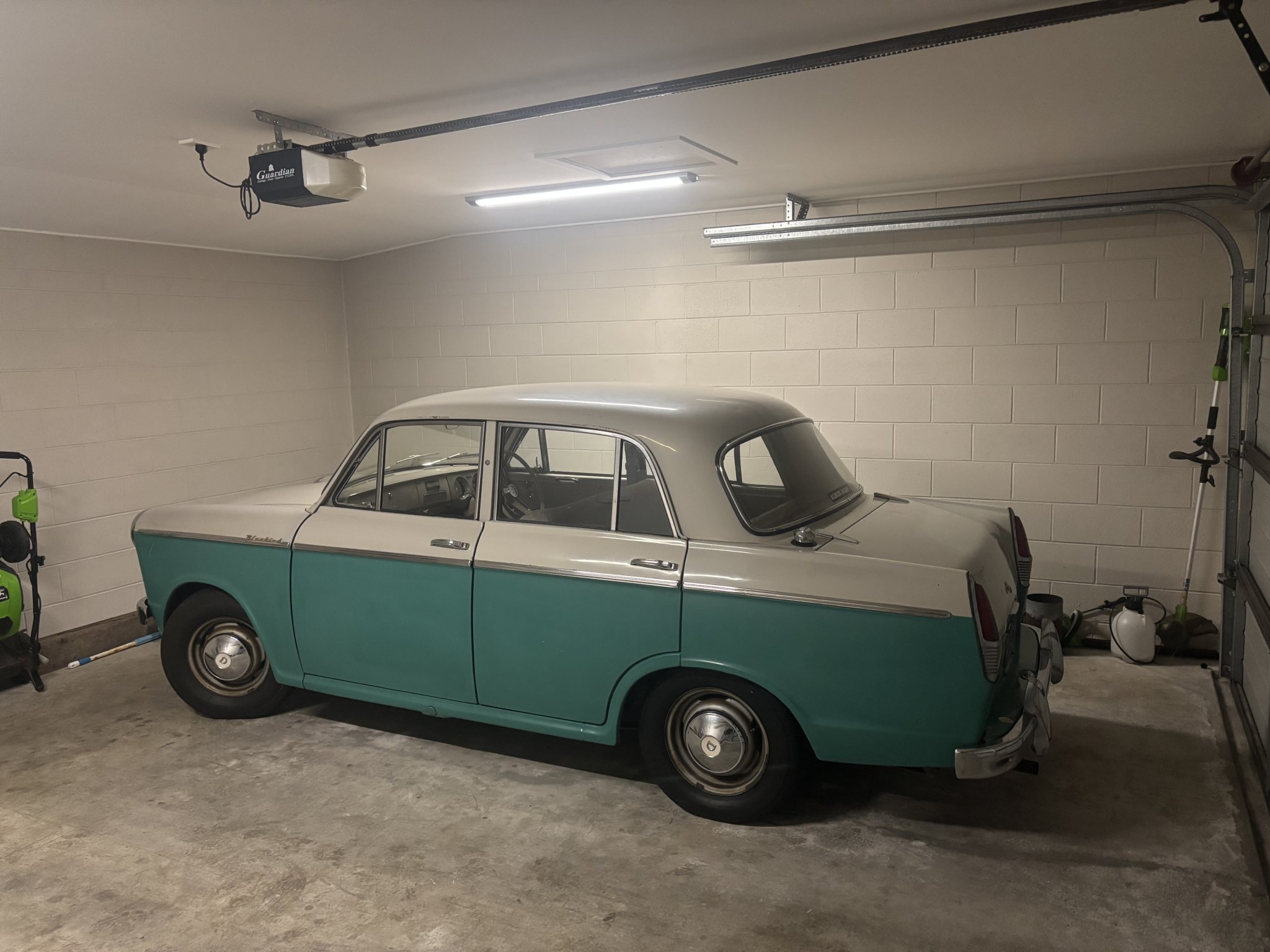

Popular Post MRT1TRD Posted June 10 Popular Post Posted June 10 So I purchased this in march for a decent price compared to repairing rust on my other cars, It’s a 1962 Datsun Bluebird sold New in Chch and after two family owners I own it. needs a bit of mechanical refinement but came wof and reg 23 Quote

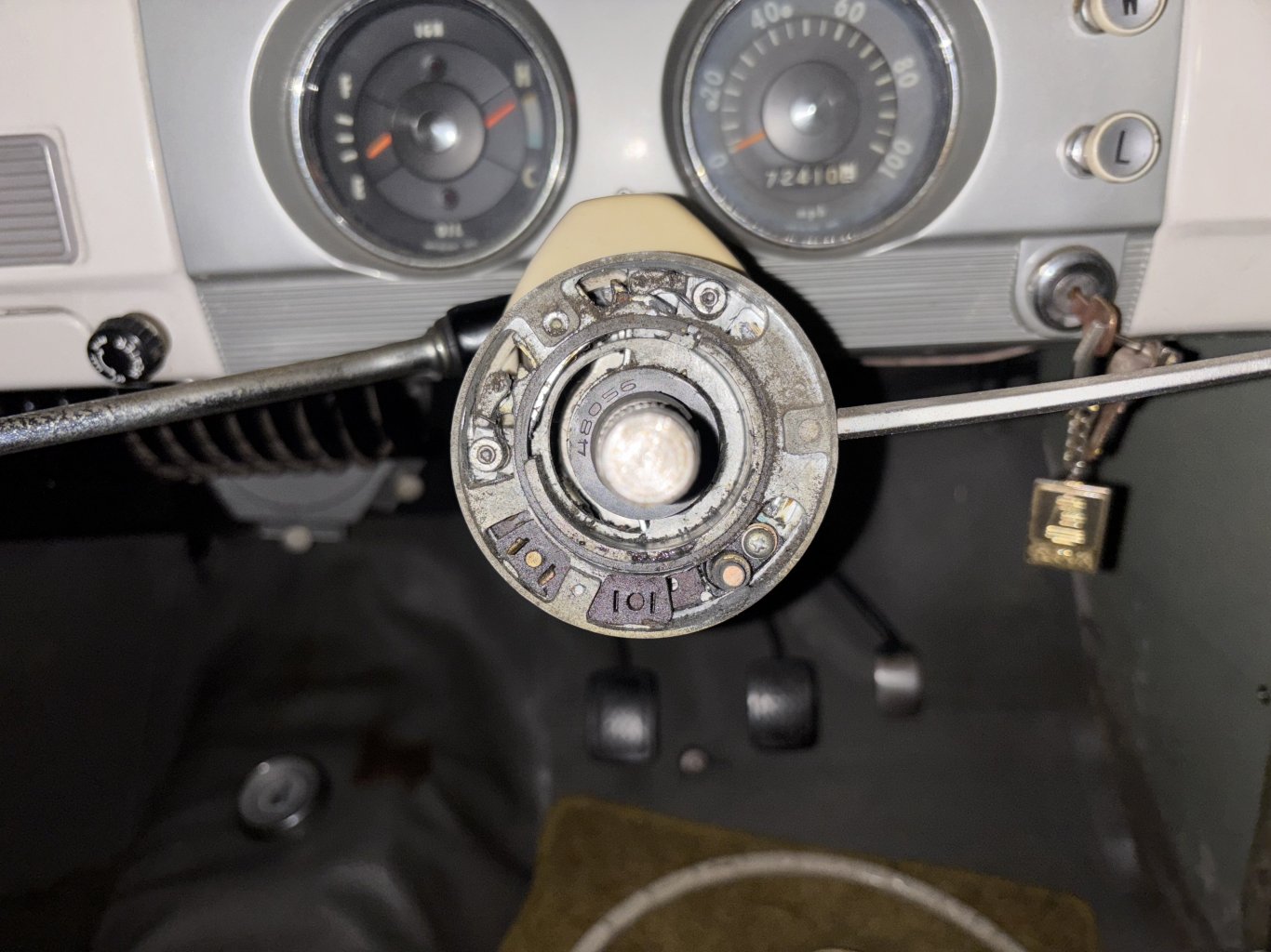

Popular Post MRT1TRD Posted June 13 Author Popular Post Posted June 13 So before I picked it up I had already planned its first outing in two weeks but had a few things to fix (tho lockup rules state no working on vehicles) first was the LH Indicator not selecting. so after carefully removing the cracked bakerlight wheel I cleaned and played with the mechanism to get it working again. 22 Quote

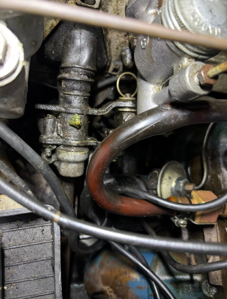

MRT1TRD Posted June 14 Author Posted June 14 So then Looked into the gear shifting issue first was the play in the shift rods, the joints had a lot of play on the 1st - rev rod, so I replaced the bushings and washers, the split pins was half the problem, being soft so best I had lying around was some key rings. this improved the selection but still had play inside the box, so I was able to select 2nd while driving if I’m slow and almost grind reverse that is 9 Quote

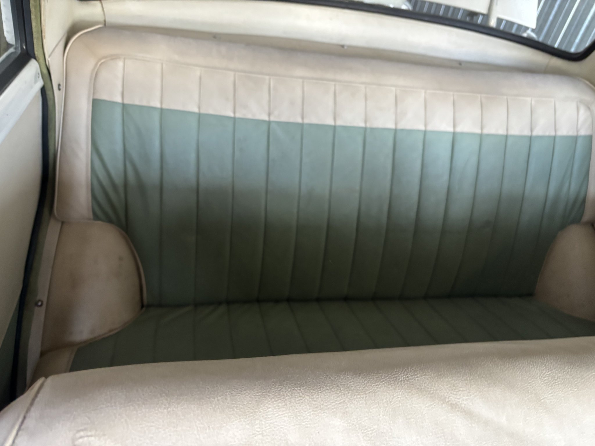

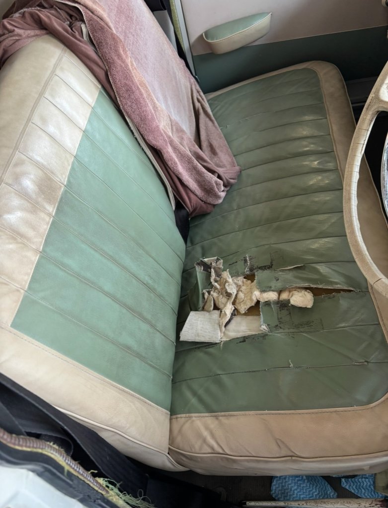

MRT1TRD Posted June 19 Author Posted June 19 The front seat base needs some repair, it’s not missing any vinyl so I think it’s possible to do a internal patch to hold it together if matching colours are not available, or does anyone have suggestions? 2 Quote
MRT1TRD Posted June 19 Author Posted June 19 Discussion here and pic of rear seat https://oldschool.co.nz/index.php?/topic/91418-mrt1trd-‘62-bluebird/ 4 Quote

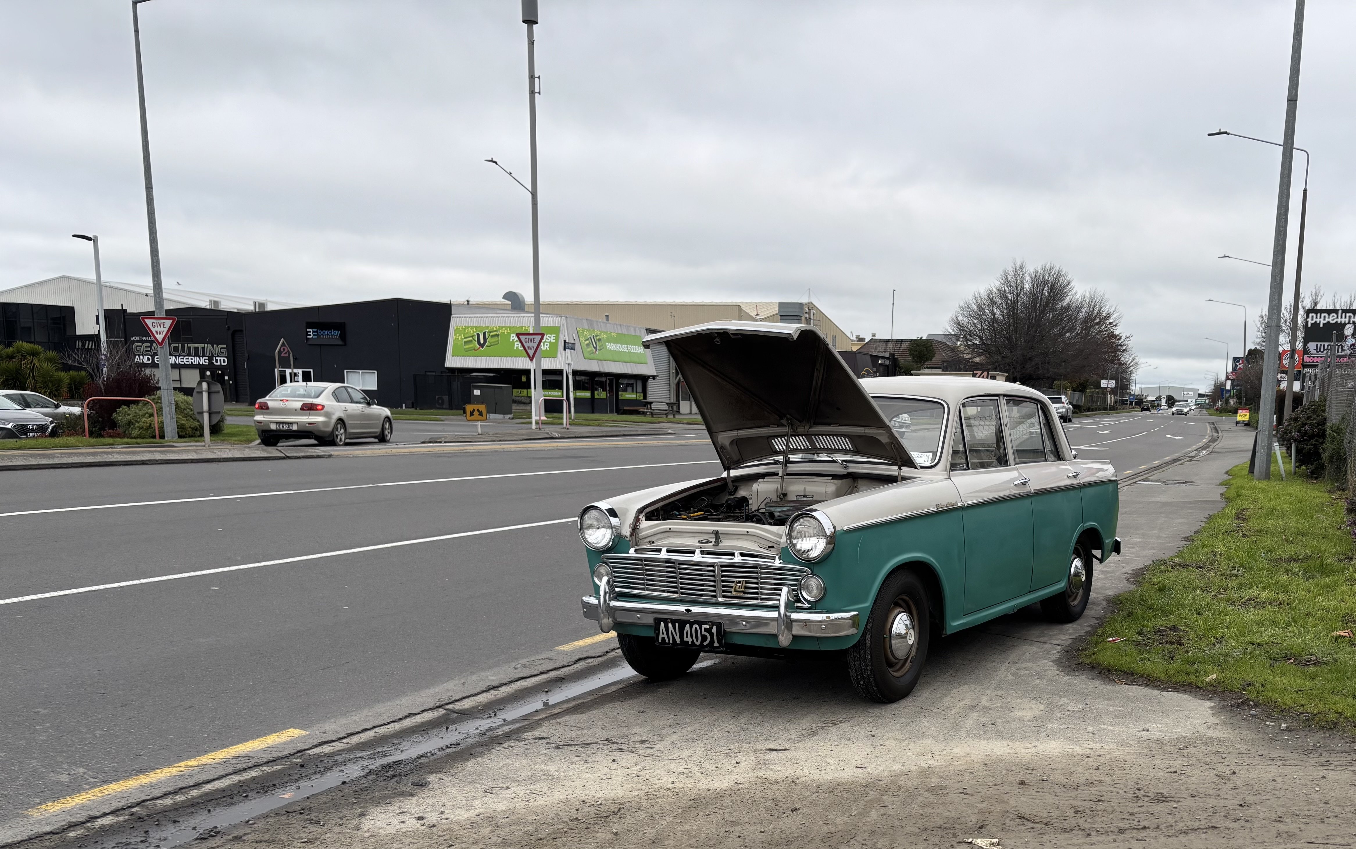

Popular Post MRT1TRD Posted July 17 Author Popular Post Posted July 17 So like the battery was not that good to start with and then you get winter time in the south and you add that with a generator that is only charging 11v at idle you get a recipe for break down right in a busy intersection . happily there was some good people around to help me push it out of the street one was driving a very tidy 2nd gen Swift GTI sadly I didn’t get to have a chat before he ran off 16 Quote
Popular Post MRT1TRD Posted July 17 Author Popular Post Posted July 17 So once I got it started again I was able to drive home but had to keep the revs up I had to use the method of using my right foot I learned in my youth. but I got it back to my new garage where hopefully I can work on it more 13 Quote

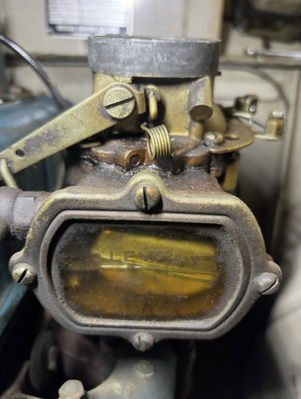

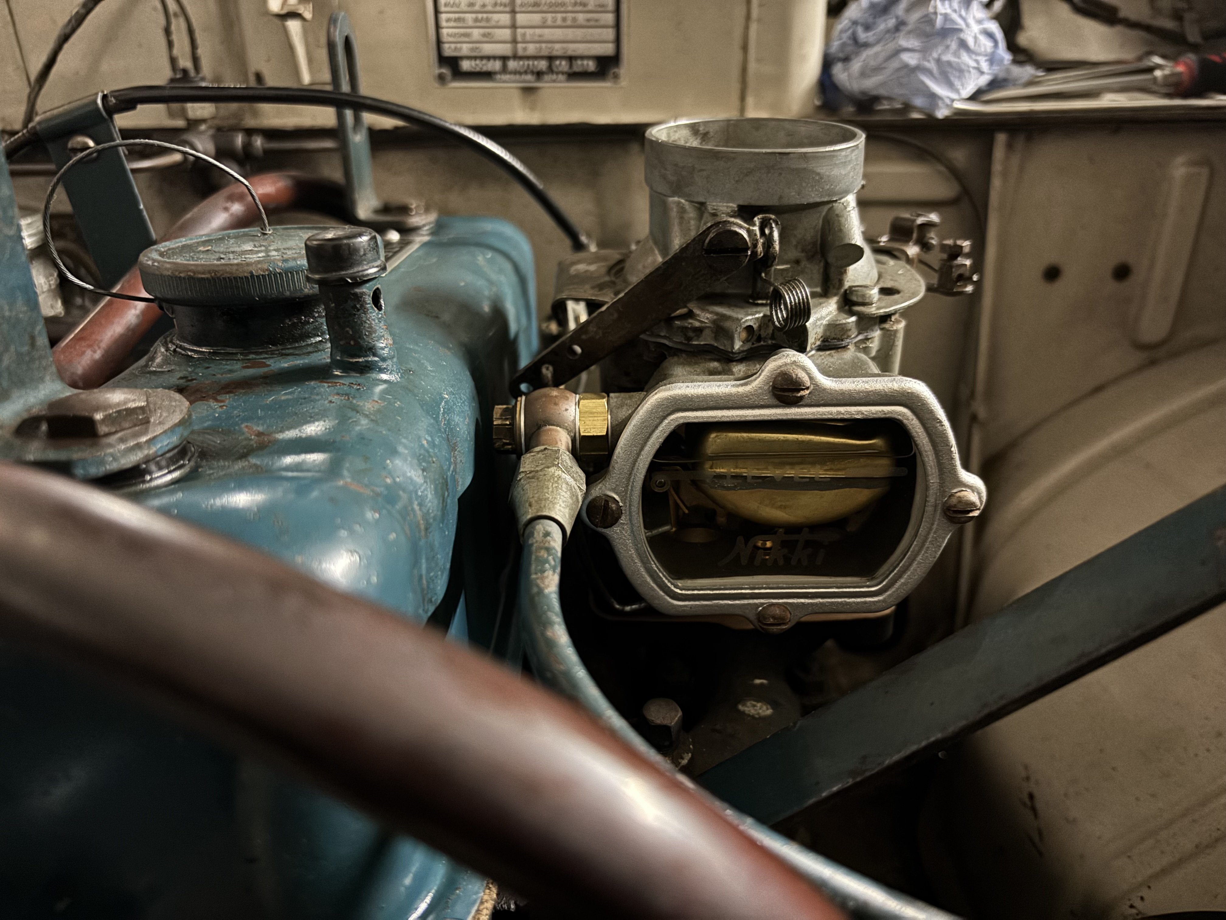

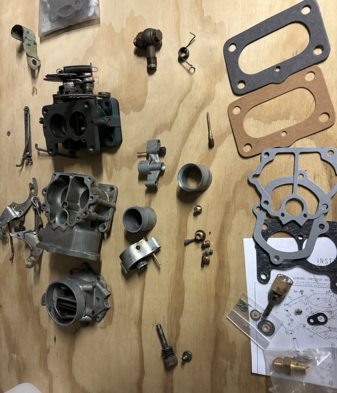

MRT1TRD Posted September 8 Author Posted September 8 So I could not find a new gasket set online so tried CDL which I had used previously for carb rebuild sets, and with a bit of back and forth I was sent a correct gasket set, which they claimed was the last one that they can get. 5 Quote

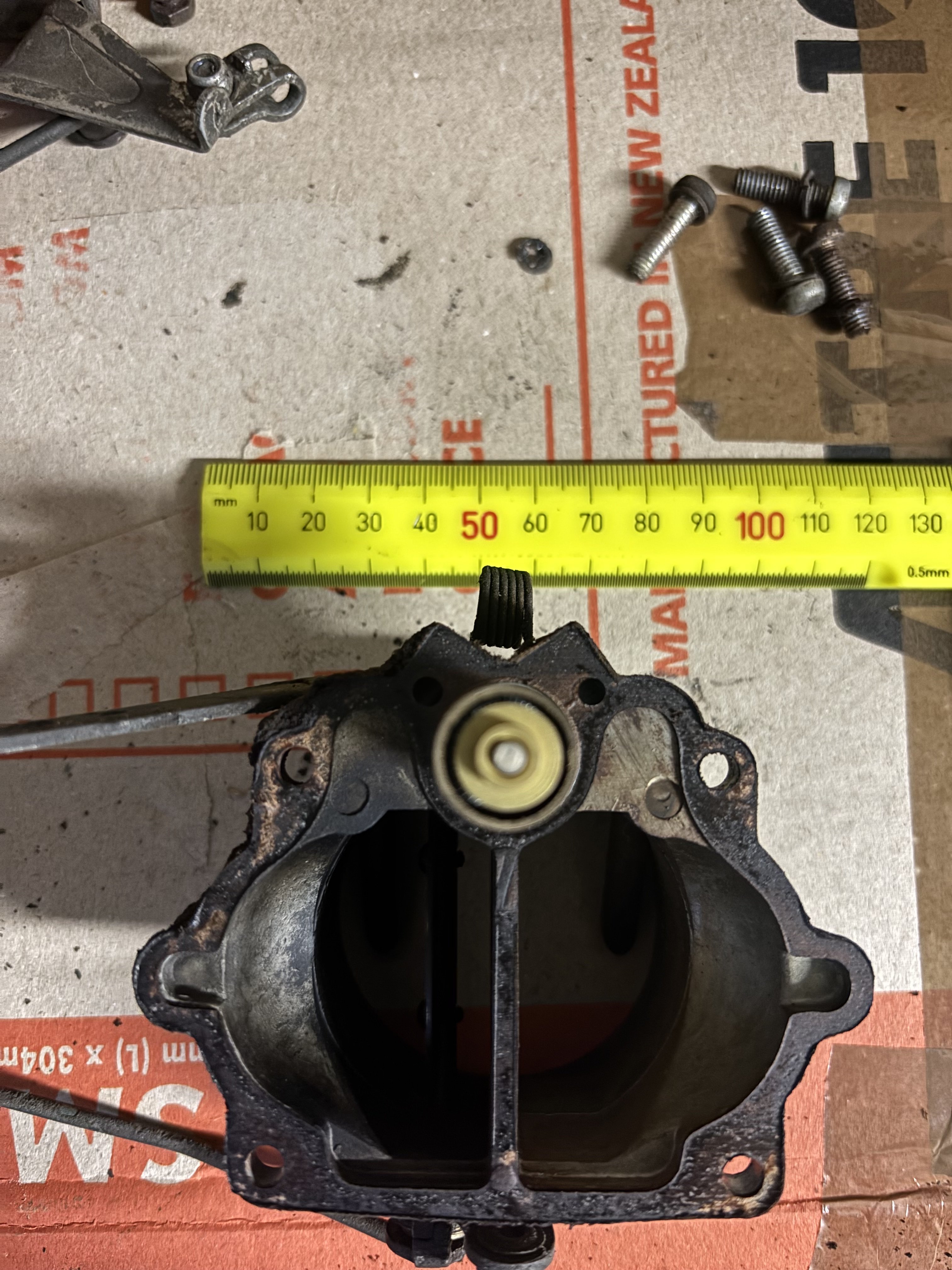

MRT1TRD Posted September 9 Author Posted September 9 I then brought a cheep ultrasonic cleaner and cleaned the parts, worked but I didn’t think it was any better than soaking parts in solvents 5 Quote
MRT1TRD Posted September 10 Author Posted September 10 Reassembled and swapped over the carb with the rebuilt one, I had to remove rocker cover to access the bolts, so I de-adjusted the rockers to spec while I was there (might need to remove head and fit valve seats one day) good thing about rebuilding the spare carb other than continue using vehicle is you can spot differences, the throttle cable on the car was cut short and they had reclocked the throttle cam which could of caused the engine to over rev with the return spring placement . 7 Quote
Popular Post MRT1TRD Posted September 11 Author Popular Post Posted September 11 So after I got the cable remade to the correct length and a bit of tuning, I took it out for a test drive and to sign up to a new club. Didn’t perform any faster but was smoother at low rpm and idle so I was quite pleased with my effort 16 Quote

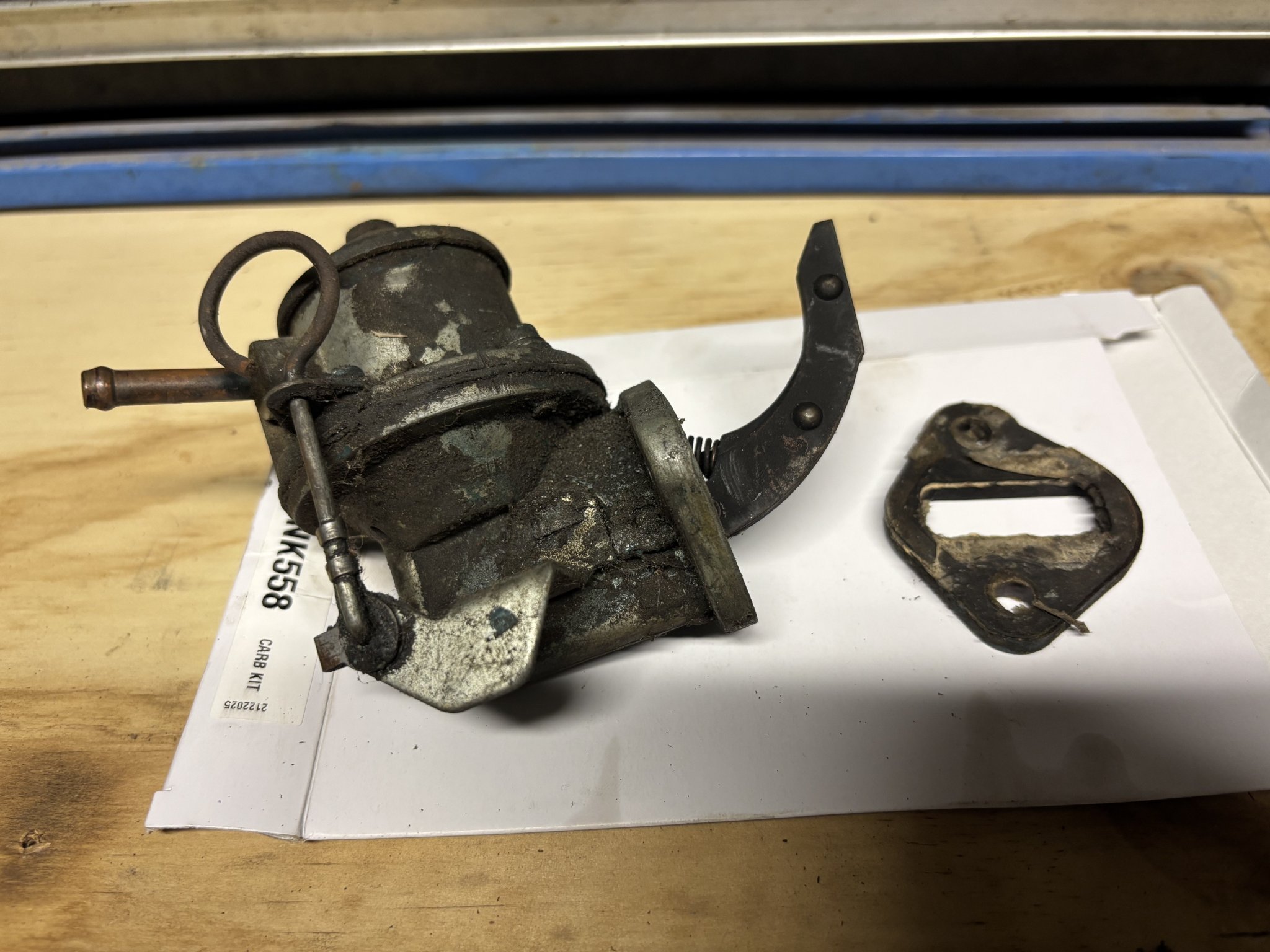

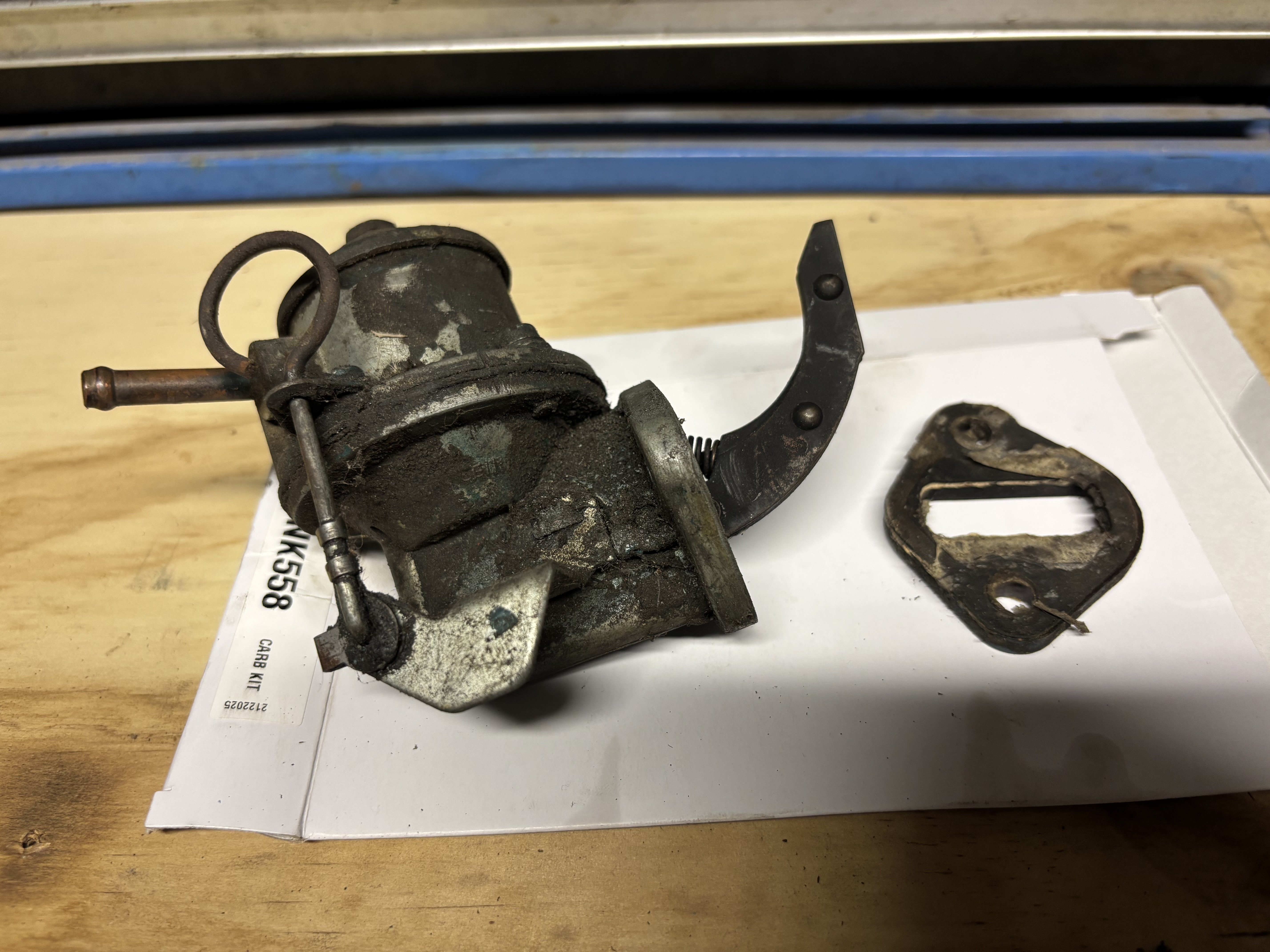

MRT1TRD Posted September 18 Author Posted September 18 Got a spare fuel pump from my collection, one on car is still working but primer lever was a struggle to fill the bowl 3 Quote
