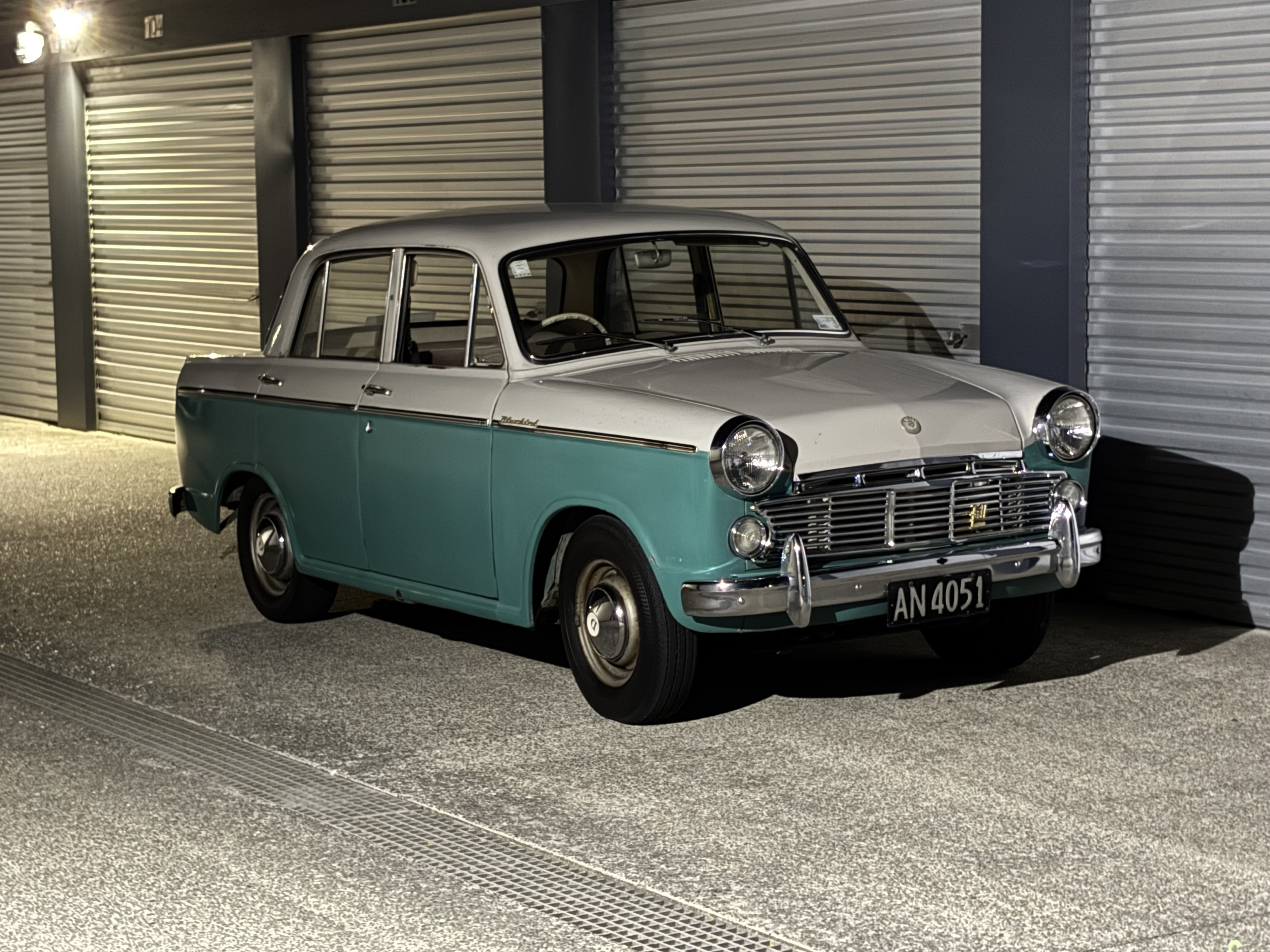

Popular Post MRT1TRD Posted June 10, 2025 Popular Post Posted June 10, 2025 So I purchased this in march for a decent price compared to repairing rust on my other cars, It’s a 1962 Datsun Bluebird sold New in Chch and after two family owners I own it. needs a bit of mechanical refinement but came wof and reg 23 Quote

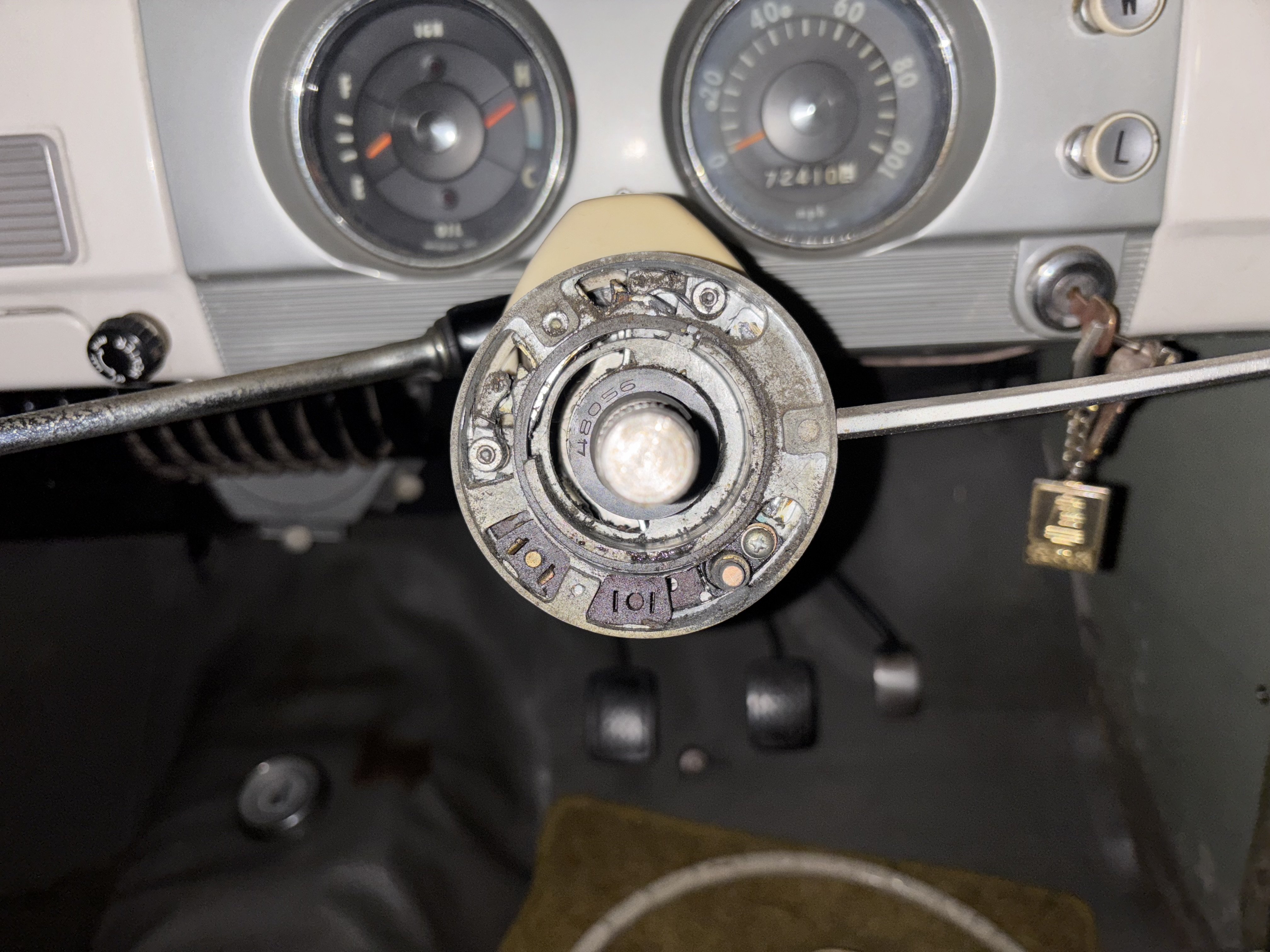

Popular Post MRT1TRD Posted June 13, 2025 Author Popular Post Posted June 13, 2025 So before I picked it up I had already planned its first outing in two weeks but had a few things to fix (tho lockup rules state no working on vehicles) first was the LH Indicator not selecting. so after carefully removing the cracked bakerlight wheel I cleaned and played with the mechanism to get it working again. 22 Quote
