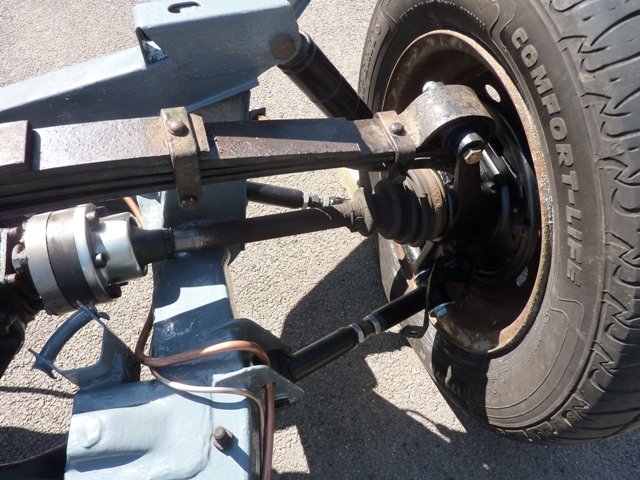

VitesseEFI Posted June 7, 2025 Posted June 7, 2025 Ok. Driveshaft UJs are probably the weakest link with the Blackline fitted. CV shafts are a nice solution. I was selling conversion kits for a while which used MGF/Rover 100 outer CVs and shafts with Volvo 340 CVs at the inner end also replacing the hubs and wheel bearings with Rover 100/MGF parts, but Rover 100s and Volvo 340s are basically extinct now. There are shafts available in the UK that bolt right up using the standard hubs and bearings but fairly pricey. There original rotoflex arrangement can reasonably reliable but only with DECENT donuts! It’s very scary when they give way in service. The diff rear casing has a boss already in the casting which can be drilled and tapped for a drain plug. 2 Quote
gibbon Posted June 8, 2025 Author Posted June 8, 2025 7 hours ago, VitesseEFI said: Ok. Driveshaft UJs are probably the weakest link with the Blackline fitted. CV shafts are a nice solution. I was selling conversion kits for a while which used MGF/Rover 100 outer CVs and shafts with Volvo 340 CVs at the inner end also replacing the hubs and wheel bearings with Rover 100/MGF parts, but Rover 100s and Volvo 340s are basically extinct now. There are shafts available in the UK that bolt right up using the standard hubs and bearings but fairly pricey. There original rotoflex arrangement can reasonably reliable but only with DECENT donuts! It’s very scary when they give way in service. The diff rear casing has a boss already in the casting which can be drilled and tapped for a drain plug. if you don't mind giving up trade secrets, was there much involved in putting your kits together? There's a couple of MGFs for bits on trademe and Volvo CVs are still available.. Quote
VitesseEFI Posted June 8, 2025 Posted June 8, 2025 No secrets…. Last set done was for my own GT6 in 2019 and there won’t be any more (though younger son is agitating for a pair for his Spit). But note that this particular route involves machining the vertical links to take the Rover/MGF bearing pack. Which is quite involved. If you are up for this (I can supply a drawing) then you need 2x front left driveshafts from a non-ABS Rover 100/Metro (not the Mini based one!), 2 x CVs from a Volvo 340 (4.4, 1.6D or 1.7 - not the 2.0 360 which has different splines) and 2x CV/UJ adapters (drawing available). Note that although the MGF LH shaft is a match for CV and splines it’s 20mm shorter. Potentially you could make the adapters 20mm longer but I think this will lead to chassis/inner CV being extremely close, if not interfering. Alternatively, my mk1 version involved Ford Escort (Euro!) mk4 1.6 manual driveshafts and again the Volvo 340 at the inner end with adapters. This used more or less standard hub/bearing and vertical links to take apart from a hub mod to alter the shim location and clamp the bearing properly (the original designer had some strange ideas). more on this here (my embarrassingly ancient site) https://www.shadetreegarage.co.uk/Vitds1.htm#top This last really just to present the idea that there are various OE part combinations that can be made to fit without huge effort. A further demonstration of that is that if you have the Rover 100 based conversion there is an existing Subaru CV that can be swapped for the Volvo one that allows use of the R160 diff with no further mods…. I should maybe also mention that there are a few examples of people using the Rover shafts with the Rover (FWD) vertical links to and also with the MGF vertical link….. which also gives rear disc brakes. Many possibilities - just got to find them. The other fairly common route is to get the outer part of the rotoflex shaft turned down and fitted with a UJ flange and making up a sliding spline shaft with UJ at each end. The was a UK specialist offering these but dunno if he still is. There was even a story about someone using off the shelf PTO shafts from some piece of farm machinery but I’ve never managed to discover if that’s remotely true! Confused now? 5 Quote
