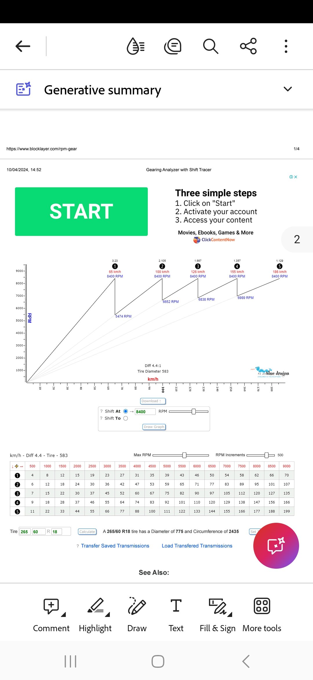

mjrstar Posted May 27 Author Posted May 27 Example here is my POS with aftermarket 3,4,5 gears I had to raid the input shaft and 2nd gear from my mates DA Integra with over 300,000km, as the 2nd gear in my existing gear kit was almost the same as the aftermarket 3rd gear. Quote
