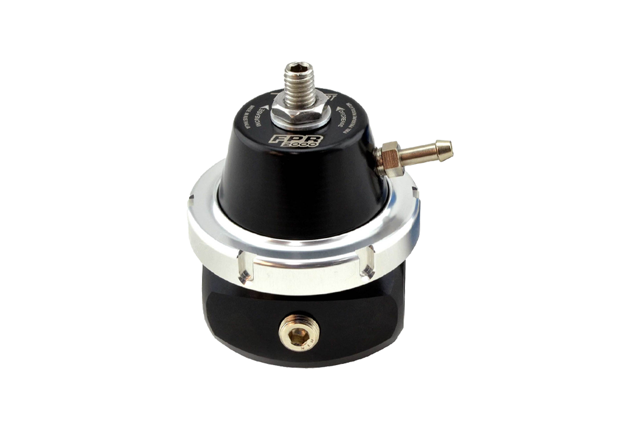

shrike Posted May 24, 2025 Author Posted May 24, 2025 Few more things turned up, think I may have ordered a couple of things by mistake but all good. Should make more sense when other orders arrive Got the AN6 adapters for the Gearbox oil cooler at least Most of the fittings to run the factory fuel rail with AN6 lines Or run this aftermarket one Aftermarket one needs some clean up Few rough bits to clean up EDIT ran my pocket debur tool over the ports and its cleaned up fine Edit 2 the -8AN to -8AN ORB will probably need drilling out as the ID on the orbside is smaller then my -6AN fittings lol, the -10AN to -8AN ORB is the correct ID for -8AN on the ORB side but could be drilled out to -10AN the whole way through. Will compare to my Aeroflow fittings in NZ and the other AN fittings when they turn up I've got 10mm drill bit so can enlarge the -8AN out if needed 0.39" is 9.9mm so .1mm bigger won't be an issue 0.30" is 7.62mm so 2.28mm smaller then it should be (will be fine on a stock engine but may be an issue when I add boost) I have a 12mm bit for the -10AN to -8AN ORB as well but less worried about that one Overall the fittings are good quality, this -8AN one im not sure why its not drilled out more but its easy to fix 2 Quote

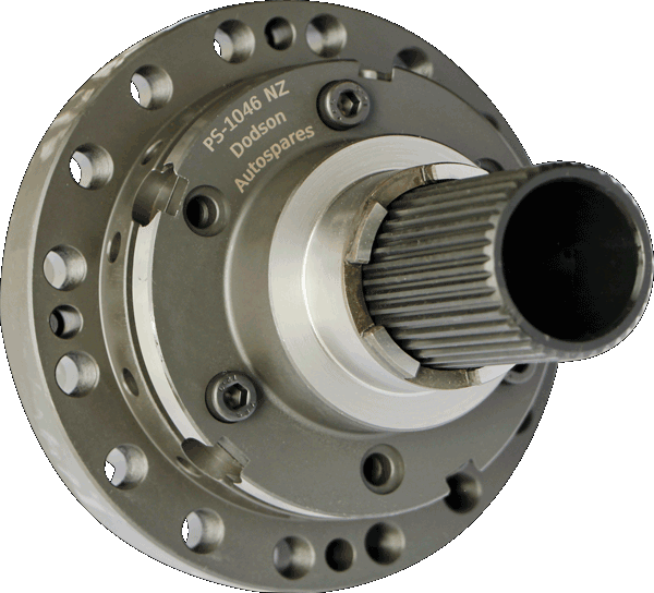

shrike Posted May 28, 2025 Author Posted May 28, 2025 So was emailing a little with Uniclutch today as I saw their product on the latest Mighty Car Mods GTR video and I also sent some notes to Steve as well https://www.youtube.com/@uniclutch And I thought the idea was pretty cool, as I am not sure which gearbox ill be using yet a clutch that can do both is very appealing Disclaimer most of the pics below are found on the internet and not of my actual items Clutch notes: Honda CRV gearbox has similar bell housing clearance to the GT4 gearbox Uniclutch do some interesting clutch options they don't currently do custom flywheels (plenty of places in NZ do custom flywheels though if needed) They offer a clutch kit that you can change the splines on so one clutch could work with either the CRV or GT4 gearbox "550kw and roughly ~840 Nm power, you'll be at the safe limit of the 8-inch Track UniClutch (which is the only unit that will fit K24 and 3SGTE). it will still be usable and safe, but if your power goals exceed this, please let us know as you may need to work out something more custom to adapt a 10-inch UniClutch instead." So the 7.25" clutch options ive been looking may not have been great long term but its still a consideration to explore as id been looking at Tilton and Quartermaster clutch setups I like the uniclutch option as it means I can use either gearbox, the UniClutch Track drives amazingly. you'd be surprised it was even a heavier duty clutch than OEM. yes, we have a fitment ring for the K24 and also the spline for the Toyota gearboxes (21T x 29.0mm). depending on which flywheel you end up with, the spline will most likely be included. we also have the spline for the CRV gearbox in most of those kits also if that's the path you'd like to take. the UniClutch diaphragm design works with hydraulic and fork style release bearing. you just need to be aware of the 48mm minimum bearing contact diameter. if you have a hydraulic release bearing you'd like to use, send it through and I may be able to confirm over email if it's good. as mentioned, we don't have a flywheel available. the UniClutch will bolt to the majority of OEM and aftermarket flywheels using the appropriate fitting kit. rule of thumb is that if an OEM clutch works with the flywheel you're choosing, then we will likely have a fitment kit to suit. Gearbox notes: The CRV gearbox doesn't have the CV shaft come out of the transfer case like the GT4 Box, as you can see below it has a half shaft similar to a fwd gearbox I know with the E153 Gearbox from the MR2 the Half shaft is bigger and is pretty tight "Cannibal" Kit Instructions | Hux Racing And they redrill the 3SGTE flywheel to suit the K24 Crank bolt pattern K24 Flywheel is the same Diameter as the 3SGTE flywheel 305mm and both are 120 Teeth K24 Flywheel is more compact then 3SGTE flywheel I am not sure if we could shave the block and the GT4 transfer case to make it fit, and id rather not shave the GT4 transfer case, as if it won't work then id like to try sell it as I think they go for ok money (esp with a front LSD) I wonder if there is an option to do a Billet transfer case that would be smaller diameter? The AE115 Gearbox (E59F) may have a smaller transfer case but im not sure it it would fit on the GT4 box plus I think its a narrow gear instead of a wide gear (May have confirmed its Narrow below as the 5th gear cover us Steel rather then Cast) Which is why I got the E51 or E52 box with the 3rd gear issue as it was wide gear so the bell-housing should work on the GT4 box as I am unsure if the narrow gear bell-housing would work Im also not sure which of the 4A or 3S bell-housing will be the best to work with for an adapter anyway, I think I prefer the starter motor location on the 3S bell housing but the 4A might be better as it gets it at the back of the engine And im more open to modifying the 4A bell-housing as its on a box (E51 or E52) that already has issues with the 3rd gear Also while I remember (I don't think I need clearance however) The Narrow Geared E Series boxes (Rav4 (E250F), E56 & E58 (AE101 GTZ) E59F (AE115?) have a steel 5th gear cover that is smaller then the Alloy cast cover so may be an option to swap if we need clearance on that side. To fit the CRV box we would need to Gear selector setup? (not sure if my existing one would work) Shorten and re-spline both front CV CRV axles to work with Toyota ST185 or ST205 Front outer CV joint Custom prop-shaft (transfer to diff) (not worried about this as most likely needed one anyway) Modifications to correct diff ratio as front and rear don't match (even factory honda diffs don't at 2.529:1) (multiple options below not sure if I really like any of them tbh) Factory CRV isn't full time AWD so the diff ratio not matching isn't an issue as the rear diff turns on and off as needed Auto front transfer case and run 35 profile front tyres and 40 profile rears to get the diff ratio closer (and if we haven't pinned/locked the front transfer this should be ok to start) Custom transfer gear 0.3778 ratio (factory is 0.434 for the Manual and 0.393 for the Auto) Custom Rear diff ratio of 2.549:1 (hard as nothing off the shelf and the Celica rear diff is a 6.7" T series diff but is potentially different to other T series) Factory Celica ratio is 2.928:1 Auto front transfer case and change rear diff to a Jag X type X400 (Currently no LSD option but one coming, and the diffs are pretty cheap so I could get two and weld one up etc ) New rear diff mounts to suit Re-spline and shorten rear driveshafts to suit Toyota ST185 or ST205 Rear outer CV joints There is also a corvette that has a 2.59:1 rear diff but its not a very common diff so availability is an issue Can happen later ie once the cars going and potentially shipped over to me in Aus Front LSD Pin/lock CRV transfer case so its 100% AWD ( there is a clutch pack option for this) Might need billet transfer case and upgraded transfer gears depending on power being run CRV/Honda gearboxes in general aren't know for taking power so would probably need to build it with a gear-set to handle the turbo Maybe I need to start stockpiling gearboxes along with engines :p Though I may pick up a cheap complete CRV if need be Edit: adding to this the E51/52, E56, E58, E59F, E153, E15XF & E59F all share the same clutch Spline of 29mm and 21 Teeth. Factory 4AGE (20v), 7AFE/4AFE (FWD gearbox) are 23.8mm X 21 Teeth. 3 Quote
fuel Posted May 28, 2025 Posted May 28, 2025 keep in mind the Honda 4WD system is kind of like Haldex where there is no center diff and it relies on a viscous coupling or electronically controlled clutch pack on the rear diff to allow and control slip between the front and rear axles. The Toyota 4WD has the center diff in the gearbox in place of where a usual FWD front diff would be, and then spits out two output shafts to the transfer case that houses the front diff as well as a LSD for the center diff. 4 Quote
shrike Posted May 28, 2025 Author Posted May 28, 2025 5 hours ago, fuel said: keep in mind the Honda 4WD system is kind of like Haldex where there is no center diff and it relies on a viscous coupling or electronically controlled clutch pack on the rear diff to allow and control slip between the front and rear axles. The Toyota 4WD has the center diff in the gearbox in place of where a usual FWD front diff would be, and then spits out two output shafts to the transfer case that houses the front diff as well as a LSD for the center diff. Yeah if I went the CRV AWD route id be pinning/locking the transfer case so its full time AWD and id be running a real diff at the back thats not electronicly controlled. Though thinking about it, would there be a benefit of only having the awd kick in when needed? Still it would probably need mods it handle the power output Quote
fuel Posted May 28, 2025 Posted May 28, 2025 Do you plan on street driving it at all, or just wanting to turn around in a car park without it hopping and skipping away? You really need some kind of differential or slip between the front and rear axles and locking it to be full time AWD will definitely introduce some drivability issues. *edit * just realised I've been responding within a build thread post whoops - though figured this should be in other projects section given its (lack of) age? 3 Quote
