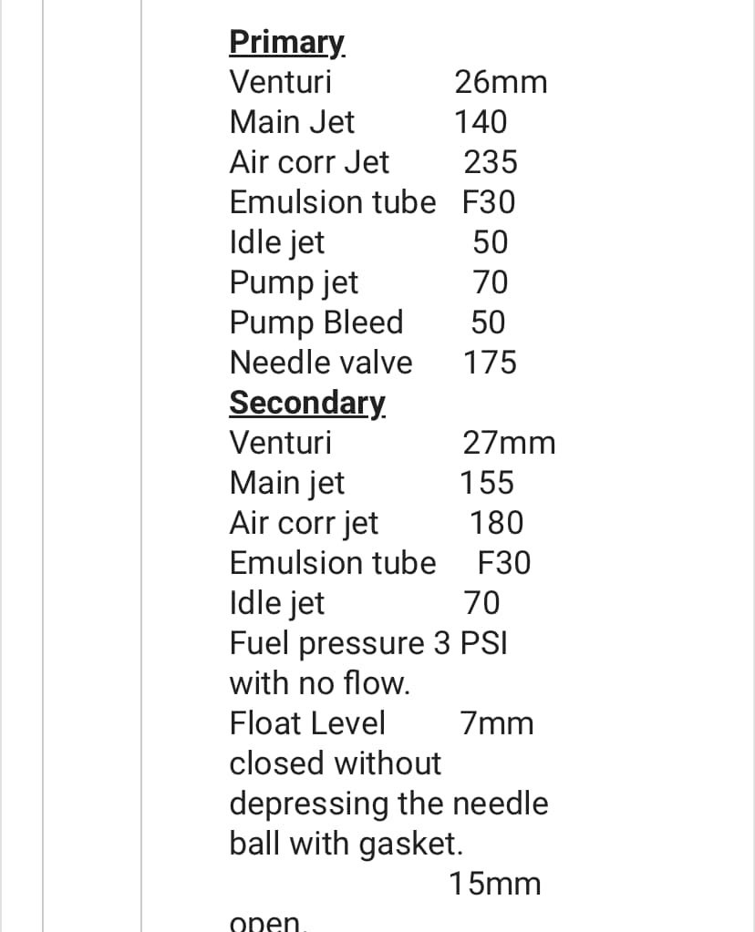

Glad you rescued this. Much love for the round eye. Any tips on setting up a 5k with a 32/36? Mate owns my old kp61 and it's always been a bit flat. He drives like a pussy so I swear it runs worse than ever now. I never got around to having a good tutu before I sold it but I recall that when you cracked the choke it would find another 1000rpm. Normally it falls off a cliff at 5k rpm and it feels generally pretty slow. Certainly not the 81hp of thunder you are wrestling. I need to go through dizzy advance etc I think as well as jetting. Any starting points on jets appreciated, but perhaps we should get an afr gauge for it?

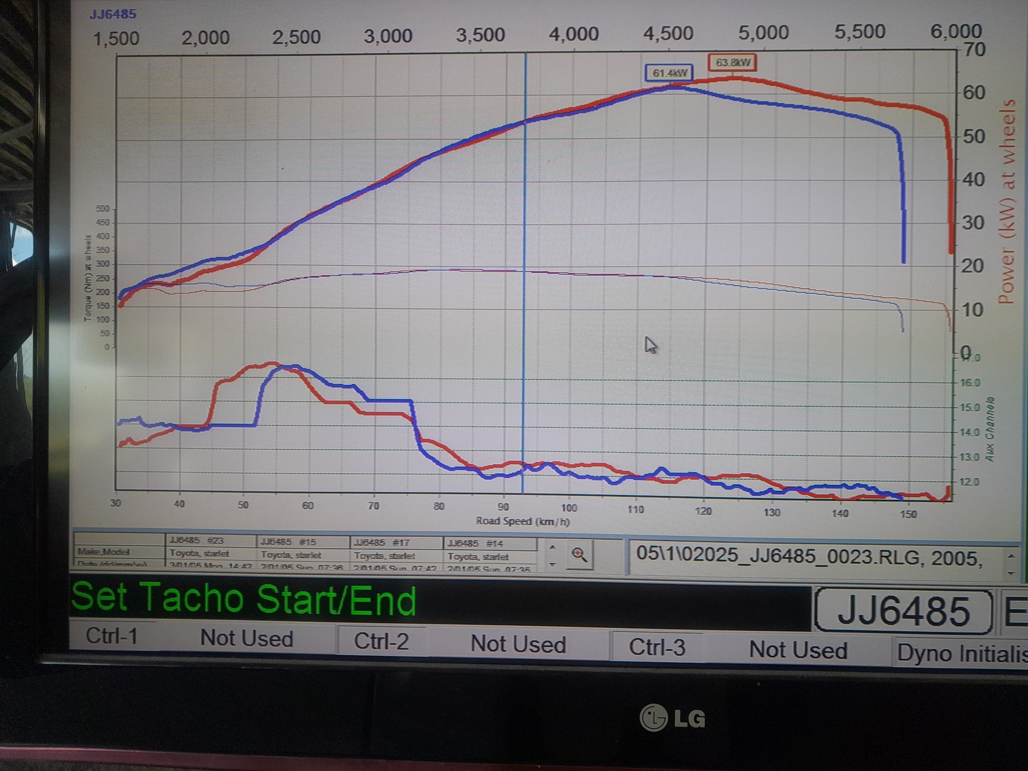

blue stock head.  red ported head.    just needs that cam upgrade to keep zinging.
I think the 32-36 is pretty big on a lil 5k
i had a 28/36 dcd of a gt cortina and it was pretty well suited, I’ll have the jet and choke sizes written down somewhere

This is what I was running, was a bit rich down low so I had a 40 & 45 primary idle jet to try out but never got around to it
