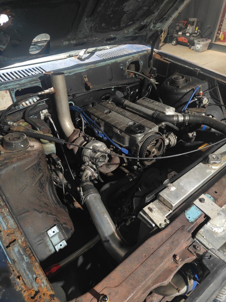

lowlancer Posted April 7 Posted April 7 Good god that's hory, I love it. What was the engine build? Would love some details on it Quote
lush Posted April 8 Posted April 8  4g63 sohc block from an L200 I dragged out of a paddock Starion pistons, second hand re used rings and bearings. Fwd 8v 4g63 sohc head Balance shaft delete Fwd intake cut shut for rwd Starion exhaust manifold Td05 turbo 38mm external gate 13psi 510cc Evo injector Nzefi ECU I think? Original build melted a piston because boost solenoid played up and let it do over 20psi this is second build. Currently I need to upgrade the clutch it was grabbing gears but is slipping now 1 Quote

lowlancer Posted April 8 Posted April 8 5 hours ago, lush said:  4g63 sohc block from an L200 I dragged out of a paddock Starion pistons, second hand re used rings and bearings. Fwd 8v 4g63 sohc head Balance shaft delete Fwd intake cut shut for rwd Starion exhaust manifold Td05 turbo 38mm external gate 13psi 510cc Evo injector Nzefi ECU I think? Original build melted a piston because boost solenoid played up and let it do over 20psi this is second build. Currently I need to upgrade the clutch it was grabbing gears but is slipping now Sounds mental. I remember when SOHC 4g63ts could be had for under a hundy out of the Loot/T+E. Good times 1 Quote
