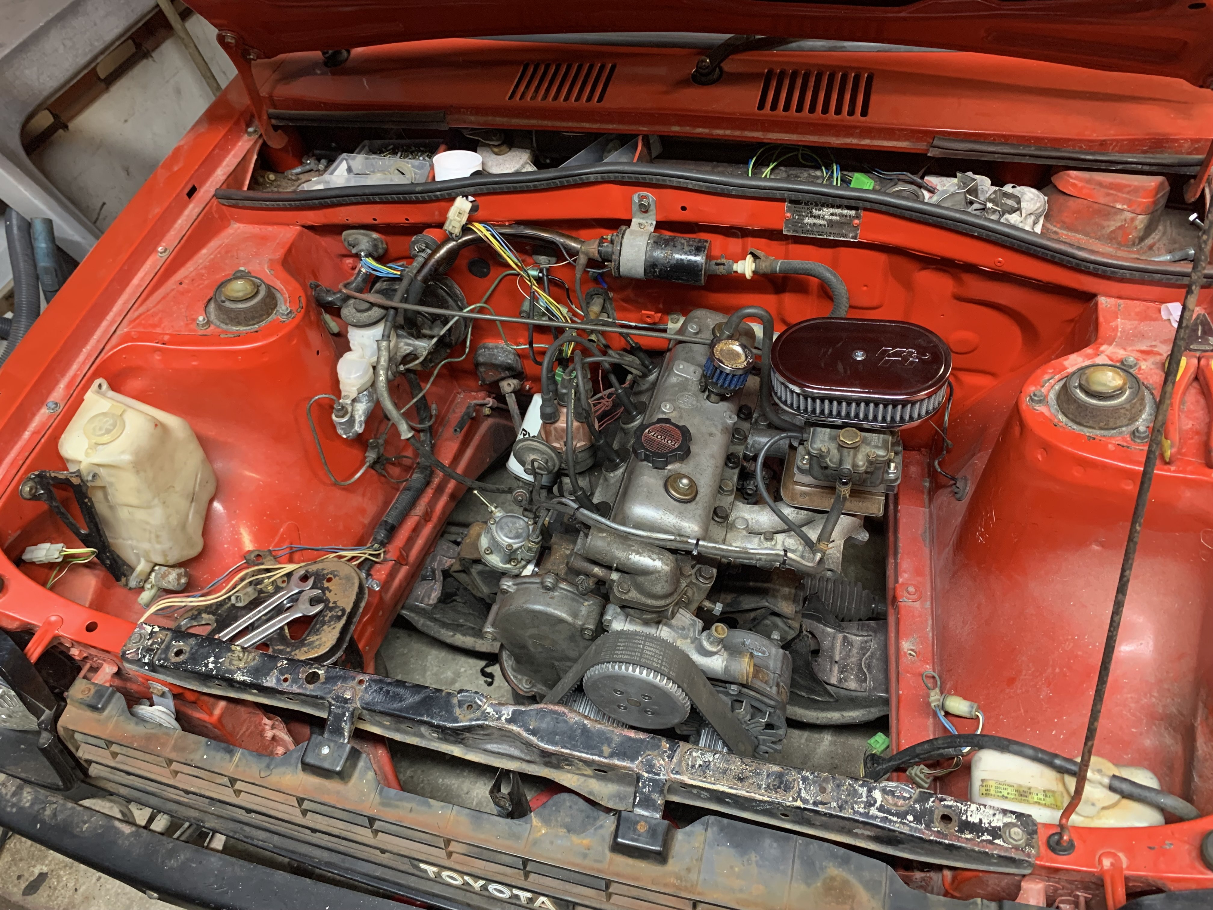

Dudley Posted April 5, 2025 Author Posted April 5, 2025 Decided the previous owner had a monkey slapping cymbols in his head istead of a brain, and now it’s time to de butcher the car with some fresh butchery 1 4 Quote

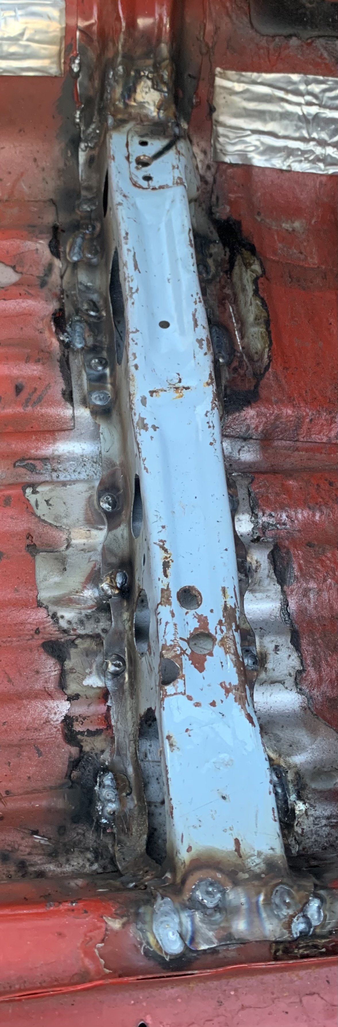

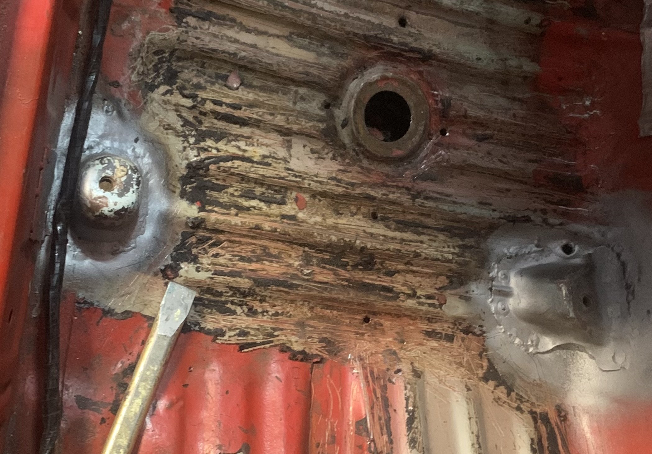

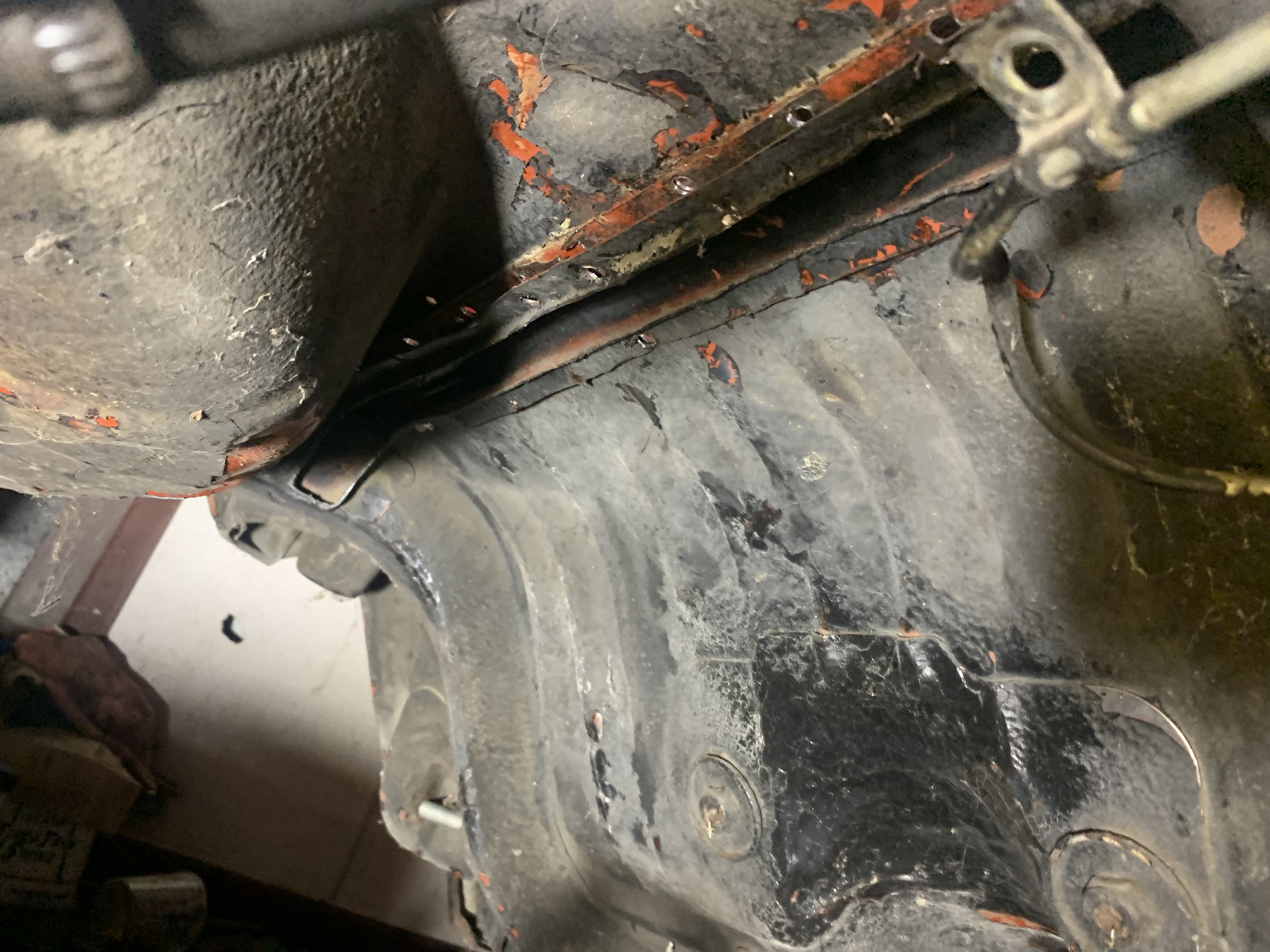

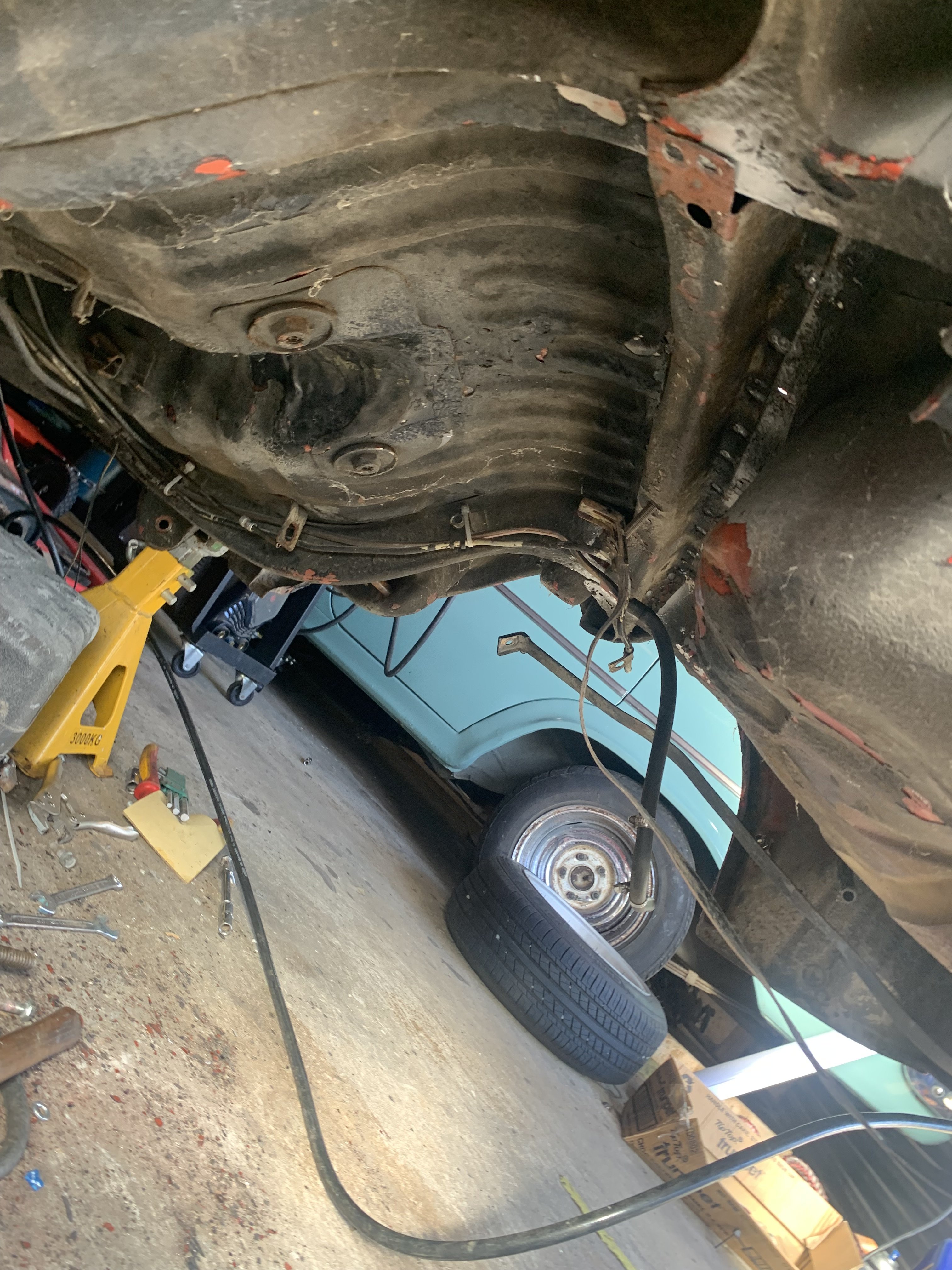

Dudley Posted April 5, 2025 Author Posted April 5, 2025 First order of business, old m8 installed a hilux diff, he then decided the chassis rail was in the way so he cut the whole bottom off that, which means you cannot bolt up a fuel tank anymore, and it’s missing a bloody chassis rail 2 1 Quote

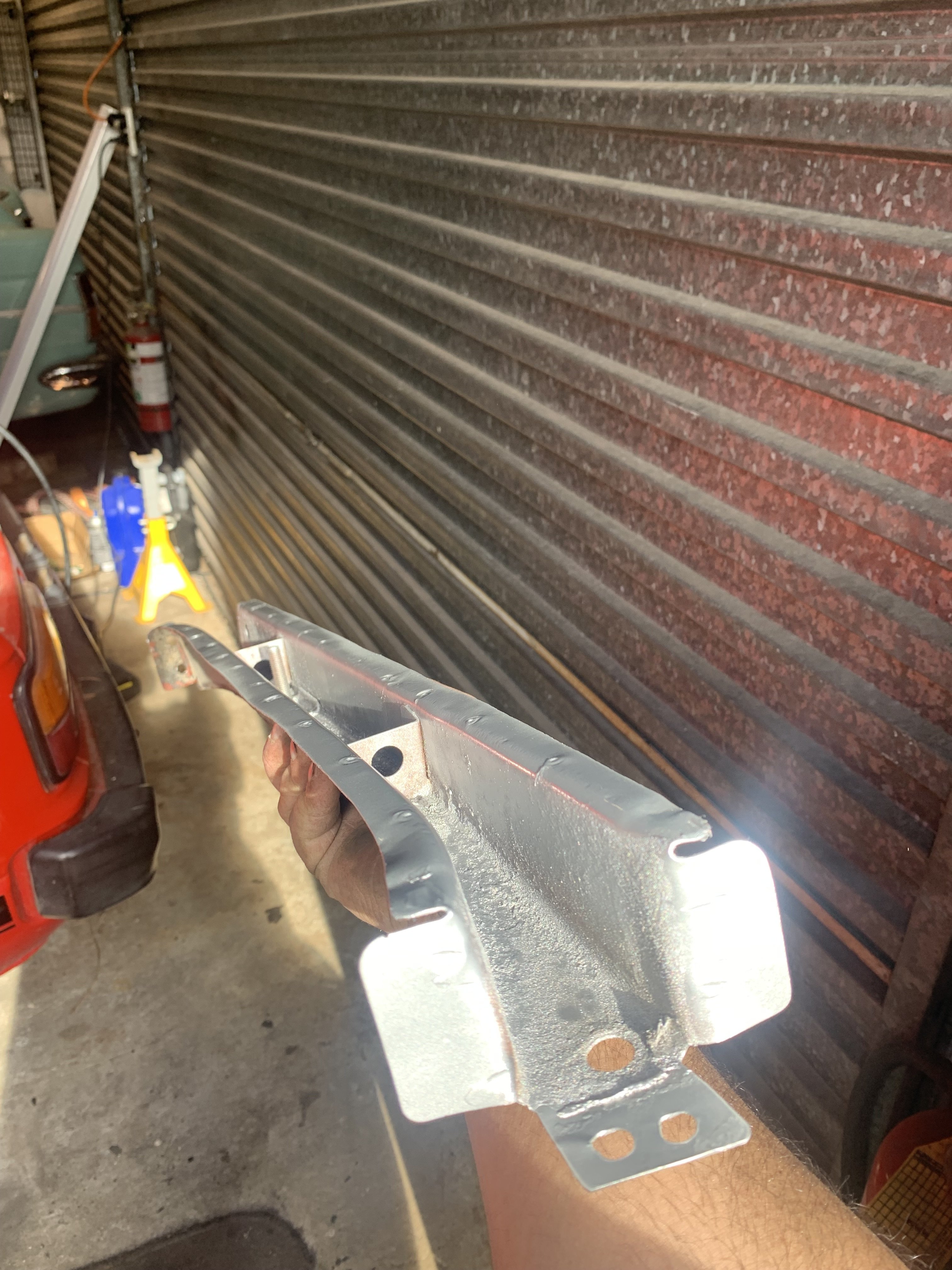

Dudley Posted April 5, 2025 Author Posted April 5, 2025 Turn welder to max booger mode and buzz a rail in Quote

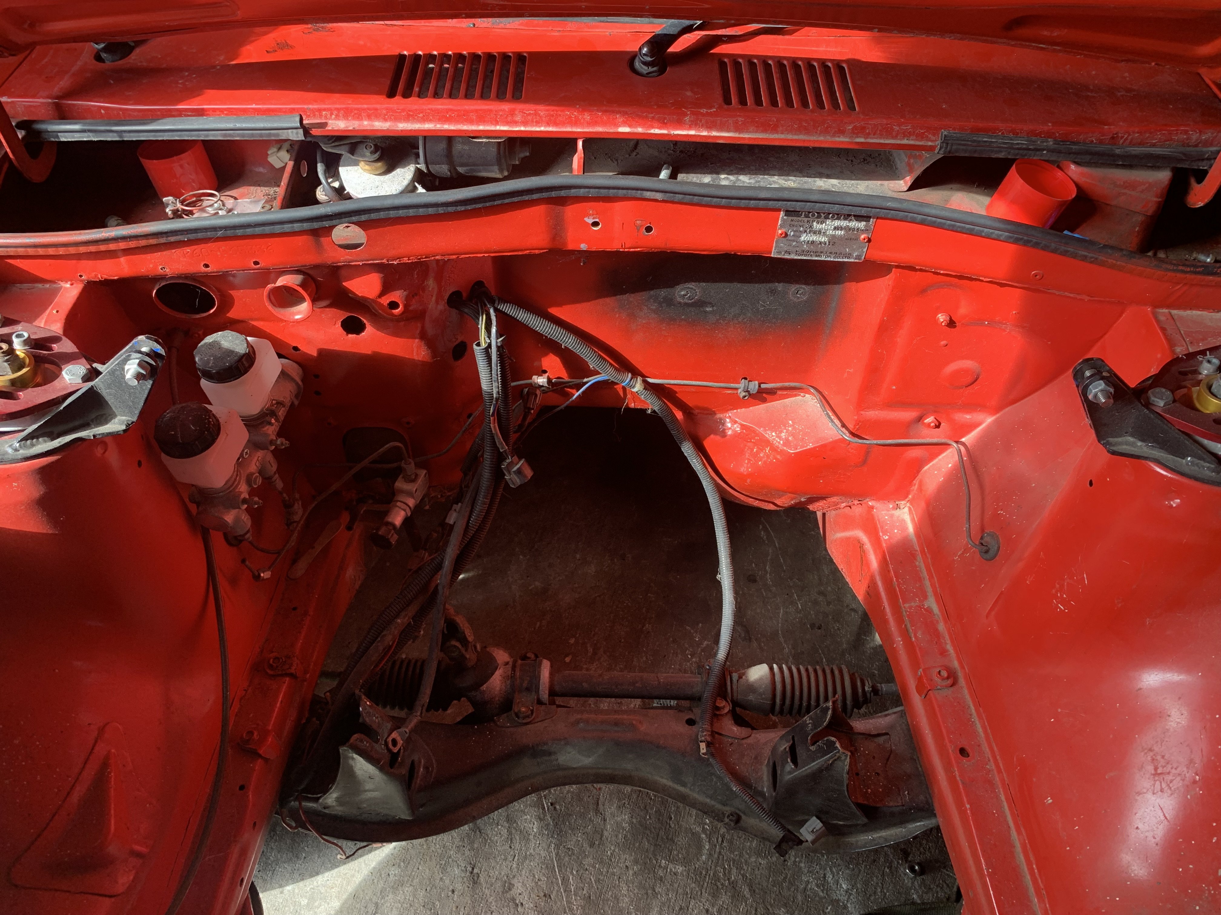

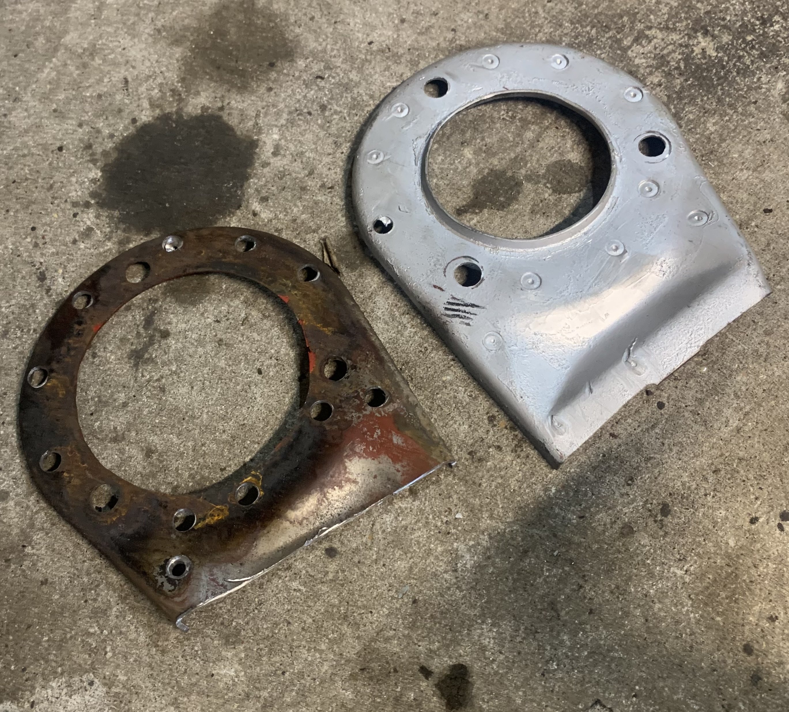

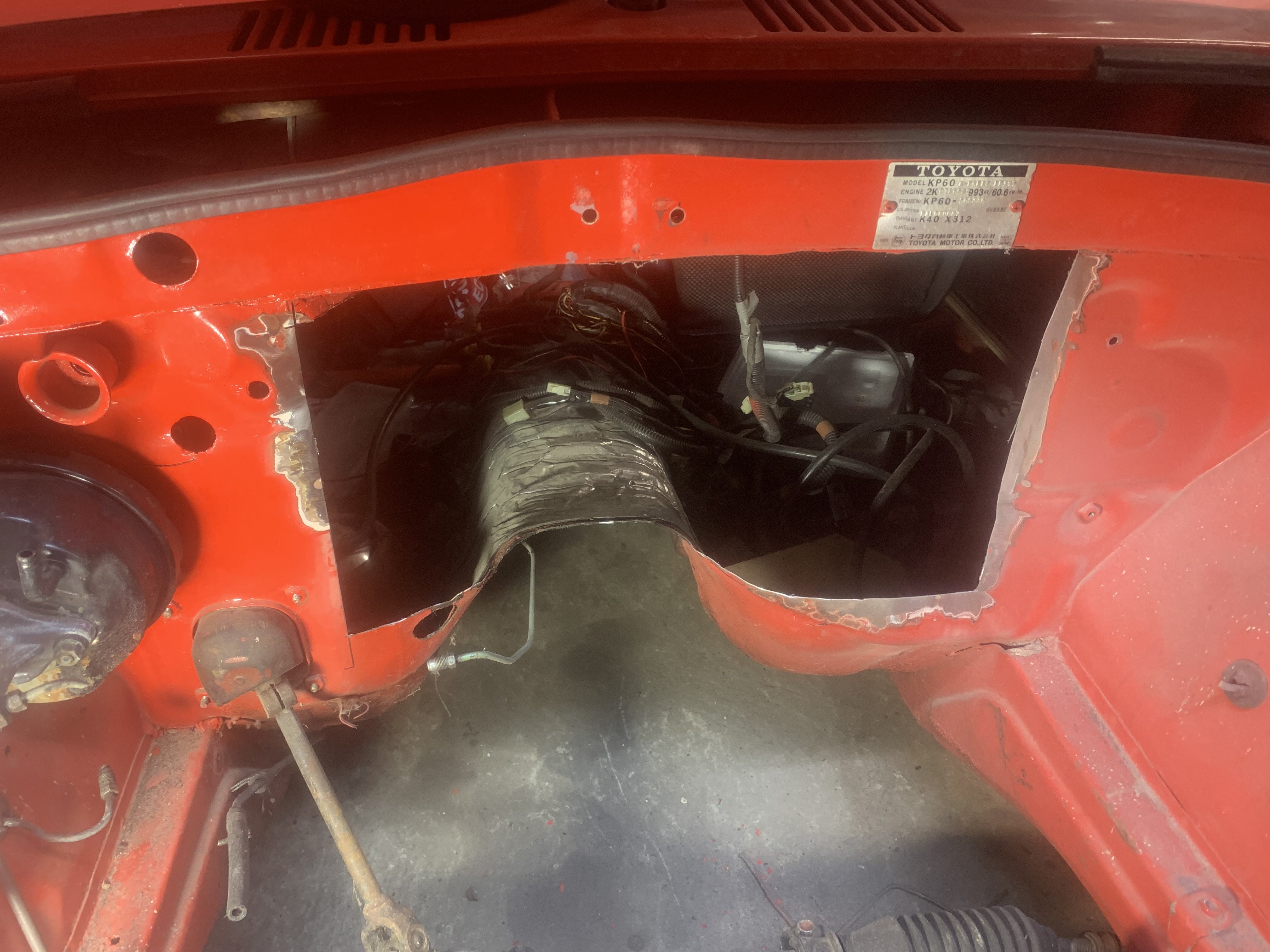

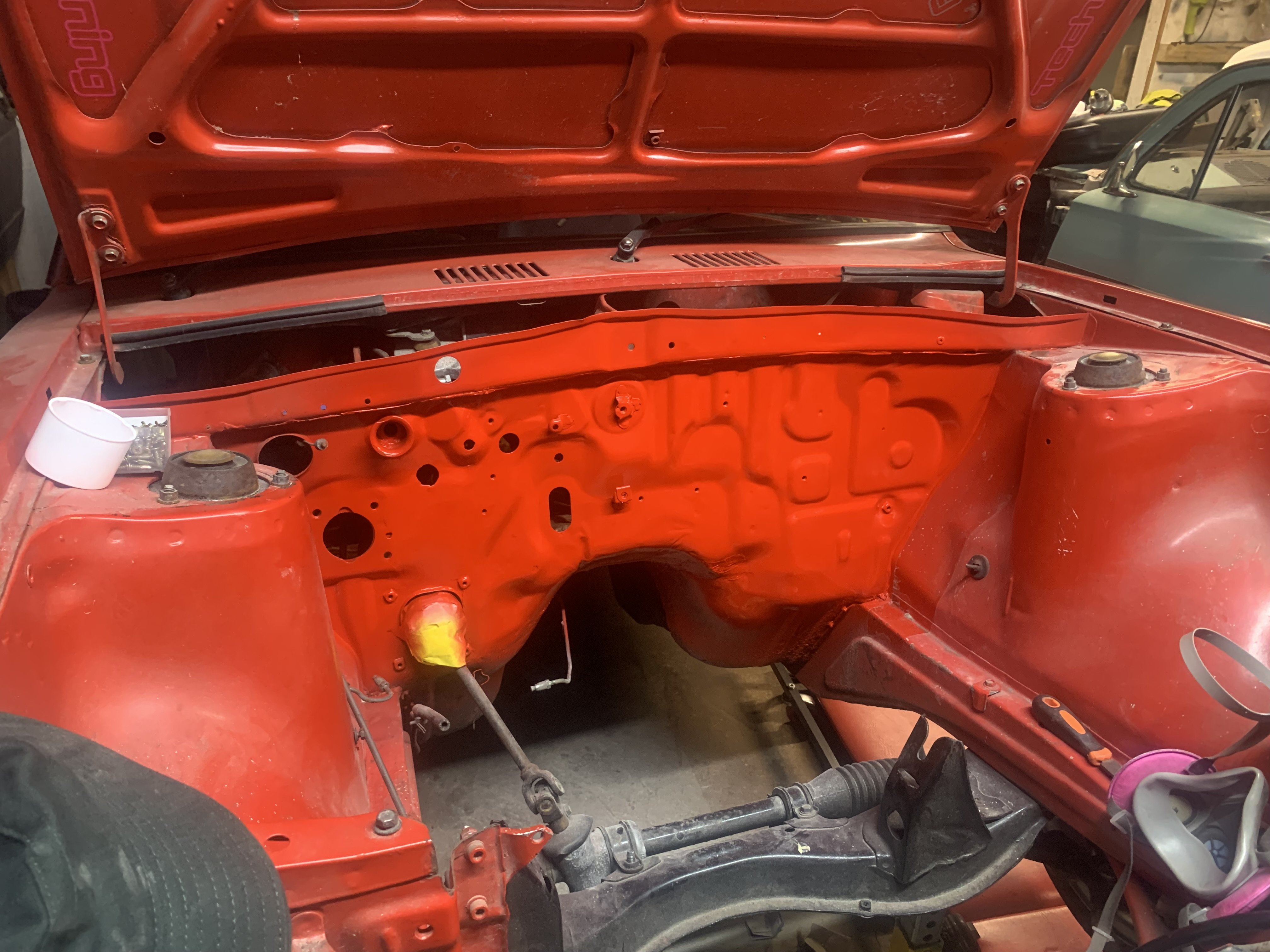

Dudley Posted April 5, 2025 Author Posted April 5, 2025 Then decide that his super sweet fire wall mods should also go, so chopped that crap out and zinged another fire wall In 4 Quote

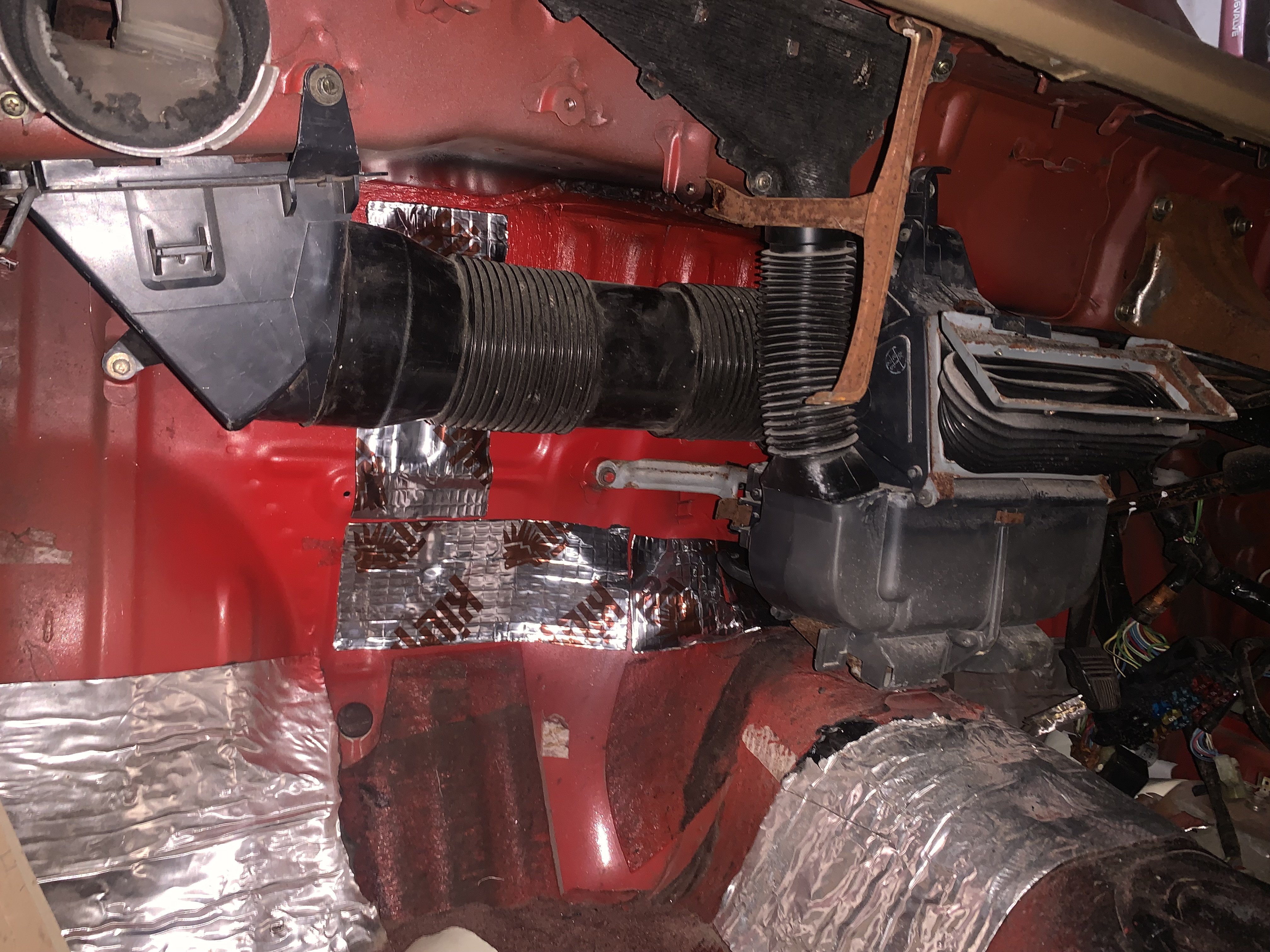

Dudley Posted April 5, 2025 Author Posted April 5, 2025 Next step add heater, loom dash etc shout out @AE25 for the bugeye loom parts, looking forward to the update on the four door bugeye mate 1 Quote

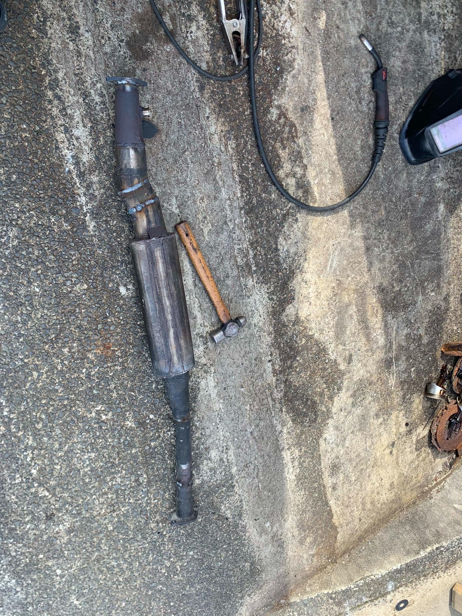

Dudley Posted April 5, 2025 Author Posted April 5, 2025 At this point I was reading the oldschool how to exhaust thread, in conclusion I needed a 3” exhaust. luckily for him I work with the sensei himself @kprand I basically raided his scrap bin for his old half exhaust Quote

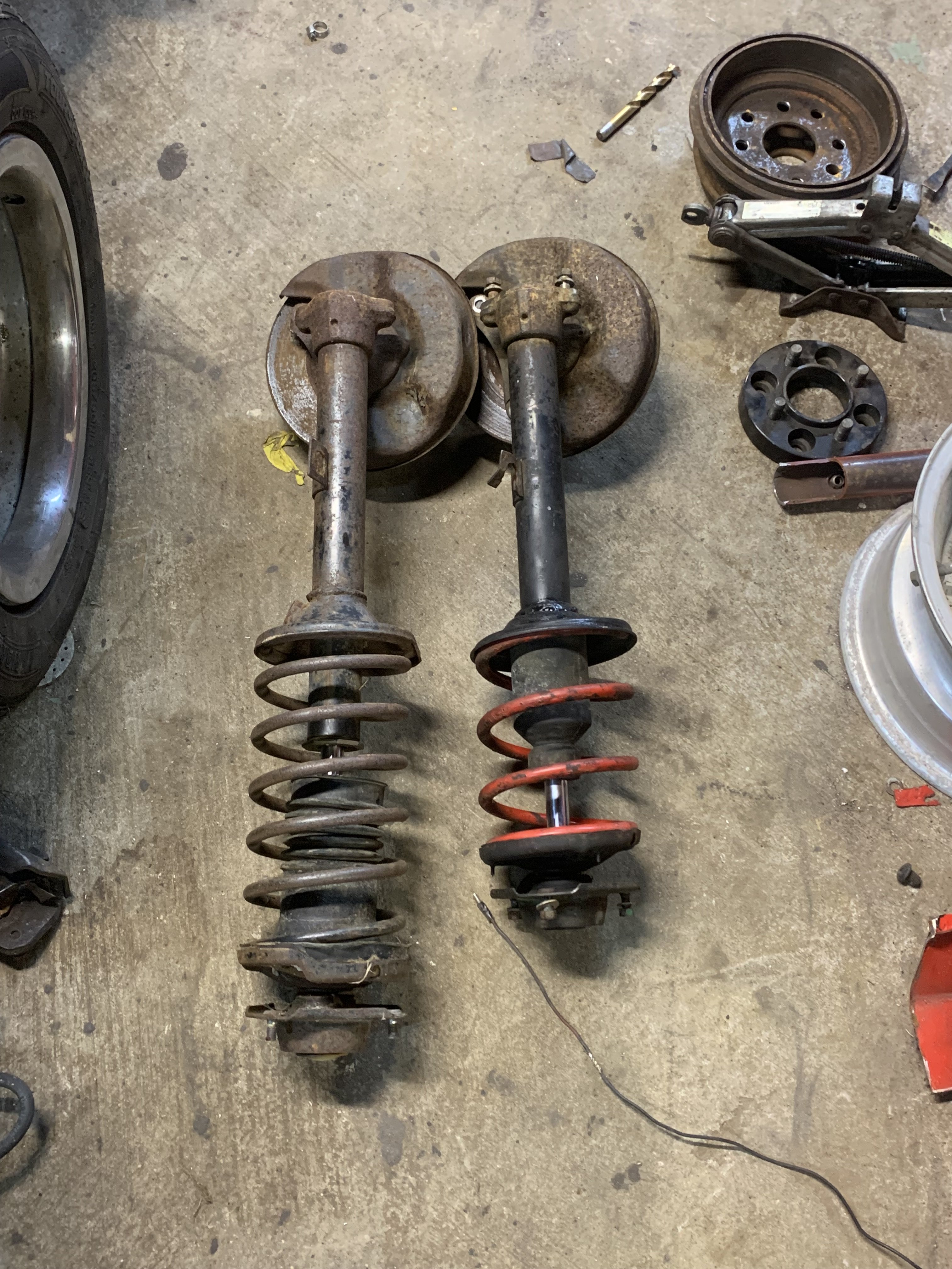

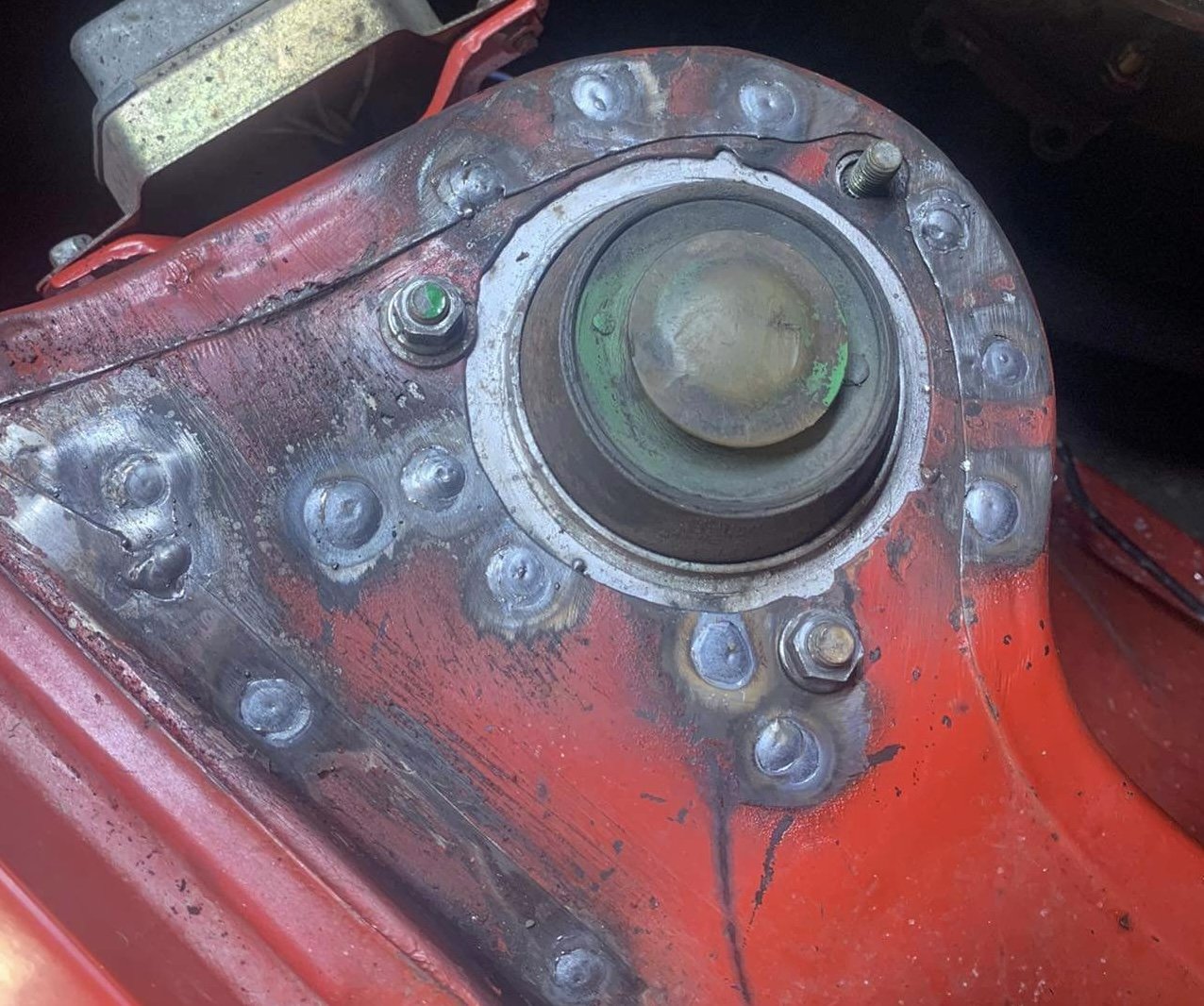

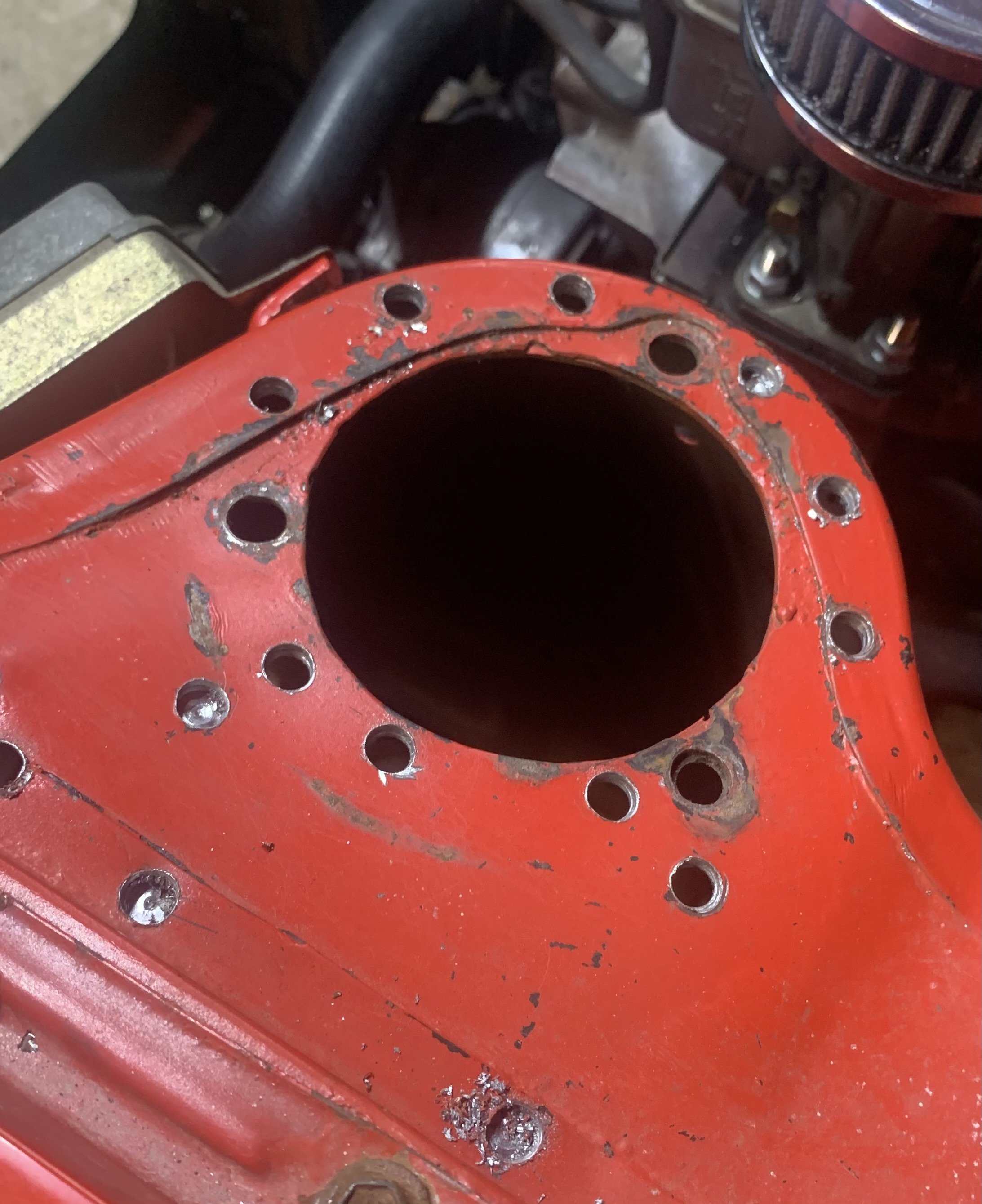

Dudley Posted April 5, 2025 Author Posted April 5, 2025 He also decided to do a pro move, he drilled the strut towers out so the old coilover setup could slip past and get free low, he then removed the studs from the top hats and used some good ol Bunnings hardware to fast the struts in, once again I zinged some og steel back in 5 Quote

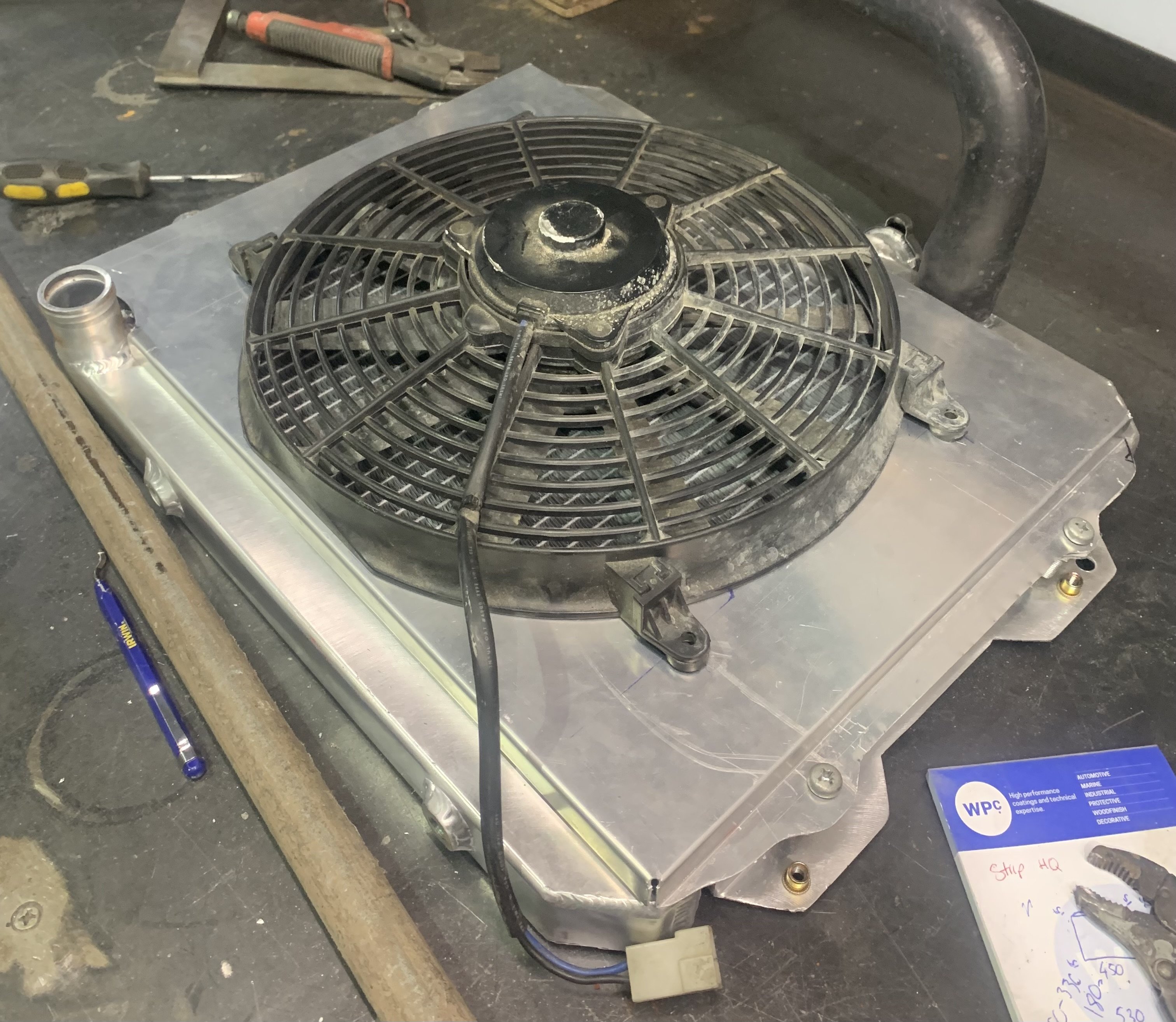

Dudley Posted April 5, 2025 Author Posted April 5, 2025 Bought the cheapest chinesium rad I could, kpr then changed outlets with his fancy new tig to suit, I also whipped up a shroud for a electric fan 2 Quote

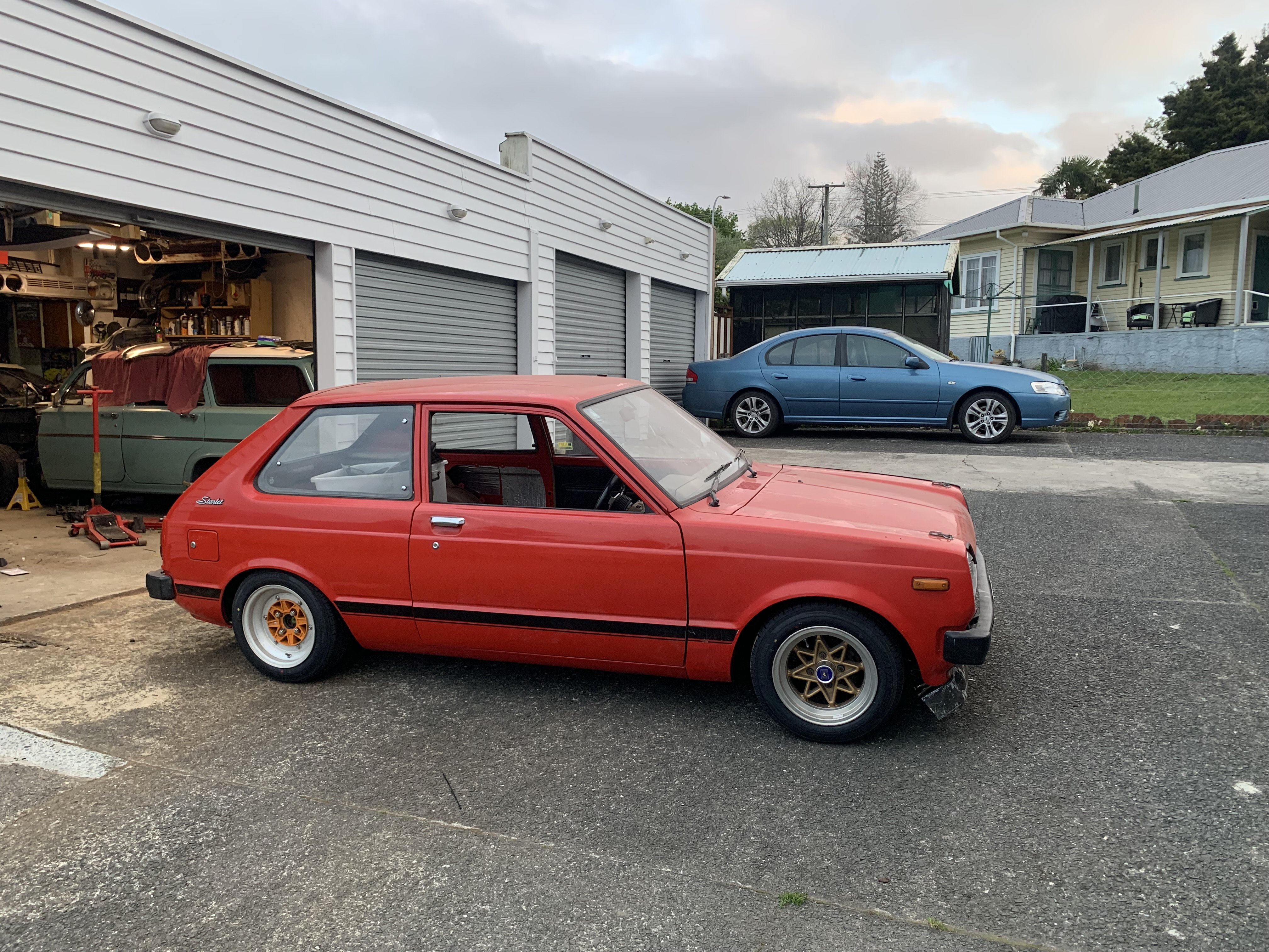

Popular Post Dudley Posted April 5, 2025 Author Popular Post Posted April 5, 2025 Managed to get it a wof, one year after bringing it home 15 Quote

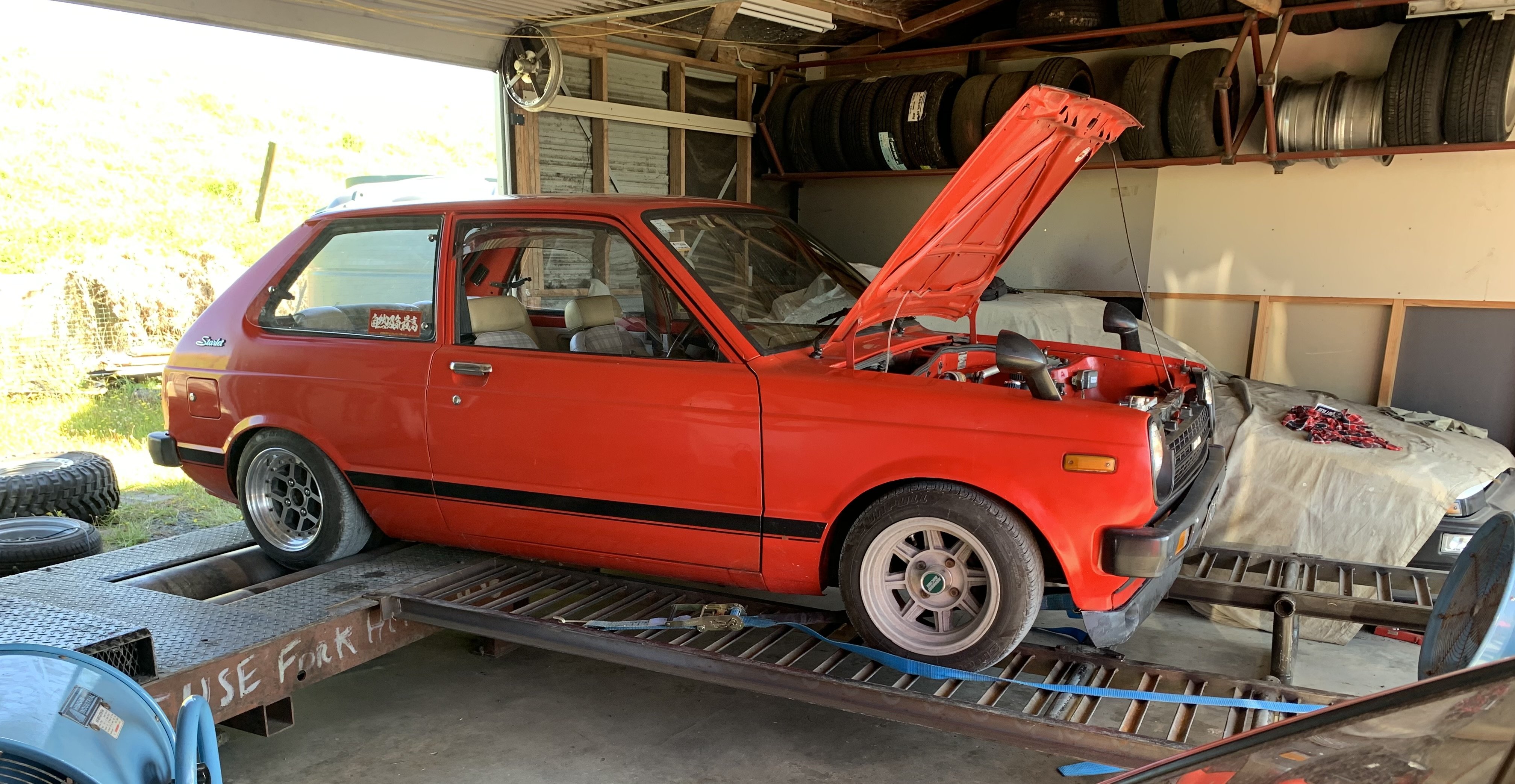

Popular Post Dudley Posted April 5, 2025 Author Popular Post Posted April 5, 2025 Then daily drive it, kris gave it a full diz twist and it made 81 hp atw on his dyno haz did his best sassy the Sasquatch rendition in the car 7 1 2 Quote

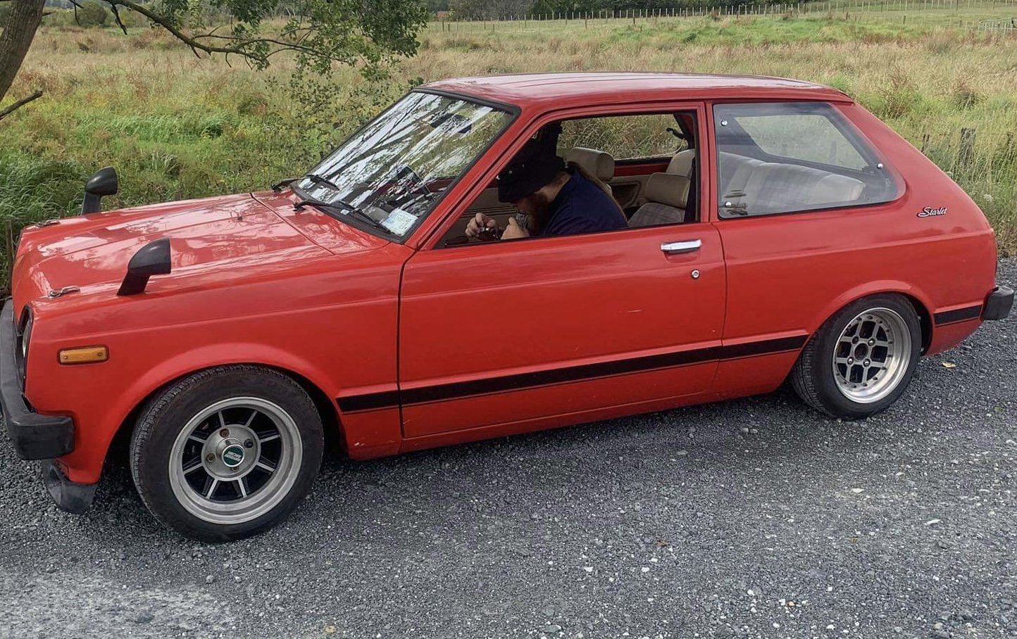

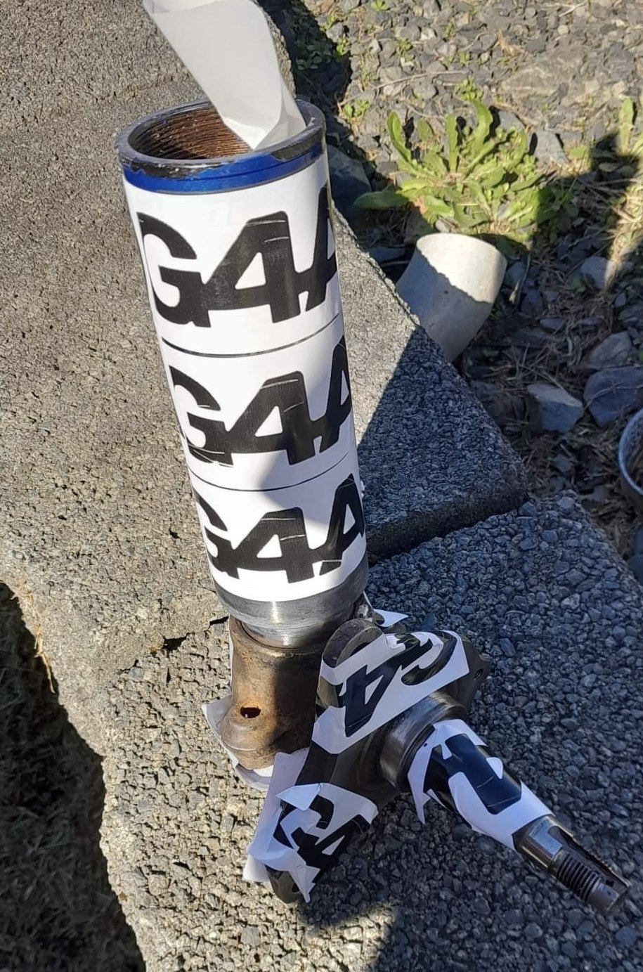

Dudley Posted April 5, 2025 Author Posted April 5, 2025 Then, I got repeatedly bullied by friends for my ride height, so I enlisted the dynamic duo of @kpr and everyone’s “favorite” Barry at mrp for some coilovers and rcas crisk proceeded to tig them to cert? Standard and give them a lovely livery then slammed it on 175 50 13s 8 Quote

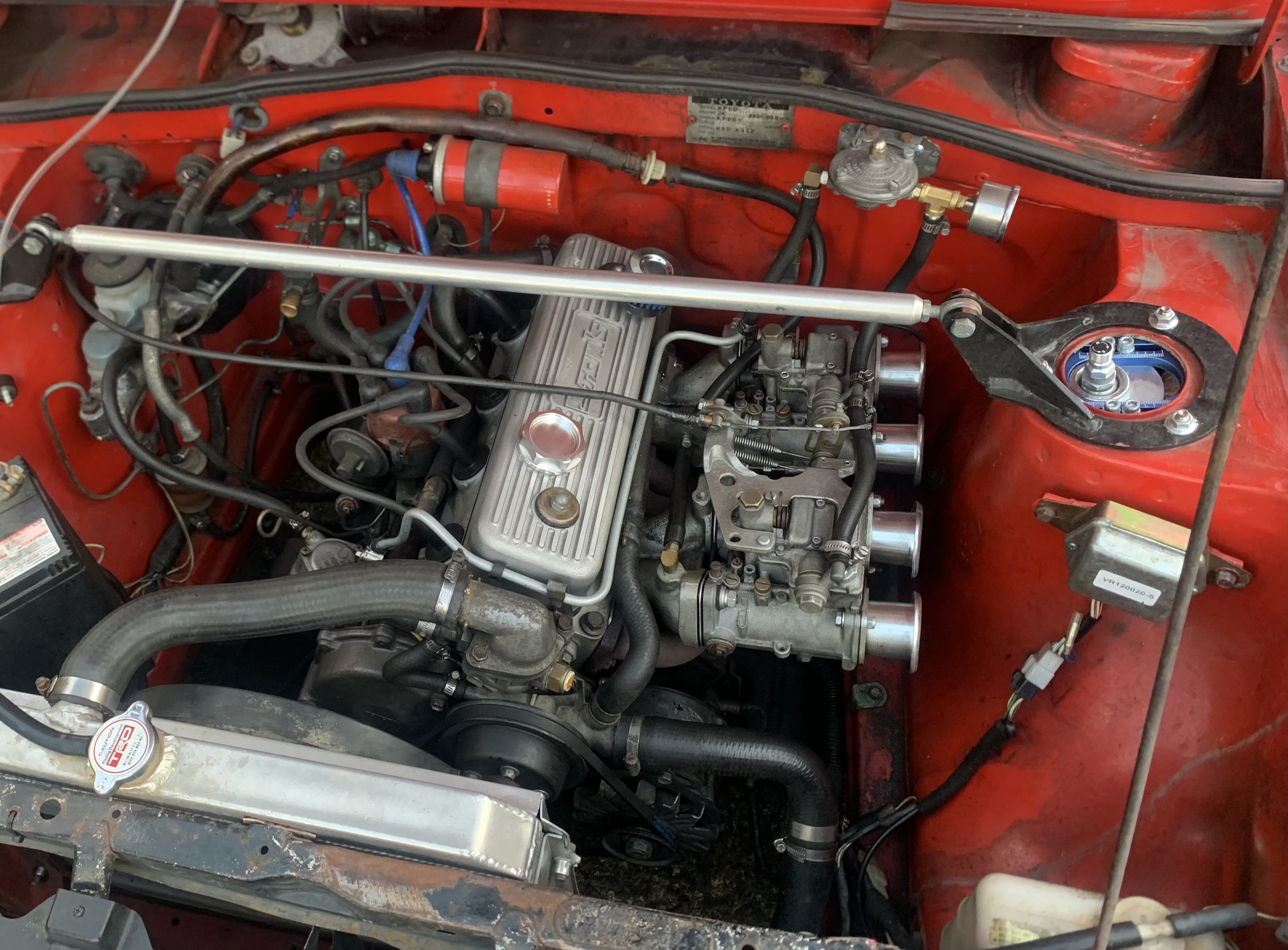

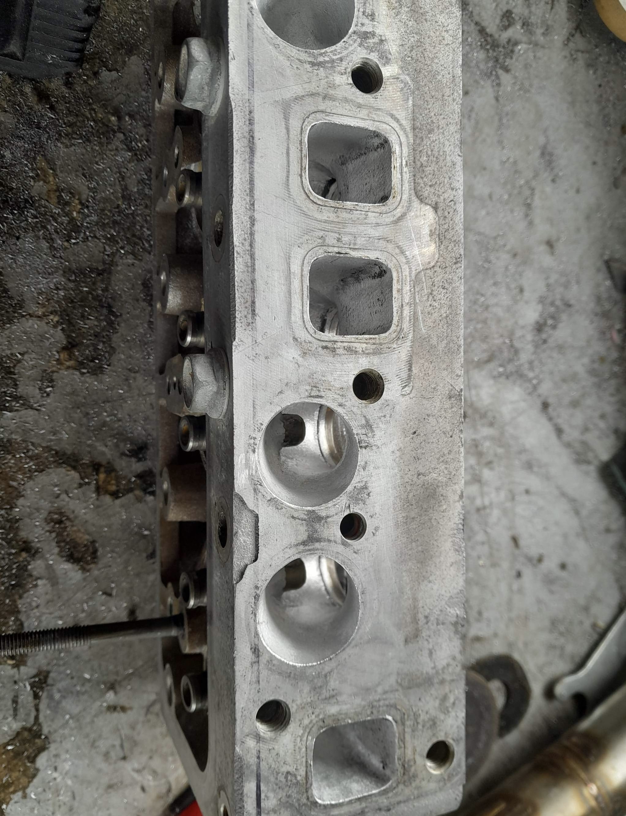

Dudley Posted April 5, 2025 Author Posted April 5, 2025 Then I went dooooooortin added some dhlas, ran good made 3hp more then the downdraft dcd weber so defo not a giant waste of money 6 Quote

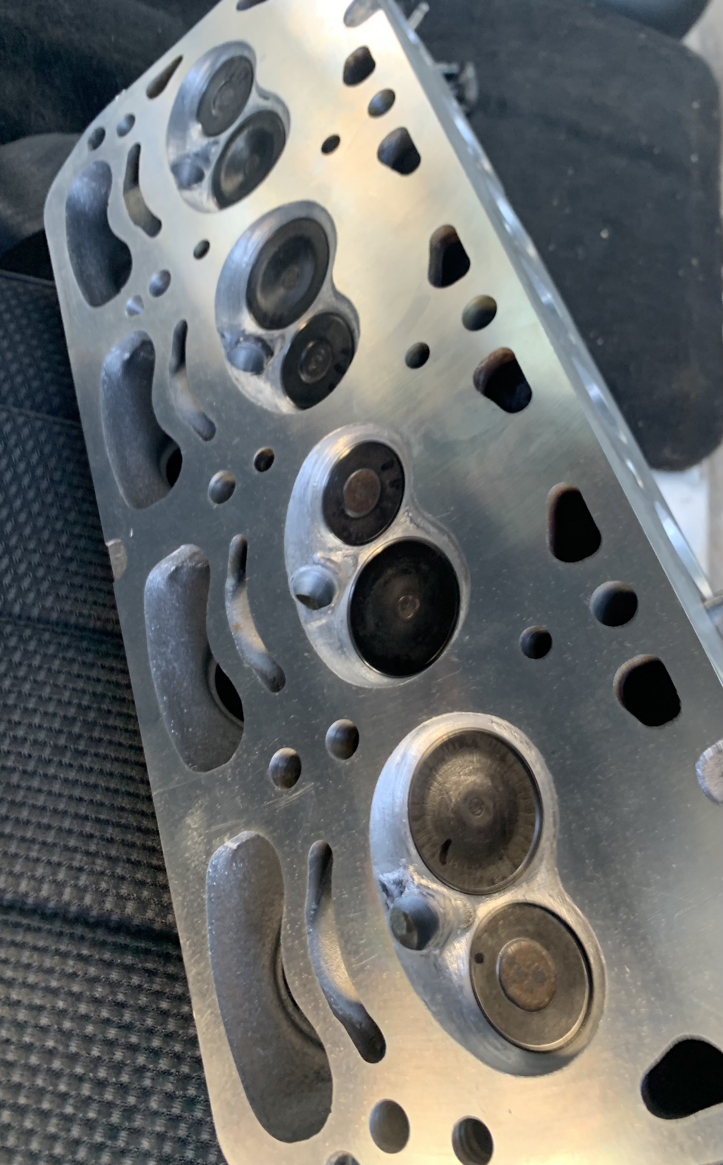

Dudley Posted April 5, 2025 Author Posted April 5, 2025 Kris then did a bunch of head work for a single smoko shout, garage4age port job very back cut valves kelford drop in springs have a fresh stage 4 hydro 3/4 race cam ready to go in at some point 9 Quote
