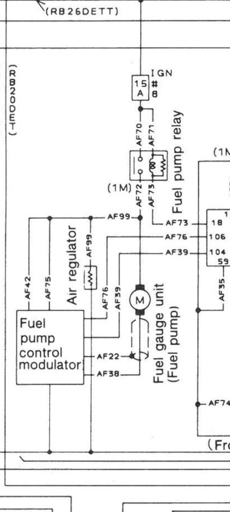

fletch Posted July 7, 2025 Posted July 7, 2025 What ecu are you running? I remember helping find a fault with this car when it had a powerFC. It had 2 map sensors and one had failed. Also, the factory fuel pump controller dicks about with the 0v return from the pump to change the speed. You want to ground the white wire coming from the fuel pump plug. It will still get its 12v supply from the ecu triggered fuel pump relay. If your running the factory air flow meters, it sounds like you have an air leak between the turbos and the throttles. Maybe under the plenum. Something like the idle air controller hose or the brake booster hose Quote
sheepers Posted July 7, 2025 Author Posted July 7, 2025 6 hours ago, fletch said: What ecu are you running? I remember helping find a fault with this car when it had a powerFC. It had 2 map sensors and one had failed. Also, the factory fuel pump controller dicks about with the 0v return from the pump to change the speed. You want to ground the white wire coming from the fuel pump plug. It will still get its 12v supply from the ecu triggered fuel pump relay. If your running the factory air flow meters, it sounds like you have an air leak between the turbos and the throttles. Maybe under the plenum. Something like the idle air controller hose or the brake booster hose power FC. i can run the fuel pump if i want to, thats not the issue. the issue is that the tune is setup for the idle fuel supply to be controlled by the fuel pump controller, which its not doing. i have already pressurised the entire plenum and piping system looking for leaks and I'm fairly confident there are none. i spent another 4 hours on it last night with no progress. i still have to go through the TPS and the idle switch wiring, that will be tonight's job. for clarity, the issue is that the fuel pump controller is either not turning the pump on at all, or its giving it 12v at idle, which then floods the motor. and the motor and ECU were running with no issues in the other car. the engine loom is different and the alarm has been wired in a very unusual and terrible way so im working my way through removing that. i shall continue to battle with the fucking thing tonight. 3 Quote
fletch Posted July 8, 2025 Posted July 8, 2025 Is the fuel pump controller pelresent in your car? It was probably bypassed and that's why it won't control. When the ecu turns the pump on, there is no low speed idle setting, it's just flat out. How good is your wiring diagram? I'll email you a good one that you can actually read the writing on. Quote
