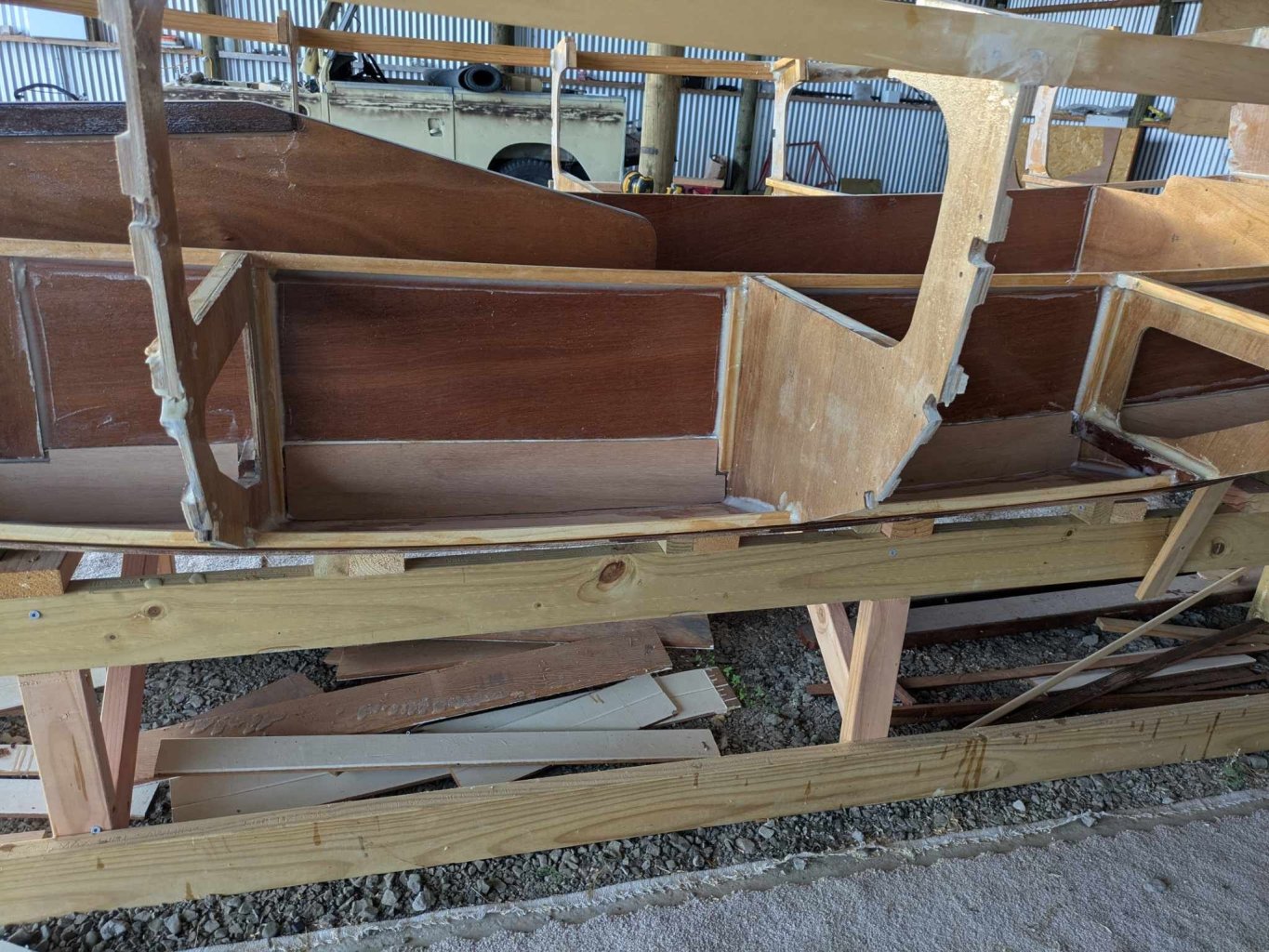

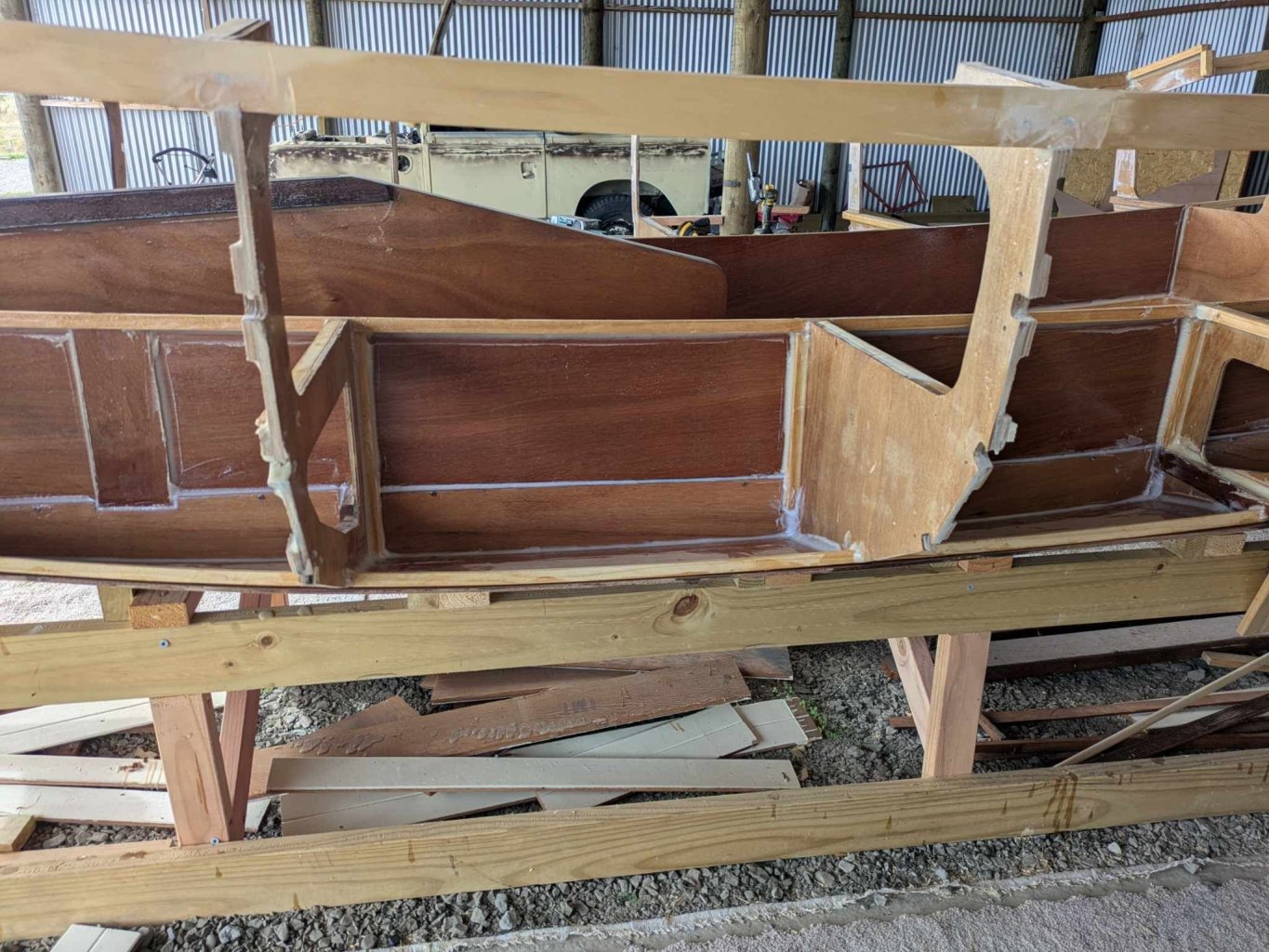

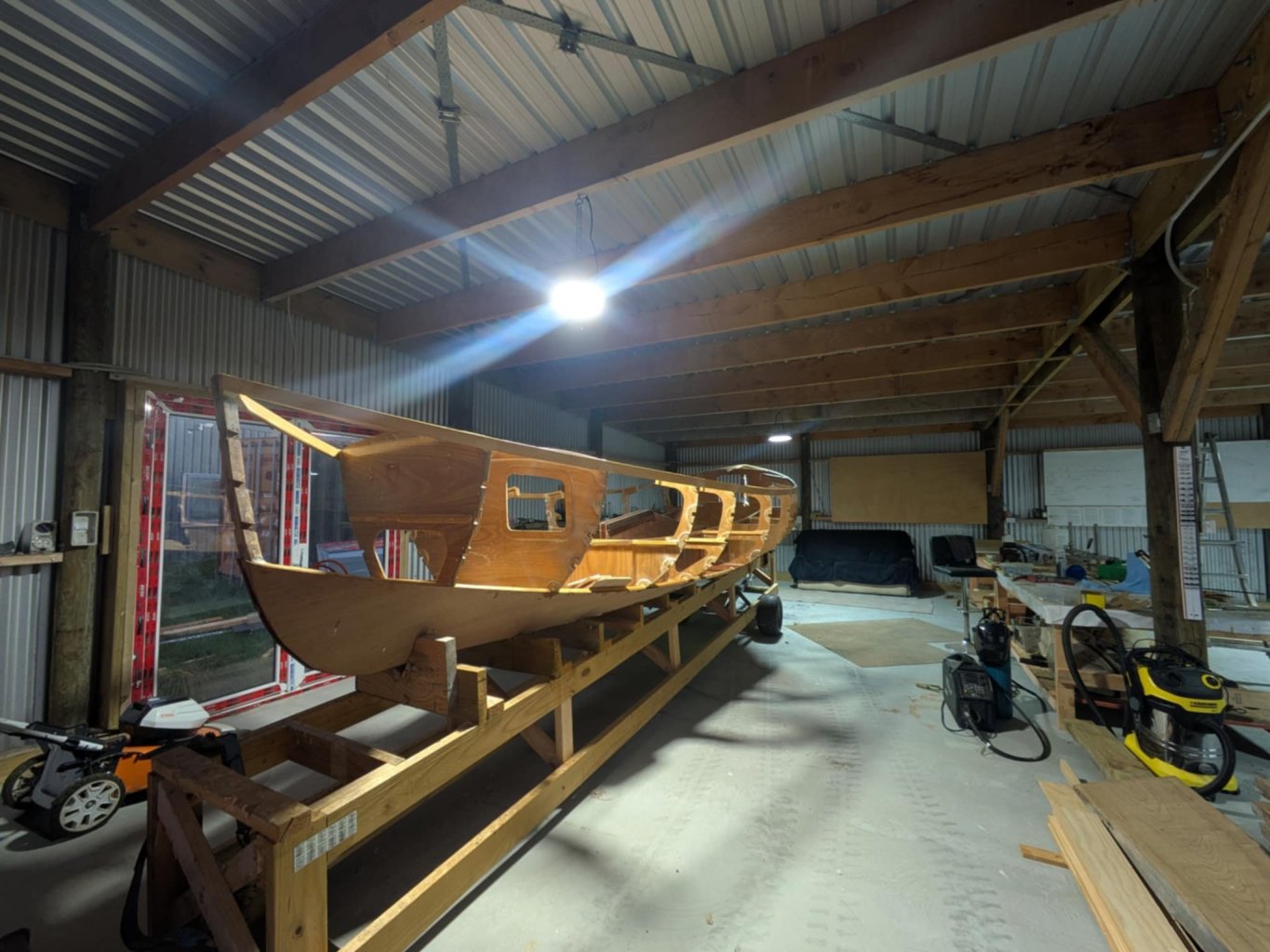

Finished the seat fronts which extended it all the way down to the garboard plank. Was quite finicky cutting all the weird and wonderful patterns but was comforted by each piece mirroring the other side. If it didnt Id be a little miffed.
Below is it all glued in. The plywood goes such a lovely shade when epoxied it'll be a shame to paint over it.

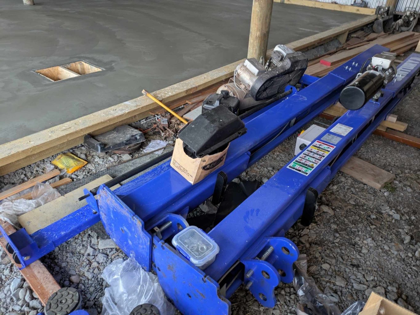

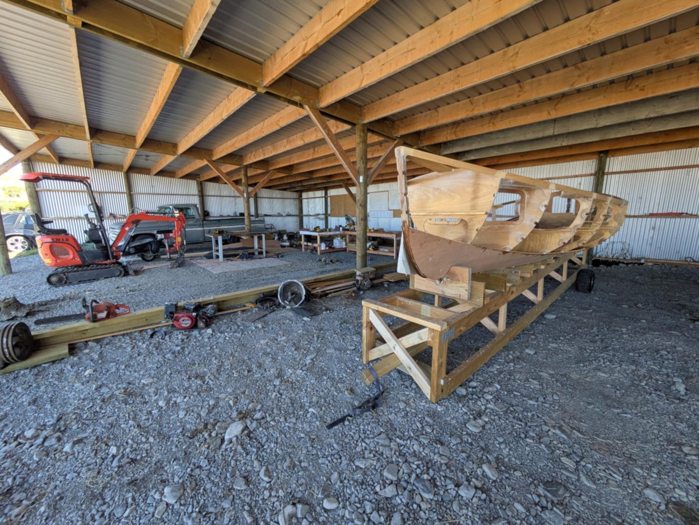

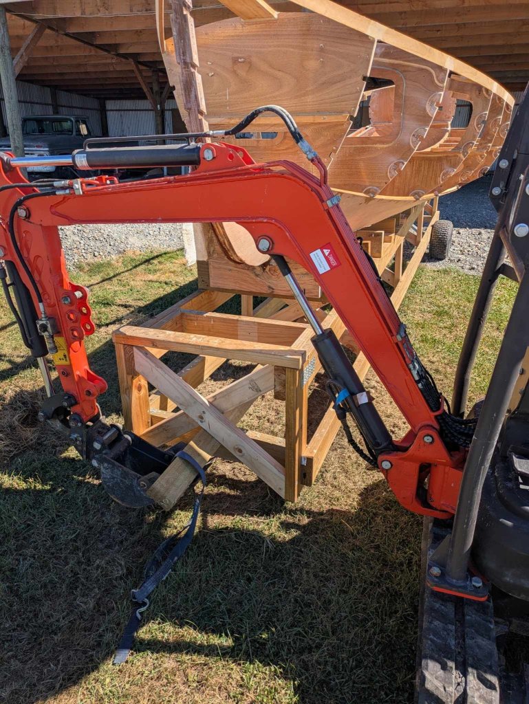

Was going to start on the transom but have had some major life changes drop on my lap this week. Although not unexpected it was something I've been putting off so I need to move the boat a couple of bays so I can concrete where it sits now. A bittersweet moment as I'm on a roll with it now getting it stiff enough to move but likely wont be touching it for quite some time whilst I sort other stuff out. Haven't figured out how Ill move the jig yet as it has posts concreted in at each end but I'll figure it out.
Thankfully the landy is wired enough to drive so should be a matter of driving it right out and back into another bay.

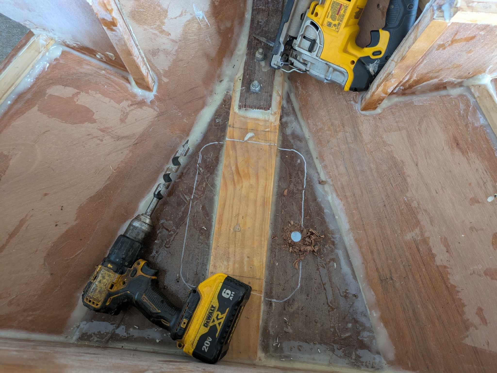

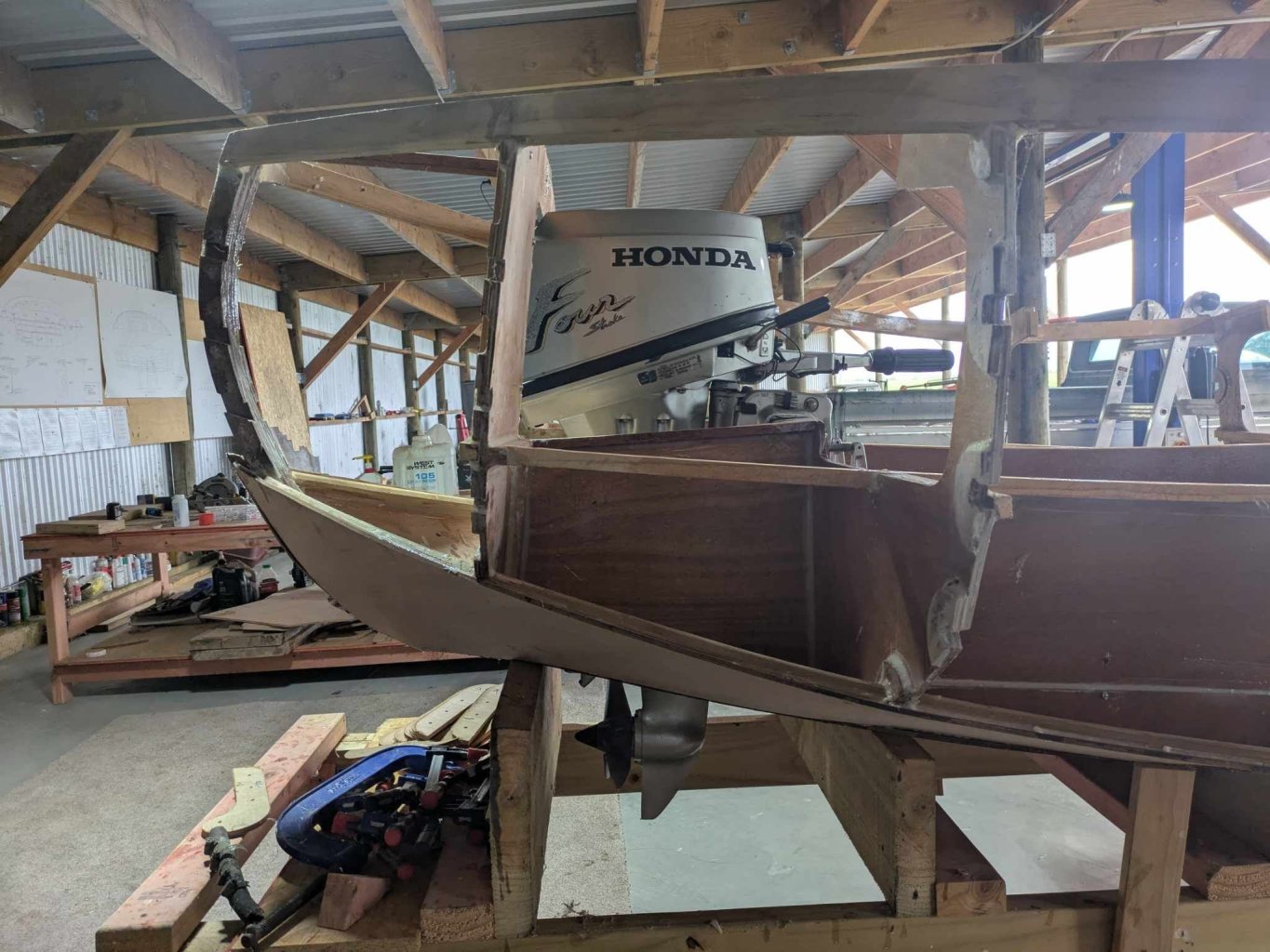

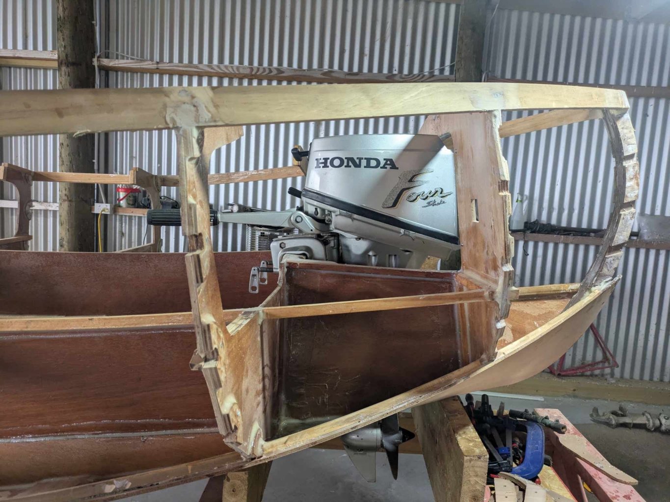

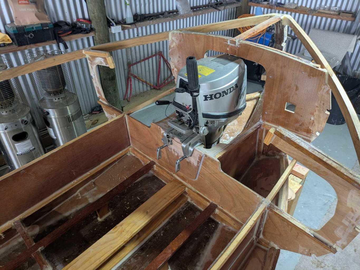

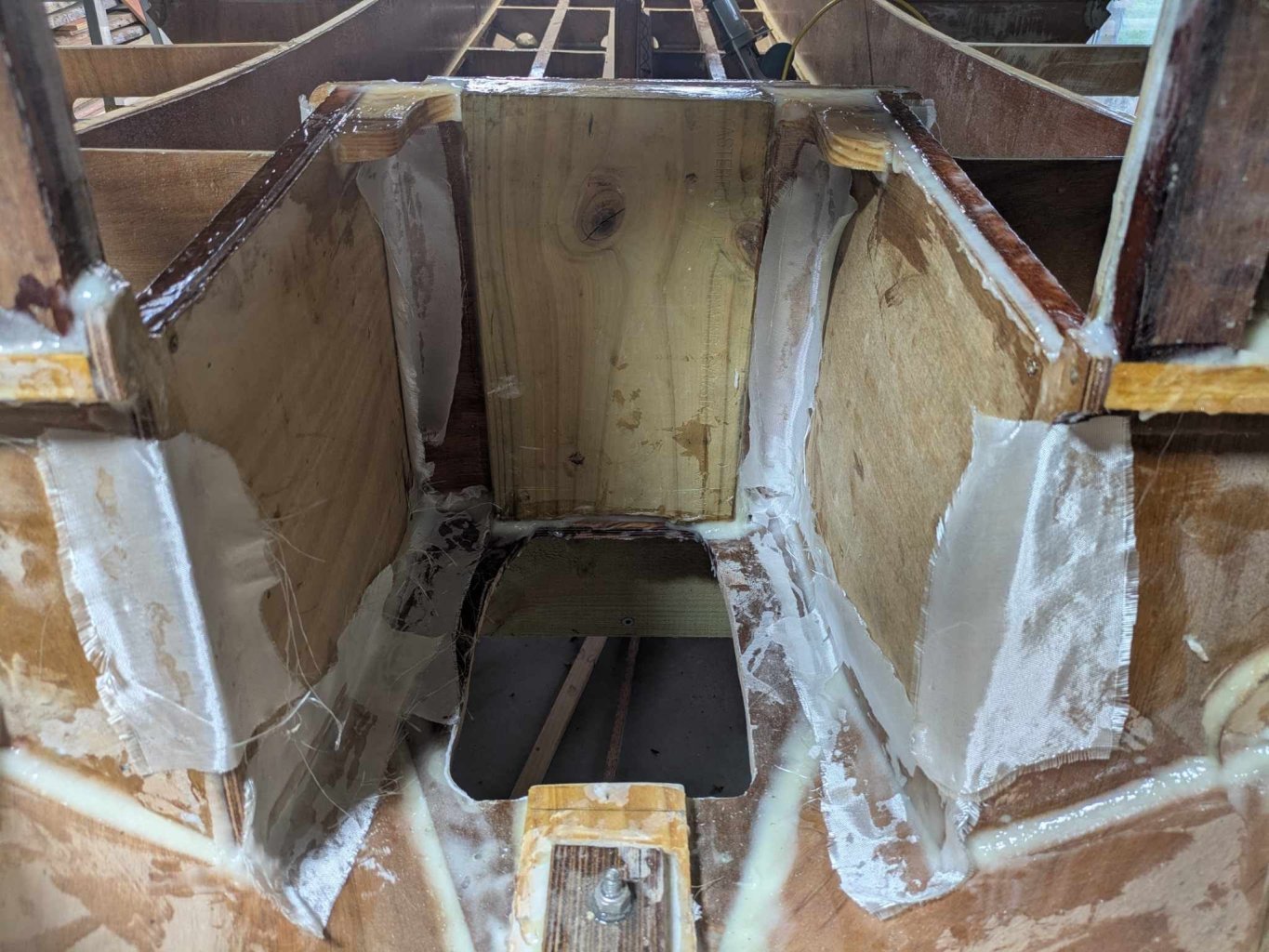

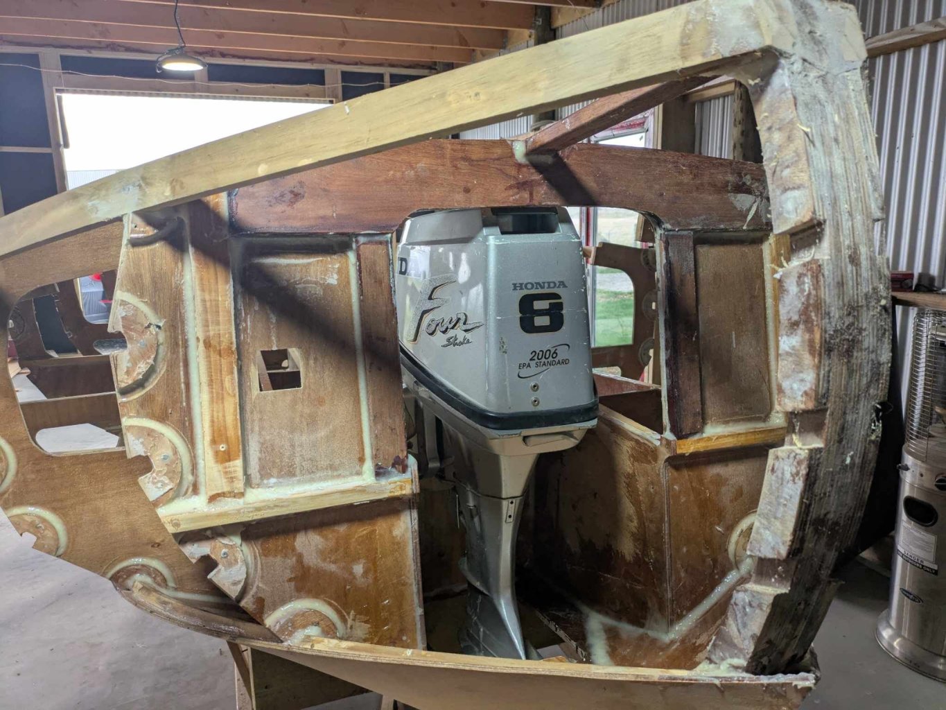

Lucky it was a long weekend as it took longer than I thought to sort out the outboard well and transom.

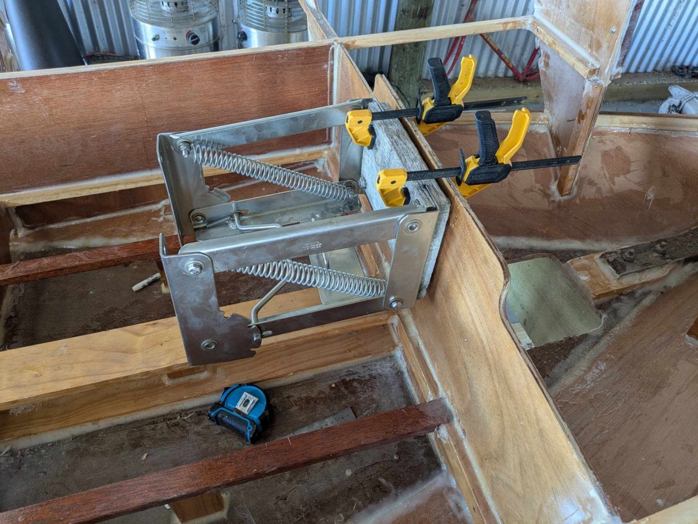

The dream was to have a rise and fall bracket so it could lift up and out of the water easily and a plug put in the hole.
But as with all things project related it was a matter of compromising.
The last bulkhead meant I couldnt actually fit the outboard on hand as it was in the way. So I just guessed where the hole would be and whilst it was fairly close, I ended up lengthening it a little. I can always close it up if it's a pain.
The rise and fall bracket I had (Tenob iirc). Meant making the transom some 500mm into the cockpit. Seeing as there is a cabin in the distant future it would eat into what I had remaining. So that was a non starter.
So with the outboard on the bulkhead as is, it was hard up against the fore end of the hole. That wasn't ideal. So as I had to beef up the transom anyway, I put in a 2" thick block behind the bulkhead and some plywood in front of the bulkhead that will have the outboard brackets squeeze into. Slight issue that was with the thickened epoxy in between each layer, it was slightly too thick. So I had to sand it down a little. I have plenty of meat left if I want to shape it to change the transom angle.
Once all the pieces were cut out and glued in, I cut out some cloth and put it over all the joins for strengthening.
I could put in a sliding jack shaft so the motor can go up and down, but that will entail having a big hole in the deck above it and put some of the weight up high too. Not to mention having the sight of an ugly honda 4 stroke sticking through the top deck. Yuck. Now a seagull on the other hand...
Anyway it's all about compromises. I spoke to a couple of other whaler owners and they just leave their outboards in the water all the time and it shaves off about half a knot off the speed. That is doable. Another whaler owner has a folding bulkhead/transom so the motor can tilt out of the way. Not sure I could be stuffed.
A 6hp single is the recommended engine for the whaler and although I do have a 2 stroke 6hp twin, the Honda 8hp will be much better performance and reliability. Even though the 8hp twin is overkill, it will be much more quieter than a single and with my deafness and tinnitus, future me will appreciate a twin cylinder barely idling. There is a weight penalty but if I move the tank amidship I can offset that.

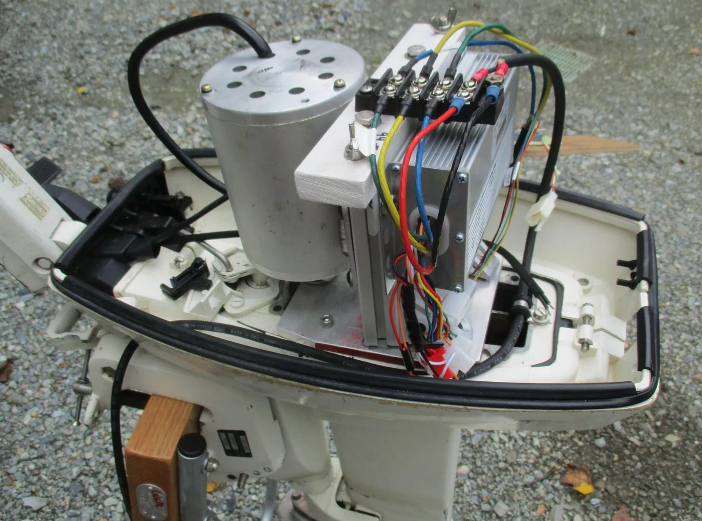

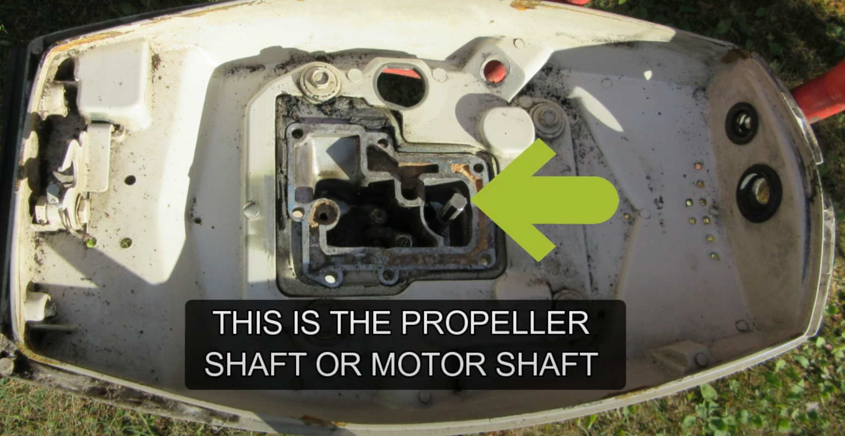

My friend has also converted Seagulls to run as Electric Outboards and  Battery Power | Facebook
So thinking out loud. Old Johnson Seahorse I have in the shed. Take off engine. Direct drive 5000rpm 48v motor. Use a coupler between motor and propshaft. Perhaps a support bearing somewhere close by the coupler. Take out the impellor so water isn't fannying about. Extractor fan on the cowl somewhere to dissipate heat. Cheat when tacking at the press of a button?
Here is one somebody has already done.
