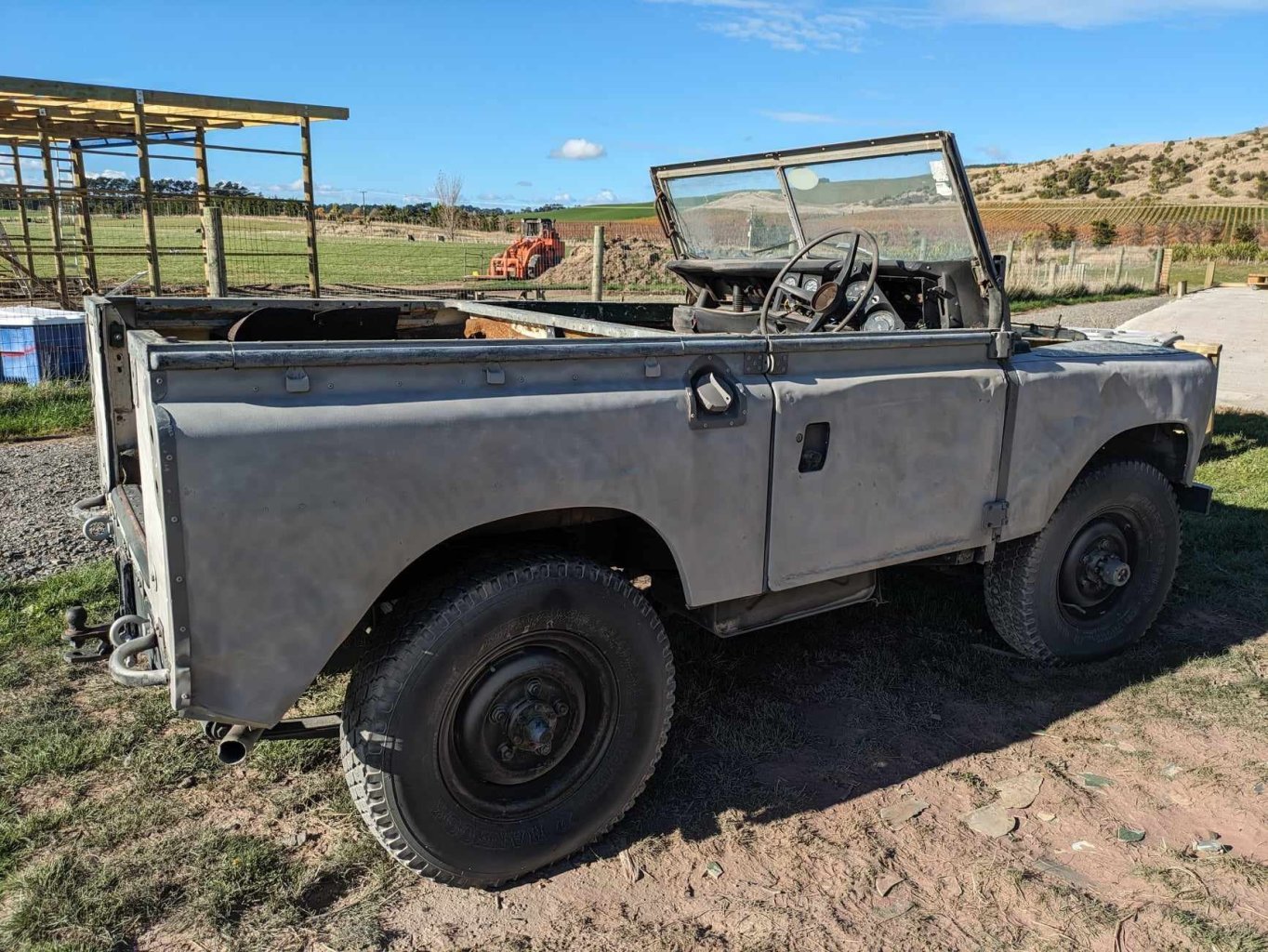

Swooning at the Landie, but also came to say I was smitten with many a John Welsford plan after finding his book in the Nelson Library.  Top effort that man!

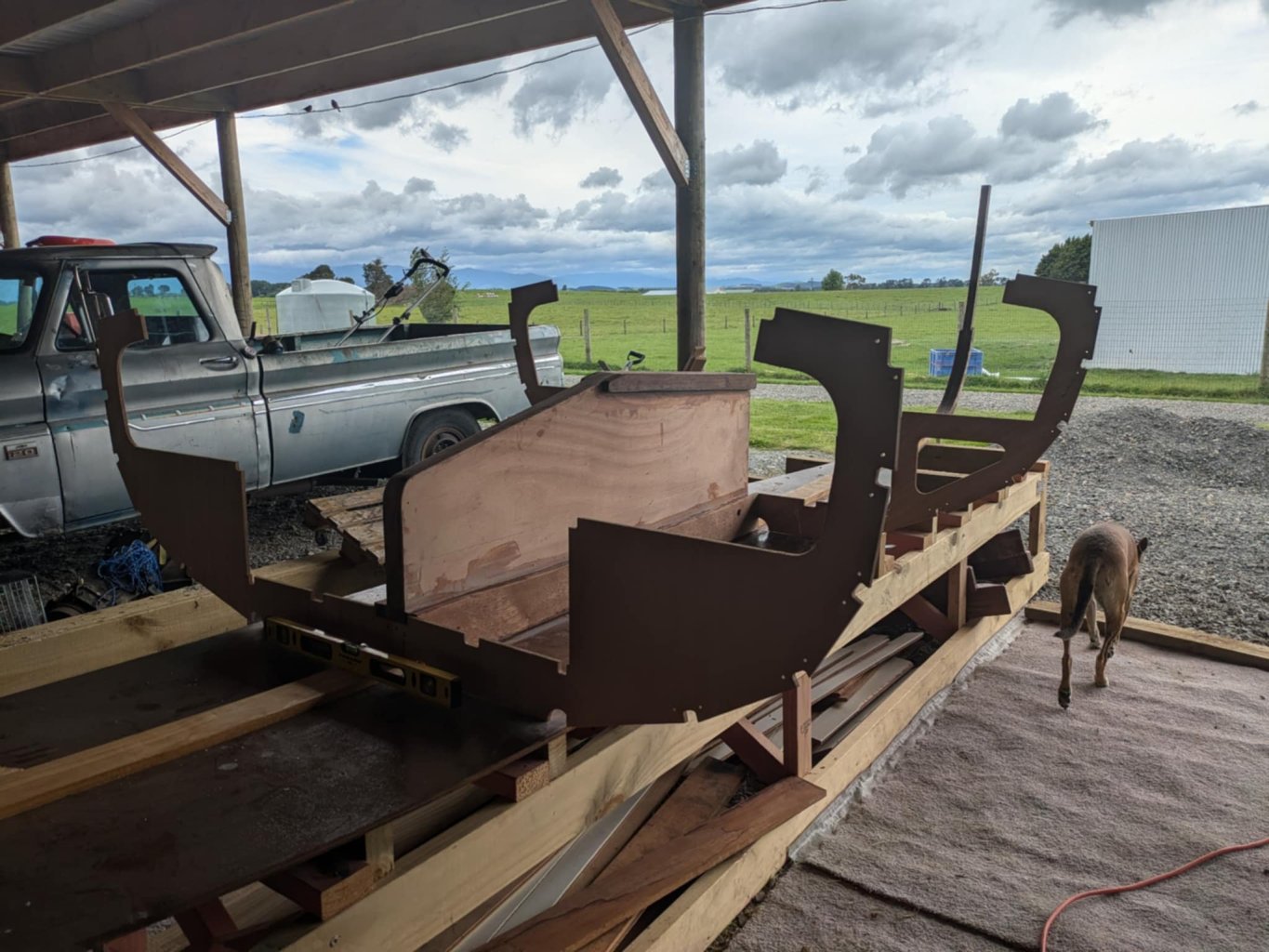

So I try to do a day a week on the boat spread over a few days as I'm usually waiting for resin to dry and dont want to "fix" it.
I don't have the skills or time for perfection so am going for working boat chic.

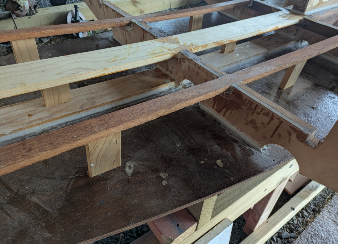

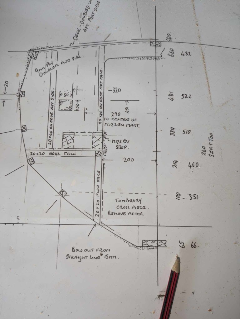

I've spent the last week or two cutting and gluing on stringer doublers. My word that was tedious. Next job is all the bulkhead extras such as seat supports and the like. Not too bad but means miles of ripping 20x20 lengths with my table saw which always gives me the creeps. Anything wider and I dont mind but 20mm is quite a tight space even with a pushing block.

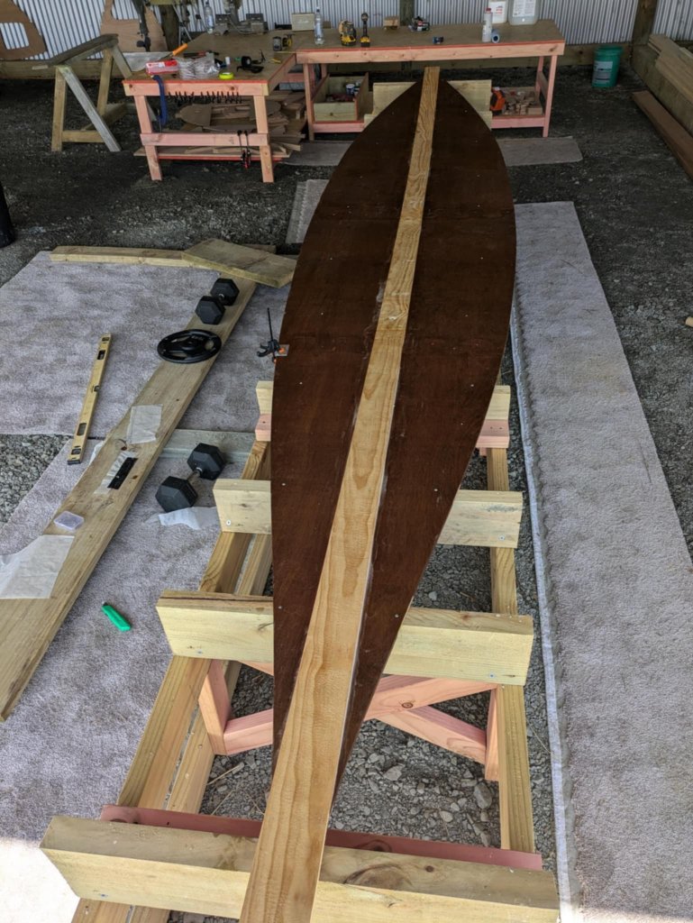

Before I get started on that I did the floor supports today. I found some bed slats at the tip and snuck them in my ute. Originally it was just for ballast to get out of paying too much for a load at the tip but they were in decent shape so on they went.

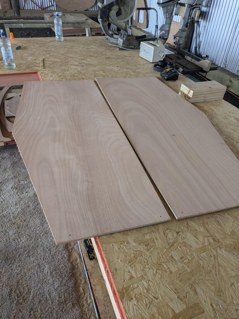

The plans call for 9mm plywood but the plans say a lot of things.

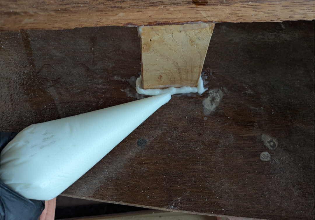

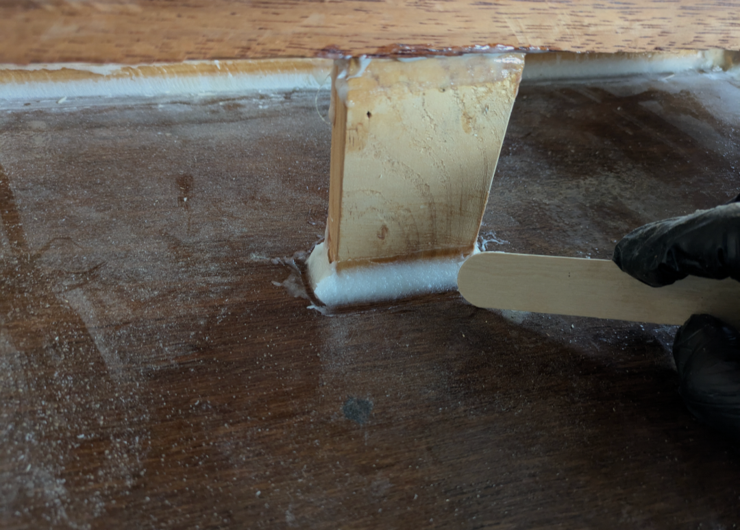

I use thickened epoxy into a caking piping bag to lay out the fillet juice.
  • Like 7

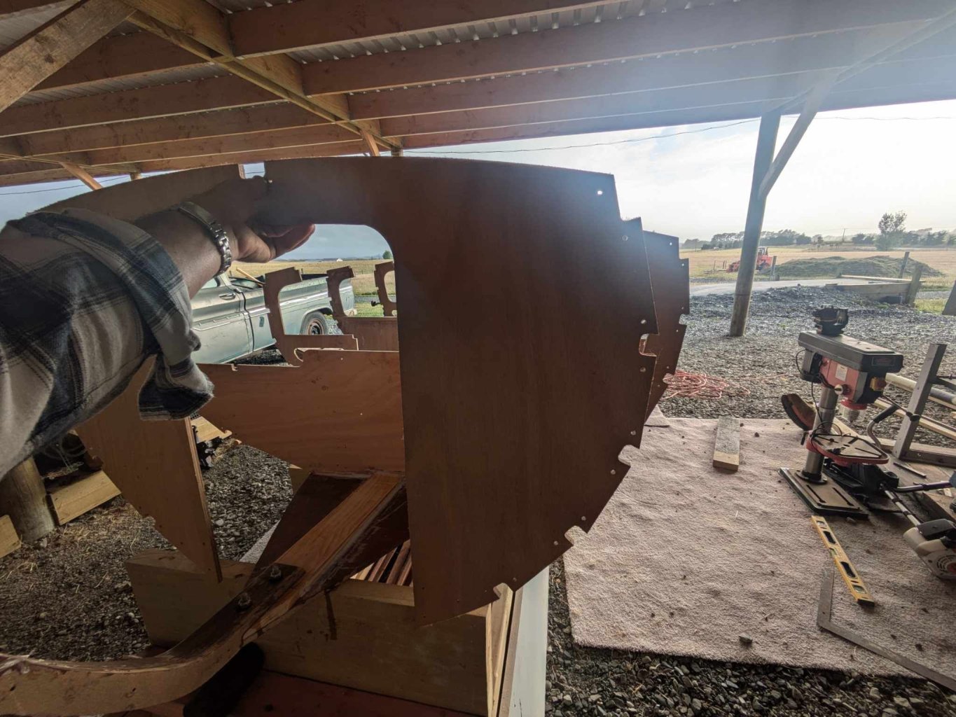

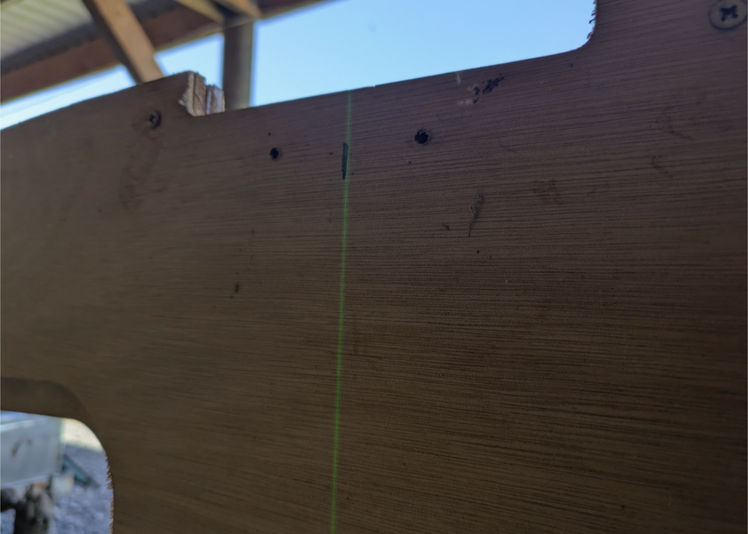

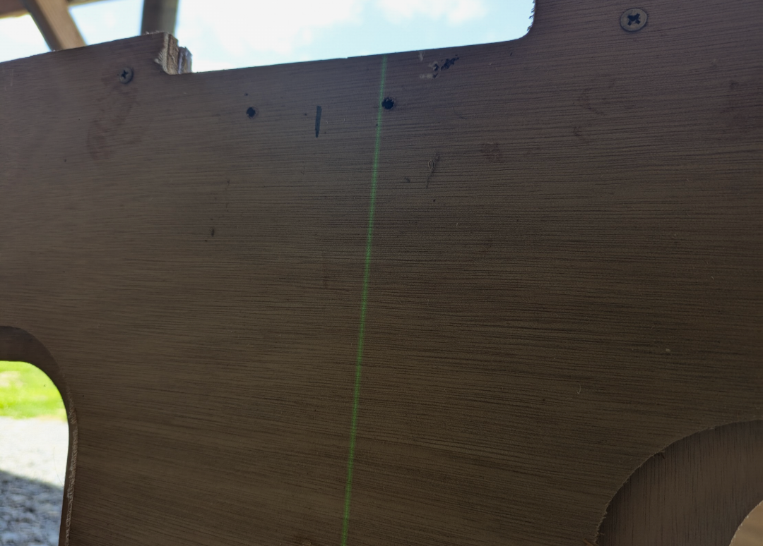

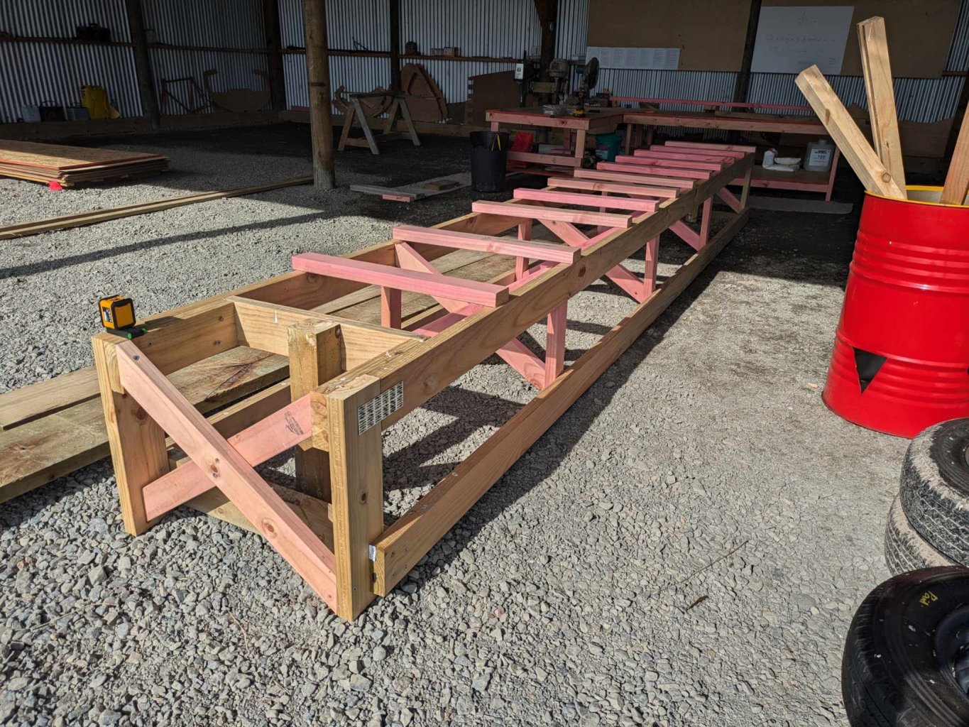

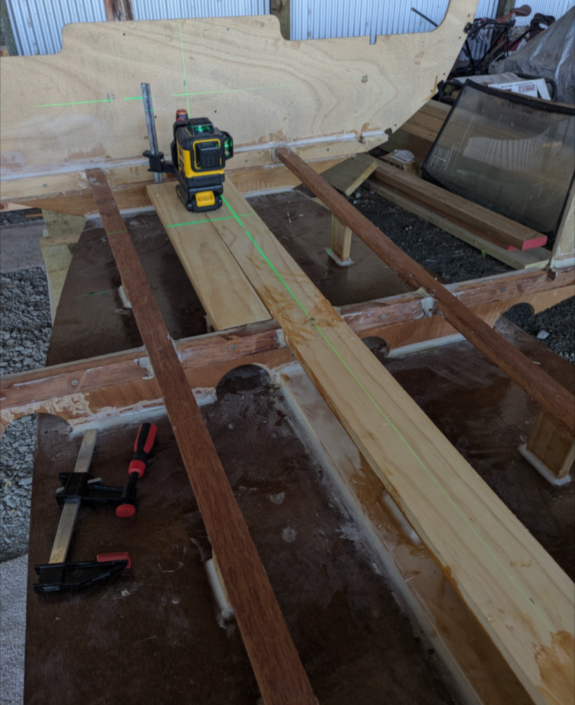

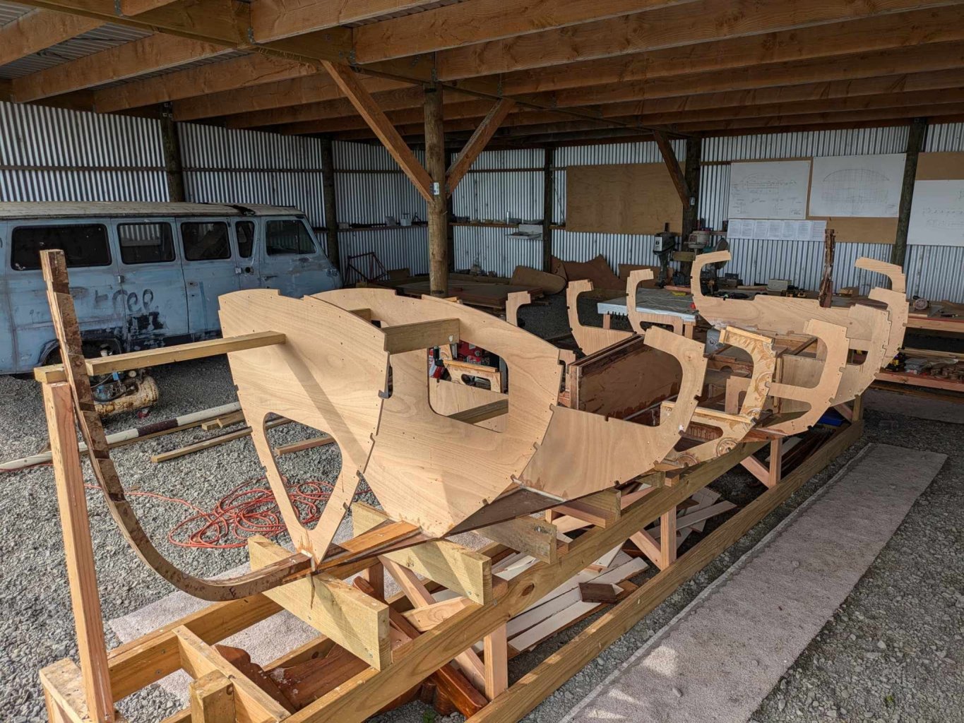

Productive afternoon on the whaler in nice wind. I was busy cutting out the seat supports and as they run across the bulkhead it just didnt look level to the eye.
Got the laser level out and as suspected the centre and aft were in line but the bow was well out. This is on bulkhead#2. #1 was out and the stem post wasn't even on the level.
Turns out the sun has been hitting the front of the jig and warping the pine as it dries.
  • Confused 2
  • Sad 1

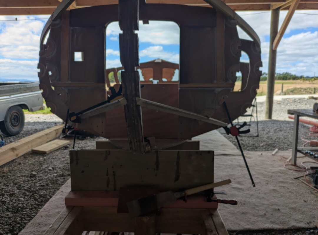

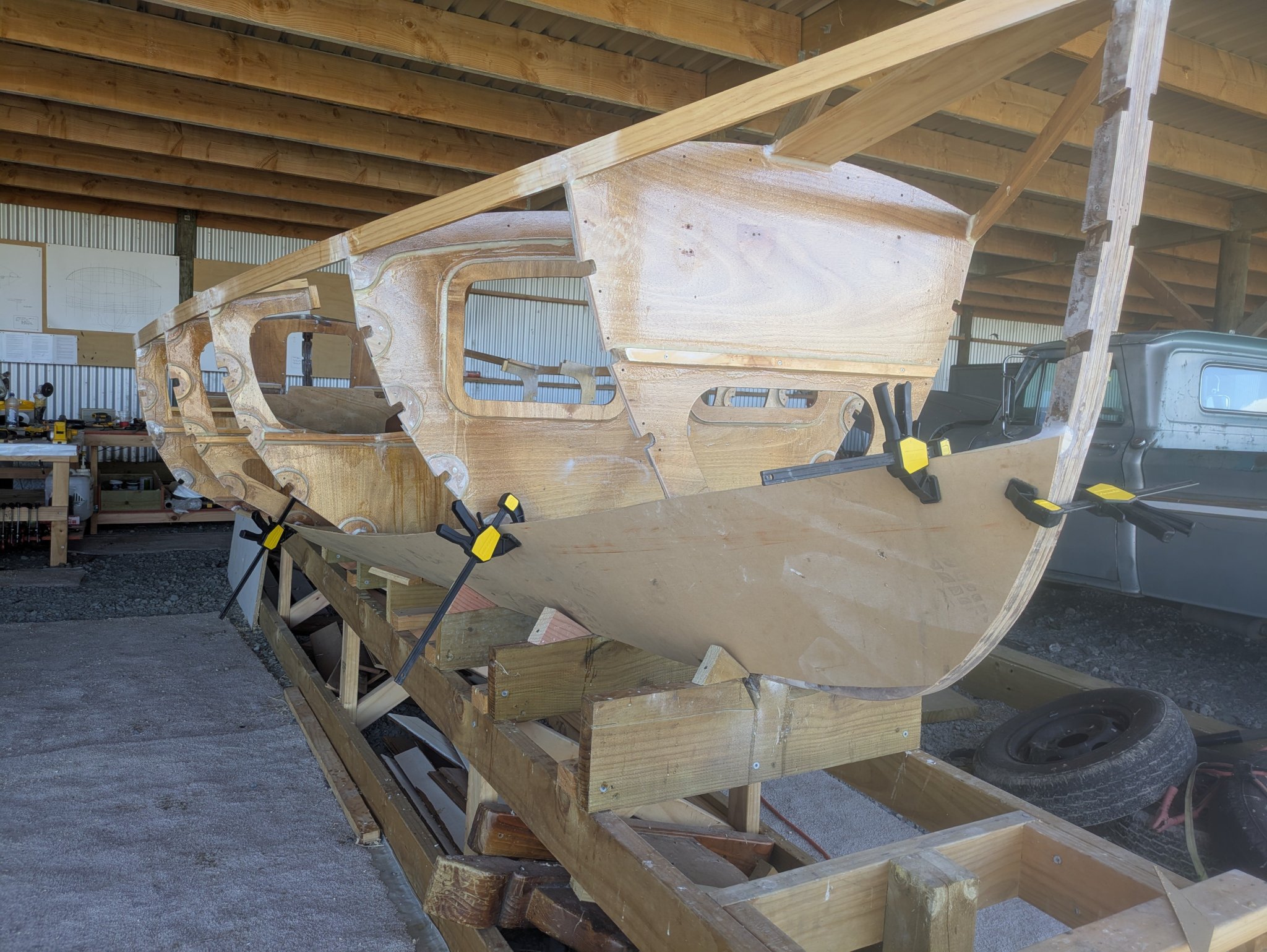

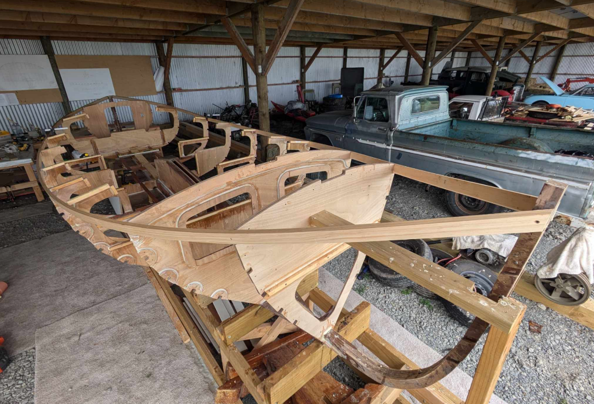

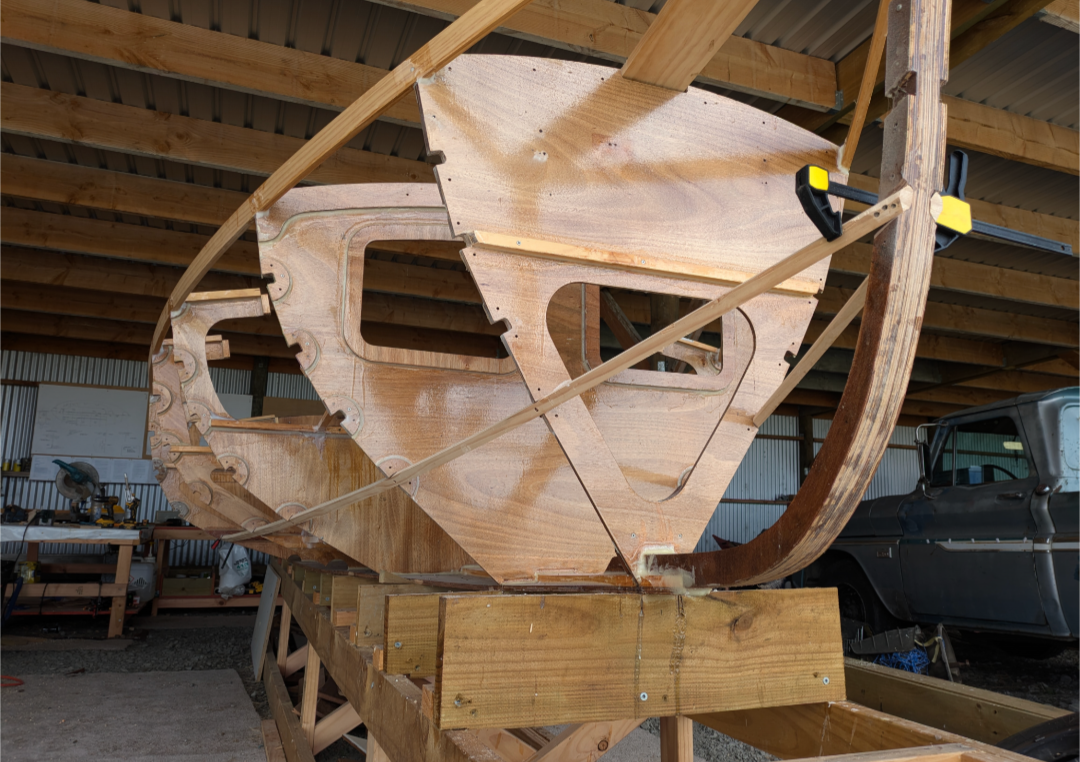

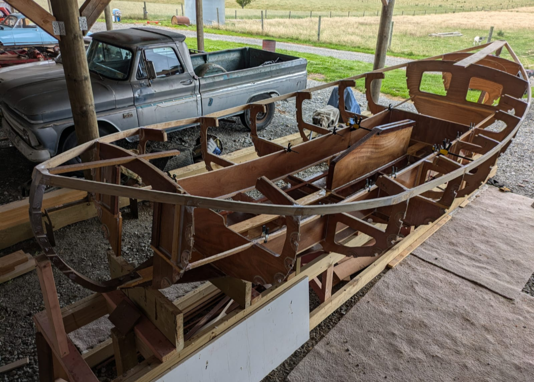

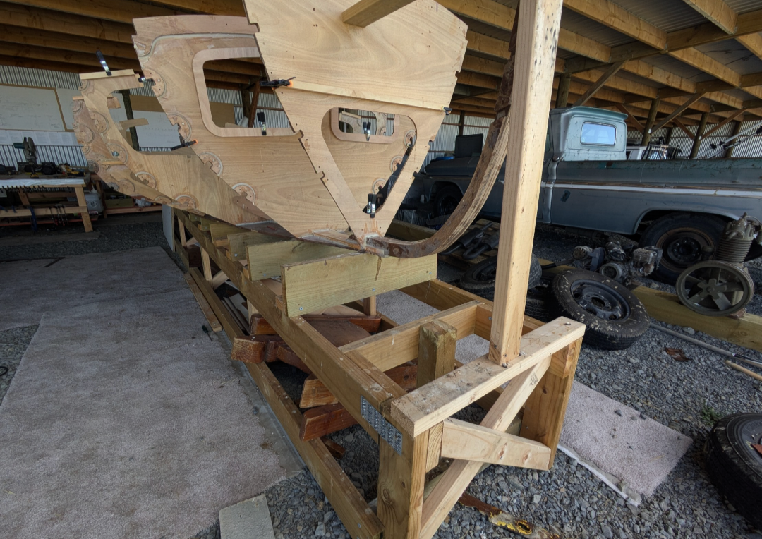

So a busy weekend but I'm pretty happy with how things turned out if you squint a little.

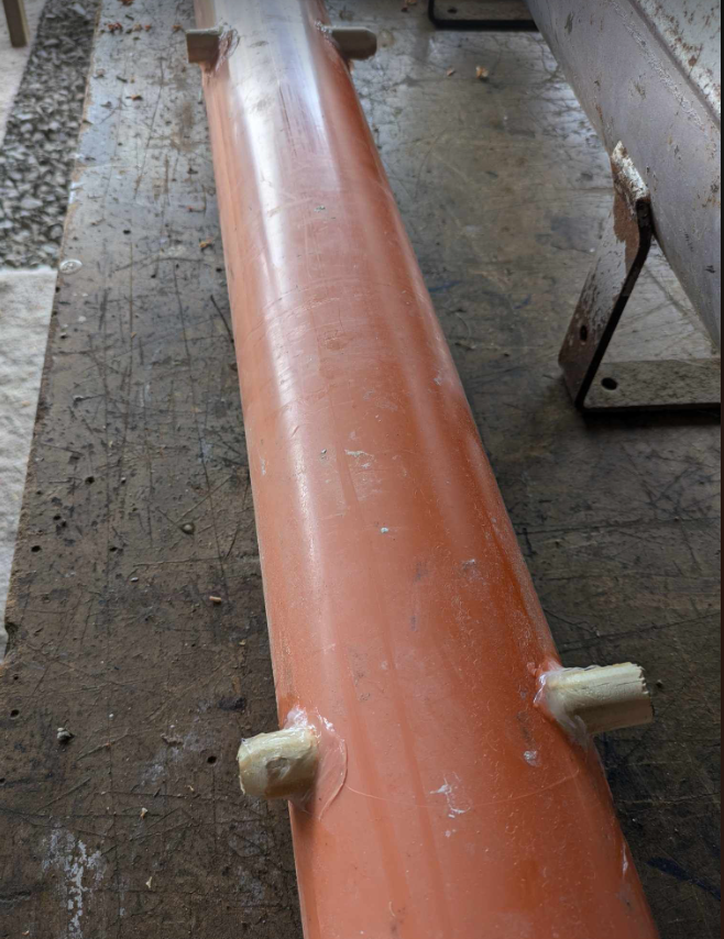

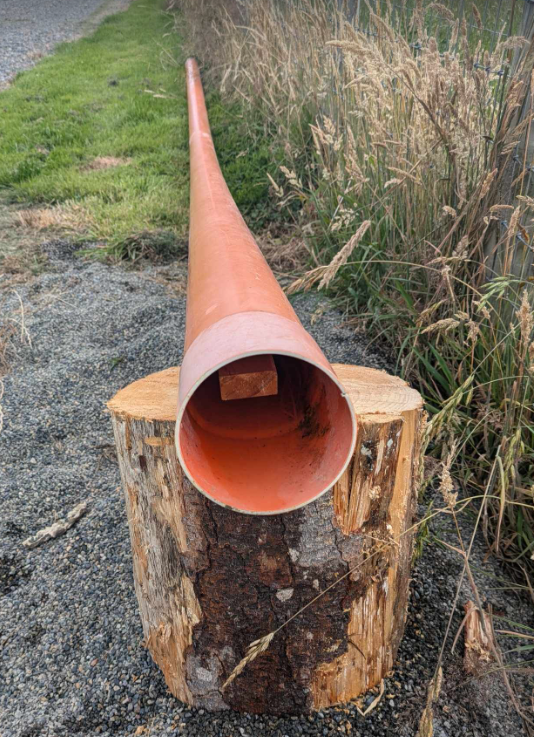

The main goal for the weekend was to get the gunwale on. That will then make the bulkheads a little more sturdy so I can start on the seats and inner bulkheads. The first thing was to make the steam box as per the crappy idea earlier. Whilst it was a success, it will be a consumable item as it has sagged overall and is out of shape already. Thankfully it had support through the middle so it didnt sag there and pool water.
There are wood dowels every 500mm which the wood sat on to ensure the steam got all around it. Before it went into the steam box it sat in a PVC pipe for a couple of hours to think about what it has done.
image.png.f24557252fd9637a46bb445615072985.pngimage.png.08e244bf7c7287c6b3ac5c5b553ecc4c.png

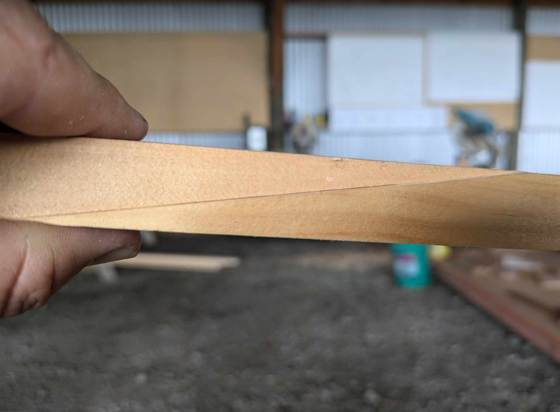

Next thing was to scarf some joints as the lengths weren't long enough and I a little bit cheated by making the scarf join right where the angle kicks up the sharpest. Whilst that means the join won't be as strong, I'll cut a curved doubler on the inside to suit and with the outer sheeting on it will be plenty strong. There is still 90% surface area to bond the two lengths together so just needs a little trimming either end. Sadly in the rush to get the rapidly cooling wood on the frame the scarfs are at slightly at different points on each side. Looks out to me now but when I fair it there won't be any noticeable difference. I'll ensure that the doublers are the same either side so they'll have to line up.

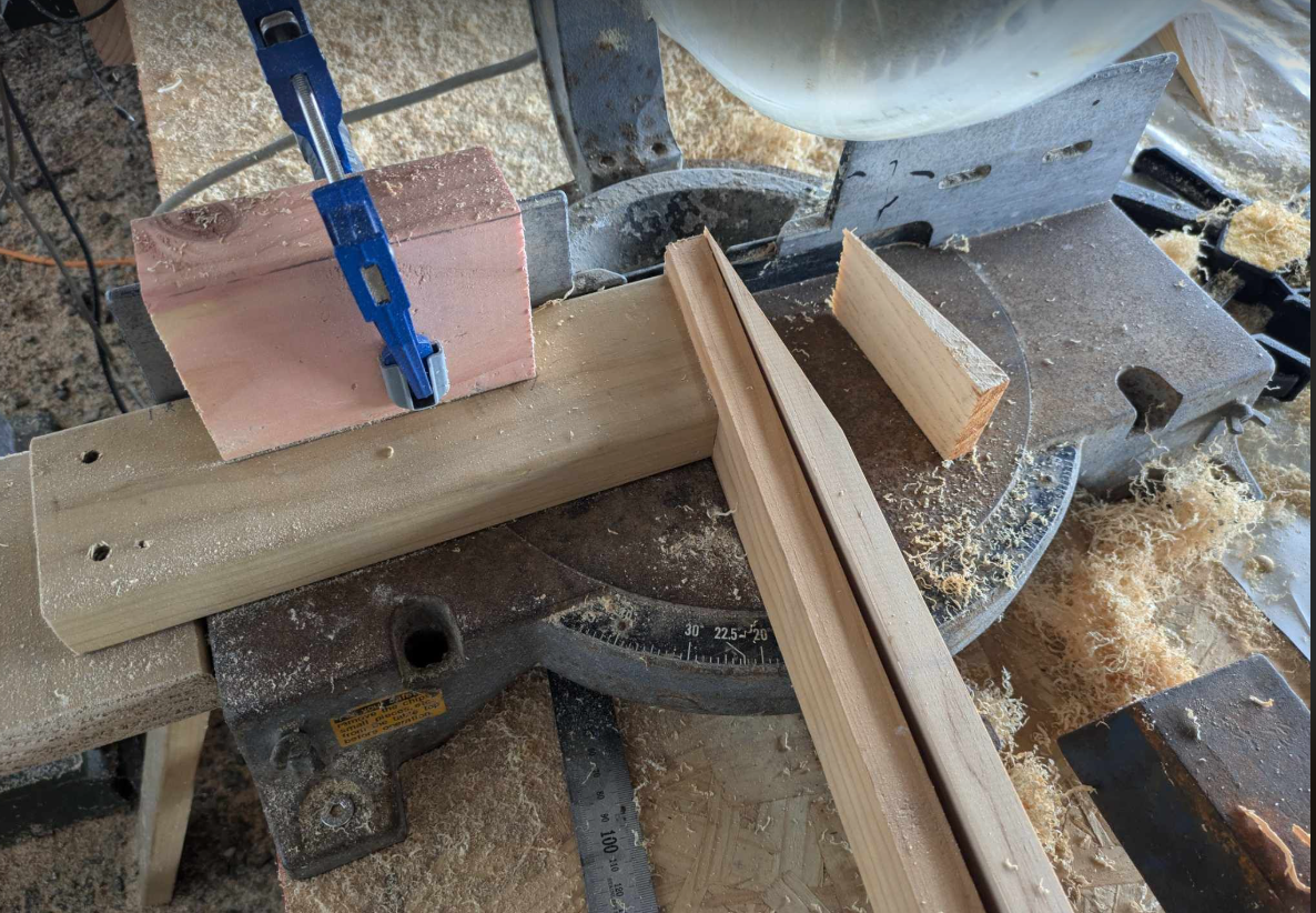

To make the scarfs a handy little jig was whipped up for the drop saw and each one took two seconds. It's a 1:8 scarf joint and will work fine for the stringers.
The finished scarf fits like a glove.
