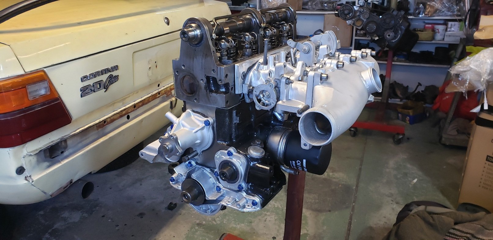

The GTIR full ITB inket is allreafy bolted the head and running so I'm not looking for an alternative ITB set up really.. same as this setup i made for my nephews motor
My plan so far is is to remove all the springs from the ITBs return spring setup (so bugger all tension).
and buy a generic bosch FBW throttle body and cut most of it off so I'm left with the motor and part of the throttle shaft. (Like this)
And.mount it under the ITBs and just make the right size linkage to open and close them.
Unless there's a cheap DBW actuator out there or some other idea that is cheap and.may work.
Cheers
