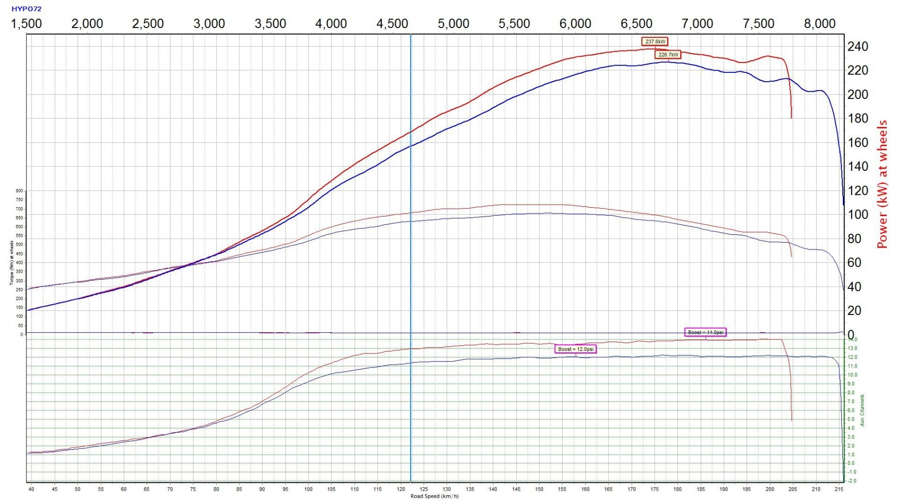

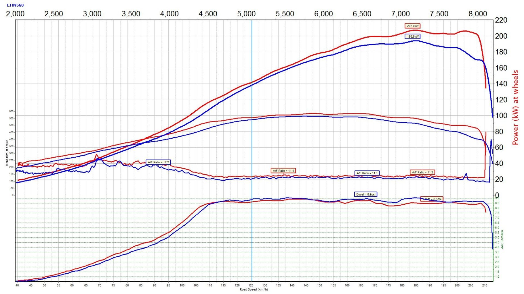

Have tuned a couple of fd's  with power fc,    both had single  turbo swaps.  one had a stock engine with a pulsar 6262 (g35)    the other one had an older gt series of similar size with with a rebuilt engine with some mild porting.    both made low to mid 200kw at wheels on low boost.   the one with the pulsar turbo  was more responsive and came on bit sooner.  but both had a stack of midrange and good off the bottom, nice to drive for street cars
Anyway,   power fc is getting pretty old tech now and fairly basic.   but for something like above they are fine.   anymore power  i would look at something newer like a link.  as they arent amazing with bigger injectors, have to fudge the deadtimes and stuff to tune the low load and idle stuff and you are putting your trust in some old electronics,   The  idle control has a mind of its own also.   Need a datalog it or similar to tune them properly,  hand controller is just for small adjustments and a pitta to tune with.

was awhile ago.    but was a t4 housing,   so probably the .85 housing going by the pulsar site,  since the 1.01  looks to be v band.    rest of setup wasnt anything amazing, china cooler and exhaust
this was the other one.  the blue line was stock engine.  and red rebuilt with mild port work.   it was pretty close to maxing stock injectors.     the above one had bigger injectors
