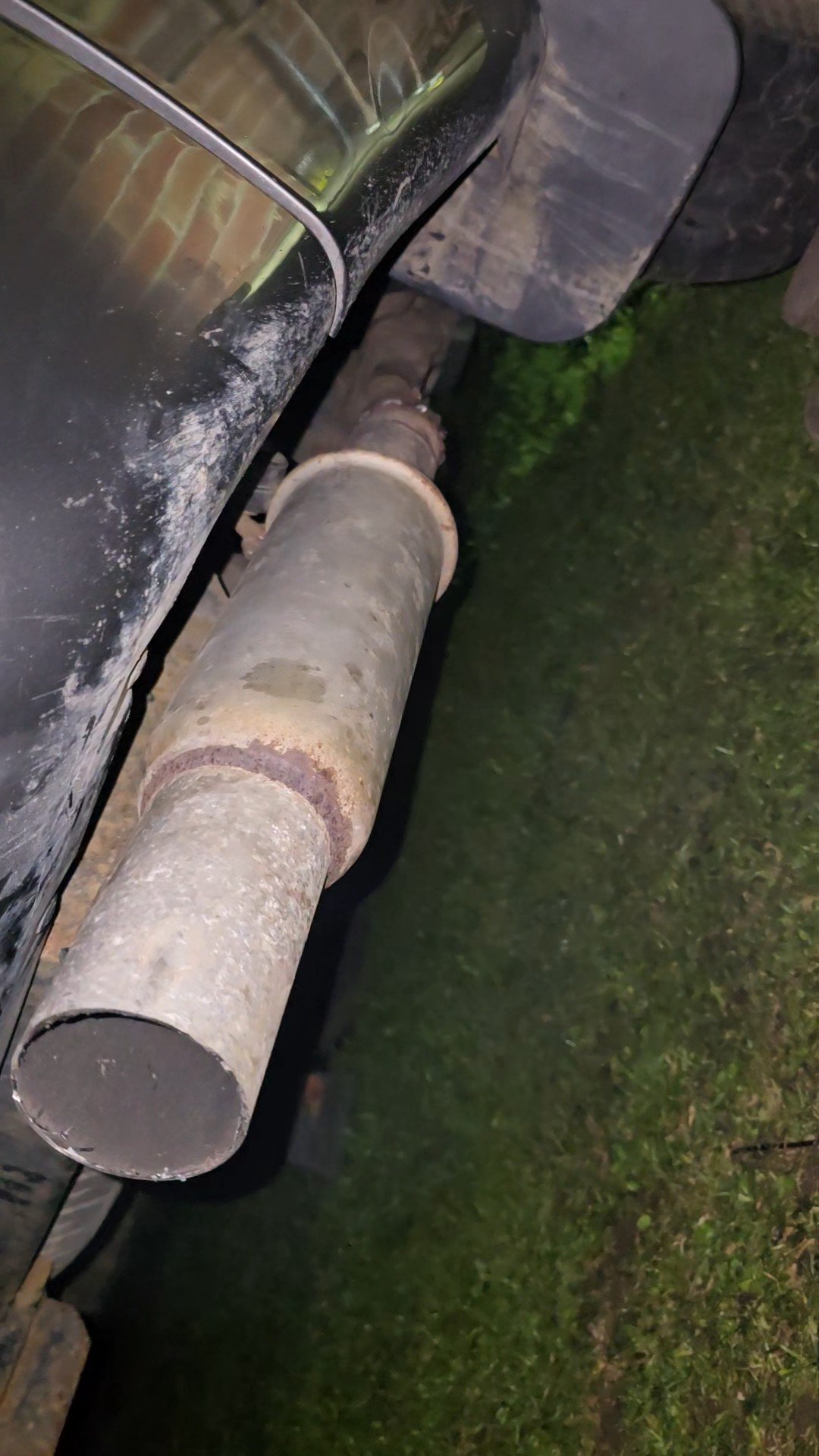

In the wind yesterday a grinder blew under the musso and the muffler fell off, it also blew under the Honda and the reso /reducer section of pipe fell off
Don't know why it has that weird bulge, possibly was fitted under a bit of compression and all the super hot exhaust from the single cam honda powerhouse softened it?
Another gust of wind blew some seagulls under the musso and welded it in.
The welds are ugly and the pipe moved as the seagulls didn't do a good job of holding the hanger in position
But it now moos and makes some 5 cylinder noises
Bum dyno says its no faster

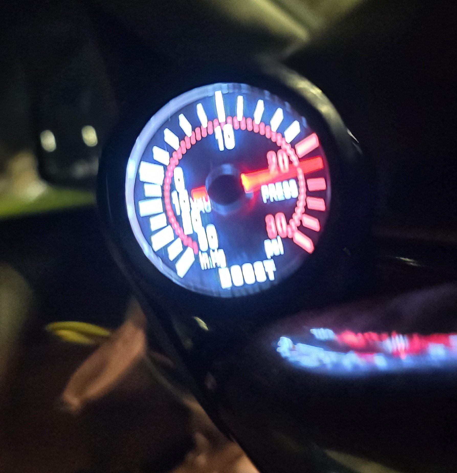

So instead of actually checking trans fluid level I'll just give it a another turn and a bit on the fuel screw and if I can't find the aliexpress boost tap might just plum the wastegate diaphragm to atmosphere
Just need to win lotto and get a om605 as thats dohc /revs higher
  • Like 6
Probably should have cleaned the camera lense but you get the idea

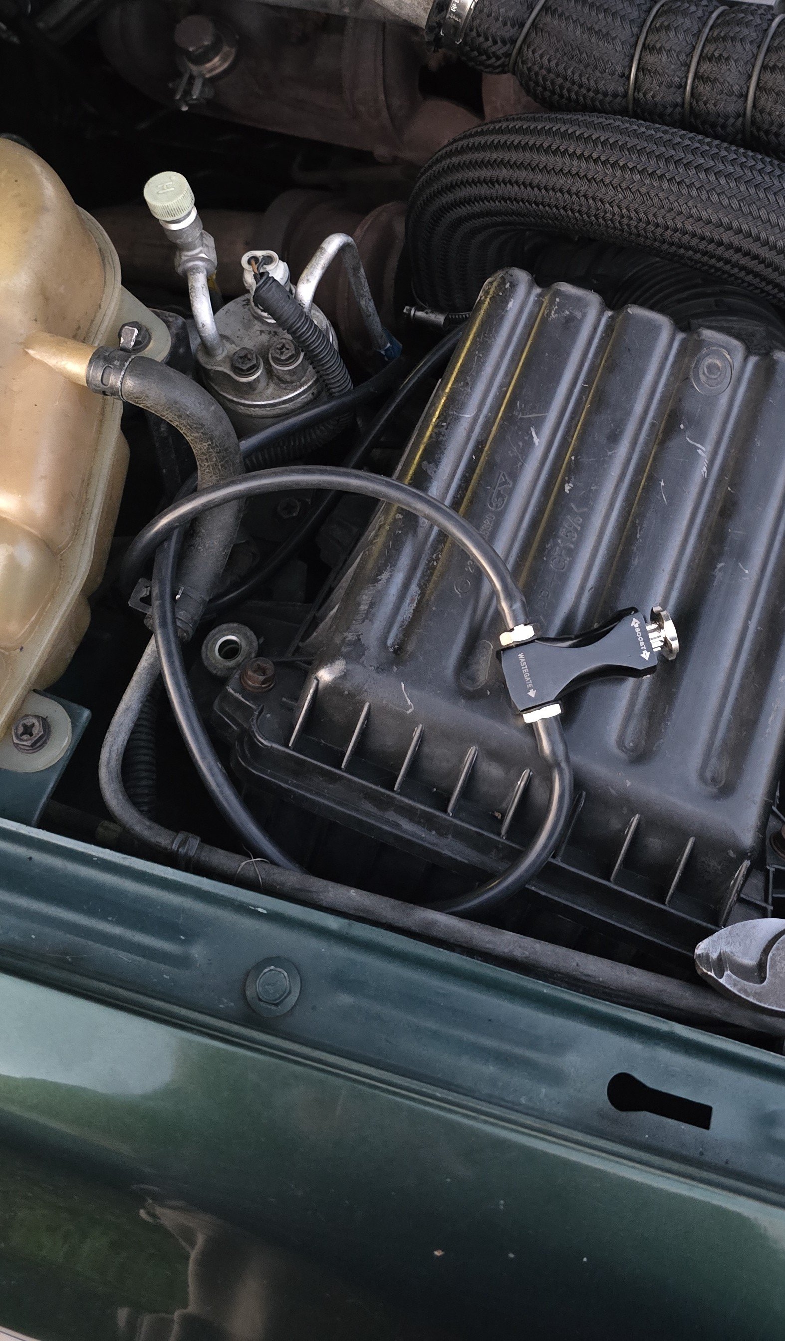

Found the alix boost tap and installed that
Gave the pump another turn and a half on the fuel screw
So it's 3 turns total now on the fuel screw.
I might actually have to spend 5 mins with the multimeter and re check the tps, transmission computer has decided its just a 3 speed and 4th along with torque convertor lockup aren't the options I get today
Seems to go better now ignoring the fact 4th isn't engaging and the pump/Governor is reducing fuel as its close to redline

do you know what psi the oem bov opens at, might be getting close at around 20psi.  if u give it too much more you may just be blowing it straight out
No blow off valve on this diesel.
Unless you mean wastegate and its blowing the gate open? If that's the case then I'll happily ignore it

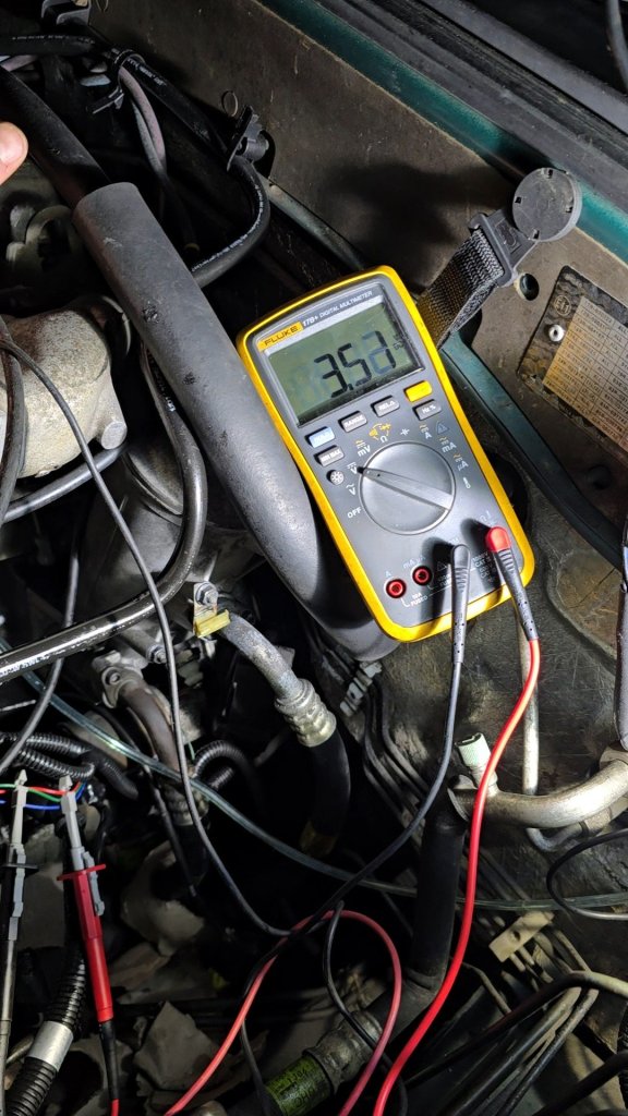

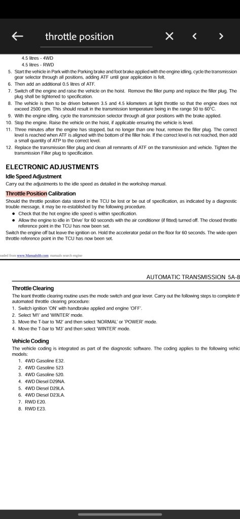

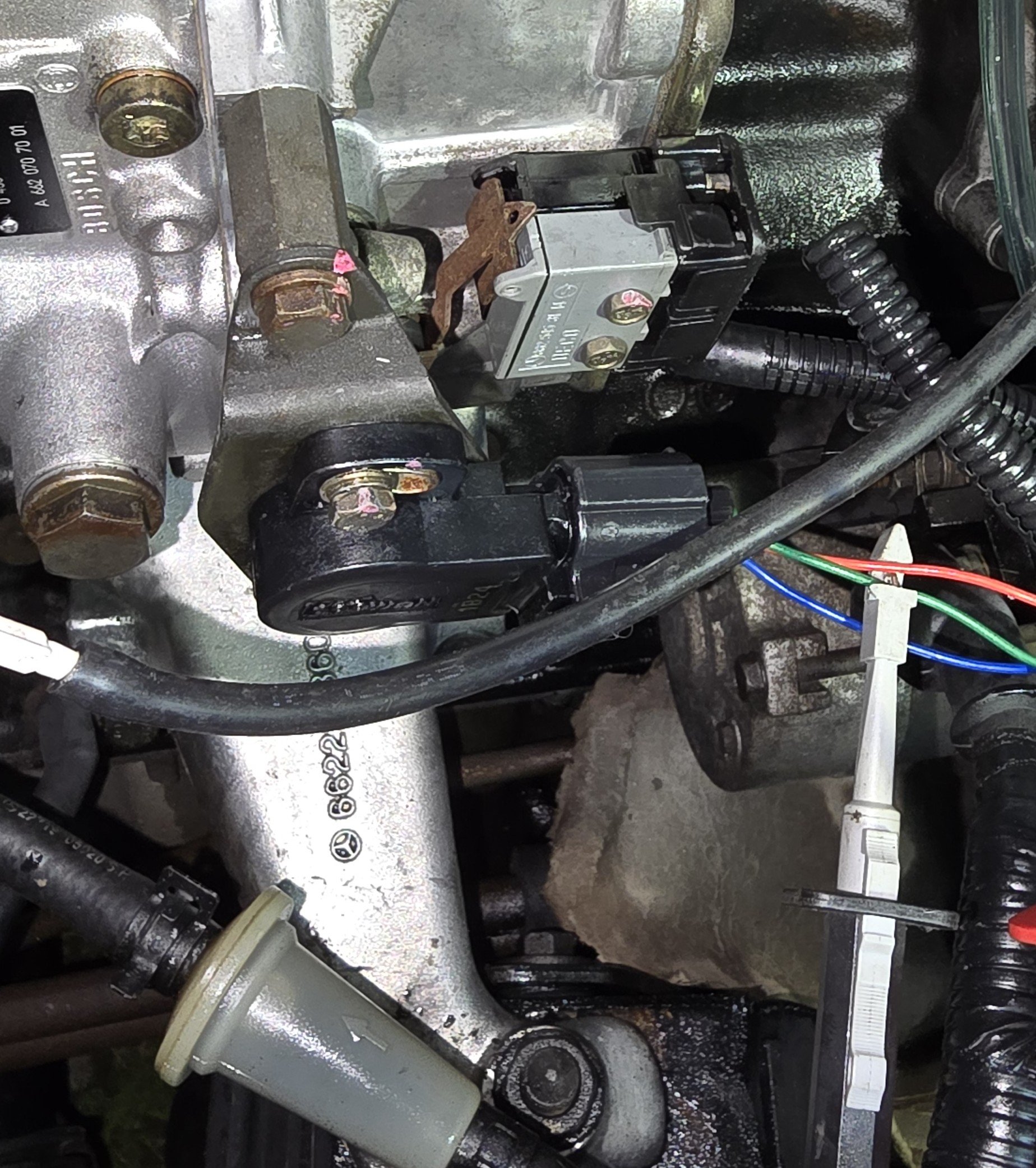

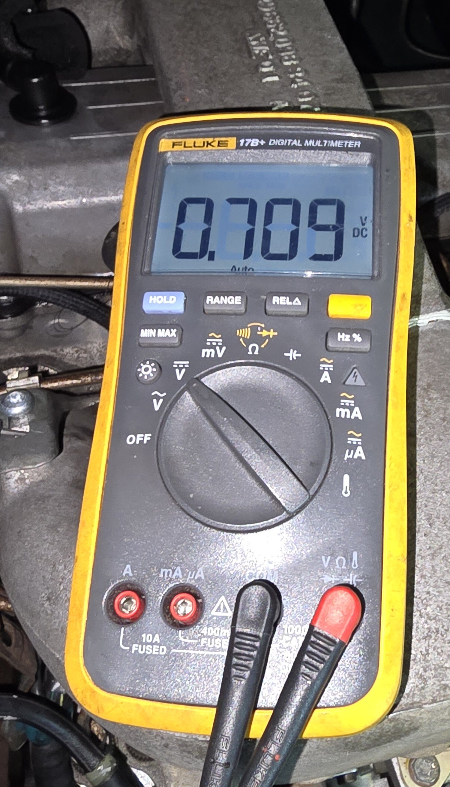

Spend 3 hours looking for a workshop manual that had tps voltages in it. Finally found one and grabbed the multi meter out.
Spec is meant to be 0.3 - 0.9v closed and above 4 wide open.
It was quite far out of spec. Can sort of see the pink dot on the screw and tps where it was originally set
20250802_193612.thumb.jpg.499c4cebf37914455a6e8f99ee231024.jpg20250802_193608.thumb.jpg.ef5787fbac77725c4d4586ea7c05482f.jpg
This service manual has the (hopefully) correct re learn procedure
Screenshot_20250802_194711_AdobeAcrobat.thumb.jpg.aa7811a1608a922be24c075e5ff33d17.jpg
Here's hoping that it behaves like it should now
  • Like 5
The aliexpress boost tap thing probably is blocked and it's free boosting but I'm not going to do anything about it
Now the tps is set and re learned the trans is shifting the nicest it ever has in my ownership.

Edit: I did do something about it
Turned the boost tee down to one 'click' from the bottom (peaks at about 16 psi now) instead of 5 and it's slightly faster, probably not full of super hot air and turbo was way off its efficiency map

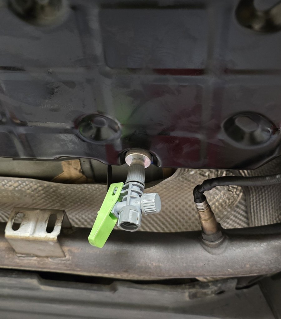

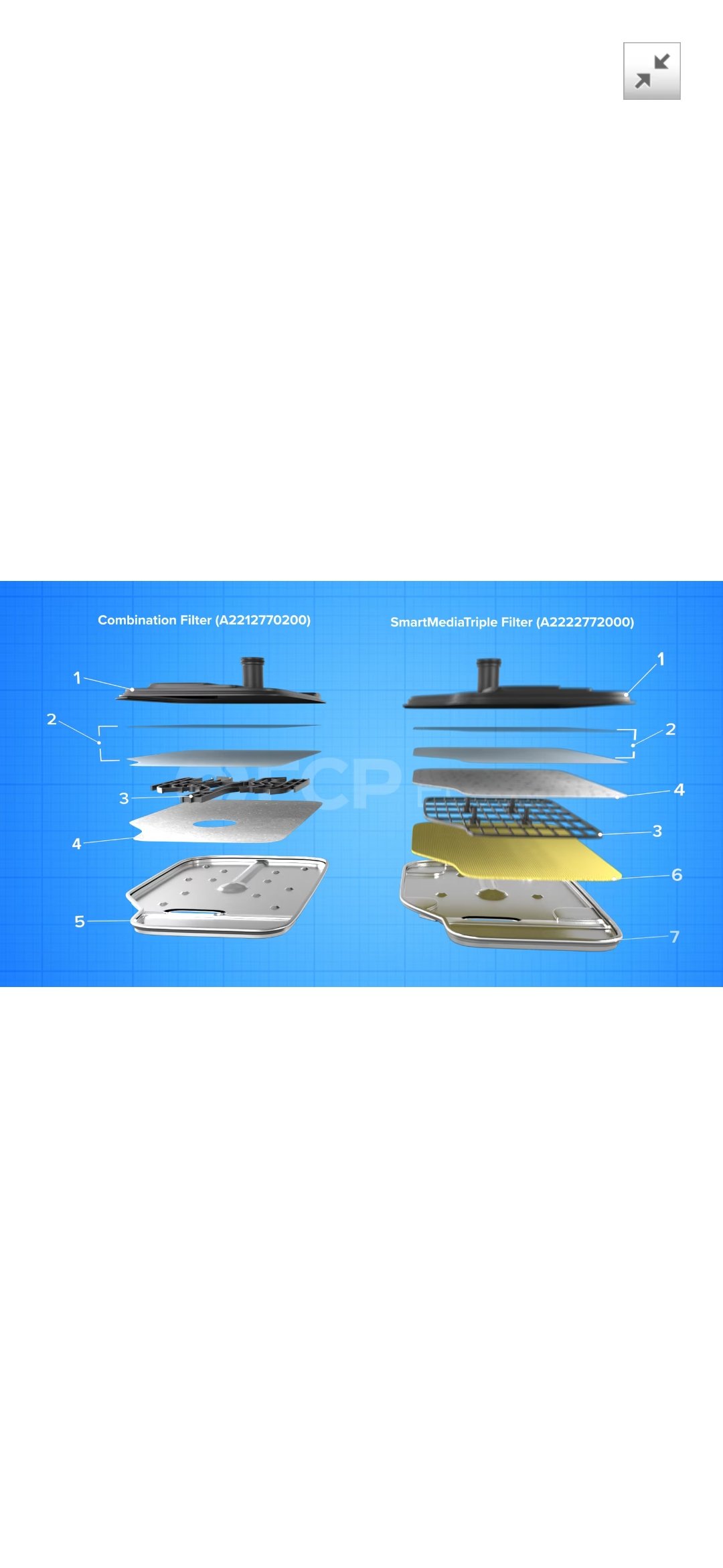

Been meaning to give the merc wagon a trans service since I got it, just so my inner barry knows its been done. It was a good excuse to go for the  2012+ 'deep' pan with the much better filter
Borrowed a hoist (thanks Jason)
Drained the old fluid and dropped the old pan. The fluid was a bit brown but didn't smell horrible.
Nice and clean in there and no glitter or excessive clutch material in the pan.
Fitted the new 'deep' pan with new single use aluminium bolts and very carefully tightened them to not snap off nm of torque
Used my genuine Mercedes transmission fill tool and pan adapter made by@Raizer20250809_1802532.thumb.jpg.054c238f856c30bf502d386194769ad1.jpg
There's no dipstick on the 722.9 trans in this, there's a factory 'tool' which is a dipstick. There's a little plastic tube that clips into the pan above the drain plug. Spec is run the car until transmission temp is 45 and the fluid no longer drips out of the drain plug.
It shifts even smoother now.

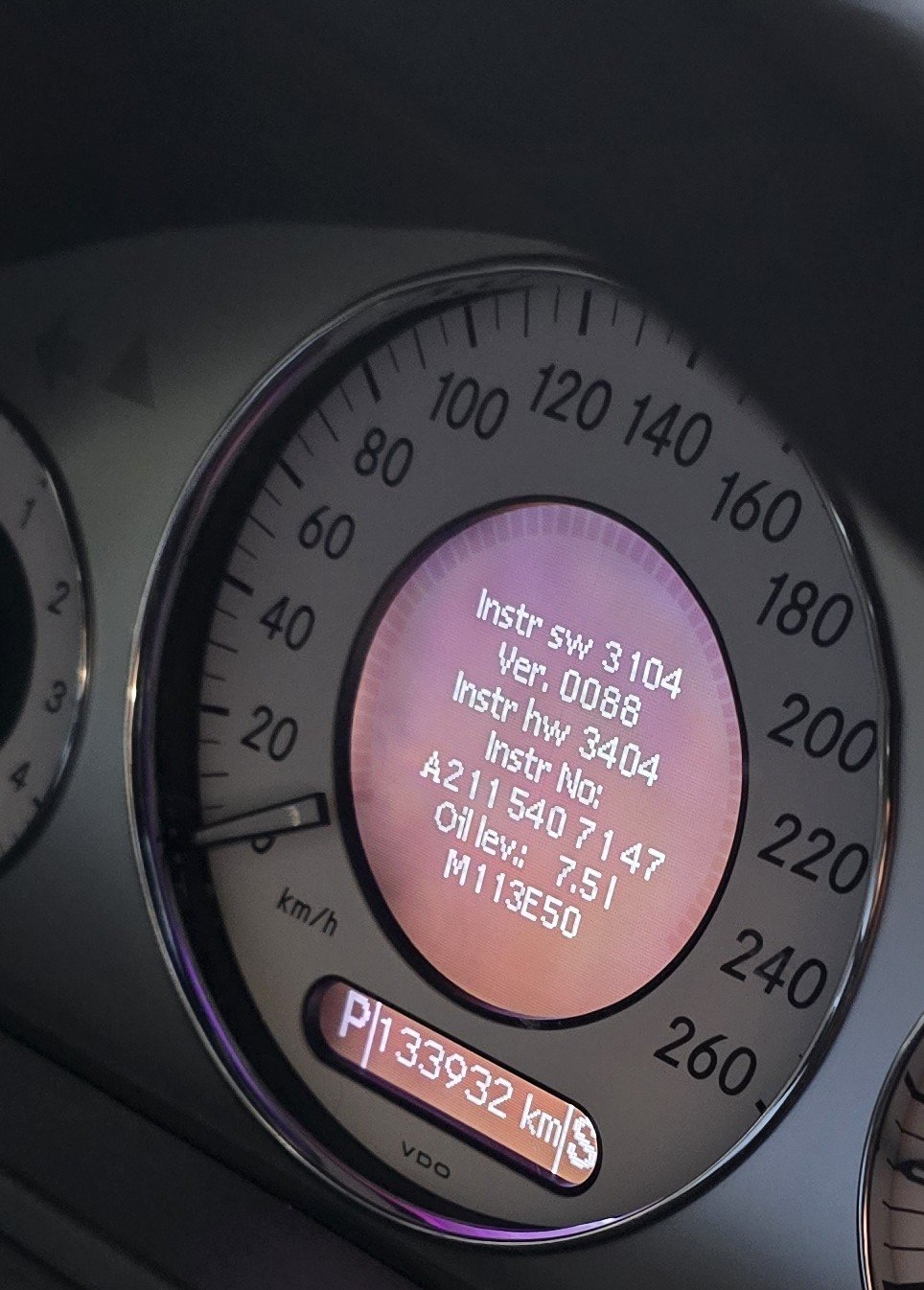

Engine on this doesn't have a dipstick either but a service menu in the dash tells you how much oil it's got

The resonator was fine for scumbaging around commuting but as I'm heading to Hastings soon figured I'd get something a bit quieter. Kept a eye on marketplace and scored a coby muffler for $30.
Carefully back purged the pipe with burning grass and mud smoke due to my excellent work area and preperation
Sounds less bad now
