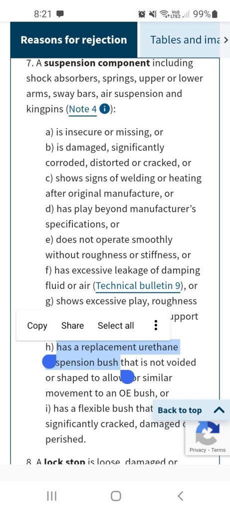

chris r Posted April 24 Author Posted April 24 Because I'm a sucker for punishment and a bit dumb I dropped the musso off for a wof check this morning. Failed but where's the fun in owning something reliable... Yeah that's fucked Now to try and find one in stock or available to buy in nz. I've found a bush in Latvia but don't know if it'll arrive in time for a recheck. I've left the bush with the local bnt so hopefully they can magic something up 5 Quote
chris r Posted April 24 Author Posted April 24 After a look on carjam it's one of 69 (heh) registered musso in nz so not exactly a common vehicle for anyone to stock parts for. I've found another bush in Malaysia so might be a bit quicker to ship than Latvia but am waiting to hear back from the shop about it Edit Malaysia shop has the correct bush in stock, shipping is 3 times the cost of the bush but its DHL express so should be here in time for wof recheck. Will see what BNT come up with tomorrow Quote
Bearded Baldy Posted April 25 Posted April 25 Measure the bush up compare to hiace and prado. Superpro website i think has the best search by size. 1 1 Quote
chris r Posted April 25 Author Posted April 25 Thanks! Bush is with bnt who seemed to care /give a shit so I'll find out how they got on tomorrow /Monday 1 Quote
Raizer Posted April 25 Posted April 25 11 hours ago, Bearded Baldy said: Measure the bush up compare to hiace and prado. Superpro website i think has the best search by size. That was my suggestion too, also to try BNT but be prepared to spend ages comparing it etc. Or turn a pair of shells from aluminium and solid mount the thing ha 1 Quote
Bearded Baldy Posted April 25 Posted April 25 I would not enjoy that argument.... Aluminium is not a urethane bush so technically doesn't need voids, but the original bush was designed to flex, which aluminium doesn't. I would be inclined to fail it myself, while admiring the ingenuity. However a few wraps of self amalgating tape around the rack under the bush, removes play and does allow flex, also does covers the 'no heating or welding of components'. Not that i would ever suggest you do such a thing in the interim and fit the new bushes later. 5 Quote
chris r Posted April 27 Author Posted April 27 I was thinking about packing it out to reduce the slop, I think some of why the inspector failed it is the visual condition of the bush too which is fair enough. Also I'm feeling lazy and don't want to drop the whole rack to pack it out and replace the bush, I'm hoping to be able to just squeeze the new bush in without removing the rack. I'll call bnt tomorrow lunch ish and see how they got on. If no luck then I'll get the Malaysia one sent over and refit the worn one for now. https://www.w124performance.com/service/Index/602_603/05Engine.htm I'll leave this link so I can find it again for service manual stuff for the head as the ssangyong manual I found isn't as detailed 1 Quote
