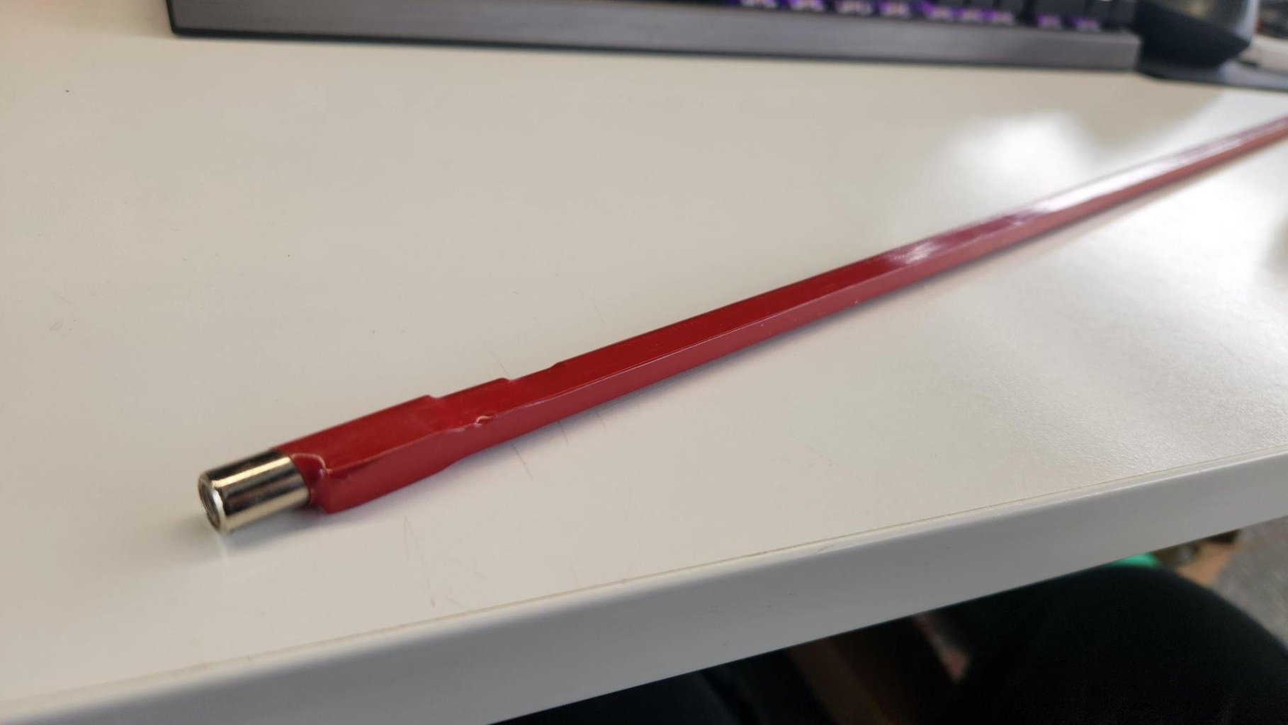

BlownCorona Posted July 21, 2024 Author Posted July 21, 2024 I do, but they are out off stock for their bass rods. the truss rod is really the next thing i need to order, despite preferring to look at shiny tuners and bridges. Quote
ThePog Posted July 21, 2024 Posted July 21, 2024 Ah i wondered of you were going to bother given the contruction and stiffness etc. Probably best to have some form of adjustment though, it would be a shame to do all that and have it unplayable. Quote
BlownCorona Posted July 21, 2024 Author Posted July 21, 2024 i certainly will, far too much risk to not have any way to adjust the neck, doubly so when that neck doesnt come off. though if anything goes horibly wrong i can still route out a neck pocket and convert it to a bolt on. if you have any other recommendations for quality truss robs im all ears, otherwise im sort of thinking about just making one in the same style as the stewmac ones. for all those unaware of what we are talking about here, in the neck of most guitars and basses exists a component call a truss rod. this component is an adjustable method of counteracting the forces from the strings (in the case of a bass, it can be a metric fuckton of tension) and this force arches the neck forwards. To a certain degree we want the neck to have an arch, otherwise when pressing down on a fret, the string would touch multiple points but if the strings pulled too much of an arch, it would be unplayable or it might even snap. the truss rod applies an adjustable force in the opposite direction by way of two rods, one fixed length and the other adjustable, causing the assembly to bow and allowing a balance to be achieved. there are a few different setups but they usually all follow this general idea. Quote

BlownCorona Posted August 5, 2024 Author Posted August 5, 2024 yeah ive gone down the youtube hole of 3d printed guitars and basses, some people have real solid success. I also enjoyed the solid bronze bass which the guy smelted himself. it weighed an ungodly amount and he couldnt play a full song without it cutting the circulation to his leg off. He never put it on a strap because he was terrified of the strap breaking and it crushing his foot. hilarious. i 3d printed my model for fun and to have a bit of a real world look as sometimes cad models on a flat screen can look a bit weird. It now lives on my desk as decoration. A test cut with some MDF and then ill be cutting the hardwood. truss rod from Stewmac arrived today aswell, and 90% of the hardware has been selected, purchased and is sitting in a freight forward depot in the states to consolidate freight to nz/make use of free US shipping. 1 Quote

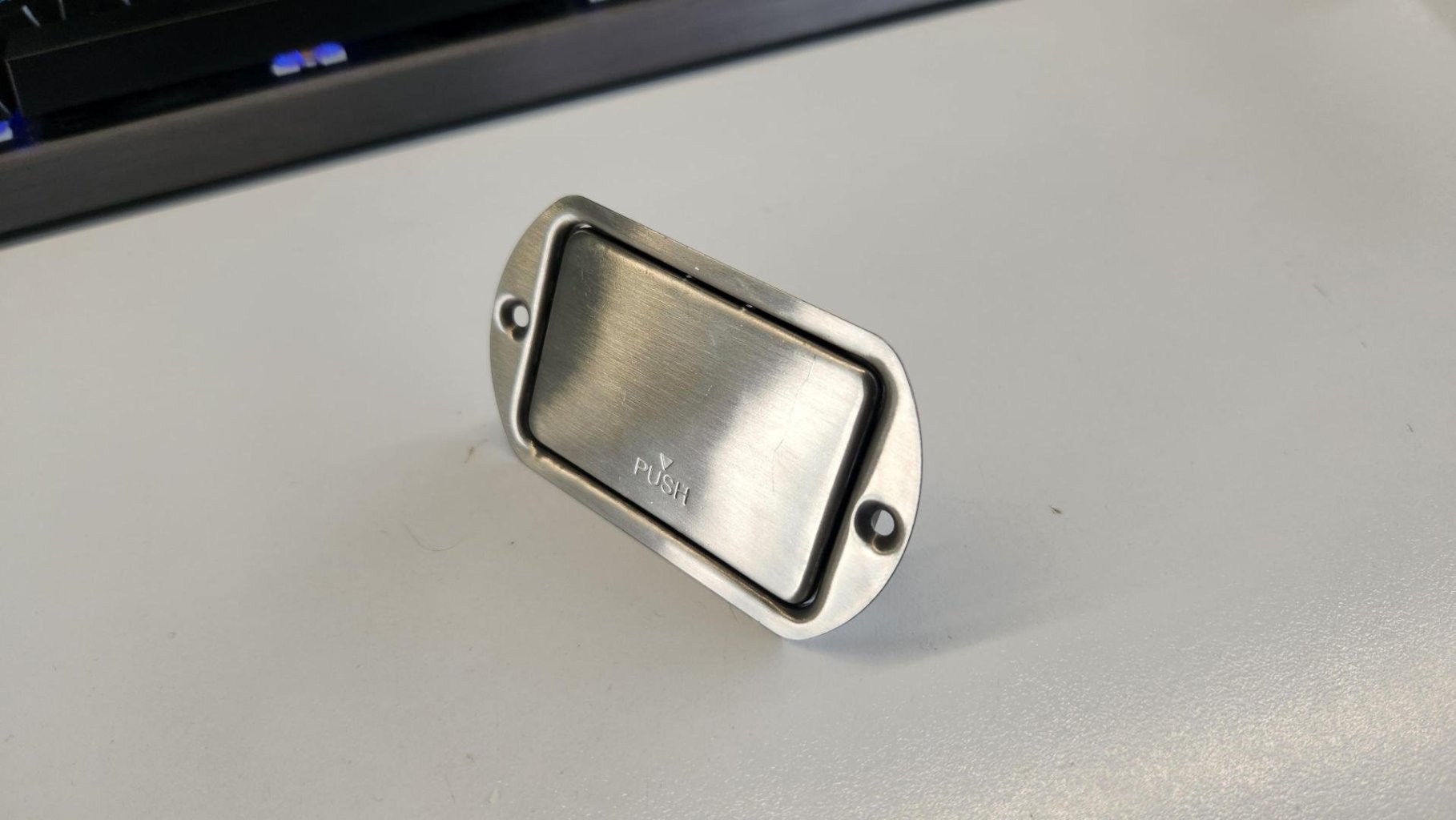

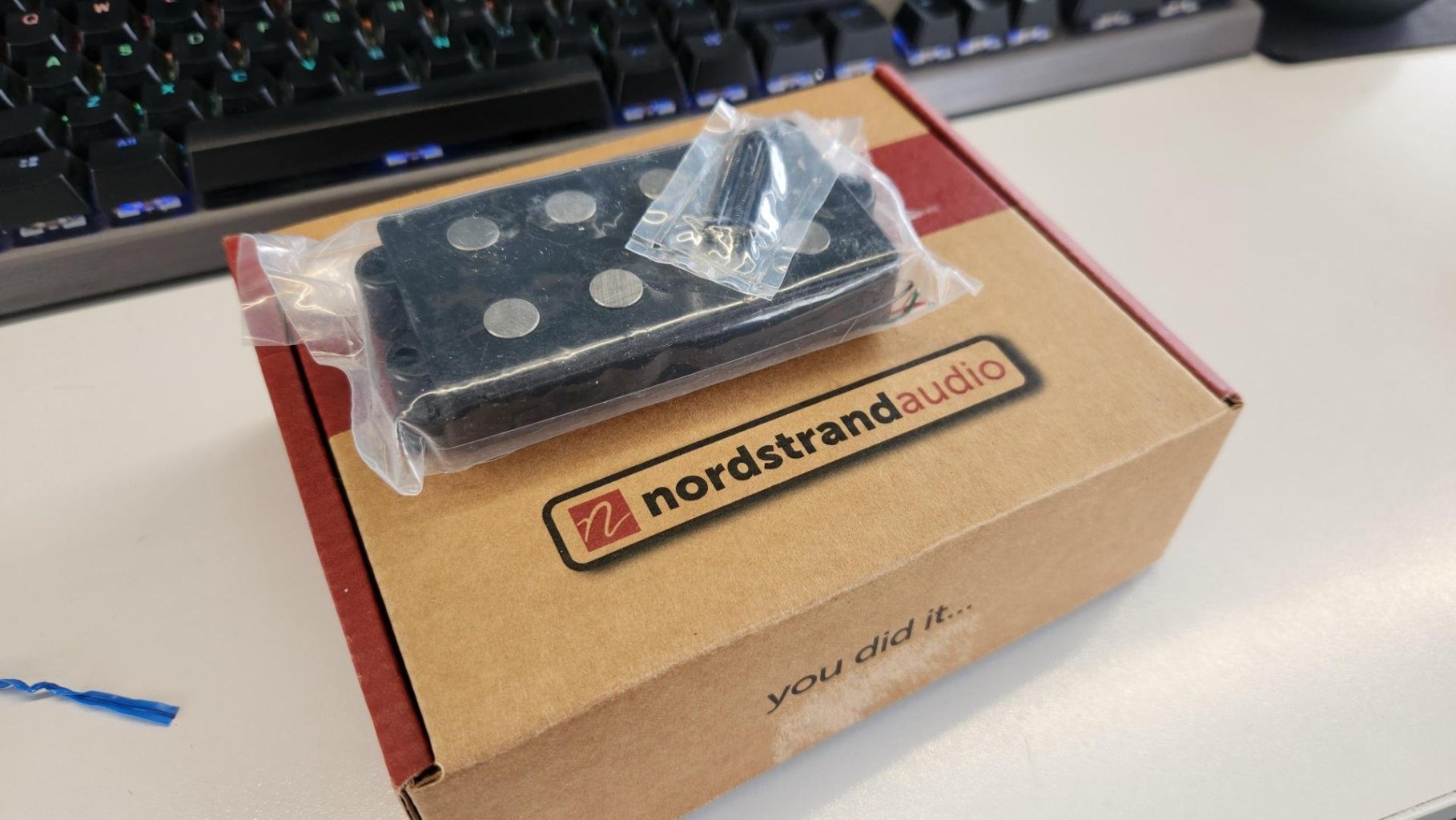

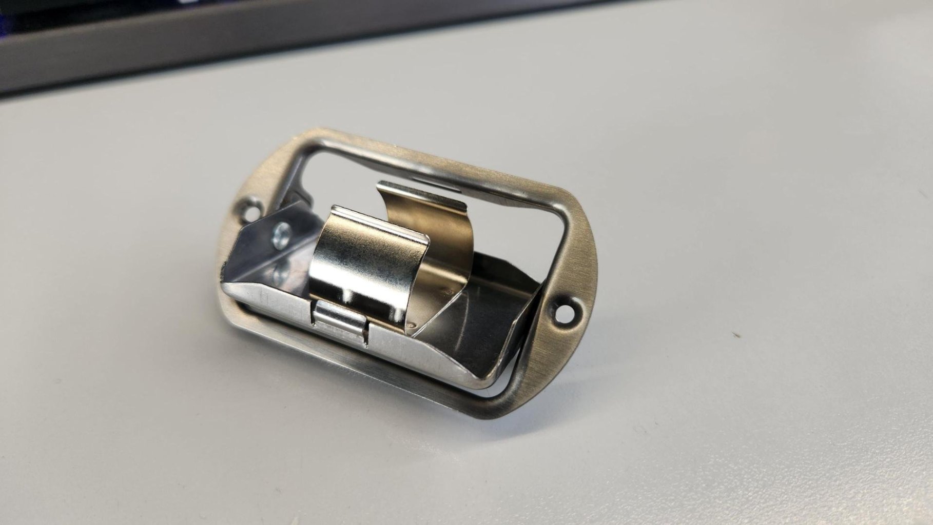

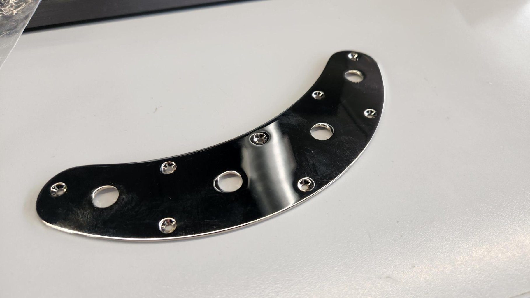

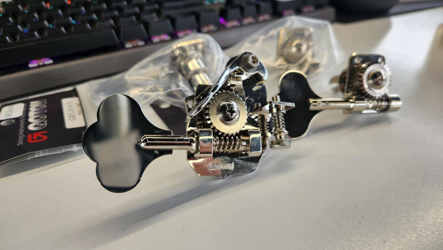

Popular Post BlownCorona Posted September 18, 2024 Author Popular Post Posted September 18, 2024 And heres a long and expensive list of things ive bought. however the amount of money ive spent is still less than buying the cheapest good quality instrument from a shop and this (should) be of far far higher quality. the most important first. Nordstand MM4.2 Pickup. This is one of two options i found for recreating the original sound faithfully (in conjunction with the correct preamp - more on that in a later episode) The the tuning machines. Gotoh Res-o-lites x3 and one Hipshot drop D tuner for the e string. this is unnecessary but i really wanted one. it allows you to pretune the E string to D and lets to flick a lever back and forth for the two tunings. just cool. Gotohs over Hipshots for the other 3 because they were substantially cheaper and look the same, still really high quality. StewMac truss rod Nickel Plated control cover Cool little stainless steel preamp battery holder. i dont want any plastic. and a set of standard but correct spec strings 11 Quote
