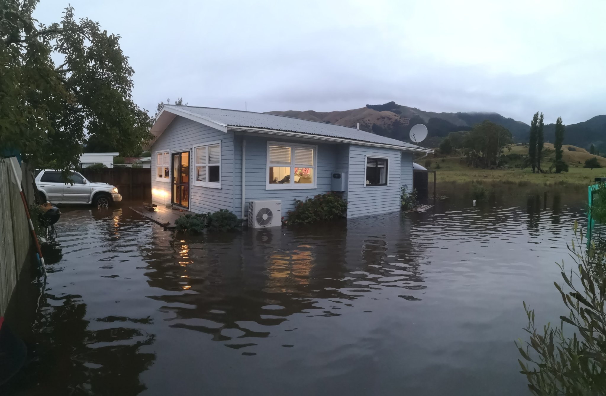

Two years in the making and on Monday we finally take possession of the next house project, well, actually two houses.. You may have seen a couple of pics from when we first shifted in about two years ago, namely this one..
Looked pretty bad but it never made it inside the house, we partially evacuated but we're back in two days later after the water went down somewhat but it was a particularly wet winter/year in general and we spent the better part of 6 months with water continually at the back of the section and under the shed at the back. After it did it again in the big August rains we pulled out of what was to be this house subdivided from the front house and offered a price to buy the whole place. But after being out again at the beginning of last year we pulled out again. After looking at multiple other options that for some reason fell through we negotiated a reduced price on this and decided to take it, it is actually in a nice area with a great outlook.. A bit small for 6, 4 wheeled projects but meh, we'll see what happens....

Good to see a couple of paddles handy.. but in all seriousness, looking forward to hearing your plans to remedy the flooding.. Would it be a matter of better redirection of the water or raising the house onto a basement for said vehicles as well as water management away from site?

The plan is to raise the house and the land around it depending on costs etc, but in the 2011 floods it had about 250mm of water through it and thats worst case scenario, so we're gonna go up about 4-500mm. Both properties either side have a higher ground level than us as well to we get runoff from all sides, but we'll lift the ground level higher than them so we stay dry..

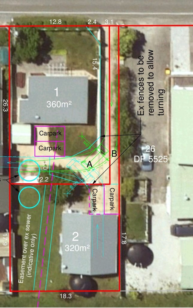

So this is the original subdivision plan, ours is the back house with zero parking, an easement right through it and the need for a second water tank only for firefighting. As you can see it's set up to prioritise the front house.

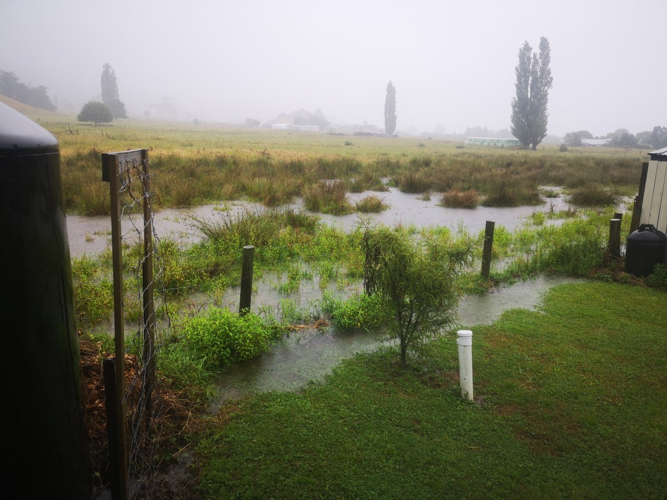

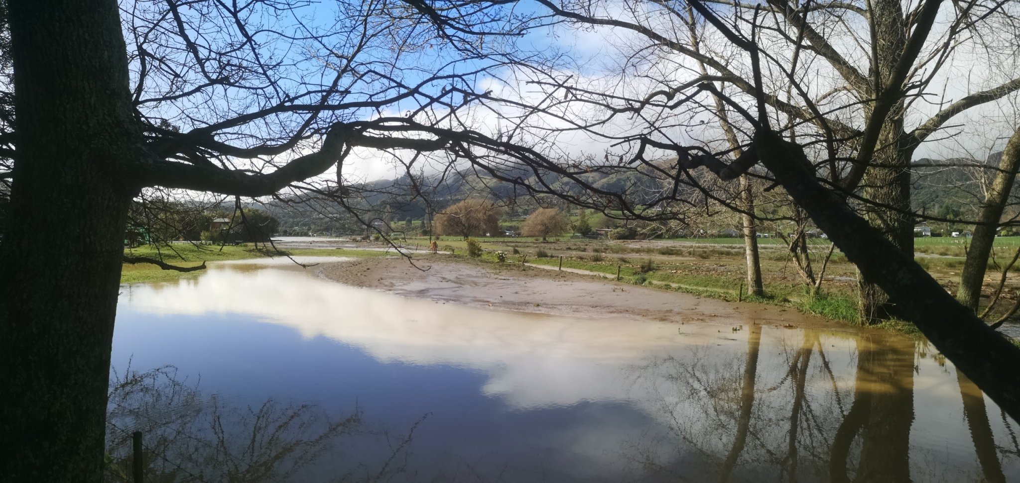

This the day before showing the location of the wetland behind us if you zoom in below the three poplars you can make out a row of fence posts, they mark the location of the Bartlett creek and the source of the flash flooding.

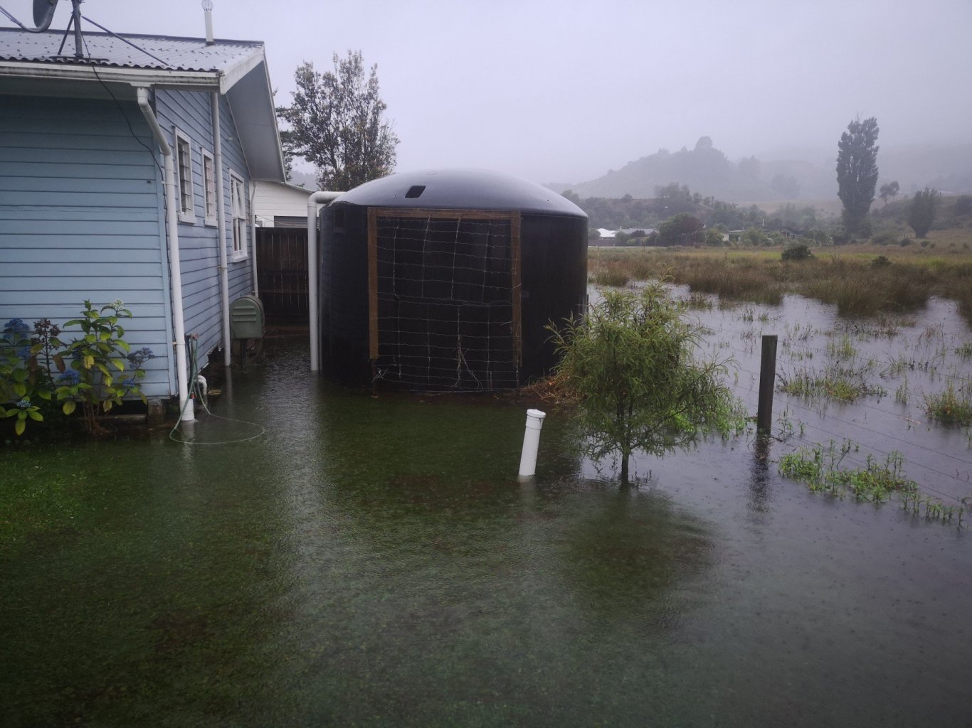

In this pic you can see by the top of the water tank a gate in the distance this is where farmer has blocked Bartlett creek with a 300mm round culvert that can't handle the jandle and blows it's load all over the paddock behind us.

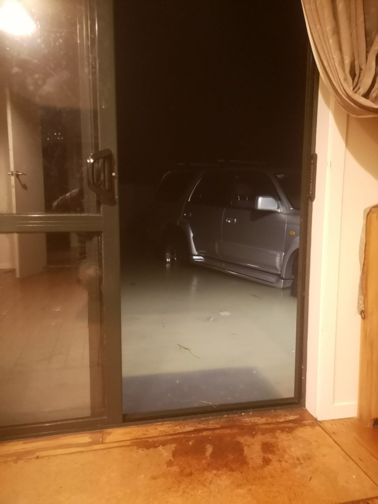

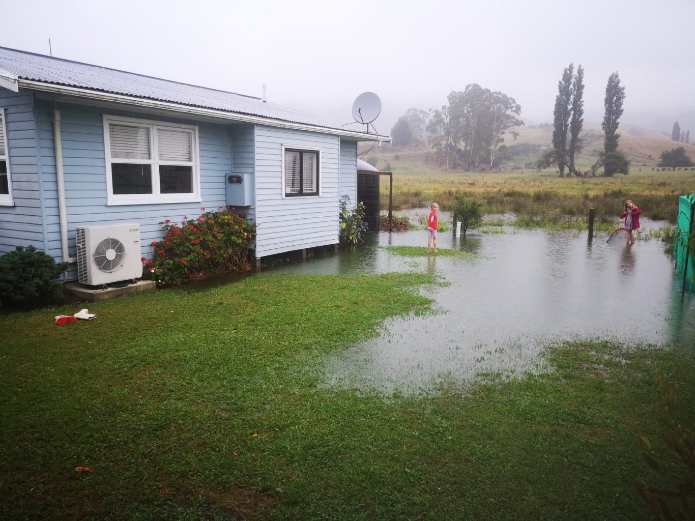

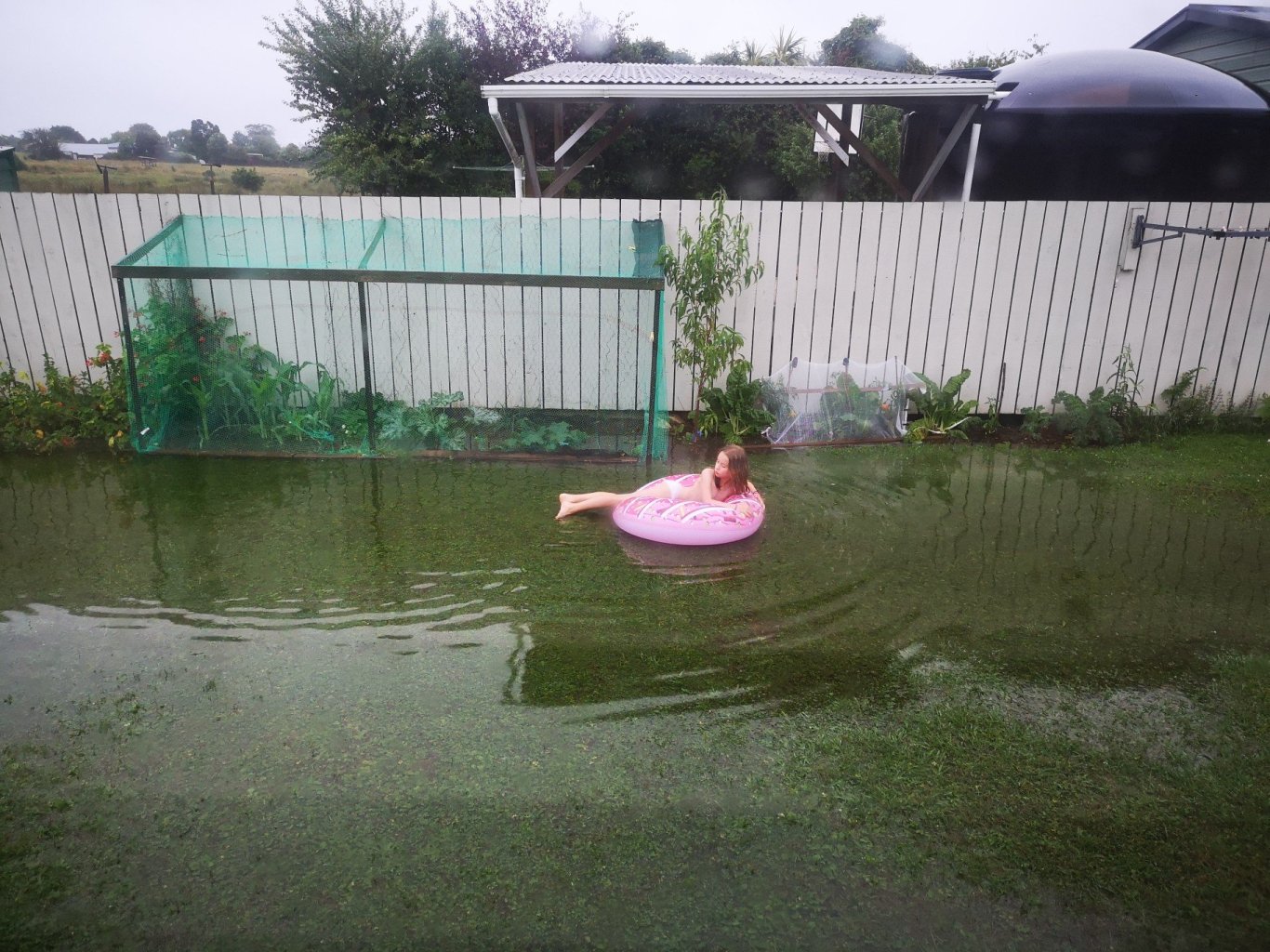

It was fun and games initially..

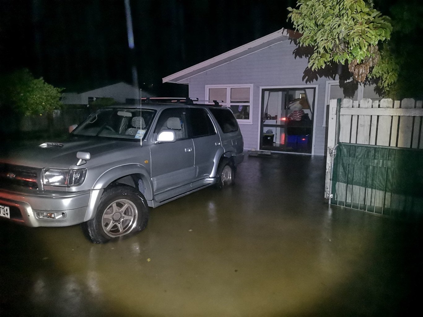

But in reality getting woken up at 11pm to evacuate isn't so fun..

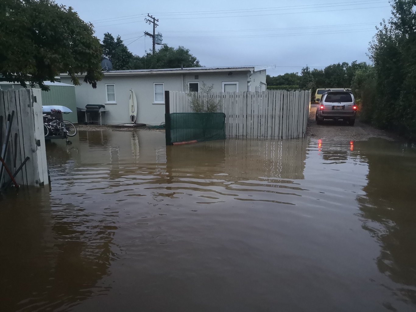

Looking back up the drive to the rental which is about 150mm higher than ours, the council has a lot answer for, like, why the fuck let our house be built lower than the front house?

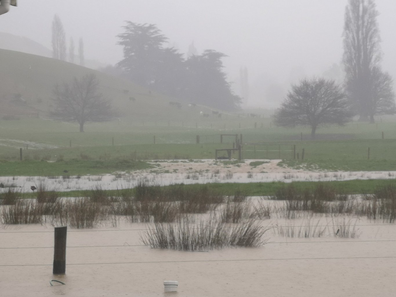

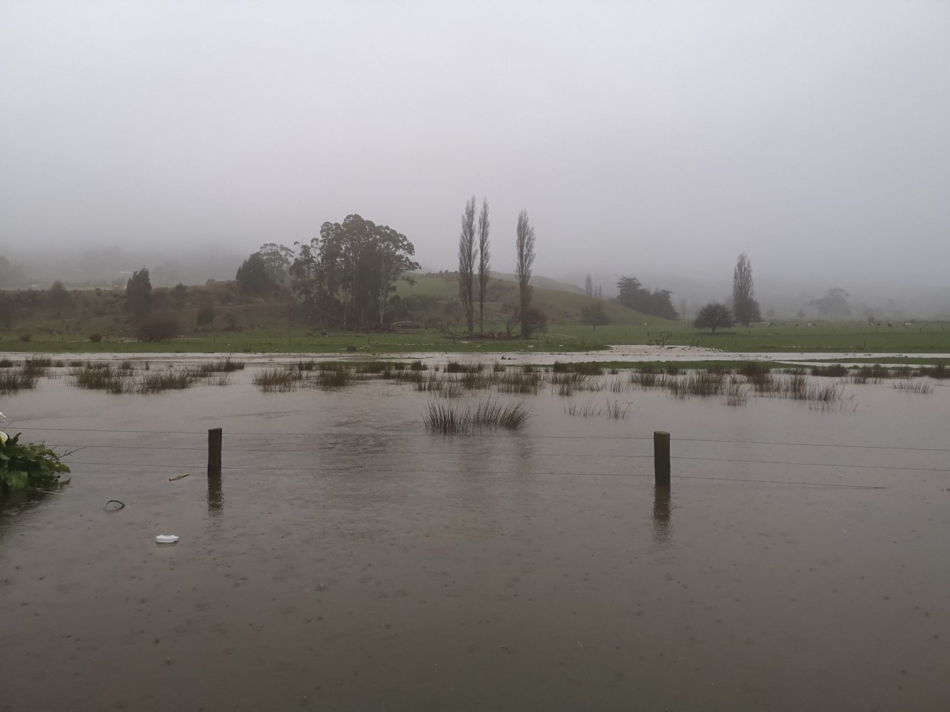

Action shots of Bartlett creek coming over.
In this shot you can see a white disc in the water, that's the top of the sewer inspection port that sticks out of the ground about 600mm (check the pics in the previous post)

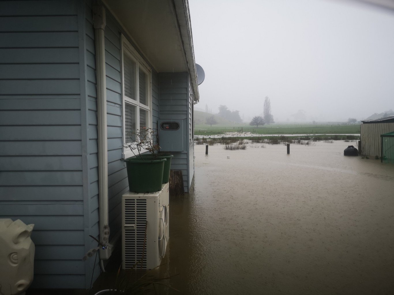

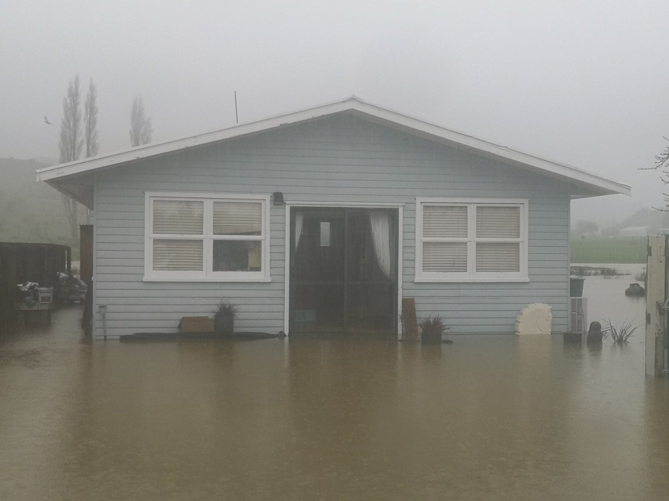

In full swing
Right up to the gunwales

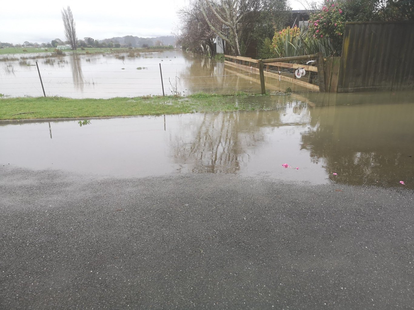

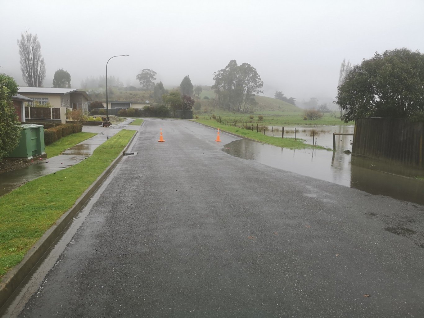

This is where the water overflowed the road and stopped it getting any higher, this is where the wetland originally drained before they put this subdivision in blocking it with this road and providing a 250mm pipe to drain both the wetland and this end of the subdivision.. Good work TDC
