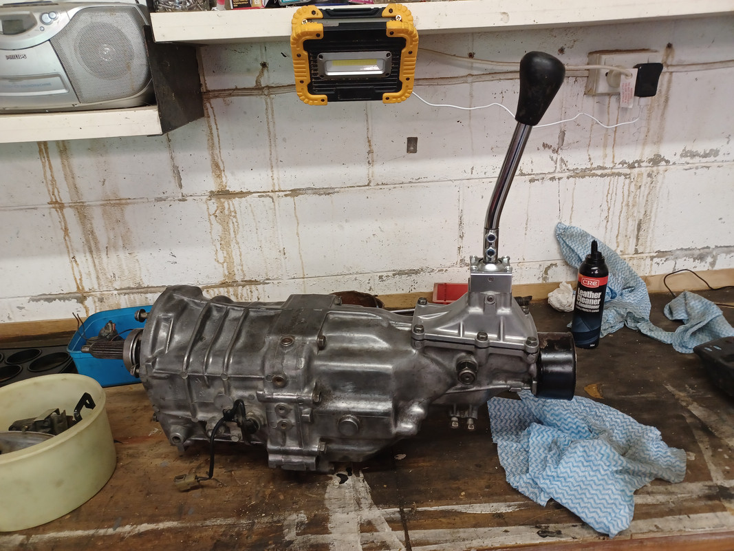

Tiger Tamer Posted November 5, 2023 Posted November 5, 2023 You could give it a good flush out with trans oil and see if anything else comes out the drain hole. Hopefully you can find another shifter assembly. You can buy parts for the shifters on trade me but that looks flogged out and nackerd. Quote
JR Posted November 5, 2023 Author Posted November 5, 2023 Cheers, yeah I think I'll give that a go. Yeah when I saw how flogged out it was I thought it could be a real mission to sort. But I've looked into it and it's actually just a bushing that's fucked. The bushing has an outer steel holder. So the plastic part is gone and it's also then flogged out the outer steel holder, which comes out and is replaceable. There is an outfit (Cube) that sells a different design, it does away with the plastic so its solid steel. I'm assuming it's quite common issue then. Quote
BlownCorona Posted November 13, 2023 Posted November 13, 2023 i have a cube shifter on my w50 in the corona. it has a nylon (i think) bush. apparently they can transmit more transmission noise into the cabin, though i never found that. im assuming those with that issue have the above steel bush. on a related note. the cube shifter is awesome. looks like theve gone up in price, but i paid about $250 and am very happy. Quote

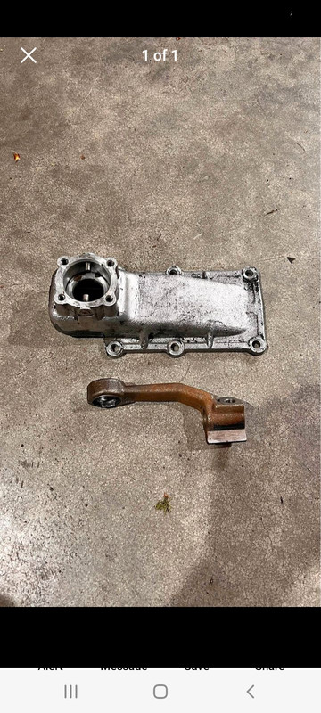

JR Posted November 13, 2023 Author Posted November 13, 2023 My aliexpress knock off short shifter just arrived today. So far I'm happy with it. Seems well made. The best part is the price $38 plus shipping. I will buy the cube steel bush though. I'm trying to find a housing and shifter shaft part for a rear position shifter like this. If anyone wants to swap, or is selling one hit me up. Quote
