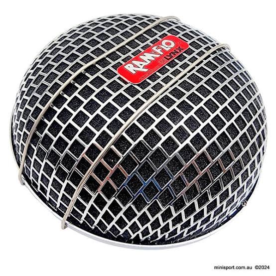

Alex - I cant use ramflo filters, because the extra torque would twist my chassis off the line

2 hours ago, Rhyscar said:
What does your filter area end up being? Seems a little on the small side compared to the size of a factory filter.
Yeah that's a fair point. Itt looks a decent size in person.
But looking up the car's that it fits, it's all fairly sedentary Peugeot stuff.
It's 330x100mm with 50mm deep pleats.
So it's still considerably considerably more filter area than nearly any pod filter I guess.
I guess surface area is more related to effective service life than anything else.
Might have to replace it every second engine instead of every fifth.
