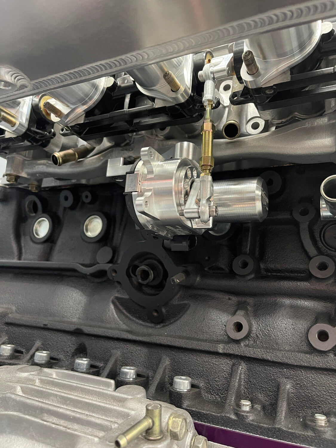

Yeah thats what the actuators look like, that operate these throttles on the factory motor. But the actuators are $1000+ each which is nuts.
A few aftermarket options like that but all cost heaps.
E36 units were about $25 each so worth a punt.
