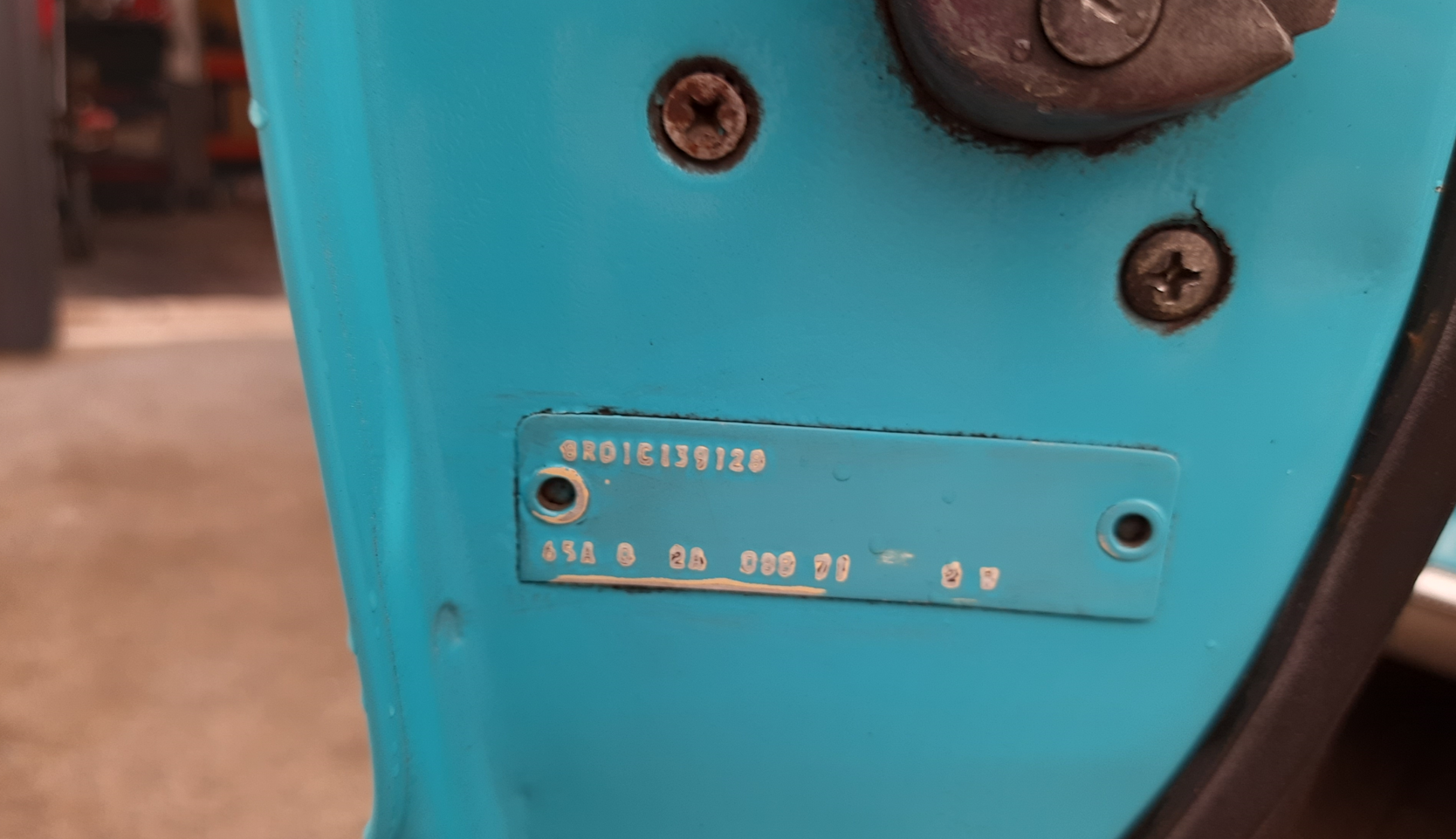

Car nerd stuff, the door plate shows a code of 8R01C139128 but the chassis stamp on the front guard is 8R01C121772. Decoded means:
8 = 1968
R01 = manufactured in San Jose
C = 2V 289
plus S/N of car. Car Jam agrees with the guard stamp but the actual VIN is on a plate on the dash that always gets covered by the dash pad when people restore them. I'll have to see if I can dig it out carefully.
The Bottom numbering means:
65A = Coupe with standard interior and bucket seats
Q = Brittany Blue (not the current colour)
088 = Not sure
71 = Los Angeles
2 = 2.79 Diff
Will have to take this with a grain of salt for now as the plate may have been changed with the door at some point.

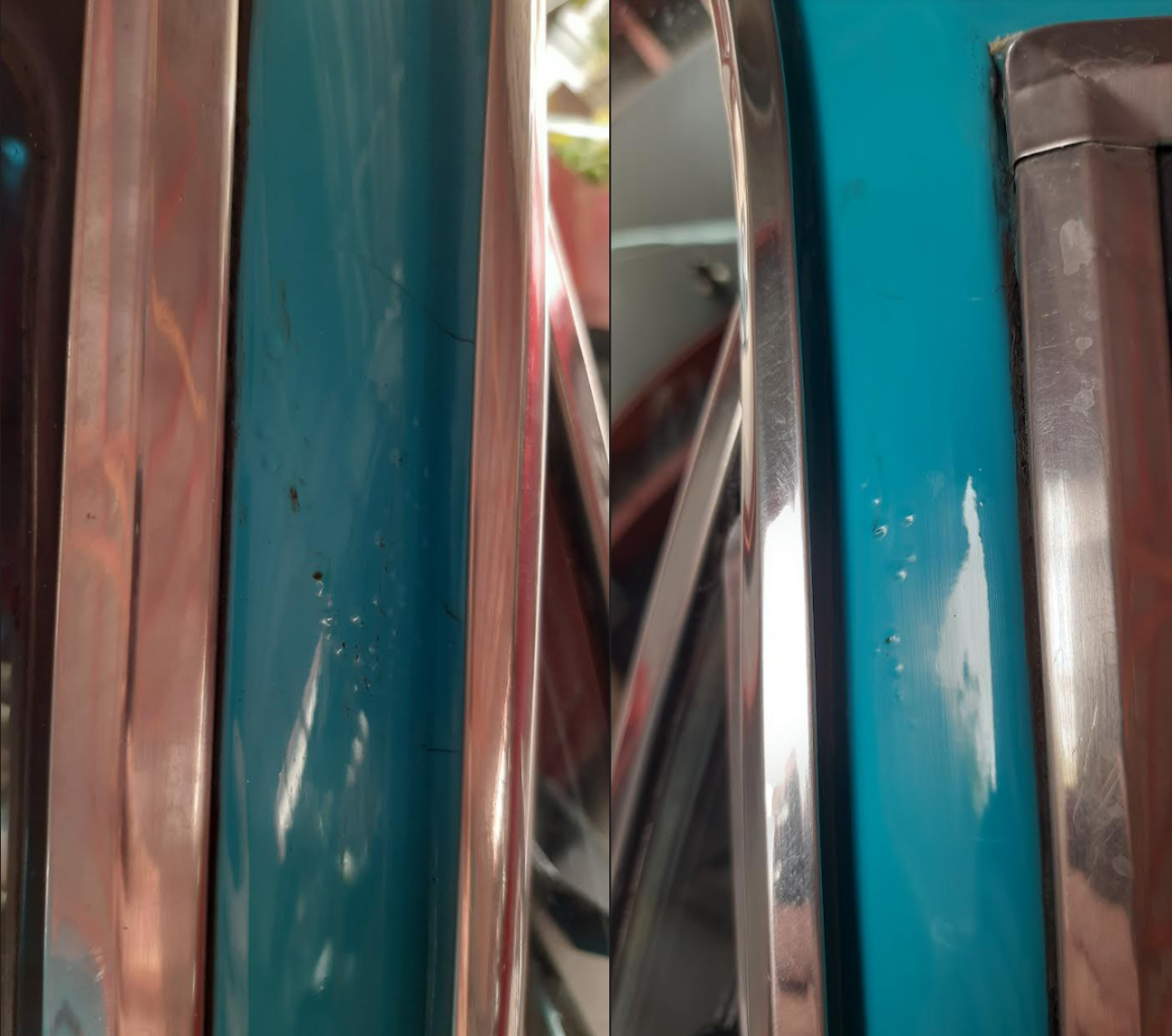

  • Rust in both A-pillars and possibly C-pillars as well. Not sure how it got a warrant on the first but the second could be a reaction to the lead filler

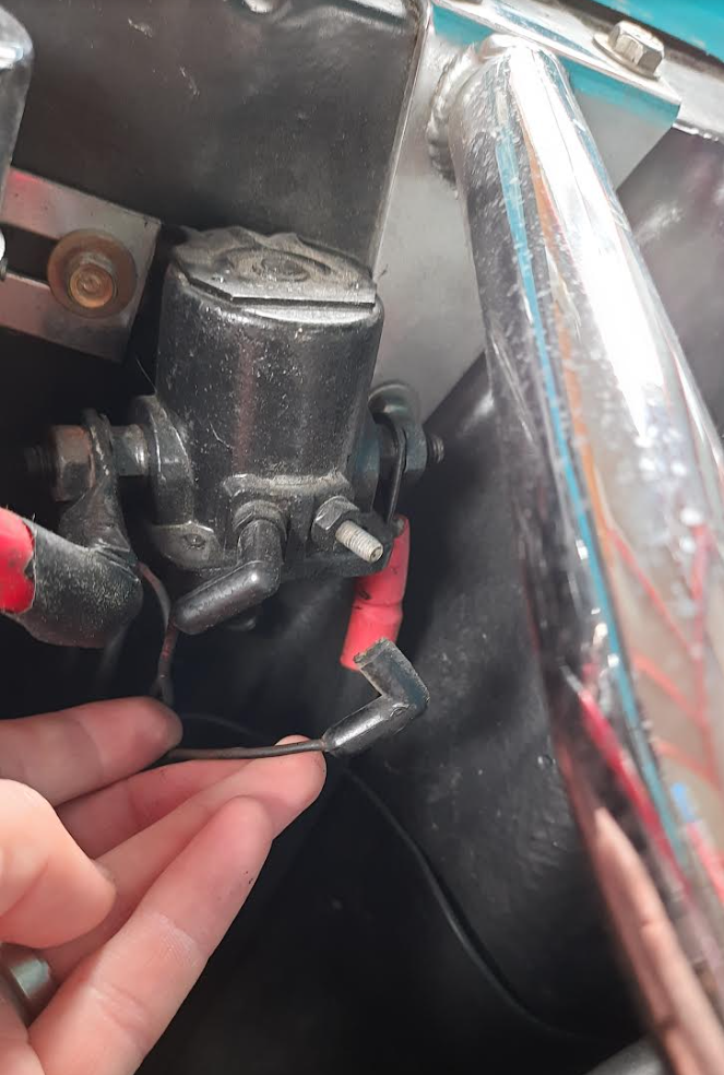

  • Random extra wire on starter solenoid that apparently shorts the car out and kills it. I think this is a ballast bypass wire and is not needed due to having a pertronix

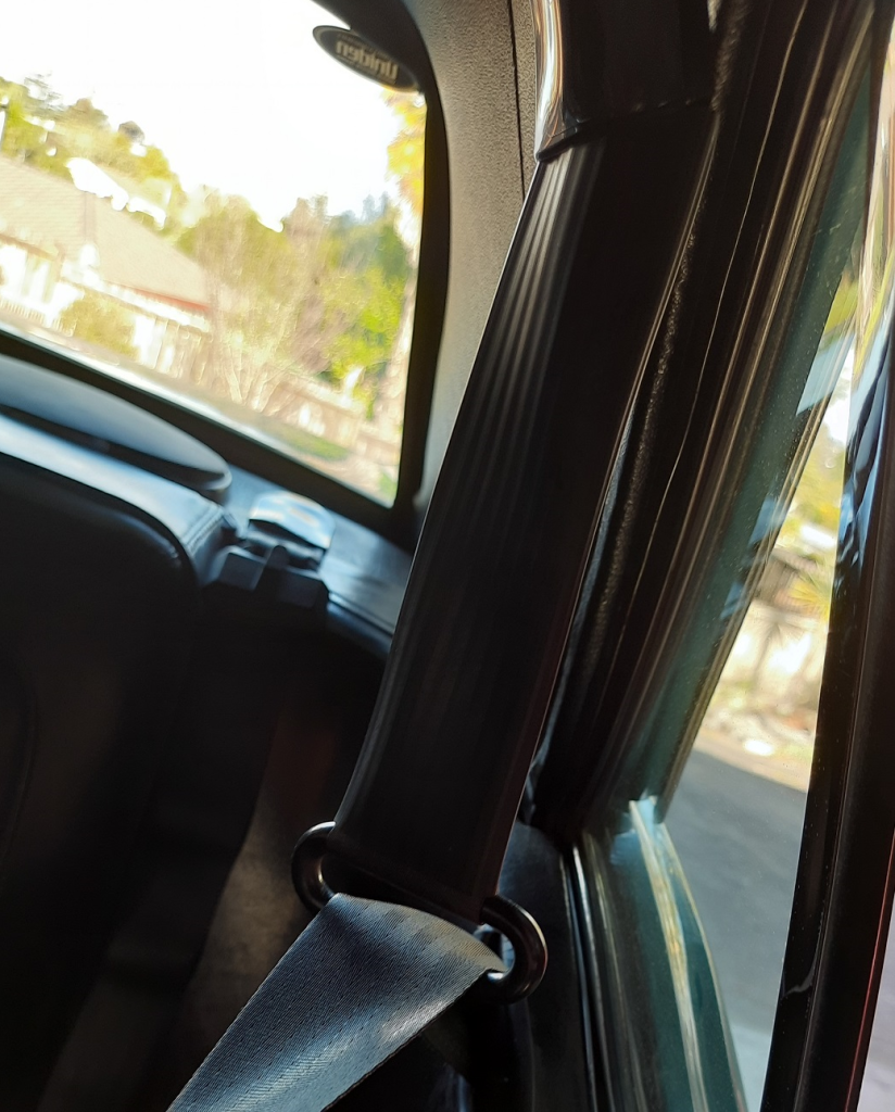

Pics of the A-pillar rust. I chatted to Mosele P&P and they said they'd have to paint the whole rear of the car which would also deal with the C-Pillar issue. I didn't bother taking a photo of that as it is really hard to see. It would need to be paint matched though as it is not a Ford colour, more fun.

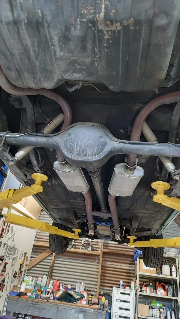

Productive morning. Chucked the muzzy on a mate's hoist to look underneath and take a wheel off for a look. Found quite a lot.

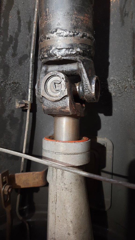

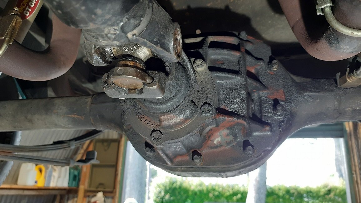

First up was looking a causes of vibration over 60mph. Better check the drive shaft.
Quite a lot of output shaft showing and a bit of play but this is at full droop so... ok maybe?
unis seem ok, bit of gunk on the diff housing. What up here...
Shit photo but at one point the drive shaft has played panel beater. No way this could happen normally (I don't think) as the pinion snub should stop this but I think the car was a lot lower based on the sidewall damage on the right rear tyre and maybe the uni shat the bed and made a mess. Otherwise it all looks ok. It seems to have a new driveshaft. I forgot to take a photo but it still has writing on it from the place they got it.

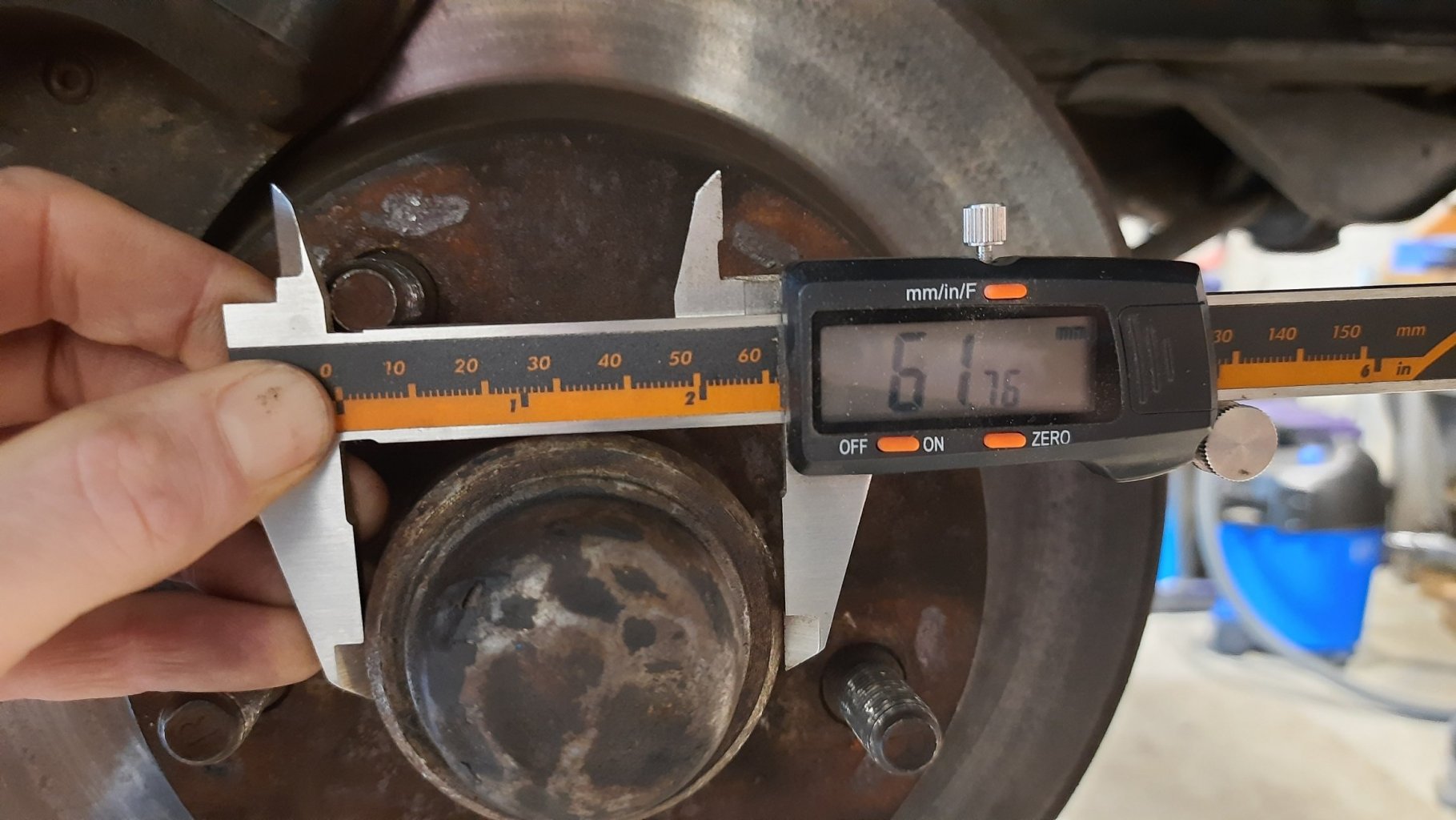

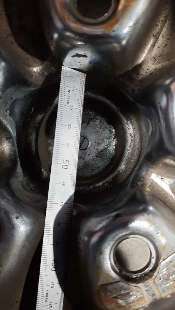

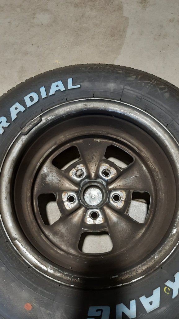

Next check was the wheels
shit photo and hard to measure the pilot hole.
It is not a nice machined face in these as they are never meant to be hub centric. Not sure if I can even use a hub centric ring here. but measured the hub pilot anyway
Will see what I can get but not sure if anything will improve.

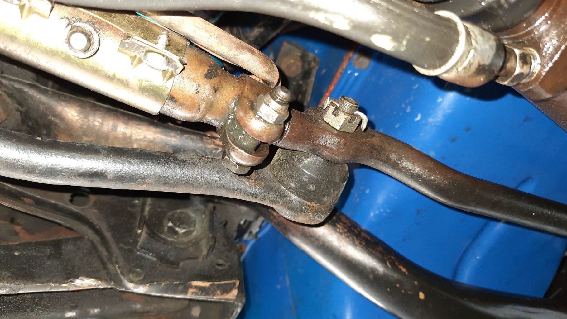

Had a look for leaks and the engine is surprisingly clean. It may have been cleaned up prior to being sold to me but I've done over 1000km now and the donk is bone dry. Power steering ram, no so much.
Again I didn't take a photo but the you can almost see the boot on the ram. There was a bit of new fluid there and these hoses are buggered. Warrant fail again? Old mate Ted says sometimes they get a mobile warrant guy who checks most things but doesn't use a hoist so wouldn't spot this. It works and not a bad leak but will need to be added to the list.

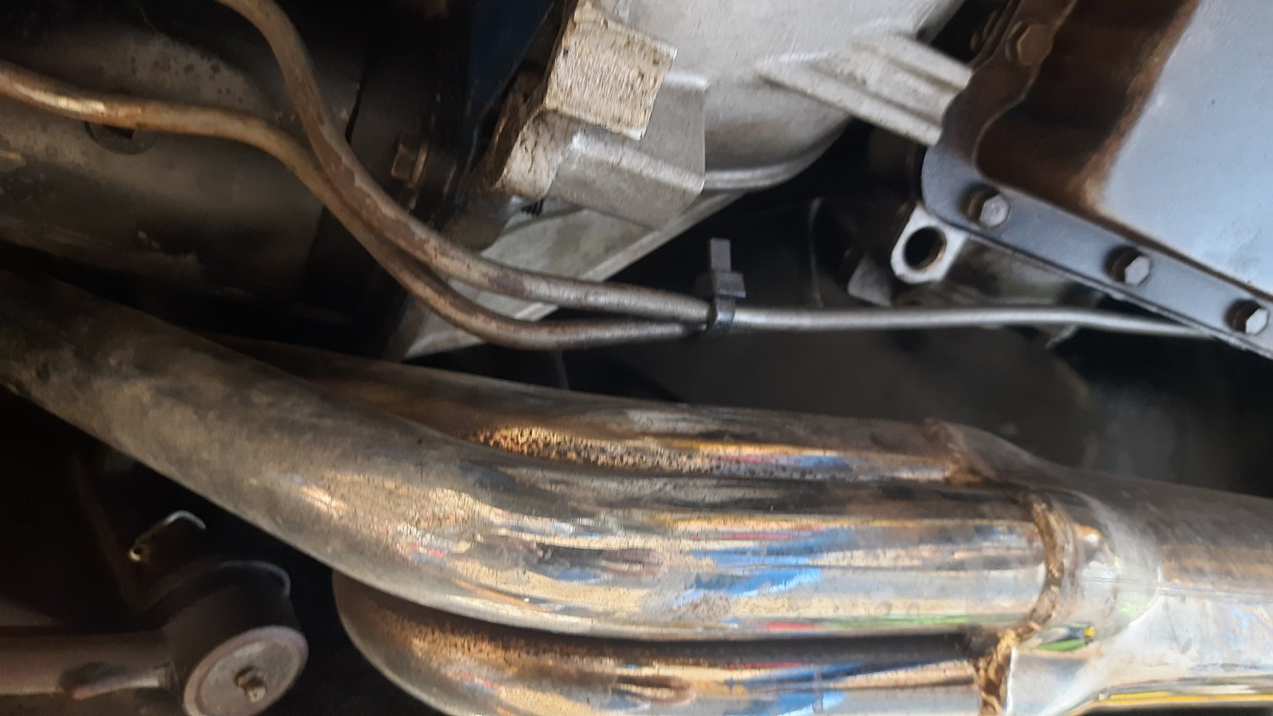

Also found a bit of a leak on the trans

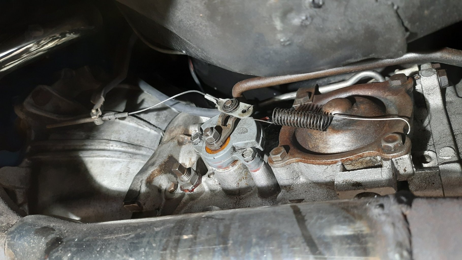

Oh, and I do have a kickdown. I'm used to 'newer' Fords that have a kickdown rod. This comes of the throttle shaft on the firewall not the carb. But loose maybe? Not sure how effective the spring is either. Good enough bro?

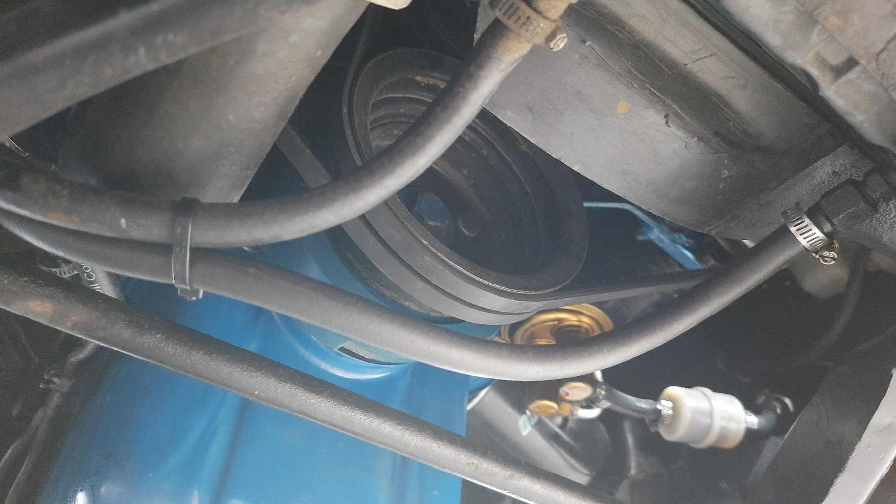

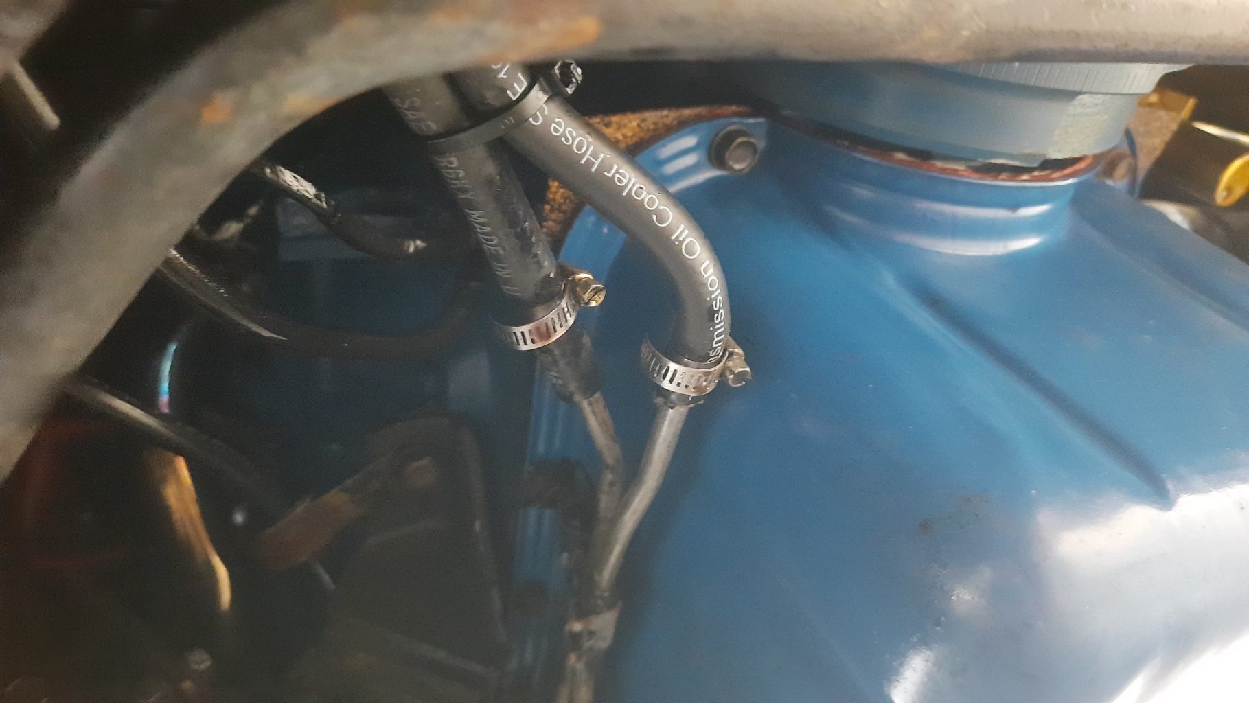

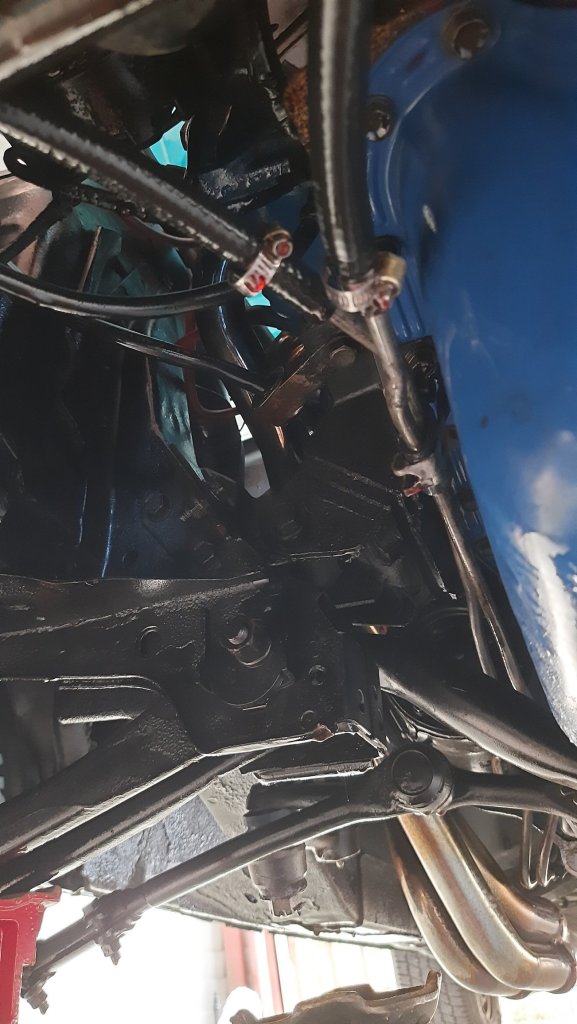

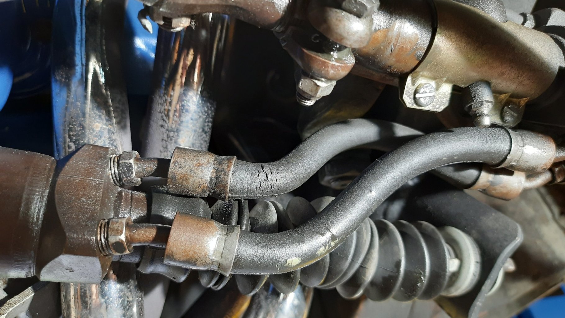

Also noticed the cooler lines are a bit close to the header
Pretty normal but maybe I'll wrap them somehow when I can be bothered. The hose at the front was also smashed between the sway bar and the lower radiator hose on the hoist (again no photo). Probably ok under load but could be routed better so I cut about 4" out and now it is much clearer.

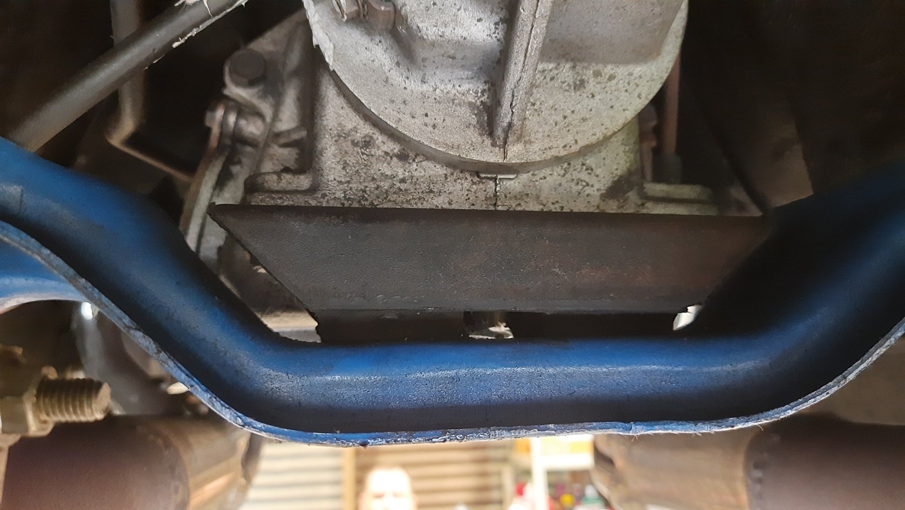

Ted also noted the trans mount is a bit skew, not sure if this is normal..
seems fine apart from being not straight. Maybe we are just a bit OCD.

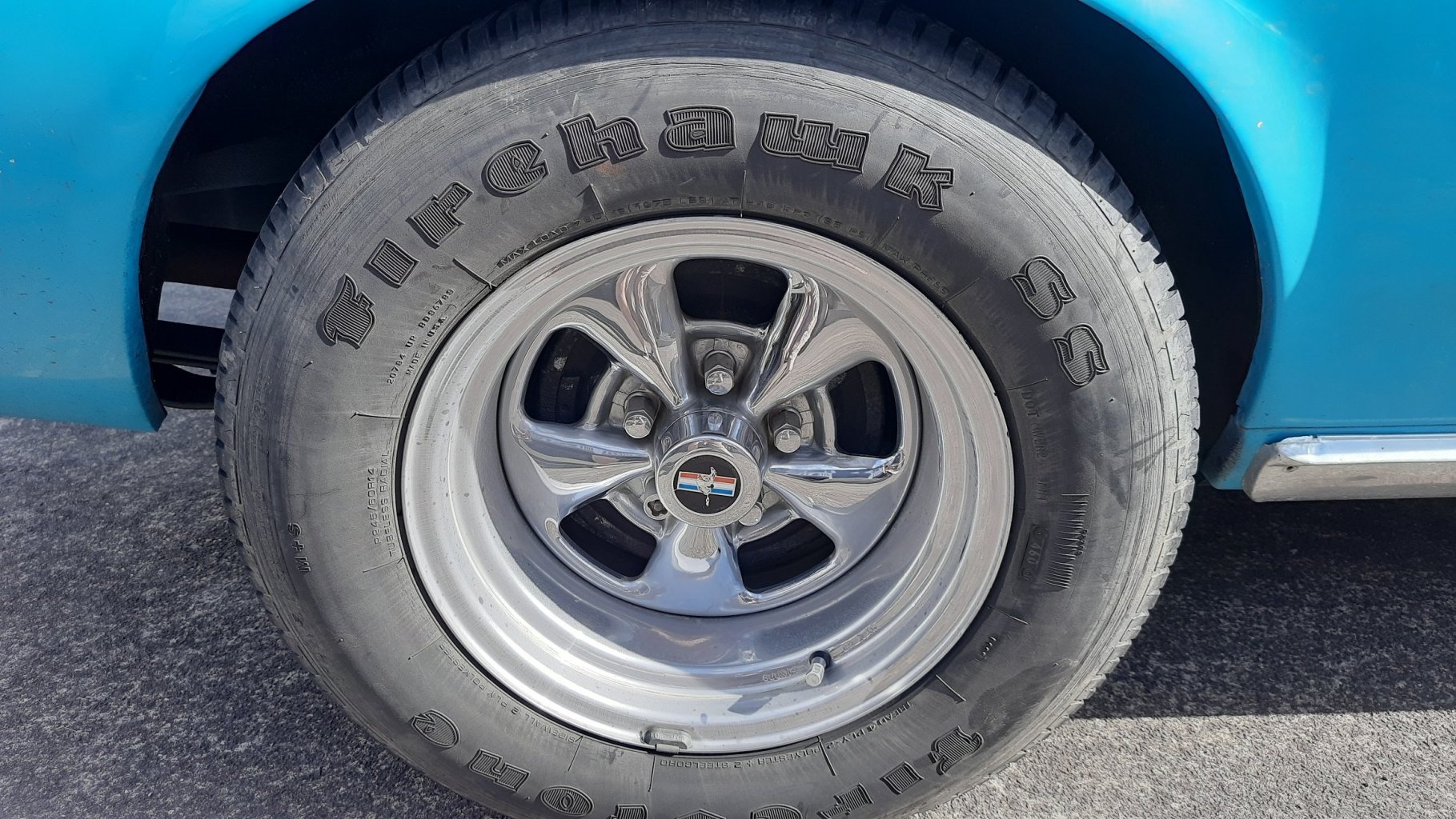

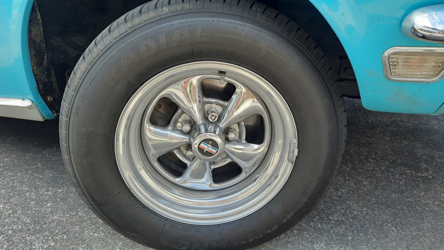

Picture of tyre damage
Fronts are ok but on the hoist were reall close to the upper control arm at full droop. Fine down.
Fronts are 225/60R14's and rears are 245/60R14's. I'll probably go down a size when I have to replace them as they don't need to be this big (words rarely heard). There is no rubbing now. I may also consider some new rims but I like the SS look and don't really want to spend the coin just after buying the car. Bit harder to justify to the Minister of War and Finance. Bit rough, she was dead keen on me buying this, but might have to spend a bit on her hobbies first.
You can just see the P/N on the wheel 7JJX14  which I assume means it is a 14" x 7" wheel and JJ? I think this might be the offset, so says Google.

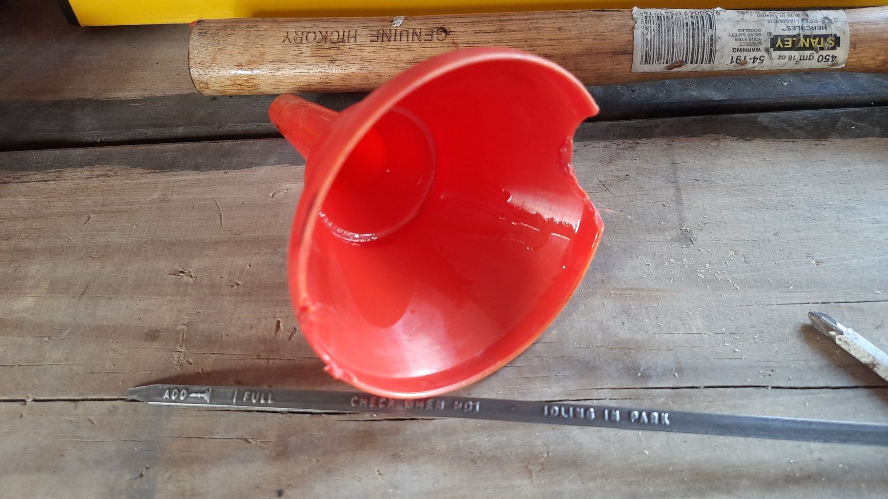

Finally found some Type F and topped up the trans. It took around 1.5l so was definitely low. Did have a wee issue topping up with the car idling in park to check level...
Plastic funnel and hot headers not a good mix. Muppet.

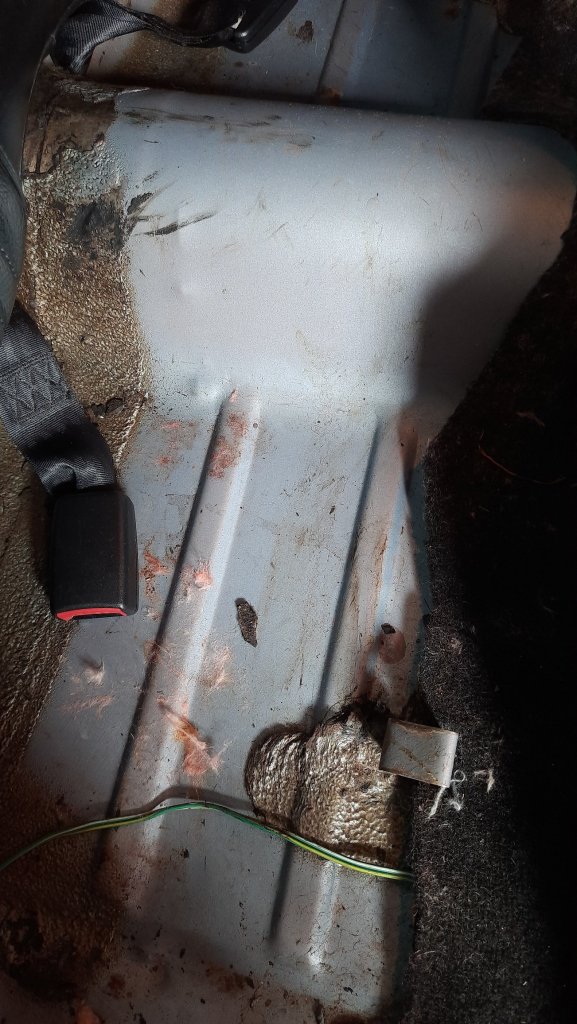

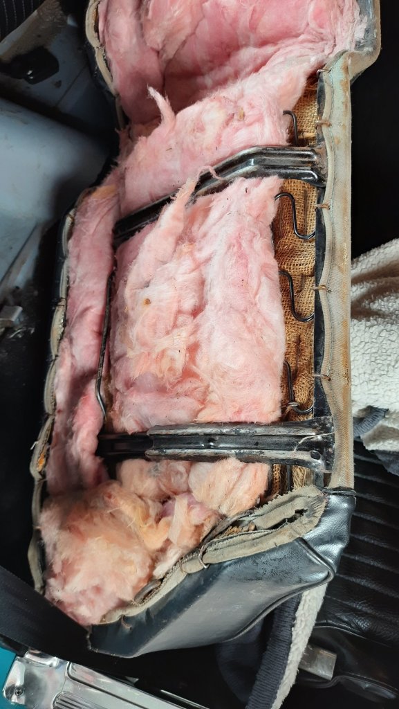

Automotive archaeology. I need to fix the rear window winders which means removing the back seat so  I pulled the base for a look.
Seems a previous owner though pink bats was a good sound deadener? Maybe the passengers arses were getting hot from the exhaust?

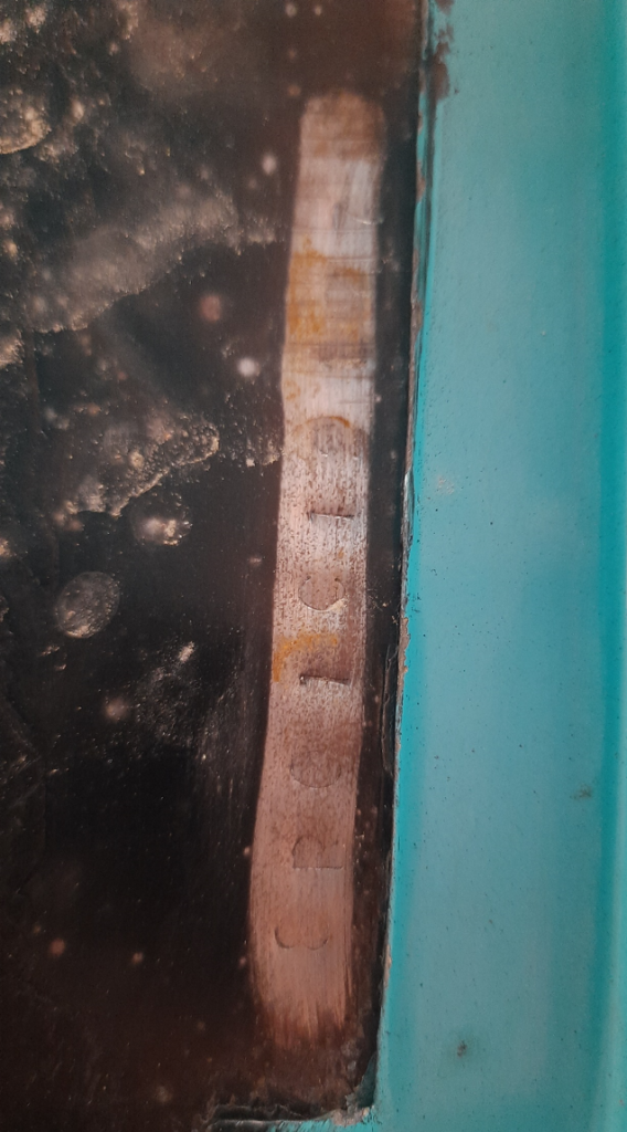

Also since purchasing I've been having debates about the colour. The door plate says 'Brittany Blue' but my eyes say something else.
Maybe it was Brittany Blue at one stage. Now I need to decide what to do with the paint. If the current issues pass a warrant should I leave it till I do the lot and then restore it back to original? I do quite like the original colour but the current one is more unique. I may also see about the dents and if they line up with the ones from the driveshaft.

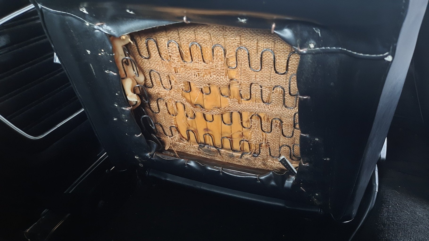

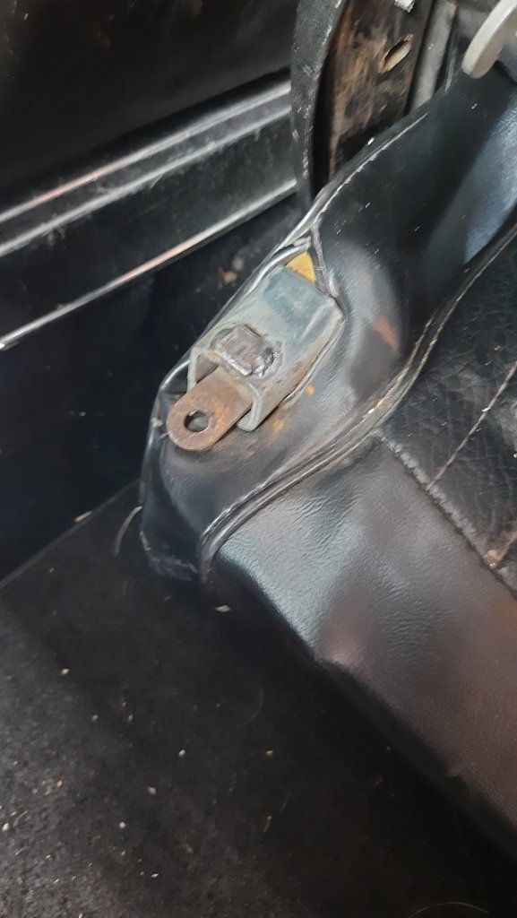

Investigated the reason behind the drivers seat not tilting forward. It seemed to be just sticky, you have to wiggle it to release where the passenger side just works. Has a weird extra tab with an eyelet that doesn't seem to do anything though and is not on the passenger side.
Crap photo but not sure what the eyelet does. I also removed the seat back as I thought it might be stuck in there. It wasn't but interesting for a look. The seat cover is not original and the holes don't all line up. Nice to see how it is attached as I need to recover the drivers seat at some stage and I may just order some foam and a cover from TMI but I'll need the clips and pliers.
I think someone added in some extra foam behind where the cracking is on the front.

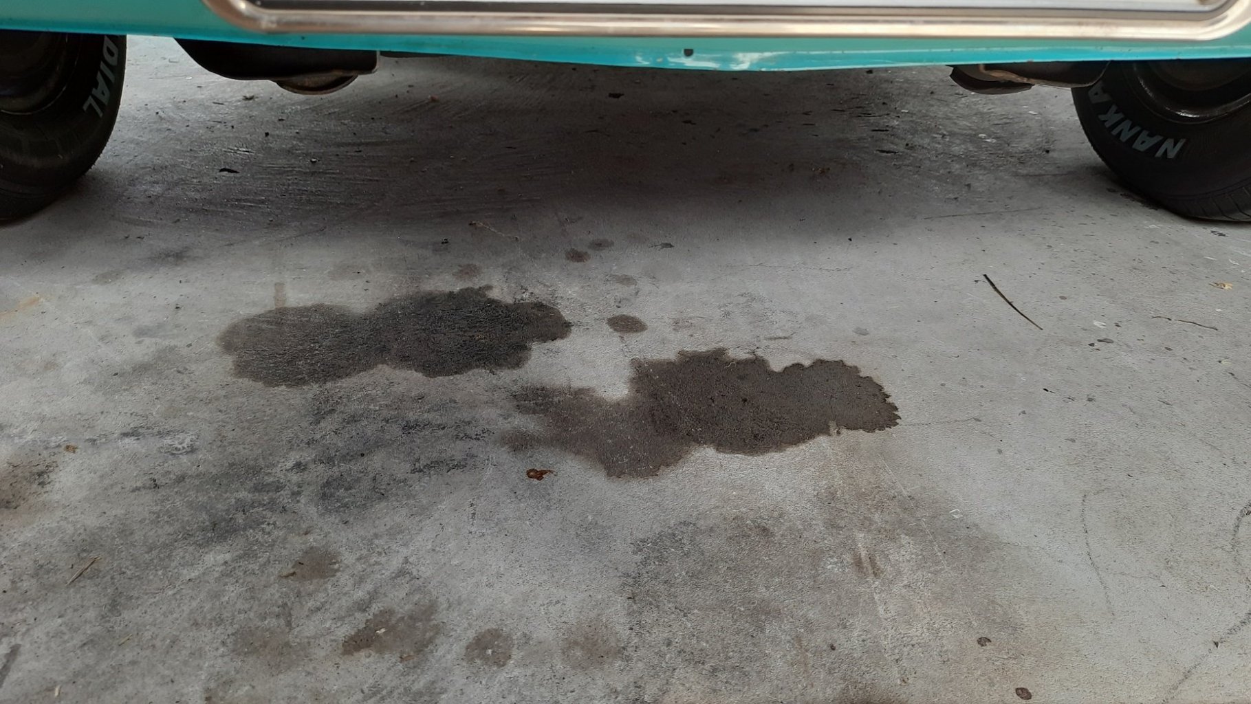

Muzzy is still wetting the bed with the red stuff so I had to have a look
Nothing on the trans lines I repaired and the marks are too far back on the floor
Found some drips on the end of the power steer ram. I thought this system was leaking but I might need to remove the whole system up to the pump. Oh, and there seems to be some creative parts usage. You'll know it when you see it.

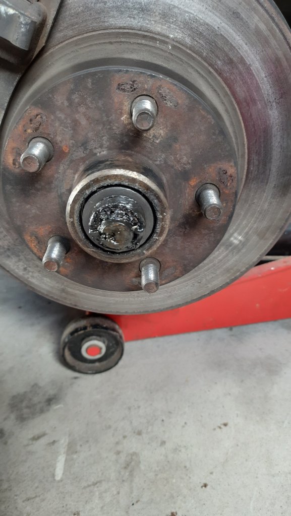

I also checked the wheel security while it was on jacks. There seems to be a bit of play vertically but not laterally in the front wheels. I pulled one to look and looked at the bearings. Plenty of grease (maybe its been serviced) but I can't check further. I might get a pro to check at some stage.

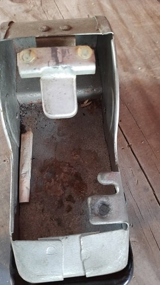

Oh, and a bit more automotive archaeology, Found a durrie in the ashtray. A previous owner must have been a smoker.
