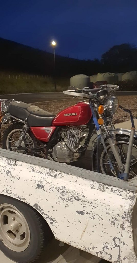

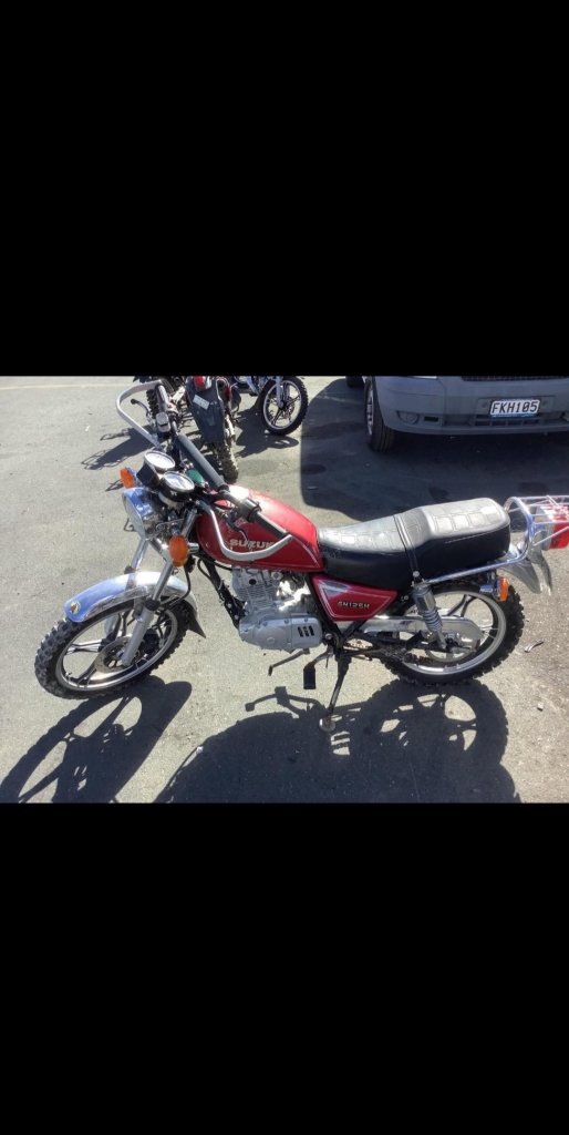

Muncie Posted May 25, 2022 Posted May 25, 2022 Just dropped a low ball bid on this gem ive kind of wanted one for ages my son wants one and my daughter has been actively looking at them as a learner bike. Scored for $370 seems very cheap for a 2016 appears to be missing a muffler but otherwise complete and tidy..... of course ive not seen it other than on trademe. Watch this space. Will be a spruce up service and rock scissors paper to see who keeps it. 1 1 Quote

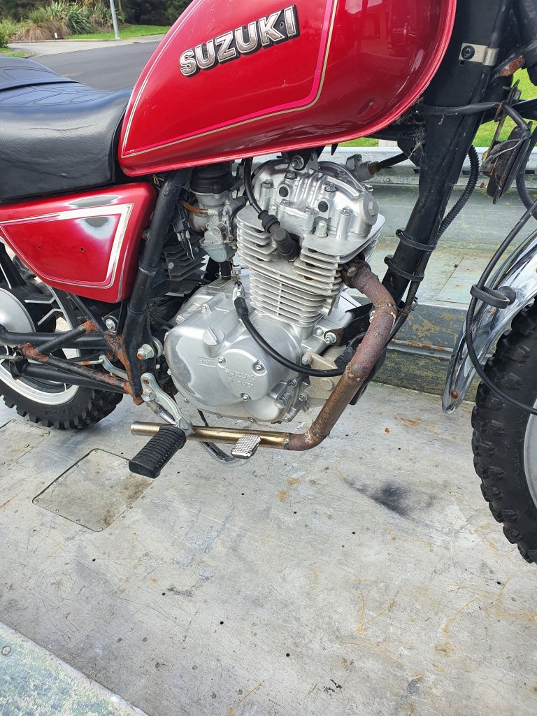

Muncie Posted May 31, 2022 Author Posted May 31, 2022 First glimpse looks really promising. Not even got rust on the chrome. 2 Quote

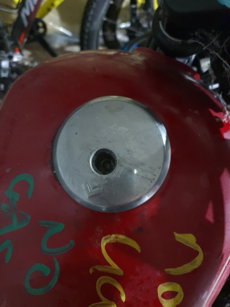

Muncie Posted May 31, 2022 Author Posted May 31, 2022 It runs, throttle was 80% jammed pulled cable out flushed it with CRC and it freed up. Discovered why it got parked it's out of gas and the key doesn't fit fuel cap..... Second bike now with same issue. It'll basically be good to go as is once I find an exhaust. Even the battery is sweet everything works. Petrol stinks so not going to persevere till I sort fuel cap and get fresh stuff in. 1 Quote
Muncie Posted May 31, 2022 Author Posted May 31, 2022 How i extract the old one will be an issue for weekend Dave. The place this bike had a few gn125s I bet someone has swapped fuel caps with one of other bikes. I really don't want to fuck the tank. *edit* couldn't wait lock barrel is corroded to buggery so wound a big old decking screw into it used 9kg barbell a short length of chain and popped the barrel out piece of cake. Flathead in the hole out pops the cap now I can get fresh petrol in. Test ride tomorrow after work 6 Quote

tortron Posted May 31, 2022 Posted May 31, 2022 Drill it down about 1.5cm and then it just opens with a screwdriver Quote
Muncie Posted May 31, 2022 Author Posted May 31, 2022 26 minutes ago, tortron said: Drill it down about 1.5cm and then it just opens with a screwdriver You read my mind...... I did grow up in south Auckland where nobody's car had an ignition barrel. Quote

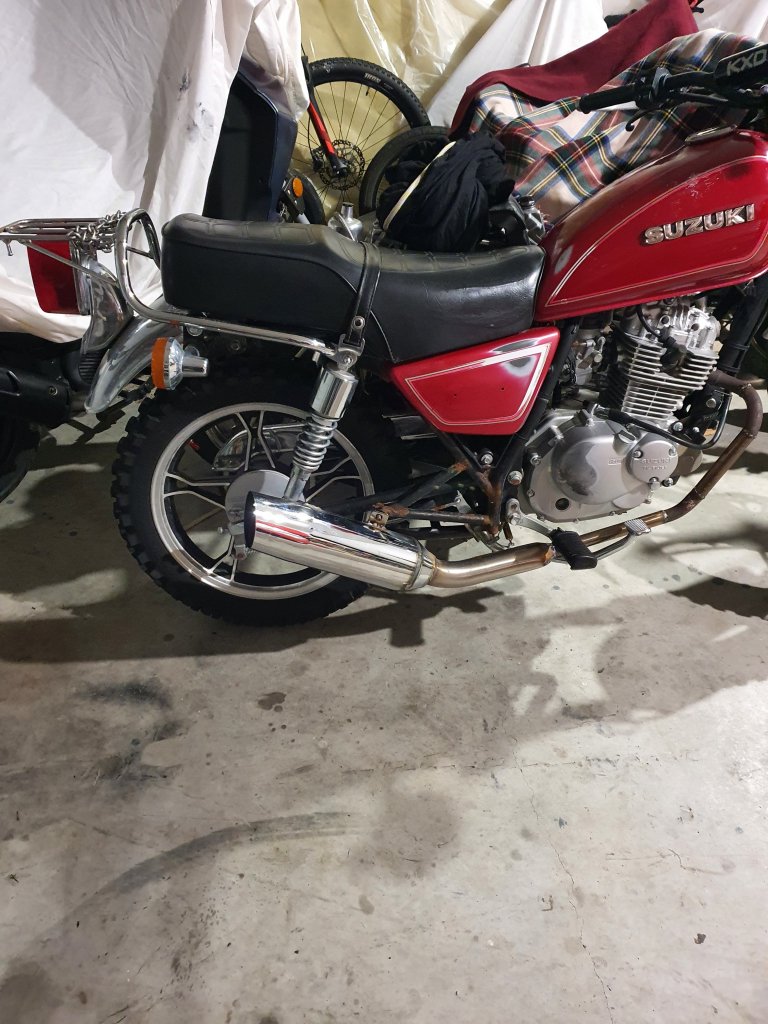

Muncie Posted June 6, 2022 Author Posted June 6, 2022 I got it running pretty well wouldn't mind betting the exhaust valve and seat are pitted to buggery but it'll do for now(ever) It needed some back pressure to give it some legs so I created the king of jank scrap bucket exhaust that directs heat and noise away from the rider from all the titbits of shit under my bench. 2 Quote

Popular Post Muncie Posted June 19, 2022 Author Popular Post Posted June 19, 2022 I used some more bits and cobbled up a muffler to go on the end of the system I made. Used a 140mm shortened harley V Rod muffler so it fit the frame its got quite a nice bark to it for a 125cc. In a moment of weakness I let my son ride it to top of the street and back only to get pulled over by the cops 4 doors from home. Thought we were fucked but shook cops hand and just agreed I'd ride it home I just pushed it as I was still shitting my self. 7 5 Quote

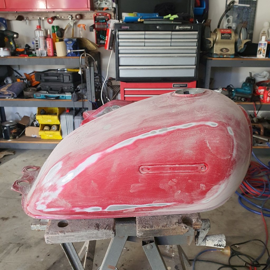

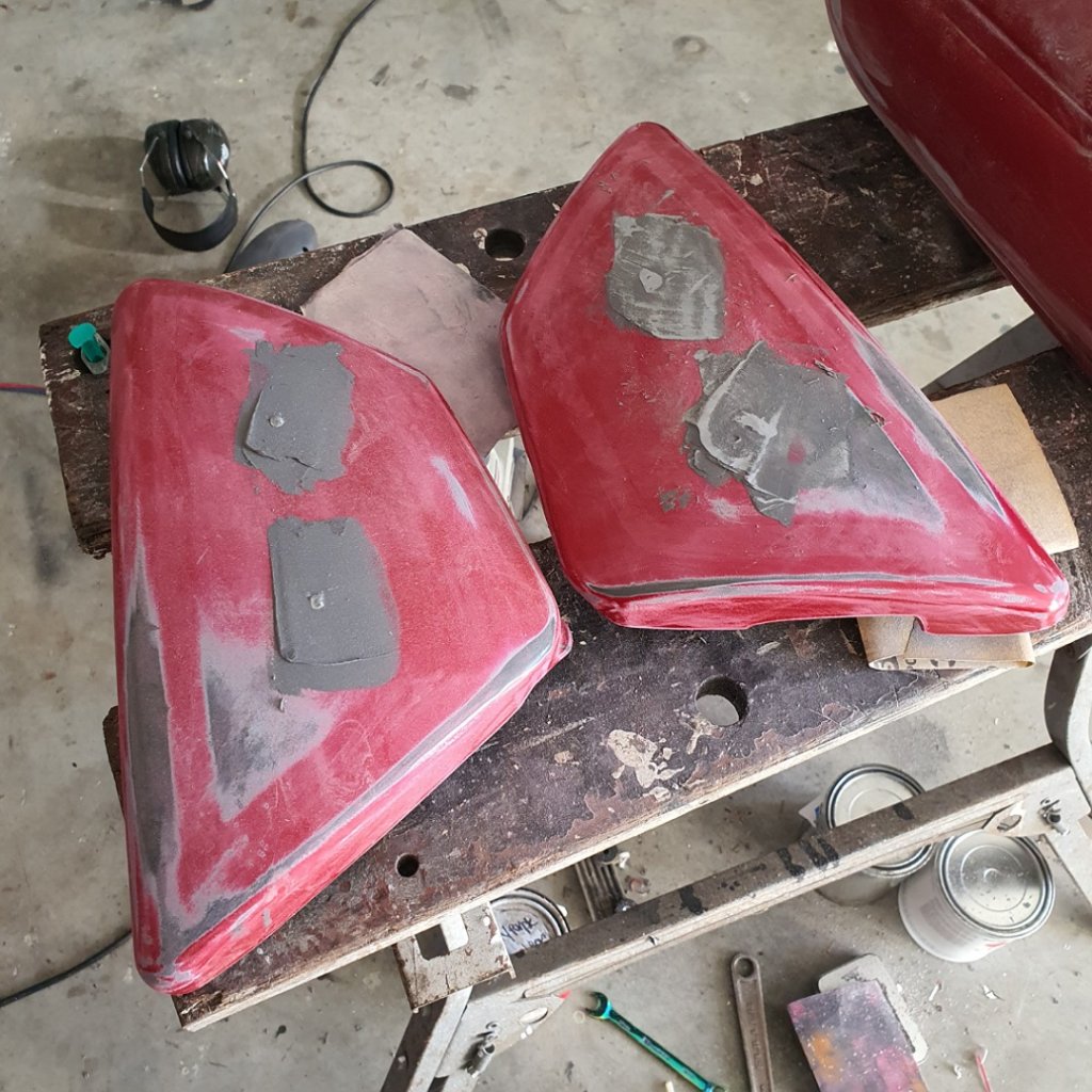

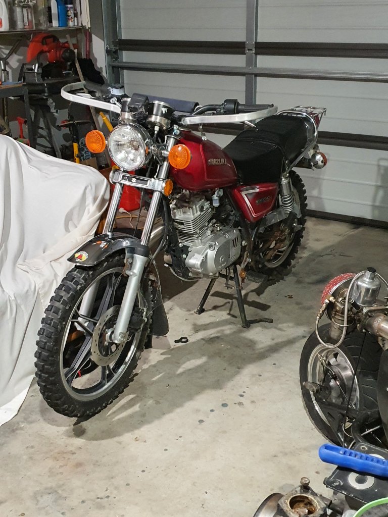

Muncie Posted February 25, 2023 Author Posted February 25, 2023 Back into this thing, it's been taken over by my son @zach_munce he's put it back to stock with nice new muffler and full service. Hes basically been riding and enjoying it recently the throttle cable snapped and we are now on to the 3rd replacement after the first 2 didnt fit, so while its out of action we are giving it a spruce up with new paint for the tank and side covers. The frame is actually mint and can be left alone for now. Home-brew paint incoming.... he got the punishing job of Removing and sanding out the pinstripes. Quote
Muncie Posted February 25, 2023 Author Posted February 25, 2023 Getting dents and scratches out Quote

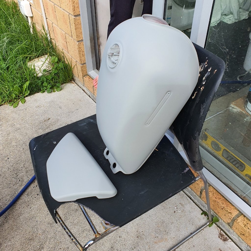

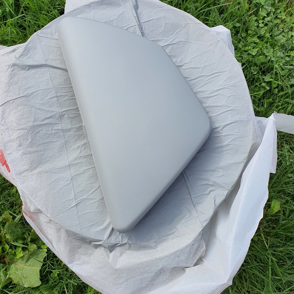

Muncie Posted February 25, 2023 Author Posted February 25, 2023 Primer done. Black next after a sand. 2 Quote
