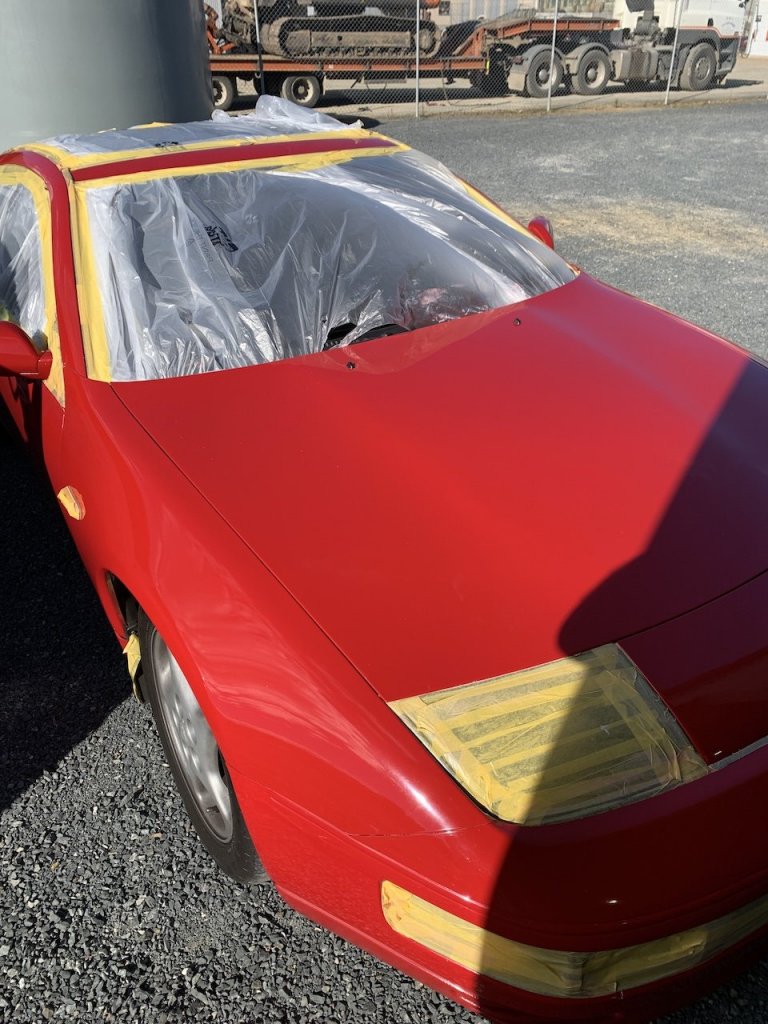

Popular Post AALAWS Posted April 1, 2022 Author Popular Post Posted April 1, 2022 Masked her up and gave her a cut and polish. The drivers door, A pillar, rear fender and bumper are still original paint so were a bit dull compared to the newer paint. It came up really good, still differences in the colour but only if you go looking for it. Dropped off to a mate who is doing the rocker cover gaskets, replacing some pipes, upgrading the headlight bulbs anda few other little bits and pieces. I've ordered a new sticker for above the taillights too. Should have an update on wheel availability soon too. 29 2 Quote

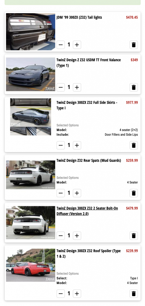

Popular Post AALAWS Posted April 4, 2022 Author Popular Post Posted April 4, 2022 This is my Shopping cart....when I say shopping I mean browsing cart....... while thinking "Deep breath......FAAARK Gst and customs are going to screw me hard for this.......and why should the govt get money for nothing and it's bullshit because If I could buy it here I would so I'm not ripping NZ business off anyway you bastards".......and breathe.... rant over. I will try and hit up TwinZ Design directly myself for a better deal, their website directs you straight to Z1 Motorsports and you see the $$$$ mark up straight away. All these bits would fit snugly and require no damage to the original body work - the best compromise for a full kit. But I still need to account for getting the wheels, stereo and exhaust.......who is a good place to hit up for a decent cat back system in NZ? 10 Quote

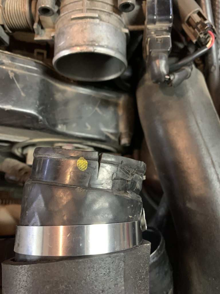

Popular Post AALAWS Posted September 19, 2022 Author Popular Post Posted September 19, 2022 Months go by...... Car went to my mates workshop to replace the rocker cover gaskets, ignition plugs, Japanese manifold heater lines delete, and a few other bits and pieces. It sat there for months, getting a little progress, but between his fucked back, no staff, covid, workshop floods, roller doors falling off, trees over driveways........ it never got finished. So I took it to the local Nissan to finish up. New Wof and ready to go now. Gave the cam covers a clean up. These cars came with a heating system to keep the manifold warm in colder Japanese climates so we took the opportunity to delete these - thought about deleting the EGR too but left if just to avoid any future hassles. Tidied up the cowel panel and wipers and got it back to the workshop, but not after one other small scare....... Once Nissan assembled it all they noted a high idle so I have a new idle control valve on the way, and it had developed a water leak. The turbo coolant hard line had sprung a leak.......removing this means engine out.....FARRRRRRKK. Mechanic was able to sleeve it with some hose for now - so I'm planning a proper engine rebuild/refresh for sometime in the next few years, so until then its cruise and enjoy. Ordered a new radiator too so that'll go in soon, along with some good sounds hopefully. Just waiting for now before getting some wheels. Theres a few rattles and creaks I want to eliminate before I head out for a lower profile tyre. 30 Quote

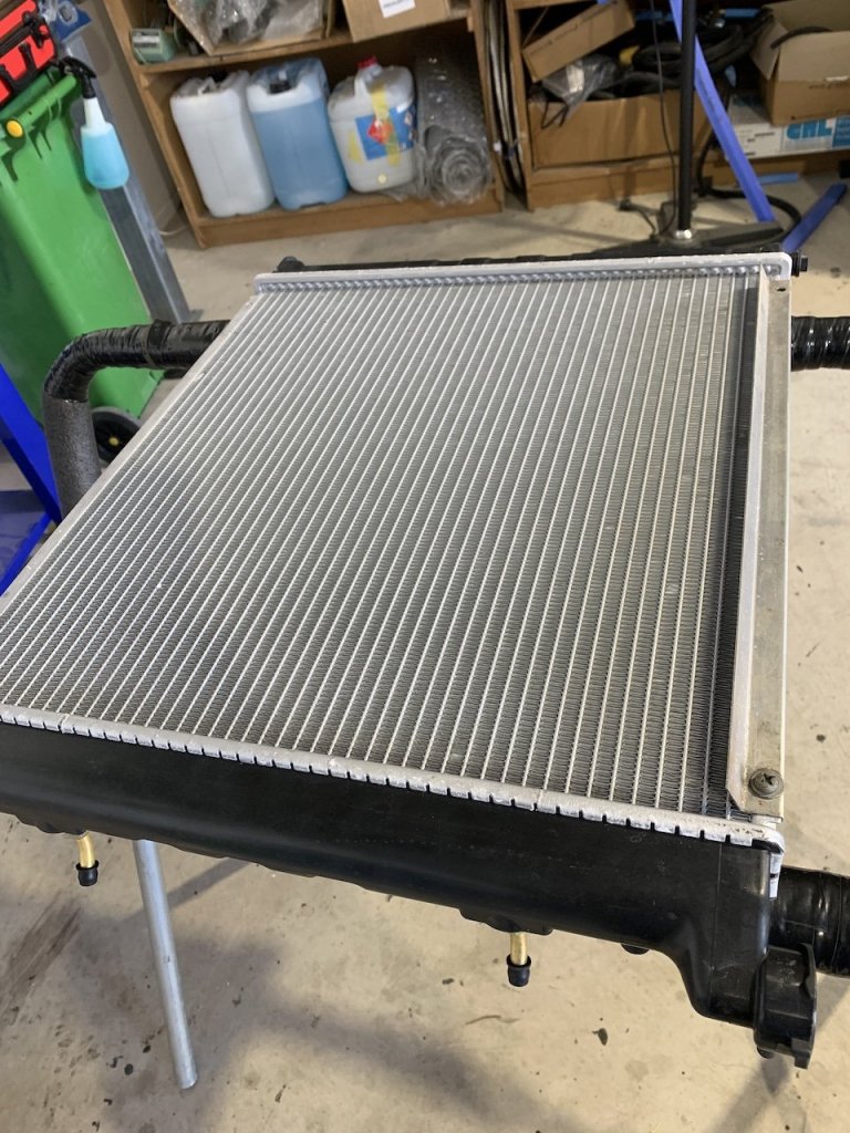

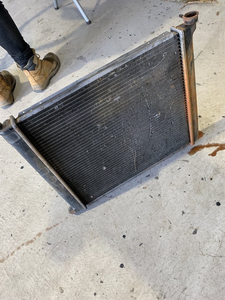

Popular Post AALAWS Posted September 22, 2022 Author Popular Post Posted September 22, 2022 New radiator and rear hatch stickers. Old radiator was a calsonic brand.......felt a bit bummed I've lost a piece of Nissan racing heritage from my car, but i've gained another 10hp with the turbo sticker 20 1 Quote

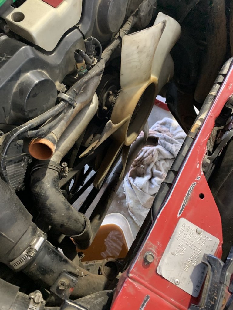

Popular Post AALAWS Posted November 21, 2022 Author Popular Post Posted November 21, 2022 Gave it it's first real shakedown a month or so back. Drove it fairly hard out to the coast, could have been harder but was wanting to be a bit conservative with her....... I got to 10 mins out of Kawhia and she spat all her water....bah!! Found some water and nursed her into town and then eventually back home. Diagnosis was a loose hose, not one I had touched previously, and a possible crack in the overflow tank which turned out to be nothing. On to the good stuff - picked up these mufflers cheap. A local oil rep had them for years and wanted rid of them - he bought a crashed Z to turn into a stock car and the previous owner had only just fitted them so score! Gave them a polish and fitted them - nice change to the sound right away, got that nice burble when you come off the gas. More Gran Turismo goodness.... Also fixed my rattles in the cabin......kind off.....decent stereo and speakers to drown them out. Out with the old. and in with the new Just need to figure out how to keep the sub from moving without doing any obvious damage.... Velcro doesn't get a decent grip/work on the carpet and the targa straps don't work......any solutions fellas? 19 Quote
