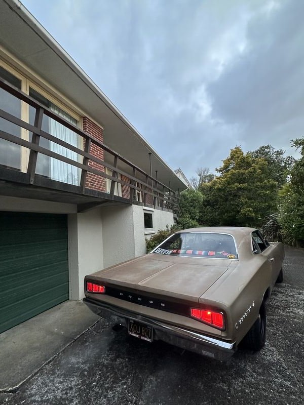

Popular Post jackeo21 Posted September 20, 2021 Popular Post Posted September 20, 2021 recently purchased a car that I know I'll be keeping for many many years. it's been a long standing goal of mine to own a B body mopar, so to own this is beyond words this is the project log of my 1968 Dodge Coronet Deluxe, a true California survivor car. the car spent much of its life baking away in the San Diego heat, driven here and there by its elderly owners until it came over here, in 2006 ish. whilst never complied, it's a credit to the previous owner, who went through all of the essentials and gave everything a freshen up. Covid allowing, I am aiming to have it on the road this side of Christmas. as it stands, it's a base model '68, with the original 318 and 904 auto. Runs super nicely, and receipts show the motor was rebuilt (standard spec) in 2000. Photos are of how it looked upon purchase cheers! 31 2 Quote
