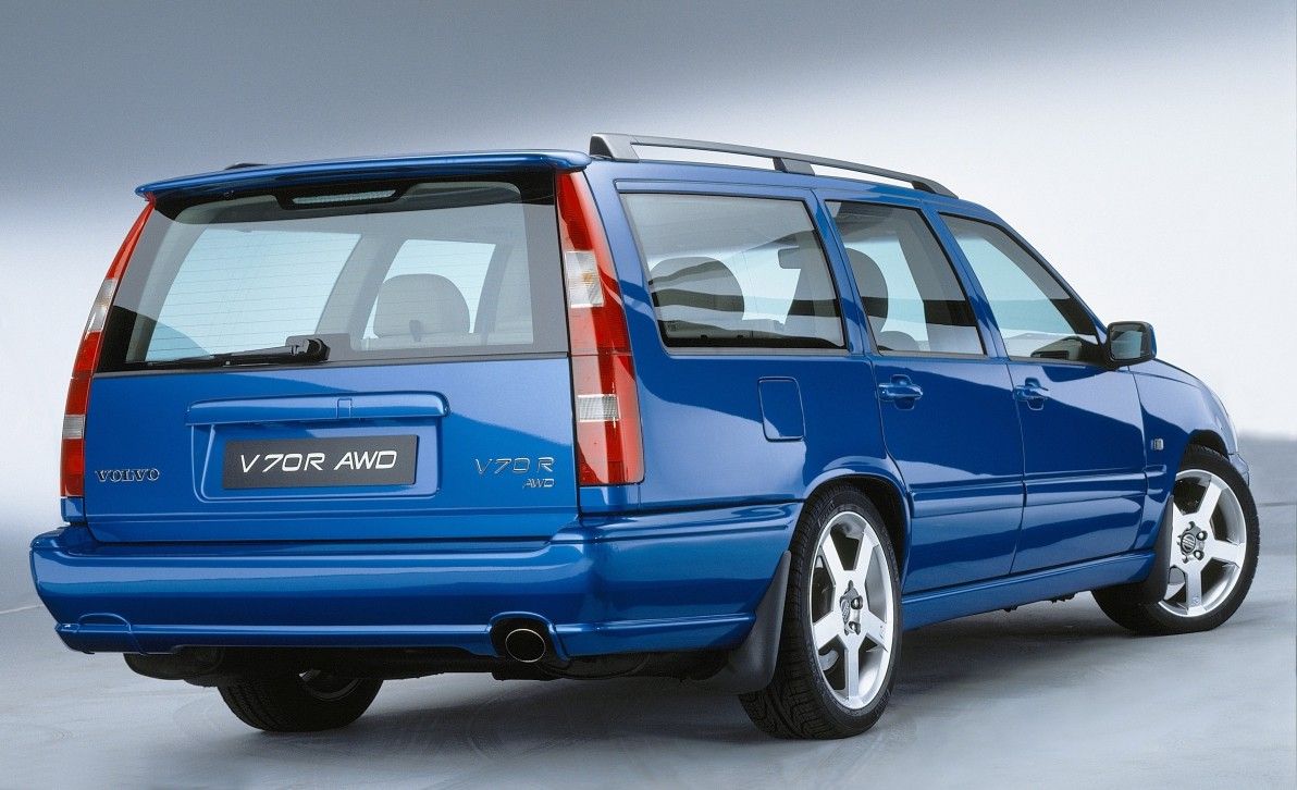

kws Posted August 27, 2021 Posted August 27, 2021 Should try get some later model V70 upper lights Quote

Motu Posted August 27, 2021 Posted August 27, 2021 3 hours ago, tortron said: just applying the linseed oil? no sanding/polishing? See my previous post. 3 hours ago, kws said: Should try get some later model V70 upper lights Try is the important word here...if I could I would. Quote
