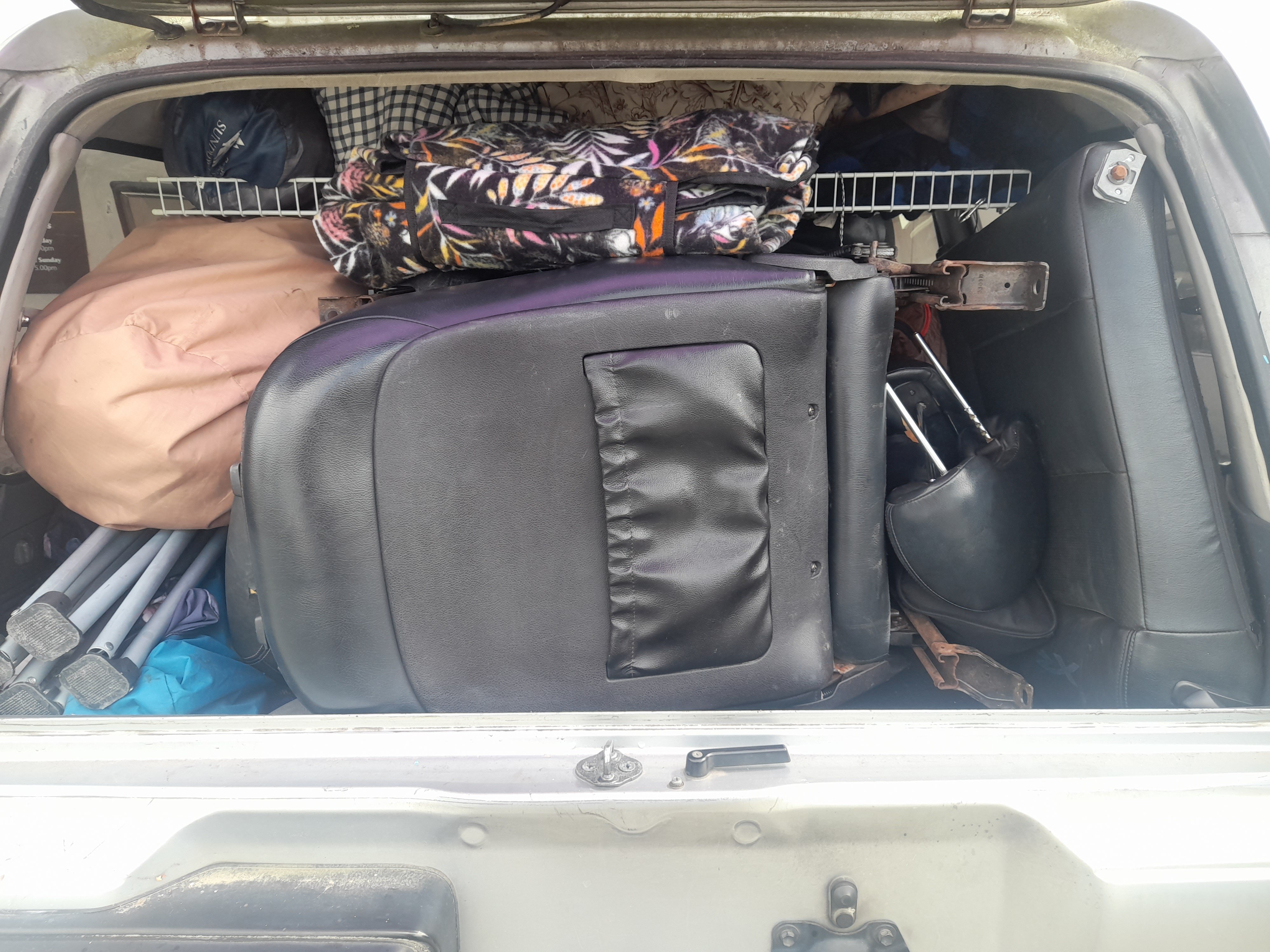

Bearded Baldy Posted January 21, 2025 Author Posted January 21, 2025 Full set of BA xr6 leather seats managed to fit in the wagon while on our south island trip. Will have to tie them on the roof when we head northbound tomorrow, left half of the load at the inlaws this morning so will need a big reshuffle. Future baldies problem. 3 Quote

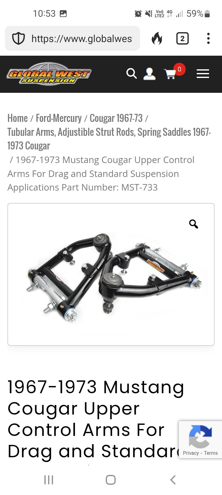

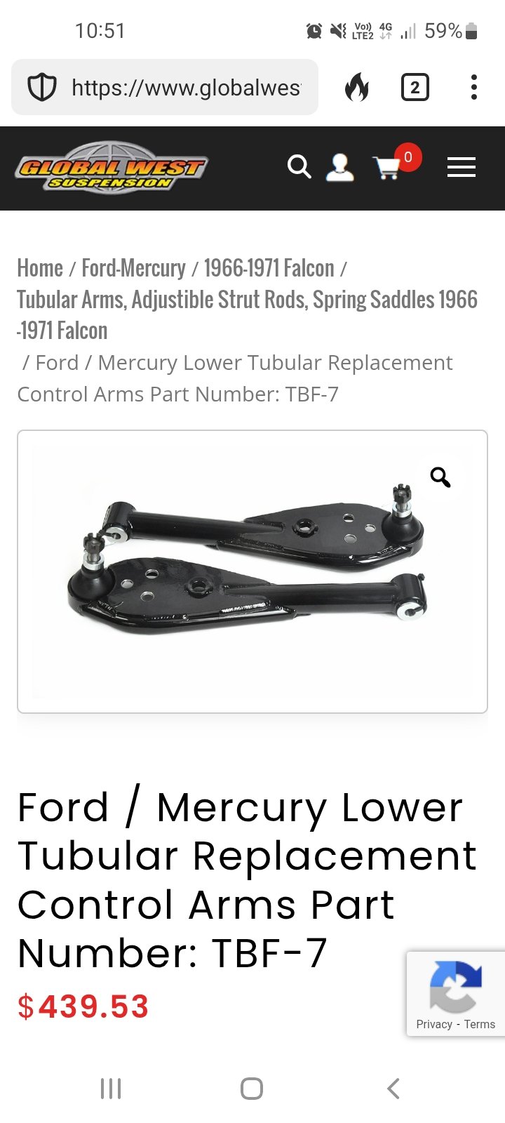

Bearded Baldy Posted May 17, 2025 Author Posted May 17, 2025 Cheers @cletus, well known in the falcon circles that the aftermarket balljoints have less movement than the originals but i have a plan. I am hoping that since i am only going low springs this time around (whenever it actually gets on the road again) that worst case scenario i lower the bump stop a touch, best case scenario is some getting in some globalwest control arms and them passing lvvta checks with no hassles. The globalwest arms have screw in balljoints with much greater travel alledgedly. That style. Actually, looking at the prices on those that may be worst case scenario lol. Quote
