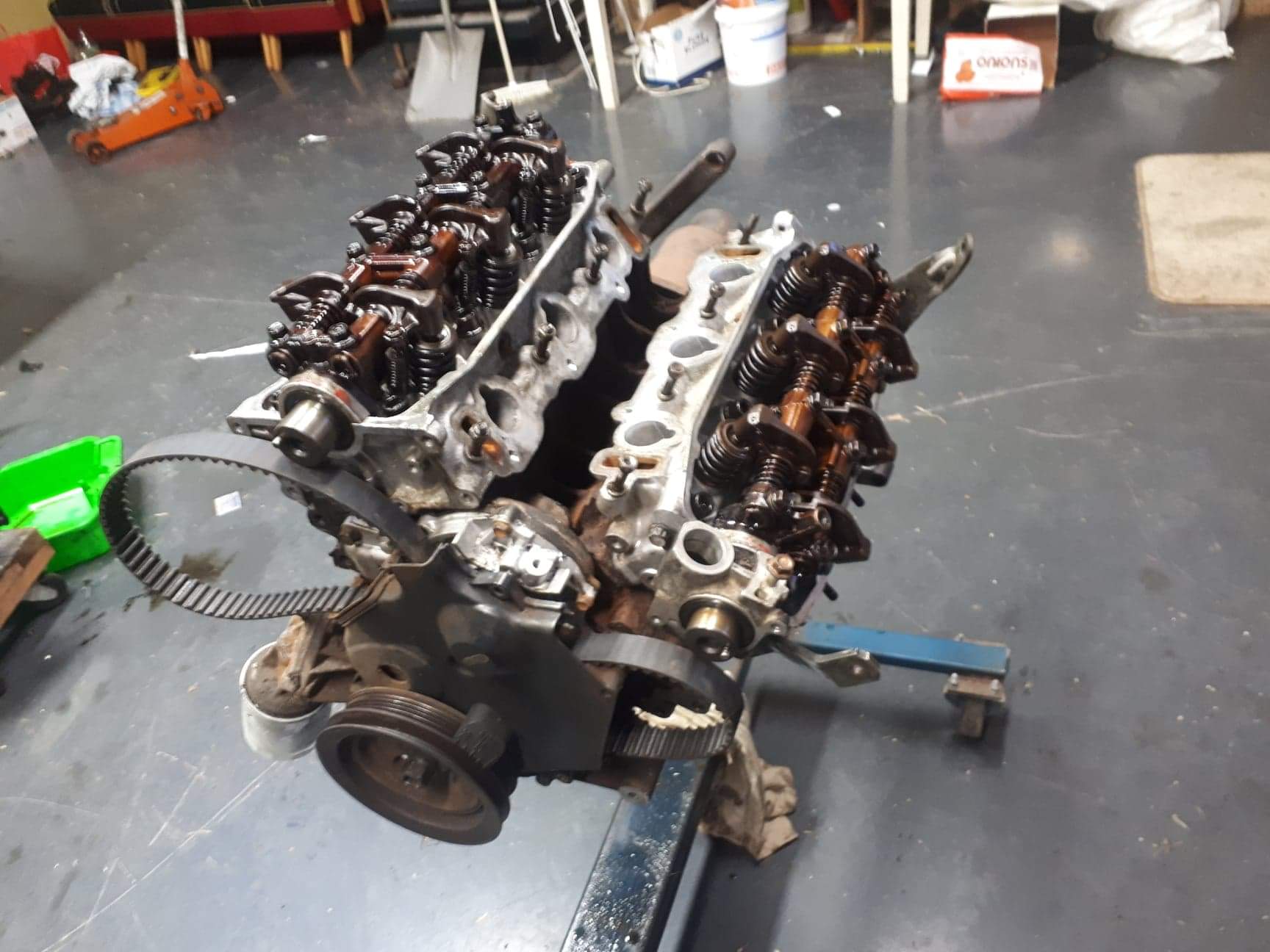

JustHarry Posted January 22, 2021 Author Posted January 22, 2021 Because it had trans problems the motor was due to come out. And like all quality mitsubishi's the valve stem seals might as well have been made of granite. So i found a top end set to repalce some gaskets fwd v6 are suuuper lame to work on. So many innacessable bolts Started pulling the trans down. Hoping to find something wrong with it. However the further in it got the more it found it was in near new condition Replaced a bunch of seals and o rings as i went. Put it all back together without finding anything actually wrong with it so maybe it just had a blockage. Dunno ill find out i guess 3 Quote

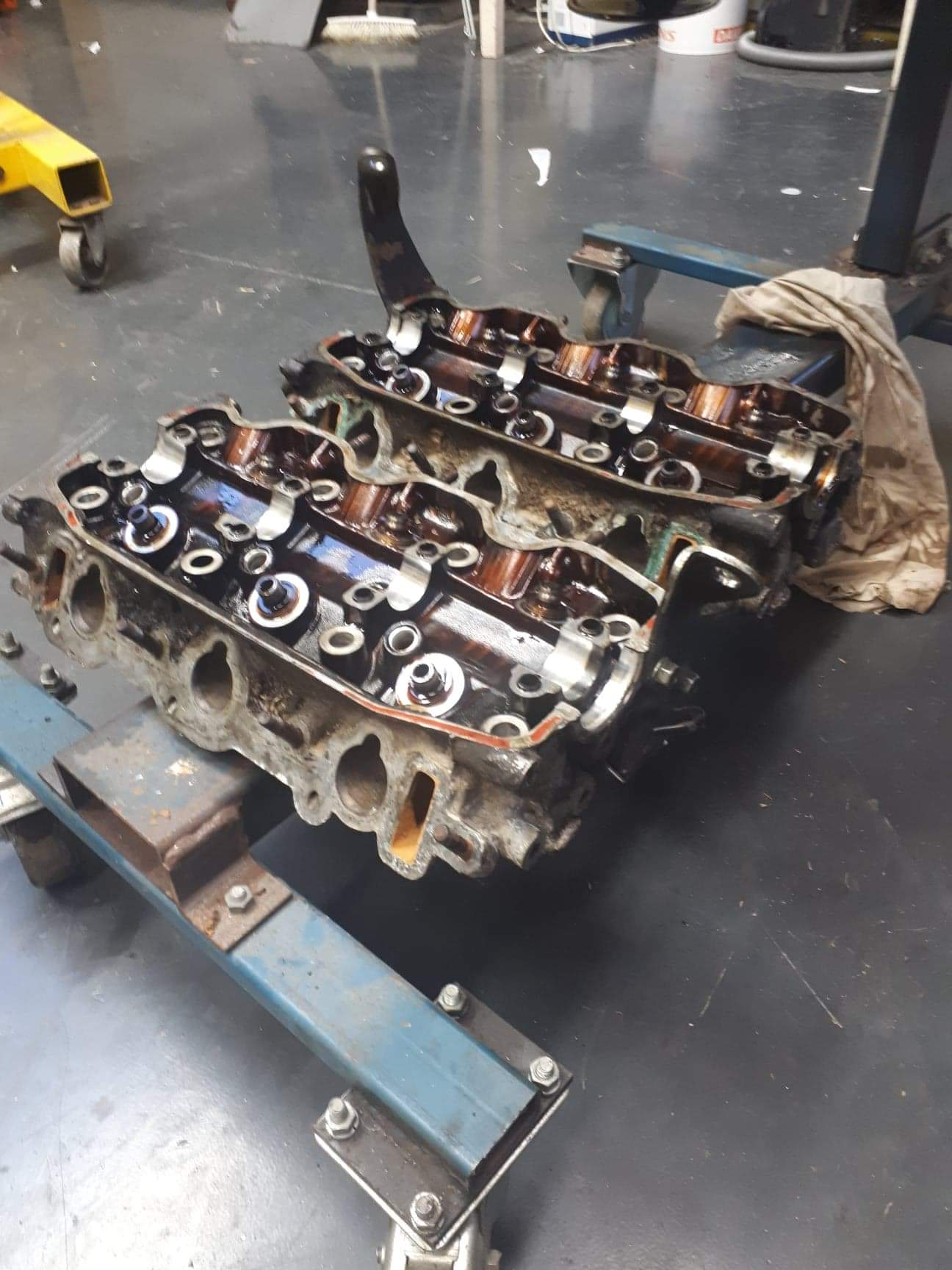

Popular Post JustHarry Posted January 22, 2021 Author Popular Post Posted January 22, 2021 Next thjng was to pull the heads off and strip them for cleaning Valve guids were mint with little to no play. Dropped them off at cylinder head specialists in town for them to tank them clean and run a skim over them ended up taking 12thou off them to clean them up as they were pretty rotten from having water in it. Also got the intake manifold vapour blasted and then i repainted the black and it looks ace Put the heads back together with new stem seals tonight. And bolted them back on the block And thats where im upto now 26 Quote

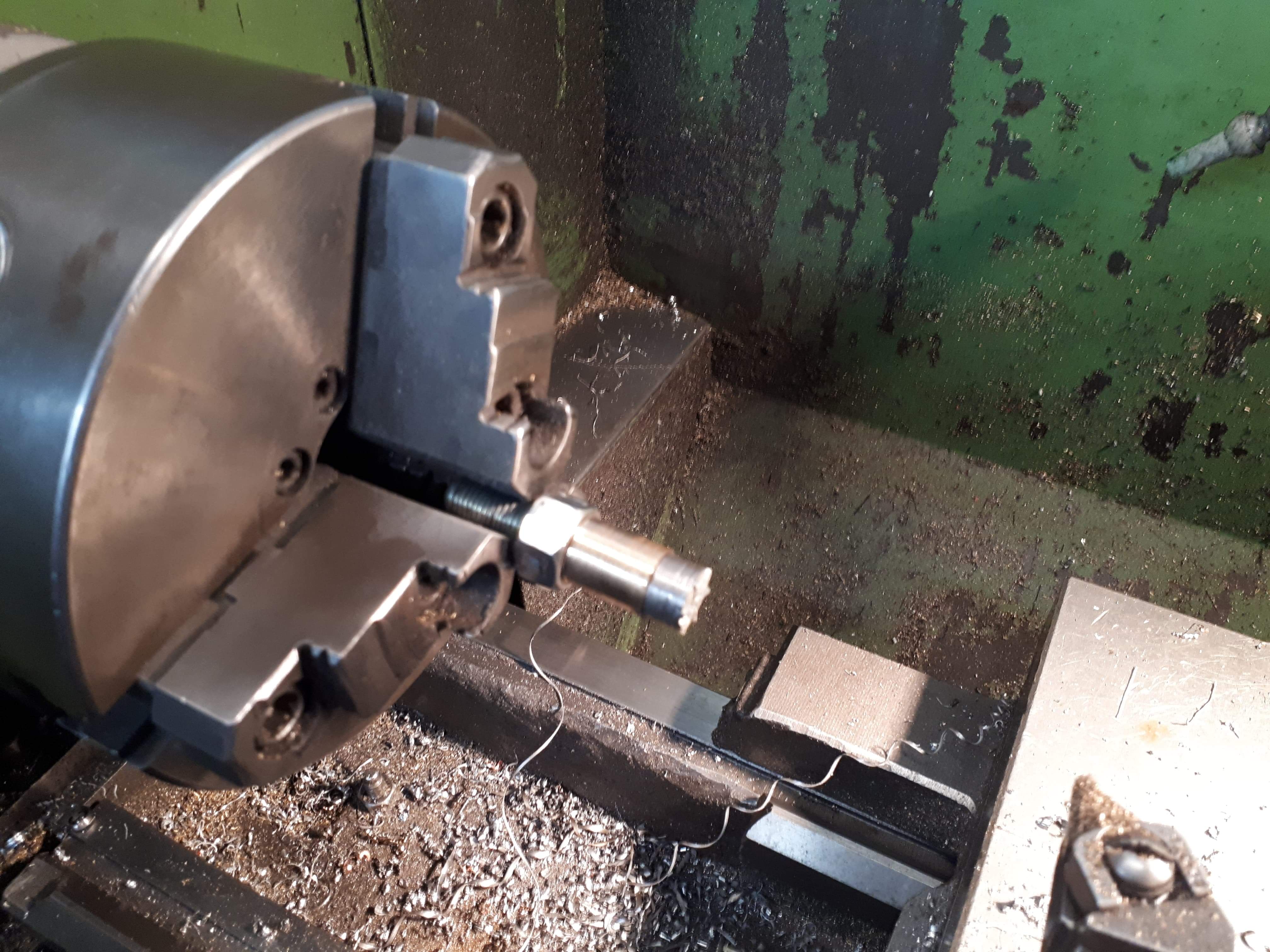

Popular Post JustHarry Posted April 13, 2021 Author Popular Post Posted April 13, 2021 Sorted the shifter bush this arvo. Didnt have any sutible plastic to make a bush out if so modifyed 2 bronze bushes O.d was to big so turned it down to fit. Made one a little small so used a bit of locktite to secure it Then reamed out the i.d till the bottom bolt would go through with only a little clearance Sorted 17 Quote
