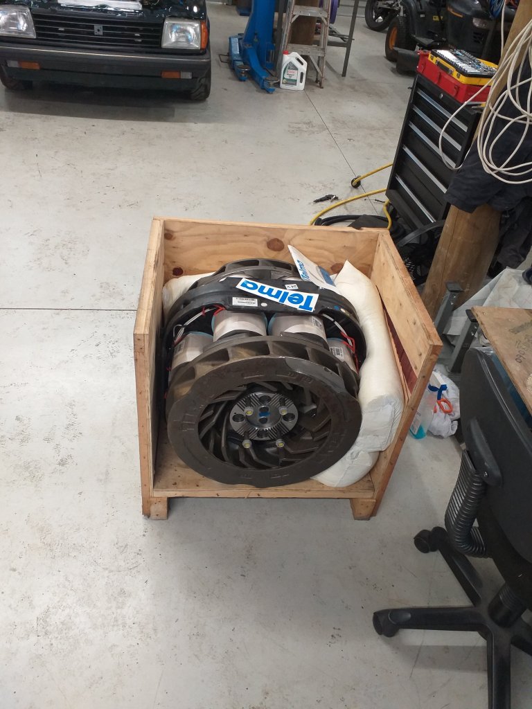

cute wee gem Posted November 17, 2020 Author Posted November 17, 2020 Yep I'm going to use a 762mm roller as some of the bigger/older Telma's like mine are speed limited to 2100rpm (newer ones are 3000rpm for this frame size) - I have talked to Telma and they can do a new hub assembly which is capable of 5000rpm however, but are around $2700 before shipping and taxes. I had a look at the DIY dyno FB page today and there is some good reviews on the Yourdyno stuff, so that gives me some confidence. Quote

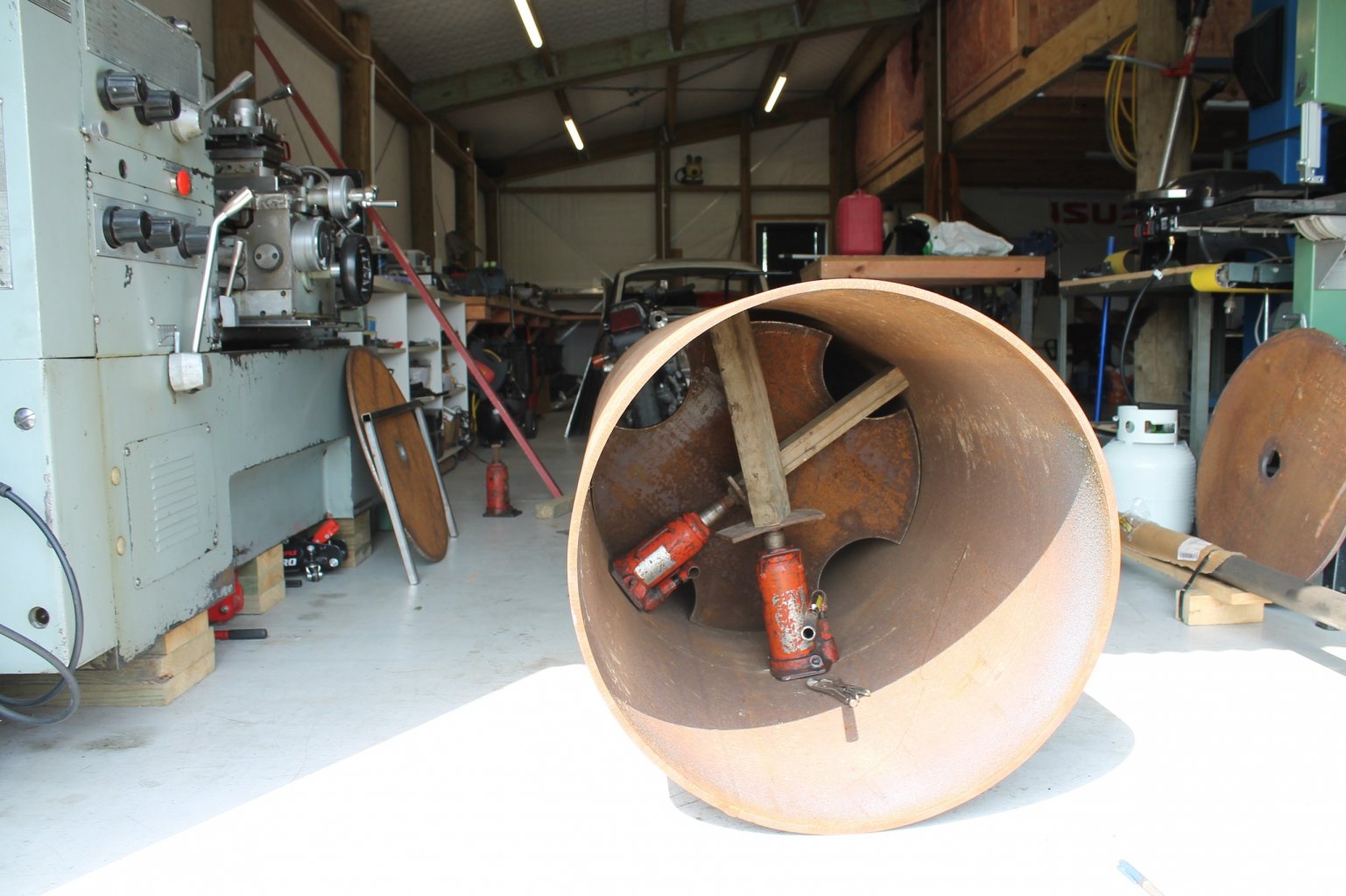

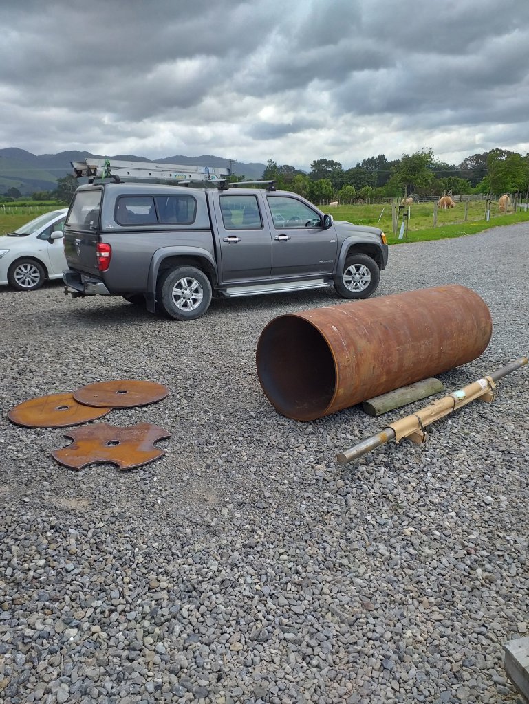

cute wee gem Posted November 17, 2020 Author Posted November 17, 2020 I talked to Egmont industrial supply who I had bought my lathe off previously, because I remembered they had stock of large diameter pipe in various sizes. After telling them I was making a roller, they said they could also supply end plates and shaft to suit. Mint! Fast forward a few weeks and this lot showed up. 2.1m of 762mm x 12.7mm culvert pipe, end caps, center plate and 70mm shaft. The reason for the large roller is due to the RPM limit of the retarder as explained in my previous post. One benefit to this though, is better traction than small rollers due to the increased contact patch, which also reduces stress on the tyre. It turns out that culvert pipe is hugely out of round. But that's nothing that a couple of dodgy 20t bottle jacks and some wood can't fix though! Quote

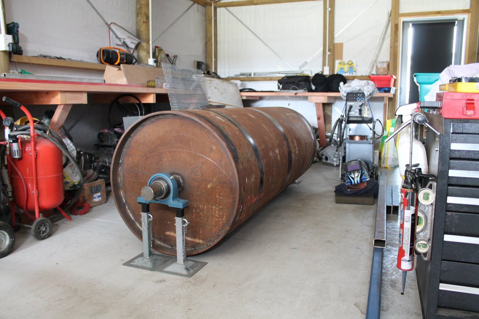

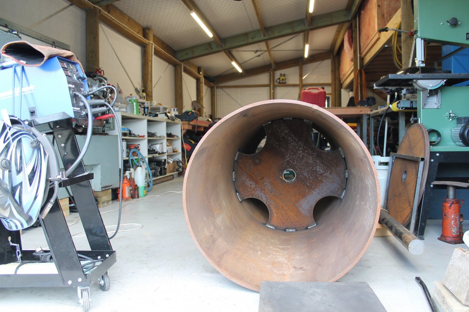

cute wee gem Posted November 17, 2020 Author Posted November 17, 2020 I then zapped the center cap in, followed by the end caps and shaft. - This took quite some fiddling to get it all as close to round as possible as well as getting the shaft as central as possible. With the roller sitting on it's bearings, I checked it all with a dial gauge near both ends and center, with the worst being almost 3mm out of round - which would give me 8.7mm or so minimum thickness after machining in a couple of small areas. Most of it was within 1.5mm, so I was happy enough with that. Quote

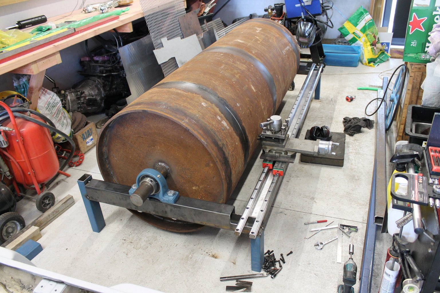

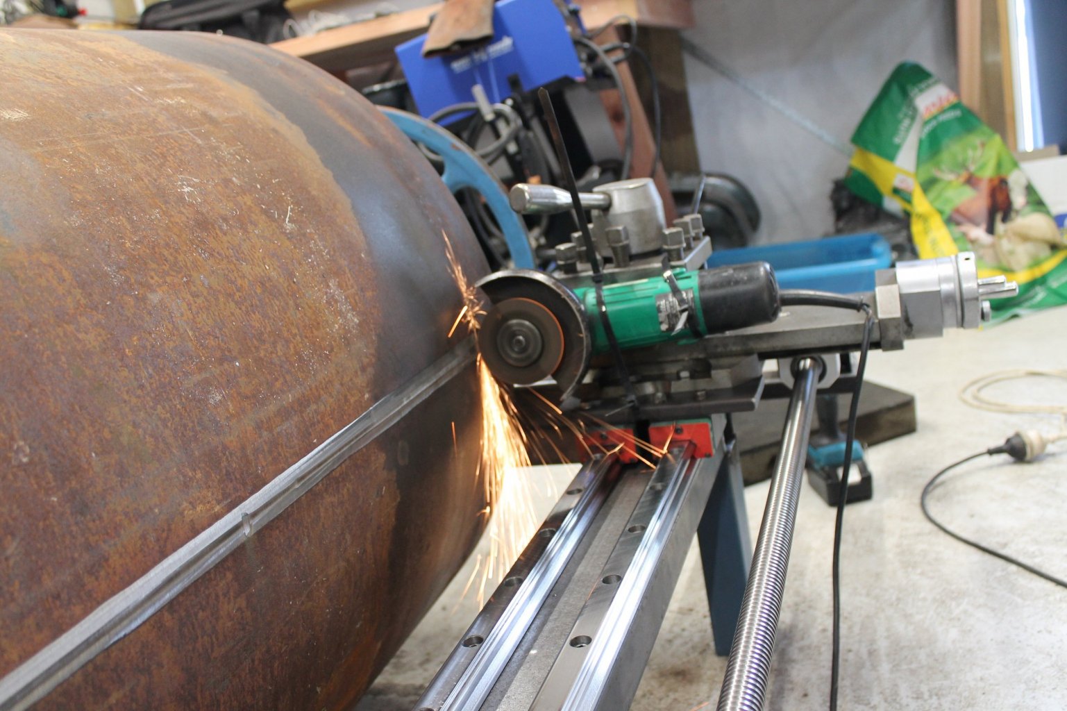

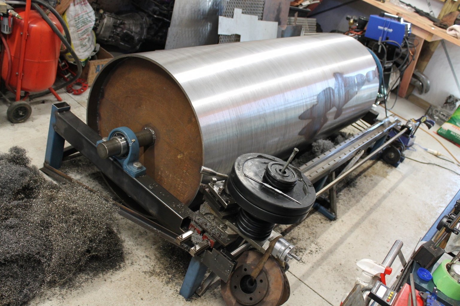

cute wee gem Posted November 28, 2020 Author Posted November 28, 2020 While I was fabricating the roller, I visited a bunch of engineers in the region and found that no one had a lathe big enough to machine it. Bugger. After getting some quotes from further abroad that would have blown my entire budget by themselves (15-20k). I decided that I'd just build my own lathe.. I jumped onto Ebay and ordered the cheapest set of linear rails I could find, including the ball screw and bearing blocks. 3-4 weeks later I got set to mocking up the "lathe" using the compound slide from my Stanko mounted to some adapters. Spinning the roll by hand with the compound slide clamped to the linear rail, I took the first test cut. "Fuuck yeah, this'll work" I said.. It would have taken forever to machine the 3mm x 25mm weld bead off, but I remember once when @kpr mounted his angle grinder in the lathe to cut through some hardening on a set of axles from memory? (that image is burnt into my mind, probably thinking it might be a useful trick one day. cheers dude!) The grinder worked really well and made short work of it. Spinning the ball screw with a battery drill. Quote

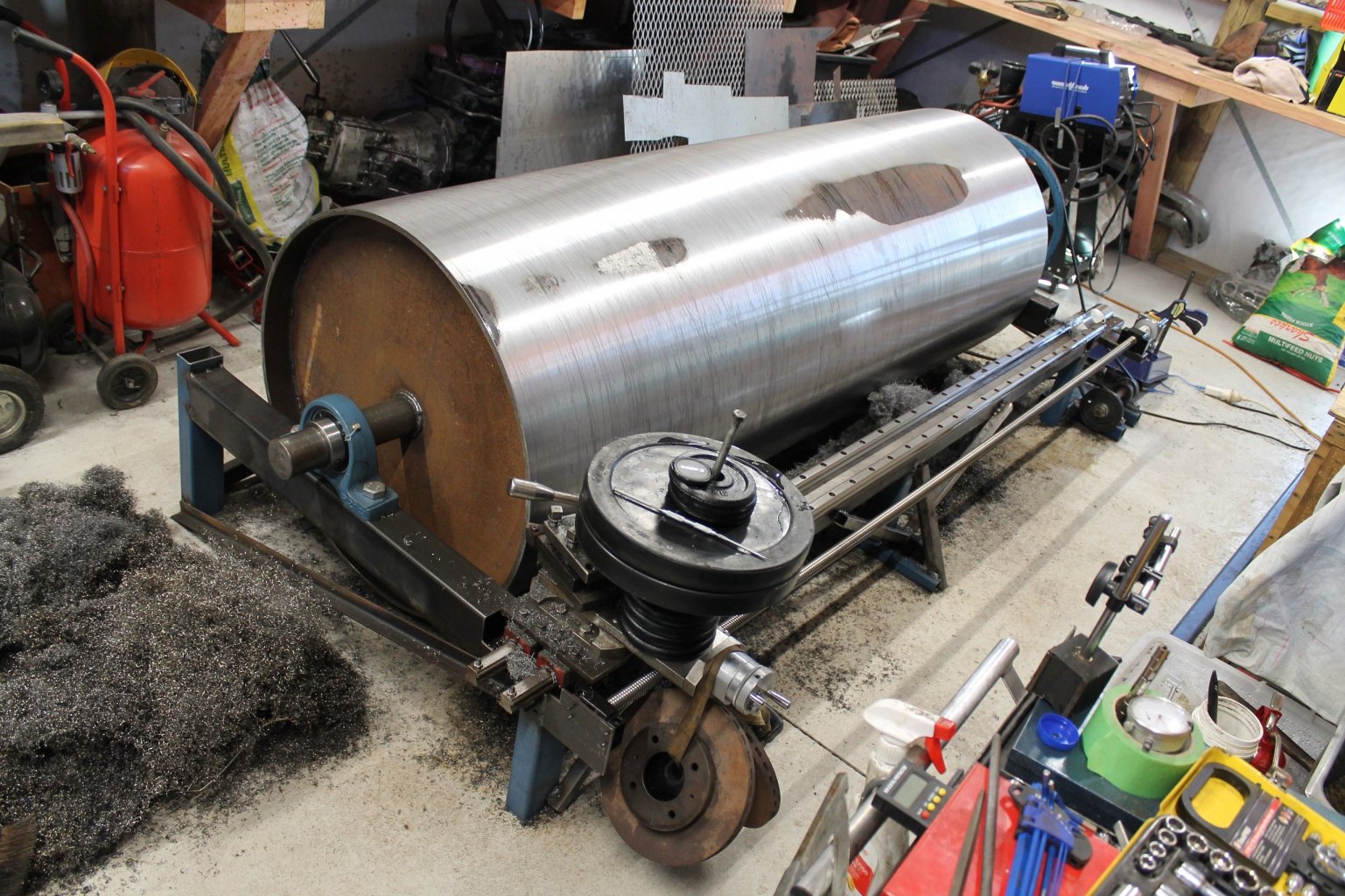

cute wee gem Posted December 7, 2020 Author Posted December 7, 2020 On 29/11/2020 at 08:46, cute wee gem said: "Fuuck yeah, this'll work" I said.. The ideal speed for machining something so large would probably be 50rpm or less. So I bought an old concrete mixer pulley off trademe (around 560mm) and a 50mm pulley for the 3/4hp electric motor I scored from work. This gave me about 130rpm. This worked pretty well at first as I machined off the high spots, but as time went on and the cuts became longer things got complicated. The carbide inserts were over heating and wearing out well before half a pass. I found a home built saw bench on facebook marketplace for cheap, which had some different size pulleys and a stand alone shaft with bearings, so I snapped it up. I then modified my original setup and managed to gear it down using the shaft from the saw bench with an isuzu crank pulley on the other end, to around 62rpm. The lower surface speed was much better but the tips were still wearing out before a full pass, and I was starting to fight some serious chatter. It became apparent that the linear rail support had some flex, causing the compound slide to tilt forward and spring back causing the chatter. I braced it up with some random offcuts which made a big difference. (The linear rails should have ideally been much further apart and properly supported) Still getting chatter, I added 30+ kg to the back of the compound slide. This was enough band-aiding to get me through to the end, without changing the whole thing completely. I also upgraded from a battery drill with a cable tied trigger to a Nema 34 stepper as I needed a much slower feed rate. Quote
