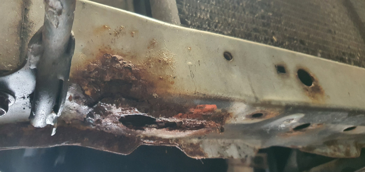

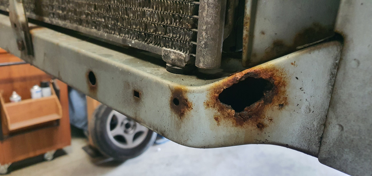

Popular Post yoeddynz Posted June 20 Author Popular Post Posted June 20 We couldn't resist a bargain 😁 Meet Mavis. She's a PFLBB4DM. A# model with sway bars and disc brake rear end. Picked her up this morning from out near Collingwood so this meant first drive home was back over Takaka hill. I'd forgotten just how fun a manual 1.3 K11 is on the hill. We stopped a few times and swapped cars so each of us got to drive Mavis. Such a great little manual box these have. Got home. No fuss. Needs airing out as she's sat a while. Reason she's a bargain is a rusty radiator X member. I've done a few K11s with this rust now. Only other noticeable bit is the bottom of the front guards where mud collects. Otherwise very solid underneath. Plan is to fix, wof, drive her for a while, probably list for sale at sensible price and enjoy owning her till she finds a good home. I forgot just how tiny they are. Not ideal for 188cm me but still comfy enough. Amazing that the Cube z11, only a touch wider and longer than a k11 was able to carry so much in the back. A boot lid and two doors plus other bits swallowed easily. It really is the sensible 11. Very comfy and a bit quieter but certainly not as fun on the twisties. If only the Cube was a manual too 😞 10 1 Quote

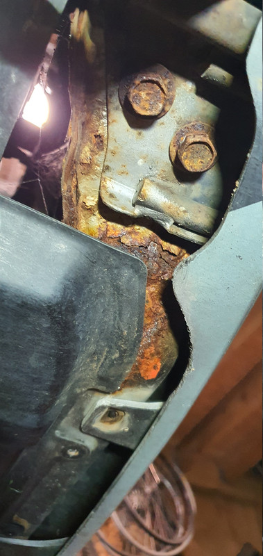

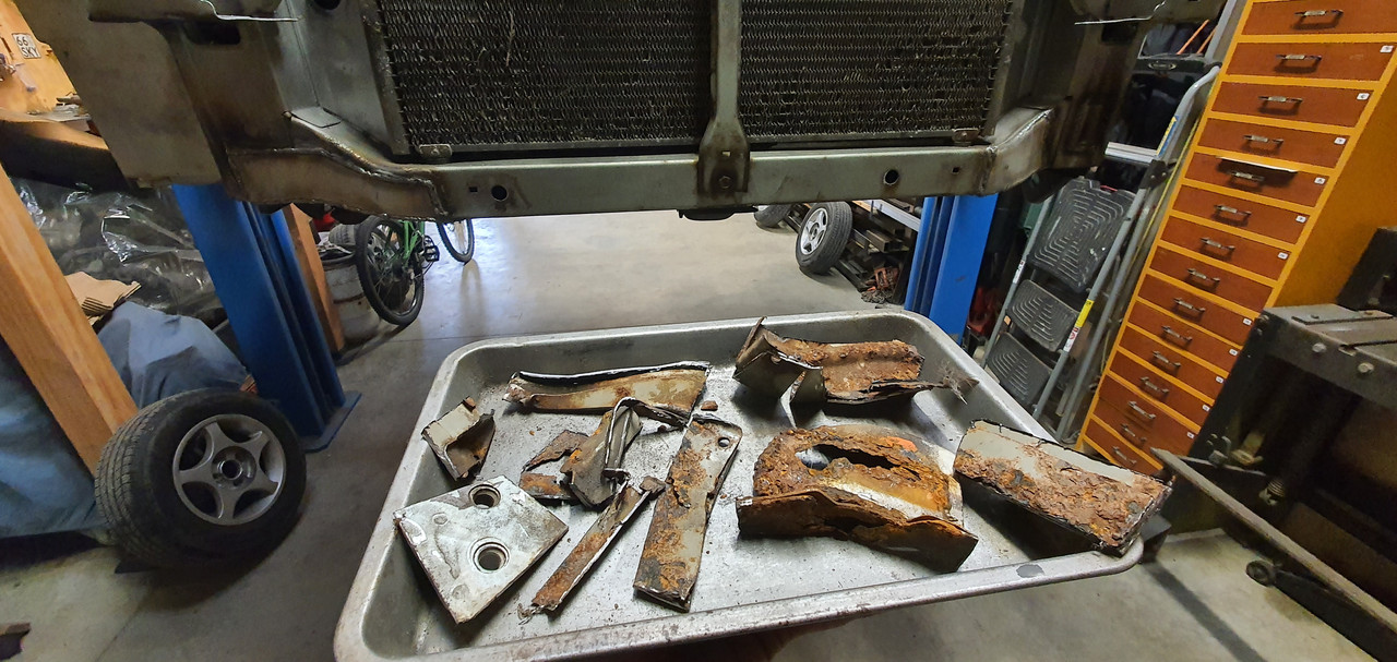

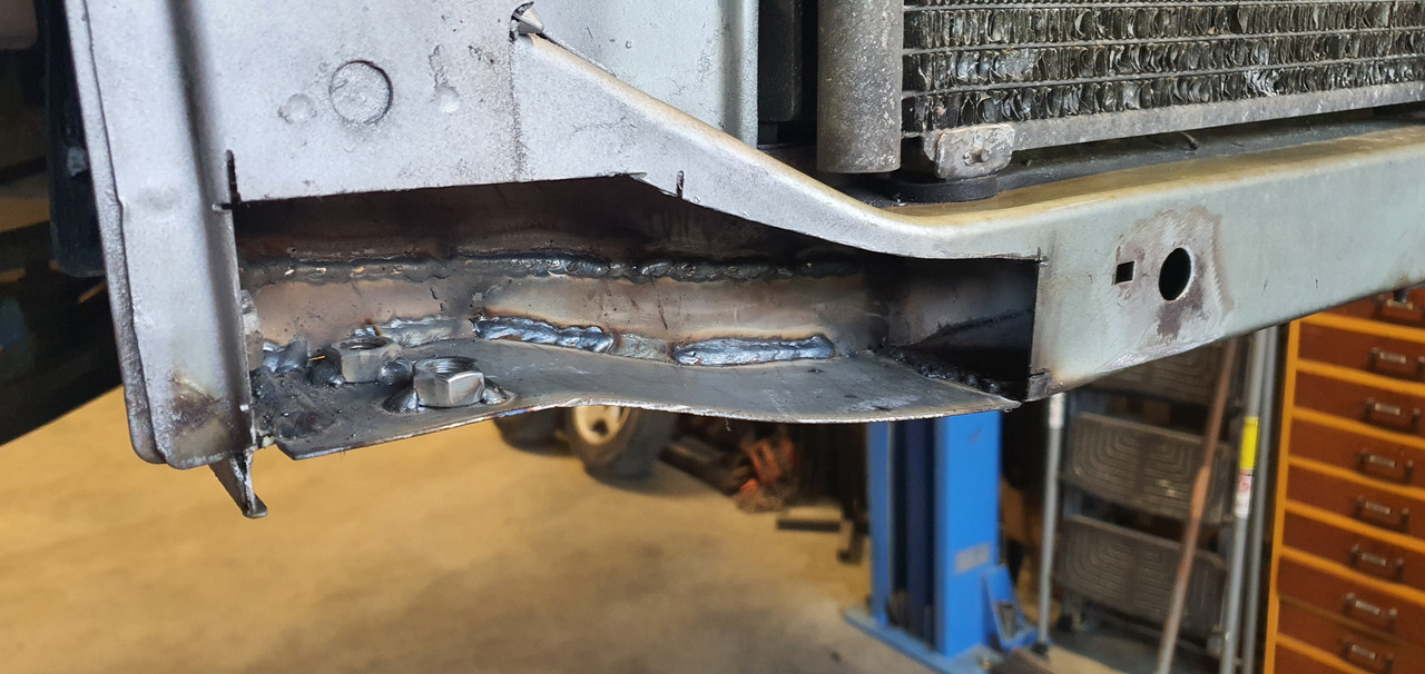

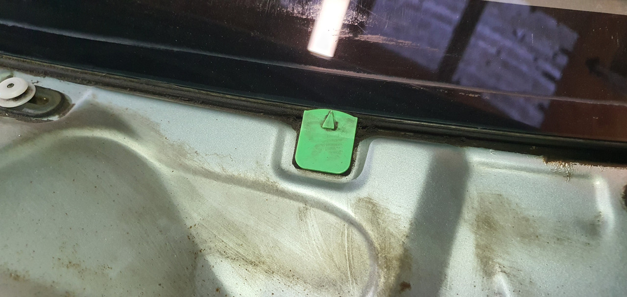

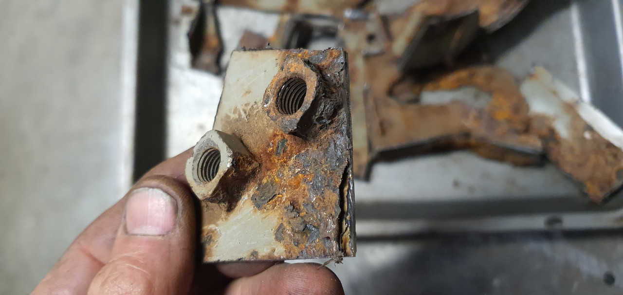

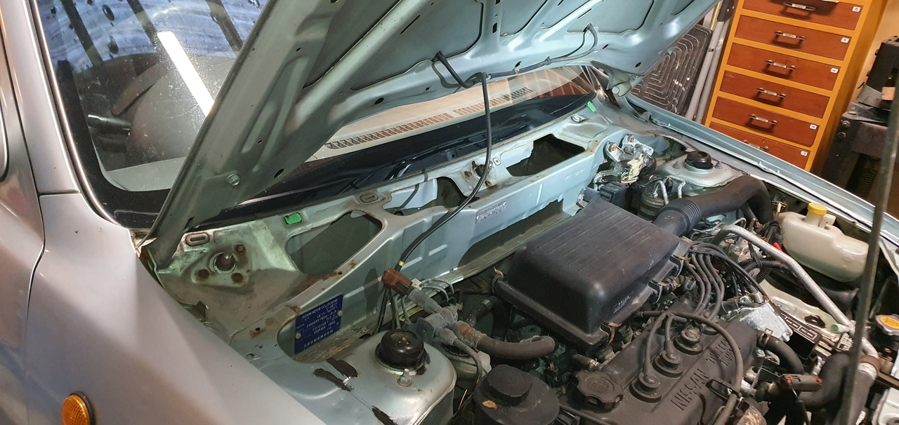

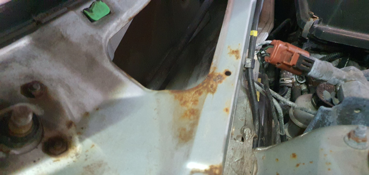

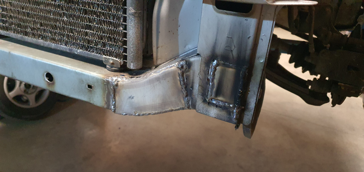

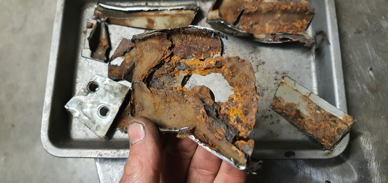

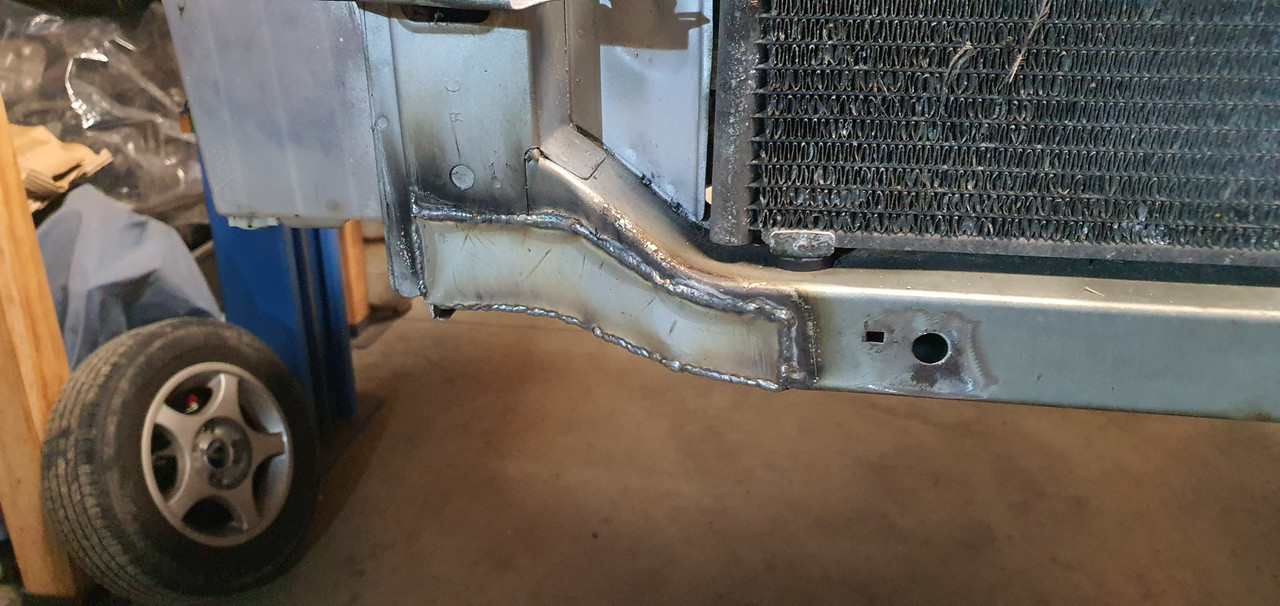

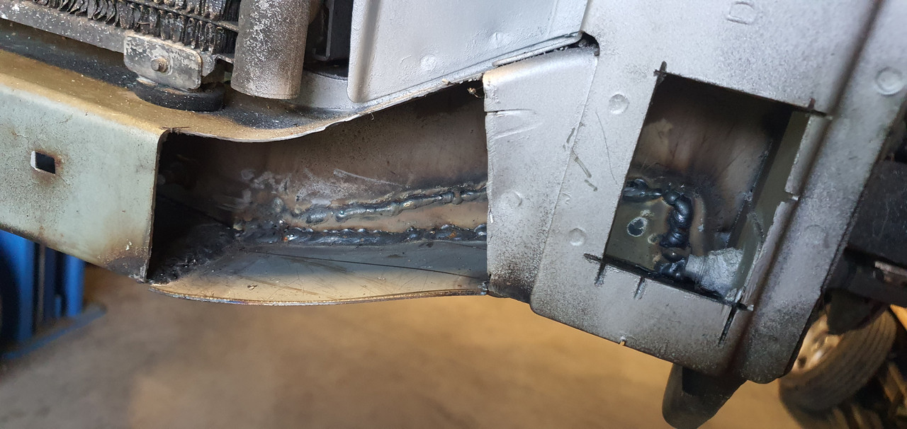

Popular Post yoeddynz Posted June 23 Author Popular Post Posted June 23 The following day I ripped into that rot on the radiator support. I cut out far more than expected but its all solid new steel now (nice thick steel too rather than two thin bits to trap moisture as was factory) in pics.. We removed the leaf guard below the windscreen and luckily its very solid under there. Just some surface rust in places. Even the windscreen locating clip seal is intact so no wet carpets.. Car came complete with a pretty little spider.. Next job is to spray bomb the underside with some 'new car in a can' black zinc. Then sort the stuck rear calipers, reassemble and take it for a wof test. 14 Quote
