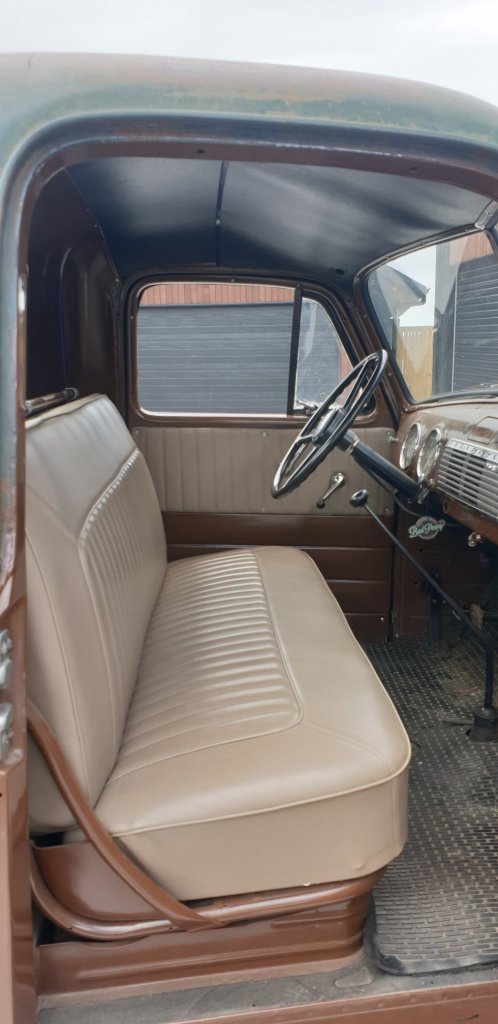

A heap of newish chrome was on it, interior has been redone at some point and truck was more or less running and driveable.

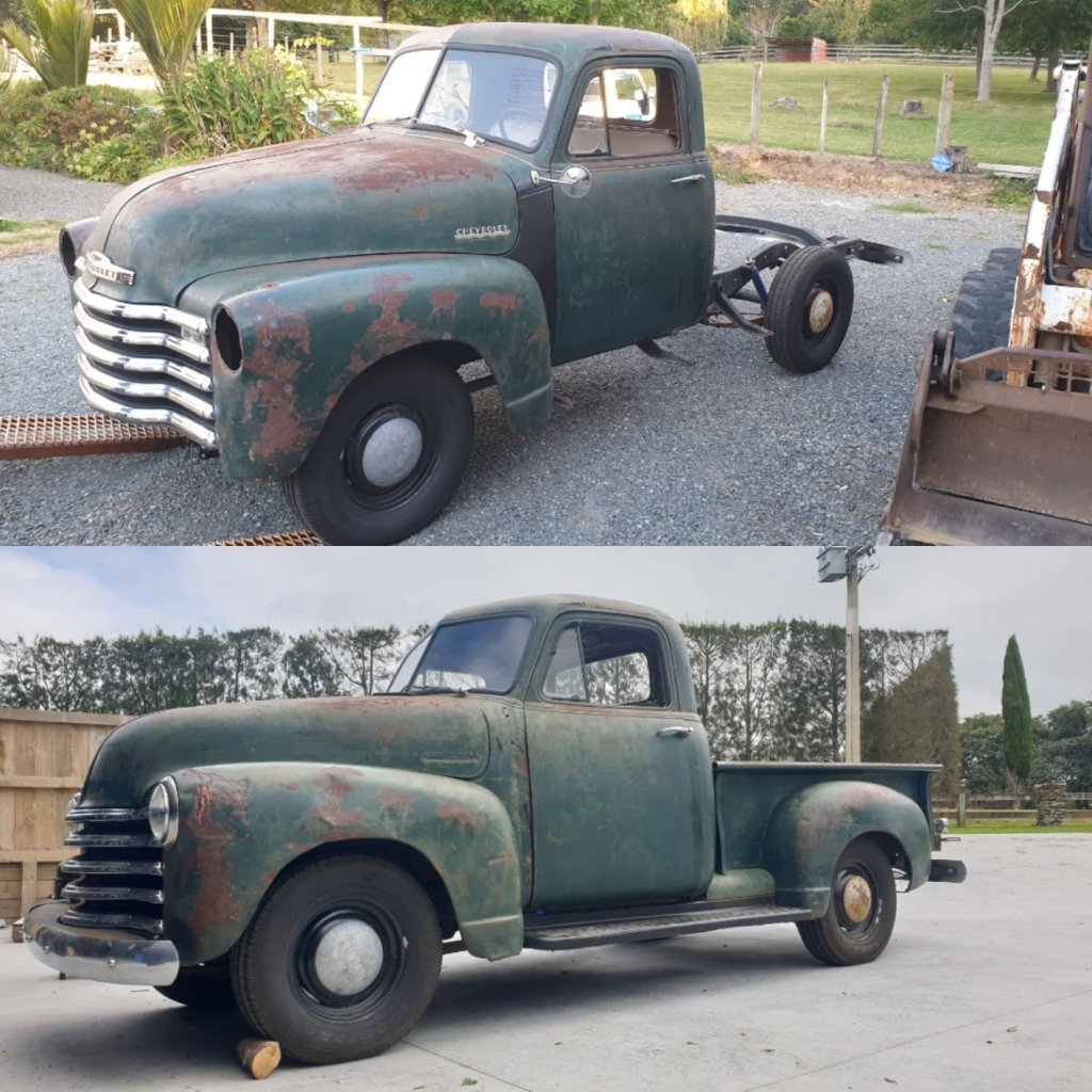

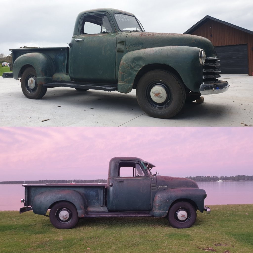

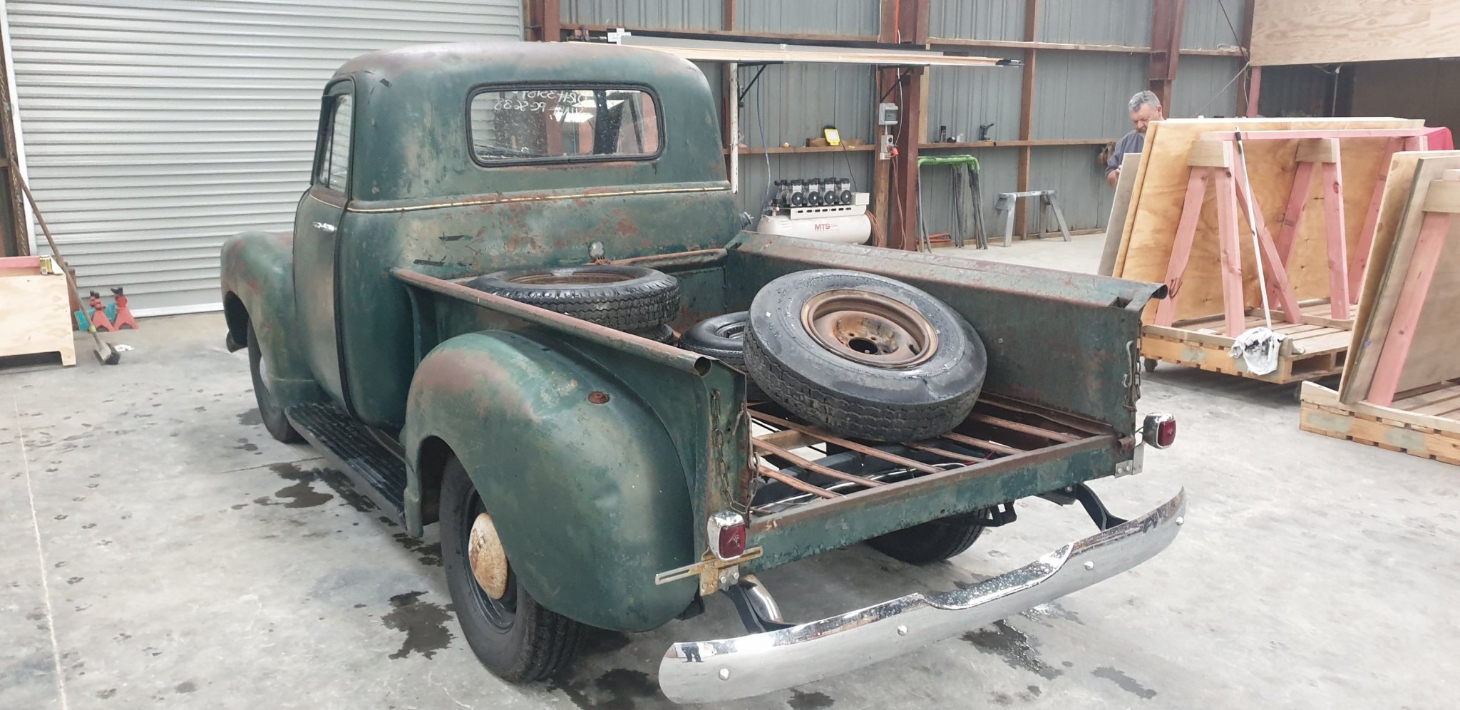

Pics of when i first got it.20190915_123345_resized.jpg.d3bed694924b29b101a54fbdcfdd4fb6.jpg20190915_123511_resized.thumb.jpg.a9fd8acb55d01303e312df74bdd4f510.jpg20190915_123331_resized.thumb.jpg.f40c4a52a4ab537aee2df70cee2b617f.jpg20190818_114336_resized.thumb.jpg.734a98d8d610005f9707e96b0f6a7540.jpg20190810_165343_resized.jpg.49828c853624a7cc4ca1adf65c77bb0f.jpg

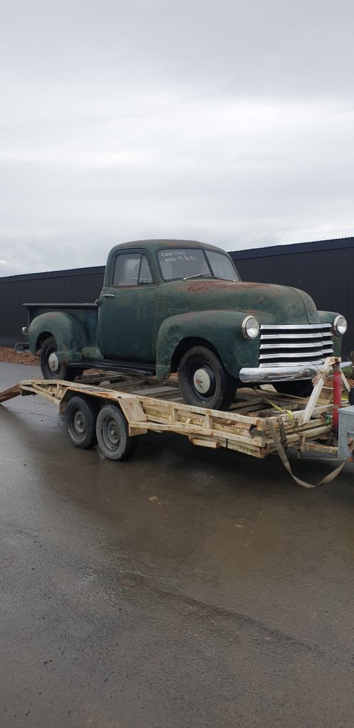

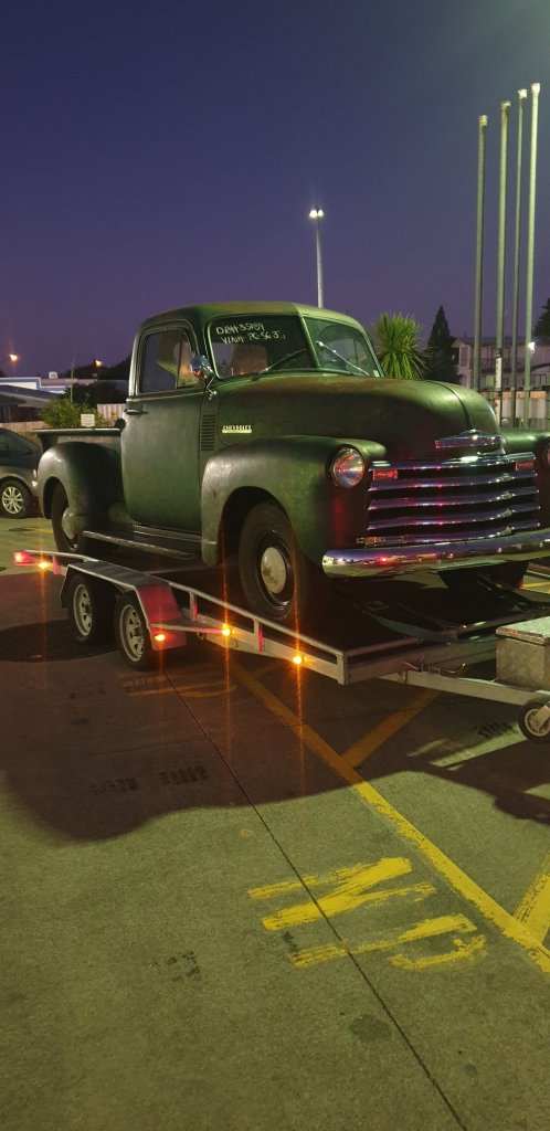

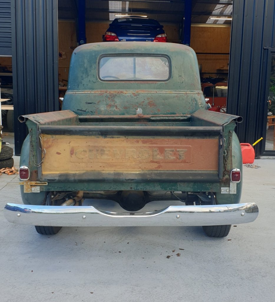

Couple more pics of whe n we bought it.
Managed to drive it on the trailer which was ideal after a push start.

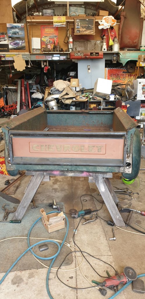

Got it home and test fit the tailgate.

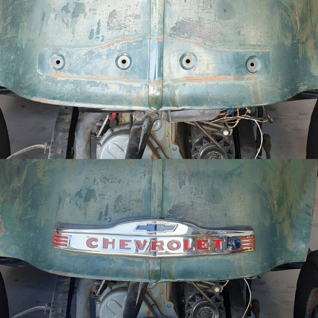

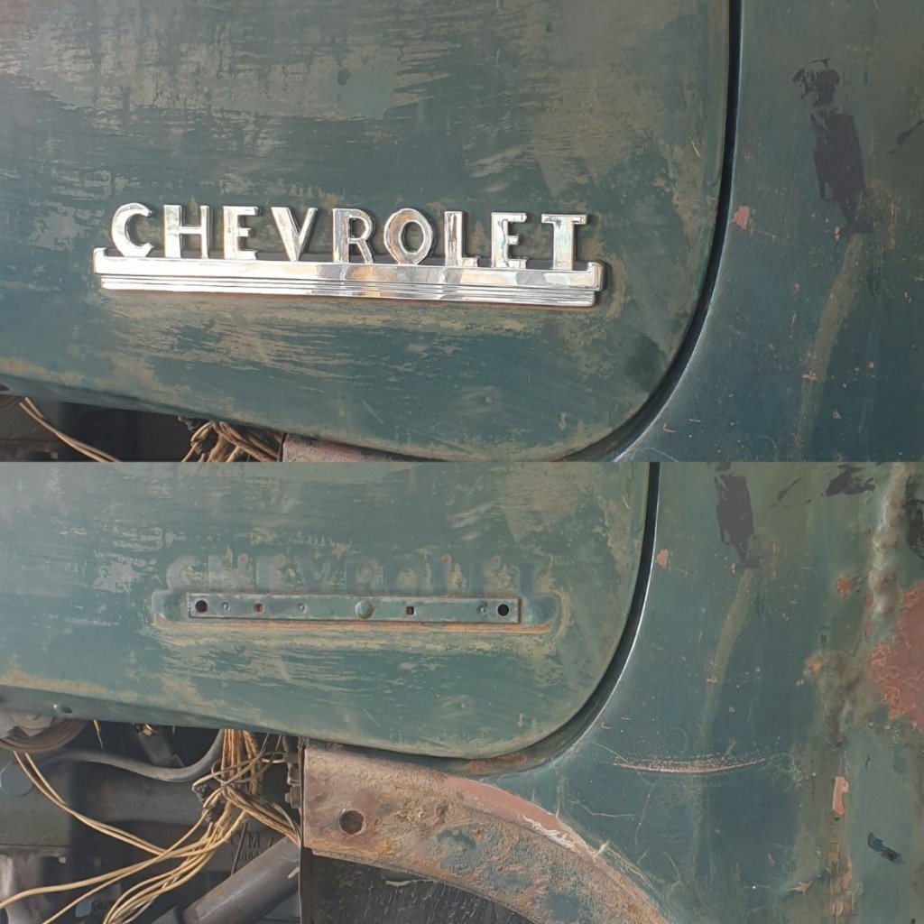

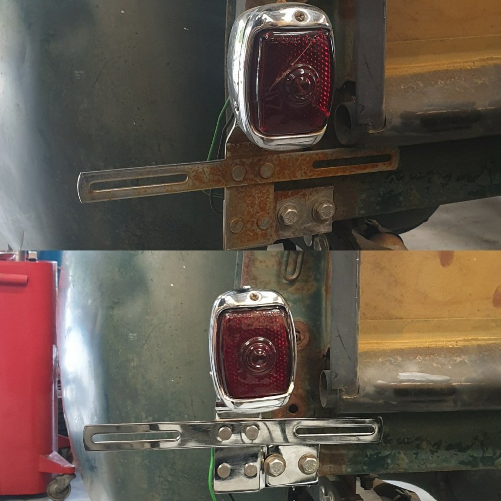

New front bonnet badge, side bonnet badges, new tail light brakets and glass lense, new side mirrors. Front indicators (didnt have any)

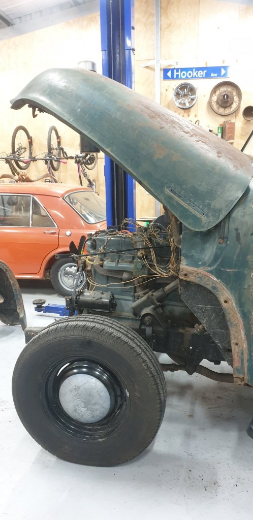

Starter wouldnt work when we got it, turns out the solenoid thingymebob for the pedal start was worn asf!

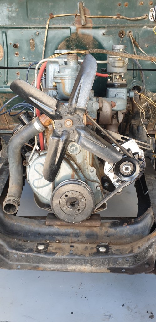

Started doing the 12V conversion, fitted new alternator
Nearly forgot took it for its first drive to the end of the road before we pulled it apart after a tow start down the drive.
Couple of final photos before it got pulled down

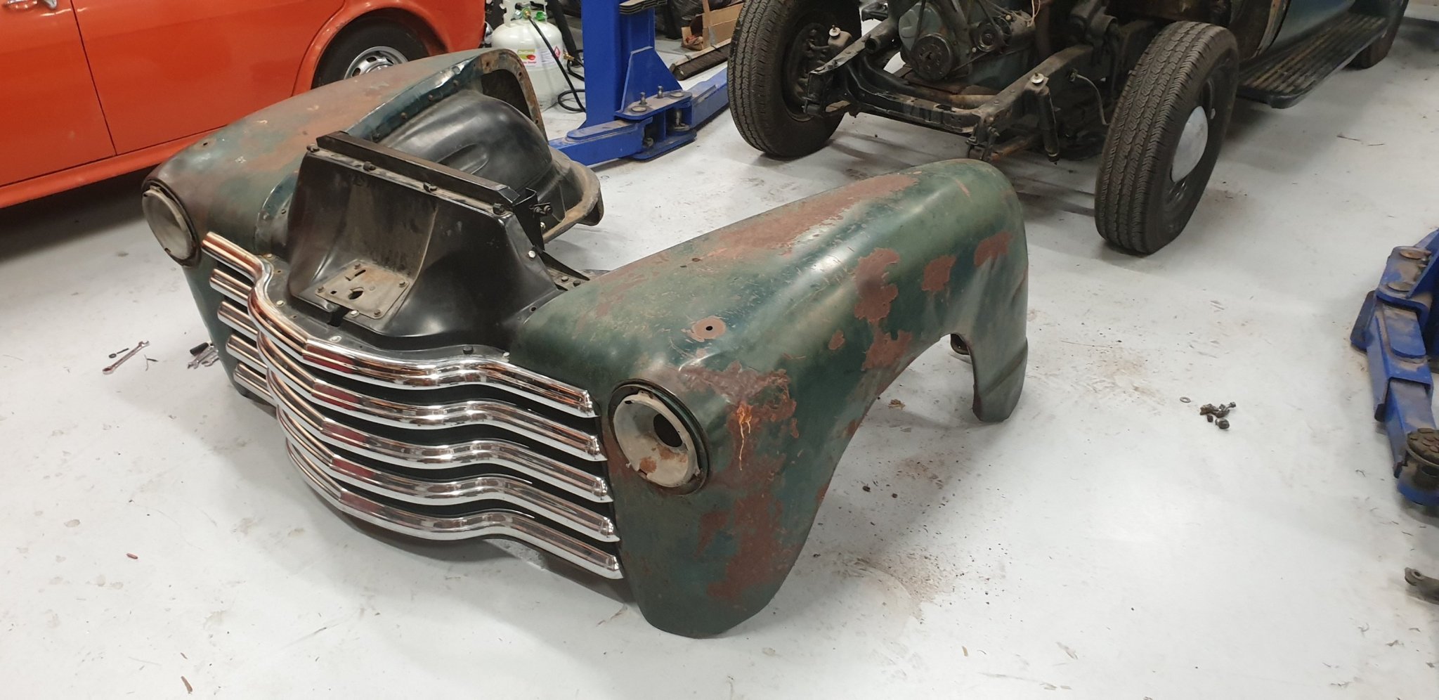

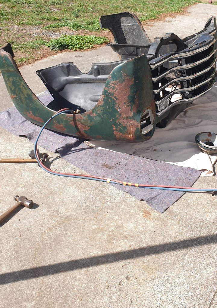

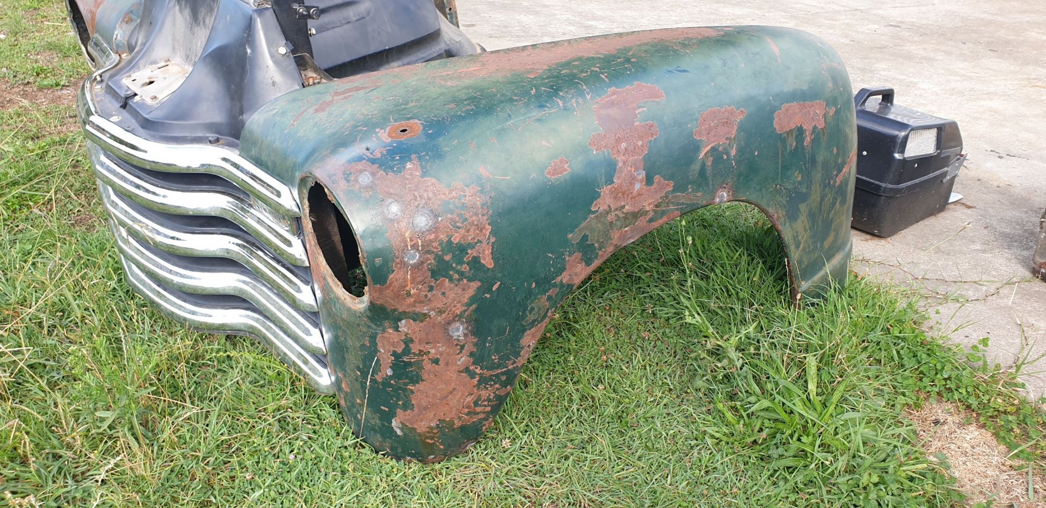

Started pulling it apart ready for rust repairs and new timber deck etc. Front clip comes off as one piece which can be manhandled difficulty off by yourself haha

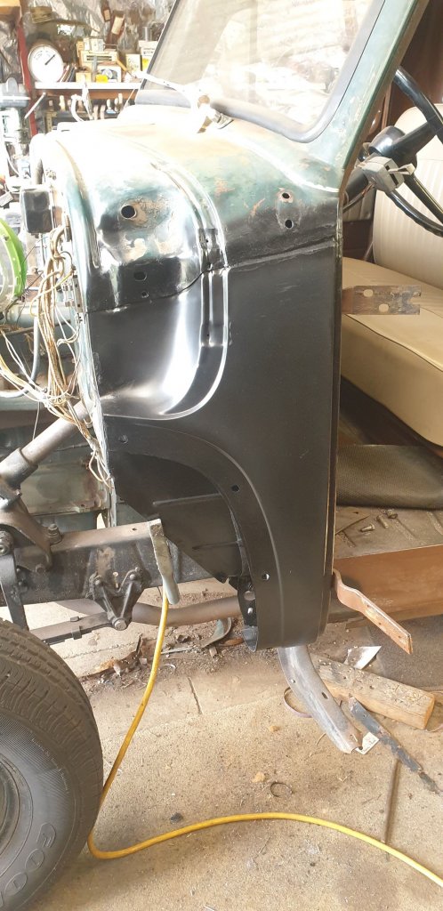

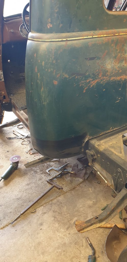

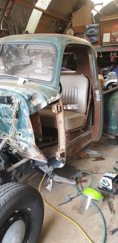

Next up was get stuck into the rust.
Managed to find a skilled older tradesman who was keen to tackle it. And also keen to let me come and help him which was awesome.
Learnt a heap of new skills and was epic watching him hammer and dolly out the dents.
The front drivers side door had swung round and stoved in the corner of the cab as well as bent the door at some point. The yanks must of tried to bang the dent out from behind via piercing holes in the inner guard to put a bar or something through to hammer dent out from the inside (unsuccesfully) it ended up leaving a heap of holes for water to get in which in turn rusted the bottom of the inner and outer cab corner out.
The rear cab corner also needed replacing on the same side, outer only.
Had a bit of rust around one tail gate hinge to fix as well.
Apart from that she was solid as , floors and doors and guards are good as!

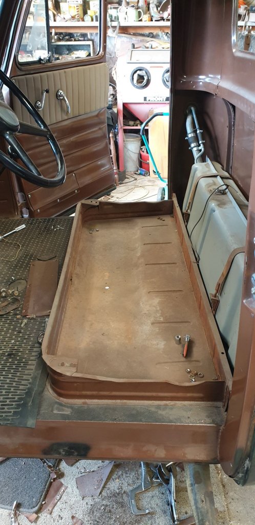

Seat wouldnt move backwards and forwards so pulled that out and cleaned up all the sliders and got that working again.

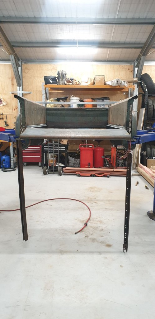

Also spot welded new bed angle strips on the side of the tray as the old ones were rusted out.
Gave the panels a good bang with a hammer and dolly and straightened them out a heap! Gas welded up any splits or breaks in them as well.

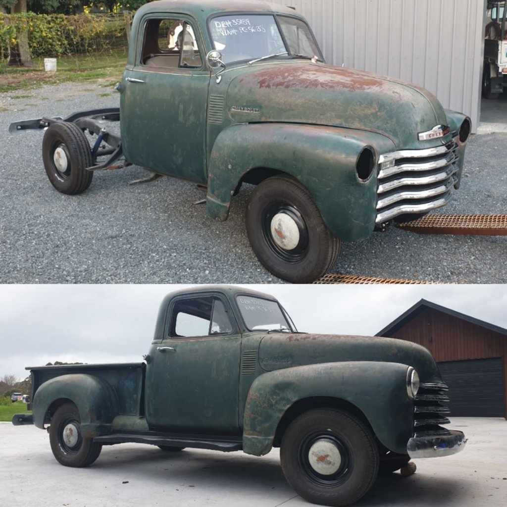

Couple of before and afters showing how much straighter the cab and front end is now!
Got the tray panelbeated, the one bit of rust on it fixed and the new bed strips welded in.

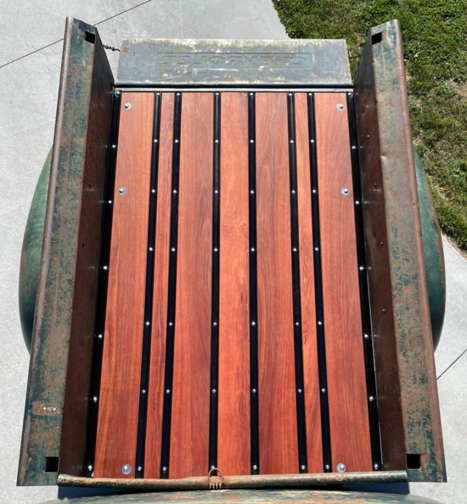

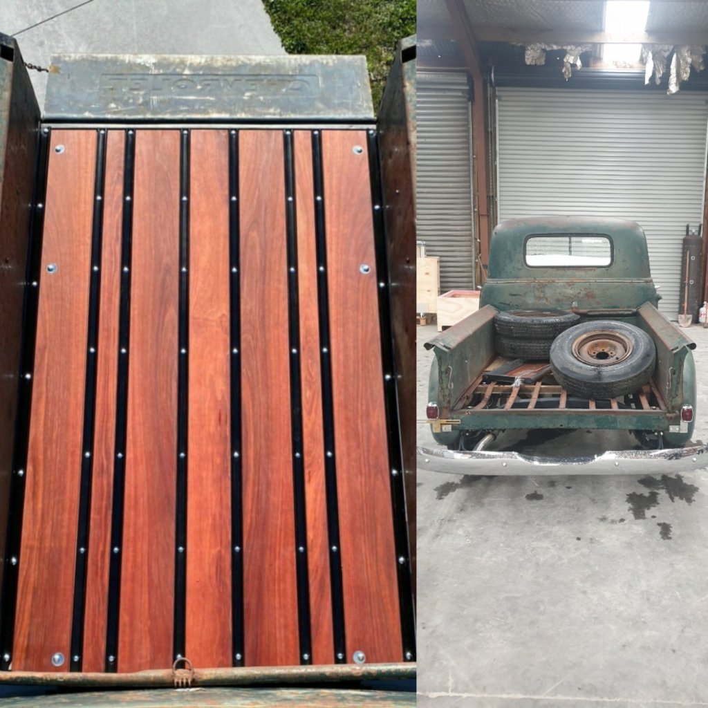

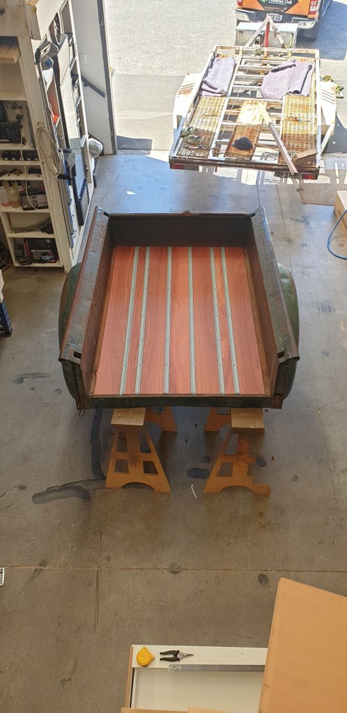

Then took it to a mate whos a cabinet maker and we spent the day making new timber for the deck.

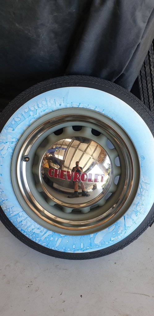

Also got some tyres test fit on the artilleries with the new hub caps and whitewalls. Looking forward to getting these on!

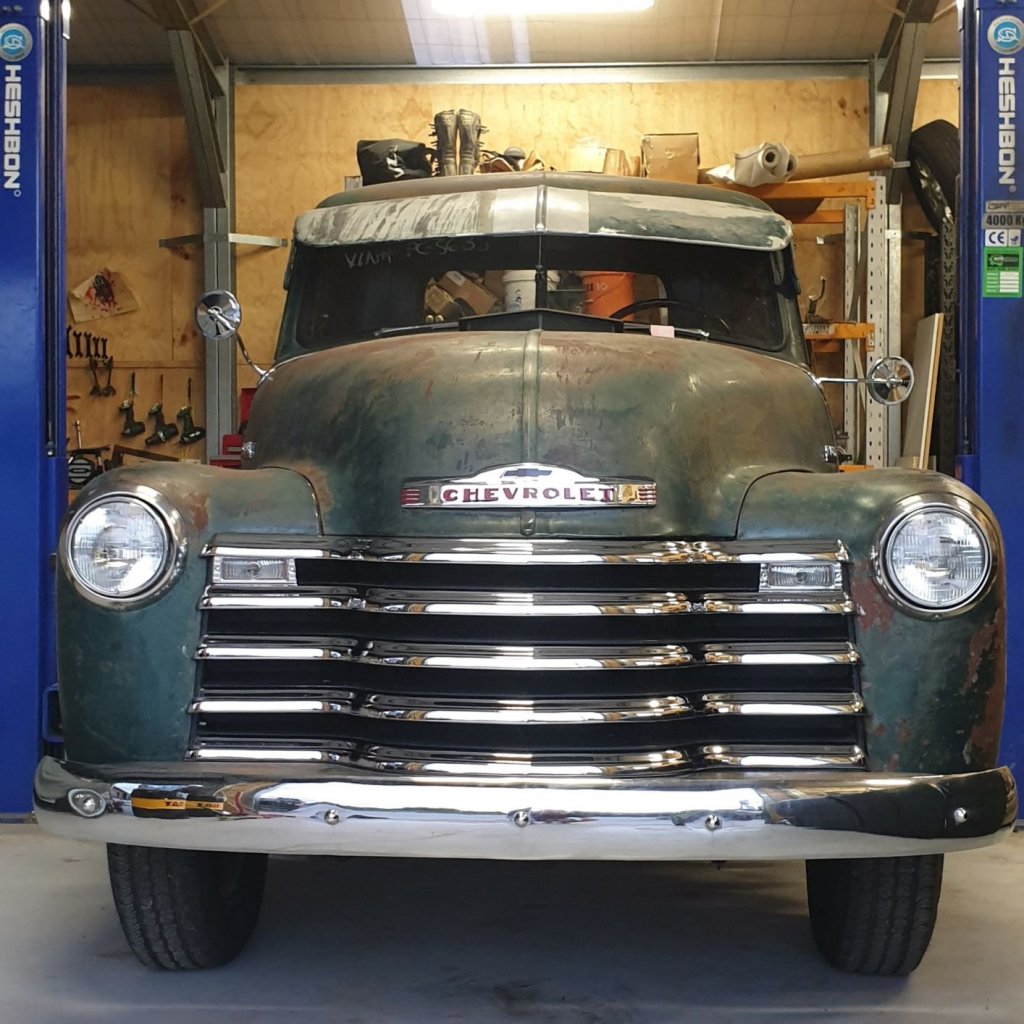

Got the bumper back on and the front end together with the lights on.
Found a Fulton Visor from the states which was already green/patinad so matches the truck quite well i think! Got that on test fitted.

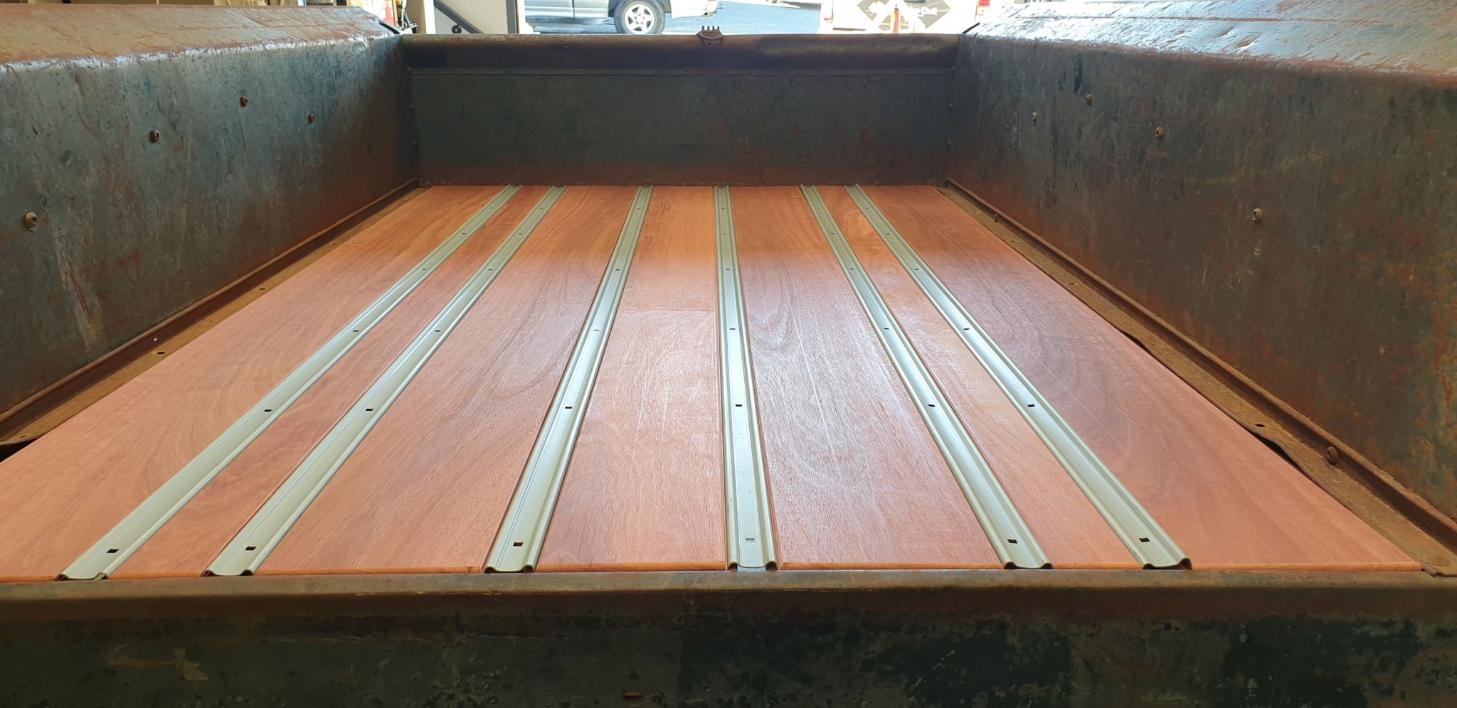

Got the timber deck put together on the weekend.
Jarrah timber deck with new deck strips all painted up.
Stoked with how its come out.
One step closer to going for a VIN.

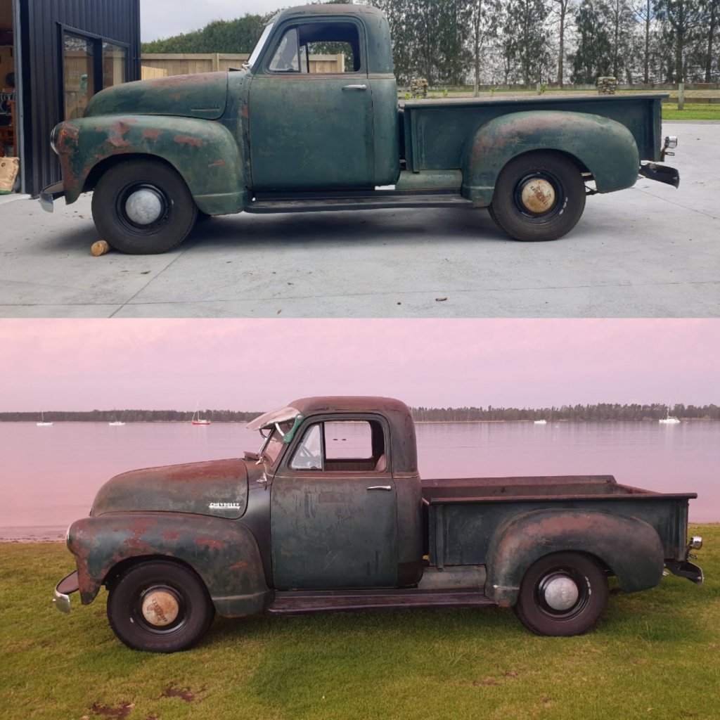

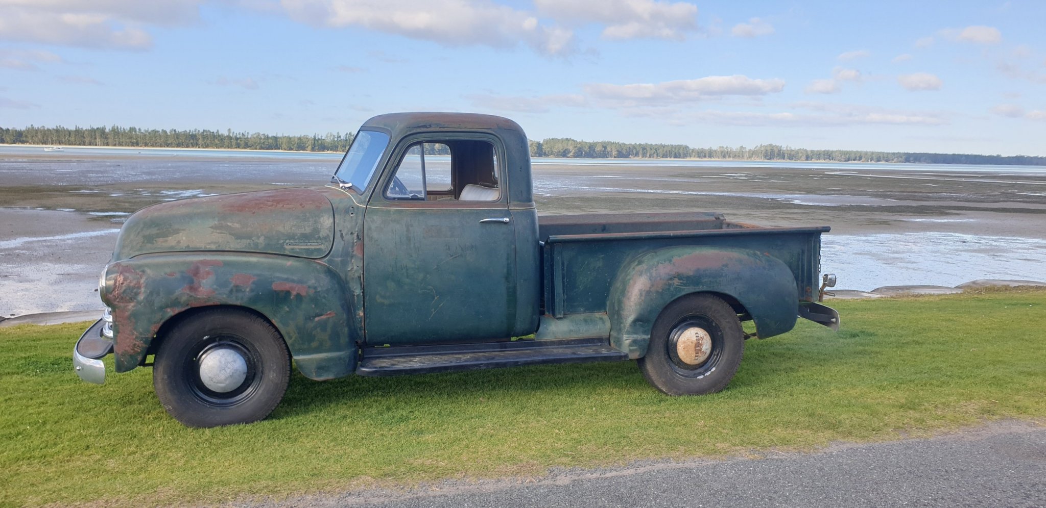

Took it for a quick jaunt up the road to grab a couple photos last night.
Heres a couple of before and afters of the whole truck before/after rust and dent removal.
IMG_20200421_183339.thumb.jpg.963e1e4c9ea37a554697024ea2fbd012.jpgIMG_20200421_183436.thumb.jpg.35a2c3b67a7e4c7948d4e449cb4394d8.jpg

Have had the Artilleries rebarreled as after sandblasting they had a heap of holes in the barrels.
Wheel and Frame in Cambrdige rebarreled them with 7 inch barrels instead of 5.5 they were factory.
Centres were riveted in from factory so they drilled these out and welded  the centres into new barrels.
Mate lined up to paint these this week then the whitewalls can go on!
