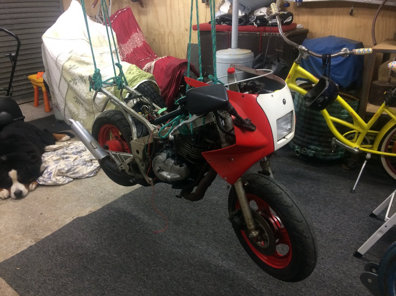

Duke Blackwood Posted July 8, 2019 Author Posted July 8, 2019 A couple of years back I bought a YSR50 with a TS185 engine transplant, half complete, from an estate garage sale; it may be the best value purchase of my life. I haven't touched it, never got it running. After reading about the upcoming Urewera Undertaking, I knew it was time. The factory YSR frame is only rated for 65kgs and I weigh more than that... I'm also looking at a horsepower increase of something like 240%... and I should probably make some kind of concession for the gravel. So there's a bit to be done. Step one, amalgamate the looms and achieve stable idle voltage. Step B, celebratory burnout. Watch this space. Quote

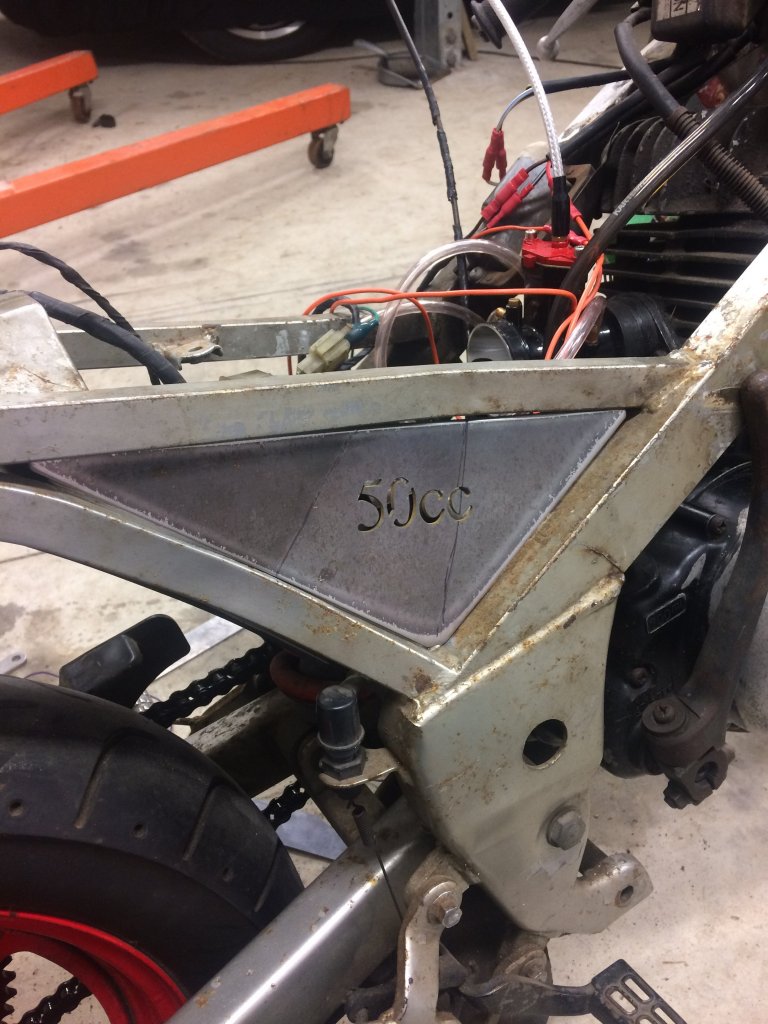

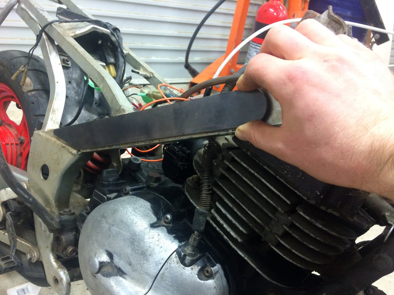

Duke Blackwood Posted July 11, 2019 Author Posted July 11, 2019 Alarmingly the bike is already showing evidence that it intends to reject its new engine; by breaking in half and letting it fall out Quote

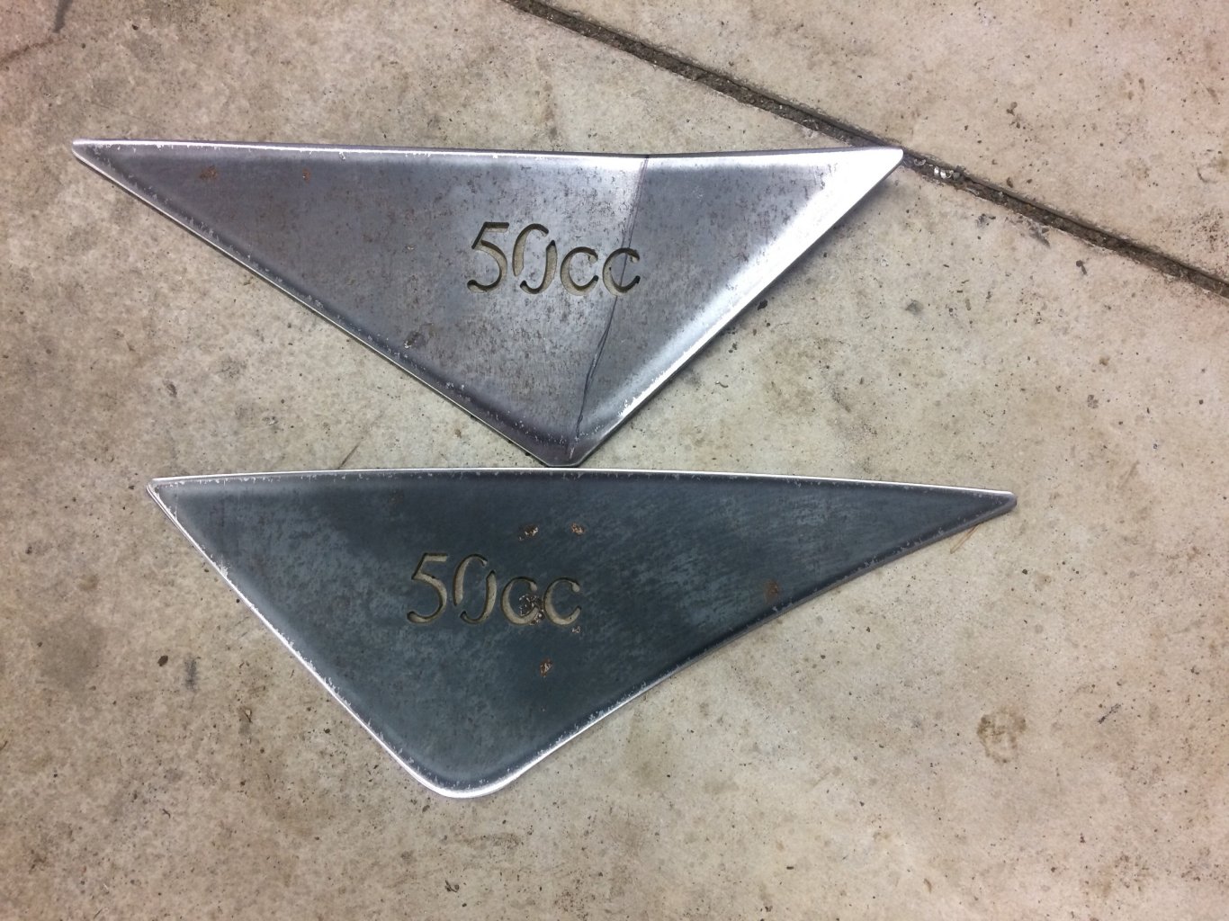

Duke Blackwood Posted July 11, 2019 Author Posted July 11, 2019 To avoid this, I've made up some frame gussets and doubler plates. She has also had a test idle and a stable voltage has been achieved. Quote
Duke Blackwood Posted July 11, 2019 Author Posted July 11, 2019 Sorry officer, you must be mistaken, I can't have been doing a 70kmh rolling burnout.... it's only 50cc? Look at the frame.... Quote
Duke Blackwood Posted July 11, 2019 Author Posted July 11, 2019 As it sits, behind anglia4's Austin Quote

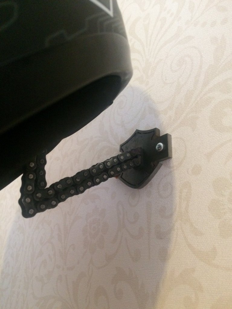

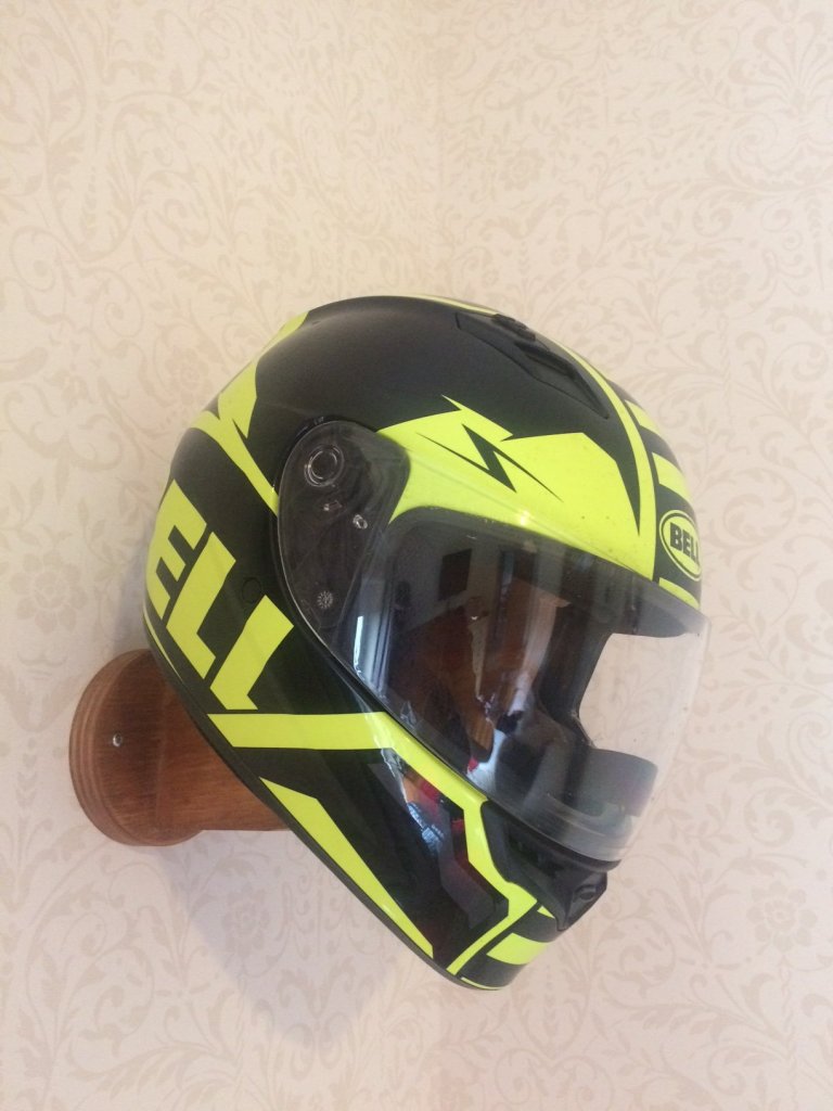

Duke Blackwood Posted July 17, 2019 Author Posted July 17, 2019 Hoping to setup a YouTube account soon and put up videos of me gapping Busa’s at the lights etc. In the meantime, here is my solution to a problem that plagues all of us: where to store all my damn helmets. On a damn handsome helmet rack. Quote

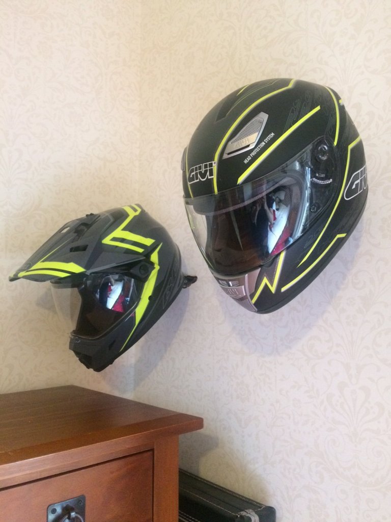

Duke Blackwood Posted July 20, 2019 Author Posted July 20, 2019 Got distracted at shed night, was supposed to be working on the pole smoker but wound up making more helmet racks since I was so happy with the first one. Welded up some go kart chains in a plywood jig and then welded them to some ‘Harley-esque’ non-copyright waterjet cut mounting plates. Lay some brass over one to make it a bit different. I’ll be working on the pole smoker again tonight and will have an appropriate update. Otherwise I’ll change the thread name to ‘Helmet Storage Chat’. Quote

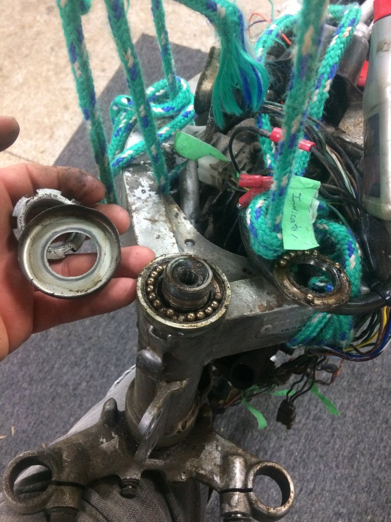

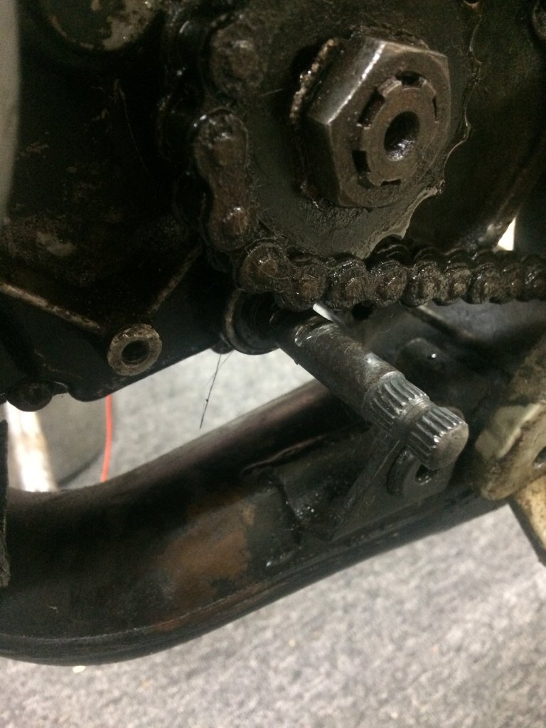

Duke Blackwood Posted July 20, 2019 Author Posted July 20, 2019 I like working on hover bikes because the swinging reminds me of Mad Max 2, beyond thunder dome, and that fight scene with master blaster (how hot was Janet Jackson...). Anyway, wheel bearings are all so chooched I can't believe they spun, steering head bearings the same, lock washer comically fucked, larger drive sprocket has been beaver chewing the shifter shaft.. fork seals shagged... top triple tree is tinfoil... front tyre split like a piece of old timber. But in positive news, big carb from China fits good, and the new pads and shoes look to be a good fit too. Quote

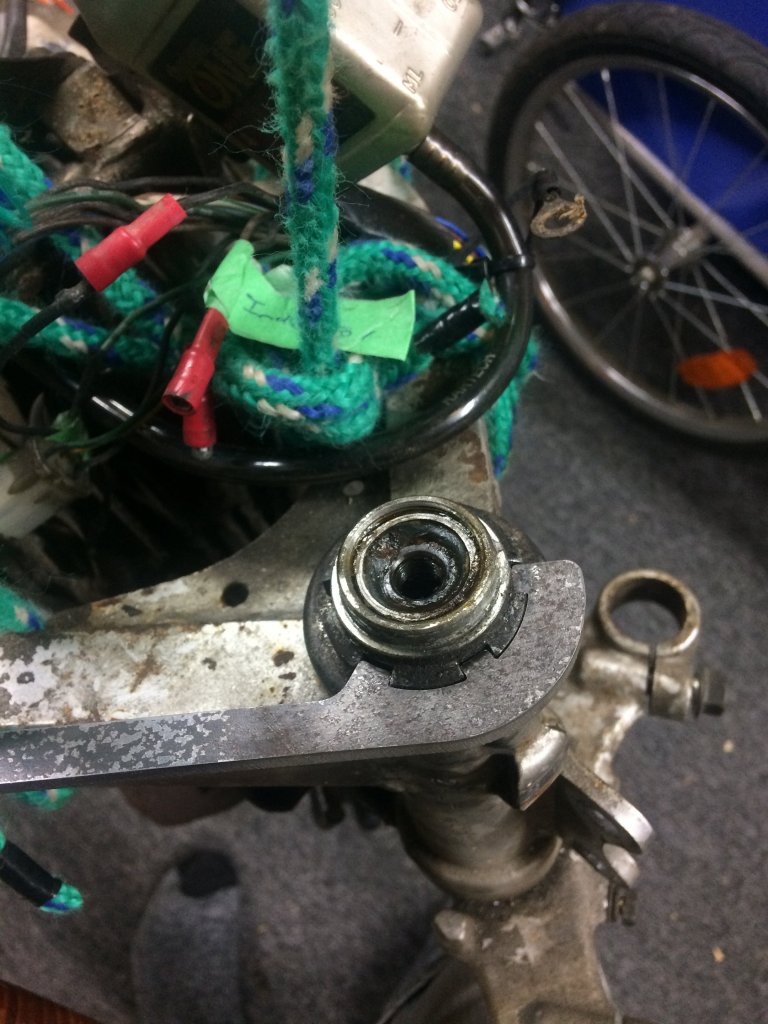

Duke Blackwood Posted July 26, 2019 Author Posted July 26, 2019 Stripped more off it over the last week, forks and brakes are completely disassembled, forks are funny, one side is the spring and one side the shock, like an old Buell. I had to make a special spanner to get the steering nut off. It has pushbike style bearings which I'll be replacing with something more heavy duty and I'll make my own triple trees from 20mm Ali, top and bottom functional, not just the bottom as it is currently. Just waiting on fork seals from CHINA and I'll have it all back together. Might have the front brake disc skimmmed. Quote

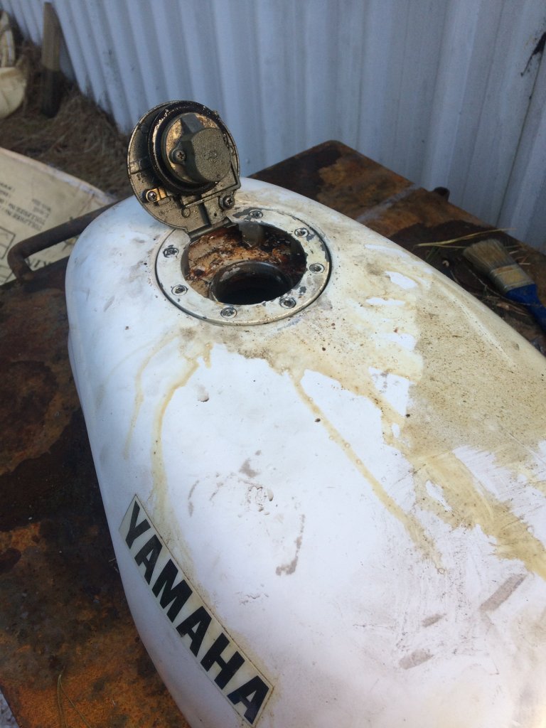

Duke Blackwood Posted August 3, 2019 Author Posted August 3, 2019 Forks are rebuilt now, but not installed, pending the manufacture of my heavy duty triple trees. Front pads and rear shoes replaced. Brakes bled. Hub dressed. Now it's time to make a start on the tank restoration.... I had to shank it open with dads good flathead screwdriver (no key) and was greeted with a combination of varnished rotten fuel and rust.... she's in pretty bad nick. I watched a YouTube video that said to fill the tank with aquarium gravel, wrap it in a blanket and chuck it in the dryer... that would work brilliantly I'm sure, but the old lady would never allow it, and with my recent track record of comical accidents I would no doubt Chernobyl my shed with a fume based explosion. So I filled it with meths and turps and fuel and 60 odd zinc washers and took it behind the shed and gave it hell.... it seemed to work ok. Next step rust converter soak, followed by possibly lining the tank with a fibreglass additive as a sealant? Thoughts? Quote
