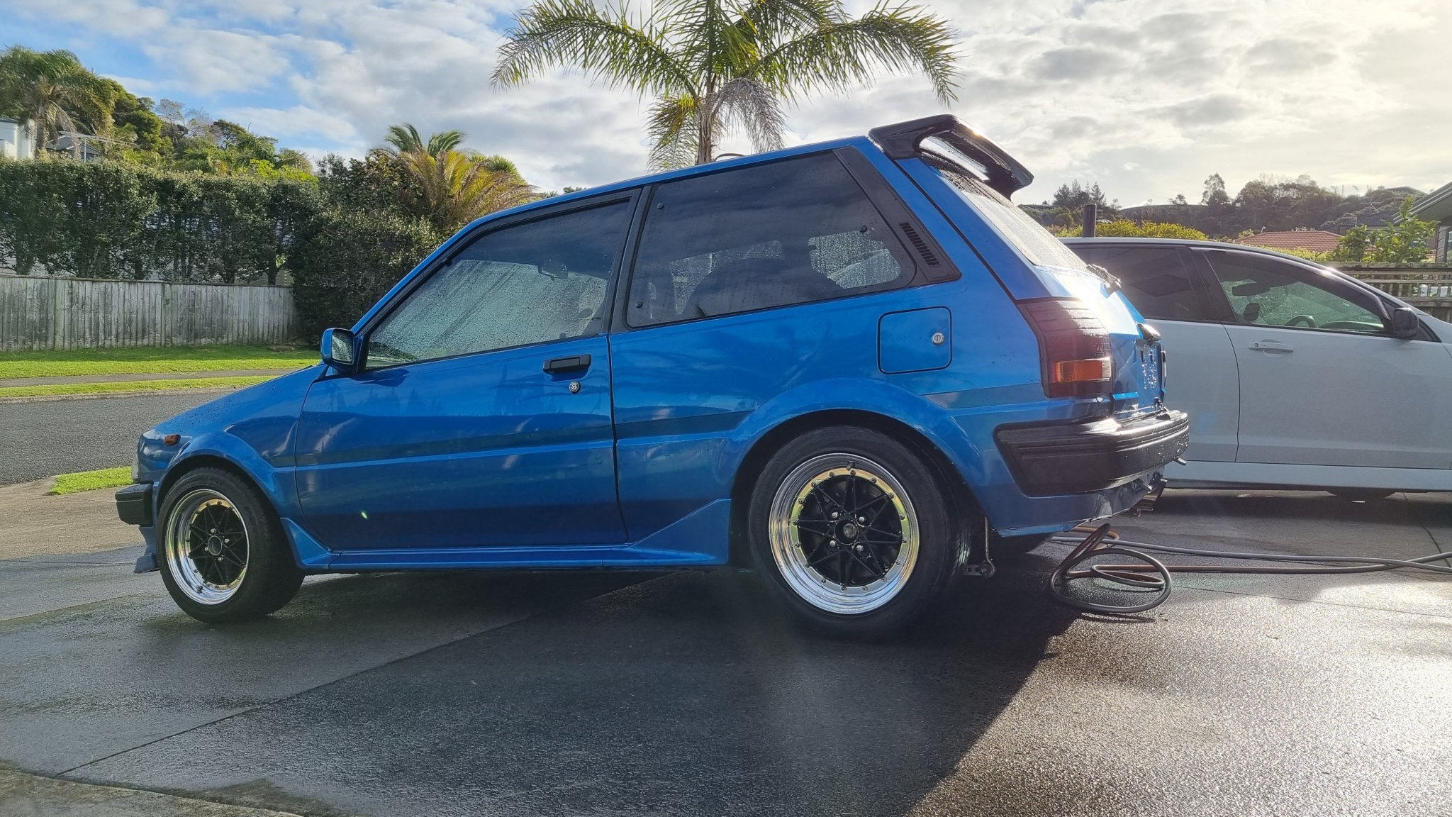

Popular Post Stu Posted July 4, 2021 Author Popular Post Posted July 4, 2021 Oh yeah, I also added this turd to the fleet. I have no idea why, seemed like a good idea at the time. Will likely move it on if anyone is interested. Its a 1985 EP70, that someone has spent alot of time/effort/money into squeezing a silvertop 4age into. Its quite hilarious to drive and unlike my blue car it doesn't try to kill you. Comes with a Link g4+, coil overs, si interior, rear disc brakes, etc. If I keep it I'll turn it into a track hack. It needs some new panels and a few bits so if anyone knows of a reasonably tidy EP70 going or not then let me know - just needs to be tidy. 16 1 Quote

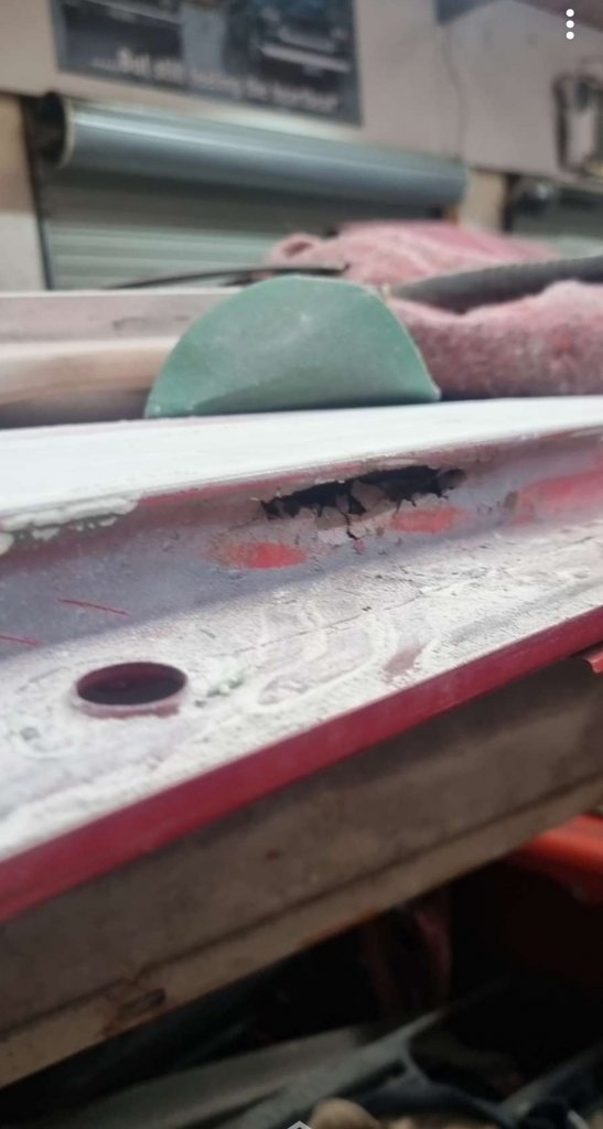

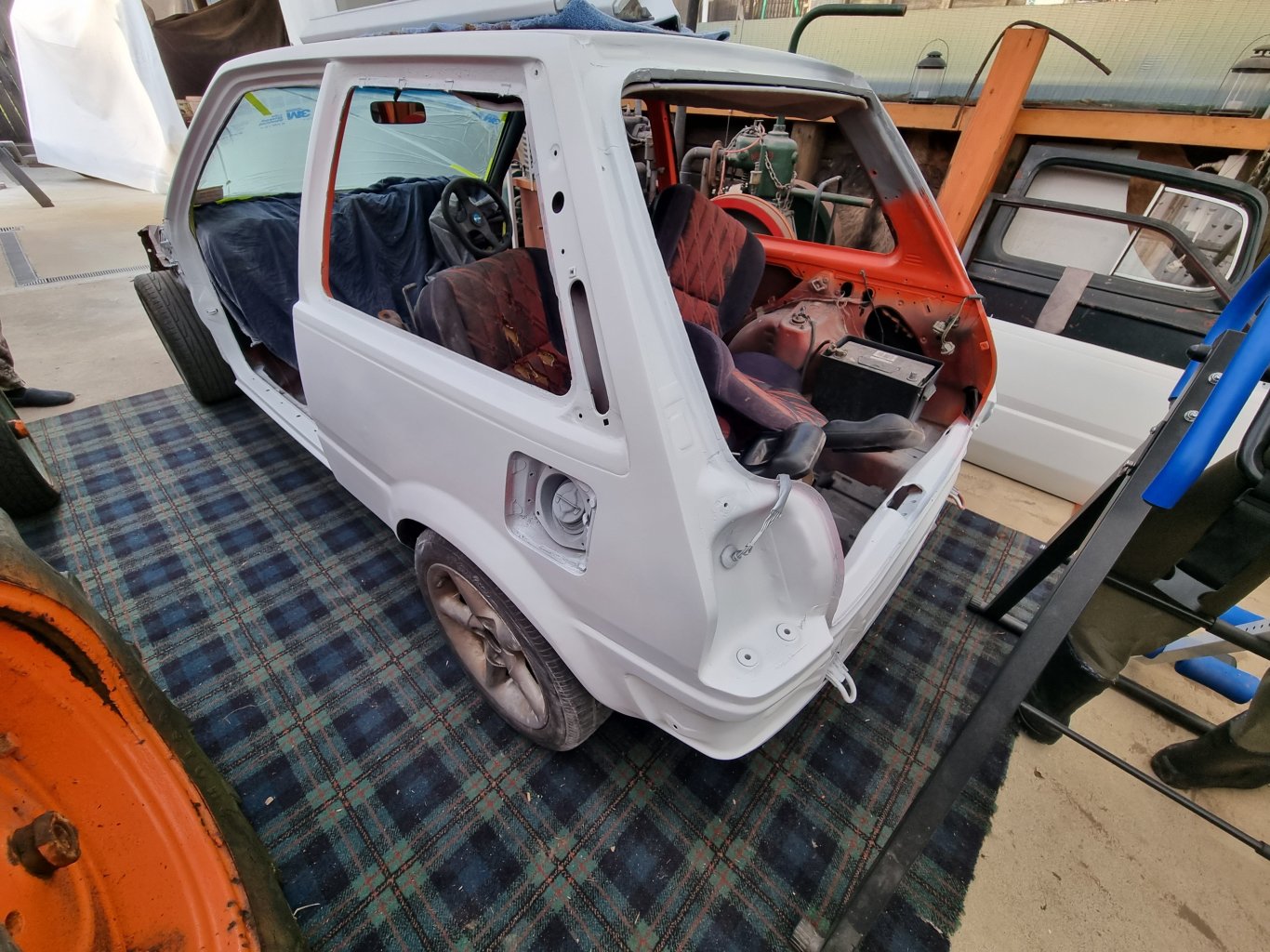

Stu Posted June 7, 2022 Author Posted June 7, 2022 Oh yeah, also found another hole in the NA 4age EP71. Fuck I hate bodywork. Everything else is looking good though so hopefully in the next month or so it will be close to ready to paint. 6 2 Quote
