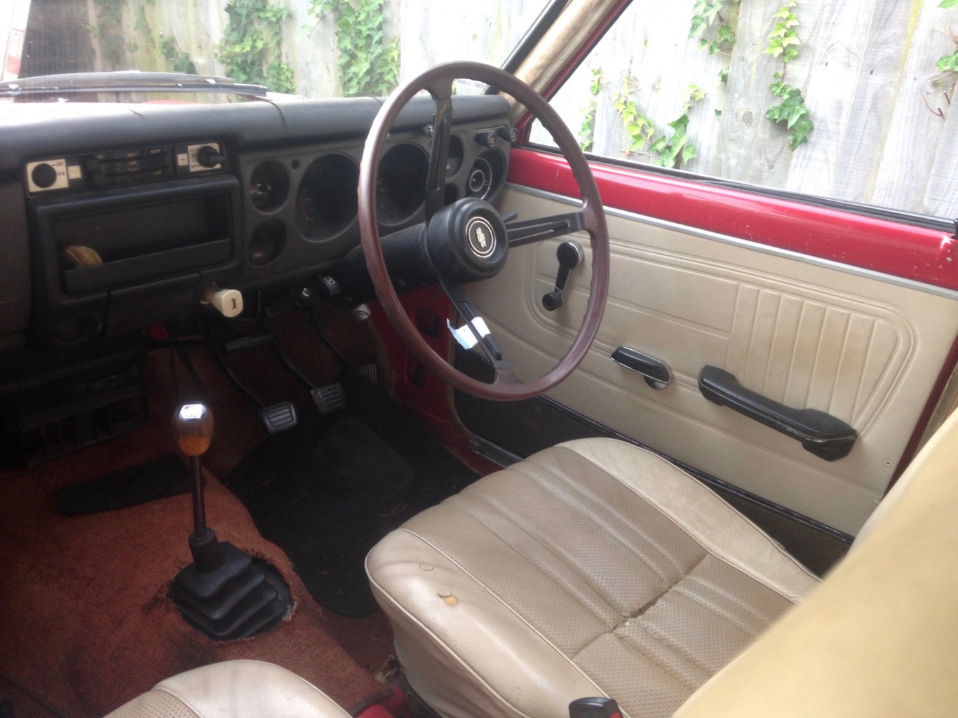

With mechanicals looking ready for a drive I moved onto the interior, how about the stolen dashboard you say? well as luck would have it, a history of writing off Datsuns racing had left my father with just enough bits to kit the car out as required, he even produced a full set of badges that I now have tucked away awaiting some modern technology for reproduction.
The carpet was very much in fine race spec consisting of two or three coats of red paint, in order to prevent my girlfriend from running off halfway back I needed something to muffle the road noise, once again the family parts warehouse presented a front carpet in the most delightful shade of poo brown, matched with carefully positioned black mats to cover the tears a more suitable environment to conversation was produced.
Yup, white interior, far better suited to summer!

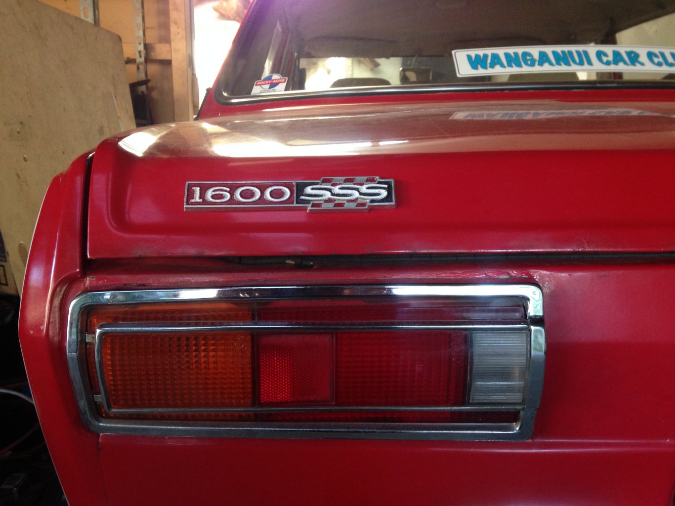

Had another play with casting the badges after work....
Built a new mould using timber scraps
Left the plaster a couple of days between each pour, the last few practice moulds had been too green and I lost detail removing the badge.
Baked it out for 24 hours and then poured at about 200C, no bubbling/spitting at all.
Not 'perfect' but so much better than the previous attempts and I have proved a few fundamentals for myself.
IMG_7893.jpg.5fcc8ed537a8de36b7610b2732e24f2c.jpgIMG_7894.jpg.3b66cb2973500d8ceb8ce5a1756a7748.jpg
Gave it a quick file and it fits the contour of the bootlid surprising well, considering the worst bits can be filed out or painted over, it may just do the trick.
Managed to scratch up some suitable paints from the horde and now the badge looks much better than expected, time for a beer!
